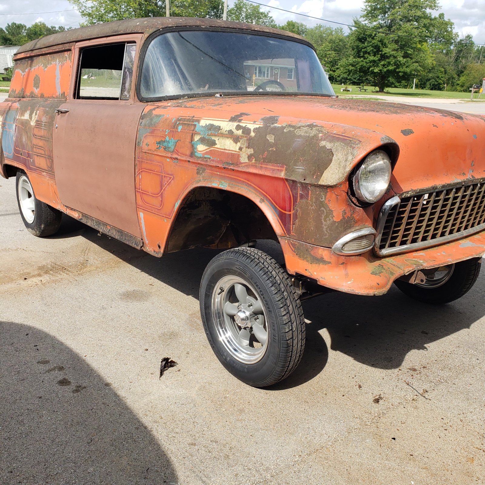

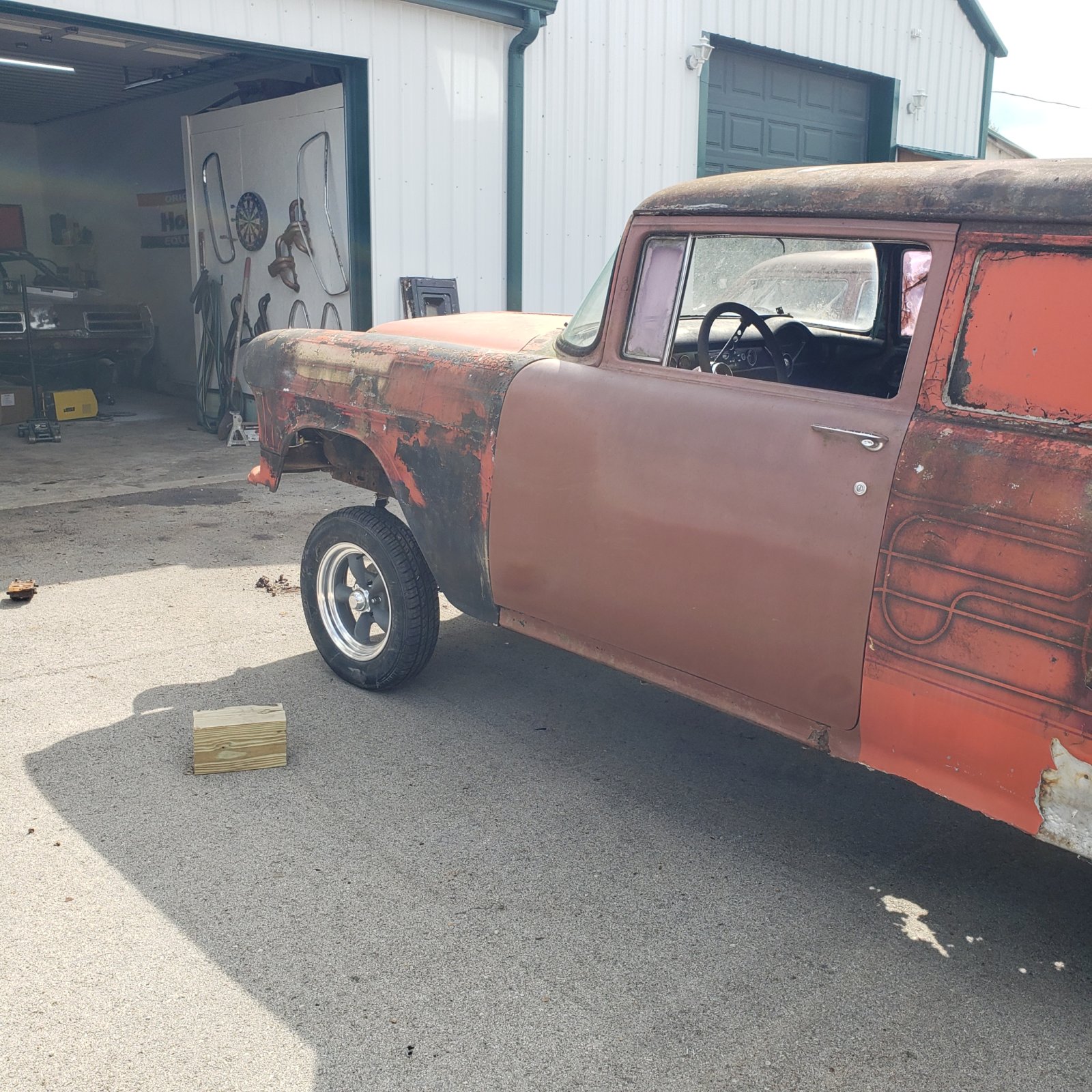

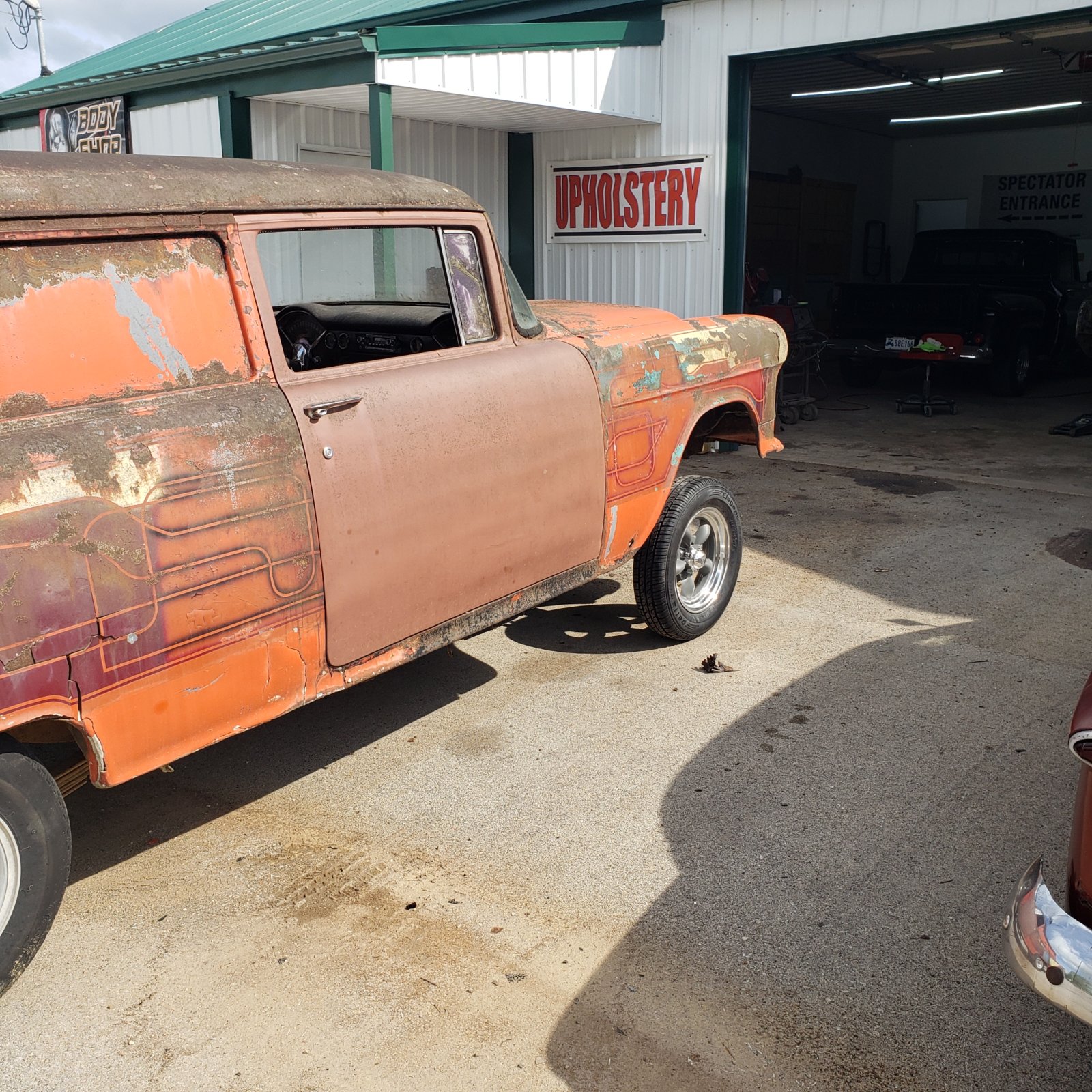

    NEWSFLASH!!! rear tires are mounted. That's all for now.. 20240728_135426.jpg

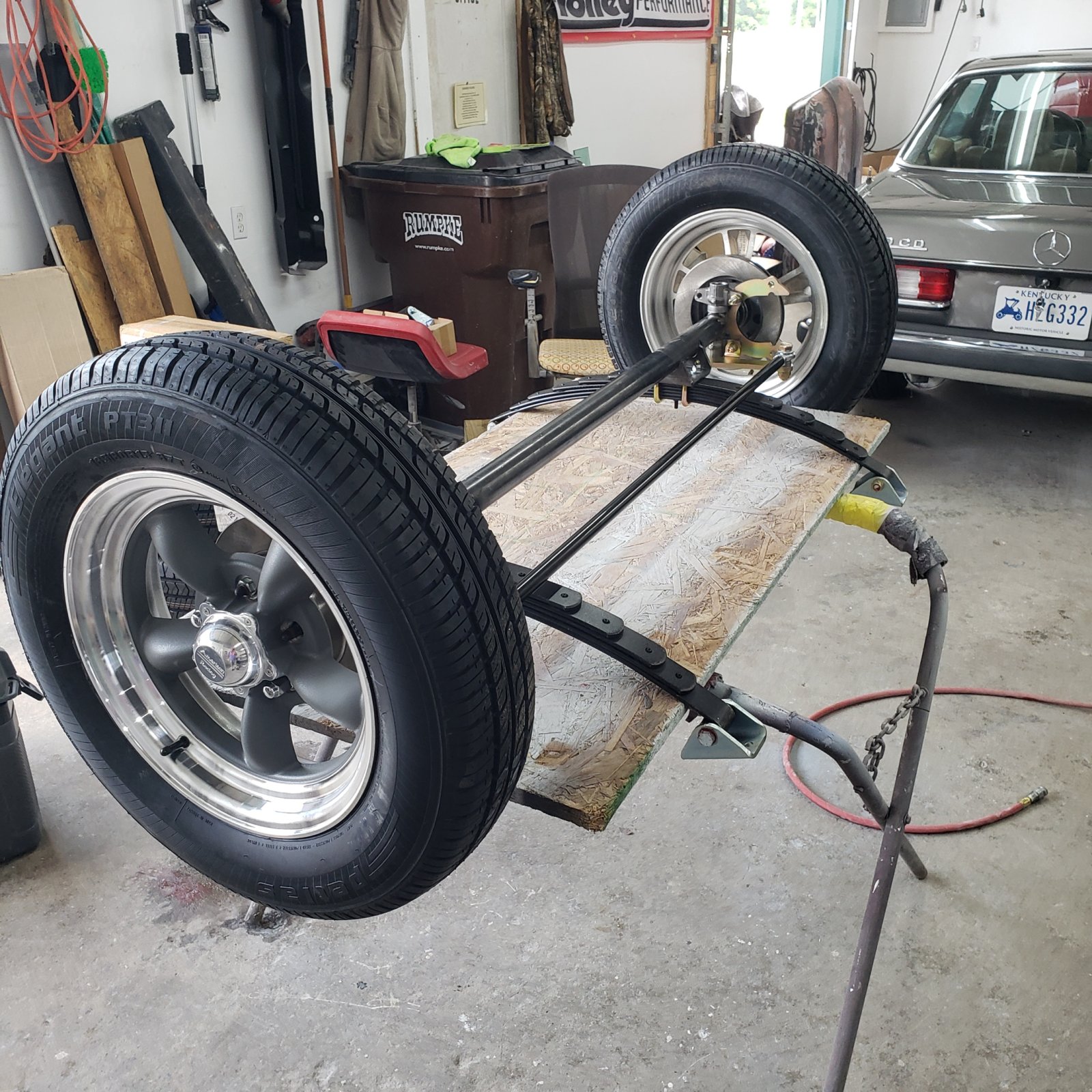

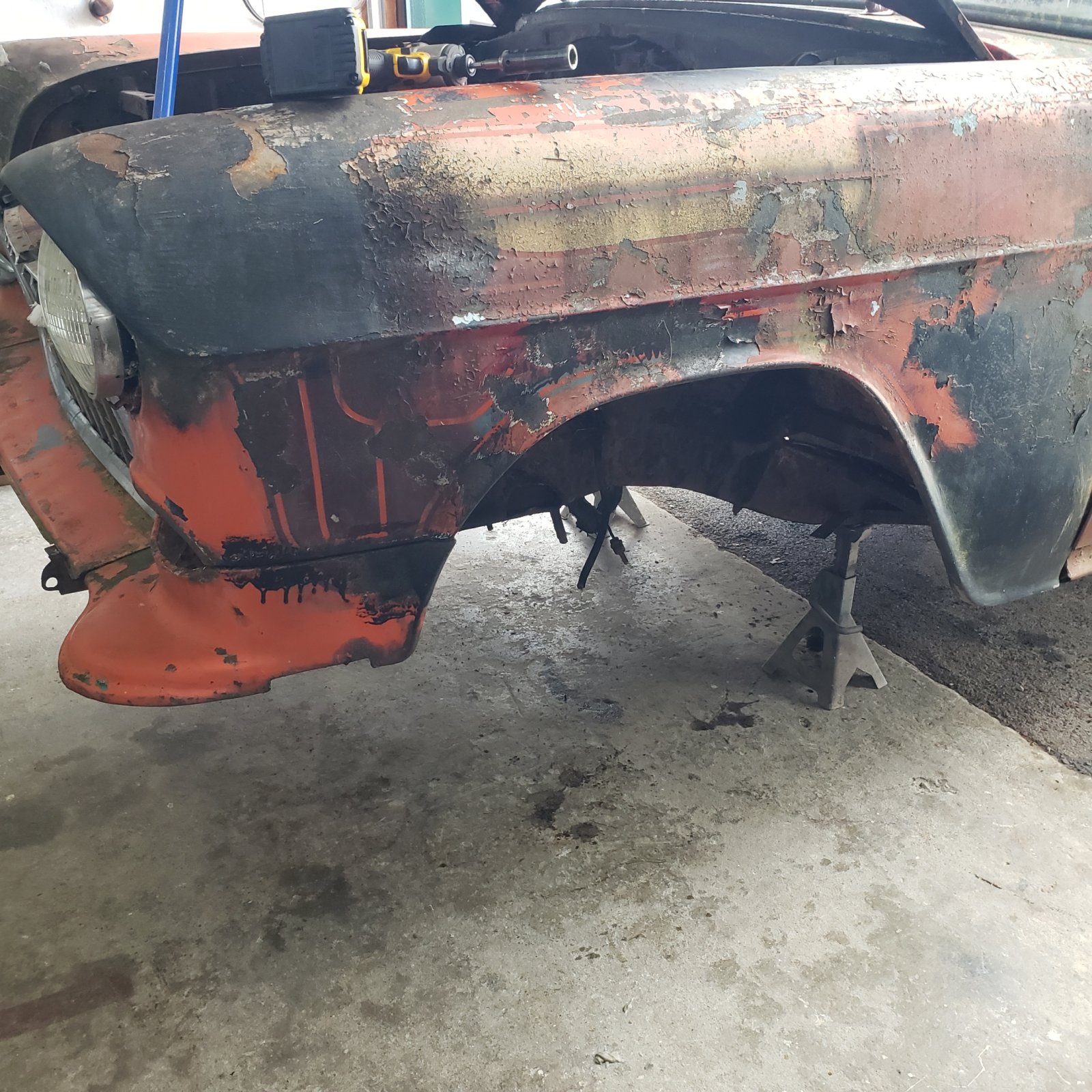

    Got tired of block sanding so I did a couple little things to my car before I went home today... 20240729_150729.jpg 20240729_151751.jpg 20240729_165223.jpg 20240729_165234.jpg 20240729_165243.jpg 20240729_165253.jpg 20240729_165629.jpg
  17. Lloyd's paint & glass
    Joined: Nov 16, 2019
    Posts: 10,904
    2 hours and 10 minutes. I think it's my new record lol... still some welding to do, and I've gotta go get a piece of tubing to make my drag link, it's rigged at the moment so I can steer it lol
