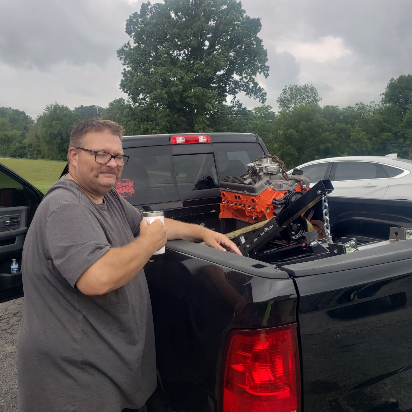

    Opinion time, you see the cam profile, it has around 11:1 compression, it has 2.02/1.60 valves, should I buy a performer rpm air gap dual plane, or a Victor junior? Keep in mind, this isn't a drag car.
  7. Budget36
    Joined: Nov 29, 2014
    Posts: 15,372
    Budget36
    Ya know, I’ve always liked the performer. Never had the RPM version.
    Isn’t the Victor Jr a single plane intake?
    Edit: get the carb you want, try out what you have. If you want more, then think about changing it out.
  8. Sharpone
    Joined: Jul 25, 2022
    Posts: 3,018
    Sharpone
    Since the cam is a Big Daddy Rattler maybe that should be the name of the car. IMO I think the carb/manifold combo will limit the engines performance some, what about an original Z28/LT1 manifold very good all around, I believe there are clones , the performer RPM is liked by many and is what I plan on using in my next build.
    Dan
  9. 427 sleeper
    Joined: Mar 8, 2017
    Posts: 3,371
    427 sleeper
    A Performer RPM with a 3310 vac. sec. Holley is a good combo. Not sure if the air gap is worth the extra money.

  12. swade41
    Joined: Apr 6, 2004
    Posts: 14,523
    swade41
    from Buffalo,NY
    4 hp and 4 tq according to the CarCraft manifold shootout
    HEI distributor won't clear those right

  14. chevy57dude
    Joined: Dec 10, 2007
    Posts: 9,715
    chevy57dude
    An Edelbrock Scorpion would be a cool vintage manifold for it.

    Use the HEI out of a 3 rd Gen Camaro or Firebird with tuned port injection. It is a smaller diameter cap with an external coil. You might have to change the module to a 4 pin so it will work with a carb.

    I'm gonna run my Mark Moriarity point setup on this engine.
  22. Lloyd's paint & glass
    Joined: Nov 16, 2019
    Posts: 10,913
    I have a new long water pump and pulleys, I'm gonna run the alternator on the right side.

    ditch that POS intake and carb. put a decent dual plane intake on it with a 750 Holley . Are you going to tow a trailer? It will make power from less than 3000 but you have to figure out how you are really gunna drive it and what rear gear your going to run. So many variables to a good set up ....It's all about looking at the big picture.

    You got O/D and tall tires in the rear. Put a 4.11 gear in it and you'll never be able to wipe the **** eatin' grin off your face! :D:cool::p Plus you'll get decent milage. ;)

    The cam will still make power below 3000, enough to get that wagon moving along and have a healthy reserve for the p***ing lane.
    People get to caught up with reading statistics and think the engine will be non working outside the power band, the recommended power range is where the cam works optimal but millions of cars on the road going about their business are not working optimal.

    I don’t think so, I can verify before work, but no advance in the distributor. It just spins, the brains do all the advance.

    Good information about HEI fitment here. But I'm happy to hear that you are running points. Swade is right, that 350 will move the car fine under the power band. Then above 3k it'll really come to life!
