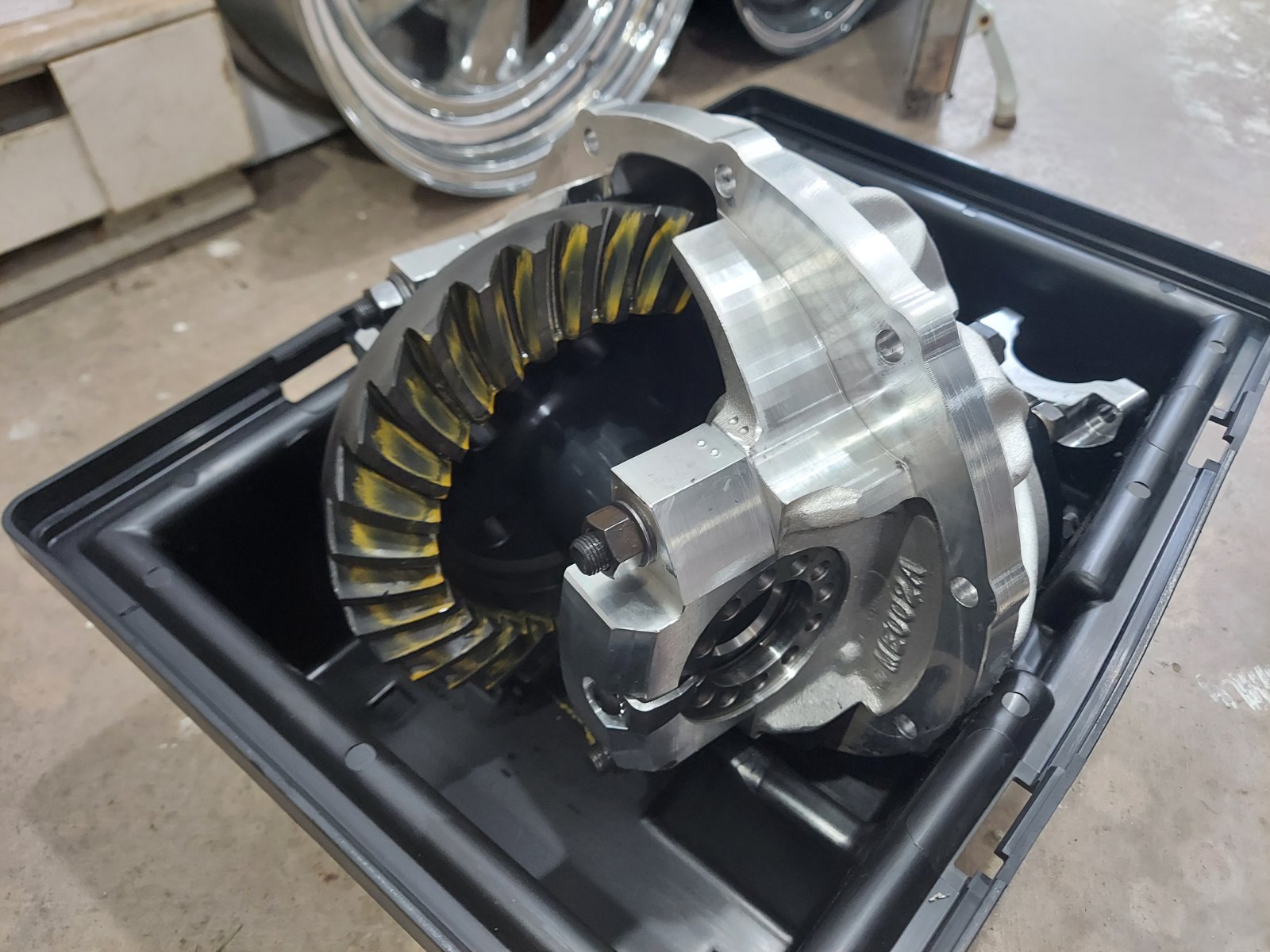

    A 9 inch is what you needed. Not fast at it, but I can perform the poor man's quick change in about 90 minutes. Later down the road you can get a pumpkin with 5.13's for some 1/8 mile fun!

    I'm gonna put 4.10's in it. RPM calculator says that those gears, 28" tire, and .073 overdrive is 2450rpm. I like that. I ordered a radiator from Jegs this morning, if I go on and spend $60 on brake shoes and wheel cylinders for the 10 bolt, and $60 on a master cylinder, I just might be able to drive this beast over to Lloydfest :cool: not sure though. Running out of time quick

    I had a 9" in my old '40/'37 pickup. As I recall, I had 3.23 for the street and 4.56 for the track. Changing gears was about a 3 hour ordeal...hate the smell of 90w.

    4.56 with a spool is my track setup. Aluminum case, through bolted mains and billet pinion support.
