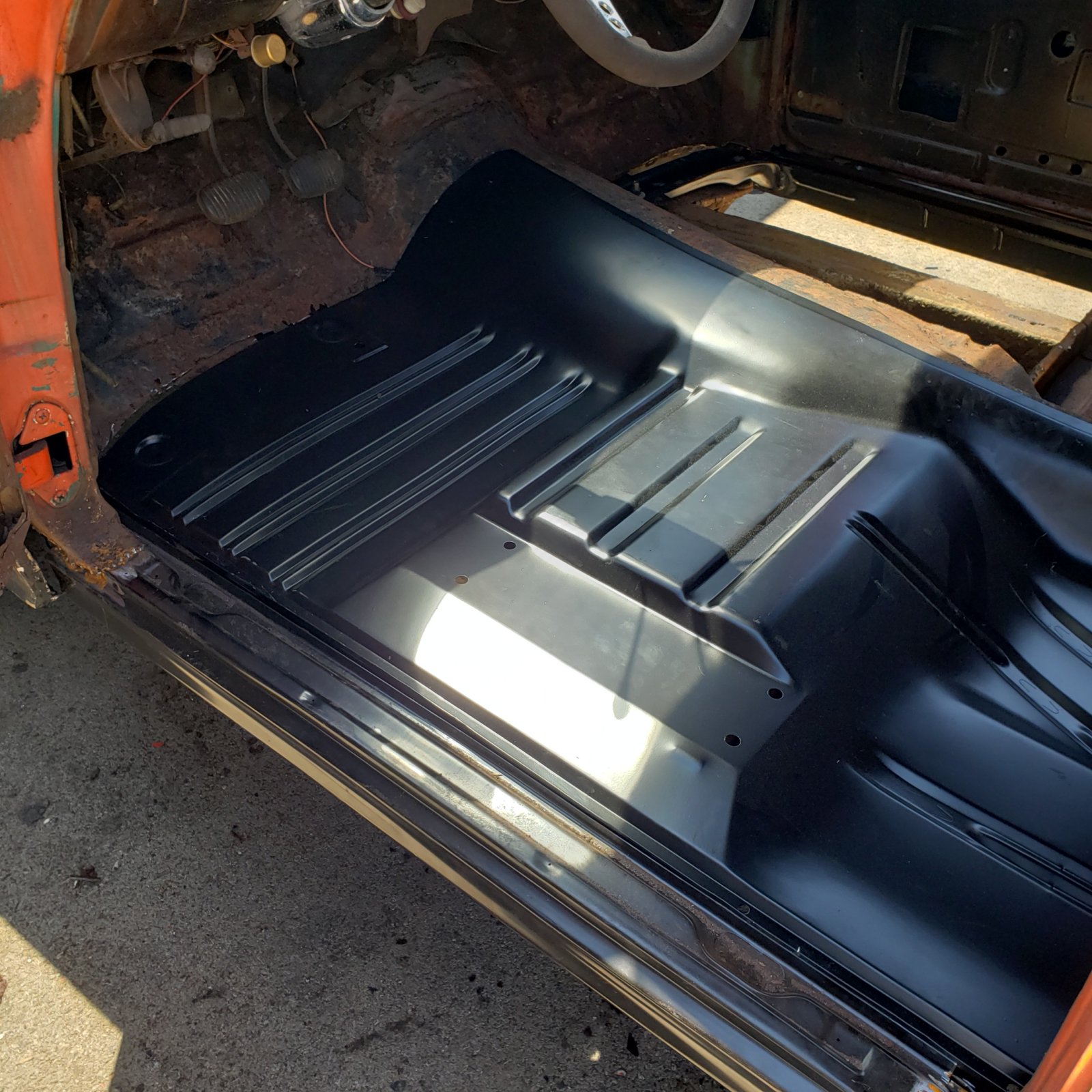

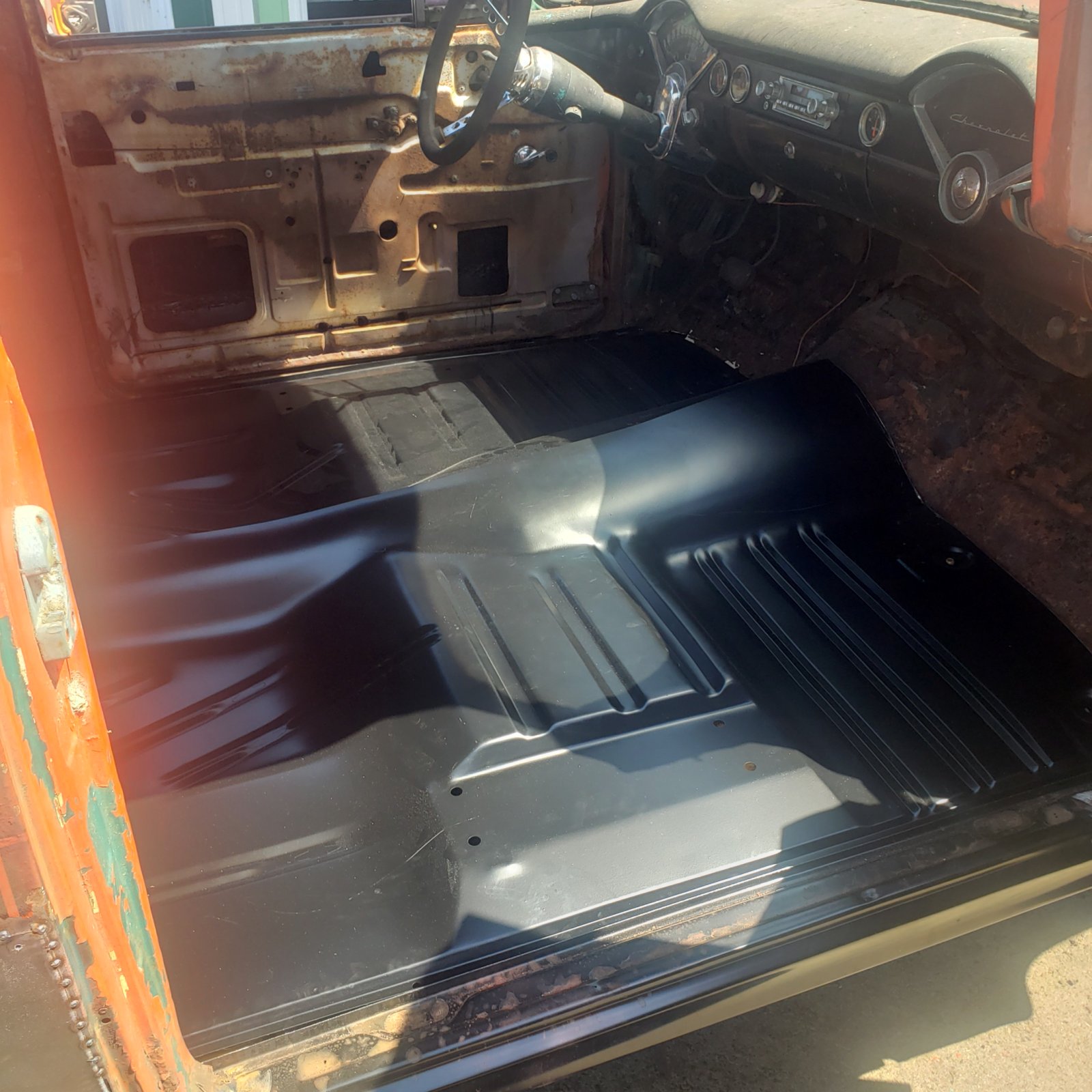

    Just fitted, not gonna weld them in until I sit the motor and trans in, that way I can weld the crossmember brackets in from the top lol 20240810_144708.jpg 20240810_150653.jpg

    Man, that is definitely a nice way to do the floor. I know it isn’t cheap, but sure saves tons of labor and time.

    $700, had free shipping. Sherman I believe, the rocker kit was almost that much, it came from golden star. The floor braces came from golden star also. I need the rear floor, but I'm thinking flat 16 or 18 gauge from metal depot. I don't need a spare tire well.

    That’s not as bad as I expected.
