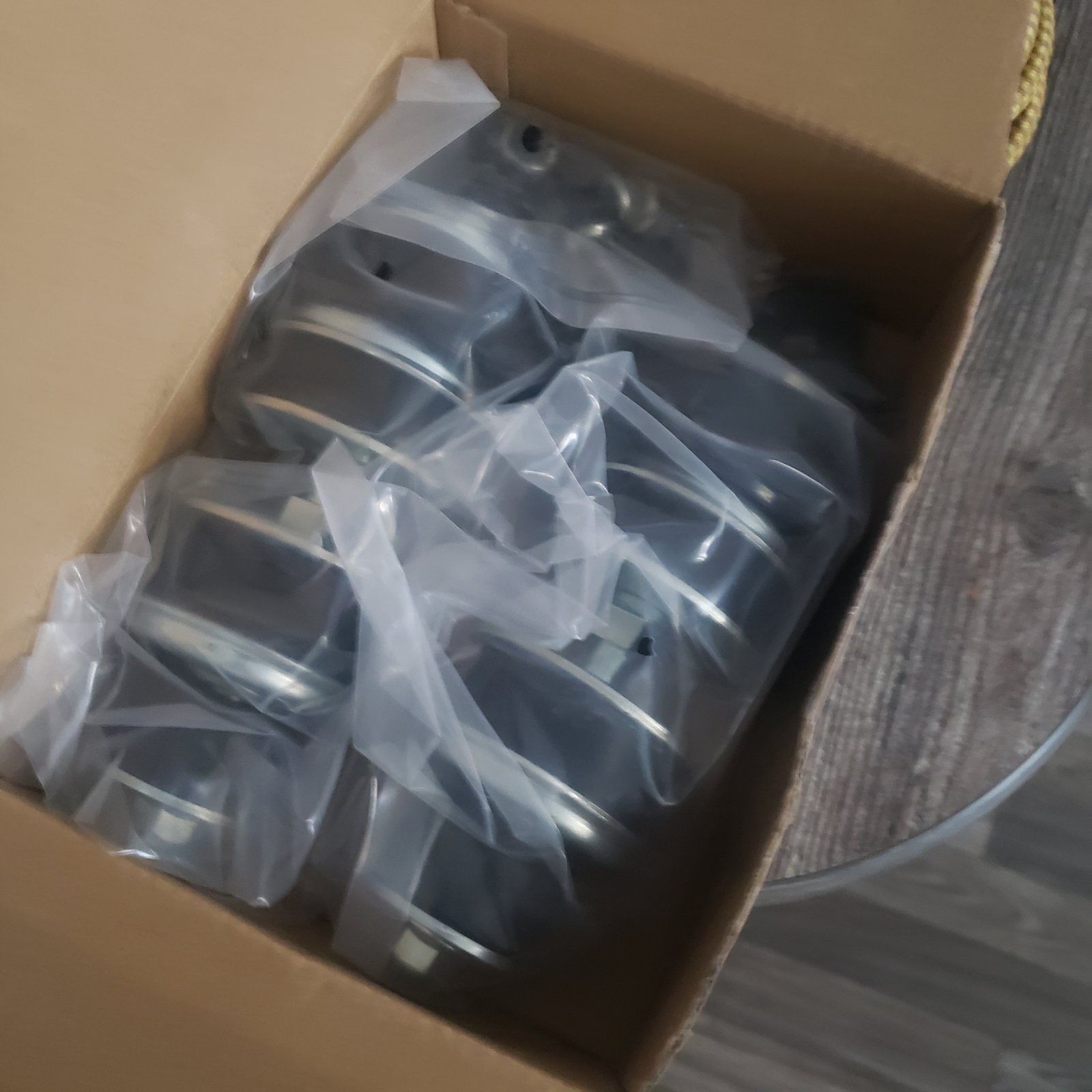

    $50 and overnight. Man it's hard to believe how things used to be. 20240830_160817.jpg

    For those of us wondering. What inside? I can’t tell

    Those are tri 5 engine mounts

    The idea is to use the stockers to locate the block. Then install your side mounts. But if the front mounts aren't in the way, you might as well leave 'em in place.

    I don't believe they'll work with my 8" balancer, I'm not sure, but I've read it. We'll see.
