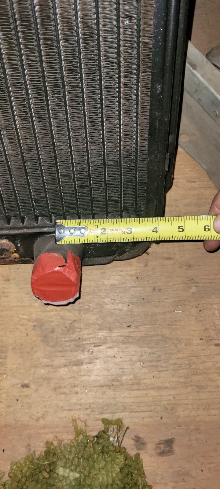

    Yeah I didn't feel good so I quit and came home. I don't know if it's the outlet on my radiator or what, but it's pretty much running into the mount. It's gonna be simple to make the brackets for the side mounts now.
  6. At first glance at this photo it looked to me the outlet was to far inboard also.
    I have a 1955 factory-built V-8 Rad so I went and took a measurement from the edge of the Core to center of outlet. Looks to be exactly 4".

    Guess I just need to see a stock bottom radiator hose. I'm gonna pull the front mounts after I weld the side mounts anyway.

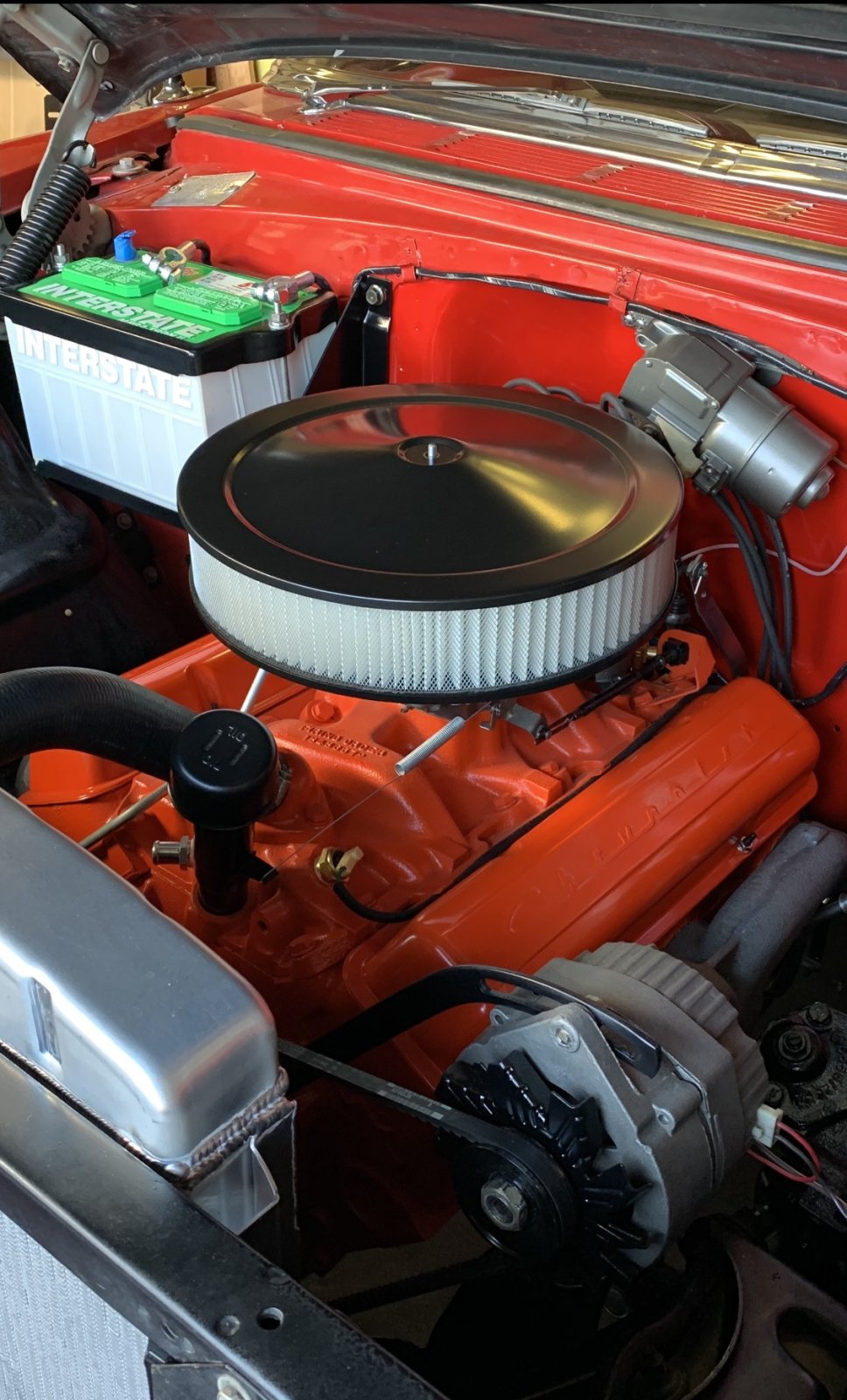

    I used factory lower hose and it all fit well.
  10. That is one good looking engine.

    Now that I’m more awake. I should have mentioned that I picked up a 57 air cleaner (type shown) (56 unit are too tall for my liking) for Carina’s car and have since painted the radiator tank black. IMG_3018.jpeg

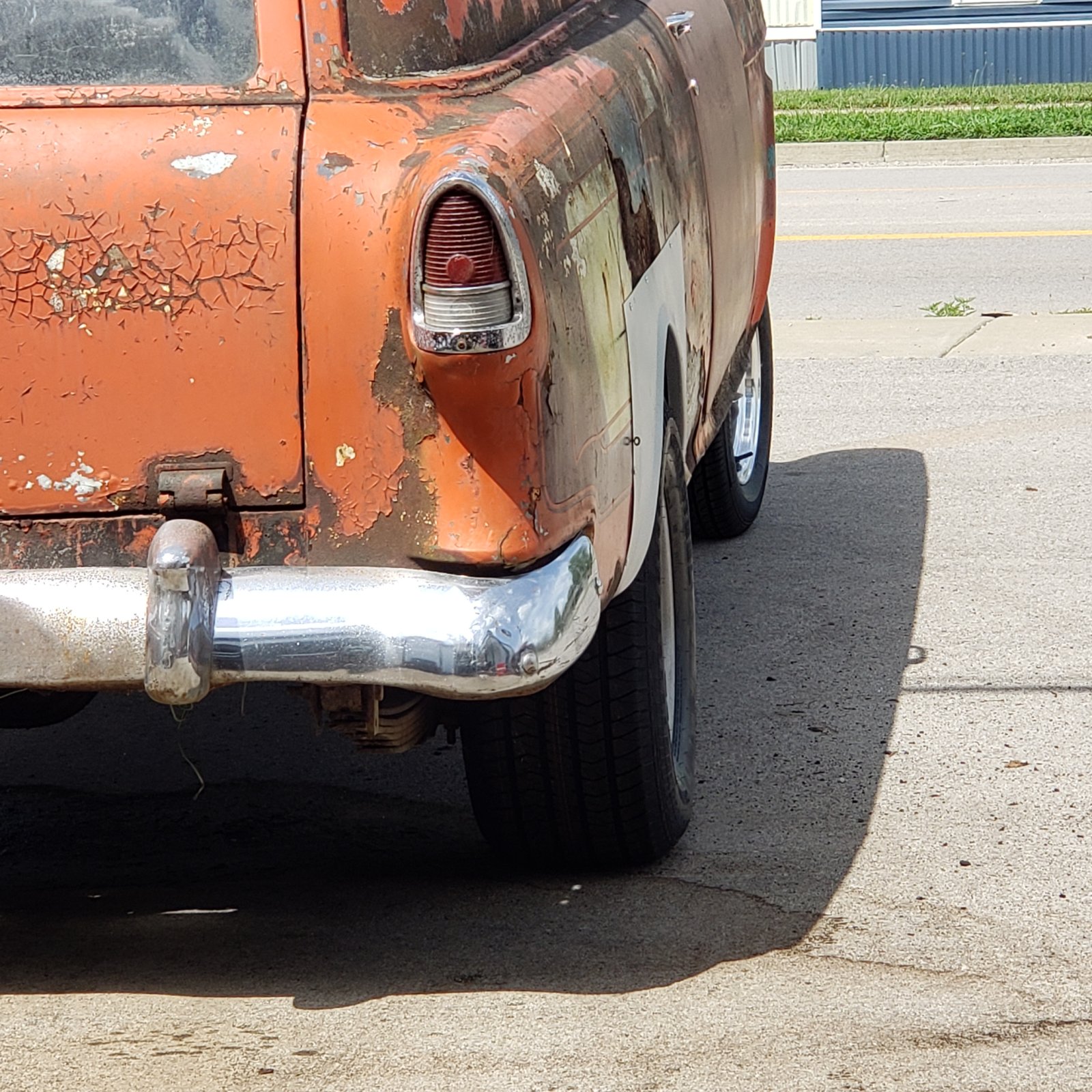

    Moriarity
    SUPER MODERATOR
    just my opinion but moving the springs under the frame for tire clearance? tires need to stick out or be right at the wheel lip. straight axle cars with the tires under the fenders (ala pro street style) look dumb, two different eras fighting each other....

    The rear end in using is 62.5" wide. Effectively moving my rear tires out a little over an inch on each side. Which is why I wanted a 62" axle. I have no limits coming further out with the radiused wheel openings. 20240801_150820.jpg

    all the more reason to not go through the extra work of moving the springs...
