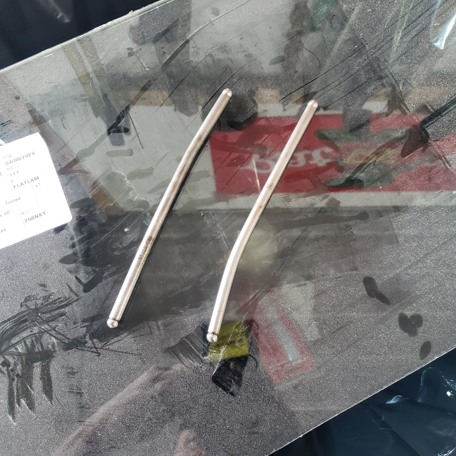

    Lloyd..so why the bent pushrods? What was wrong?

    Hey Lloyd , do the heads have guide plates? If so check that the push rods are hardened. Just trying to save a brother from more grief:cool:

    Cam timing. Yeah I've been a prick. Sorry. But I live alone, so I have to be an ass to my friends on the internet. I threw shit, kicked a dog, punched the old jehovah witness lady in the fupa, etc... but I sent a picture of bent pushrods to @lumpy 63 , said it looks like i get to pull heads... he told me to check the cam gear first. At tdc on the crank, the cam was ar about the 10oclock mark. Redone all of that, replaced pushrods, and life was better. Also want to add that the Chineseium rpm copy intake gave me a little headache with sealing. So keep that in mind if you go that route.

    No sir. I put "vintage gm" pushrods and rocker arms back in it. Time tested if you will (used) ;)
