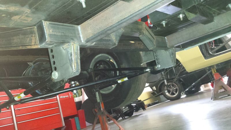

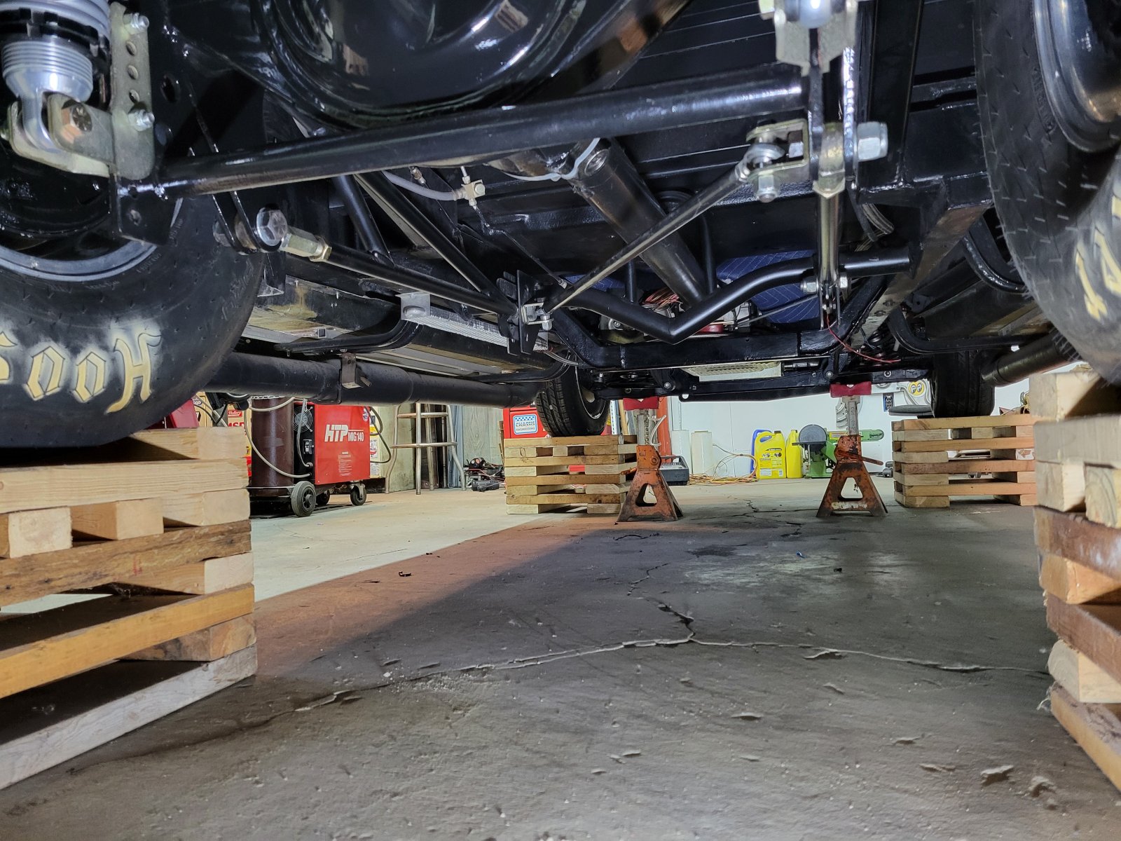

    No dickhead... :( working on customer cars.... trying to decide on the rear suspension. Of course the easiest thing to do it leave it alone, and change the perches on the 8.5", but I'm not at all happy with the leaves. Looks like he took 2 main leaves and burnt the eyes off, then added them on each side. There's 7 leaves. But if I go with ladder bars and coilovers, it seems that I've gotta lose the factory gas tank to make room for the coilovers and crossmember. Hurts my soul that I've already bought the ladder bars, coilovers, ladder bar crossmember, coilover crossmember, and coilover brackets for the axle tubes, and not gonna use them. But I still need to order a panhard bar setup. So.... here i am. I'll sand on some primer and filler for a few days while I make up my mind lol...

  22. You can use a ladder link instead of a panhard bar, I have them on 2 of my cars.
    https://www.summitracing.com/parts/...PSS_kzsB4ntZEKPfmjfj4tc_2KhNcPz8aAiEWEALw_wcB
  23. Like this, so you can have rear jets

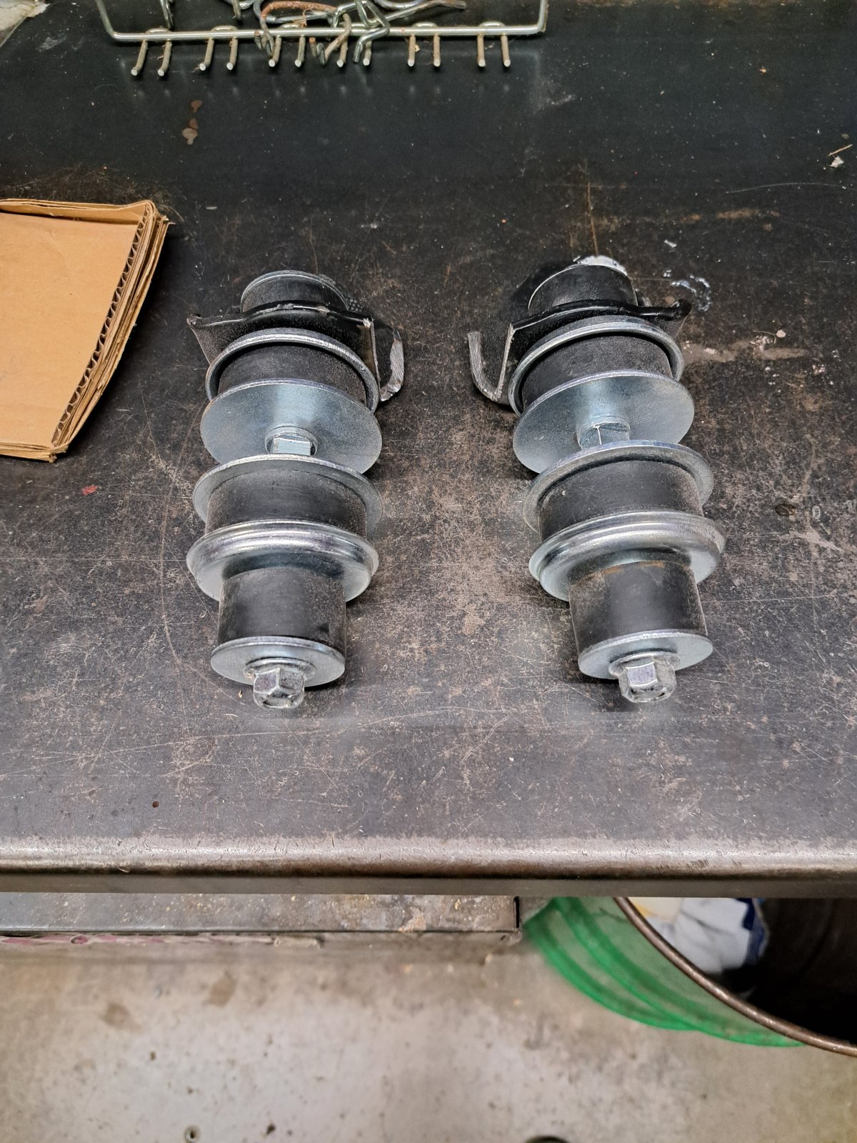

    Figured I'd jump in and work on my clutch linkage this evening before I came home from the shop. It hit my that I had a Z bar pivot that bolts to the block, that I took off of a 2nd generation C10, so I dug out of of a box and gave it a try. Had to add a piece of plate to it, forgot to take a picture of it done, but it worked awesome. With that figured out and assembled, I was trying to figure out the cross bar bushing issue. Didn't wanna hack it up too much, but after talking to ol lumpy, he recommended converting it to a heim joint. So I ordered a bunch of 3/8" heim joints. Still cheaper than the cross bar bushing kit lol. So it has a Z bar in it now, just not hooked up to anything :rolleyes: 20240924_155430.jpg 20240924_170220.jpg 20240924_171659.jpg
