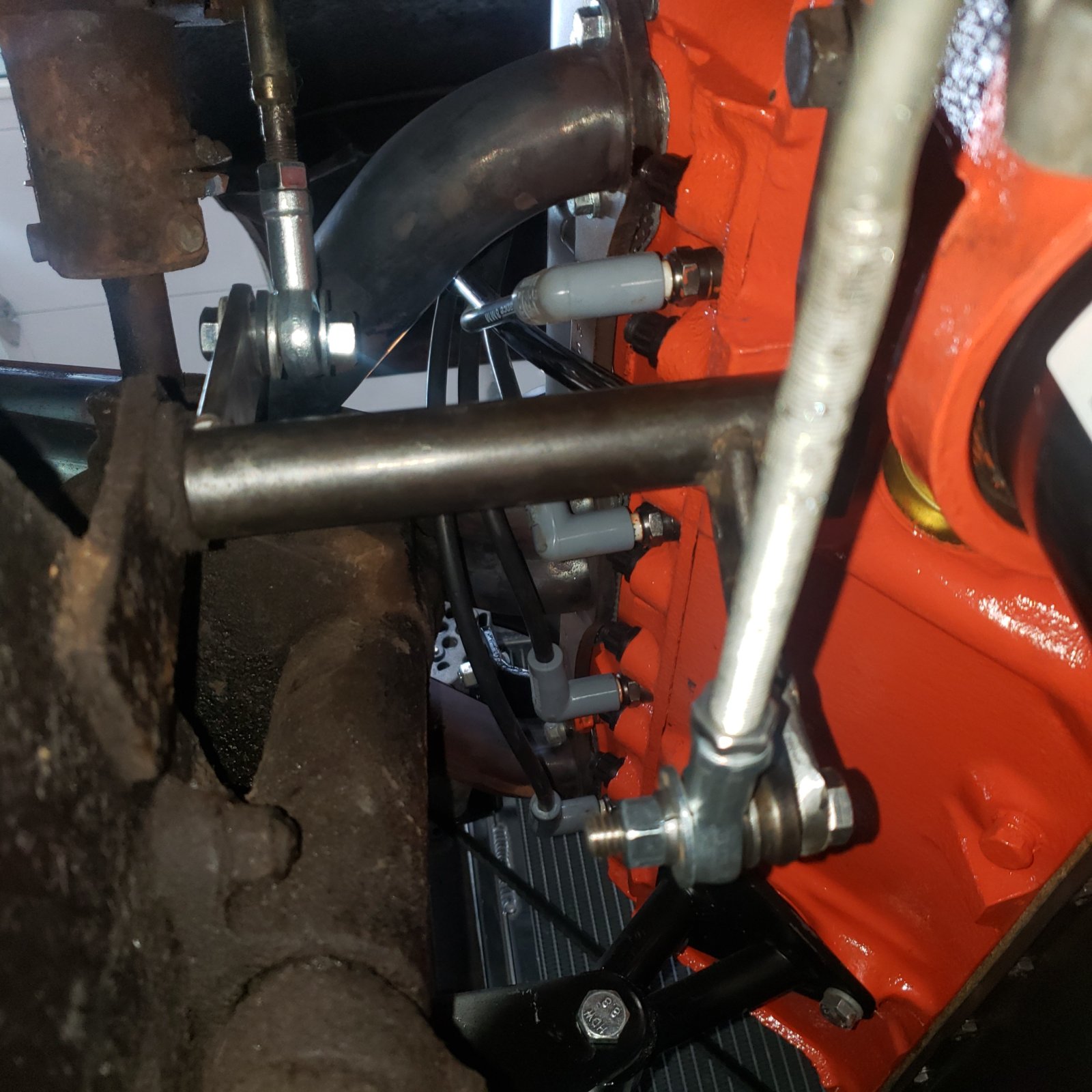

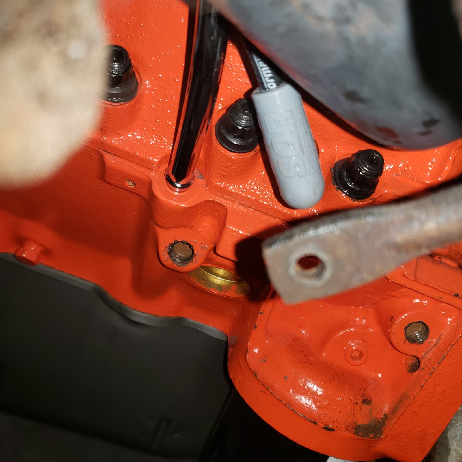

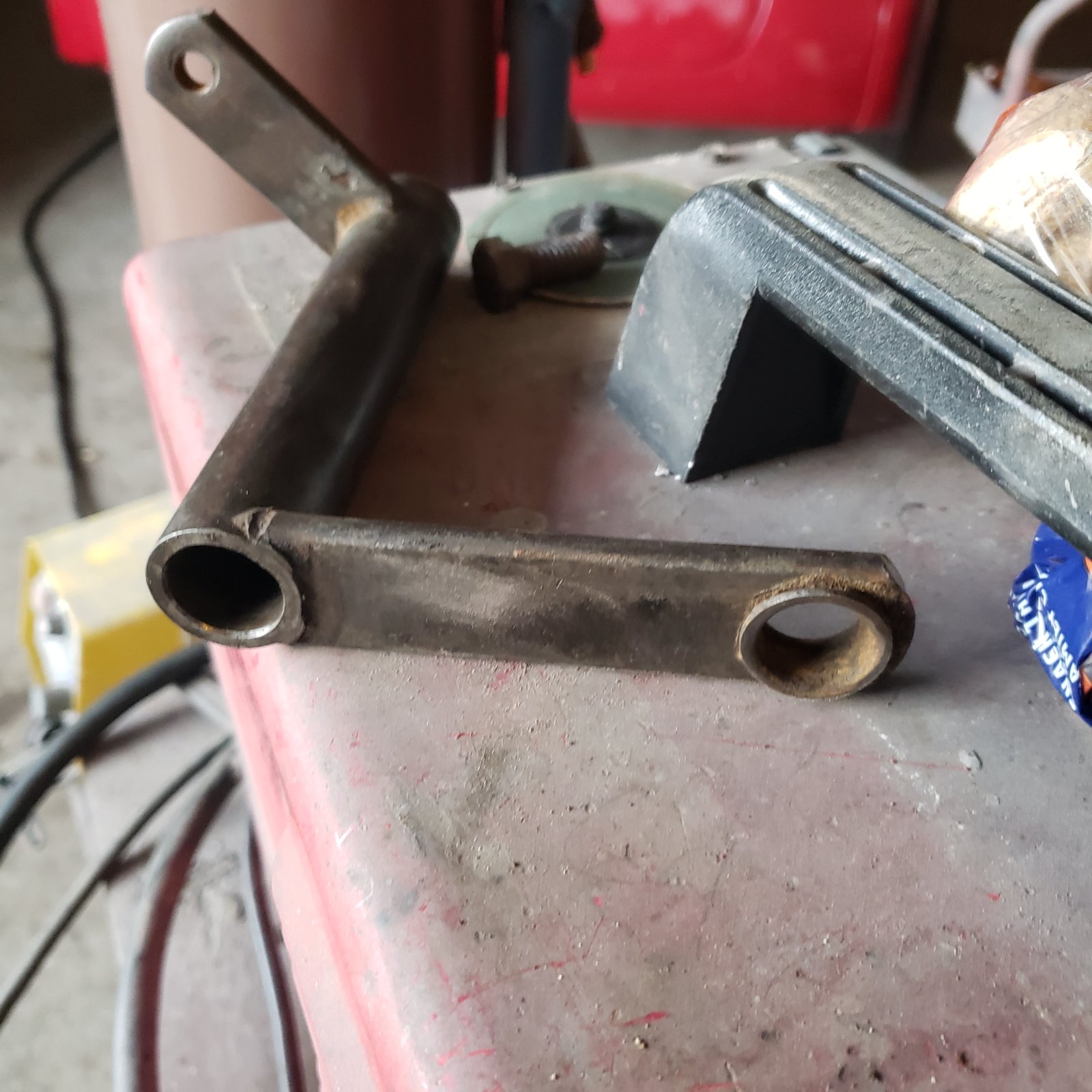

    But yes. Have you seen the stock cross shaft bushing setup? That hole in the end of the pushrod is 1/4"

  6. 3/8” Heim joints are very popular on medium/heavy duty truck clutch linkage. They will be plenty strong.

    Yeah, having a 3/8" bolt vs a 1/4" bolt is a no brainer lol... I stared at that thing, walked away, came back, stared some more.... it's a shoulder bolt, with 1/4-20 threads. I'll fix that. Thanks to Amazon, they'll be here when I get home from the firehouse Thursday morning :cool:

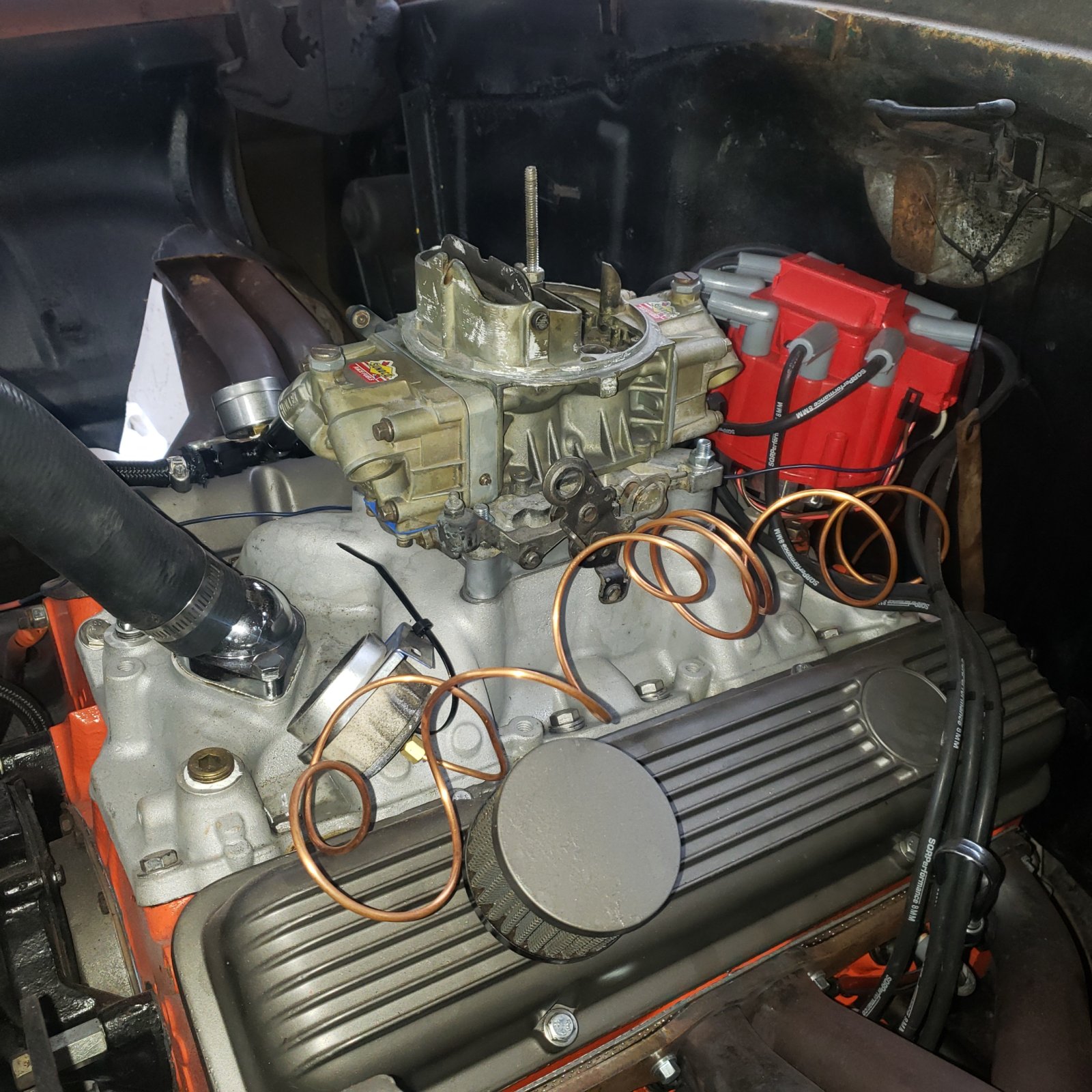

    OK I have a clutch now. And I pulled the master cylinder in prep for the new 2 pot flavor. Also put the 750 on it. My buddy Dave was at the shop, he helped me with the clutch pedal duties, fired it up and made him smile. Dave was the cat at Lloydfest with the 390 Galaxie. 20240926_165045.jpg 20240926_173511.jpg

    Looking great, Lloyd. That oil pressure gauge is gonna have to make it inside the car soon!
  14. There is something so right about a Holley on top of a Small Block Chevrolet.

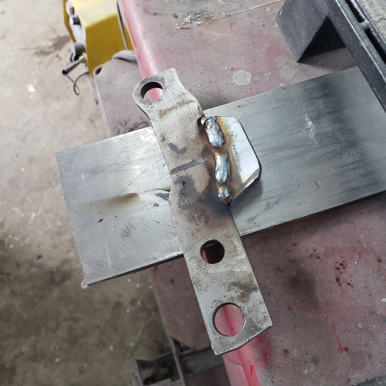

    Consider welding some gussets on the Z bar arms.
