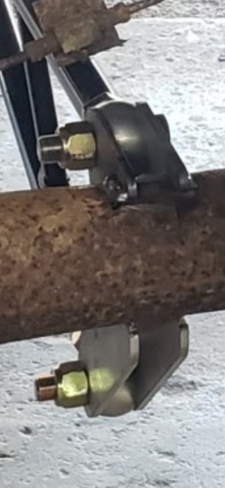

    It's all separate pieces. I said earlier that they were Comp engineering bars, but the crossmember is competition engineering, bars are jegs 32" adjustable, coilover crossmember is Allstar performance, and the coilovers are off shore pieces, I call them "coilrovers" :D:cool::p
  2. Lloyd's paint & glass
    Joined: Nov 16, 2019
    Posts: 10,410
    I did this different than my usual bullshit, I set it all up on the stock rear. Brackets are just tacked to the axle tubes. Now I've just gotta cut the tacks and pull it out, put the other axle in and set pinion angle, weld the brackets. And I took a hole saw to the frame rails, both crossmembers are sticking in the frame 1". Hopefully it works lmao

    I was gonna say. Welding on a rusty surface is a… :eek: :) IMG_3168.png

    Lol top quality work Johnny Gee :cool: no I ground off a spot to tack weld to. I do quality hack work in my shop. ;)

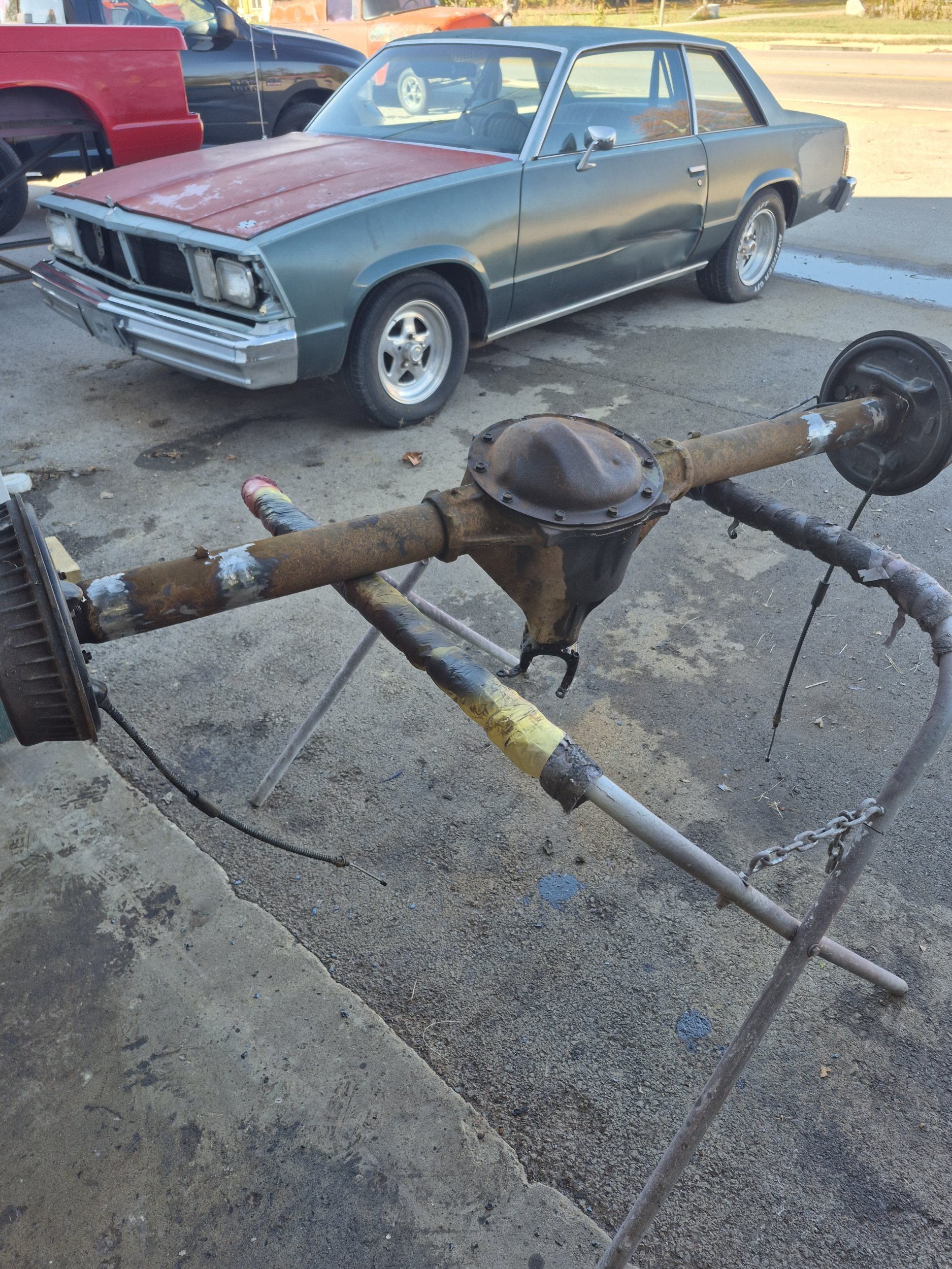

    Rear cleaned up, new brakes, might put it in the car tmrw. 20241018_154346.jpg

    8.5 10 bolt from a 72 Camaro

    Hey Lloyd, could you get the drum to drum measurement on both the 55 & Camaro rears?

  25. Steve, I believe the Camaro is 62.5 WMS to WMS. At least this is what the charts said when I was looking for Papaw. The 55, I’m not sure.

    55 Chevs are 60" wms to wms

    Borrowed this from the Camaro net site. [​IMG] .
    The 68 Camaro was 60" just like the 55, which I can confirm as I have one sitting in the shop that won't be going in the 51.

    Yep, I have a 69 Camaro rear going under my sons AD pickup and it is a great fit same as the original in those trucks.

    Stock is 60" wms. 8.5 is 62". Gives me another inch of push out on each side.
