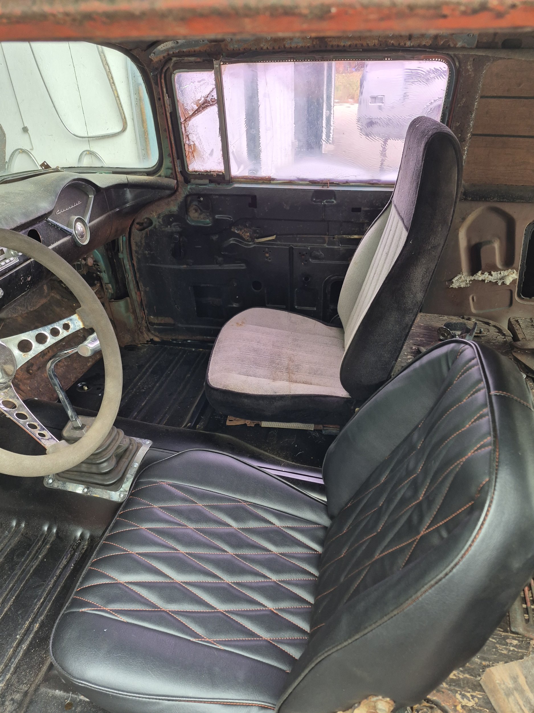

    What up *****s? I'm good, had to put the phone down and have a break lol. I've not done much to my car, customer stuff comes first, and there isn't enough hours in the day, this dark at 5:30 **** is for the birds. I did finish one of the bucket seats. Cut down the back and did diamonds with orange thread. Gonna be a LOT of diamonds to sew this winter. I bought 10 yards of black vinyl, and I'm hoping it's enough! Thanks for the phone calls and texts guys. 20241104_105330.jpg

    hotrodjack33
    But won't that seat leave diamond imprints on your ***? The chicks will really dig that.:eek:
    Looks great though.

    I like the seat! Hope you are getting caught up on customer stuff so you can get back on the 55

    I'm impressed at how different the seat looks with the hi back removed.

    Me too @Lloyd's paint & gl***,
    Did you take pix of how you rebuilt the seat frame when you removed the top section?

    Hey Mike :cool: no sir I didn't. When the foam came off the seat back, there's a 1" pipe that makes the radius you see on the cut down version. The high back section is sheet metal, all i did was follow the radius along that pipe with the cutoff wheel. It's kinda like they made a high back seat out of a low back seat, and i just reversed it lol. I'll take pictures when I do the other seat.

    I'm thinking mid eighties Blazer. But I don't know. They were sitting in a parts truck i bought for another project.

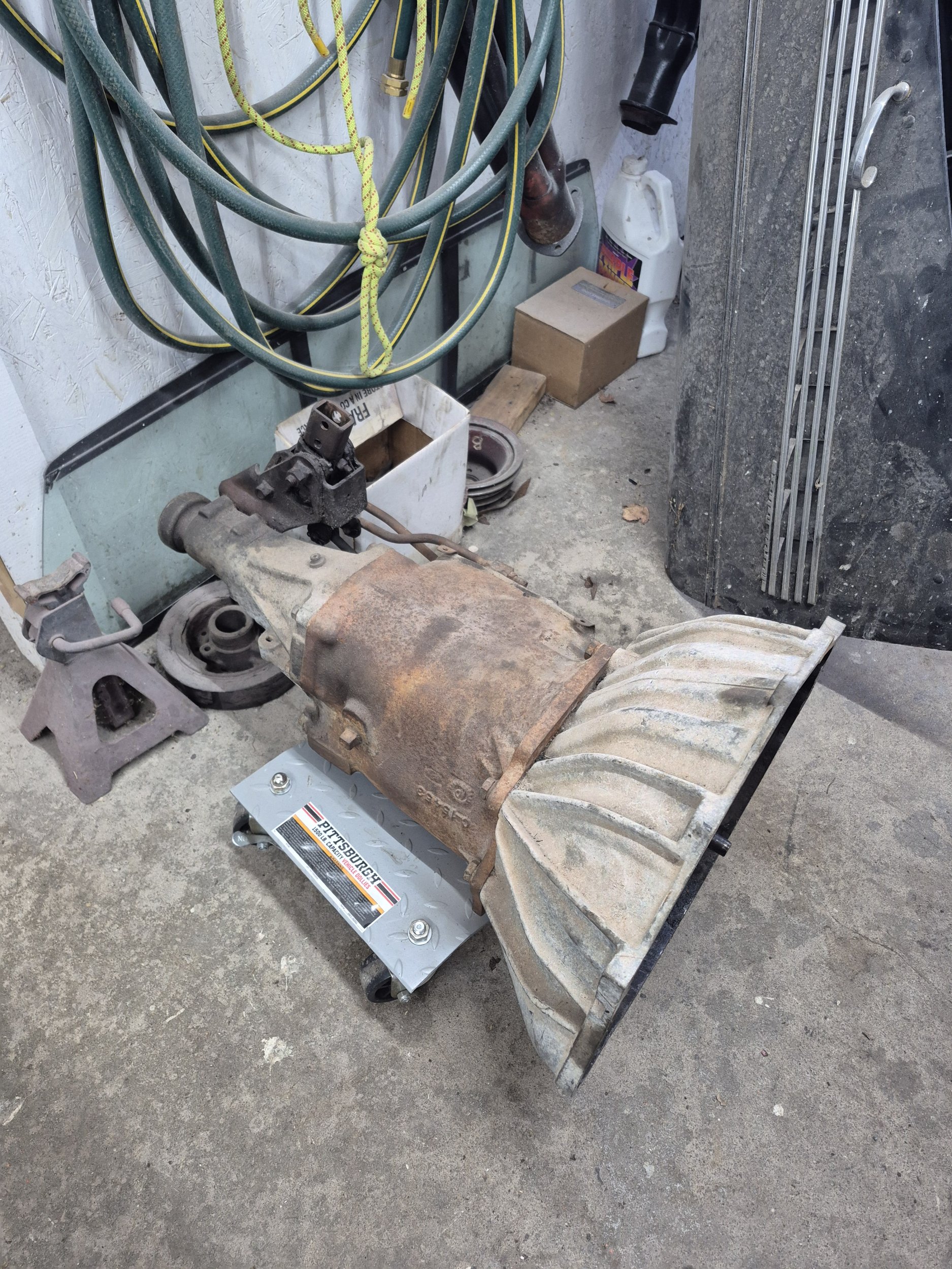

    Not a lot to report. I cleaned up the frame rails before I put the pans in, painted them with some rustoleum and a brush, still gotta do to l the toe boards. Switched the transmission, put the M20 in. Even though I've already put the crossmember in for the ladder bars, I'm having 2nd thoughts. Thinking about cutting it all back out, and going leaf spring. Part of what I like about looking at my car is those shackles. Just seems to fit the look better. 20241201_161333.jpg 20241201_161339.jpg

    And if anybody wants a nice NP833 4 speed, it's here. Make you a deal lol. 20241129_162609.jpg 20241202_144421.jpg
