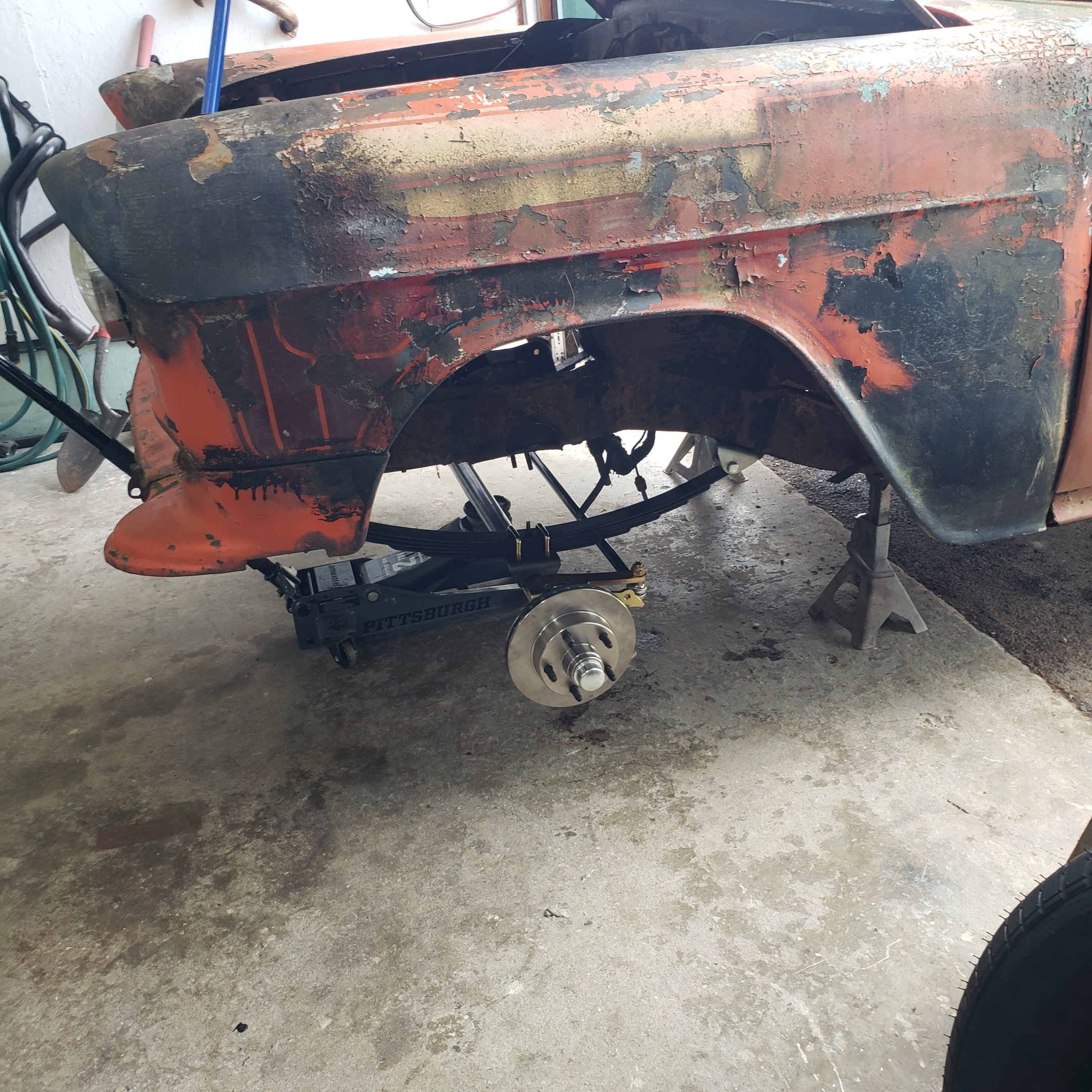

    Quick question. Started putting my front brakes together this evening, and ran into an issue. I put my steering arms to the rear, the car is rear steer. Now the steering arms are interfering with installing the caliper bolts. My question is, can I switch my caliper brackets and move the caliper to the front? I don't see why it would be an issue, but i figured somebody here might have been through this. 20240729_151751.jpg
  4. I don’t see why that wouldn’t work, I’ve seen quite a few front mounted calipers on straight axle trucks at work.
  5. 57 Fargo
    Joined: Jan 22, 2012
    Posts: 6,232
    57 Fargo
    If it all bolts together it will work fine.

    The calipers don’t care where they are, but the bleeders do. Oh wait, you only asked about the brackets.

    You just have to have the bleeder at the top side to blled the brakes, otherwise it will work just fine.

    Yeah switching calipers right to left, left to right keeps the bleeder orientation, I'm questioning braking effort and pedal feel. Some of the stuff I've read says changing orientation is a no no, but some of the rear kits I've used have staggered calipers. I'll give it a go

    I flipped one on a Strange Engineering rear disc kit. Called them and they said no problem. Sold me a right side bracket for the left side and it's been fine. Their calipers have a bleeder on each end just for this.

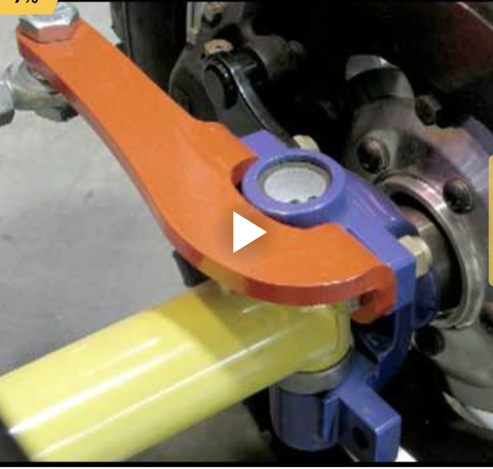

    You can put the caliper on the front, if you want. If it's this design from Speedway, do you have all the brackets in the correct spot (caliper bracket on outside of spindle, steering arm inside)?
  16. 05snopro440
    Joined: Mar 15, 2011
    Posts: 3,037
    05snopro440
    Darn. Hoped it would be something simple.

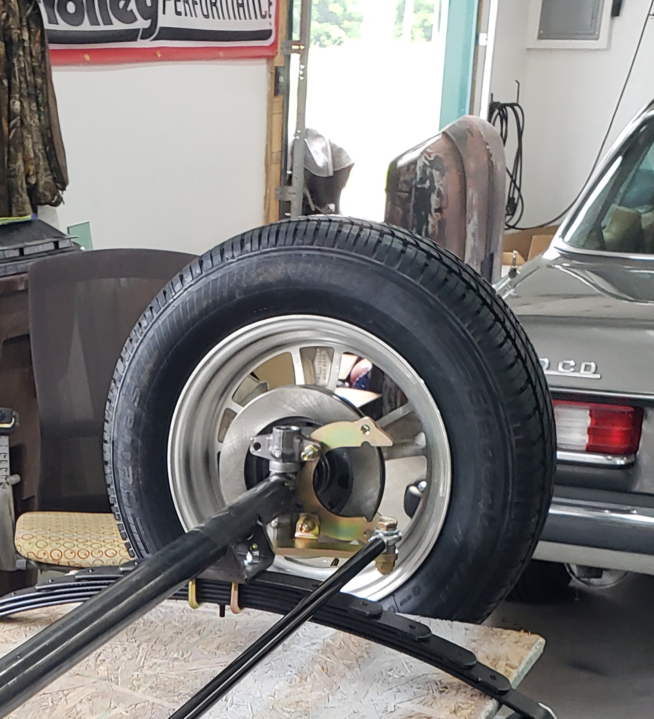

    I would be willing to bet that it was. a 60 chev has its steering sector close to the radiator while a 55 has its back by the firewall

    Yeah it was.

    Mine has the caliper to the rear and rear steer but it has the Wilwood brakes on it.

    Just too much **** in the same place for this to work together lol. And I'm not bashing speedway, because I'm a fan of them, but the caliper brackets were rough in the area where the caliper slides in. Never had that happen, and I've probably used 20-30 disc brake kits from them. I took a file and cleaned that area up, they're good now. Still gotta relocate the brake hose brackets. Always something. Crunch time though, gotta get it all done and shake it down before I drive it to Bowling Green on June 11th lol... I love pressure.

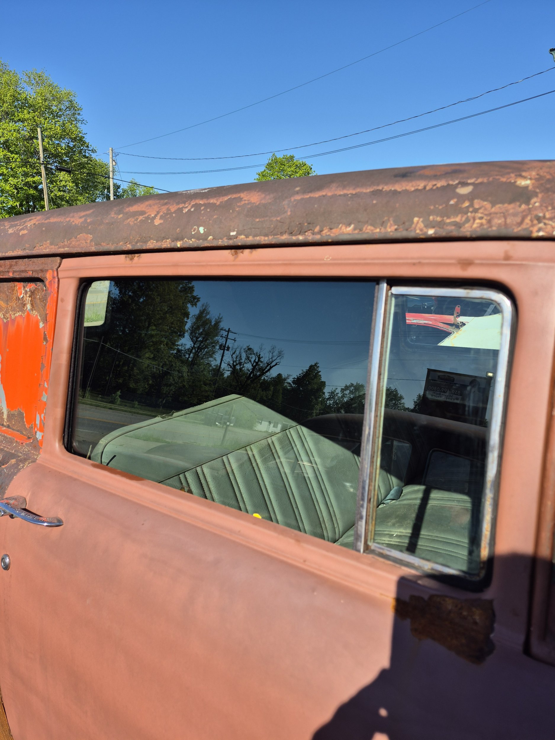

    Did you watch Christine? When Darnell said "he's completely *** backwards, brand new wipers on a busted windshield" :cool: well i stuck my door gl*** in today :D 20250509_172605.jpg 20250509_172552.jpg
