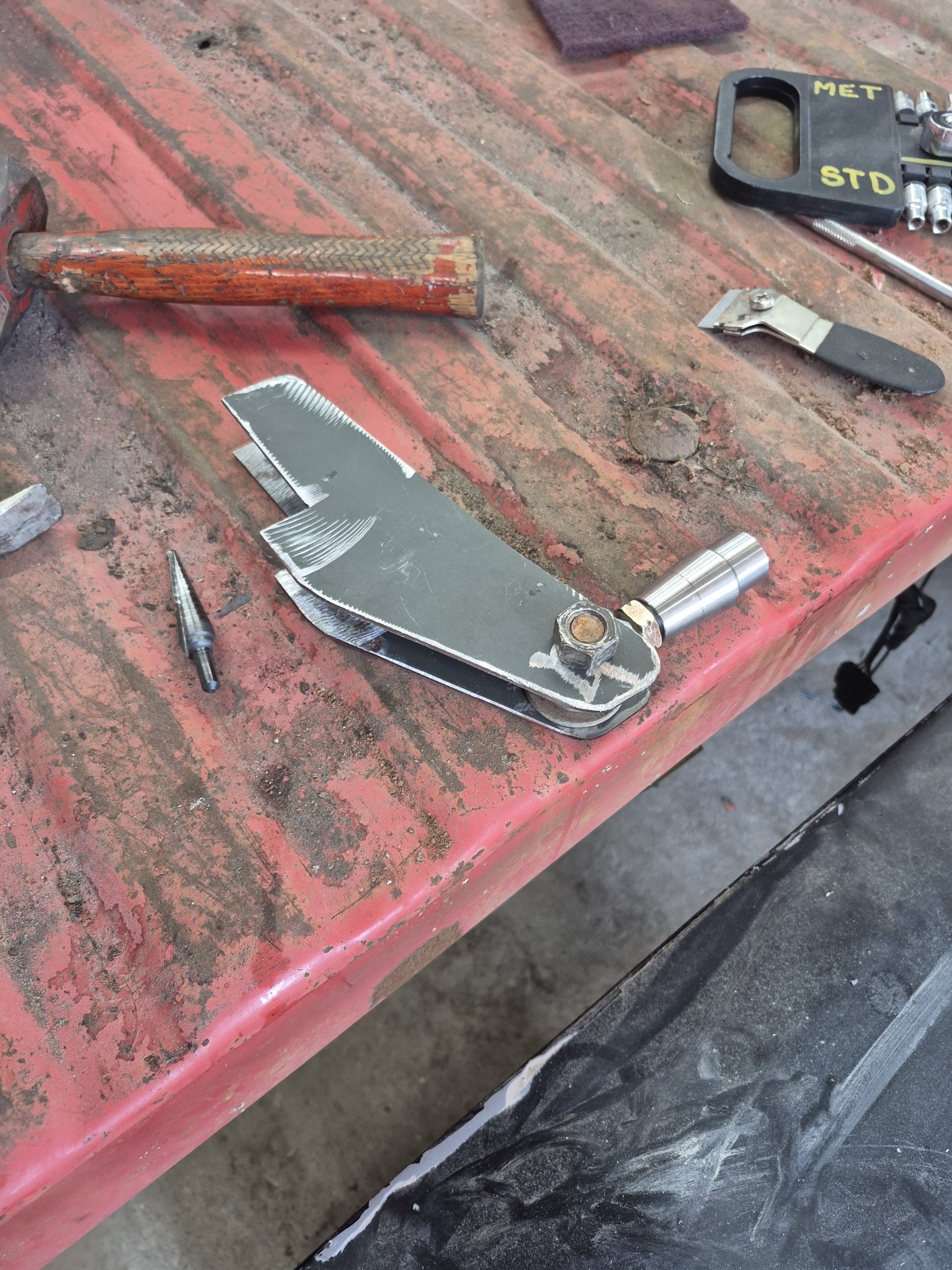

    I jacked it up and pulled the leaf springs out this evening. Put the ladder bars back in. Hopefully fixes the wheel hop. Another issue was rear steering lol, when you held the vertical pedal on the right to the floor for very long, it started getting squirrely, you could feel that it was in the rear of the car. So when I was pulling the leaf springs, I noticed that the top bushing on the rear, both sides, was pretty much completely gone lol... and with those super long shackles, I now understand where my rear steering was coming from. But anyway, ladder bars are back on, just gotta put a panhard bar on it. Started fabbing a frame bracket, but after a good long hot day of welding and sanding, I hung it up and came home to the air conditioner. Stay hydrated damnit! 20250621_172438.jpg

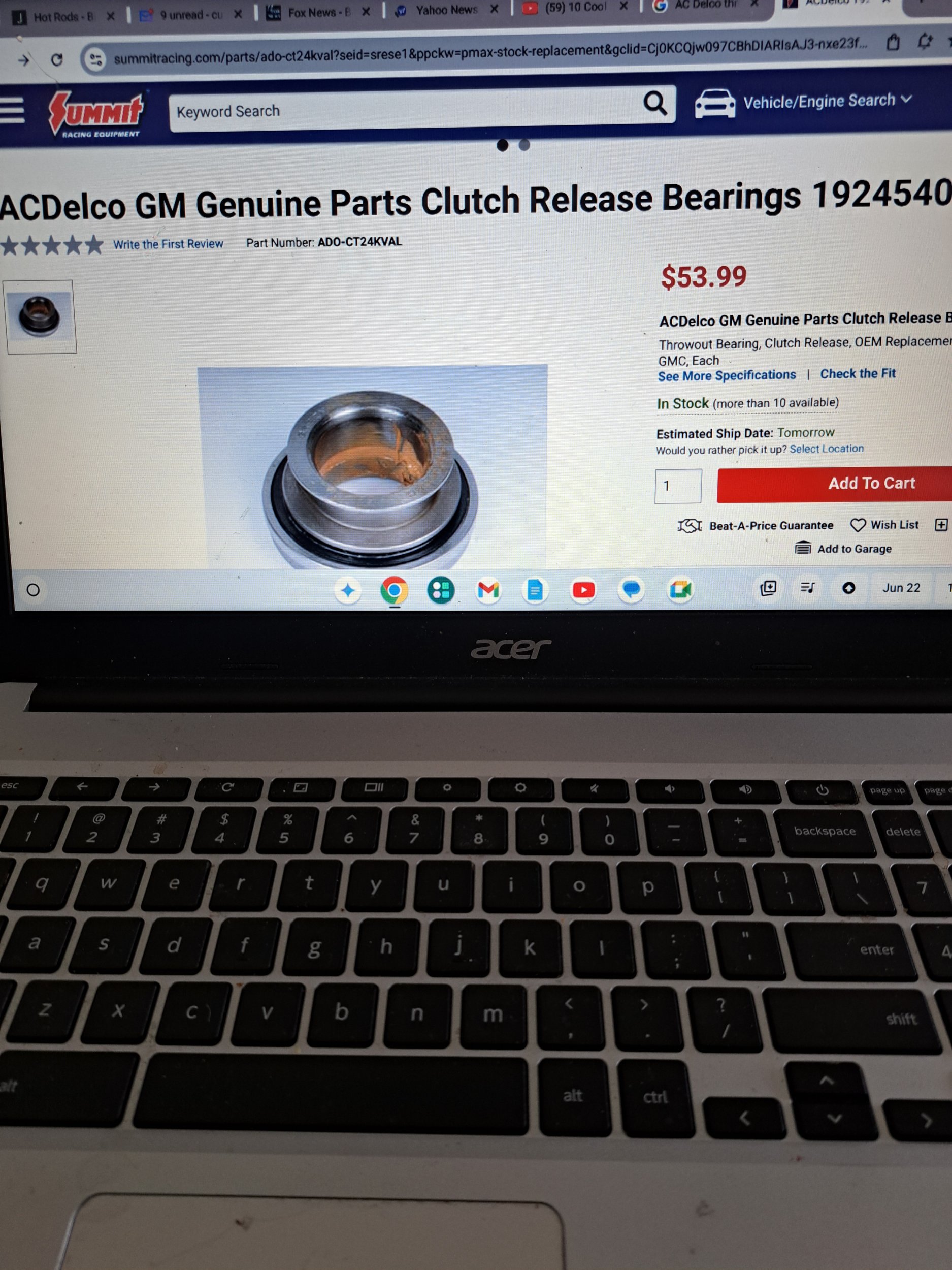

    AC Delco lists them. Summit has 'em in stock.

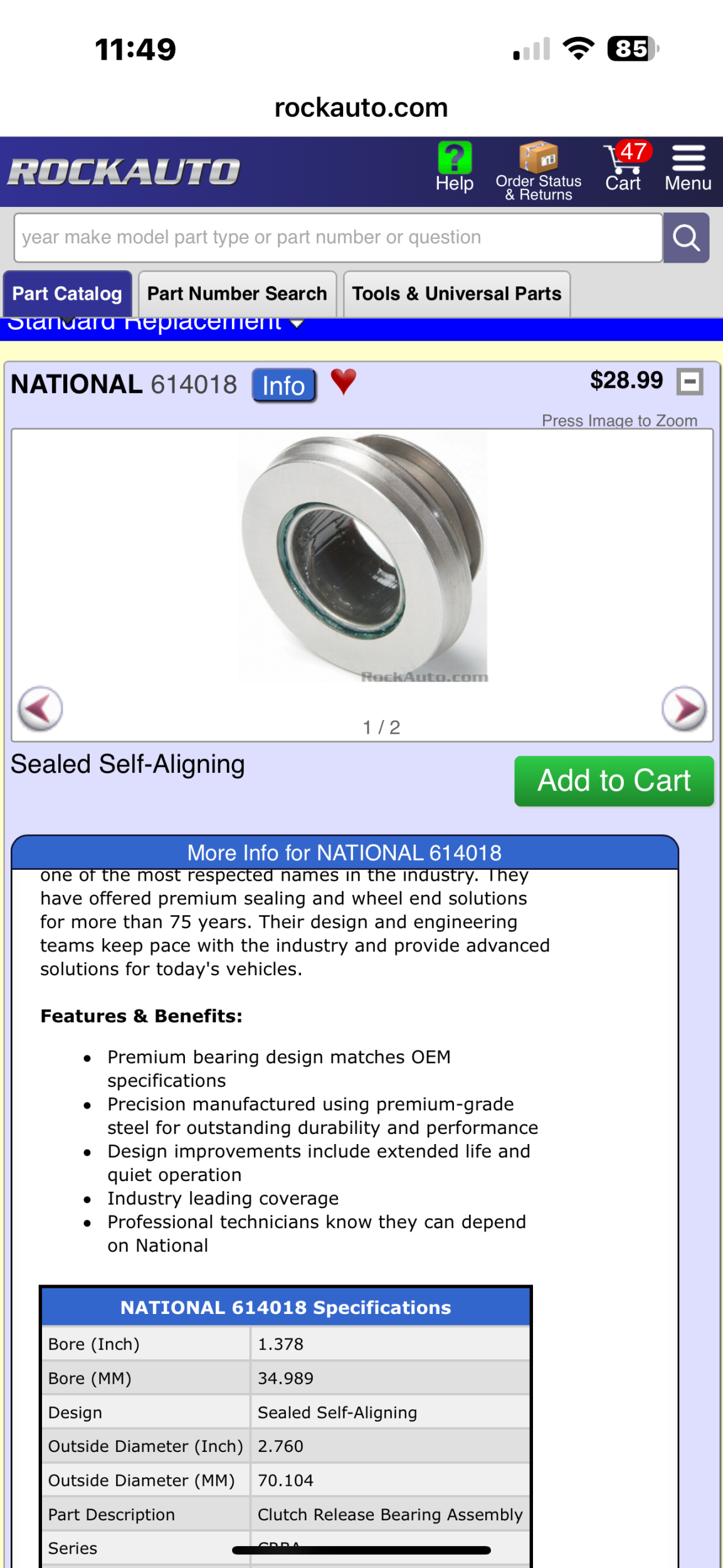

  17. I’ve always had excellent results with National Bearings IMG_9577.png .
