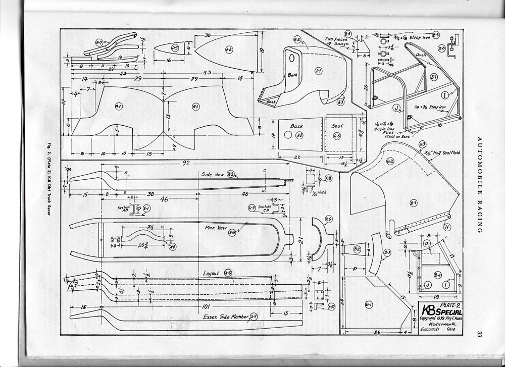

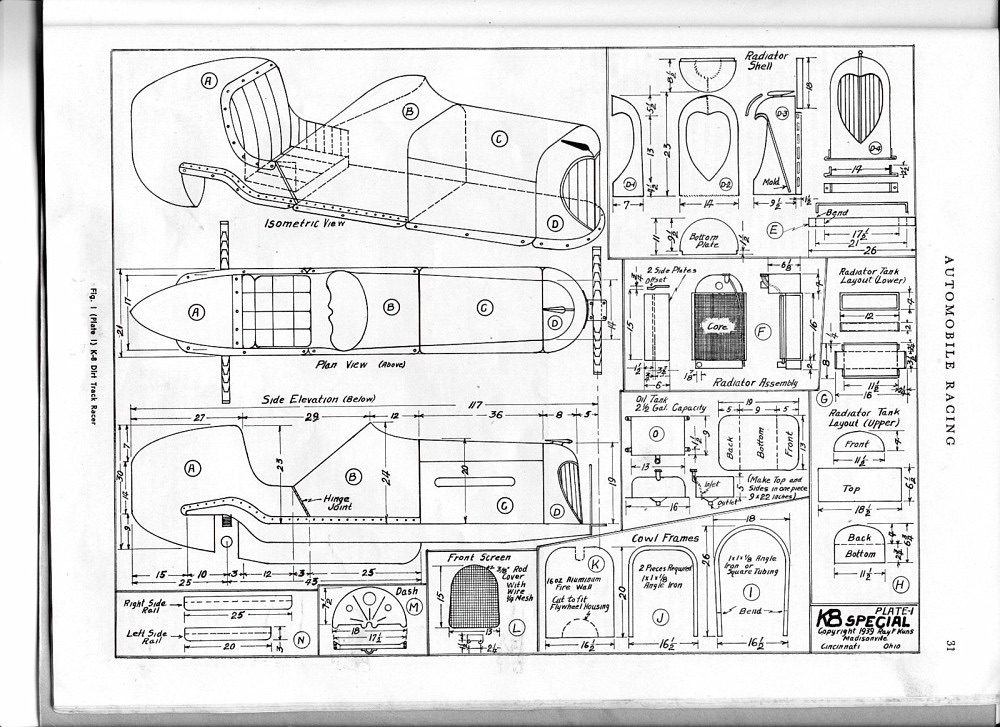

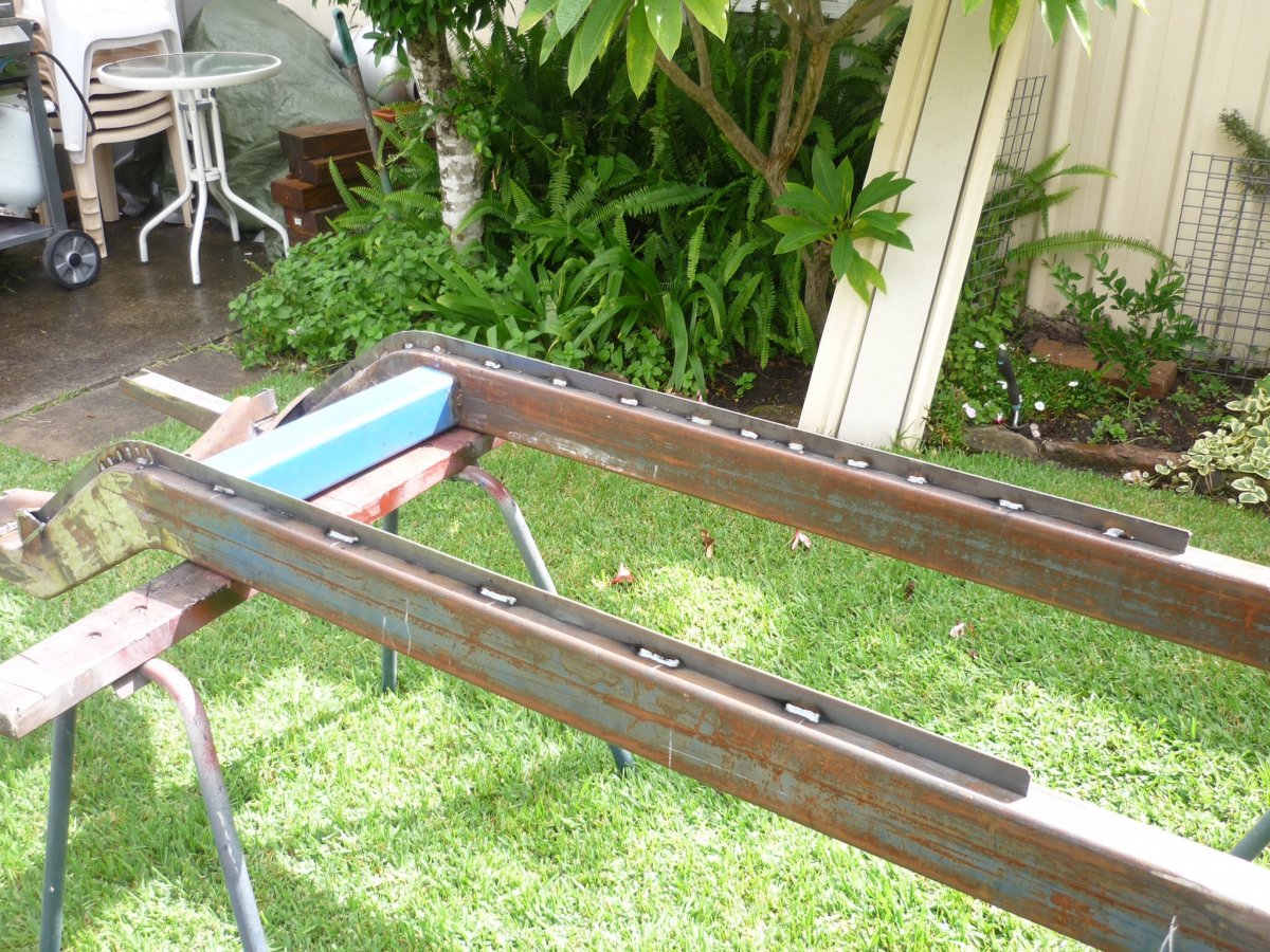

    I used these plans as a guide and sort of tweeked it a bit to suit my needs.
    Chassis made from 100mmx50mm(4x2)"3/16 thick.I cut the sides out or rear ,bent the top and bottom to the shape I wanted then plated it in. Tack the L&R rails together when welding to keep them straight. Strip on bottom is for belly pan.
    Model a rear cross member

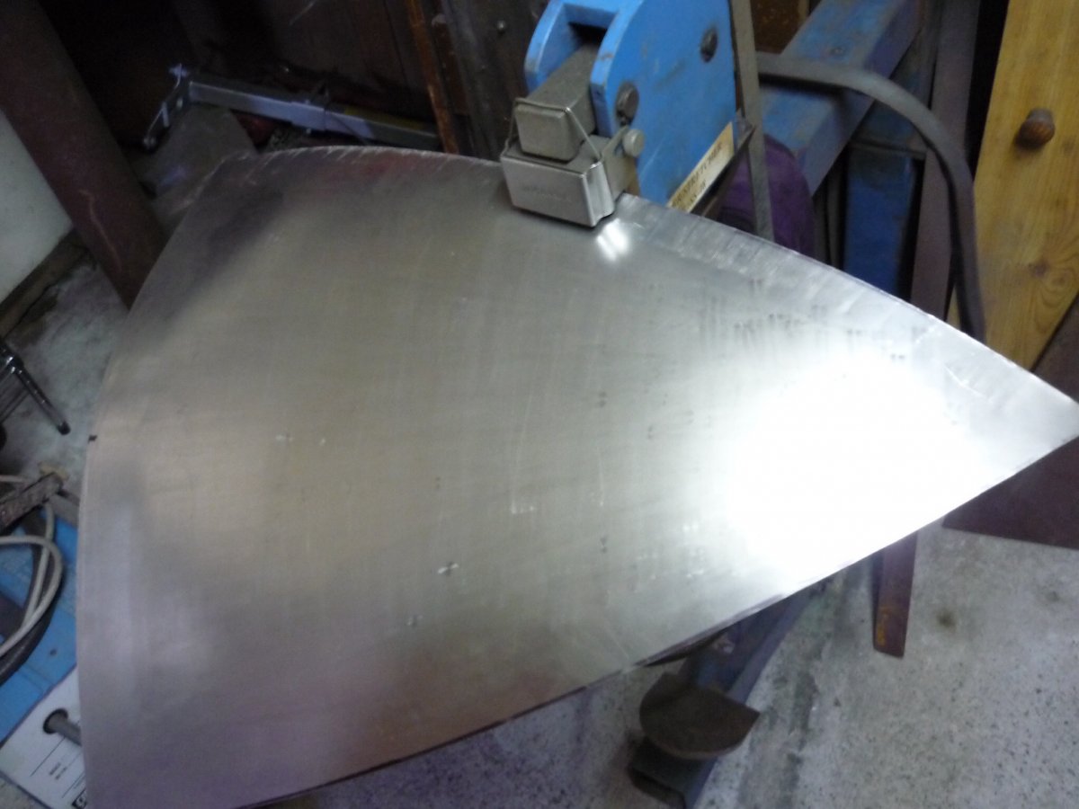

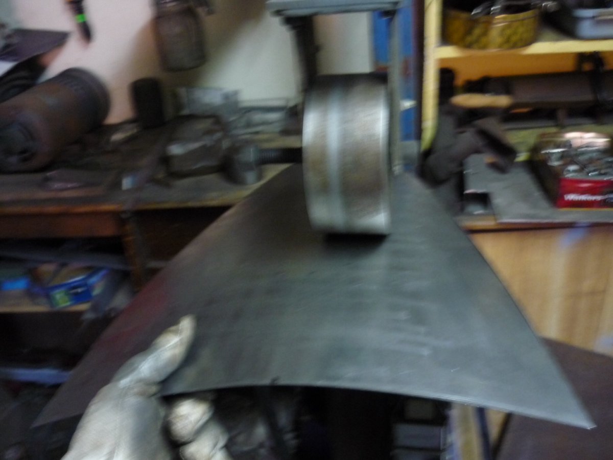

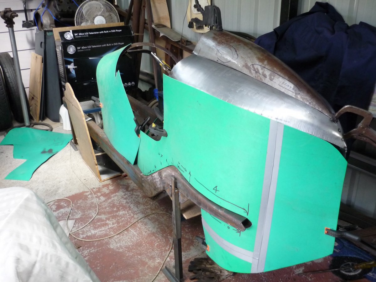

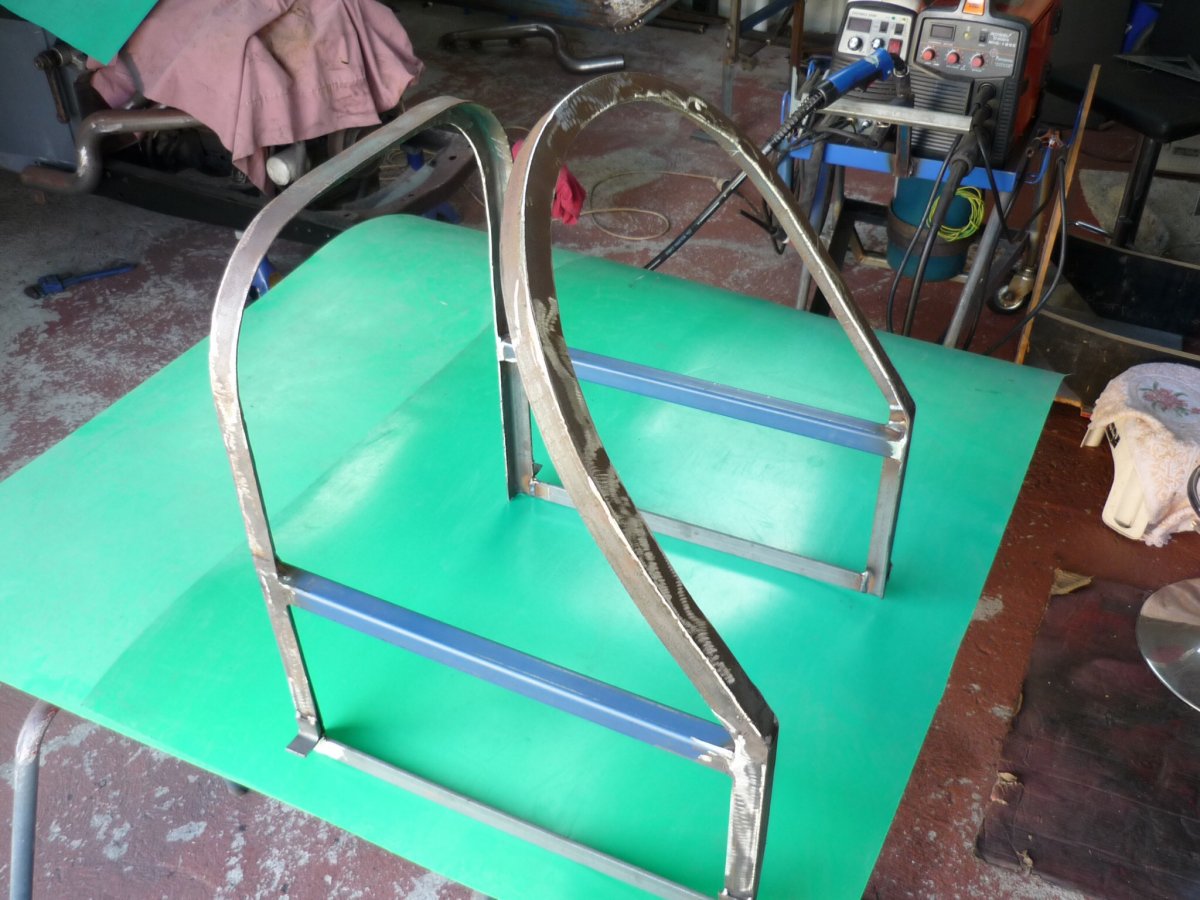

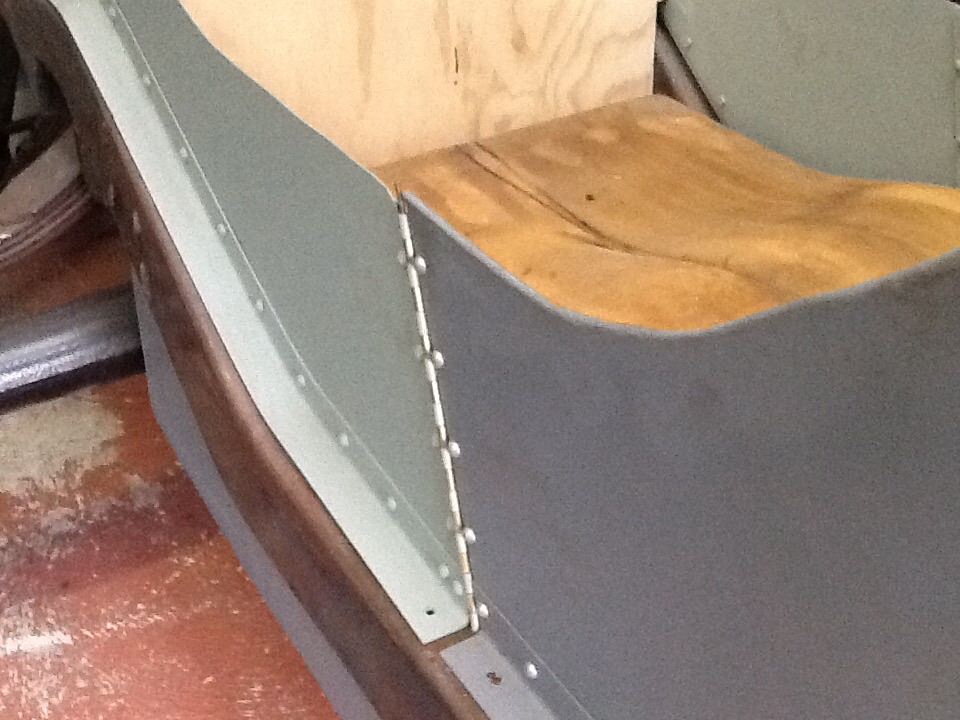

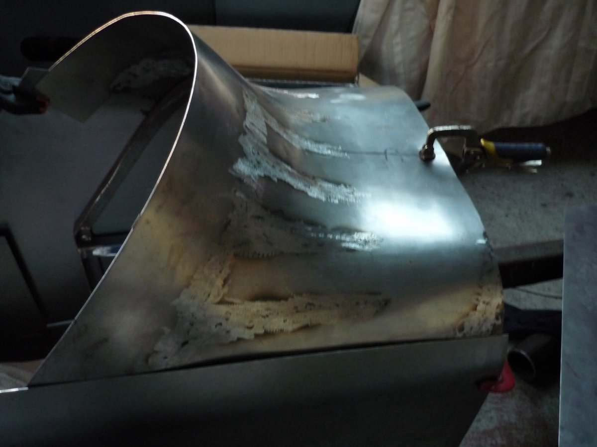

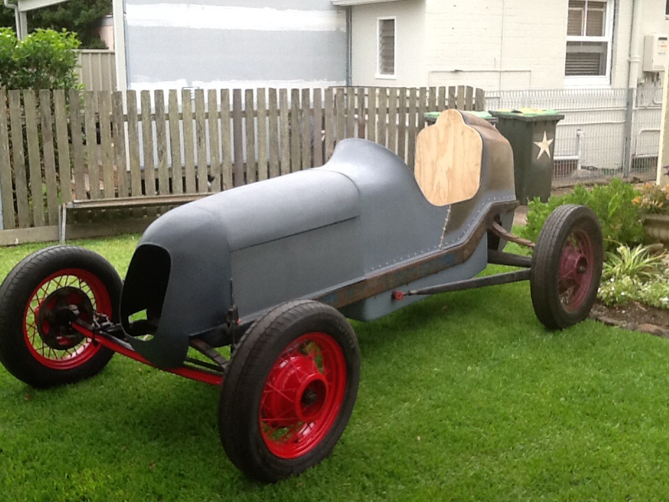

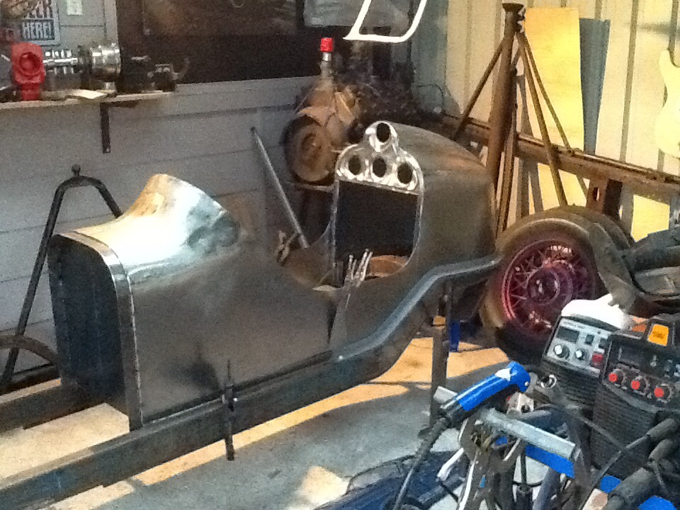

    image.jpg image.jpg image.jpg image.jpg Actually the body is finished ,here's some more pics of how I got there

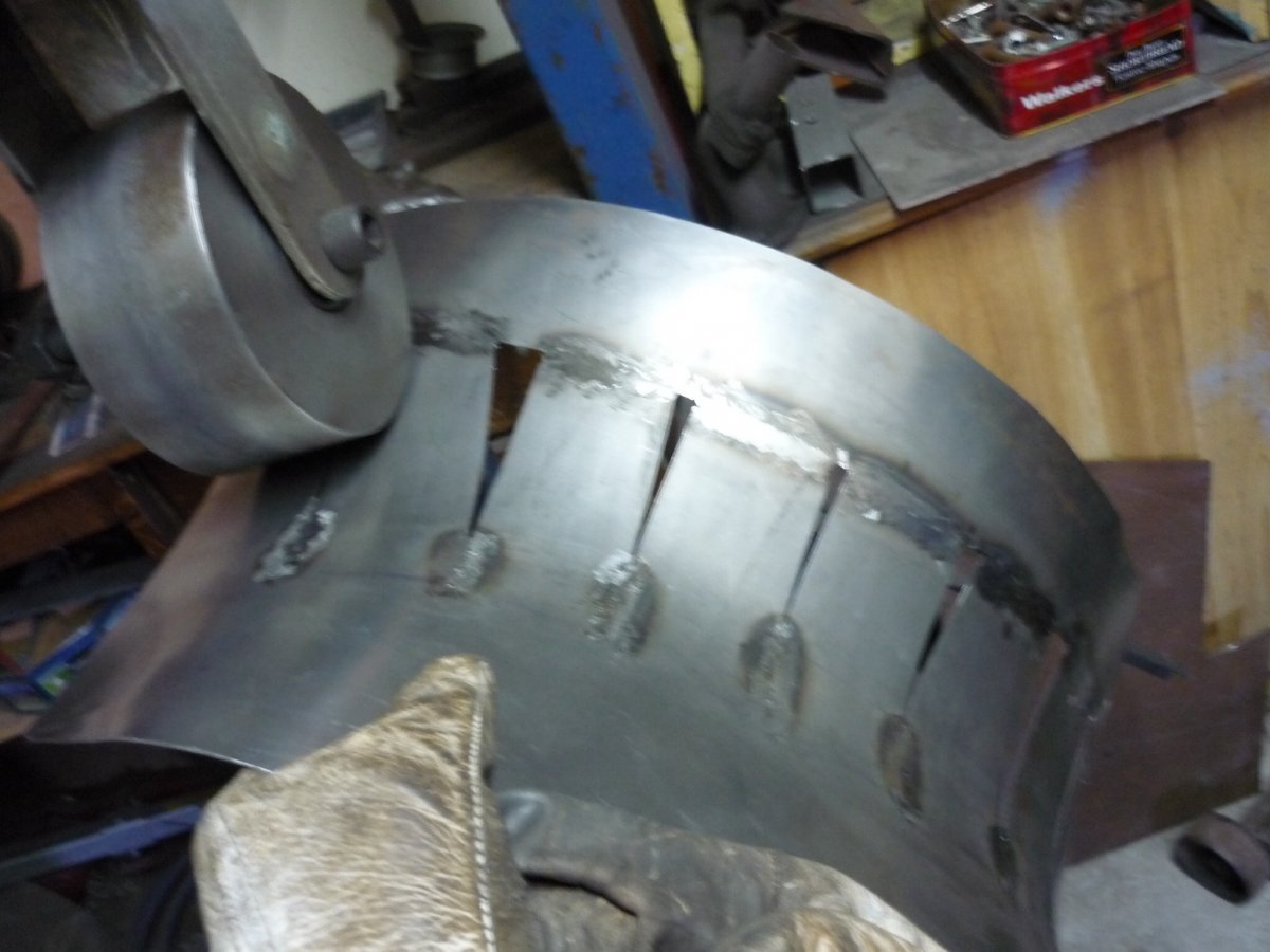

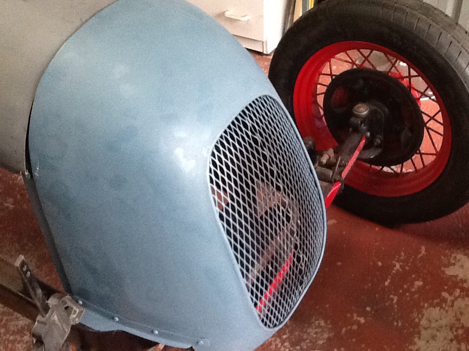

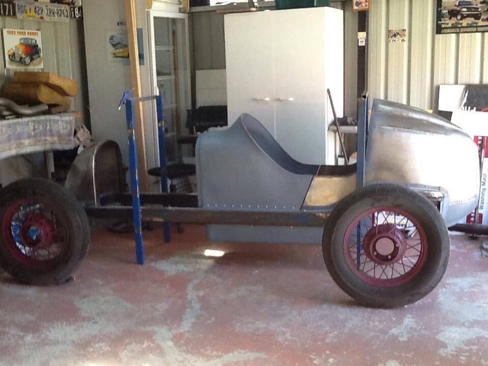

    I will show some of my home made tools next post. Hope you get some ideas..cheers Gaz.
