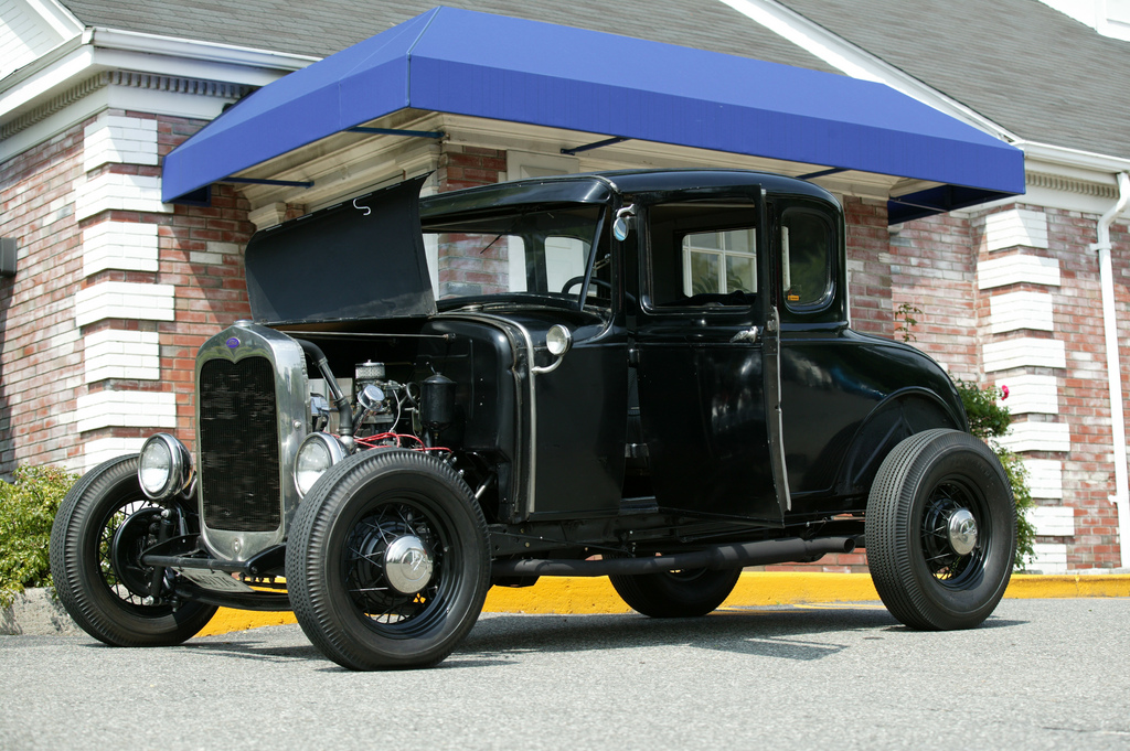

    We did 5.50 and 7.00 Firestones on ours.

    As per Walls question, are those the wheels you're using? If so, we had no problem mounting 5.50's on our rims which are '35 Ford wires and the last spoke wheels they made. Just like the ones you show in your picture.
    Also, no difference in tread pattern front to rear on our tires.

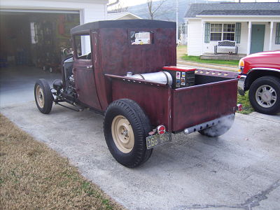

    I just put 5.00/5.25 x 16 on front and 7.50x16 on rears. Put them on 16x4 rims all around.

    Are those Tornel's on the rear?
  20. fatboys69
    Joined: Jun 19, 2007
    Posts: 278
    fatboys69
    from Tennessee
    they say Skyline on the sidewalls. I have never heard of them, but seems like everyone and there brother was making tires at one time.
  21. 5.25-5.5os on the front and 7.00s on the back with tubes on 35 ford wheels.
  22. That's a pretty robust tire for a model A. what pressures are you running?

  24. MATACONCEPTS
    Joined: Aug 7, 2009
    Posts: 2,069
    MATACONCEPTS
    20-25psi
