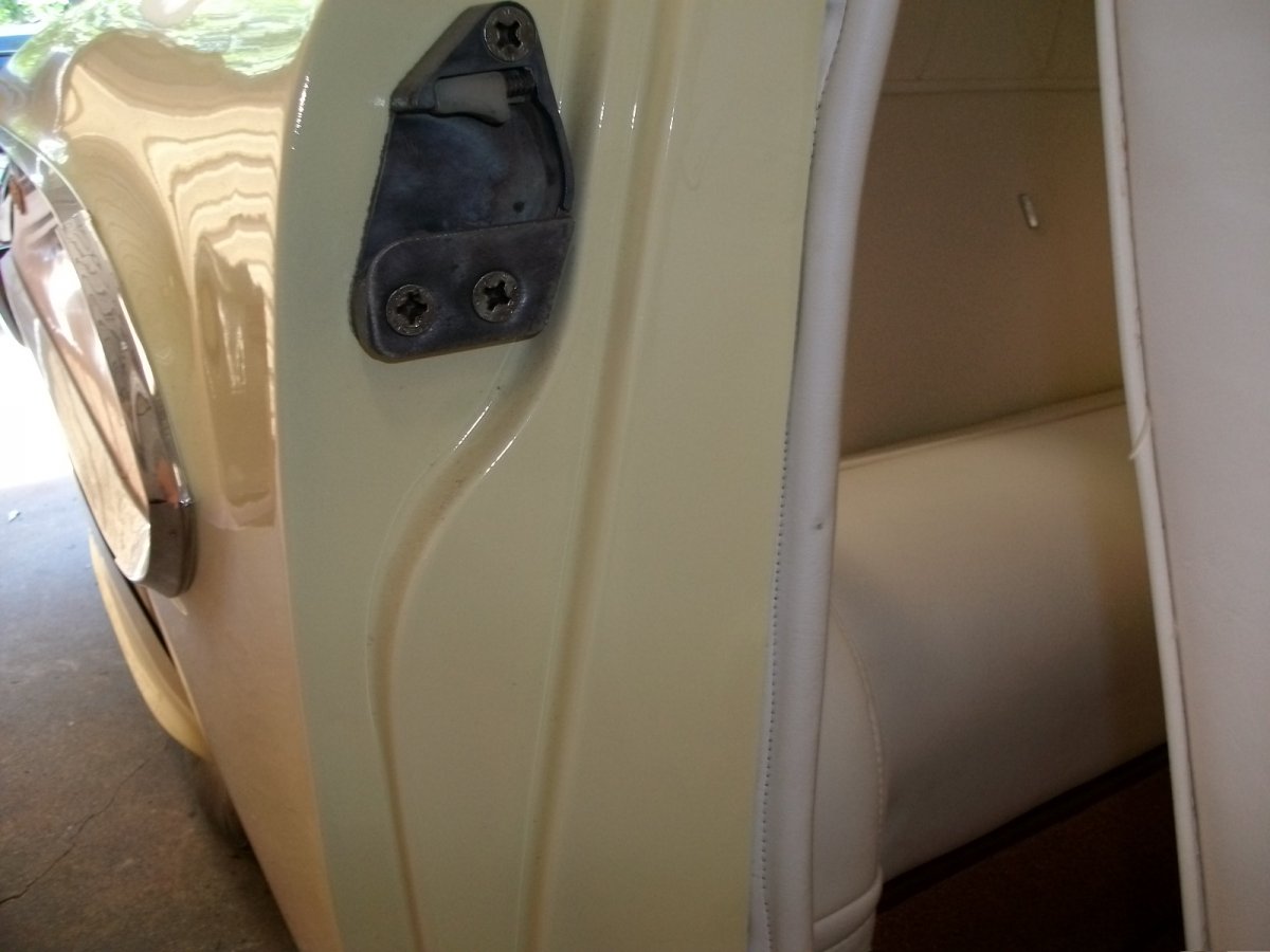

    My PPG rep for 35 yrs. advised me to use Omni single stage instead of the Platinum line as it had a better shine, he seen to many resort to clear coat and would have been cheaper to go BC/CC , went with Omni but used the Platinum hardener and reducer shines really nice people asked me how many coats of clear I reply None you should see the look on there face, the only clear is on the belt line for the air brushing , it has not been wet sanded and buffed except for the hood and fenders IMG_0910.JPG
