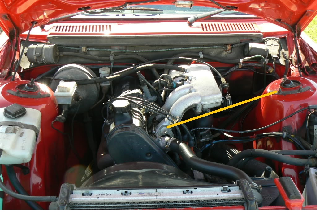

    Had a Volvo 240 with a lot of miles. the clutch was probably down to the rivets, but started chattered when starting off. The engine mounts on 240s are quite soft to hide the big 4 cylinder vibes. The engine can be rocked a lot sideways by hand. I installed a medium grade screen door closer between the engine lift loop and the strut tower. It pretty much killed the chatter.
