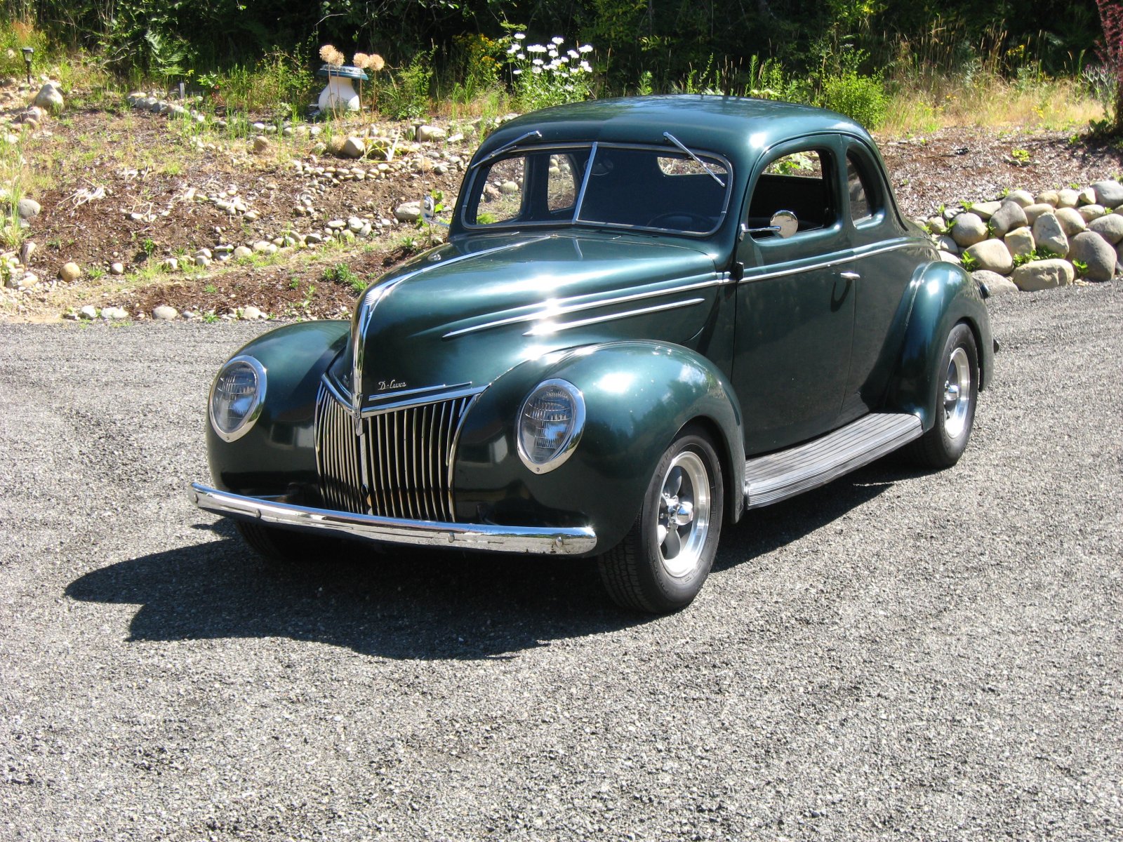

  1. I figured I'd take my coupe into town get gas, make a bit of an "appreciation of collector car day thing" out of it.
    Well, Damn if the old coupe decided the Hell with that, and died in route..seems to have lost compression, oil pressure..basically leaving me stranded along the road, temperature in the 100's (okay, it only seemed that way, more like low IMG_2318.JPG 80's), I was in a bit of a situation, so after thinking on it for a while, I decided to give @crazysteve a call for some help, he dropped what he was doing, came with his pickup and a tow strap, and proceeded to tow me in (another one of those car towing episodes never to be forgotten).

    It died going down the road after losing power, then a bit of rattling then, crank no start..and apparently no compression, as it turns over like there are no spark plugs in it.
    Not concerned, a couple of years ago, I had a 283 built for it, bored .030, balanced, ARP rod bolts, etc., it's on my engine stand, and will install, after I finish the '41 Ford p/u I'm currently building.

    I told him it was the Ford rejecting the Chevy transplant... LOL. And I'd be willing to bet it's a cam problem; one of the cam gears spinning, broken chain or cam. Probably has a bunch of bent valves which is where the compression went. Let us know what it is...

  19. Update..took a break from sanding on my '41 Ford p/u fenders (pretty easy to take a break).
    Removed valve covers, pulled off distributor cap, turned engine over, and balancer spins, but rocker arms, distributor rotor don't move,,I believe that is a problem..okay, that is the problem.
    So, as Steve suggested, either broken cam, or timing components.
    When I first bought this car, it had been sitting for at least 7 years..I got it running with its mis-matched heads, and Damn it actually ran decent.
    That inspired me to get a rebuilt set of camel hump 194 heads, new Edelbrock Performer series cam/lifters, new Cloyes double roller timing chain/gears, new pushrods, and new rocker arms.
    I knew in the back of my mind that the old SBC, would eventually let go, which is why I bought the rebuilt shortblock a couple of years ago, for the inevitable replacement.
    It ran strong right up until yesterday.
  20. The bummer is you've no doubt got at least a few bent valves, maybe more (that 'ticking' noise you heard). At least it didn't sound like any broke and dropped into the cylinder. Hopefully it's not a broken cam, it's a real PITA to fish the piece or pieces out of the block. My money is on the cam gear coming loose. The way you described the way it quit points in that direction. First the loss of power (cam timing changed), then the 'ticking' (more timing change, and valves kissing the pistons), then total loss of power (cam timing totally off or not turning at all, and either open or bent valves and loss of compression). If it didn't booger any piston tops badly it should be fixable.

    Sure enough the timing chain fell off with the removal of the cover, crank sprocket is nearly round..pretty sure it's supposed to have actual teeth on it, found one cam sprocket bolt, a part of another, and some metal pieces.
    Rather than repair, I'll more than likely put in my new short block..when?, not sure, I seem to have buried myself in projects lately.

  28. "On the road again"..if you want to realize a new appreciation for your HotRod take it out of the line up for a year and a half.
    So, I put in the new camshaft/lifters, timing components into the fresh shortblock (less cam and timing components).
    I had the heads rebuilt (5 bent valves),flywheel surfaced, I installed a new ring gear, I also rebuilt the three Stromberg 97's, put in fresh gear oil into the Muncie 4 spd.
    I'm going to re-visit the original builders Z bar fabrication, worked but lots of room for improvement.
    Runs good, sounds good, happy to have it back on the road.
