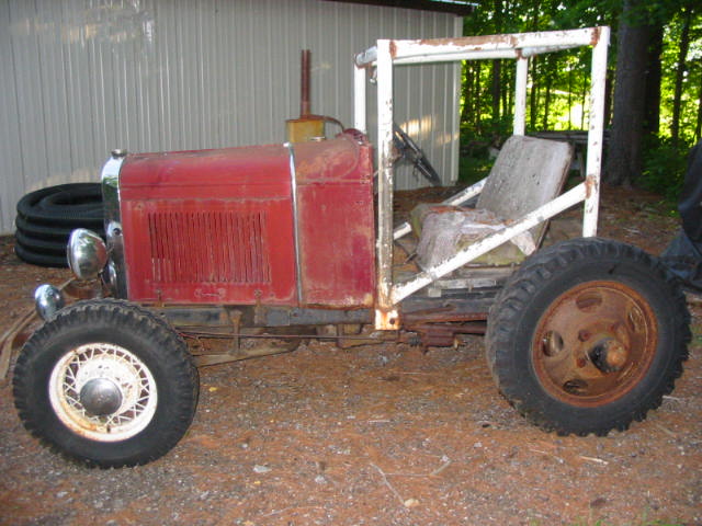

    Well,got it home today and it rolled right off the rollback,all the wheels loosened up and now she rolls.will pull plugs tomorrow and see what she looks like or at least get some pb blaster squirted around them to loosen them up
  9. 4b316
    Joined: Oct 8, 2011
    Posts: 52
    4b316
    from ny
    Pulled the plugs today, came right out. Good looking inside, a little black soot on the plugs, doesn't look like any water got in it. Pulled the dipstick, nothing but oil, no moisture

    You will have spent less $$ and have more fun with your new toy than all the rest of your rides. I scored this one for half a grand put another $500. into it, and use it all the time around the place as a poor mans Gator. Also take it to truck and tractor shows and use it as a golf cart to get around. Has a AA 4 speed with a A 3 speed behind it. No one can touch it in slow races when it is in double reverse.
