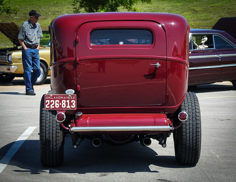

  4. Tall (31 1/2) and skinny 8"tread on an 16 x 7 I use a 235/85/16 2019 32 delivery back end.jpg 2019 32 delivery best pic.jpg
