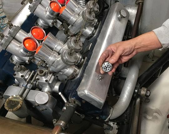

    This came up, as it does, in the course of looking for something else:
    Eight motorcycle-style Dell'Ortos (presumably SS1-42s) on a Cadillac V8 (presumably a 331).
    http://www.lastopenroad.com/burtsblog56.html
    "Also took a bike ride out to Jay Leno's garage once again for a looksee at what's new or progressing inside and to congratulate Jay on his new, car-guy (and gal) TV show. He was busy with a tour-bus-full of people from Apple (they all looked like they were barely out of high school!) but I saw a lot of neat stuff and was once again captivated by a strange and wonderful "racecar that never was" on Jay's floor. I'll hopefully be doing a pictorial story on it for Vintage Motorsport, so I don't want to give too much away, but suffice to say it was created out of thin air right there in the LA area back in 1952-'53, and it is one of the most amazing, ingenious and advanced vehicles of that era I have ever seen. No, really. Like how about a spaceframe ch***is, a cleverly-located, fully articulated DeDion rear suspension, 4 wheel disc brakes (aircraft, I think, and inboard at the rear!), a Cad/Lasalle-based rear transaxle (!!!) and a big ole Cadillac V8 sporting no less than EIGHT Dellorto motorcycle carbs working off a common float bowl! Plus impeccably machined, knurled-nut valve-cover hold-downs that double as crankcase breathers. Wow!
    "There's more, too. Pretty damn incredible for a 1953 'homebuilt', even if it never turned a wheel in anger. Watch for the story."​
    Interestingly, I haven't been able to find anything else on the car or the engine anywhere on the internet.
    The motorcycle-carbs-on-a-car-engine thing has a certain following right now, generally on at best OT-ish builds. The idea is that carbs for a 1200cc bike engine spinning at 12500rpm would be just about right for a 2000cc car engine at 7500rpm. Moreover, a rack of modern Keihin CVs can be had for a lot less money than a pair of Weber DCOEs, and there are downdraft versions if your engine configuration wants it. I'm not sure when such high-winding motorbike engines first became commonly available, or how far back that approach would therefore have been viable. Into our era, or just after?
    The common float bowl idea — I wonder if and how well that worked — reminds me of a past rabbit hole: https://www.jalopyjournal.com/forum/threads/bendix-stromberg-aircraft-carb-ruminations.1281920/. Subsequent reflection would suggest that SUs might not be the best for that: their whole point is that they maintain constant vacuum. So motorbike CV carbs wouldn't work either. But good old round- or flat-slide motorbike carbs might be perfect.
    It gets towards fuel injection controlled by pneumatic rather than electronic means. Air logic sounds like a running shoe, but that'd be pretty much what it is.

    It was a pretty common mod over here to fit Amals to car engines going back to the 30s.

    I’d like to know more about the mystery car too! I can’t see any dates on that blog post @Ned Ludd referenced, is it a week old, a year old or ten years ago?

    That look's so good. Thanks.

    Later entries show materials from 2013, so before then. How long before, I don't know.
