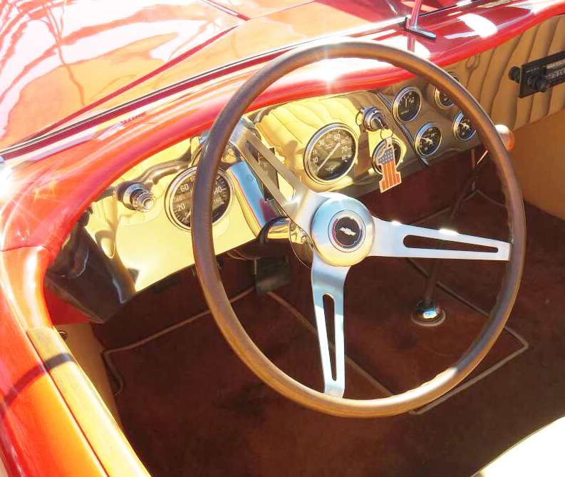

    First SETBACK on the 34 got the wrong steering wheel!
    Thought it was an 40 ford steering column or after market one.
    Anybody recognize the threads or housing has a persons name on the inside in engraved ?
    Sent from my iPad
  30. Squablow
    Joined: Apr 26, 2005
    Posts: 18,448
    Squablow
    Sure looks like it says Rodgers Trucking, which when Google'd comes up as a company in San Leandro, CA. Very near the original builder's home town, maybe he worked there? It's very common for chrome shops to etch the name of a customer into the pieces so they don't get lost or shuffled around during work, my guess is the column got chrome plated and that was the name of the company they put on the pieces.
    Does it still have the Olds steering box in it? Does the box have a rag joint or universal joint added to it to attach the column? I'd wonder if the column shaft isn't the Oldsmobile one and just a new chromed mast jacket was added to it to make it look pretty. Would make sense if that Camaro steering wheel bolted right on with the original splined adapter, that it would be GM.
    If that is indeed the case, I'm going to try to suggest that you could find a 55-56 Chevy 210 steering wheel, which should fit (if that is GM spline) and would be a match to the one in the earlier photos. A 50ish Olds wheel would also be appropriate.
