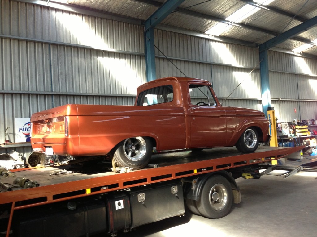

  19. The trailer Queen getting unloaded at the transmission rebuilders. Hopefully wont be too long before I get it back.

    I would hardly call it a trailer queen when it is broken. You have to drive them to break them.
  21. One more time on the the tilt tray and it will have more miles being towed than driven..............:mad:

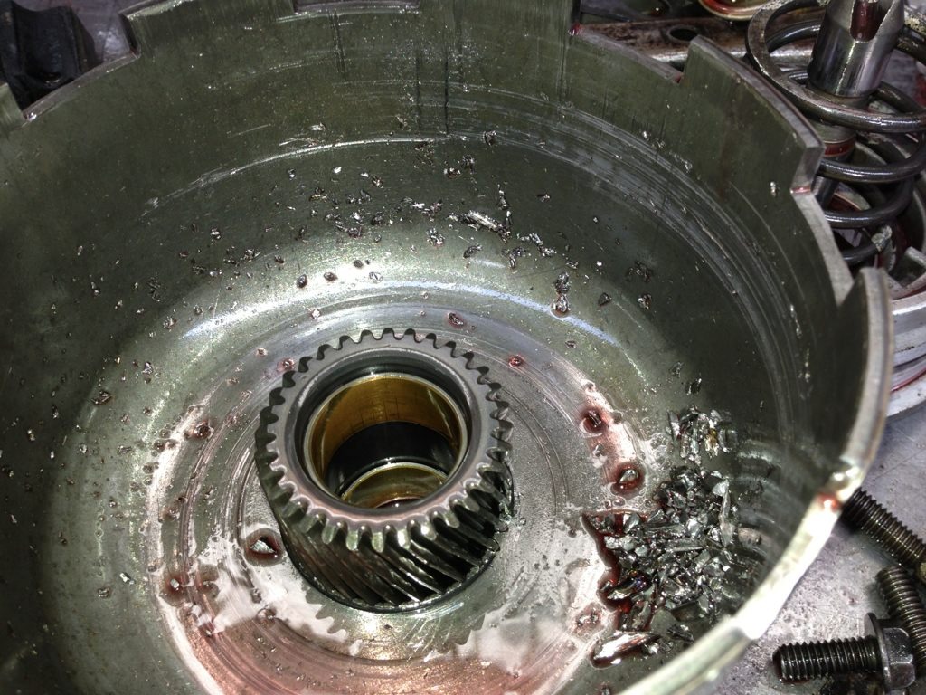

    Got a call from the auto rebuilder and the auto is toast, so it looks like I'll have to throw a heap more money at it................:eek:
    Something spun in the box and blocked the oil lines to the cooler and cooked the box.
    He said it's only the second time he had seen this happen...........:(

    Well Mark it was looking good but haven't you been told that the back of a tilt-tray is not an ideal location for a photo-shoot. Does give folks the wrong impression.

  25. Just been to the auto rebuilder and this is what he found in the box
    Swifty he should have the box back together Friday.

    I'm with Swifty on that. Does not create a good image.
    Not a good find.

    swifty
    Is that due to Jen's driving LOL
    Seriously with lack of cooling I thought you would have burned out clutches not chewed up gears.
  28. Not Jens driving though she does give it a hard time.......;)
    I have had a weird metallic sound coming from the box when I put it in reverse a couple of times and it was the same sound it made when it started playing up.
    The inside of the hub was scored so that was the noise I heard.
    It also had one band that was toast.
    The rear bush spun in the housing blocking the return line from the cooler and I think that the car only did about 20Kl at a time so the gearbox probably didn't really cook, just the hub wasn't being being fed enough oil.
  29. You'd swear they'd fitted parts from a 39 box looking at that mess!
    Something was definetely not right from the start.

    I reckon you are right, something was not right from the start but there is no way I can prove it so I'll just have to **** it up and fork out the cash.......:(
