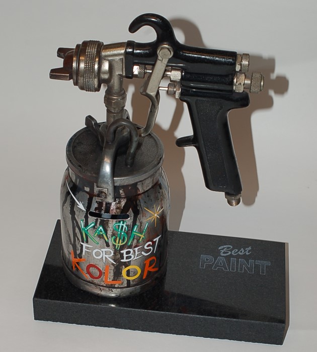

    I'd agree that the posts here about gun cleaning might be the best approach to curing your problem. I had a cheap imported siphon-feed gun ("Binks 7 copy"??) that I bought 35-plus years ago. I kept it in working order using most of those same methods. Sprayed lacquer and epoxy primers as well as acrylic lacquer and catalyzed single stage urethane color with good results on several car projects and never once changed the tip size. (But then I'm probably a hack!) But, I was due for an upgrade after all that time so I bought the Harbor Freight HVLP pair. Used the smaller touch up gun to spray the primer and satin black in the engine bay of my car and it worked great with very little overspray.
    So my advice is: Upgrade guns. You've had your use out of that Binks. You're due.
    Then you could do what I did. Make a "Best Paint" award/coin bank and present it at a local show. ;)
