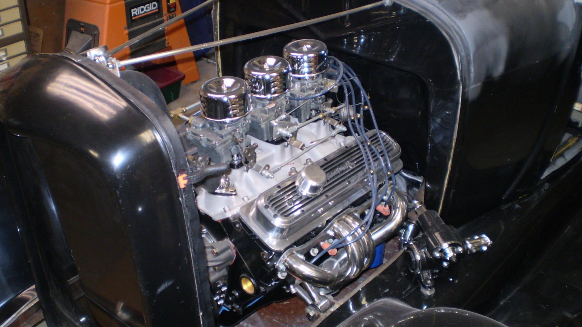

    I'm wanting to chrome my lakes headers and beings the car is going to be black I thought about having the headers black chromed, My question is does black chrome show bluing as much as regular chrome?
