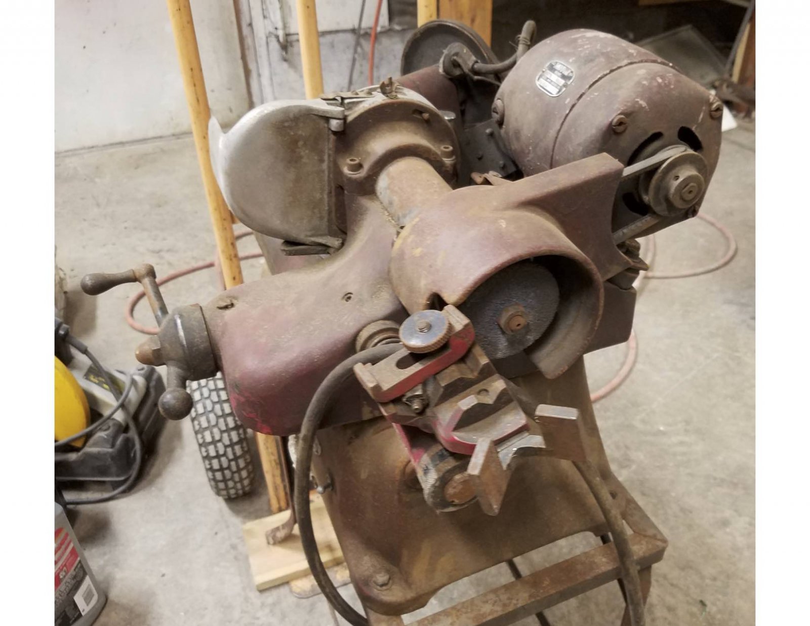

    valve grinder 1.jpg valve grinder 2.jpg valve grinder 3.jpg I just bought this old valve grinder, and need some help on how to use it. Anyone have a manual or can explain to me how to use it? What is the grinding wheel on. the right side for?

    Can’t help with a manual but the wheel on the right should have a v-block next to it. You clamp a valve in the block and there is an adjustment knob graduated in thousandths so you can reface valve stem tips.

  3. Fordors
    Joined: Sep 22, 2016
    Posts: 6,435
    Fordors
    Graduated adjustment knob.

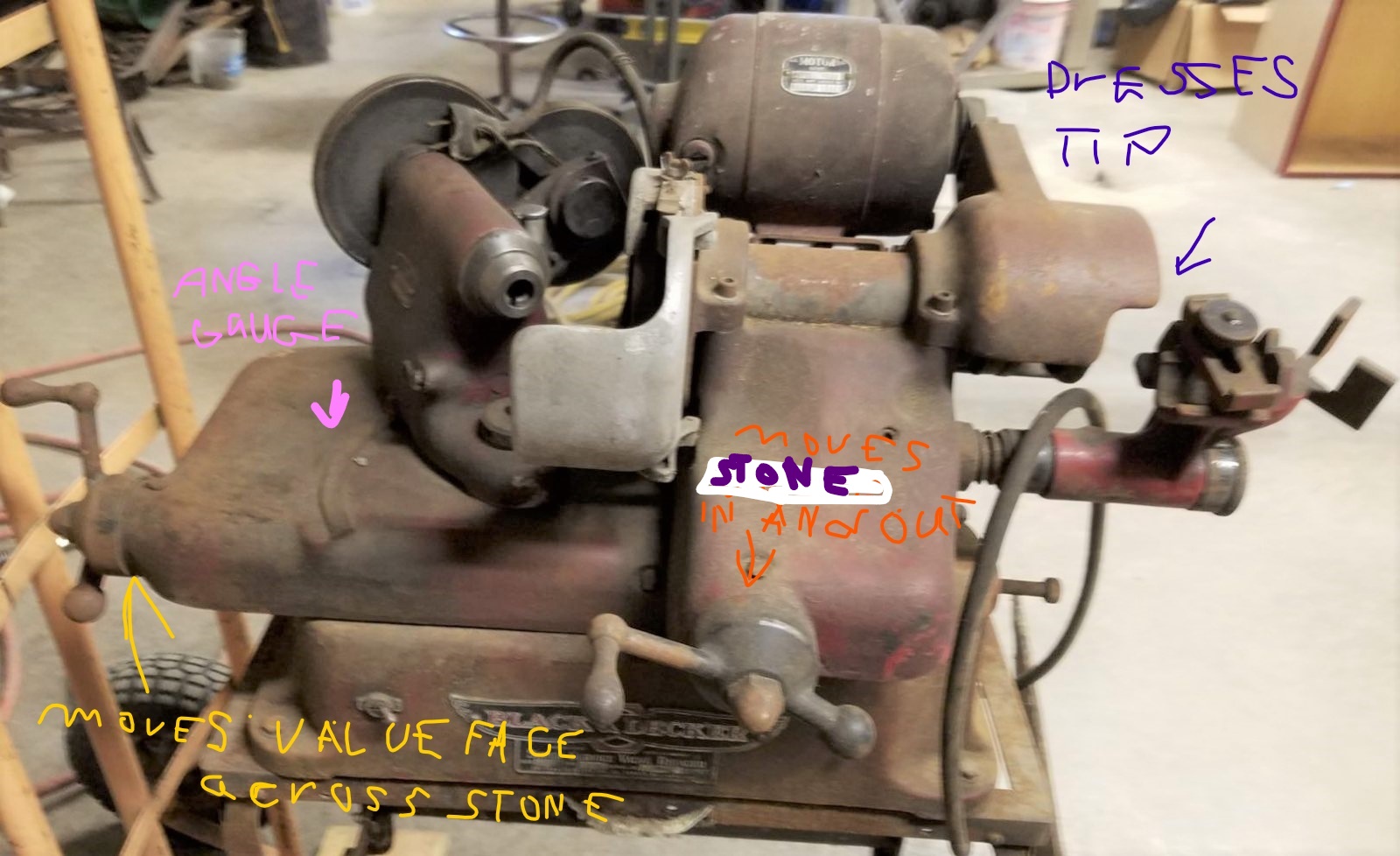

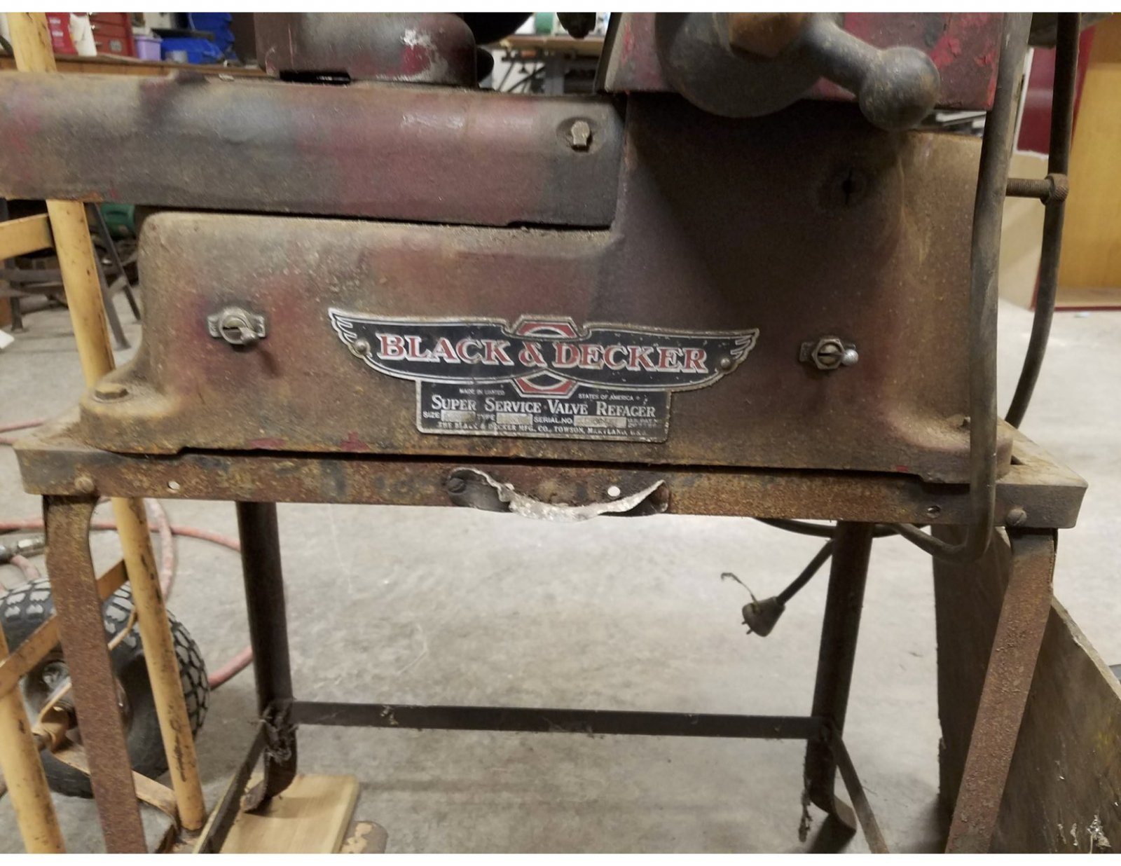

    valve grinder 2 (3)_LI.jpg Black and Decker hasn't made valve grinding equipment for over 40 years to my knowledge.
    There are a few videos here black and decker valve grinder history - Bing video that are worth looking at as they are of similar models.
    From what I can see you are missing the diamond nibs for dressing the stones and their holders. The stones have to be dressed with the proper setup or they don't grind the valve right. You also have to be beyond gentle while dressing the stones as it is super easy to knock the diamond out of the screw piece it is held in and have to spend another 50 bucks to buy another one.
    This is a Sioux valve grinder that he is using but his instructions are excellent and can be used on the Black and decker. Intake & Exhaust Valve Grinding and Machining - Bing video
    Gentle is the key, My former students will tell you that I could be 100 ft away in my office and tell if they were grinding valves correctly by the sound.
    Start and practice with a bunch of old throw away valves. It actually doesn't take that many before you usually get the hang of it and your left hand learns what the right hand wants it to do when.
    The first thing I would do is clean it up really good and figure out what else I needed to go with it so it will be useful. Then you have to find the seat grinder to do the other half of the valve job on the seats.

    The right wheel may have an attachment also for facing the rocker arm tips. You insert the rocker horizontally and swing the face against the wheel. I have a diamond mounted on threaded holder for this I will sell if interested. I sold a lot of B&D valve shops in the 60's

    He is probably going to need that diamond nib and it's holder if it is the right one for his machine.
    The Sioux that we had in the high school auto shop that I was a student in from 1962 though 1965 and then taught auto mechanics in from 1978 through 1991 had all the bells and whistles that came with one in the late 50's. It did have the fixture for the rocker arm tips.
    It also had a setup that you could put the slight bevel on the edge of the valve stem tip when you dressed the tip. It looks like the one that BJR bought can be adjusted for that. That is pretty much a hand operation like dressing the stems that the guy showed in the video I posted. A practiced operation but a rather simple one when you figure out what you are doing.
