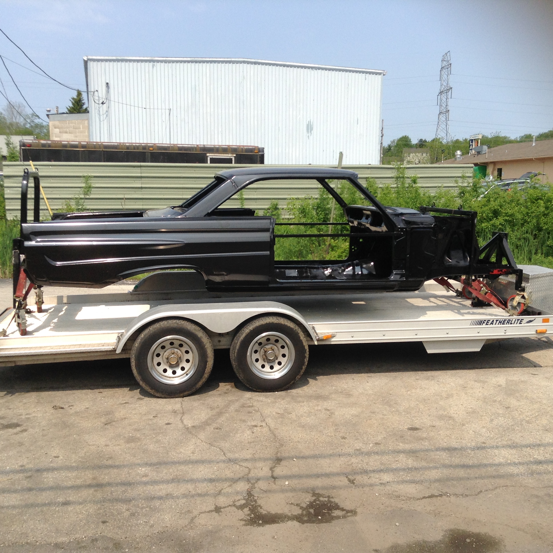

    here is my Comet body fresh out of the e coating tanks:

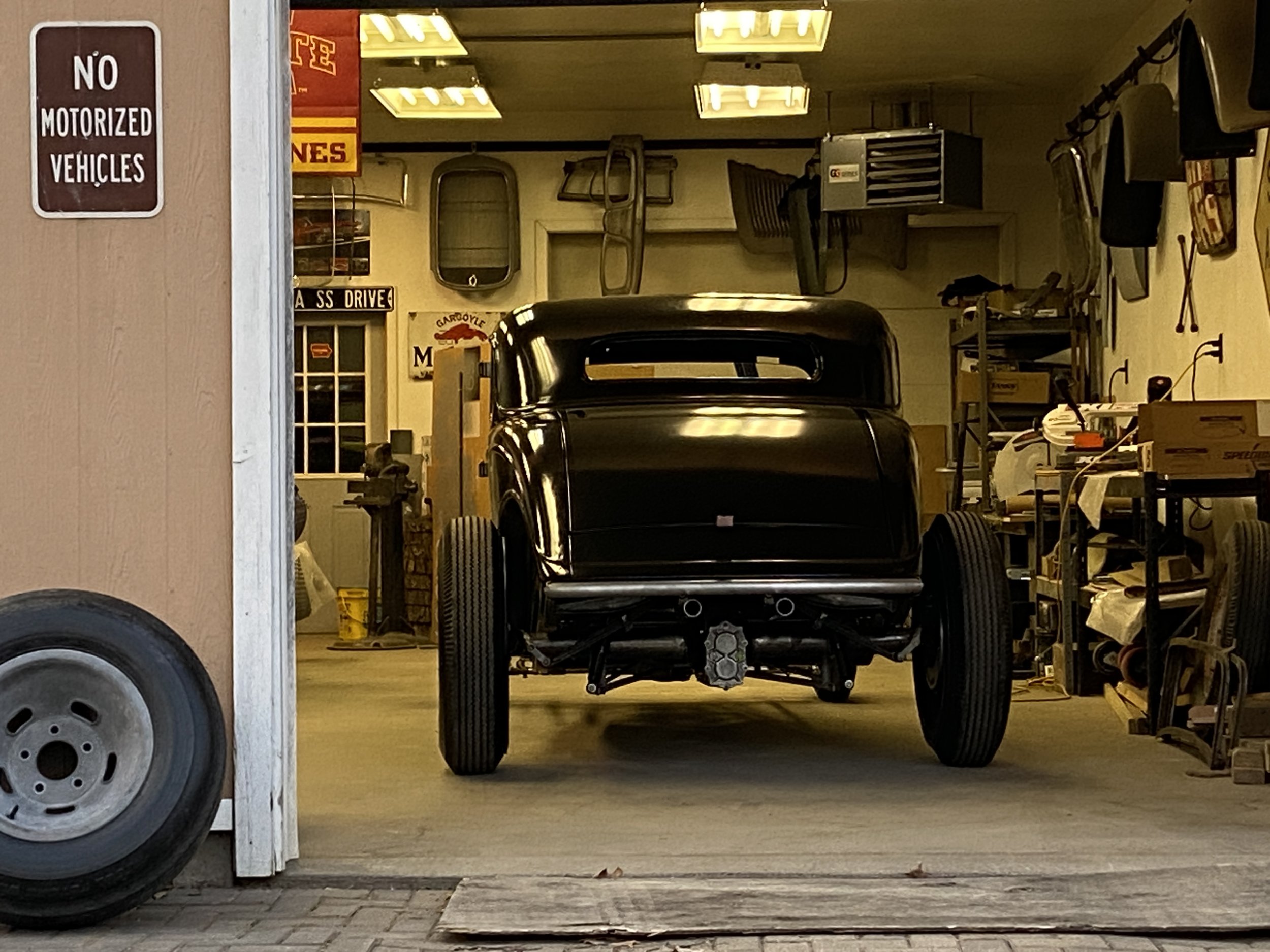

    I bought my roadster body from Speed 33 a long time ago, paid extra to e-coat the bare steel car before shipping. They dipped the entire car, deck lid and doors included. There is no bare steel on my car even in the crevices and places light will never shine. It was a no brainer as far as I am concerned. It stayed that way for years while I built the engine, frame, etc. In the damp PNW that steel body would have taken a lot of Gibbs to preserve it, as it was I didn't have to worry about it. Here is a pic oddly enough from May 2015, almost 10 years to the day.

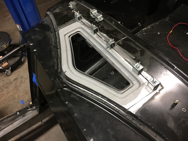

    Of course by the time I added hinges, cowl vent, etc I had sanded a lot of the coating away which was quite stubborn as I recall. But it did feather edge (kinda) as you can see in this picture of the cowl vent install.
    Before paint I DA'd the entire car with 180, hand sanded the rest like inside the deck lid and jambs prior to epoxy primer, seam sealer and then high build to prep for paint. In areas inside the doors and under the dash where it was tough to sand, I left the e-coat and applied sound deadener over it which adhered quite well.
