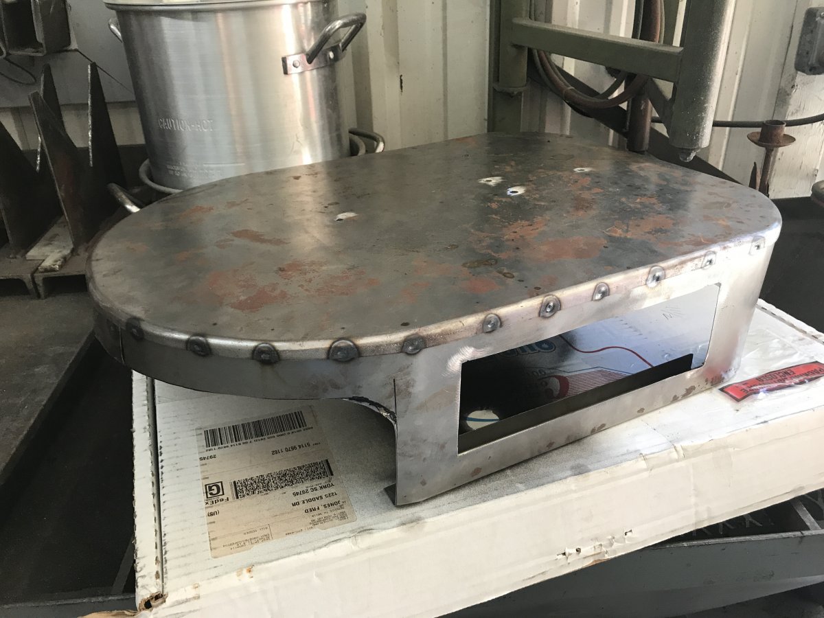

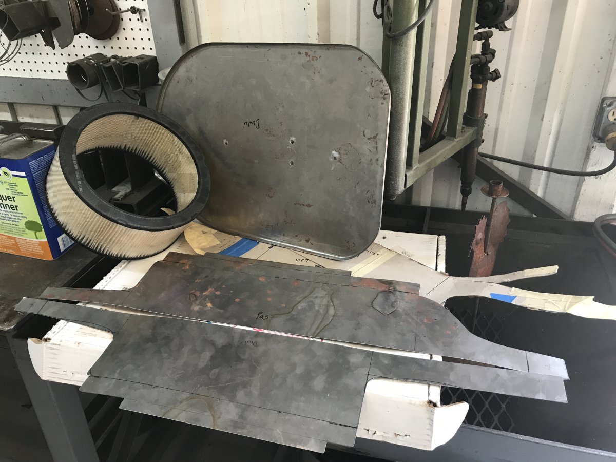

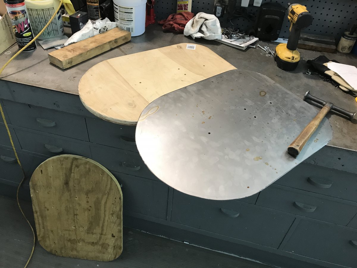

    I understand completely!:) What did you start with and what it is made with? Where did you get the chrome/stainless screen? I am looking at making another one, and if I could find a starter piece, it would be less labor for me...
    I started with a plywood buck and 23 gauge sheet metal to keep it light and easy to form. IMG_0681.JPG IMG_0865.JPG . Cut holes for air filter, Spot welded it all together. IMG_0879.JPG
    Now have to body work and decide on paint. Thanks for the reply and any info you are willing to share.

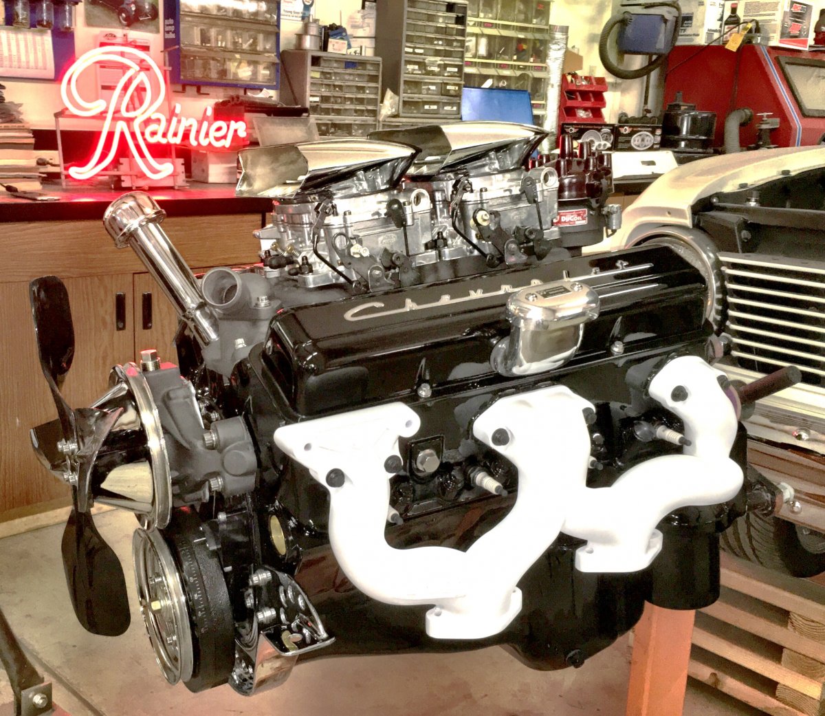

    078.JPG An "Amen" on the Eastwood Ceramic. it is damn near bulletproof and takes fuel contact very well. Only one I know that endures brake fluid.
    A few I built for clients.........

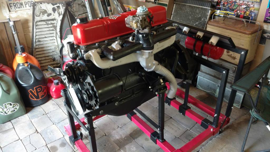

    [​IMG] Ford 223

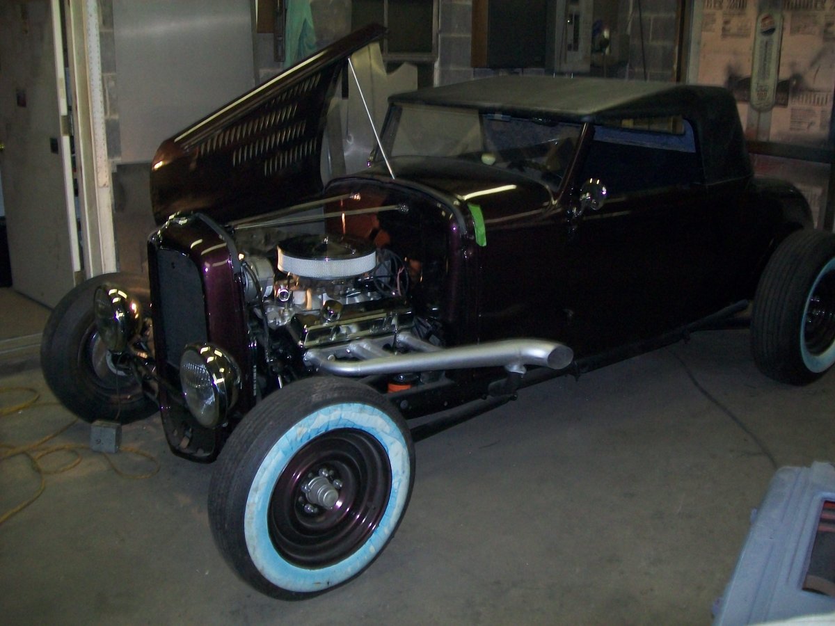

    Nice ride. Who builds those headers? I keep seeing them pop up, from time to time.

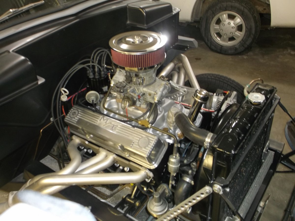

    I ***ume you mean the ones on the Coupester. That set I built using mostly Patriot components. Most people I think just use the Speedway ones. The turnouts are just segments of 3 1/2" mandrel U cut to fit. I have blockoff plates inside the U with silicone gaskets to close off the open headers when wanted. I don't care for the appearance of the 4 bolt plates to block the headers. They pull off with a wing nut. I don't get too carried away with perfection on these as PA. require them to be wrapped anyway.
    This was an early build pic on this car with a 4V carb to break in the engine. It was replaced with a set of 'trips after the engine was setup. Very nice driver with a ton of legroom and great profile.

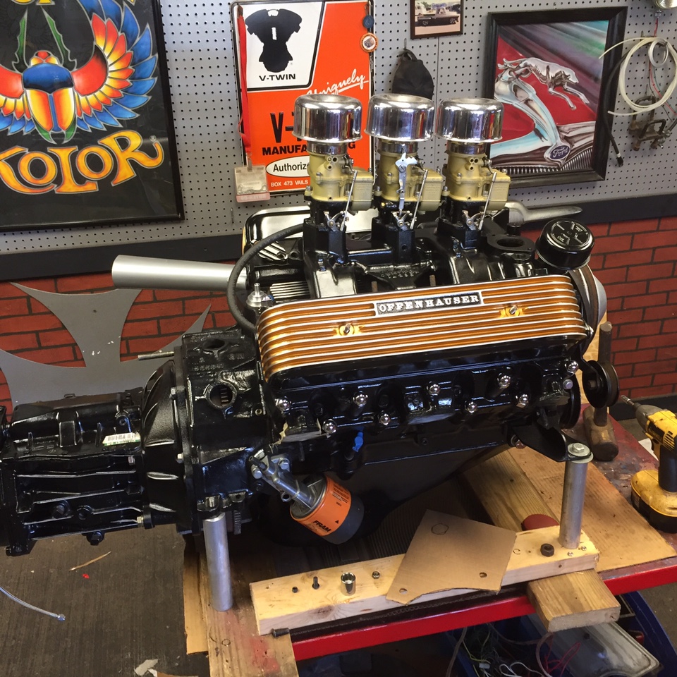

    Here's what I finally came up with[​IMG][​IMG][​IMG]
  25. Looks good. I like the contrast.

    Better get rid of that Fram oil filter!:eek:

    I was waiting to see how quick someone would jump on that Fram filer !!!!!
