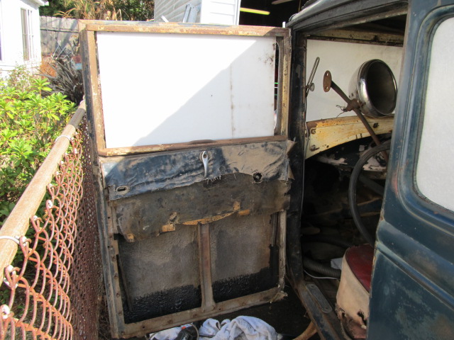

    Ran into some trouble getting the doors off,---- Had to heat & drill about 1/2 of the pins-- - didnt want to over heat them with the torches, so i used Mapp gas. After a couple weeks of soaking with penetrating oil & working them finally got it- 311.JPG 375.JPG 377.JPG 374.JPG 389.JPG 373.JPG 382.JPG 380.JPG on this last pic. in between the belt molding body lines -you can kinda see the crease in the 1/4 from that beam about 6 inches long-

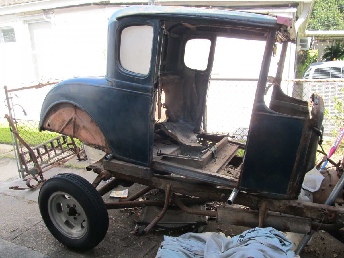

    Time to bite the bullet------------- 0ne man operation as alwayz-- 020.JPG 022.JPG 023.JPG 024.JPG 030.JPG 034.JPG 035.JPG 043.JPG

  13. sloppy jalopies
    Joined: Jun 29, 2015
    Posts: 5,256
    sloppy jalopies
    Probably fixed by now...
    but for any other rodders with a similar problem get a screw type bottle jack from under the hood in a '70s ford truck... shorten the handle to about a foot long...
    set up a "bolt on" larger base pad, [use if needed], and weld a short tube vertically to the T shaped top pad...
    weld a short piece of the same size tube to about a 3" x 5" plate to set / duct tape the plate to roof blocks on.
    get some tube that will slide inside or outside the piece you welded...
    cut an ***orted bunch of different lengths of that size tube...
    this is now a poor man's porta-power...
    use the length needed to hold the roof up while you tap around the edges... HIH...

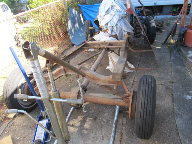

    Time to move home -for much needed space
    Used the wheels off my car lift which clamped nice to the cart -BUT where way to sensitive -- if you breathed it would take off rolling - eventually changed out to car 2 car dollies for more control 010.JPG 011.JPG 012.JPG 013.JPG 017.JPG 019.JPG 021.JPG 022.JPG 001.JPG 023.JPG 024.JPG 028.JPG

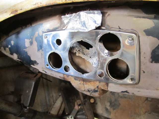

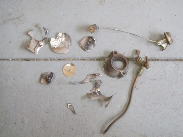

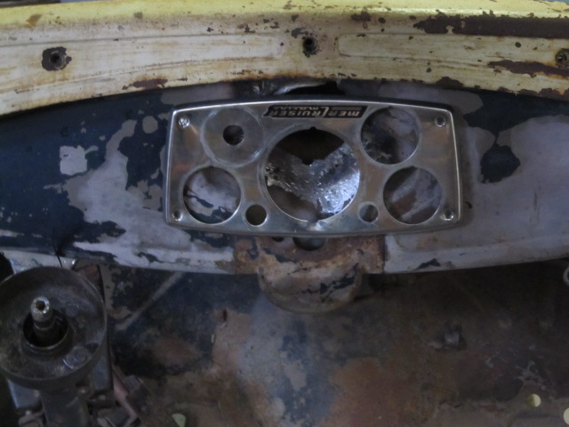

    Little Dash Modification 059.JPG 063.JPG 067.JPG 068.JPG 069.JPG 074.JPG 078.JPG
