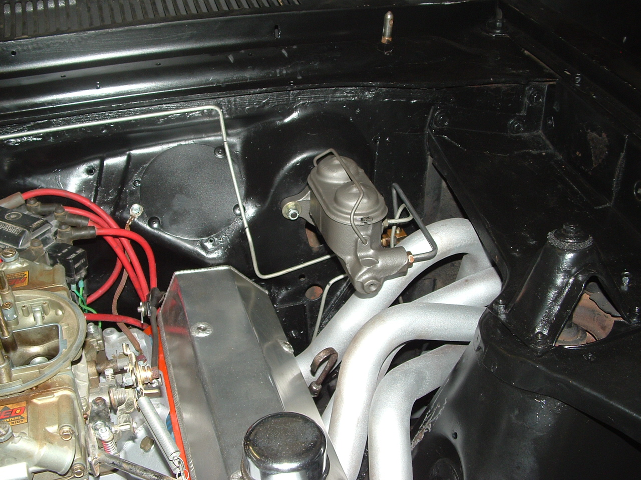

    Put a master cylinder on a '64 Nova yesterday and am getting zero fluid out of the front cylinders. Bench bleed the M/C, have 1/4" free play in rod, all new lines. It looks like a Camaro (?) drum-drum M/C, it come with the car and I have the front port plumbed to to front brakes. I'm thinking on drums it don't matter, right or wrong? No proportitioning valve used. It has me stumped, anybody? I read thru half a dozen threads on bleeding before posting this, but most I read dealt with disc-drum or under floor M/C's.

    Try switching the lines. If your getting good pedal pressure and no fluid out the lines I bet that cures it.

    Bleed the rear first if you haven't. You will need residial checks both ends.

    Put a rag around the front line at the master cylinder and crack it a little to see if the M/C is giving you pressure at that point. When you bench bleed it, it should have been O.K.? The problem would then the be the wheel cylinder or the line.

    I'm not getting a "pedal", goes to the floor!

    With drum brakes you do !! I repeat bleed the REAR FIRST if you have not.The back half of the MC piston pushes the front by hydraulic pressure. If you still have air there bleeding the front first will be tough if not impossible.

    no pedal at all? could be a couple things. maybe the bench bleed didn't take. had it happen on a '66 chevy II once. and the other thing, i dunno if it makes a difference on a drum/drum setup but the rear port on the MC goes to the front brakes and the front goes to the rear. i just finished a drum/drum setup and after bench bleeding, i used a vacuum pump at all 4 corners. worked great and i didn't need a guy pumpin the pedal either. :)
    p.s. i didn't realize you needed residual valves with a firewall mount MC. i thought those were only necessary when the MC is mounted at or below the the wheel cylinders or calipers. did chevy incorporate them into the prop valve? cuz i don't recall seein any on that '66..

    Is that a brake line going above the master? (could be an air pocket issue)
    The old way to bench bleed was with return hoses to reservoir - I now plug the ports and use a 1" stroke /don't bottom it out
    Then bleed furthest away on your car, I jam a stick between the brake pedal and the seat for pressure
