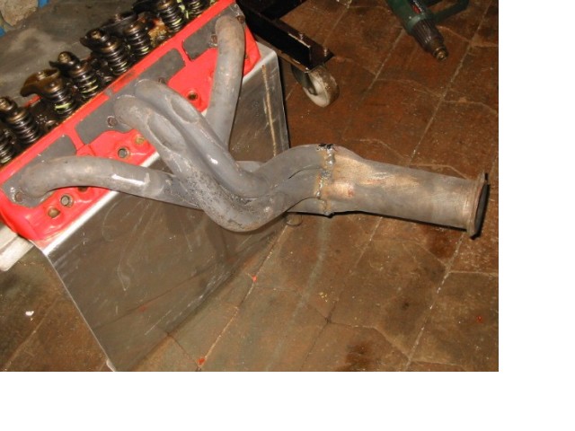

    Thanks to all of you for your help. I use the original style front engine mounts with new rubbers, rear engine mounts and the th350 cross member tranny mount. I guess the engine should be in the correct position.So, what should I say... I did it. I´m not yet finished with the drivers side header, its collector will have to be shortend and "bent" about 45° to the rear. The clearance is perfect and I´ll be able to run the pipe tight to the floor. Here´s a pic of what the problem was. The steering box is really close to the cylinder head.

    The passengerside header is finished and fits perfectly.It´s about 10" shorter than before.

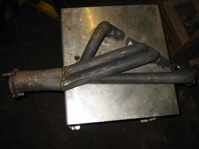

    The driversside header has been shortend about 10,5". I had to modify the collector to accept the pipes.There are no more clearance problems with the steering box, oil filter or rear engine mount. The collector will be shortend about 2" and it´ll get a 45° angle to the back. Maybe it was worth at least to save the new headers from being dented.

    And here´s what I´ve cut out
