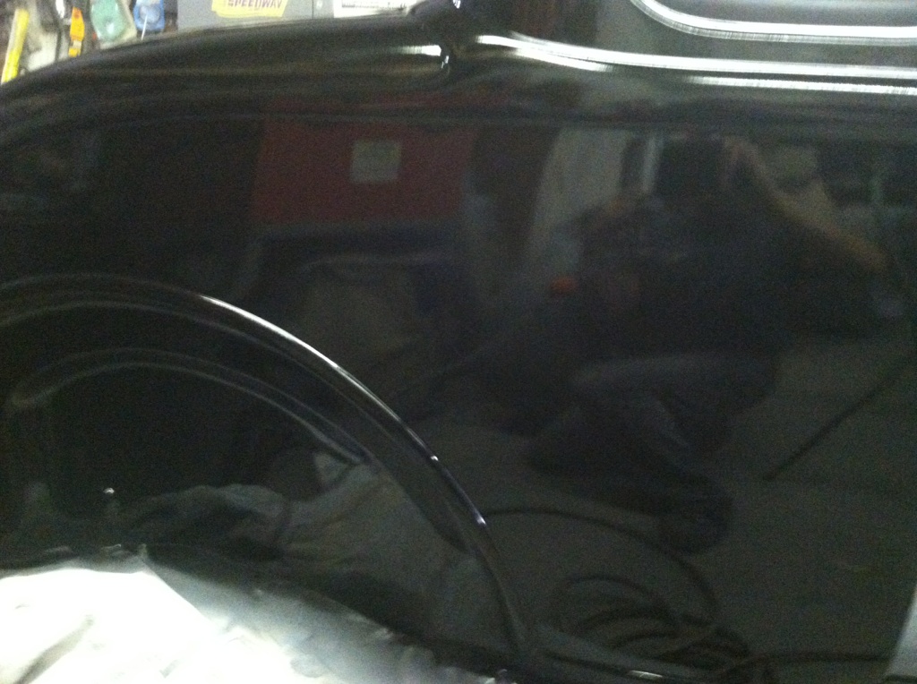

    Tony
    I couldn't agree more!
    Blocking ****s big time..pretty much because I, like you, can't allow myself to do it half ***ed. So, it takes a lot of time and tedious work.
    To back up my stupidity, i show you this. :)
    The p*** quarter on my 32 that i just painted a couple weeks back.
    The pic was taken wet, but it's satin paint as you can see in my avatar..still straight enough to be shiny black though..
    Why? 'cause i can't do it any other way..hahaha
    So, sanding ****s!
    or maybe i have have OCD?..hmmmm
