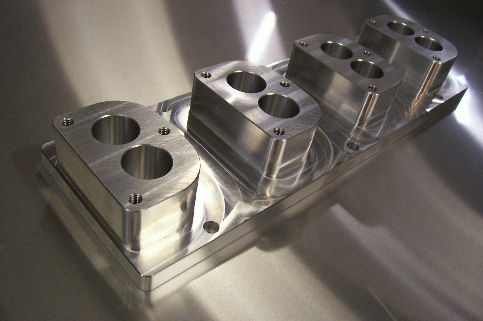

    I have a strong running 347 SBF (Stroked 302) that's going to be making it's way into a 31 Vicky on 32 rails. I want some Eye Candy for carburetion, but not the 2x4's that I had originally planned on. Edelbrock offer's their 3-2's Vintage intake for the SBF, but the idle-5500 RPM specs for this manifold makes me feel that I'm going to lose all the breathing ability of the TFS heads and stroking that was built into this engine. I picked up a couple of sets of the Demon 98 carbs and was contemplating modifying a Offy Dual quad manifold to accept four of these Demon carbs inline. At 205 CFM, three on a good flowing manifold would be a little short for the breathing ability of this particular engine and 4 at 820 CFM, would be a little too much. So I was also contemplating using a blower manifold and bolt on one of the adapter plates that dashman machines, with either the three or four two barrels carbs. My question is, how would a blower manifold perform with such a large open plenum, in this particular scenario? Here are dashman's plates I'm talking about using on top of a blower manifold.

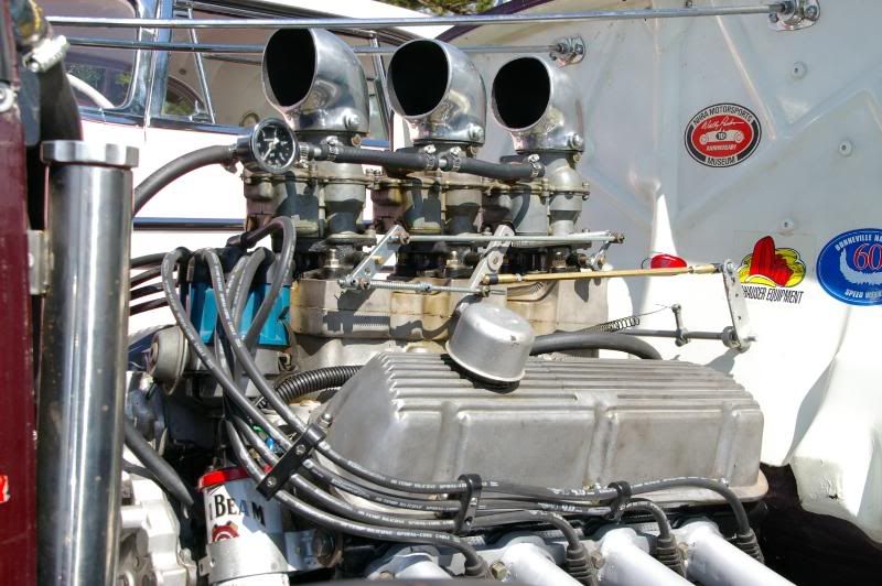

    there's a picture of three 94s on an adapter on an injected truck manifold here someplace...
    didn't look too bad, don't know how it performed
    better eye candy (in my eye anyway) would be four Webers on a Cobra intake

    here it is, you no doubt would need more carburetor but the truck manifold may be a better base than a blower or tunnel

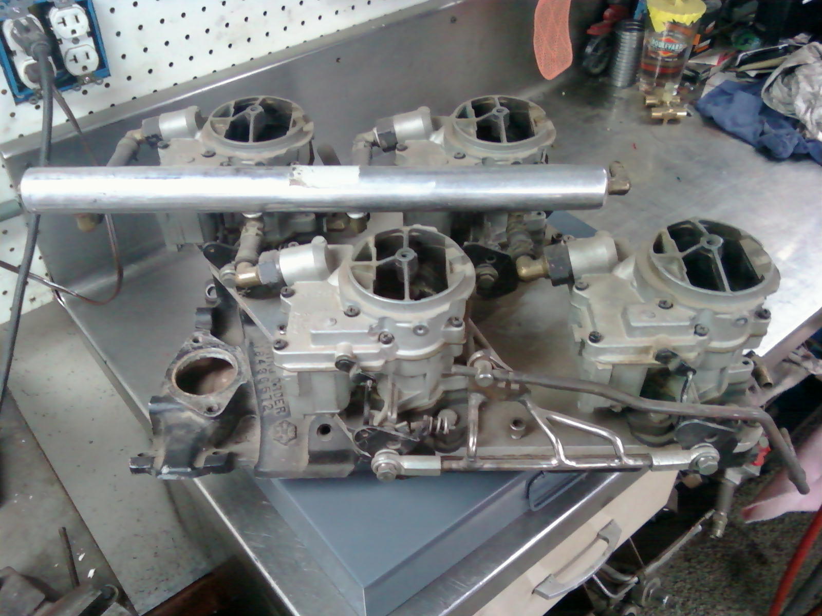

    Here you go, A blown 347 with six strombergs .

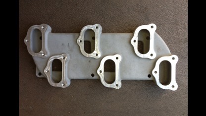

    I have a cast top I make for 6x2
