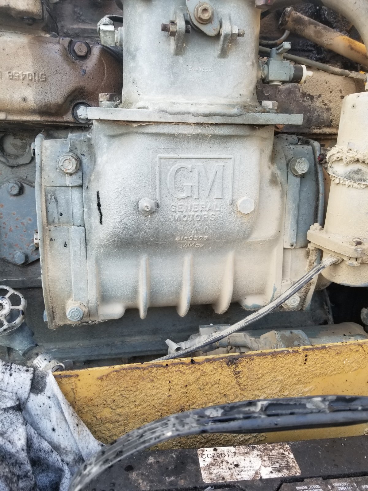

  1. Ok, gurus, I need your advice. I just got this 671 blower from a local guy (no money traded yet as we have known each other for years). It wouldn't roll completely around, so I started blowing it out with air and parts cleaner and finally got it turning completely (I didn't force it), it's obvious it had some moisture in it. Without tearing it down further yet to inspect the case, would you say the rotor is screwed? He has another complete engine, so he's gonna pull that blower off for me to look at. The picture makes it look worse than it is. There really isn't any pitting, just surface corrosion. Can this be saved provided the case is OK?

    How much of that will come off and did it harm the parent material?

    The corrosion damage is too deep and the rotor is at a weakened state, Might be OK for some people, but I myself ,personally would not run it

    I'd run it, but I'm an idiot.

    I gave you a like @squirrel , not because I also think you’re an idiot, but because I’d run it too.

    It's a supercharger, not a lawn mower engine that was stuck and you free'd up. It's a precision clearanced unit. If you care nothing about anything but just having it sitting on top of your engine for show, go ahead. I personally would send it off to a blower shop and pay to have it re-built. JMO. Lippy

    There's probably more corrosion in there. Needs further inspection. Then maybe call Dyer's for their opinion. No offense to anyone here, but it's probably junk.

    My only experience with GMC 6-71 blowers .. was selling a pallet & a half of cores to Gary Dyers of Dyers Blowers in Summit, Illinois.
    No pricing on my cores, until he dis***embled and inspected. Luckily I did fine. Of the 15 cores, 3 had bad cases, 2 had bad rotors. Basically, can't tell sh*t with photos.
    There are decent rebuild guides on the internet, some would even gl*** bead those rotors, if the case is good.
    I of course, dunno' sh*t .. unless I'm selling, & shipping to Gary. That's my expertise. :) Yep, you're welcome. :D

    I've overhauled several 4-71 and 6-71 blowers as a part of a rebuild of engines in heavy equipment we own. I wouldn't see any problem in running it based on the appearance of that rotor alone since it doesn't touch anything if the blower is properly clearanced, but the final decision would depend on the condition of the case bores as well.
    To collect that amount of water, the blower would have to be laying on its side, either in the normal mounting position on the engine, or possibly laying out in the weather. I'd be more concerned with the case and whether it may have frozen while holding water, or if water may have byp***ed the seals and got into the gear case.
    All that said, 6-71 blower cores are not rare parts and useable ones aren't worth much because 2 stroke Detroits have been out of production for 25 years, so the demand for parts for the diesel application is shrinking every day. Any blower coming off an engine that has run even in the not so recent past will have its internals protected by a coat of oil that creeps by the seals between the gear case and the rotors,. They may have some minor scoring of the case bores and rotor tips, but they won't be corroded. Based on that, I'd keep on looking. If the guy is gonna pull one off another complete engine, it should be in much nicer condition. Remember, you're buying a used part for an obsolete but very common diesel and not a hot rod part. I can't imagine paying more than a hundred bucks for a decent used one, and that makes all the checking necessary to verify the useability of a corroded one a not very worthwhile venture.

    Again .. you're asking the internet, to judge a picture. When you already did say there is no pitting, just corrosion.
    That blower has your eyeball & it's in your hands .. don't un-trust your first judgment.
    Dis***emble the unit. Check it out.

    Me too, on both counts.
    I would scuff off the loose stuff with a red pad and go!

    If you're building a AA/G car I'd agree probably p***..
    I bought a blown up engine (350sbc) that sat in a 55 chev no hood an a leaking roof.. looked exactly like Yours, same deal could turn to a sticky point..
    Knocked it apart, carefully sanded the heavy "fur" off the one spot, Sanding with the grain shall we say, Don't carve the "lip" of the rotor's..
    Bought a bearing/seal/gasket kit off eBay.
    Regularly ran it up to 6,500 trouble free on a standard bore 327.

    Since your friend has another blower, look at that one before going further. Tear down the better looking of the two, if any. It may be way better.

    Keep in mind, I'm just suggesting that the corrosion on the rotor does not necessarily make it unusable...I have no idea how the rest of the blower is. Maybe it's OK, maybe not, but he didn't ask about that, he asked about the rotor.

  25. Thankyou all for the advice. I do hope blower number 2 is in better shape. I was asking about the rotor in the picture, because if it was deemed no good then there would be no point in tearing it down further to inspect the case. Once I have a decent one, it will be tore down and built up for a 392 hemi for street use. And sorry to 57fargo, but the worse of the 2 will be going to another friend nearby as a display piece apparently.

    I would think that cleaning everything up and polishing the surfaces would not hurt anything. Increased clearance (within reason) may make it somewhat less efficient, but I don't see how it would actually cause any problem. Since its for a street driven vehicle, I don't see any reason itcouldn't be used.

    Yeh, like Jim said, run it, it's not a race car.
    Of course, standard practices, just like an old engine freshen up, cleaning, inspection, quality bearings, etc. and careful ***embly.
