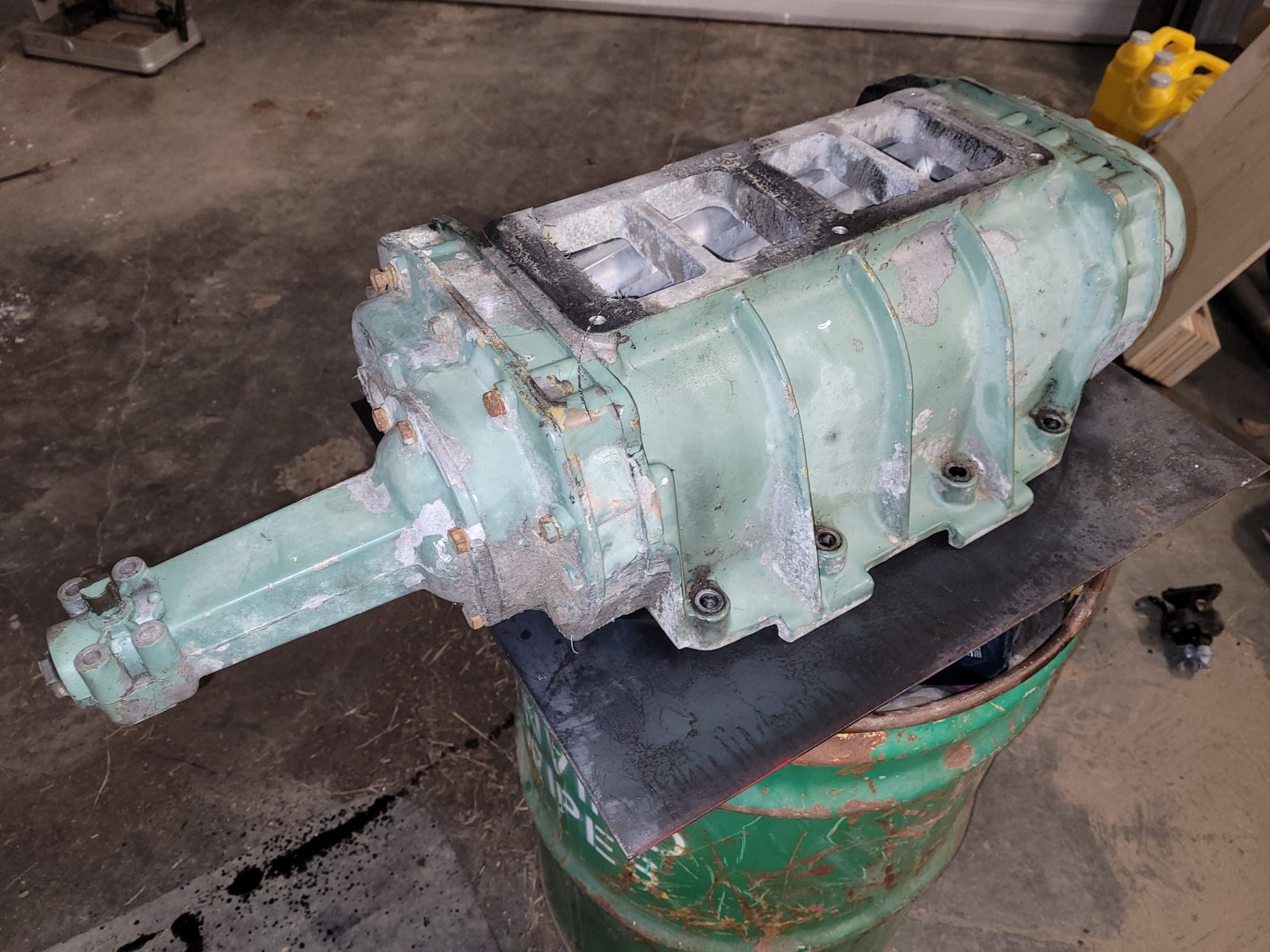

  2. From what I can see in the pic,,,,,,as long as the corrosion is merely on the rotor,,,,,and has not eaten away the aluminum,,,,you should be fine .
    If you will look at the rib on top of the rotor,,,,,,,that is what matters,,,,,it is what pushes the fuel mixture through the housing .
    The rotor should clean up nicely with a Scotchbrite pad and some cleaner .
    And check the case for any severe places inside,,,,,,as long as it is sound,,,,,,you should be good for the street .
    What really caught my attention is that is not a 6/71 .
    I can’t really tell from the partial pic,,,,,,but it might be a 6V/71
    Or even a different size blower,,,there were several other sizes in diesel applications .
    I know it is a small bore blower,,,,,the rotors are smaller diameter than a regular 6/71 .
    And the pattern on the case is different,,,, ,definitely not a 6/71 .
    It can still be used for a good street application though .
    Tommy

  3. By the way ,
    There are 6V/53 applications,,,,,6V/71 applications,,,,and 6V/92 applications,,,,,and many more sizes with each of those applications .
    Those are just a few ,,,,,but all very different,,,,,,and none of them are the 6/71,,,,,,complete different animal .
    Tommy
    Deuces likes this.

    O P , its not a big issue to take apart ,
    If you do so , keep track of shims that are under the rotor gears,
    What is your intention of use?
    Blower just a air pump , rotors do not look bad , By pic seen worse , & was dis***emble cleaned up and ran.
    If case rough & end plate are scored as long as you're not running a certain compe***ion Hight Boost application, pulley change,
    But also depends on cubic inch of engine and boost levels you are seeking.
    Street use 10 psi under 400 inch ,
    No problem,,
    By chance have you added up what is needed to install ?
    Just off top of my head , been long time since I purchased supercharger /blower parts,,,
    End plate $150 ( some times needed change)
    Front cover $80
    Bearing/ seal kit , $150
    Snout $250
    Pulleys $75 each
    Idler plate $150
    Idler pulley $150
    A actual Blower intake $400 up
    Carb plate $150
    Bell Linkage $140
    Carbs $150 each used
    Carb kits $25 each
    Rubber band $140
    Bolts / studs $75
    Boots gauge $50
    Relief valve and sight gl*** $80
    Gaskets $60

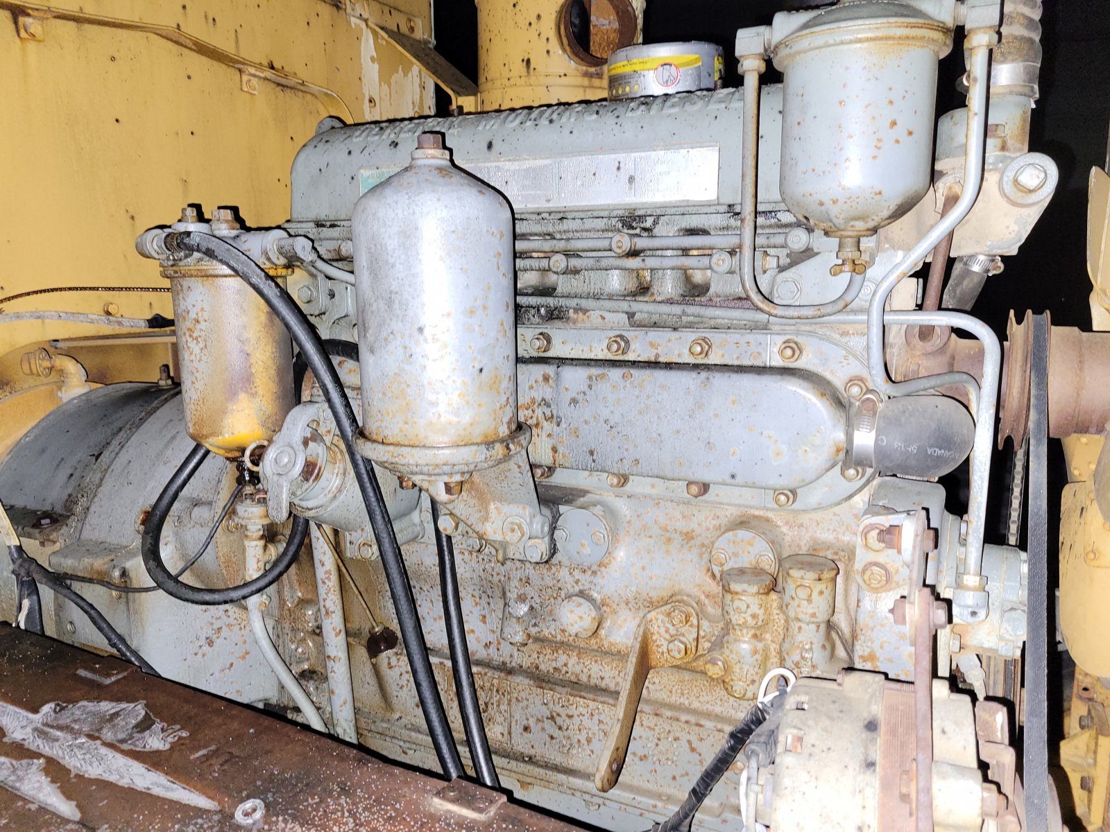

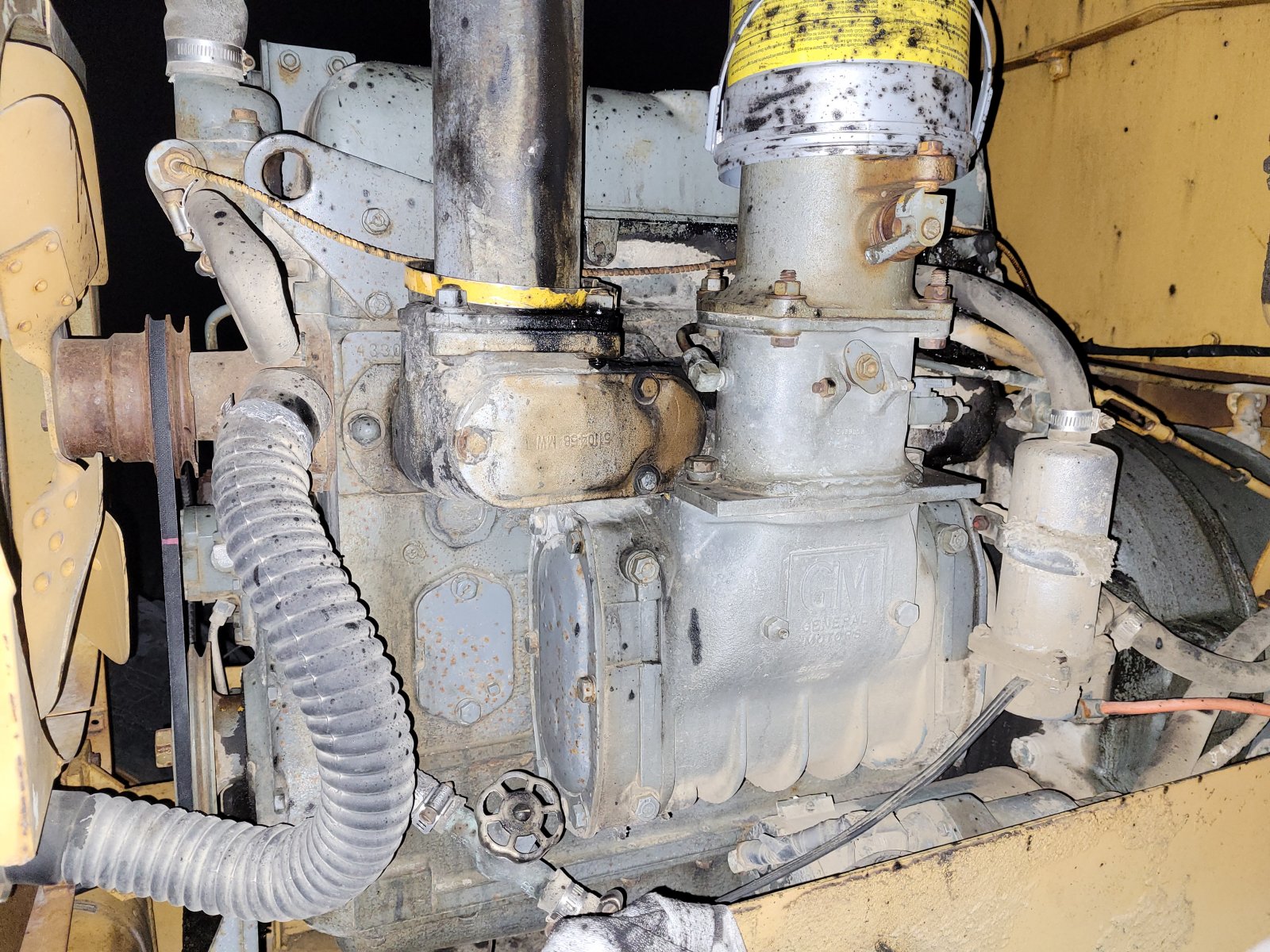

  7. I put only the one picture on original post as the rotor was of concern. I think I'll go deeper into the case anyways just out of curiosity. I'm including a picture of the blower itself, and a better picture of the 451 engine in my grader. Don't confuse the two. They are two different things altogether, and I have no intention of trying to fit a 671 blower onto the 451.
