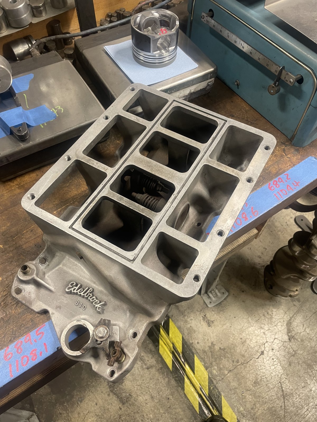

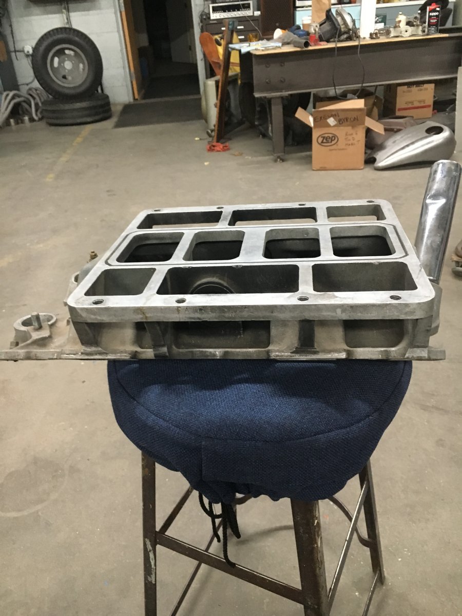

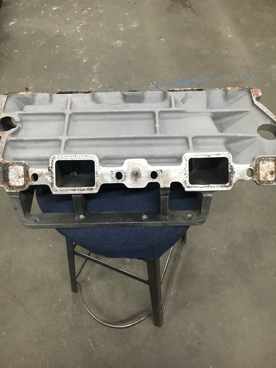

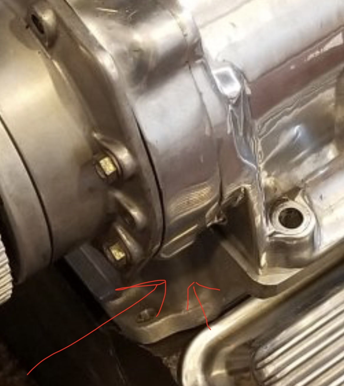

    Is there anyway to plumb the intake instead of drilling the heads
    lumpy 63 likes this.
  4. Fordors
    Joined: Sep 22, 2016
    Posts: 7,052
    Fordors

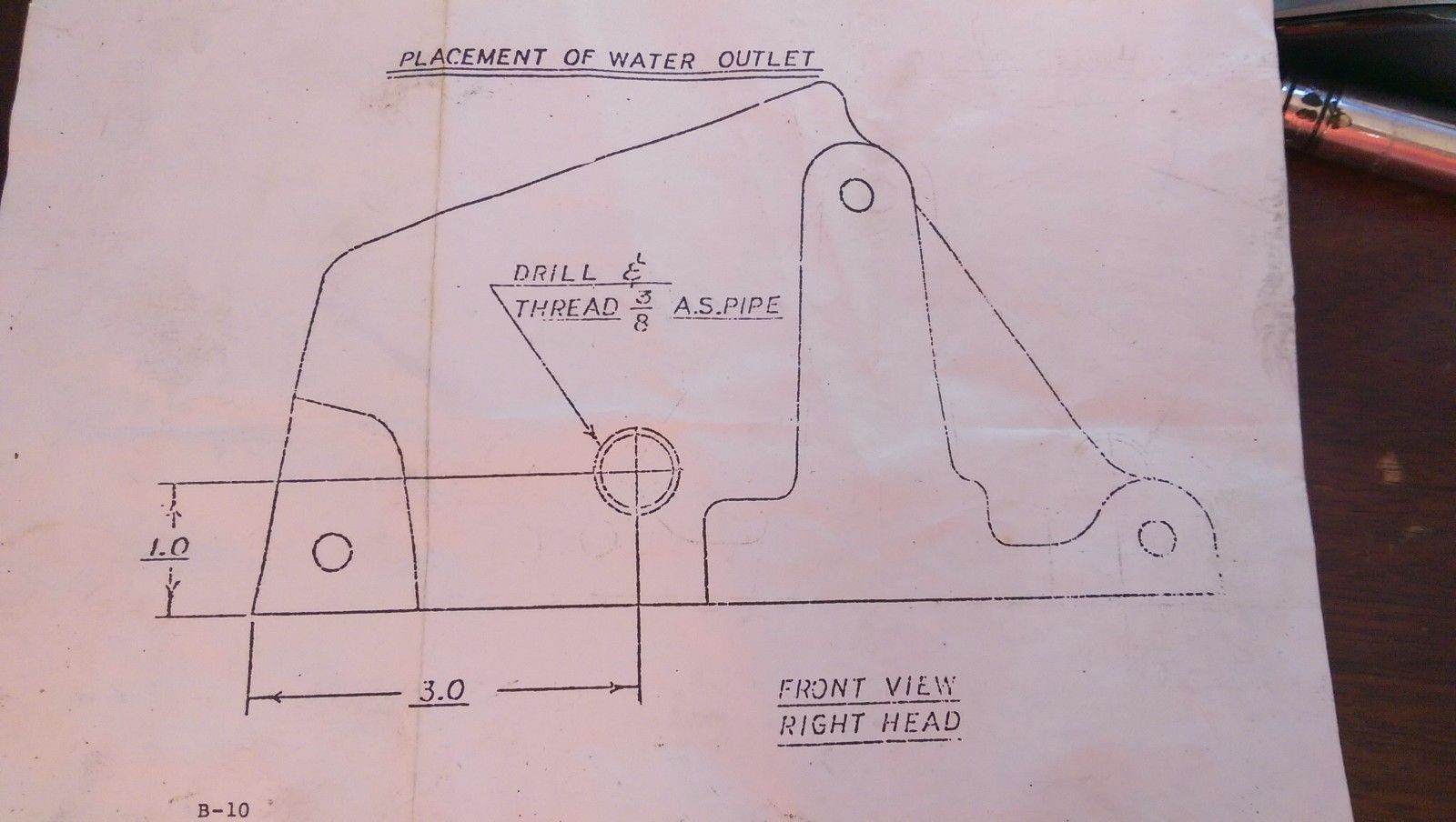

    This picture of your mock up on a SBC is marked to show how the B10 would need to be drilled to get coolant from the heads to a thermostat housing. Drilling the heads is an easier way to accomplish the task, at least to me.

    The B10 has a water port coming up from both sides in the rear, on either side of the distributor, one side has bleeder valve and the other is a 1/2 inch male pipe thread. Could be modified to run off of that fairly easily, currently that’s sounding like the simplest way to get coolant back into the motor.

    I can understand wanting to use a vintage speed part, we've all done it hundreds of times, but this might be one of those times to use a later model part. The port on the left side of the B-10 manifold was intended for a temp. sender and the one on the right was added by a previous owner for an air bleed, and using those ports for an outlet will not allow proper cooling, the coolant need's to be routed to the front of the engine - through the head's. If you don't want to drill and tap the front of the head's for the crossover and remote t-stat housing, a later model manifold with a water crossover and t-stat housing on the front might be your best bet, and then you can figure the snout length once the blower location and accessory pulley's are accounted for. JMO

    use your B10 intake , dont be scared to drill the heads on engine & tap ,
    Set of harbor freight pip tabs under $100, not the best but they work.
    Drill small pilot hole 1/8 first , then tape or have someone hold Vac hose while you drill the bigger hole , same when tapping ,, No big deal ,,, Me personally if I hade to do, I would have No problem drilling my 15 deg heads .
    "water gallery" vacuum out after wards
    Thermostat optional, !!!
    make a Y with two #10s to 1-1/4 1-1/2 to top of Rad
    #10s might be to big , Drop to #8s
    You can play with washers to speed up or slow down flow ,,
    I copied this from another thread and saved it on my phone for that "someday that I might need it".
  19. Gavin Tittle
    Joined: Aug 15, 2017
    Posts: 277
    Gavin Tittle
    And now I’ve saved it, the pattern continues. thank you

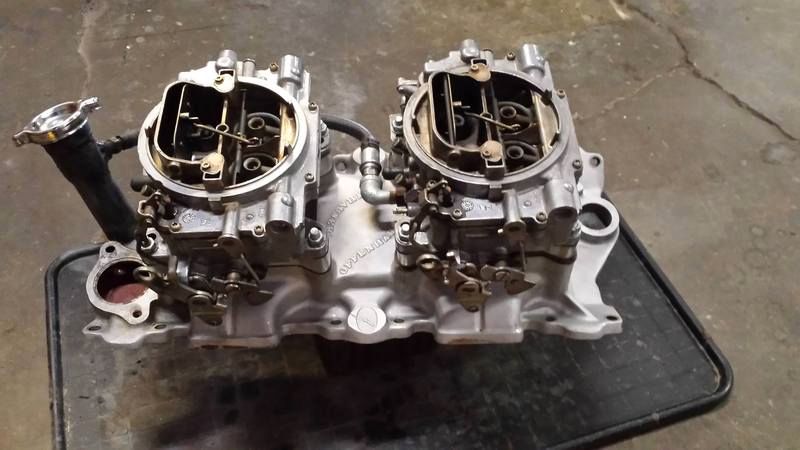

    Here's a couple shot's of the stuff needed for the Drag intake, It was combined with isky drive set-up..
  21. 19Eddy30
    Joined: Mar 27, 2011
    Posts: 5,154
    19Eddy30
    from VA
    That style of pulley , I do not how hard to find, But with a lathe & mill can be
    Duplicate & in different sizes if Originally Not made with a tooth count needed,
    Machine from solid stock ,
    or take a modern pulley , cut center out & machine a new center , weld in , face it off & tapper ,,,
    I have made odd ball thing for my self ,
    427 sleeper and mad mikey like this.

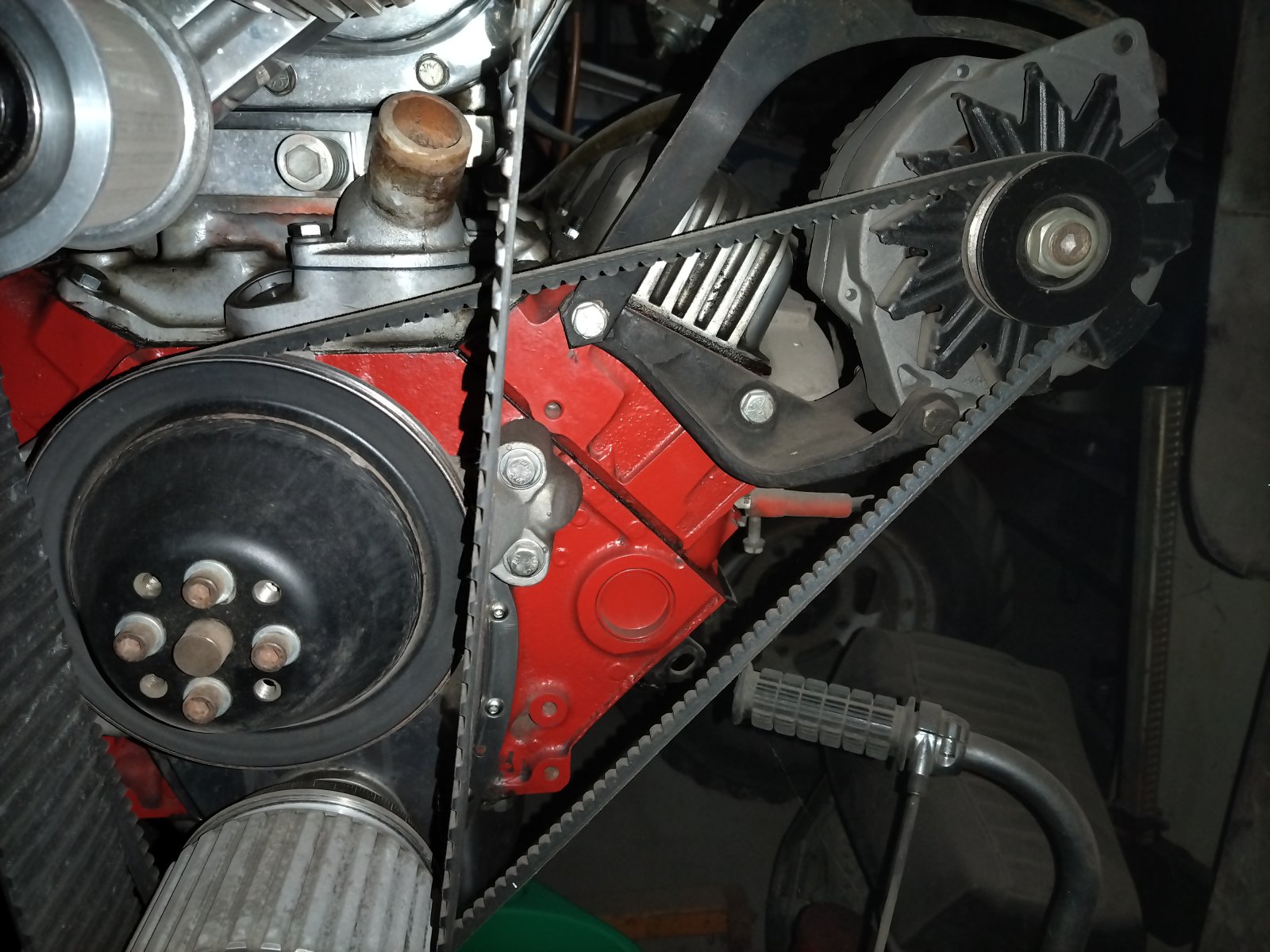

    Here's a sbc I'm putting together myself, Blower is a hemi , Hemi/sbc are the same as far as pulley reference, give or take depending on your V KIMG6355.JPG KIMG6356.JPG pulley count, May need a shim to get out farther if two pulleys are needed..
    swade41 and mad mikey like this.
  23. Hollywood-East
    Joined: Mar 13, 2008
    Posts: 2,203
    Hollywood-East
    This is a V 671, only showing to give ideas.. Used a late 60's/ Early 70's truck alternator mount KIMG6357.JPG KIMG6360.JPG
    mad mikey and 427 sleeper like this.

    I would not drill the holes per the diagram you have until you moch up all your stuff and see just where you have room and don't have room. Using Hollywood-Easts picture, you can see that there are a lot of things that you need to avoid interference with to make it work. Also, instead of an NPT thread, you migh want to use a JIC fitting...maybe one with a swivel so you can clock the fittings well. Also it would allow all fittings to be a silver color to match the tube.
    mad mikey and saltflats like this.
