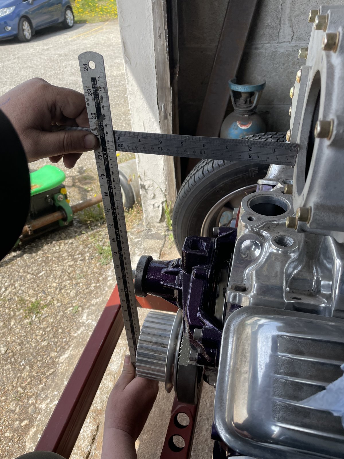

    Hi,
    I am fitting a 4 71 to a sbc. I have the blower mounted and I have the bottom pulley all mounted. I have run a straight edge up from the bottom pulley and measured back to the flange on the front of the blower where the snout will mount. I planned to turn the top pulley around so the hollow side closest to the blower if that makes sense? I am unsure how they measure the snouts that you buy? Which measurement do I use when purchasing ? Any advice is greatly appreciated ..

    You need to know the thickness of your upper pulley to find the true length of your snout. You can use the bottom pulley thickness as a guide as they are MOSTLY the same. Not all, but most. Once you have the top pulley face lined up with the rearmost edge of your straightedge, then you can measure the upper pulley inside mounting face to the face of the cover where you have the upper straightedge now.
    Snouts are sold measured from the front cover mounting face to the top pulley mounting surface. If your upper pulley is 1/2 thick, you would need a 7.5 long snout. Better to be a bit short than long. They make spacers in just about any thickness.

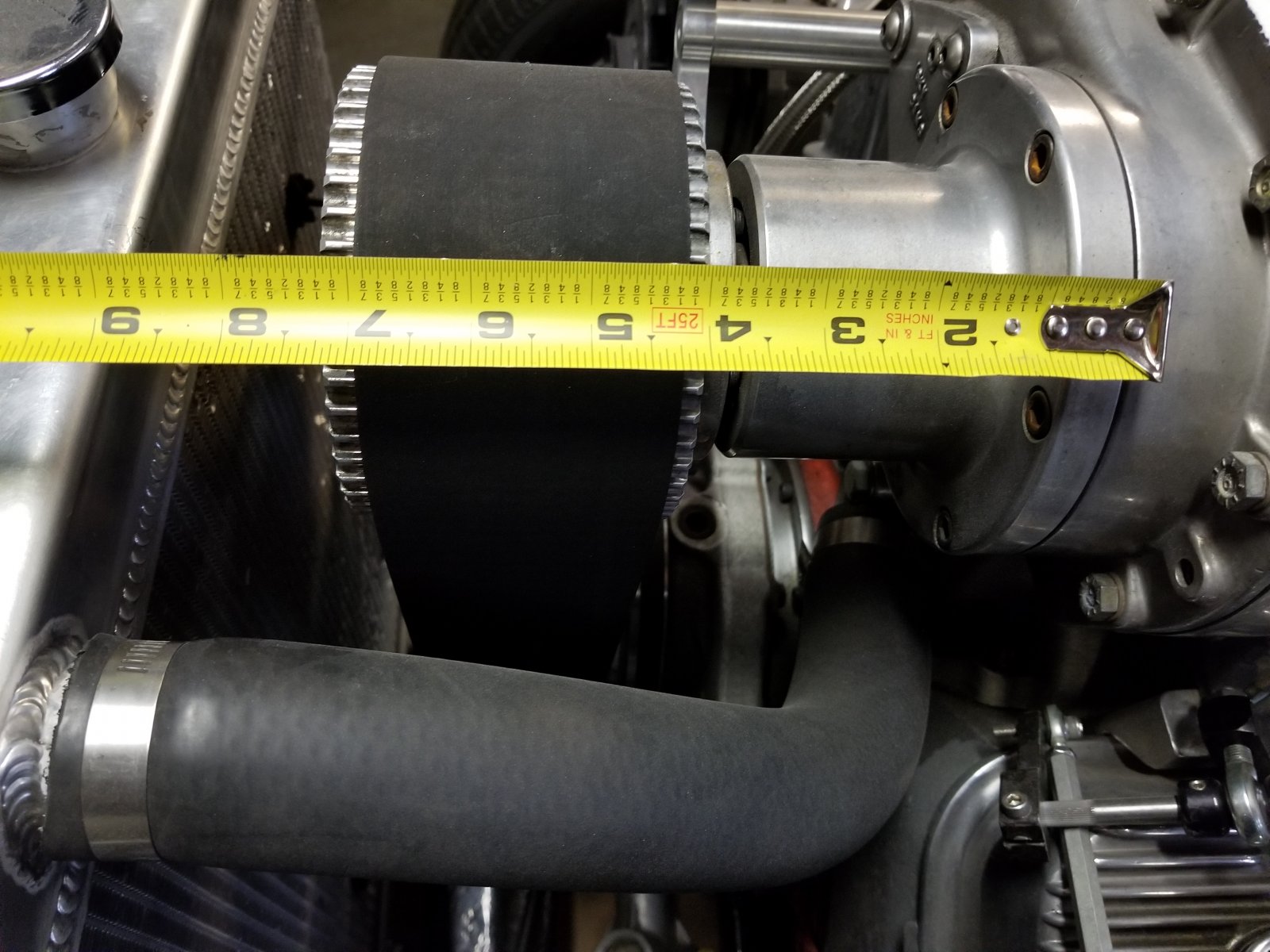

    Most pulleys are 1/4 -3/8s thick (Unless ful compe***ion) , the snouts are Measure from mounting flange on gear cover to the flange of pulley , being first time running/ setting up you will find you will have ***ortment of shims & spacers Not even so call bolt on kits rarely are that , modification adjustments required.
    If Tight clearances become an issue you can always go to an 8 mm pulley and kevlar belt cut down or purchase to 1-1/2 set up , & probably can get away with a 1.00 -1.250 inch belt on 4-71. I have ran 6-71 @ 15 psi on 2 inch close to 700hp 7,000 rpms 8mm & 8mm GT belt/ pulleys 478B3BCB-BA7B-4866-8990-2737F831EC79.png

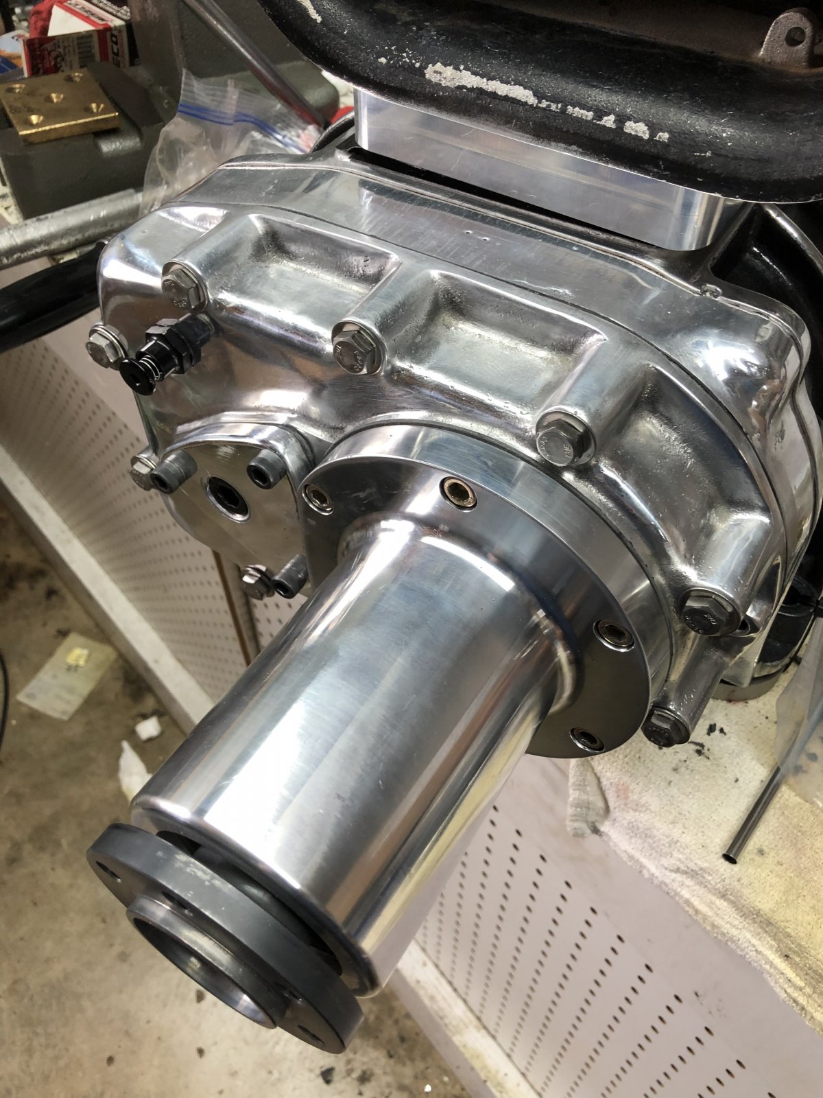

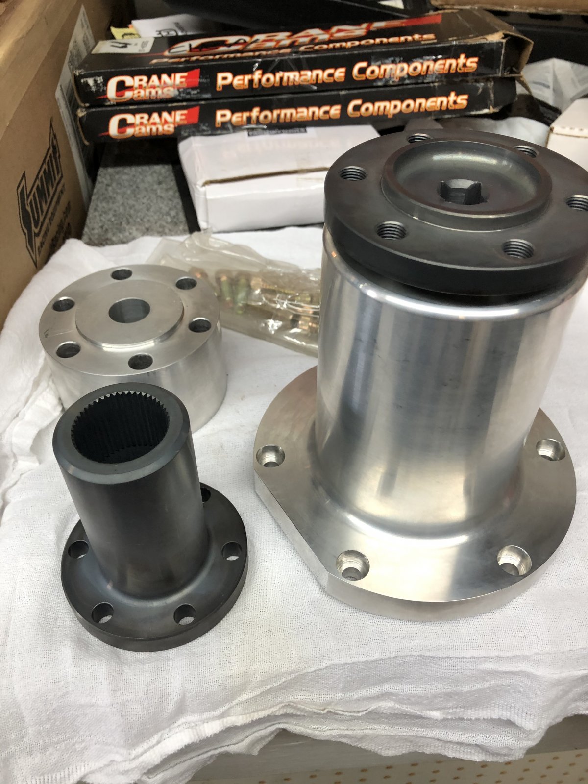

  8. This is what I have,,,,it’s cl***ed as a 6 inch snout,,,,,( measures around 5 7/8 ),,,,,I’m gonna use it on my Mopar small block,,( Desoto Hemi ),,,,LoL .
    I’m planning on running the pulley turned to the inside,,,,I purchased a spacer just in case I need it .
    But,,,you can run the pulley whichever way you choose,,,or need to .
