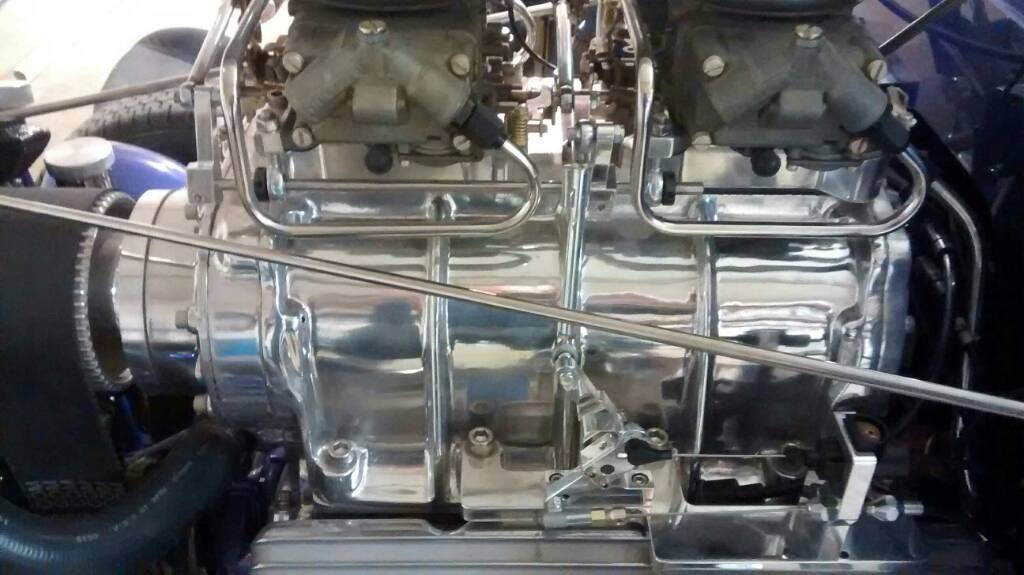

    From your description, I can't really tell what you have...I can kind of guess...but a few pictures would help us help you figure out what changes you might want to make.

    When the carbs are half open, are all the linkage arms at right angles to the rods they attach to?

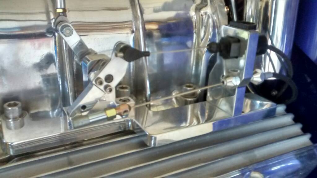

    Yes, it's definitely not going to work. I had the Morse cables on a jet boat, but didn't think I can get anything that short. I figured it's a pretty common setup,just don't know how people do it. No blower guys around me.

    The setup you have could probably be made to work. Be helpful to see the carb end of it, too.
    The gas pedal cable situation...if you moved the pivot point out off the firewall, and also raised it up a bit, then it would probably be much better. Try to set everything up so it's at a right angle in the middle of it's travel, not at the end of it's travel.

    Like Squirrel says: ALL rotating arms 'equidistant', another thing is return springs.
    Put return springs on the end of the linkage, or in a straight continuous line with linkage.
    Springs attached to opposite angles of carb arms tend to encourage the throttle shaft (s) to 'saw through' their bushings.
    ...and the idle setting gets higher...and higher...and hi...

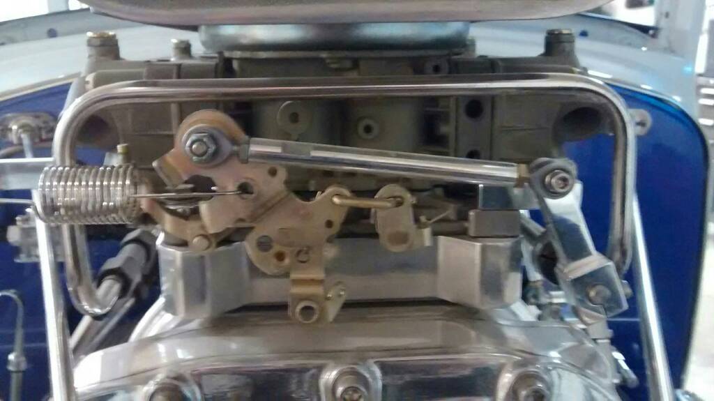

  24. rawcjw19
    Joined: Oct 8, 2012
    Posts: 581
    rawcjw19
    Figures I made real nice return spring brackets, and they probably won't work. Ugh

    P***enger side

    Drivers side

    I see some horrible engineering practise there. Big long levers, horrible mechanical advantage, cables pulled at bad angle. I have twin Holleys on a tunnel ram, throttle is finger pressure. It won't be any different with a blower underneath.
    How far does your foot pedal move to get full throttle?
    My throttle pedal is home made, pedal moves twice as far as it pulls cable, cable has to be pulled 2" max to wide open throttles.

    your spring setup looks ok to me, it's pulling on the linkage, not on the bottom of the throttle arm.
    Take a look at all the angles, I think the pedal is the main issue, but there are some other angles that are hard to see from the pics, that might be causing problems, I can't really tell what the bellcrank that goes from vertical to horizontal movement, looks like.
    Also the springs don't need to be very stiff, you might try some different ones and see how it affects things. For racing the tech inspectors like to see double springs in case one breaks...using light springs is a necessity when there are 4 of them you're working against.
