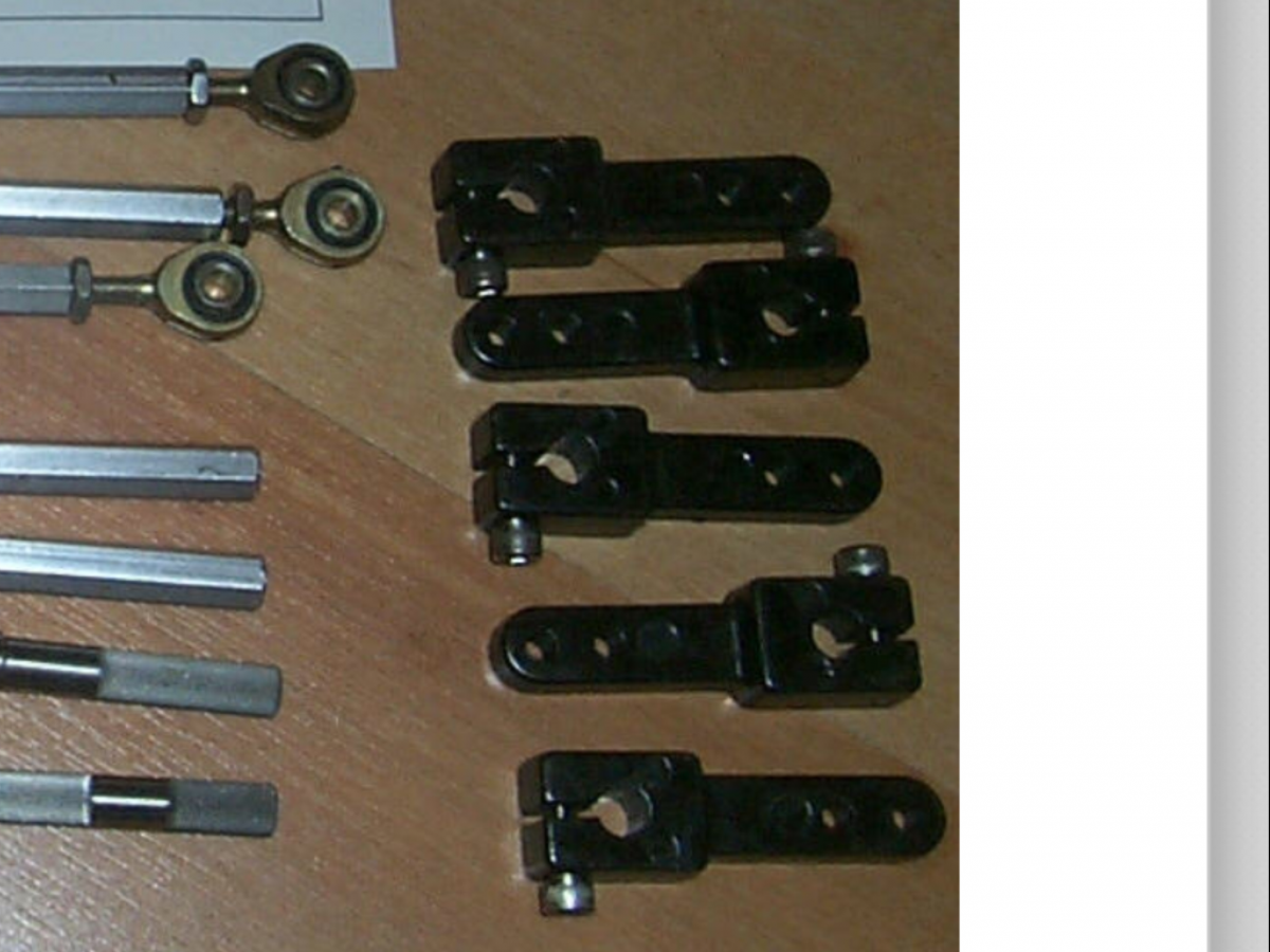

    Drill & tap new holes in yr linkage to change the Ratio , ( like Enderl set up ) then it will Chang the the amount of pull @ gas pedal,
    Now it will be completely adjustable !!

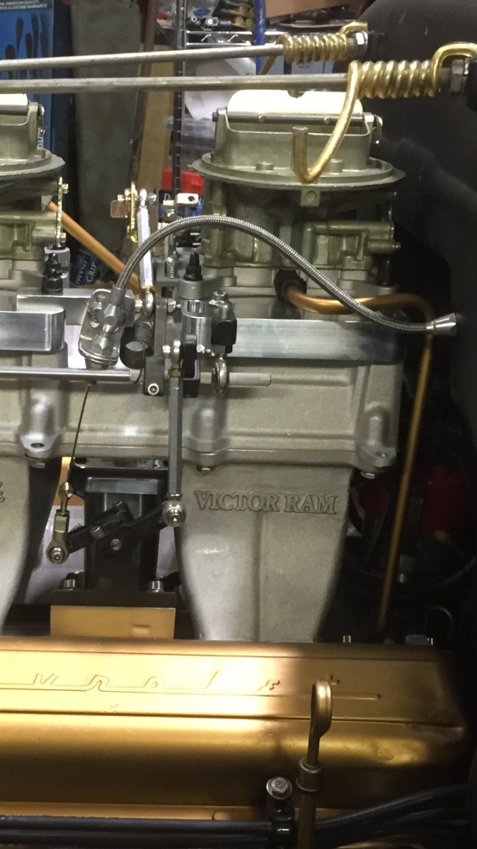

    My set-up is all home made and works a treat. I use a marine grade standard style cable (not morse) The marine ones use a Stainless steel inner with a liner, very smooth. IMG_0045.JPG

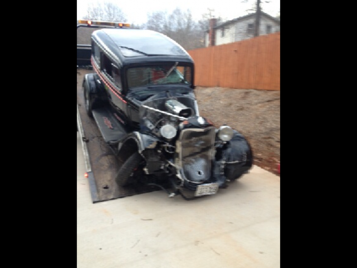

    image.png Some thing That I Recommend & I Do ,,
    If You have a Bad A$$ power plant ,
    make shore you can find the KILL switch ( Key )
    Quick & Easy !! Thing can go Wrong real Fast ,Stuck Throttle
    This was a well known Street Racer Car for over 46 yrs ,
    5.90s-6.0s in 1/8 on street Tire's
    Was Just Redone , then Two week Later ----
