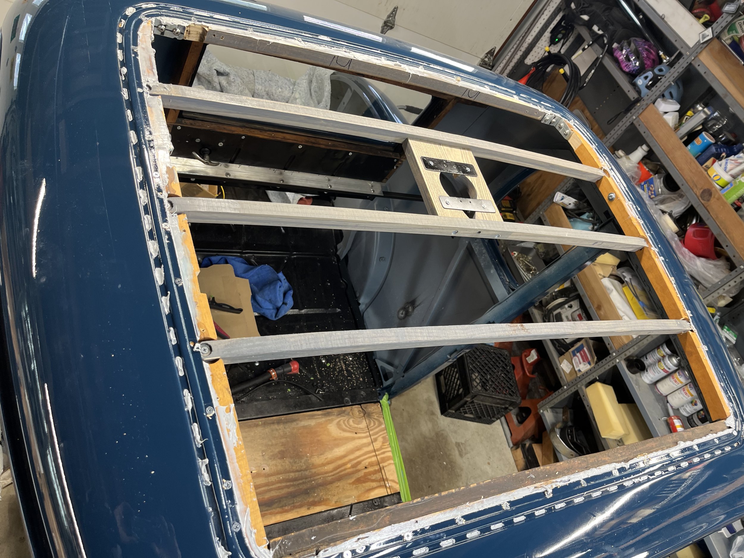

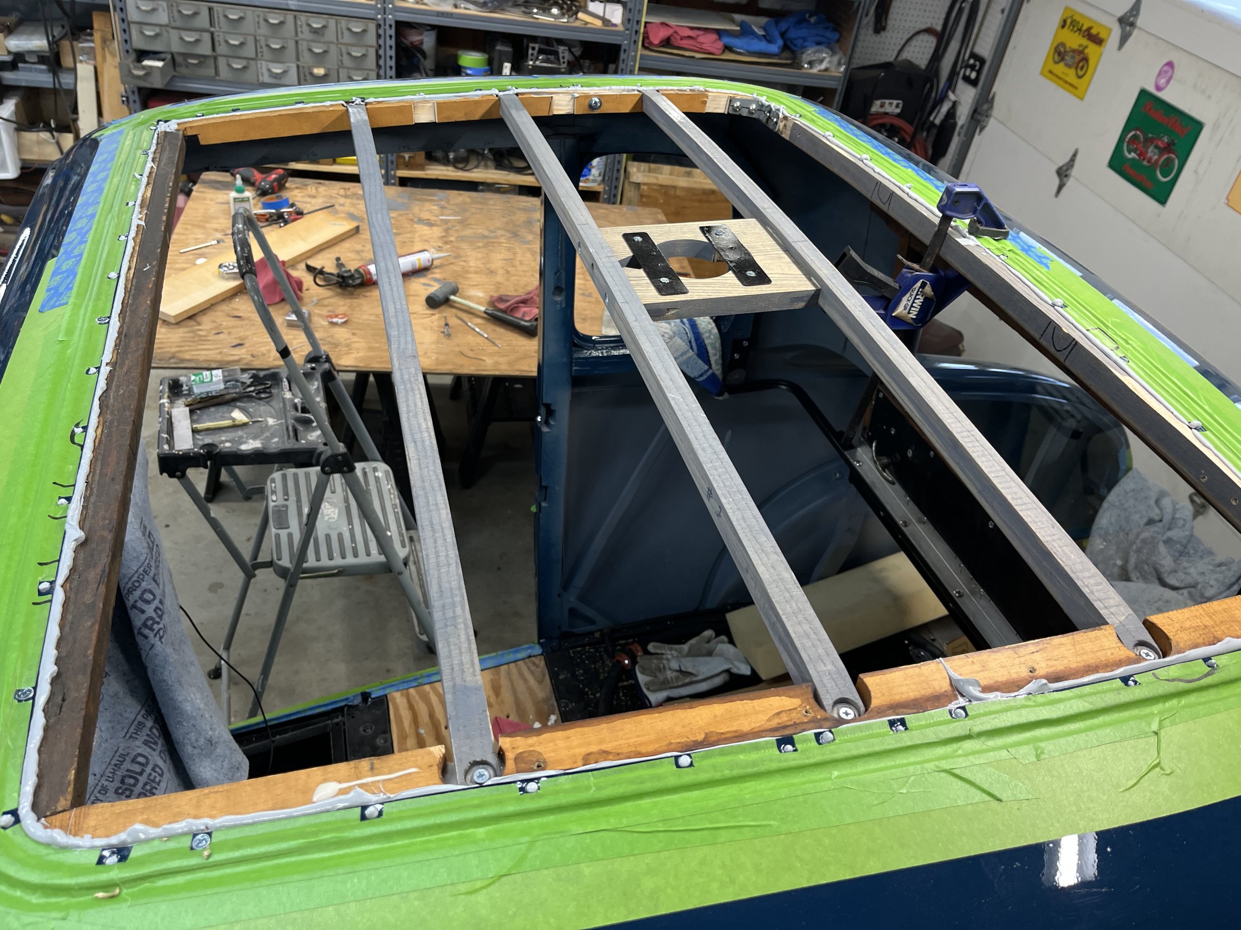

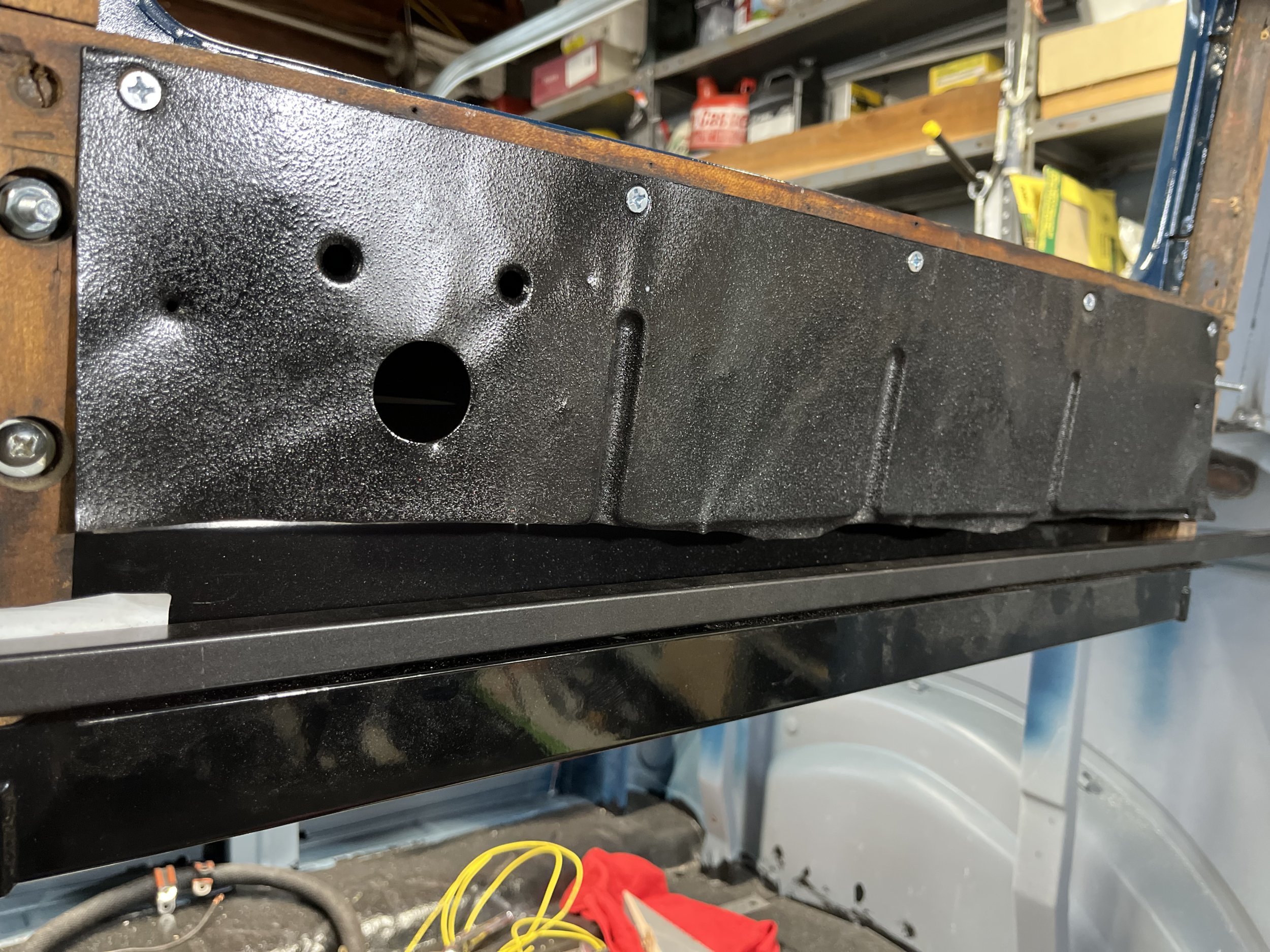

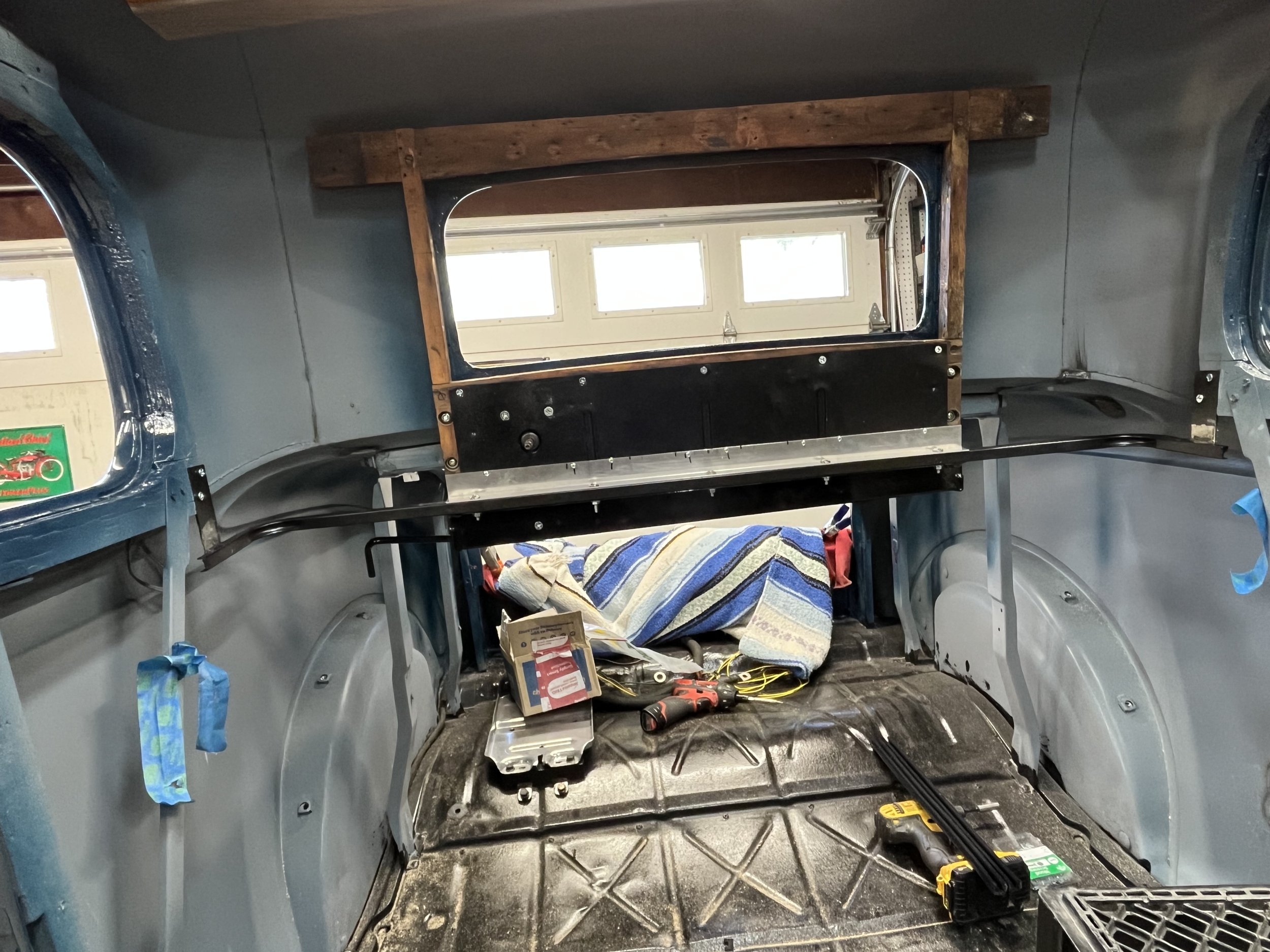

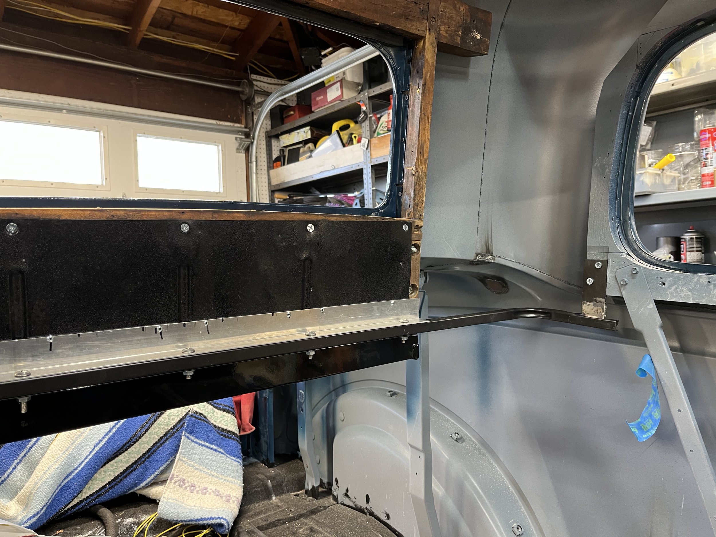

    3m sealant…….what could go wrong……. IMG_7449.jpeg IMG_7455.jpeg IMG_7452.jpeg IMG_7453.jpeg IMG_7460.jpeg IMG_7454.jpeg IMG_7461.jpeg

    I’ll clean this mess tomorrow after that goo sets up

    The price of some of those tubes makes you want to just go for it, but it's one of those things where practice makes perfect. Cutting the tip just right, moving the tip while squeezing the handle, it's a skill. If the stuff is big bucks, buy a cheap counterpart and write your name a few times to get the hang of it.
    Those plastic s****ers are going to be the tool of choice to get things cleaned off if it doesn't peel well.

    Why didn't you tool the sealer before it set up?

    It’s actually easier to tidy it up after it sets

    I actually applied the sealant to the wood frame to act as a”gasket “ to seal the wood to the roof. Any sealant on the inboard side of the frame will be covered by the steel insert. I’ll get the blobs cleaned up and start to fit the steel roof insert which will be covered to appear stock.

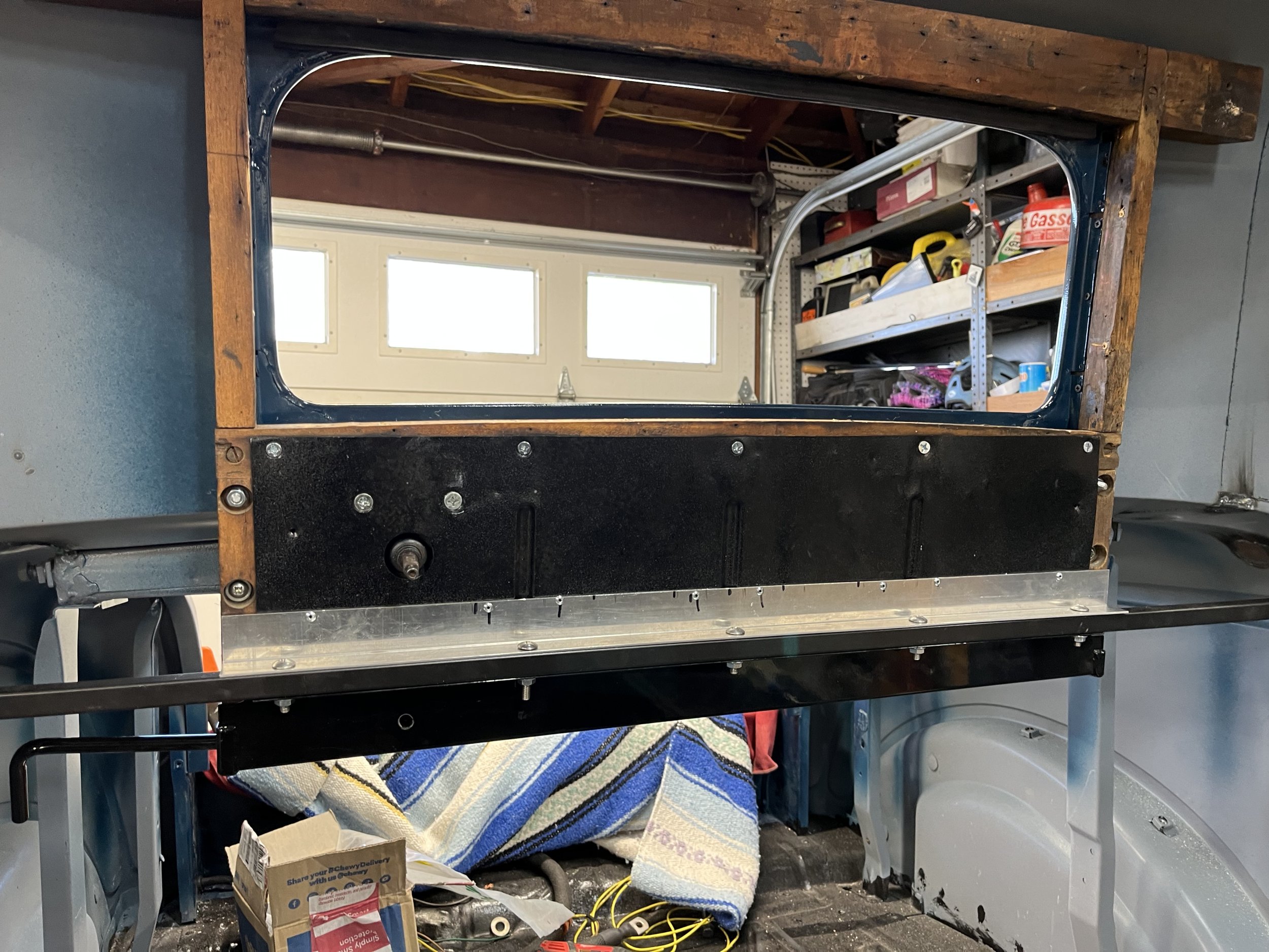

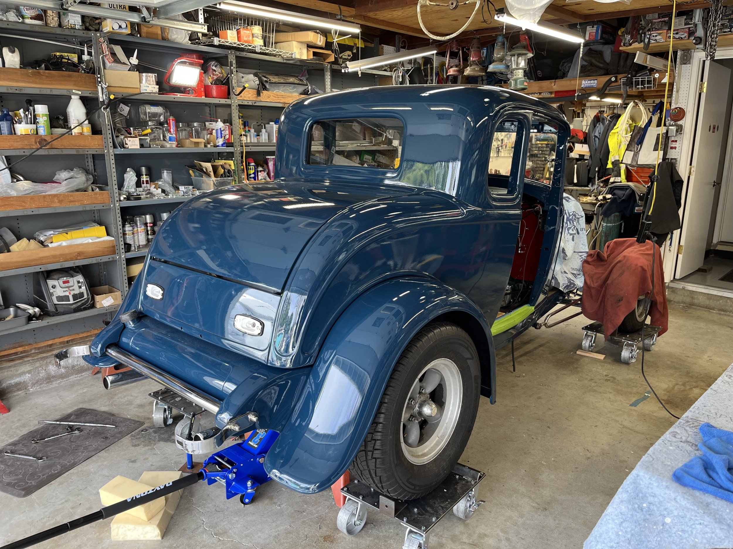

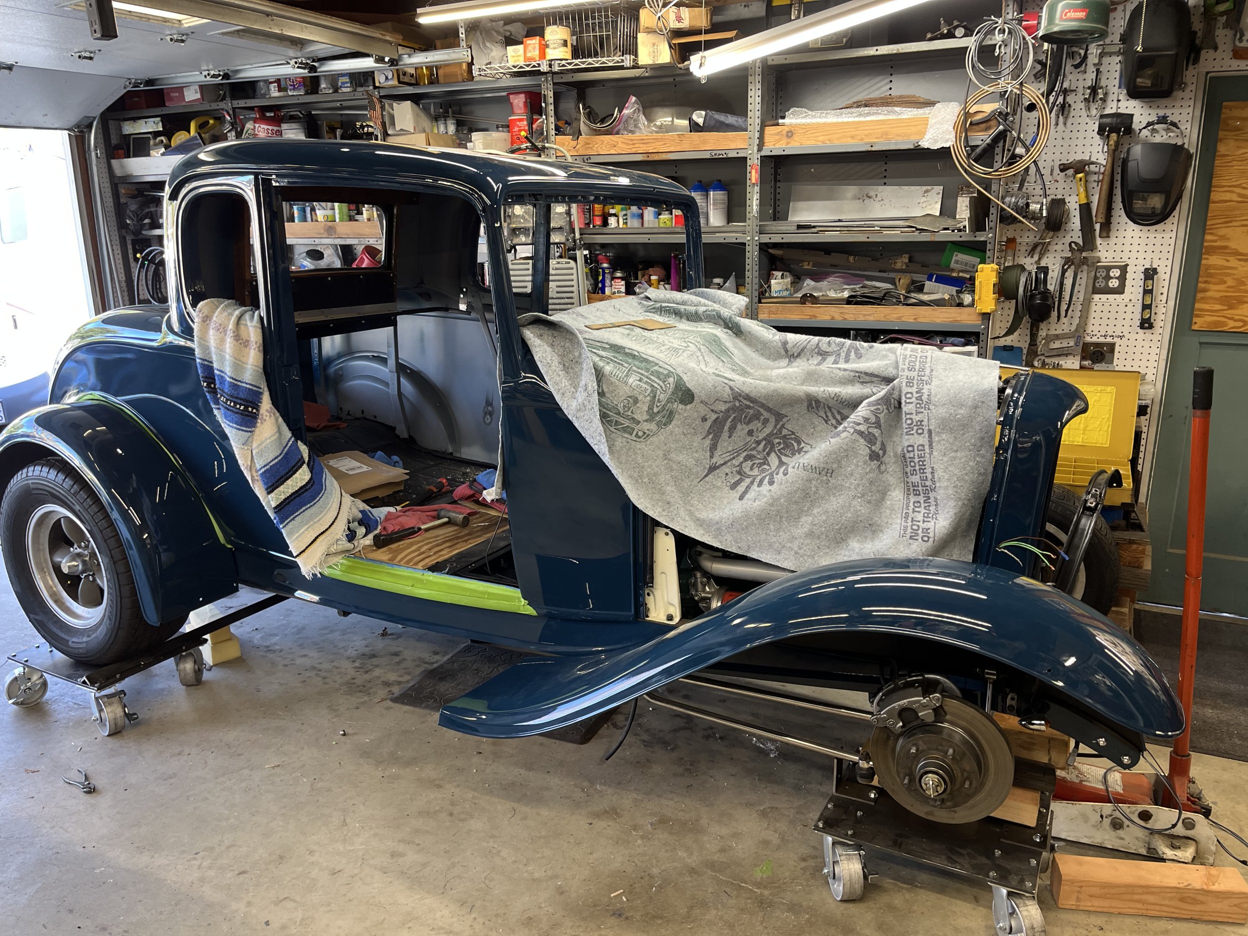

    IMG_7468.jpeg Testing fender fit and measured for new wheels IMG_7469.jpeg IMG_7467.jpeg

    Love it with the fenders back on! What kind of wheels are you planning on?

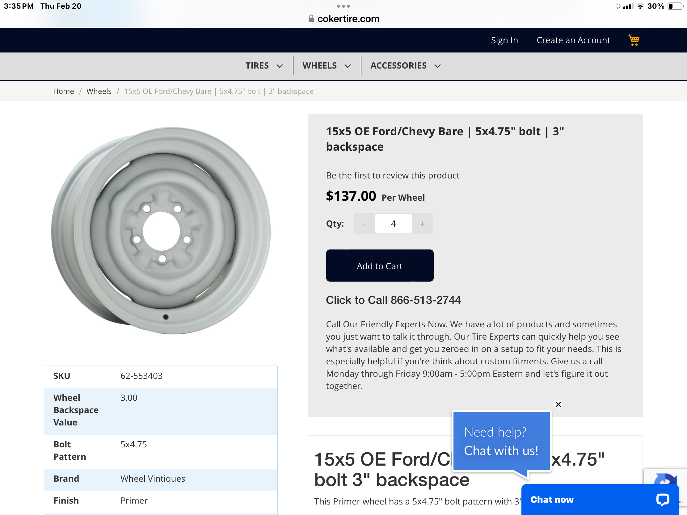

    These, not sure on finish. Have quote inquiries out for chrome plating. IMG_8014.png IMG_8013.png

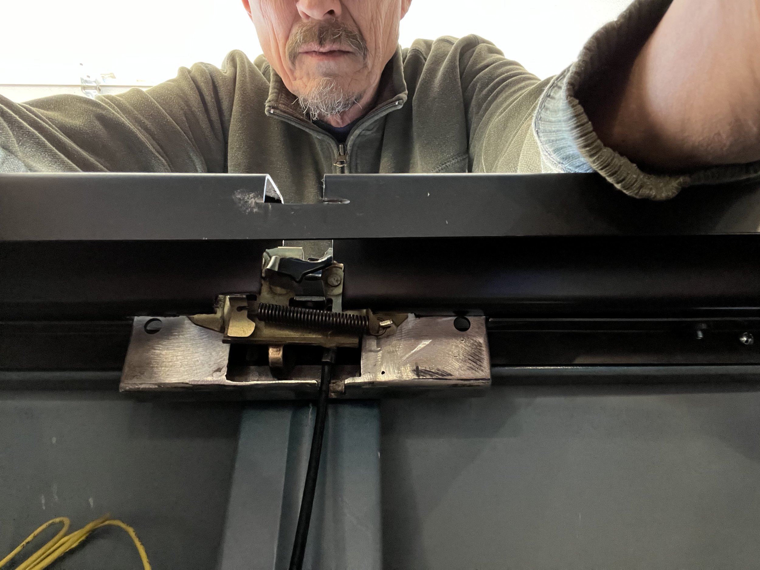

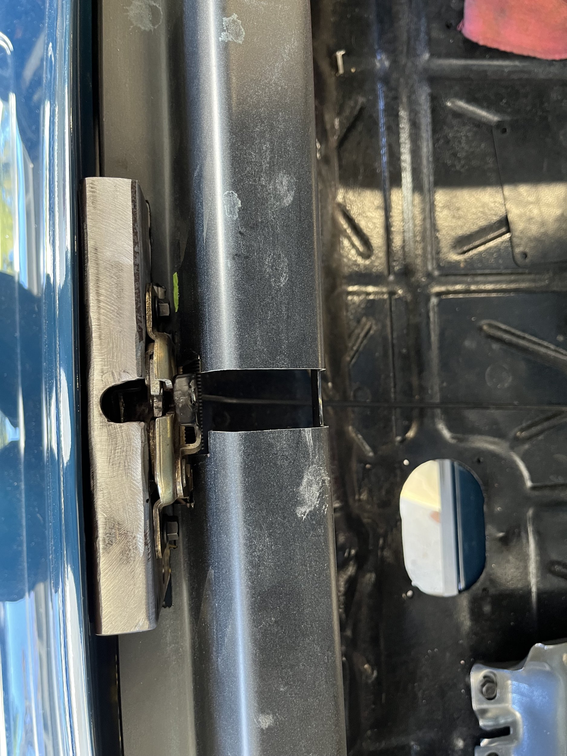

    Got the deck lid on and latch installed. Look ma, no handle. I got a pick your nose (part) with a built in popper. Cable release IMG_7474.jpeg IMG_7485.jpeg IMG_7482.jpeg IMG_7483.jpeg IMG_7486.jpeg IMG_7473.jpeg IMG_7484.jpeg

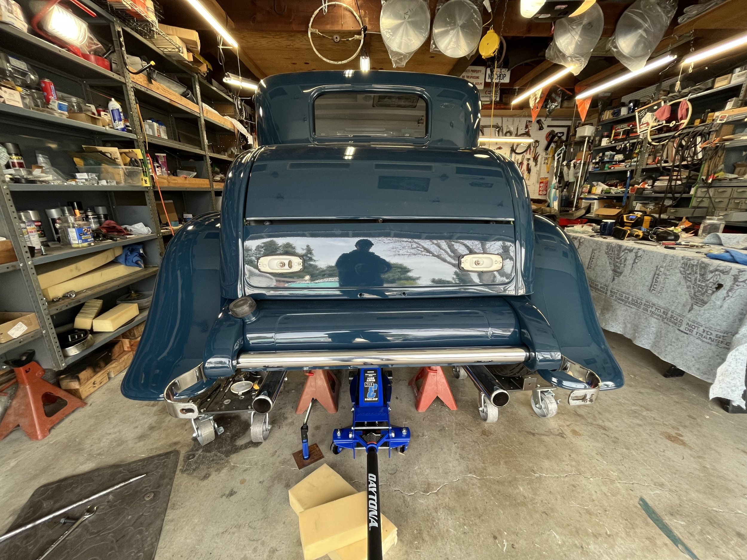

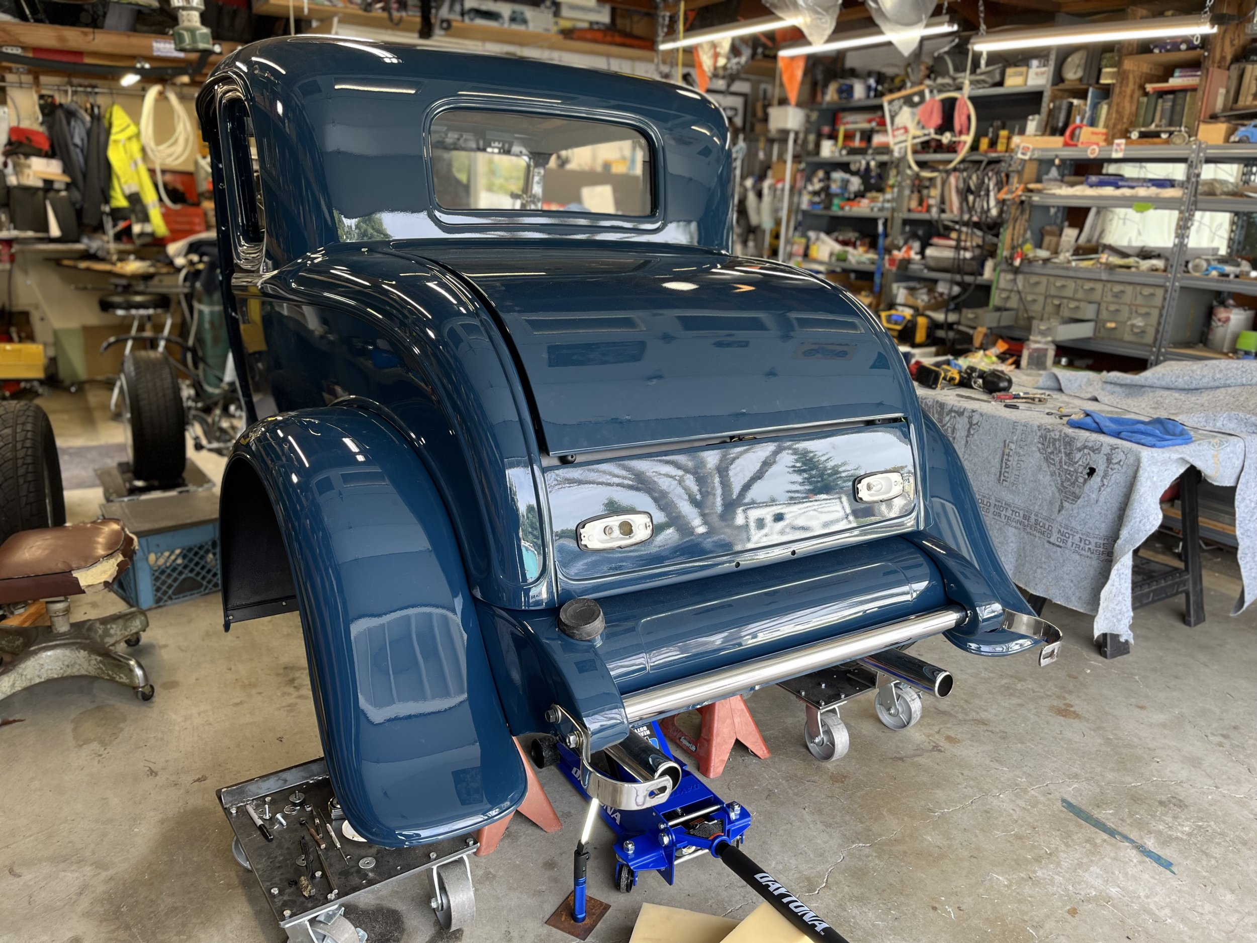

    The body paint hasn't been cut a buffed yet. It goes in after final ***embly

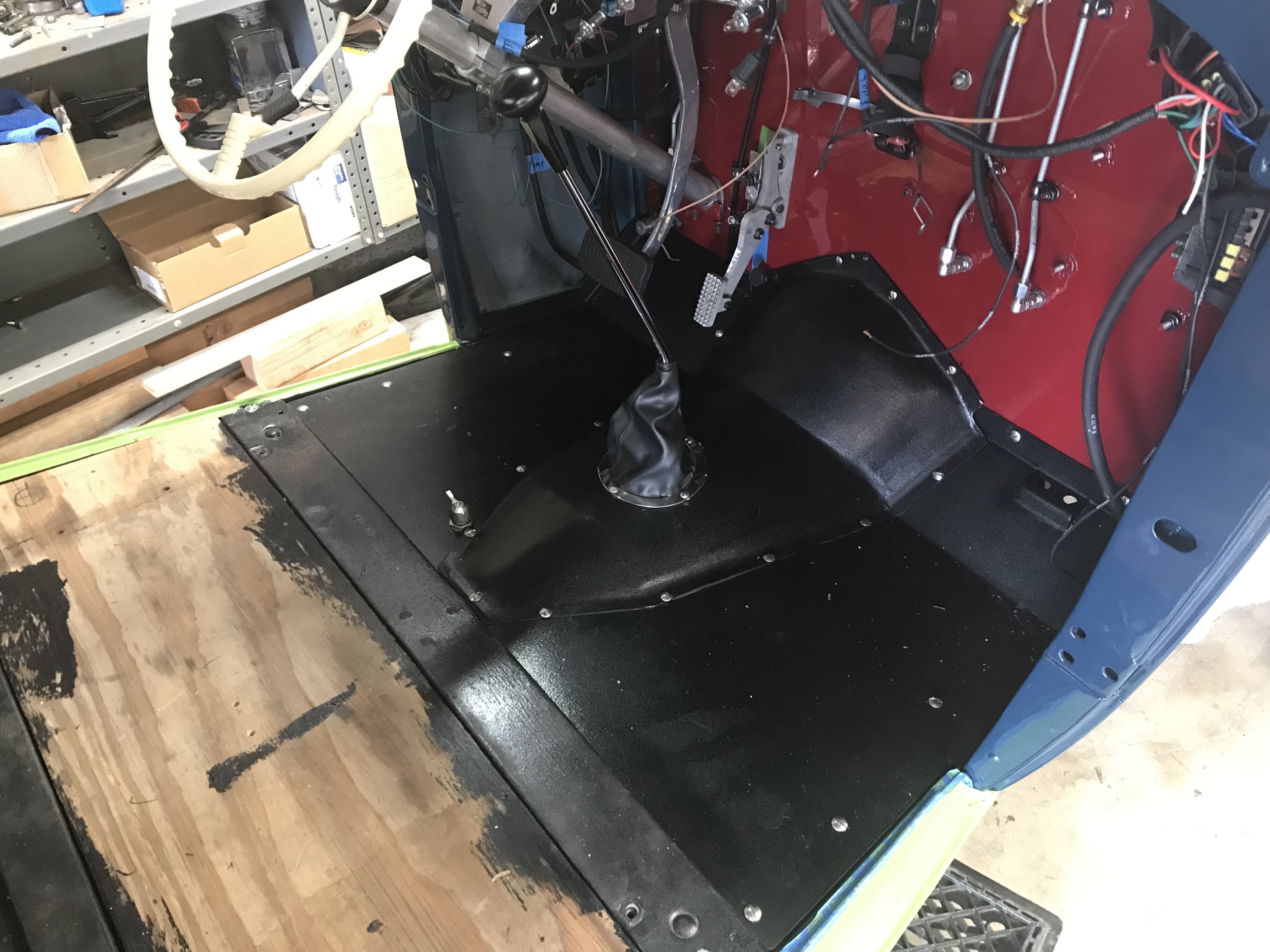

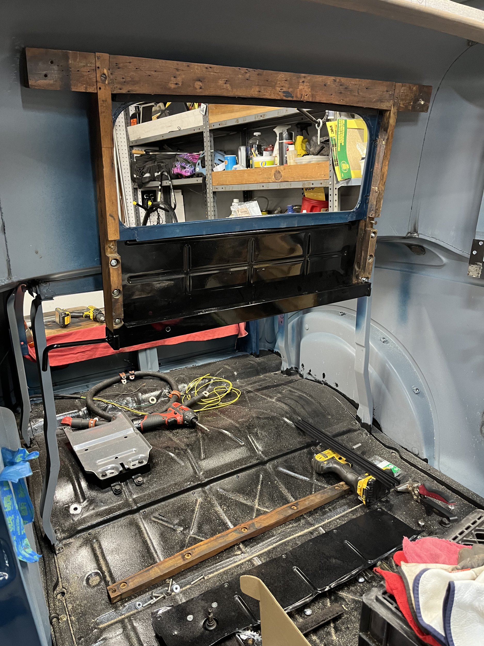

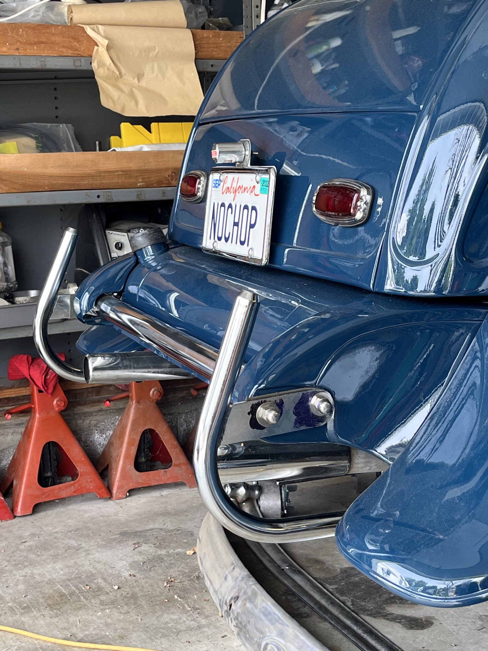

    Floor is sealed, I hope I don’t have to get back in. Plywood will get replaced with oak. IMG_8085.jpeg
