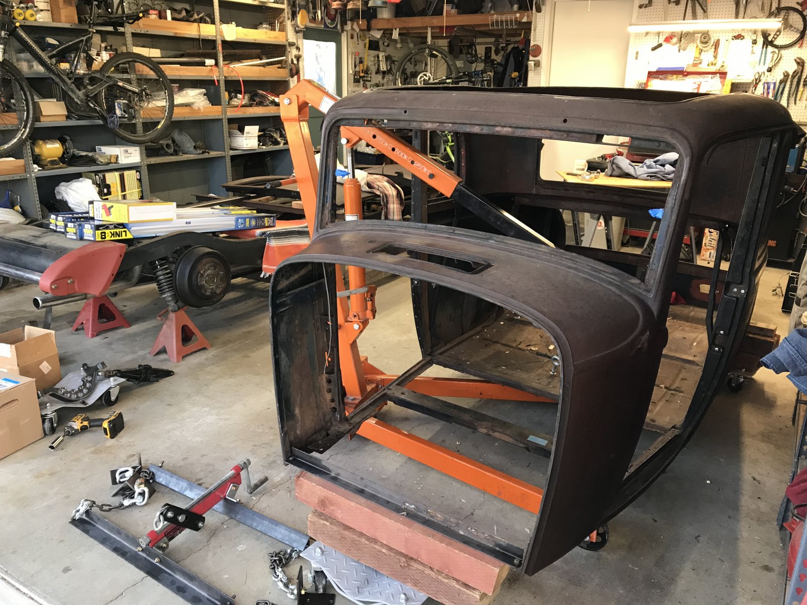

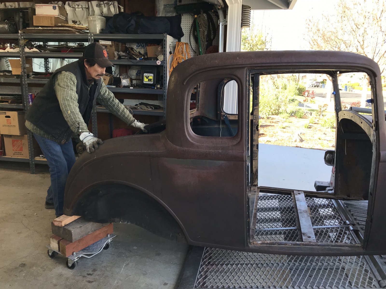

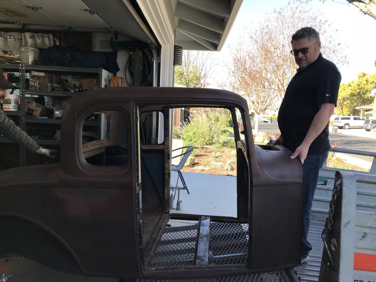

    Off to the stripper…oh la la, boom chica boom. My good friend from the Relics C.C. (Cabbie) came by to help me gut and load the body and doors. Stay tuned folks….. EE5CBCED-12CA-4700-8770-1003566C2707.jpeg 47DC8276-8362-408C-AA28-DE14C0F5CFA3.jpeg BB581086-F4F3-4AB1-AD0A-1398A1874AA2.jpeg 93F229B3-0A29-4673-A18D-1BD747C33520.jpeg 7926B24A-9640-451C-992E-B6887DB2824C.jpeg 95A9F123-963B-427F-B073-96833D787990.jpeg F9CF40AF-3CD1-421A-9268-50FE98941B8C.jpeg

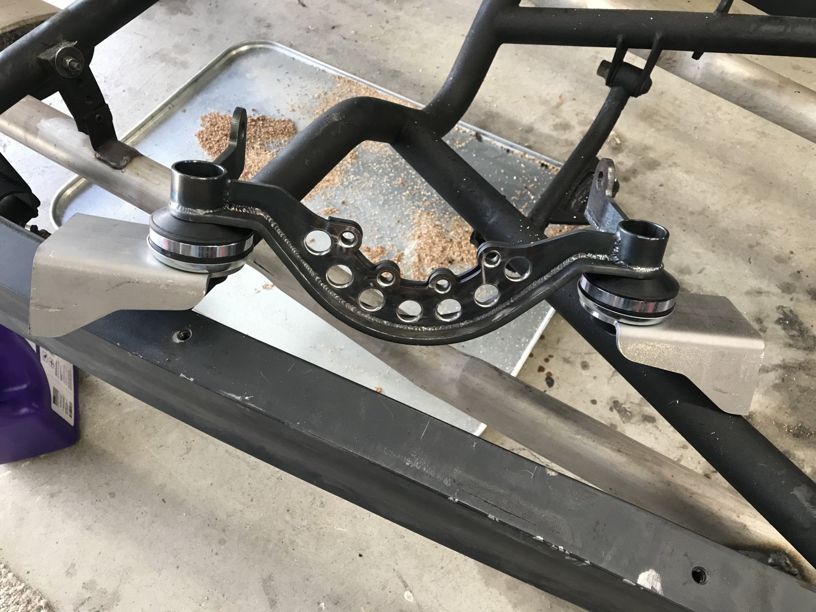

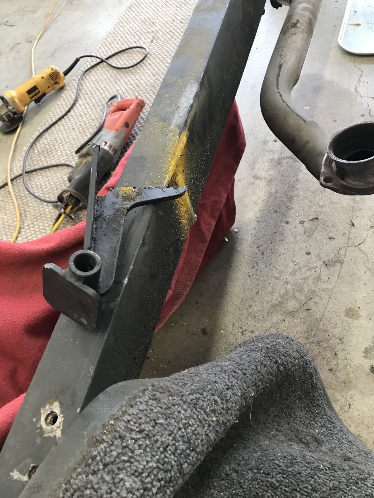

    Nothing says commitment like cutting out the sbc motor mounts B9525BD4-76A3-4BC7-8DAB-F195142EB2B7.jpeg 43FD1134-3DDD-4862-B0D2-2867DFB22B0F.jpeg CCEDEFB2-54C7-4967-A83E-BD50DD3A193C.jpeg

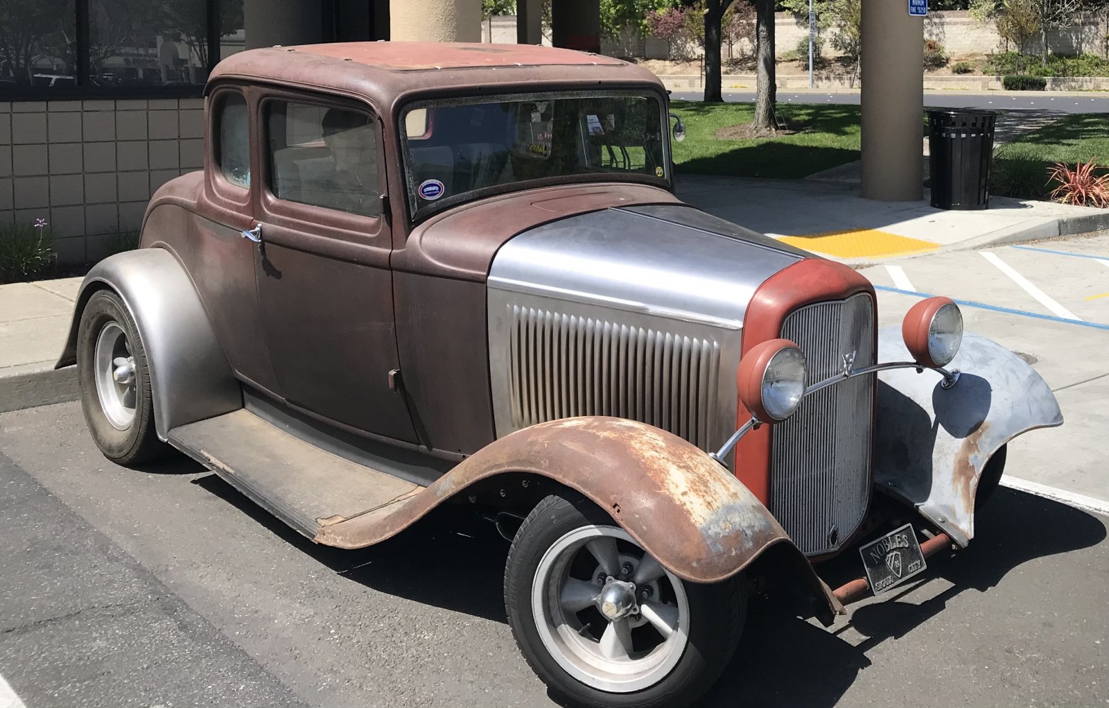

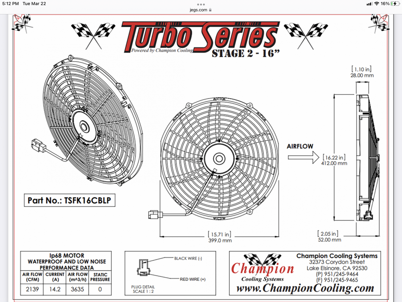

    I ordered this from Jeggs, they subs***uted a different (there house brand) fan. Over 3 inches thick and way less CFMs. Called Champion Cooling got a live person on the third ring. Item is on back order but should be in on the 1st. of April. A0707347-769F-4316-BEBF-13250CEDE1AC.png

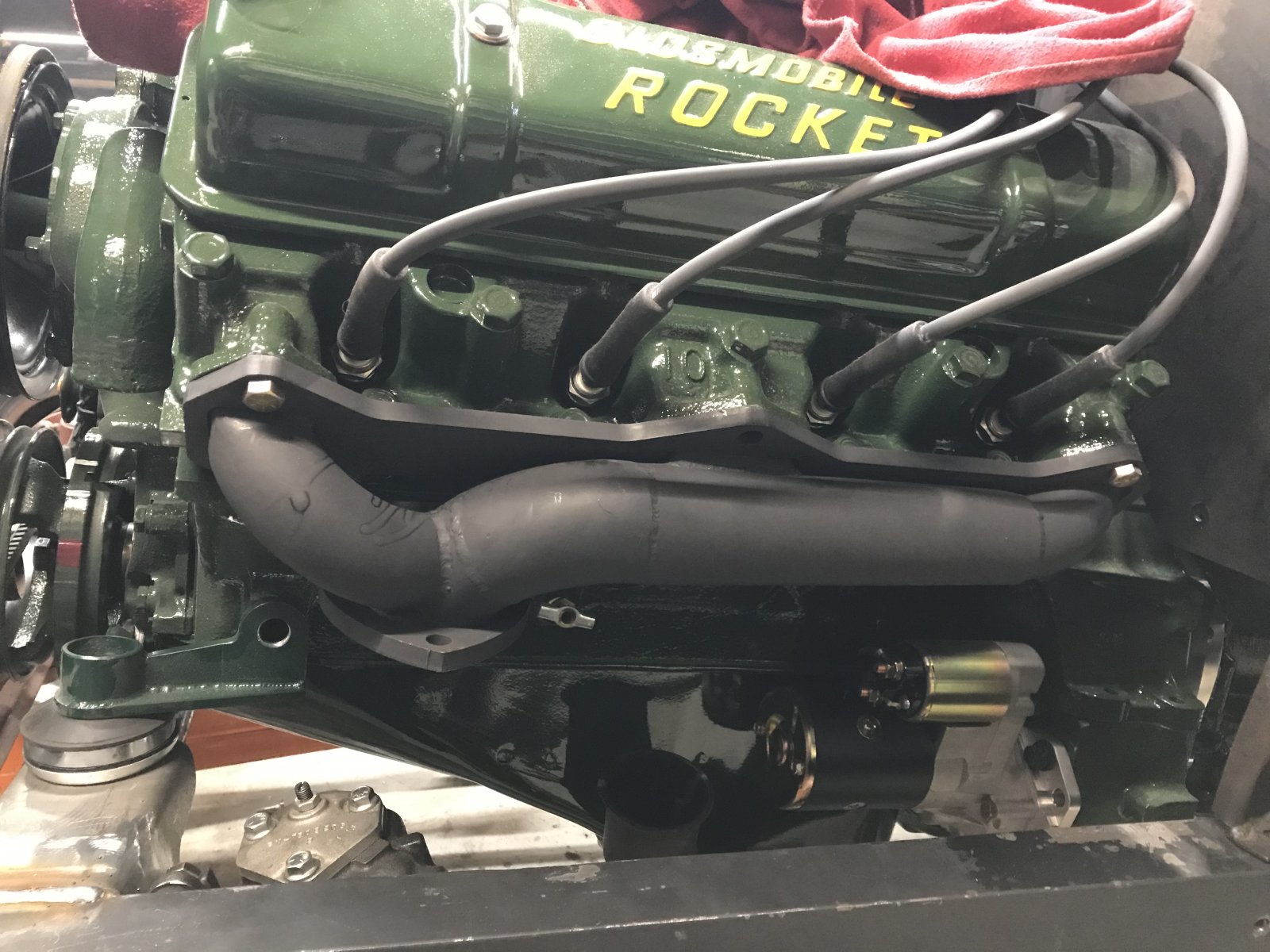

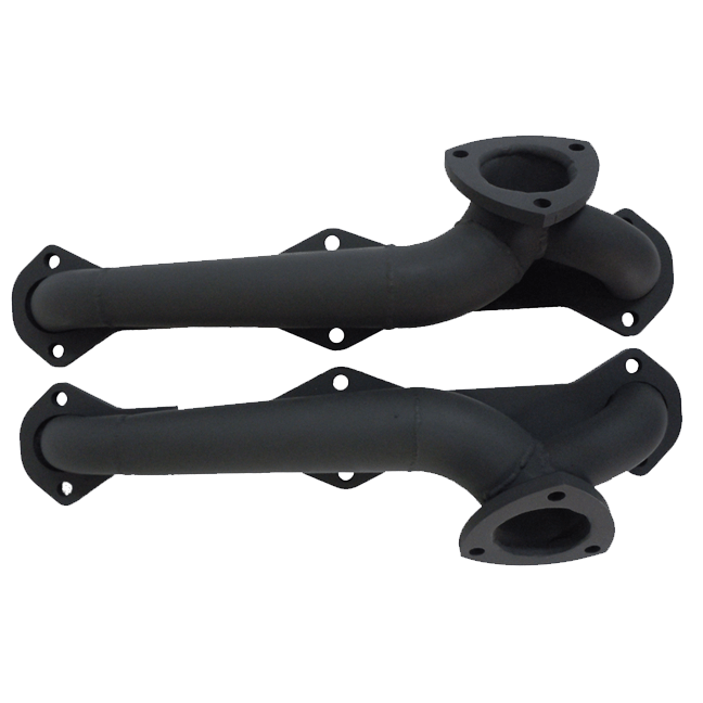

    I have those headers on my 324. Well built, so far so good.

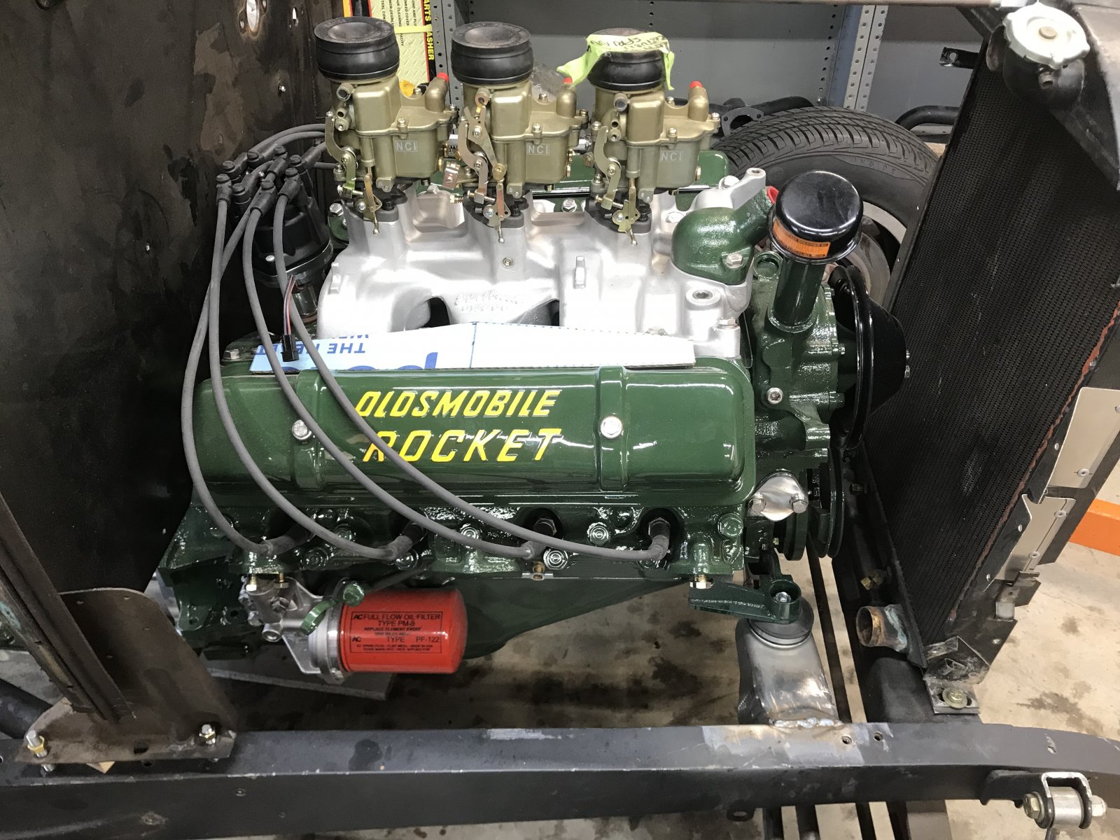

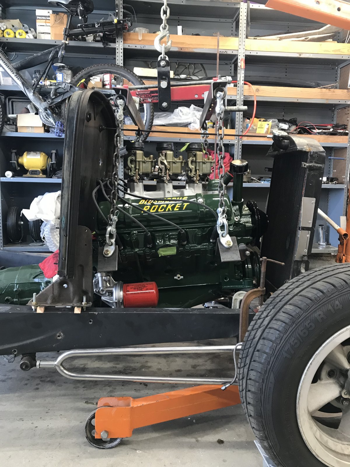

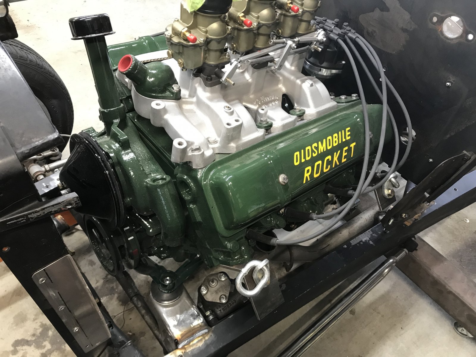

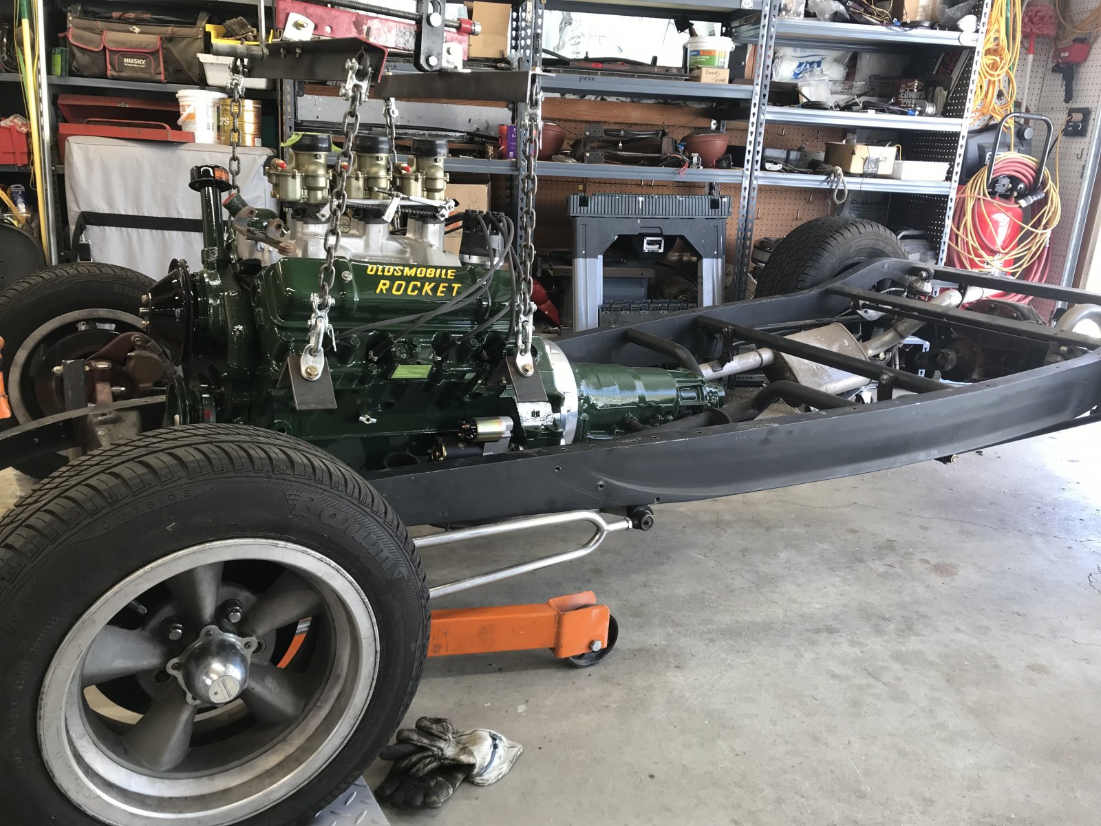

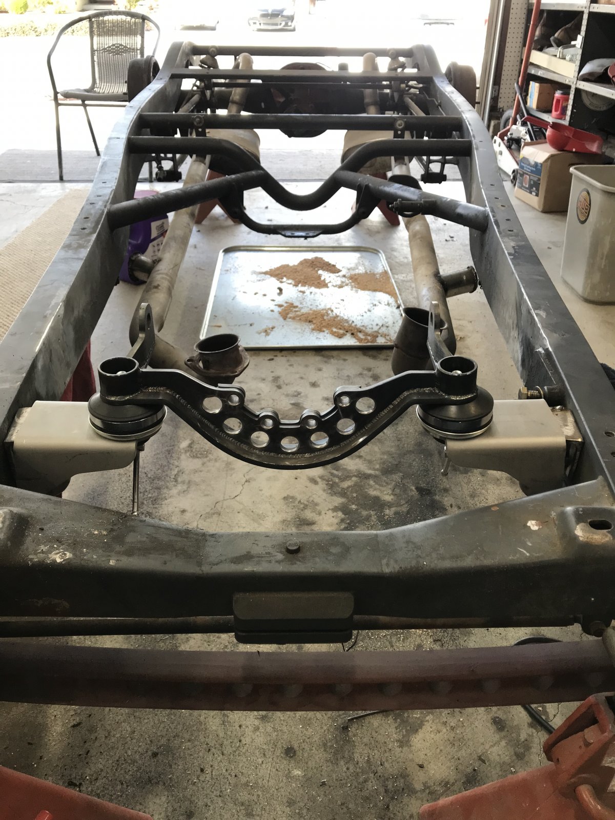

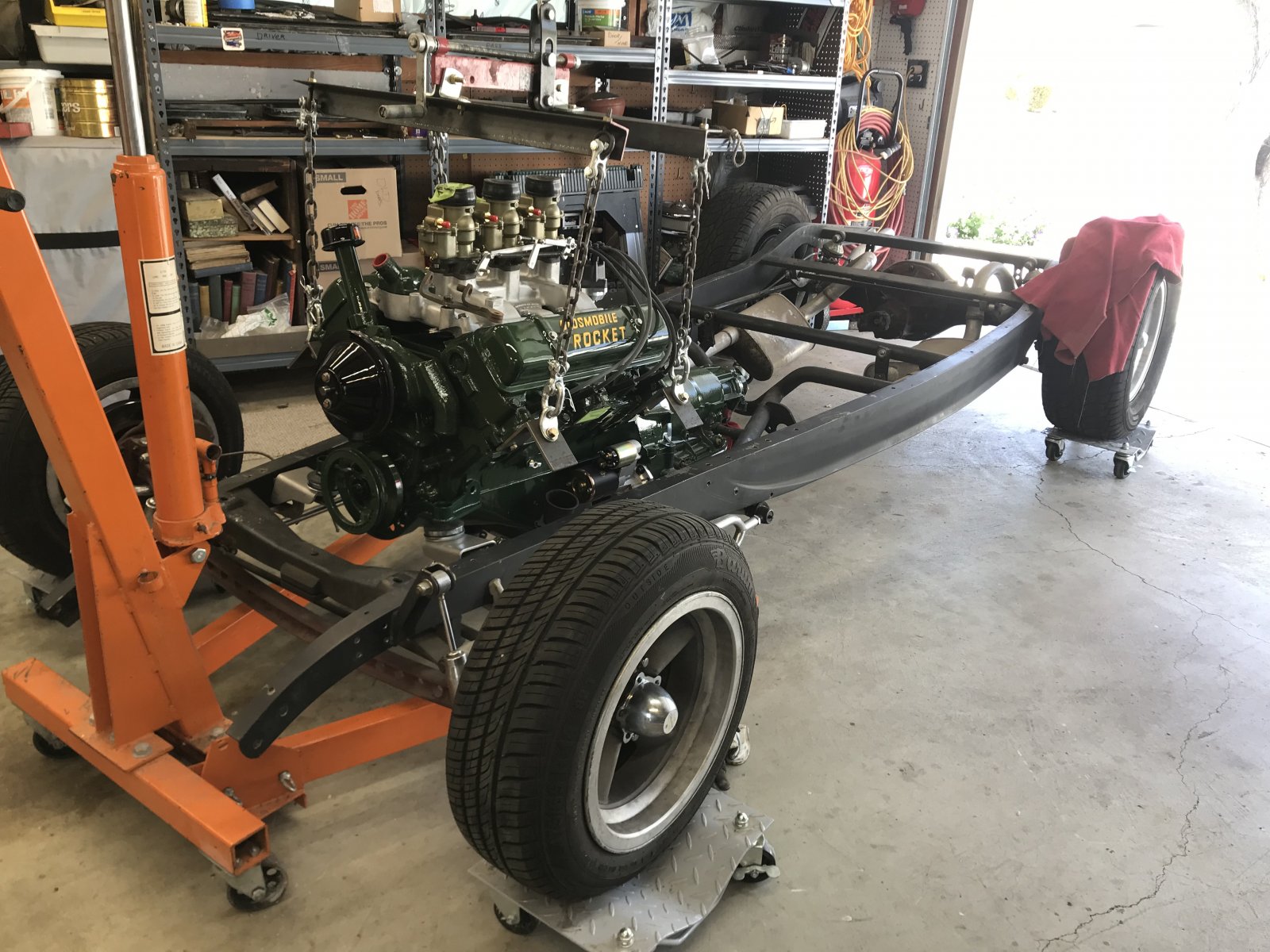

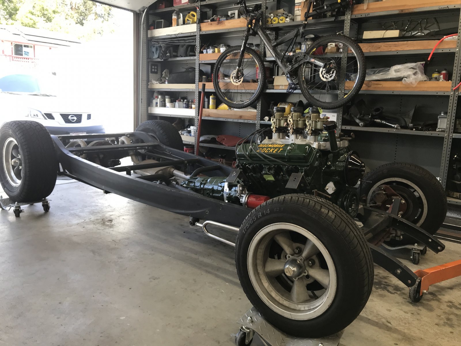

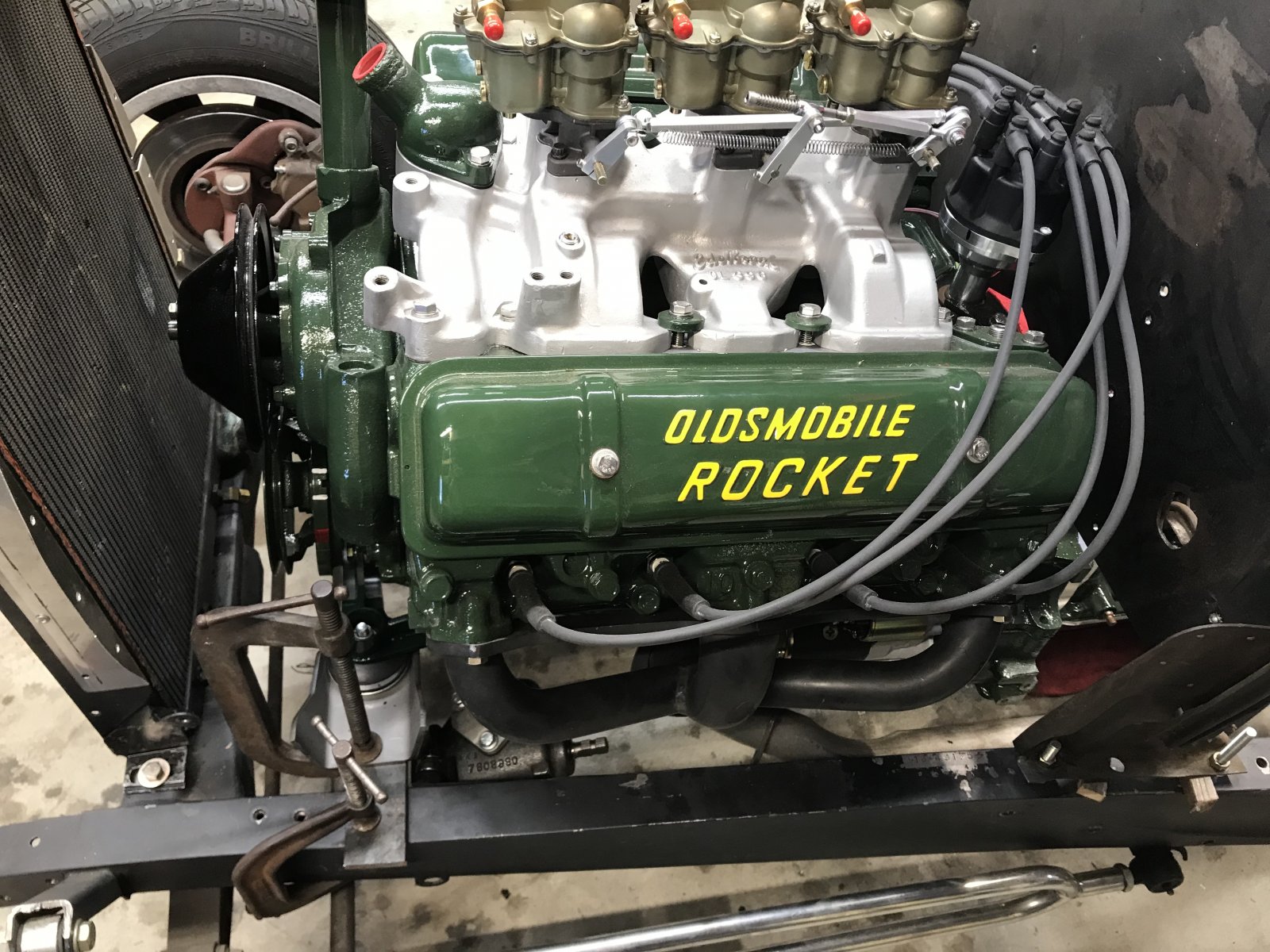

    Got the Rocket welded in, no going back now 2DC06CA0-9FA3-48AF-8CCD-304BA2BF1988.jpeg 3B5619C0-829A-451C-93FC-56D9163568A8.jpeg

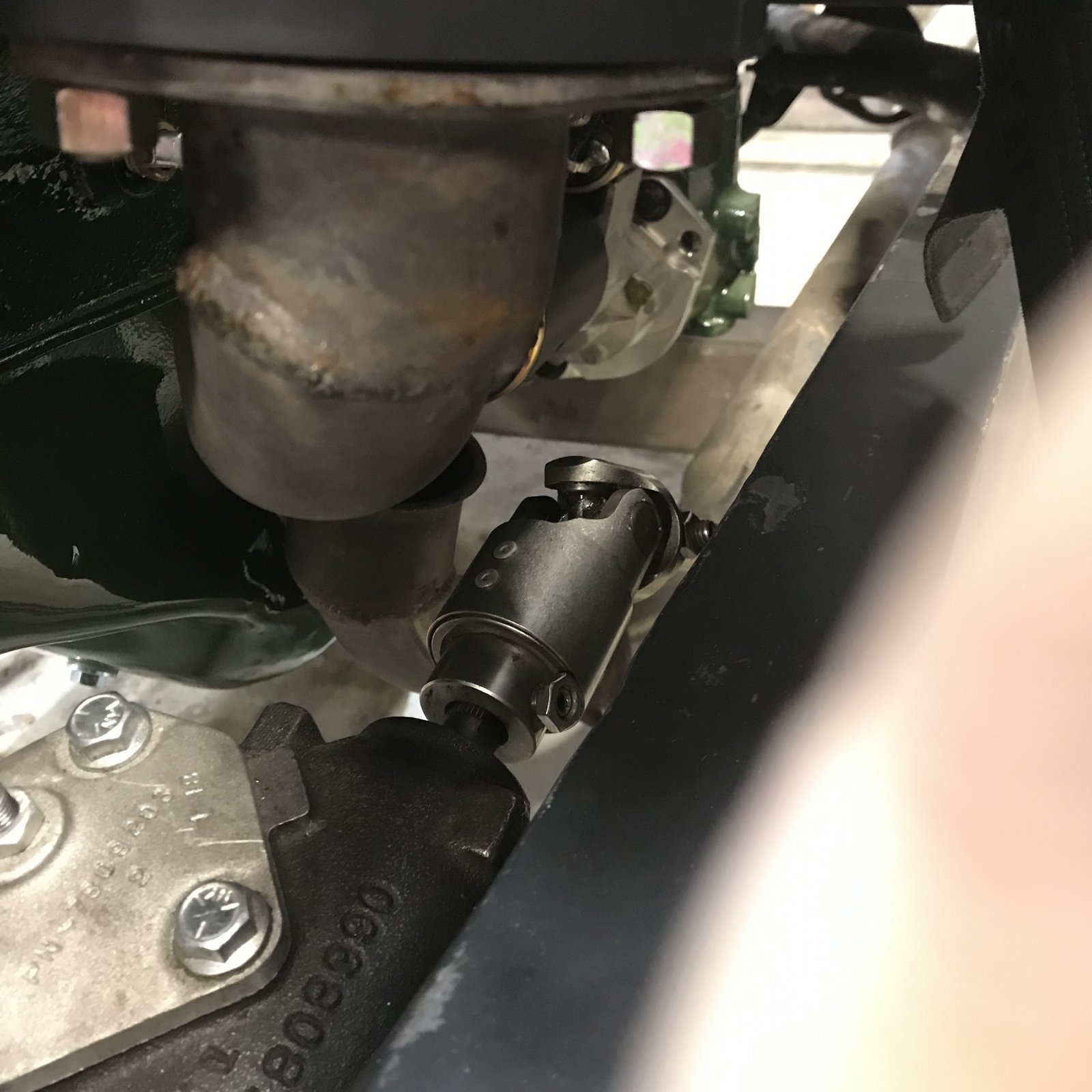

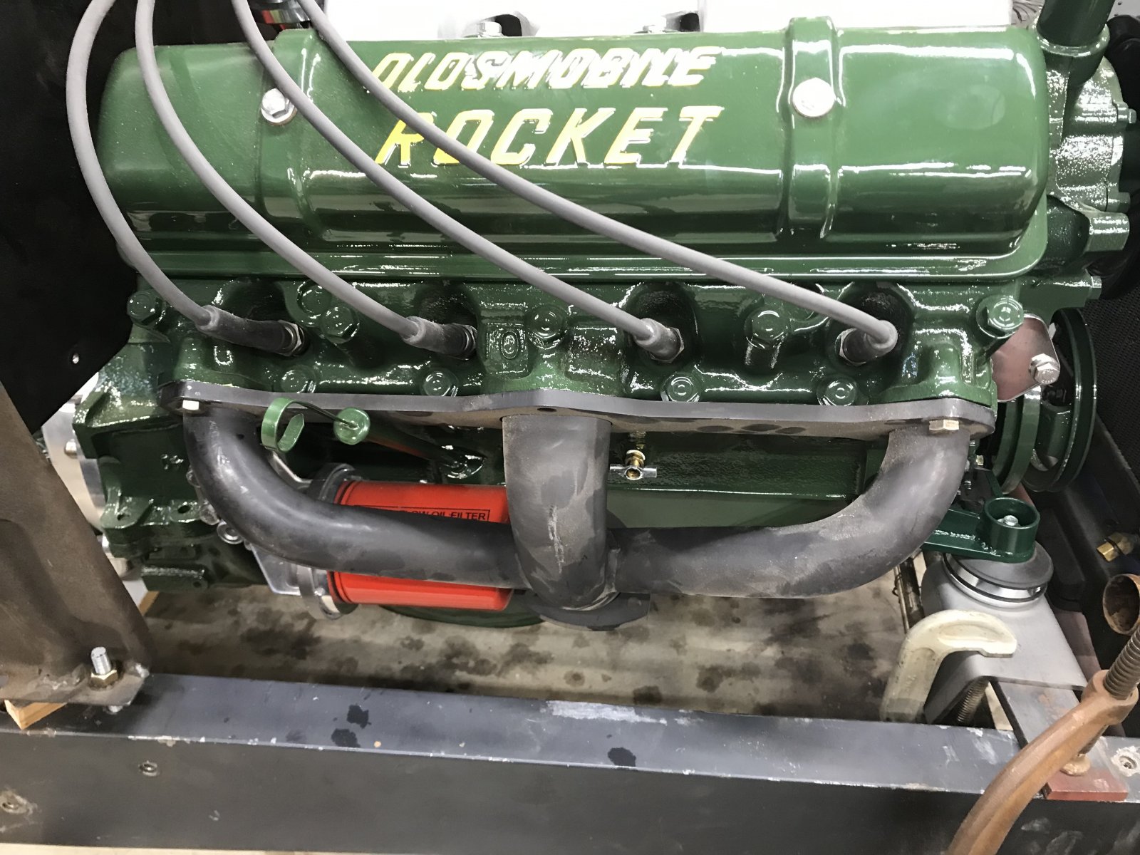

    Got my headers today, back to it….and sent the driveshaft in for a trim FE768FFC-8BE4-4F9B-A3AD-A50D7E3F56E0.jpeg E5DE435D-09C5-47A2-A93D-9B17E3866311.jpeg

  25. nochop
    Joined: Nov 13, 2005
    Posts: 4,730
    nochop
    from norcal

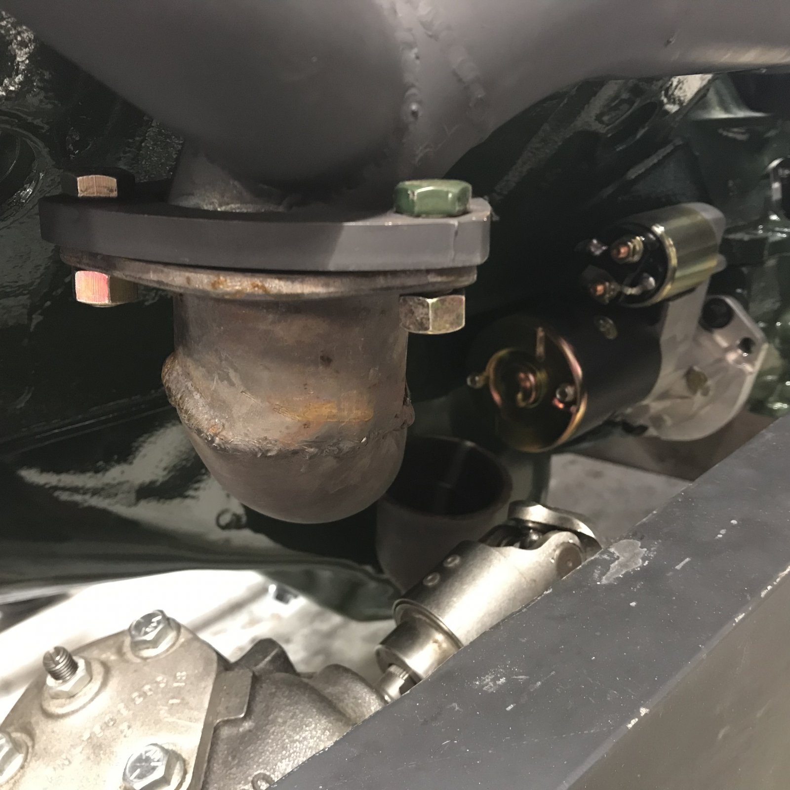

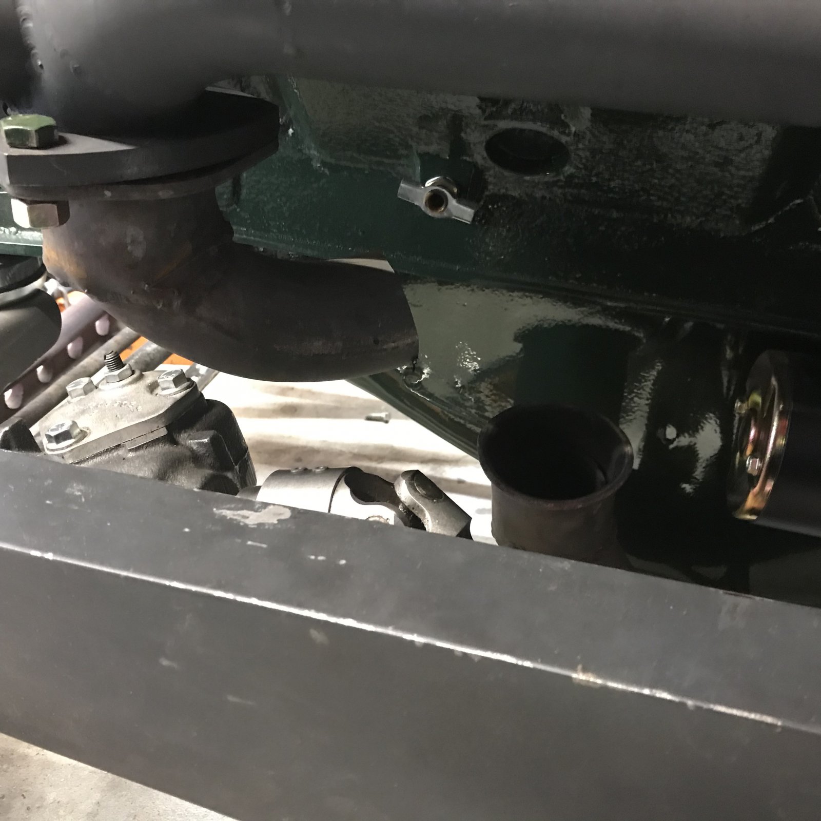

    Not bad in reality , I stuck a piece of exhaust on and it looks very doable.
