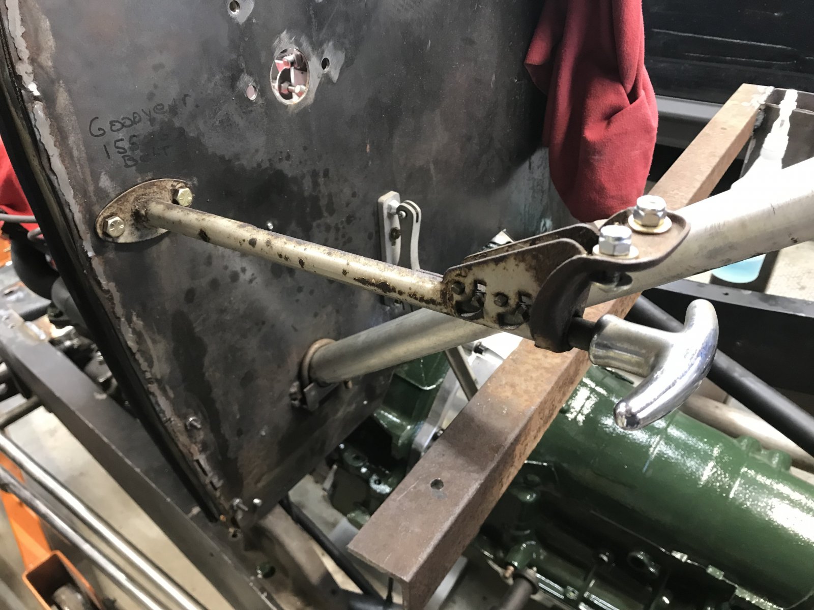

    A little throttle work. 214E45D7-EAD2-4786-BE88-FA54C47459E1.jpeg A4CBD63B-33AC-4859-9D63-7E7DB259F132.jpeg

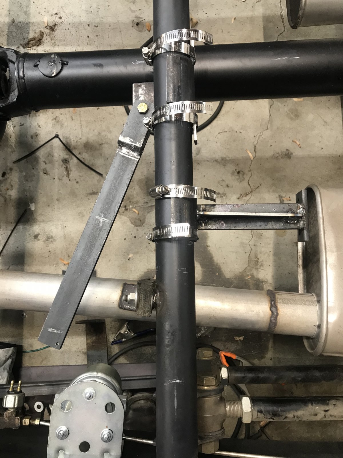

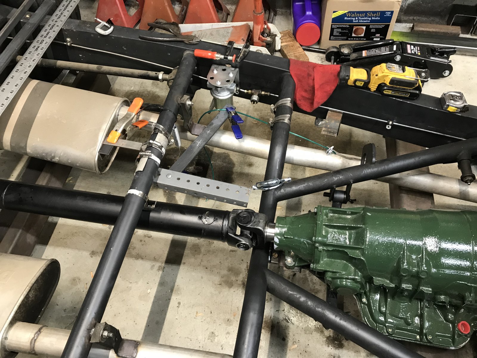

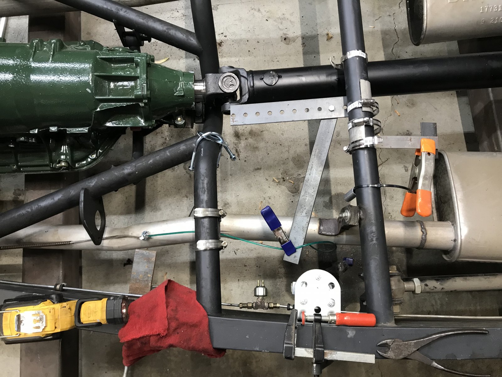

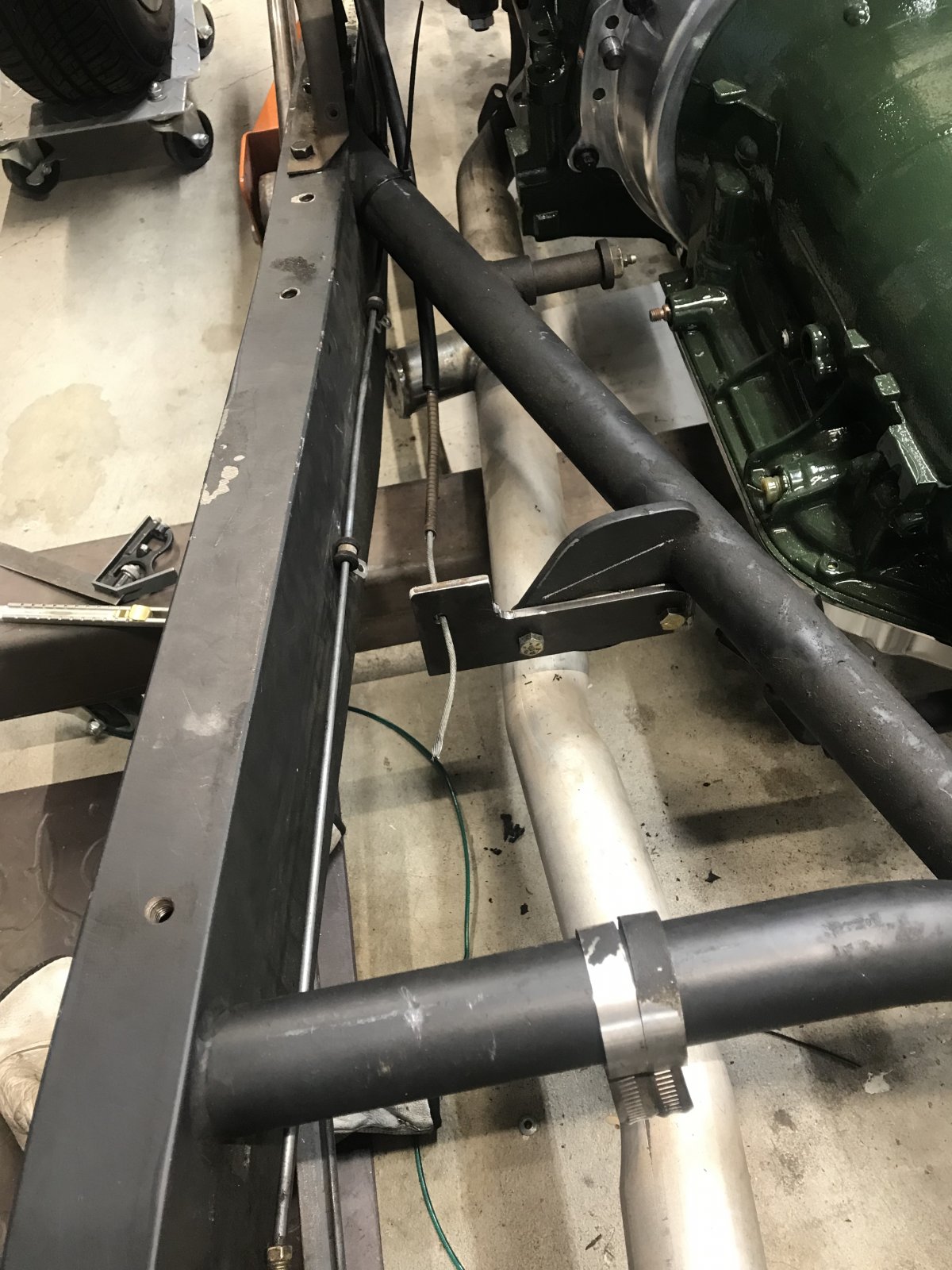

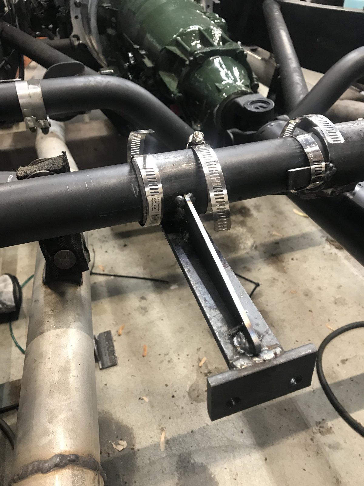

    On to parking brake mock up….note, this is a mock up with leftovers 57DE9626-5962-4472-8525-736917BDCACD.jpeg 23609503-FAD9-4BAC-82FE-ACE4C207EABD.jpeg 5C40A37E-8FA3-42EF-9971-3B7C6747F05B.jpeg

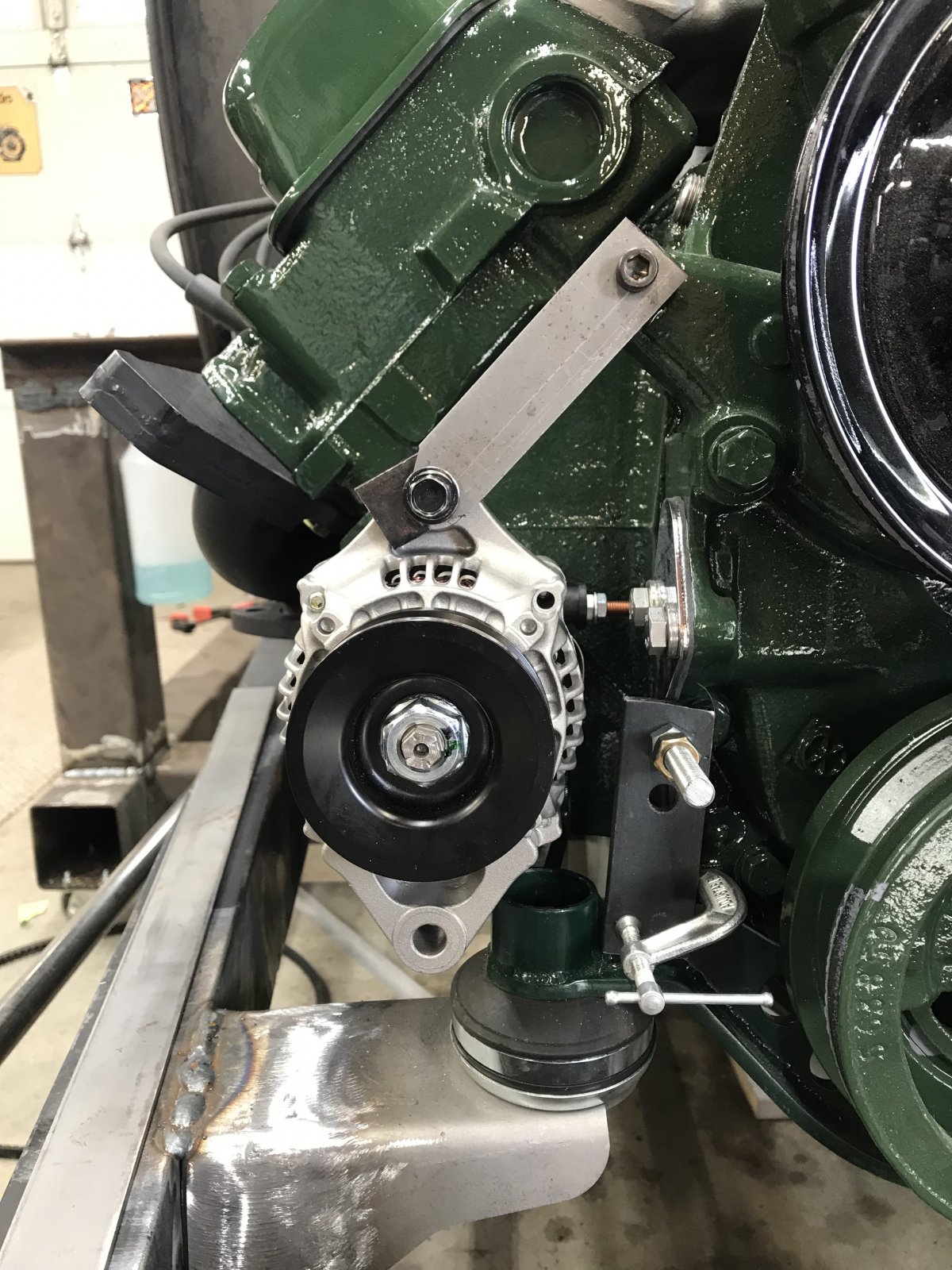

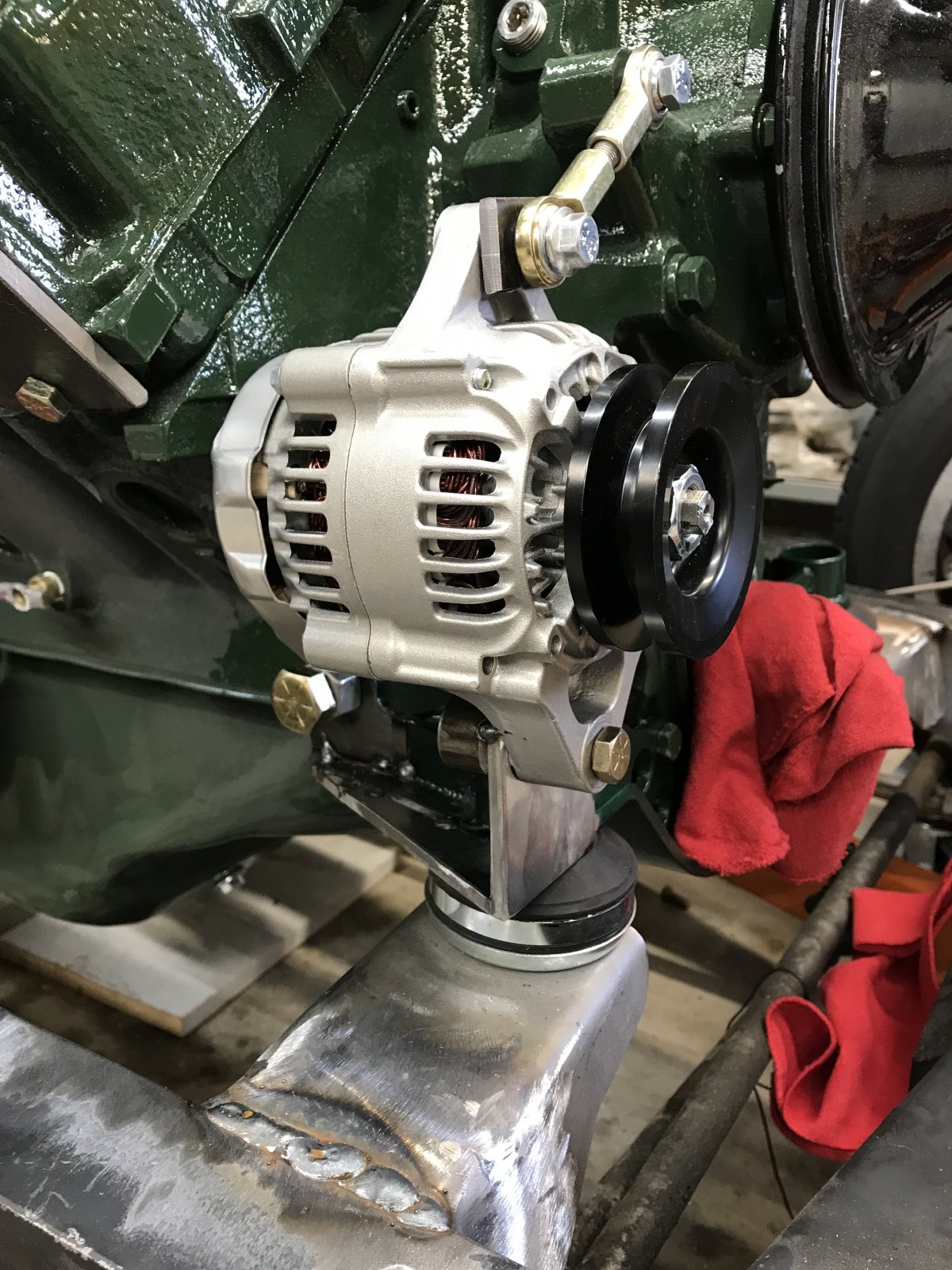

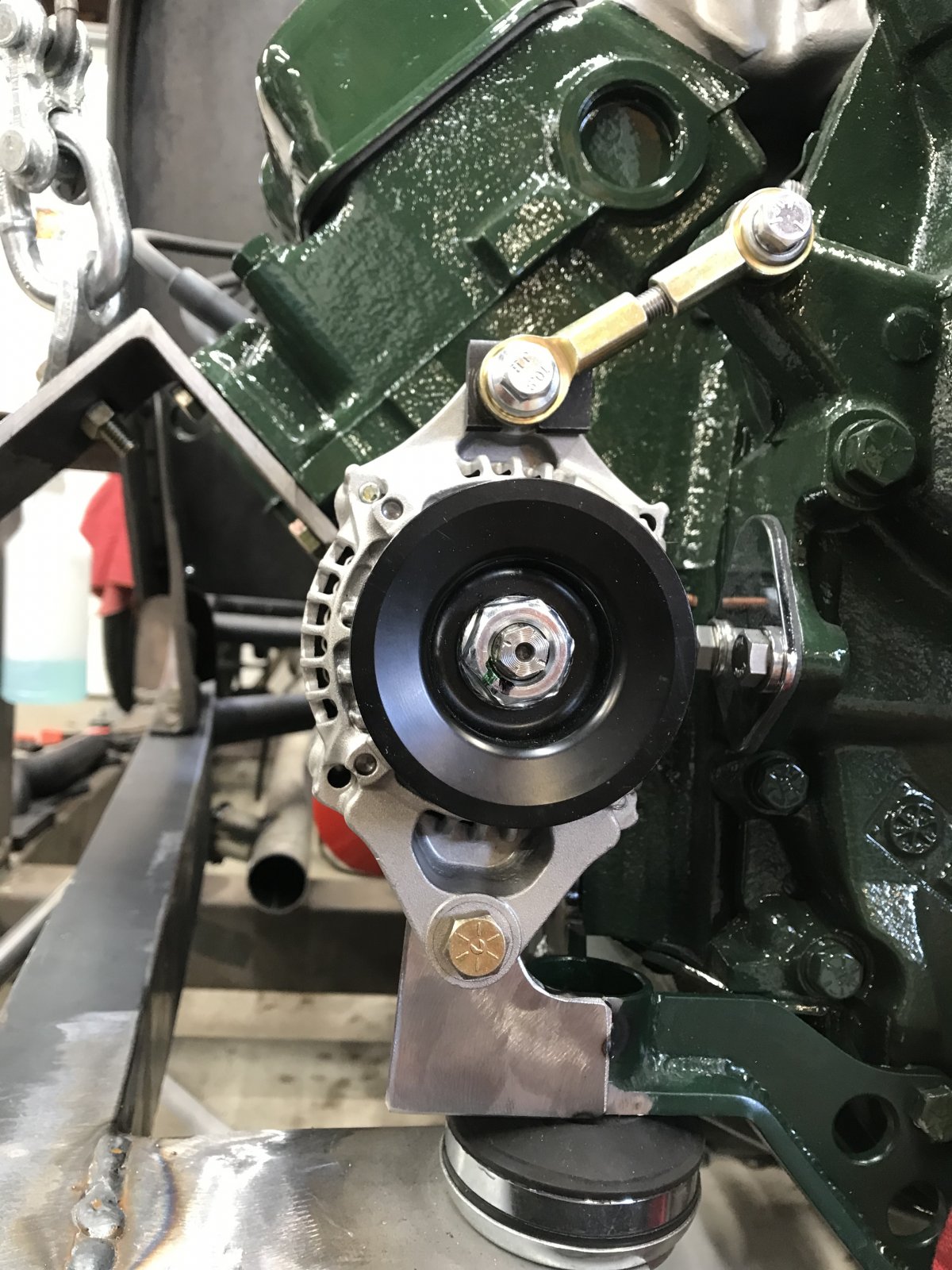

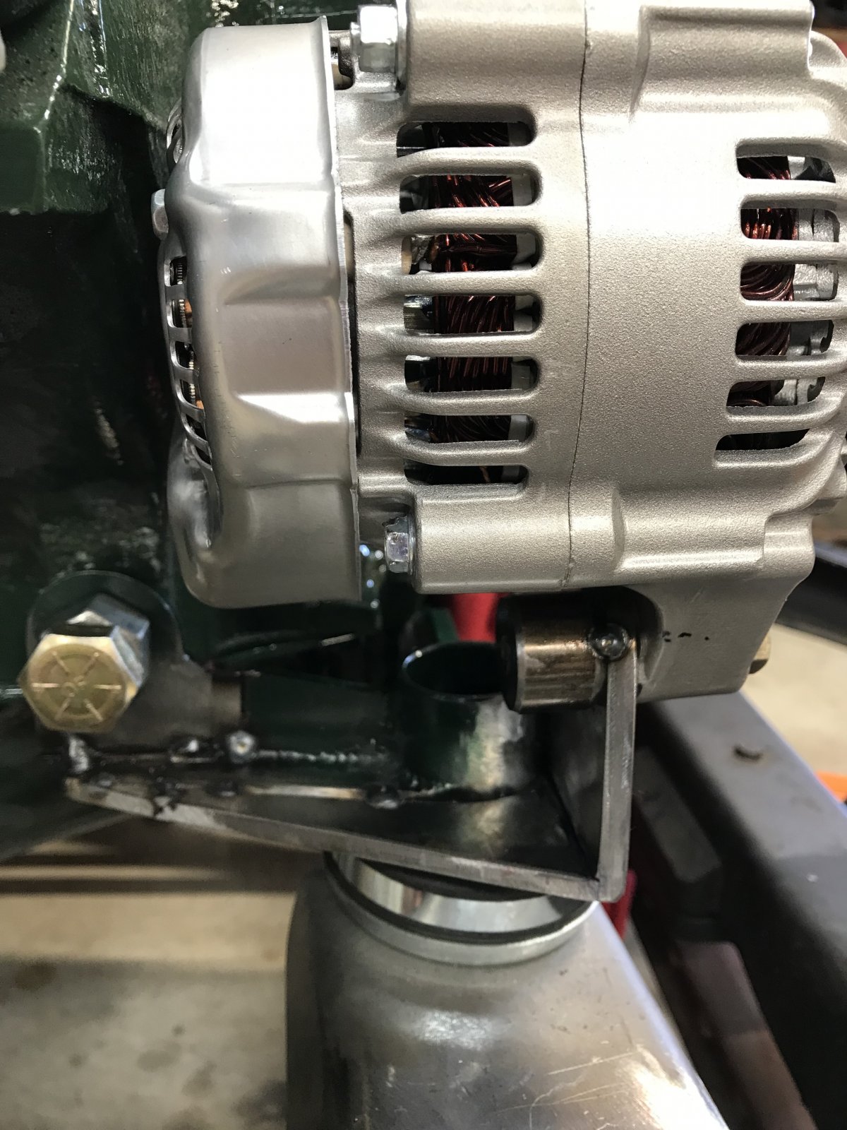

    Got my alternator in….mock up. Not sure if I like it 049E477A-223A-452D-99D6-70D73F51285C.jpeg DF4AE60F-63B1-4AA0-BC47-633F10F88962.jpeg 5687F62E-066C-4C73-913B-BB4A7CBA37A7.jpeg

    Yes, the bracket sticks out like a sore thumb. Why not mount on top of the manifold with a fabbed up bracket like the original Olds piece?

    Yup, not doing it, still working on options

    I love what you're doing here, but that car deserves a generator or a Powergen with the Delco tag added on to it. That alternator looks like it came from an Alien Planet from a far off Galaxy! JMHO ;)

    It did, lol, I want to run a hood on it. Gens look a little crowded so close to the carbs.

    Parking brake apparatus is close enough to order cables, too chicken to weld it. I’ll commit when the cables get here and it works. 7D089373-AC0C-4AC7-8059-26824430AFB0.jpeg EF11A3BF-2464-449F-AE49-1868C5A301C7.jpeg C099921D-ADFB-4348-93AA-BBF9EF118CB8.jpeg 48B55C62-7FAC-4E84-9E90-9CE82C7EE24F.jpeg

    I’m fabbing all this up using a porta band on a table, drill press, belt sander on a table, chop saw and a Miller welder. And hand grinders a press with home made dies. So once everything seems to work and not interfere with anything else, I’ll grind and shape things to be more palatable. Cheers all.
