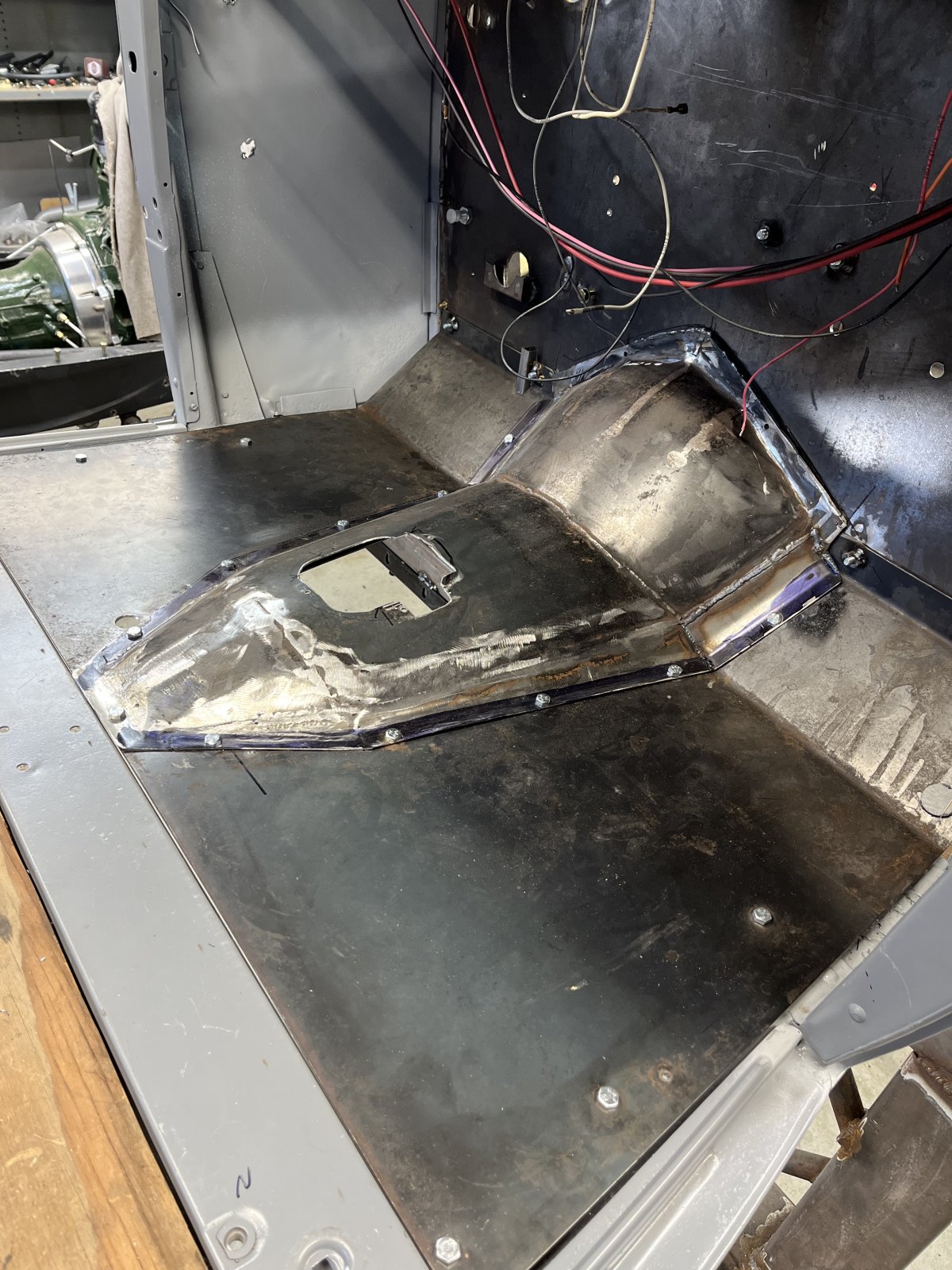

  13. nochop
    Joined: Nov 13, 2005
    Posts: 4,608
    nochop
    from norcal
    22 penetrations, 22 weld nuts, not one oblong or oversized hole B8164A8F-B419-4C2F-9D28-442D1188126C.jpeg

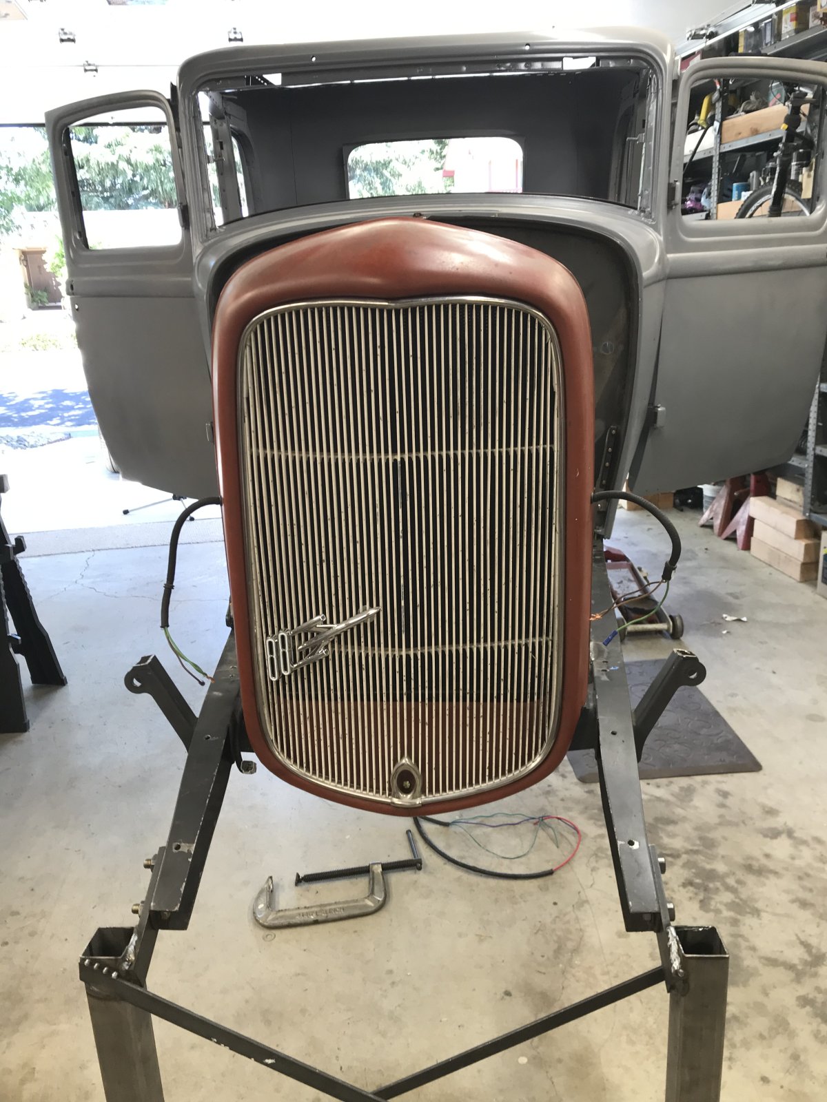

  24. nochop
    Posts: 4,608
    nochop
    from norcal
    Sometimes it’s just small details that need to be done IMG_5811.jpeg IMG_5815.jpeg IMG_5814.jpeg

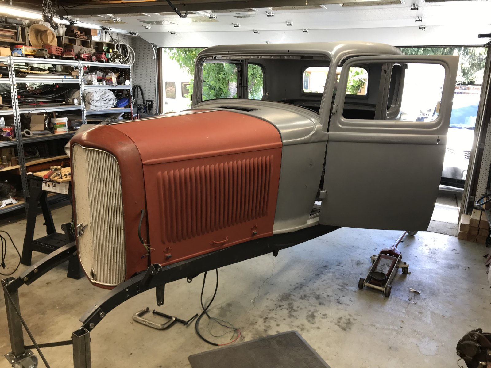

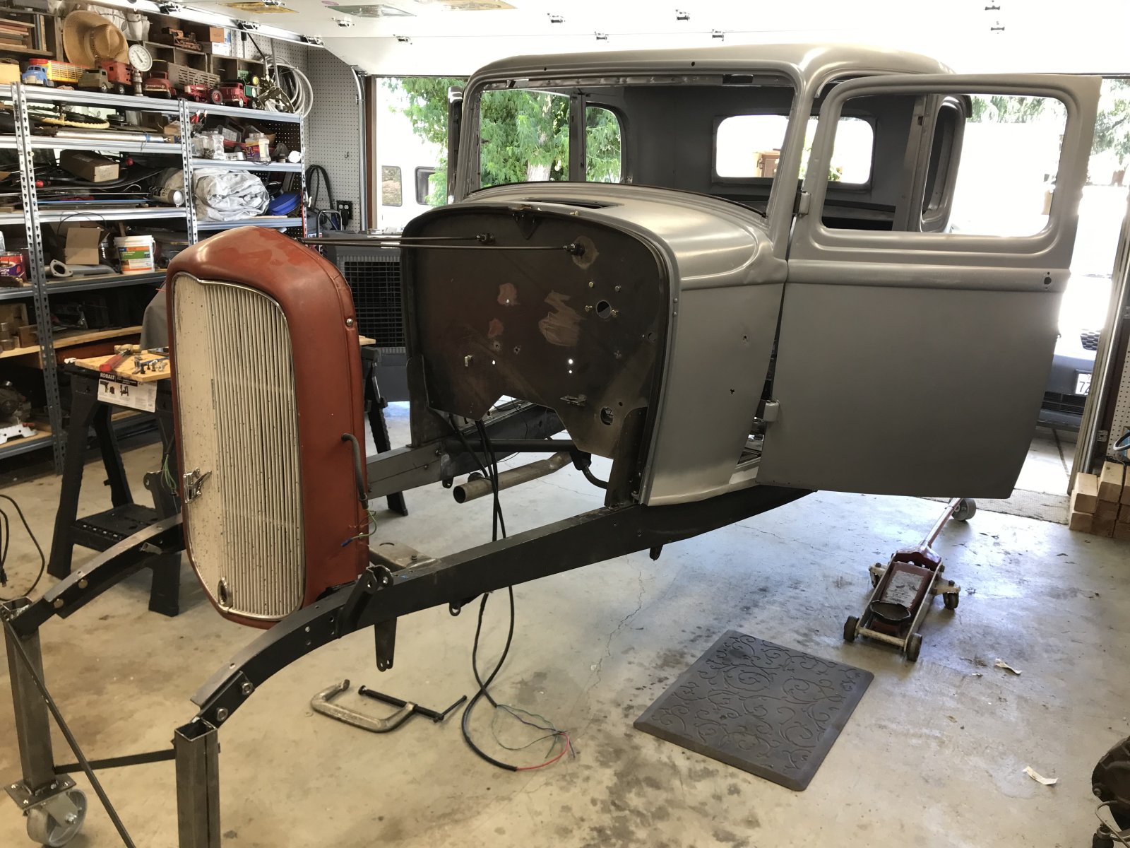

  27. nochop
    Posts: 4,608
    nochop
    from norcal
    I can see front fender support’s being a real pain
