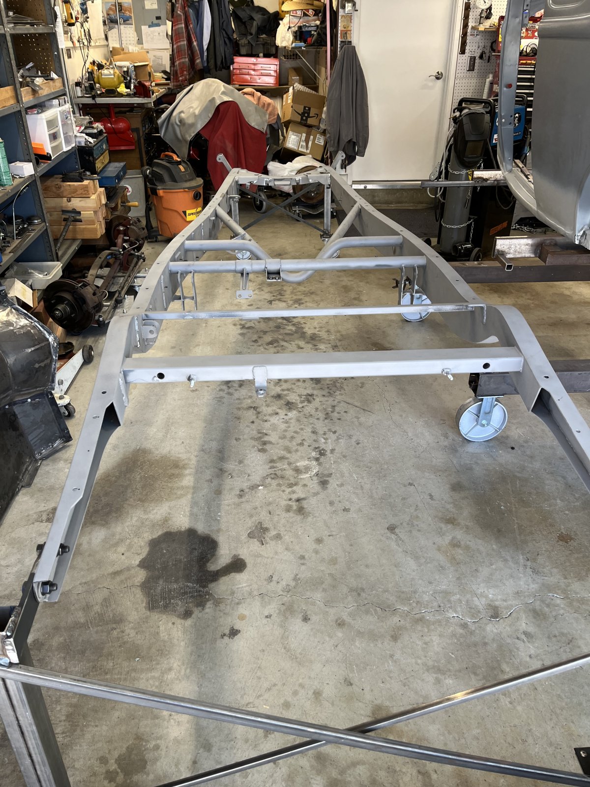

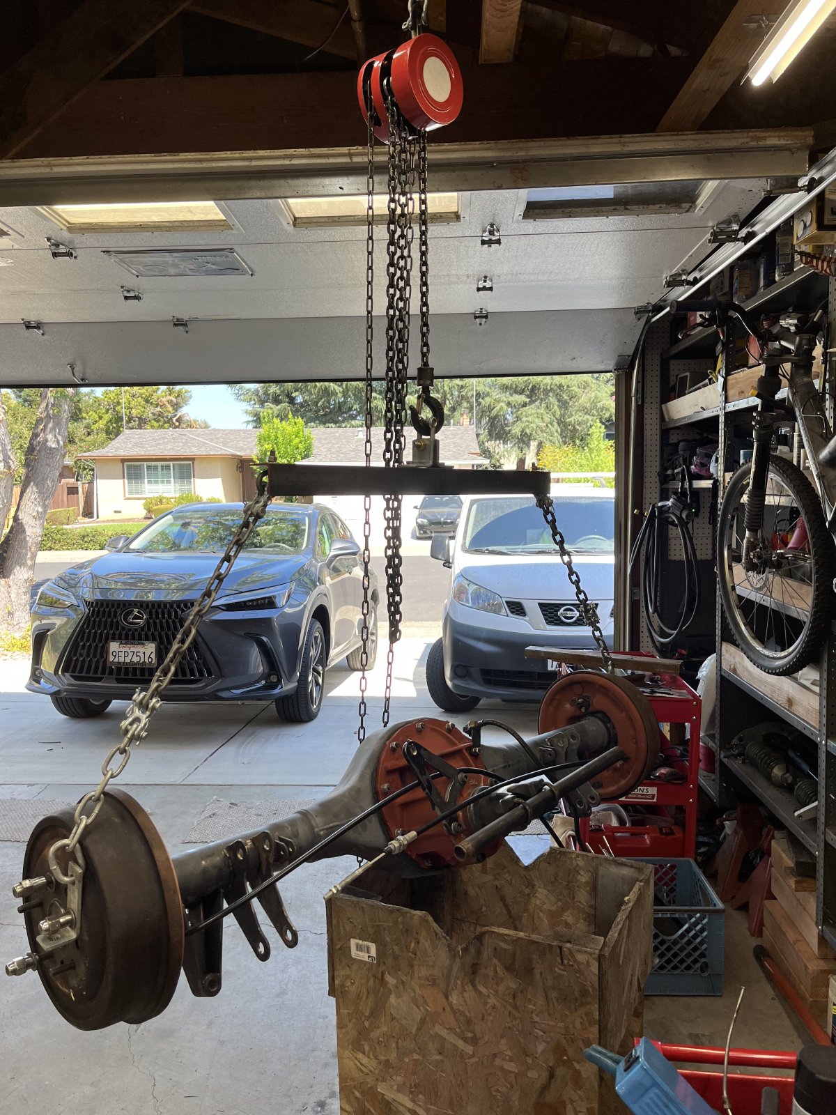

    Had to move the casters outboard it install the frame horn covers 71140122016__E4071FE0-EE07-41A5-9E7C-7ACB1A1584C5.jpeg

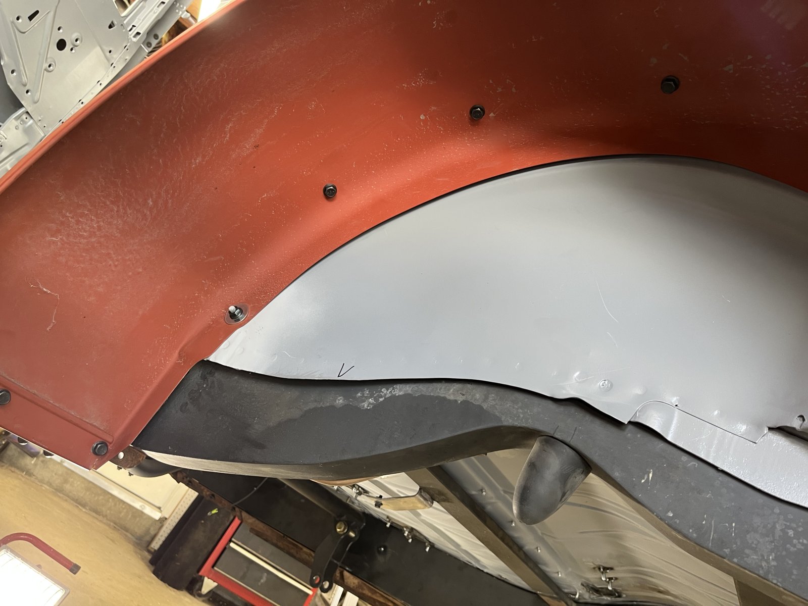

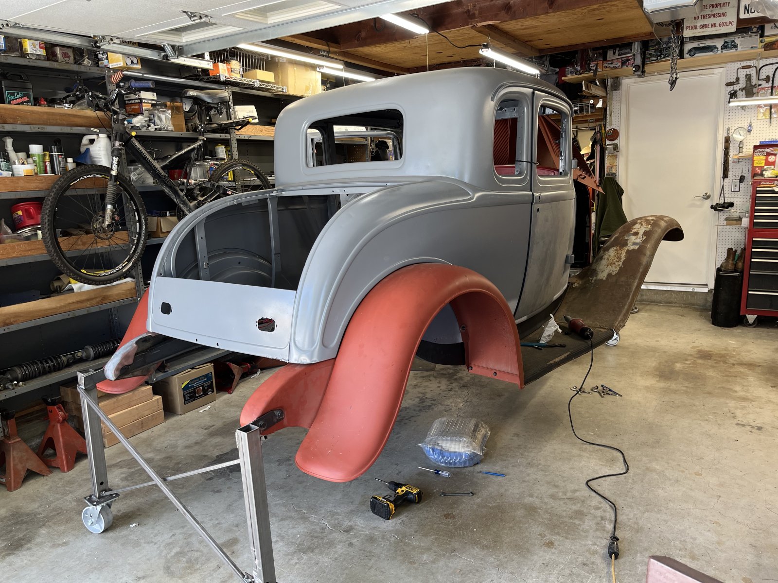

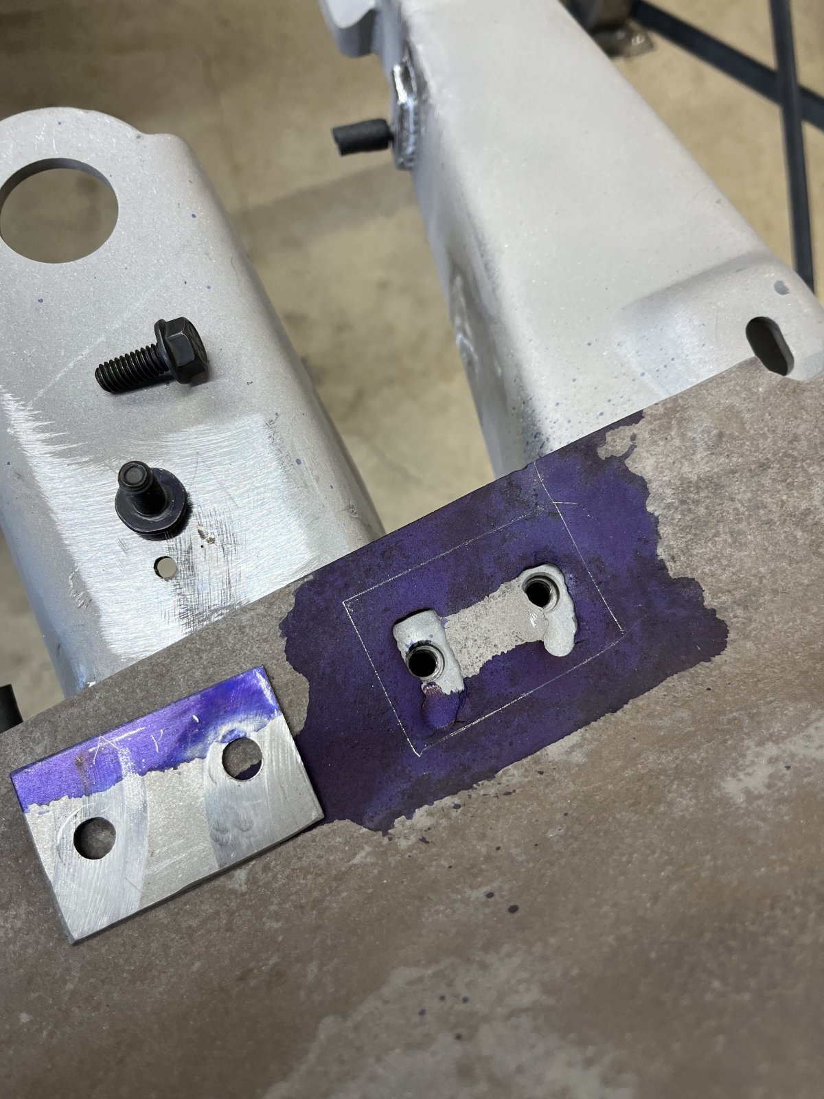

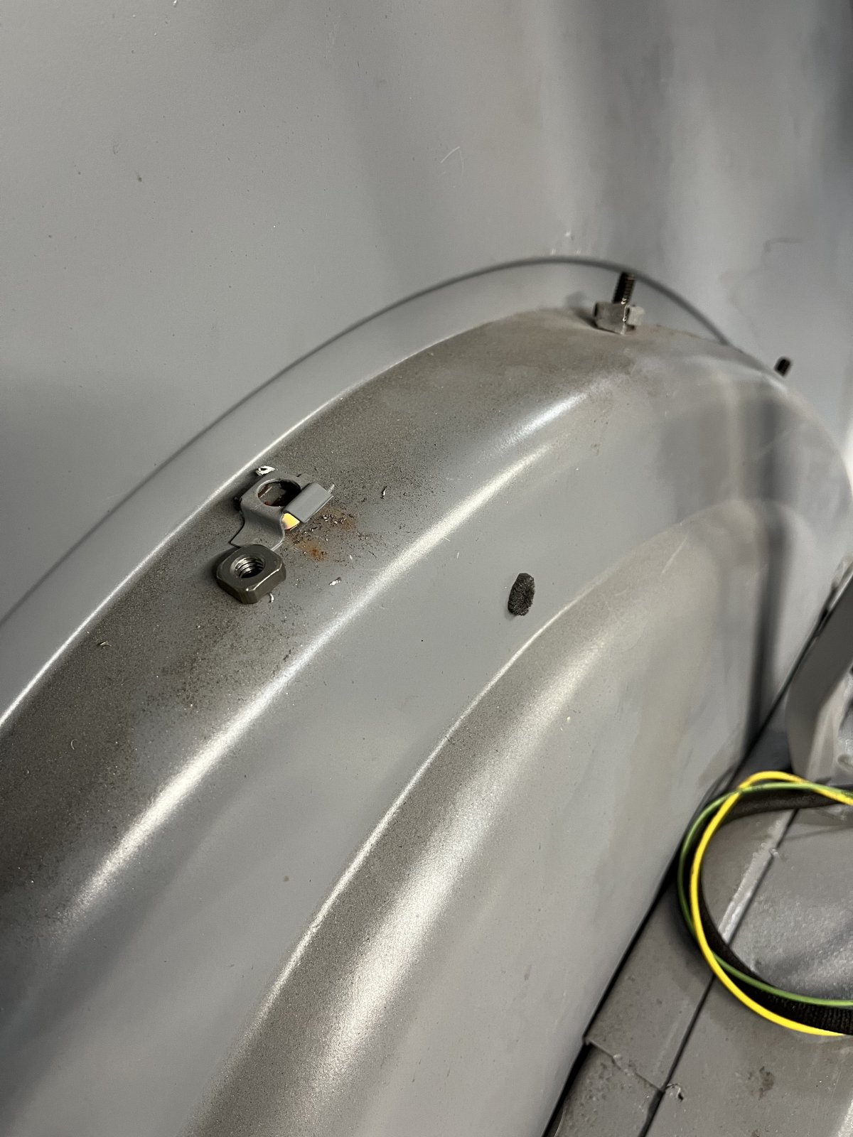

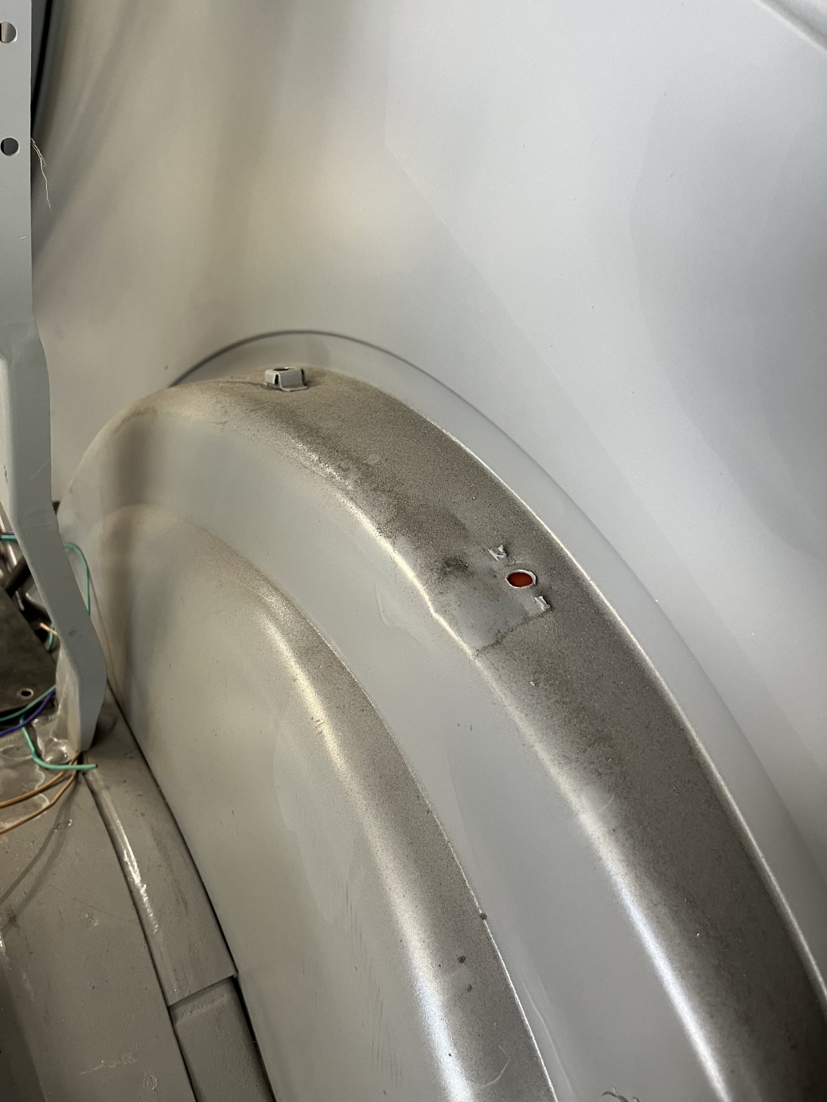

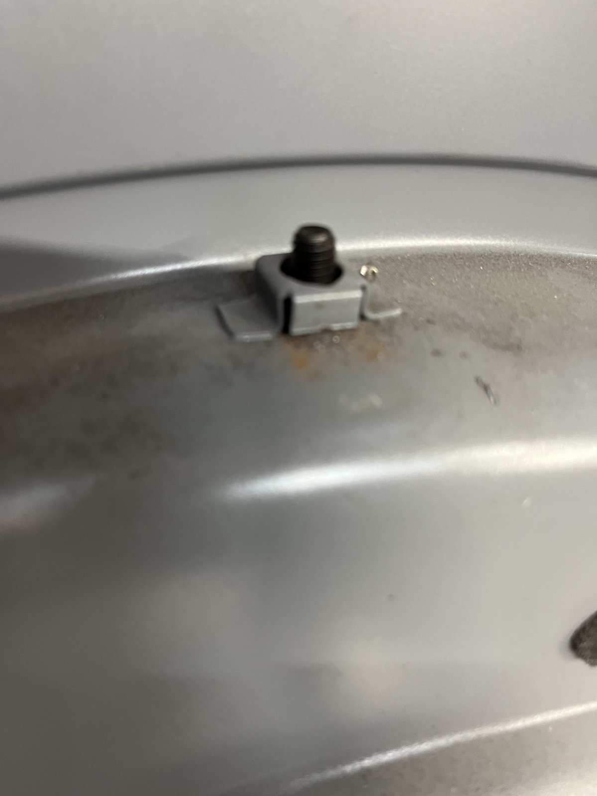

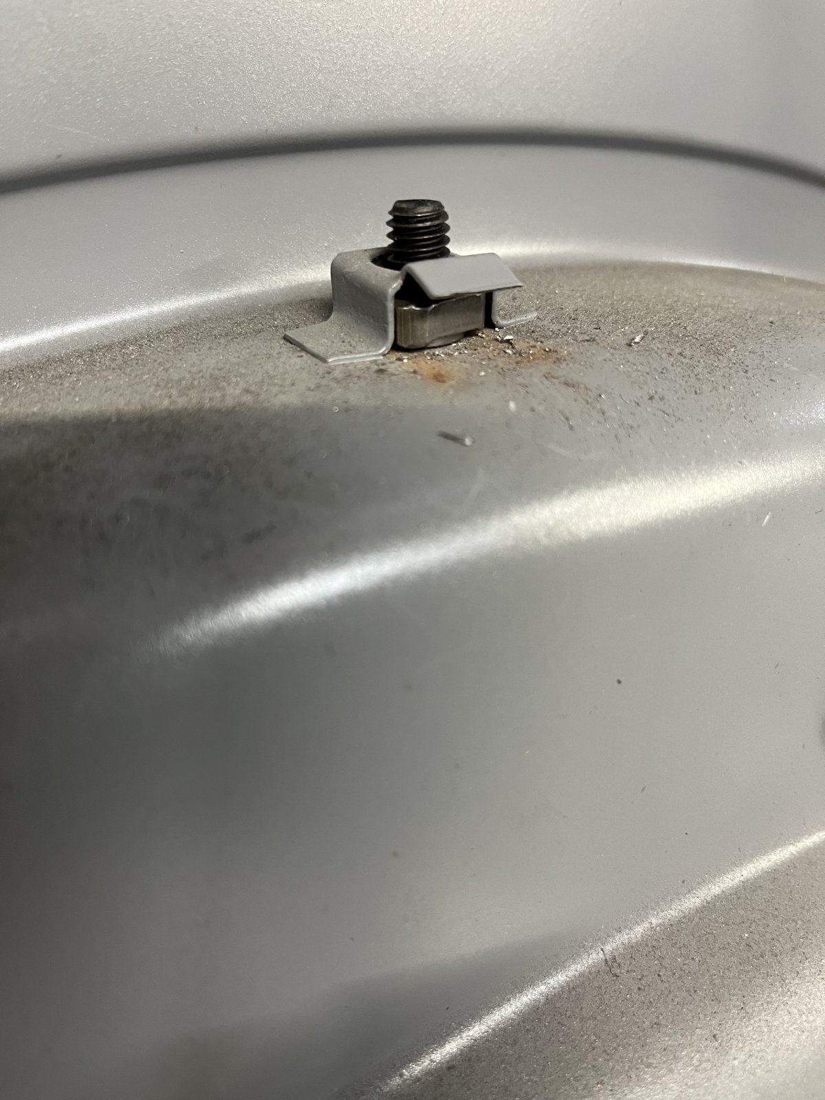

    More small work that needs to be addressed. Restored the cage nuts to get the rear fenders hung. Replaced the 5/16 24 with 5/16 weld nuts. IMG_6012.jpeg IMG_6016.jpeg IMG_6015.jpeg IMG_6014.jpeg IMG_6018.jpeg IMG_6013.jpeg

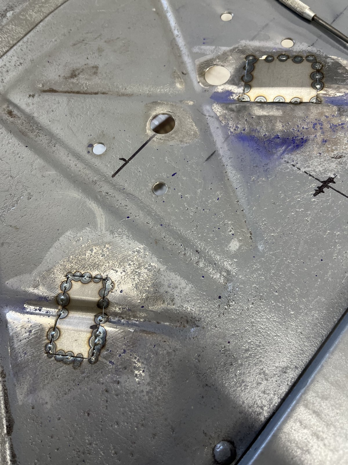

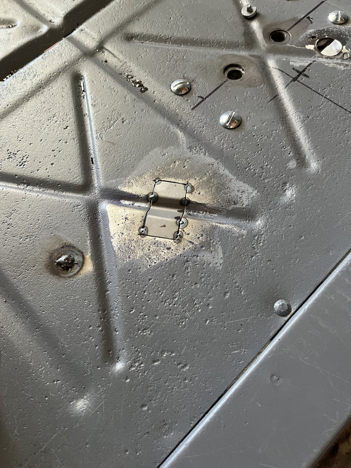

    71294851836__750C532B-6EC1-4286-BDBD-DC6E42FAD356.jpeg A little floor work IMG_6045.jpeg IMG_6046.jpeg IMG_6047.jpeg

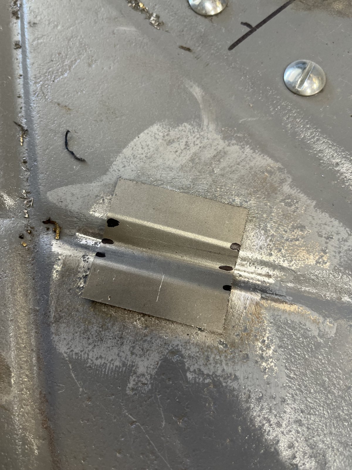

    Other miscellaneous repairs 71294866097__A9A8A598-A6BF-477B-B20C-89A225F46F5D.jpeg 71294856049__84B5F6F6-97E1-4550-91A8-DFB20A2BD791.jpeg IMG_6049.jpeg

    Nice to see the new cage nuts are 5/16-18, the original fine thread ones drive me nuts, no pun intended.
  13. I don't mind the fine thread, as long as they are all fine thread for the same components(fender, saddles, whatever) and they are all cage nuts, not nut and bolt.
    nochop likes this.

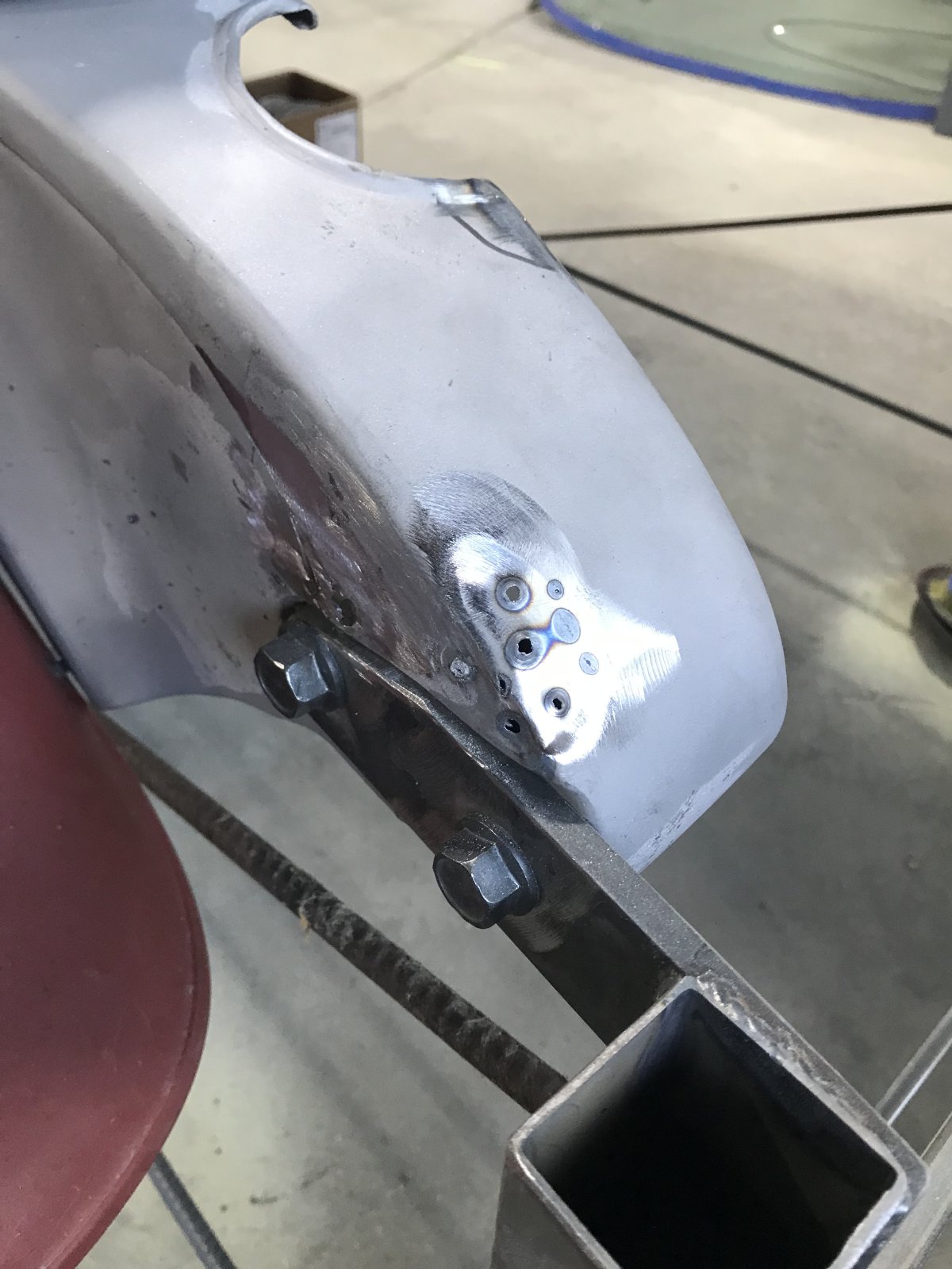

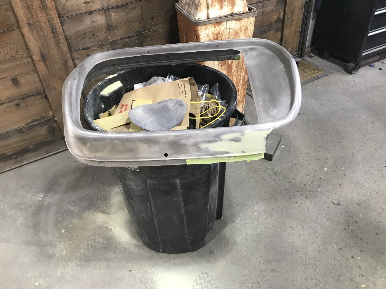

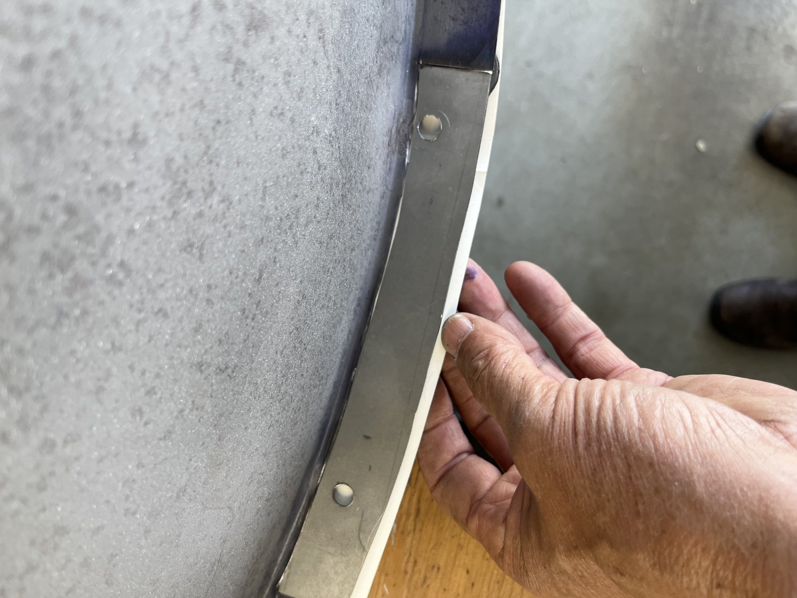

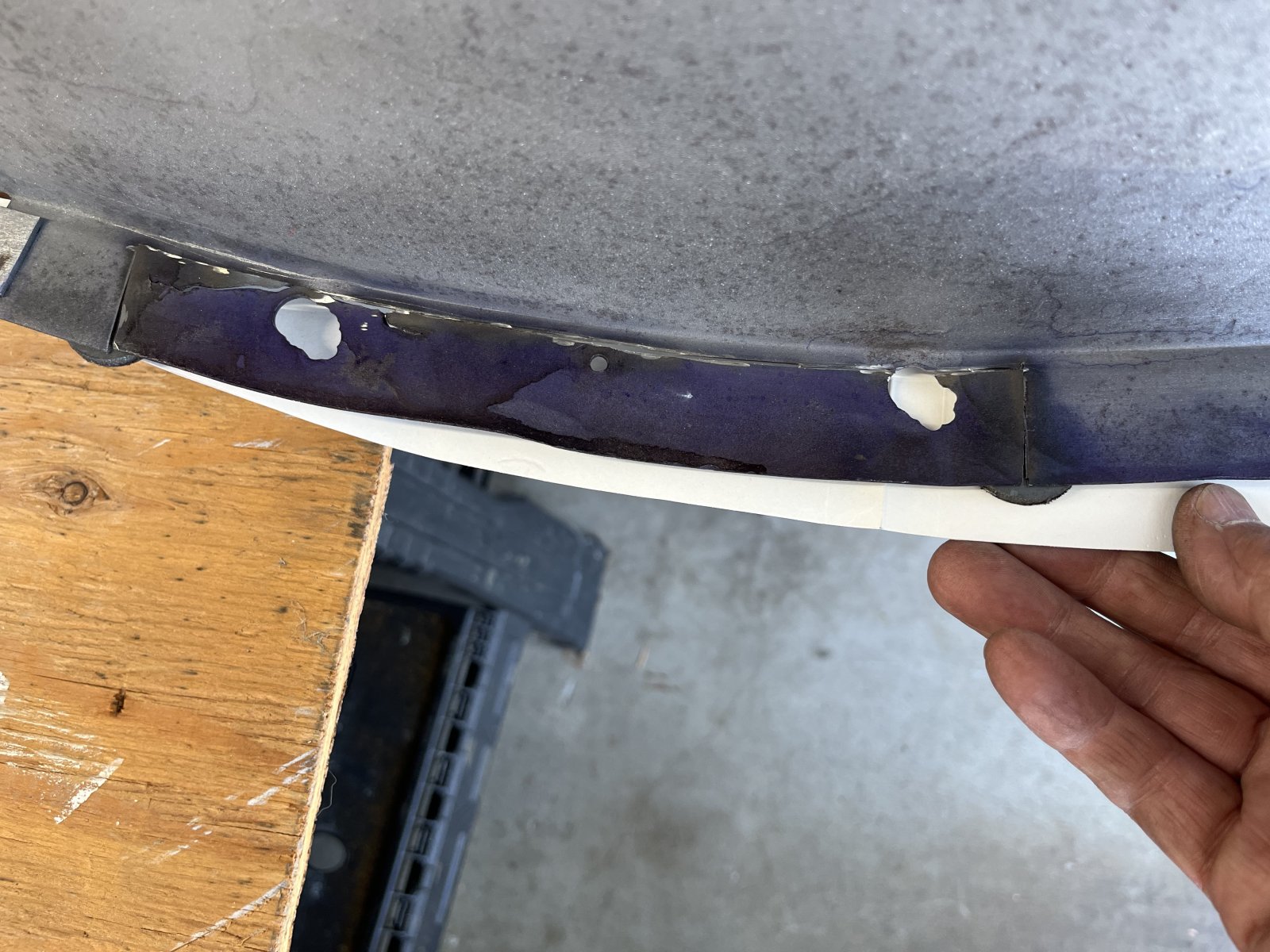

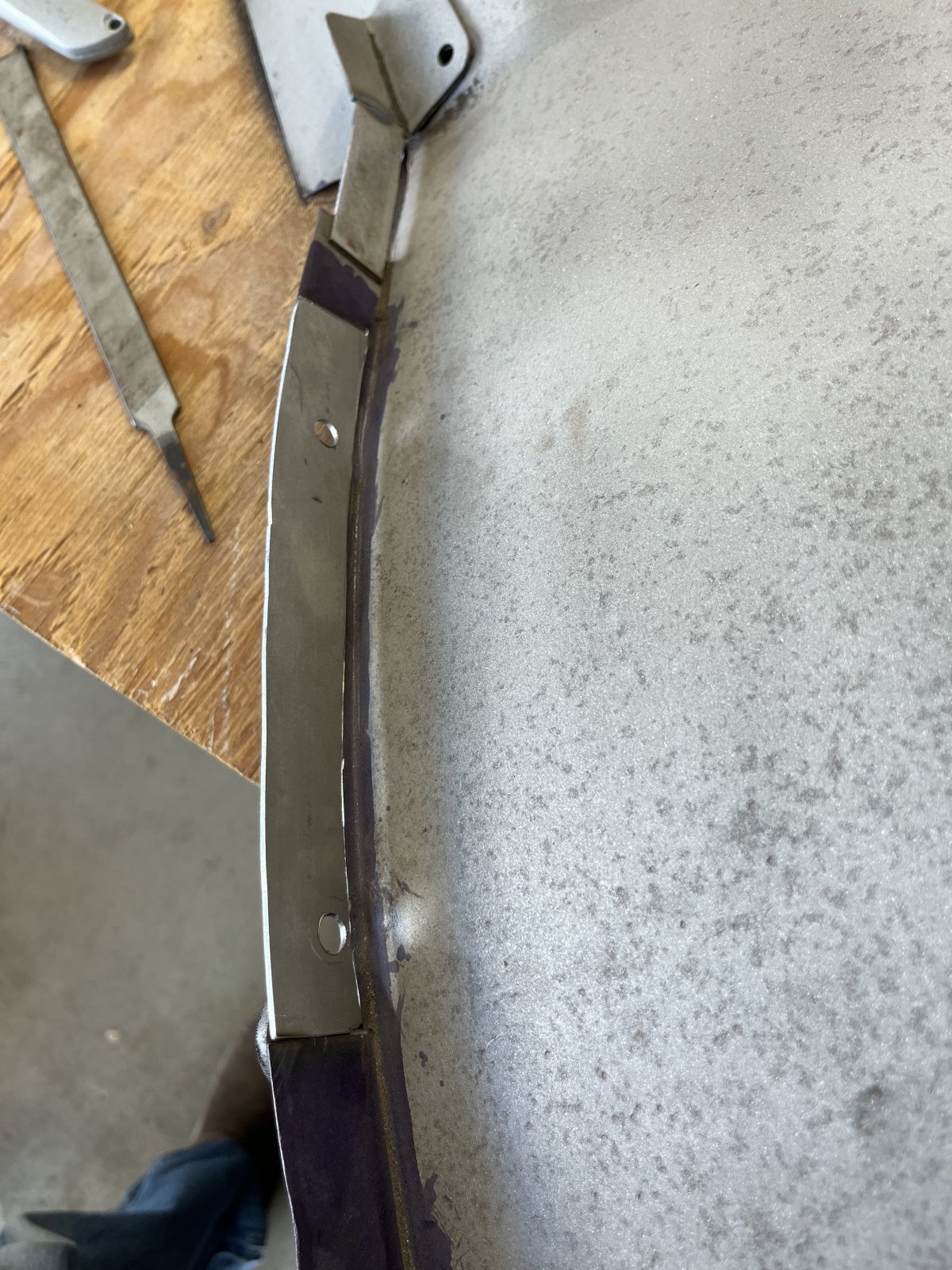

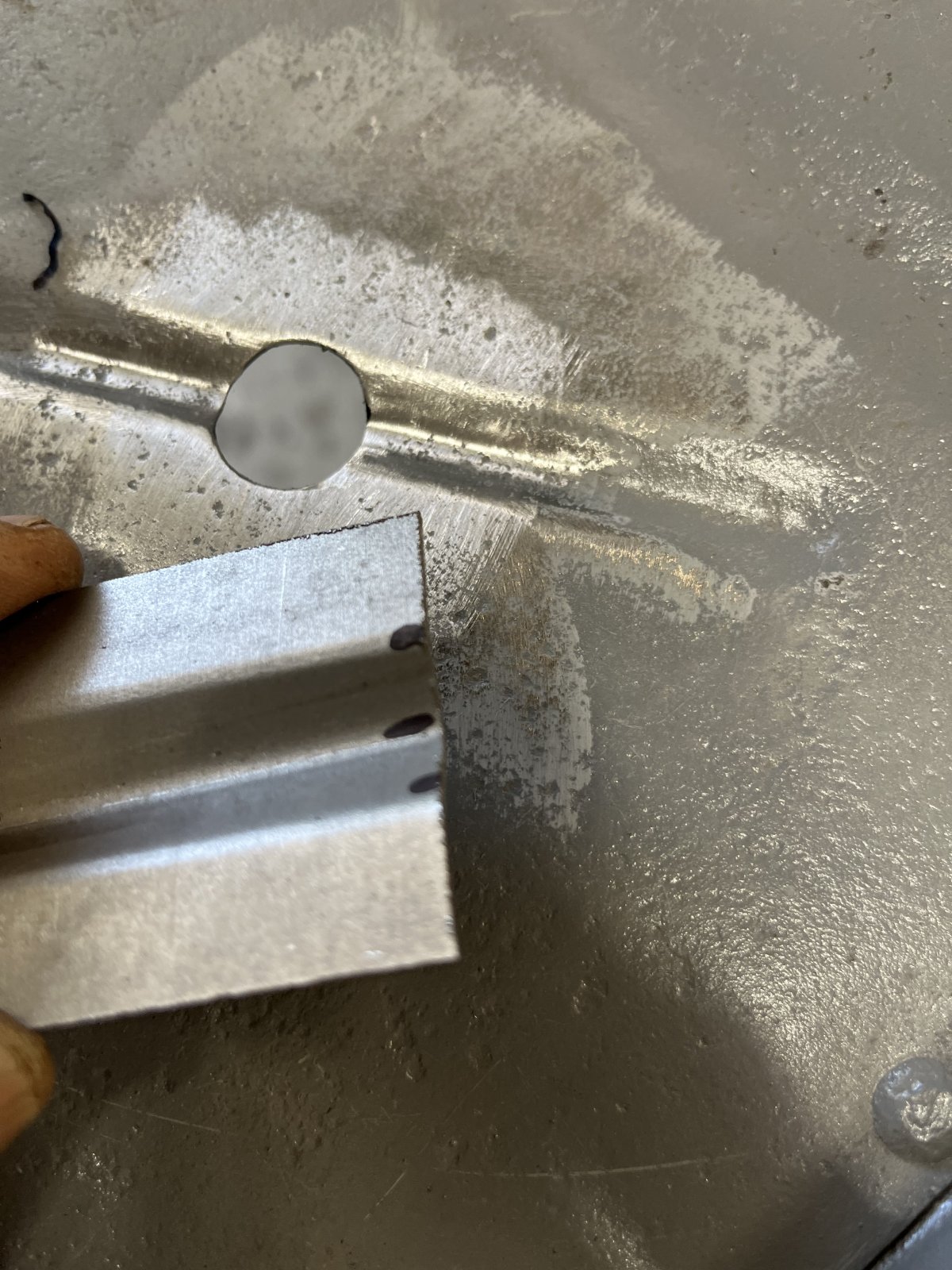

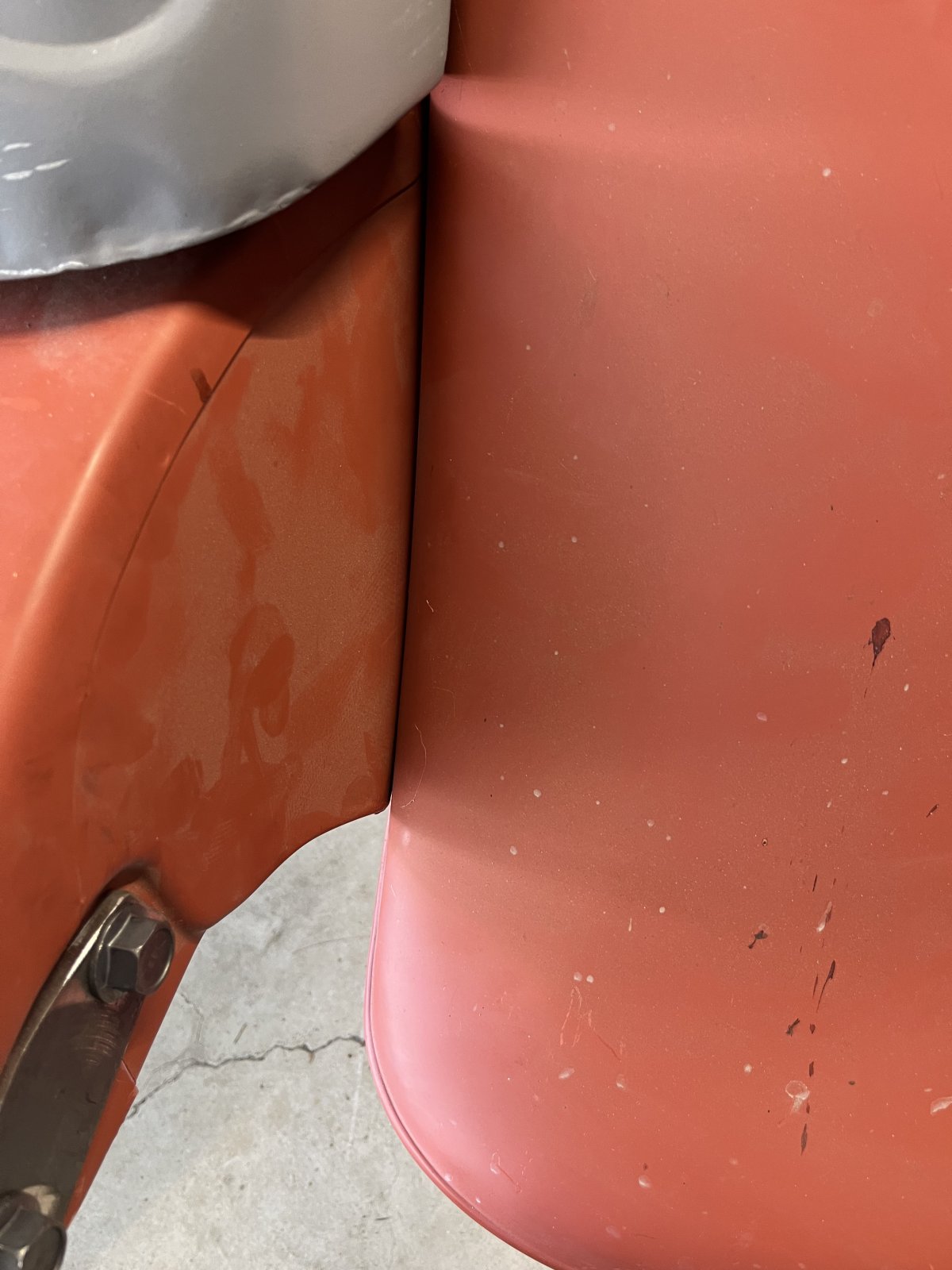

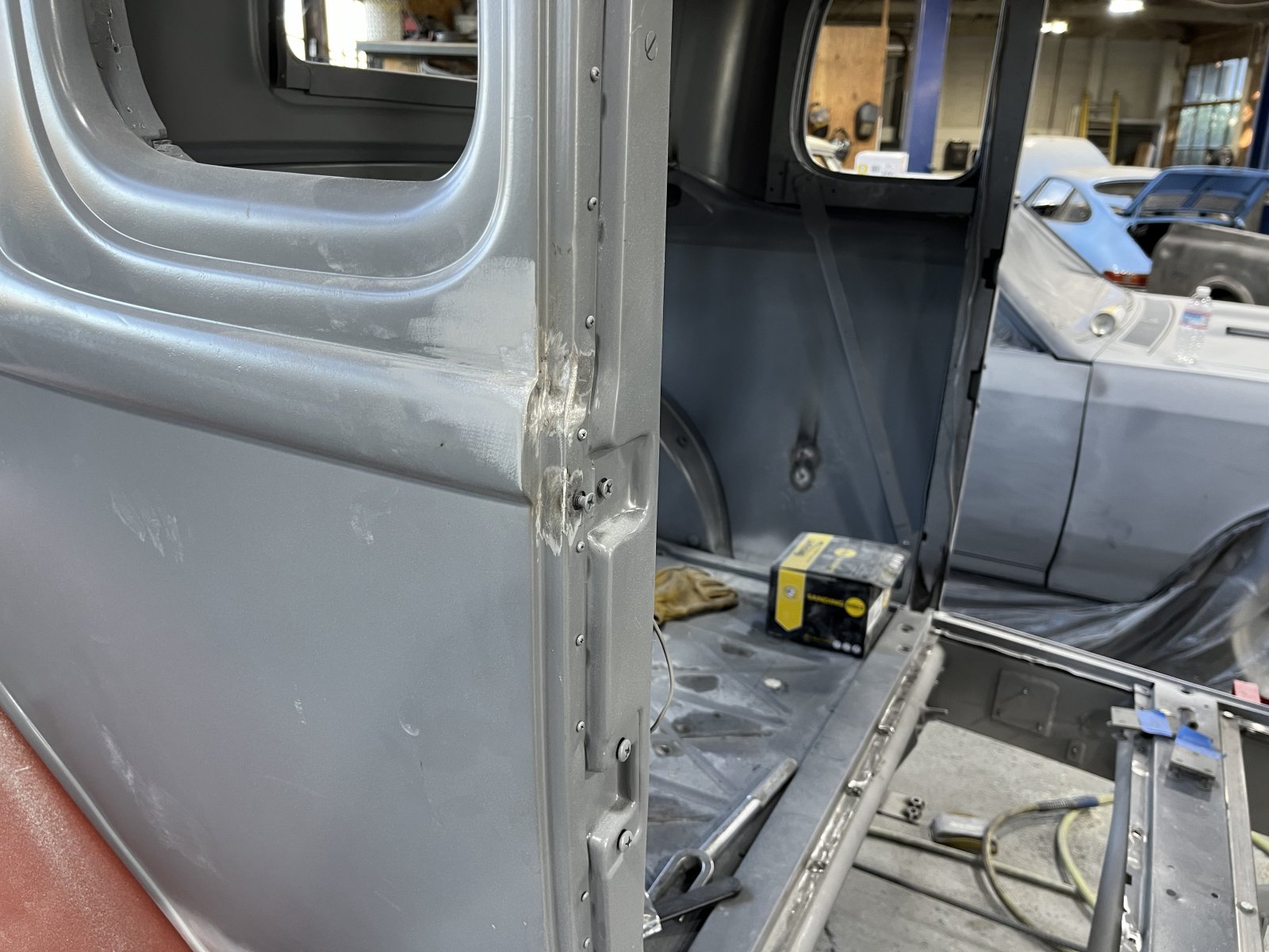

    More repairs, this time p***enger front fender. I’ll tidy up the welds later after more fitting IMG_6061.jpeg IMG_6062.jpeg IMG_6064.jpeg IMG_6059.jpeg

    They were the only fine thread fasteners on the body other than the #12 and #10 interior fasteners

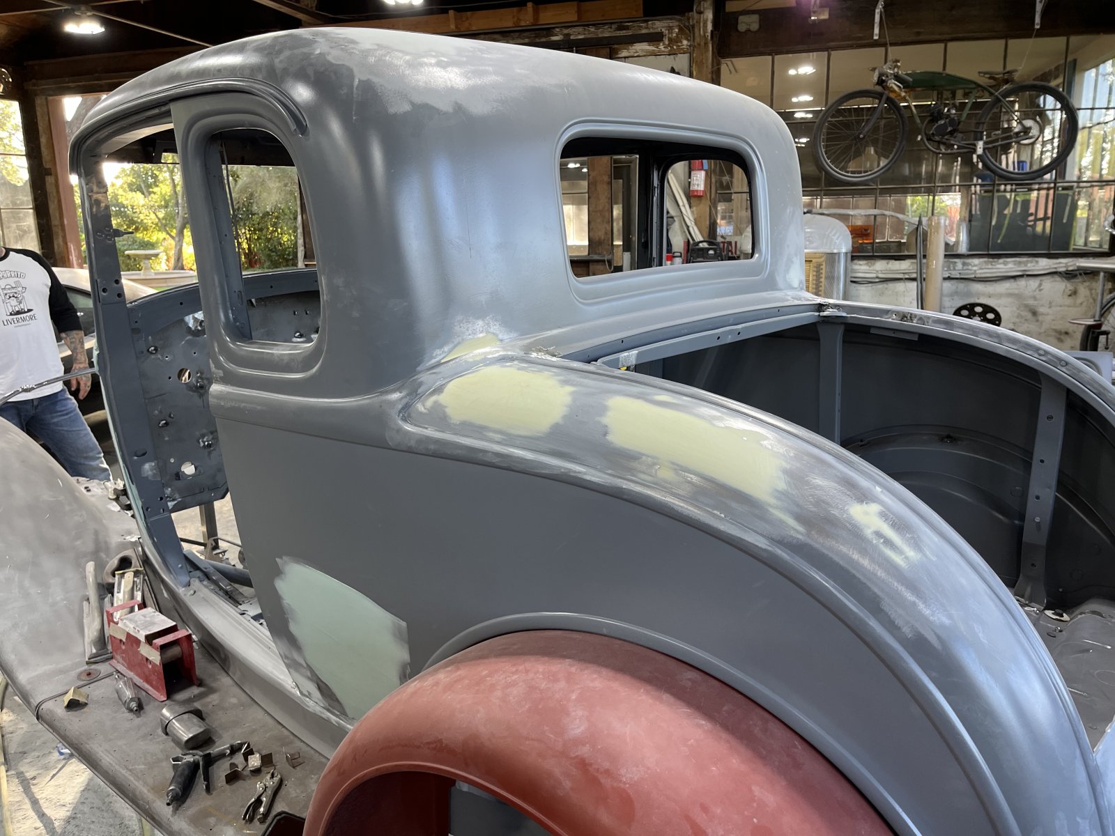

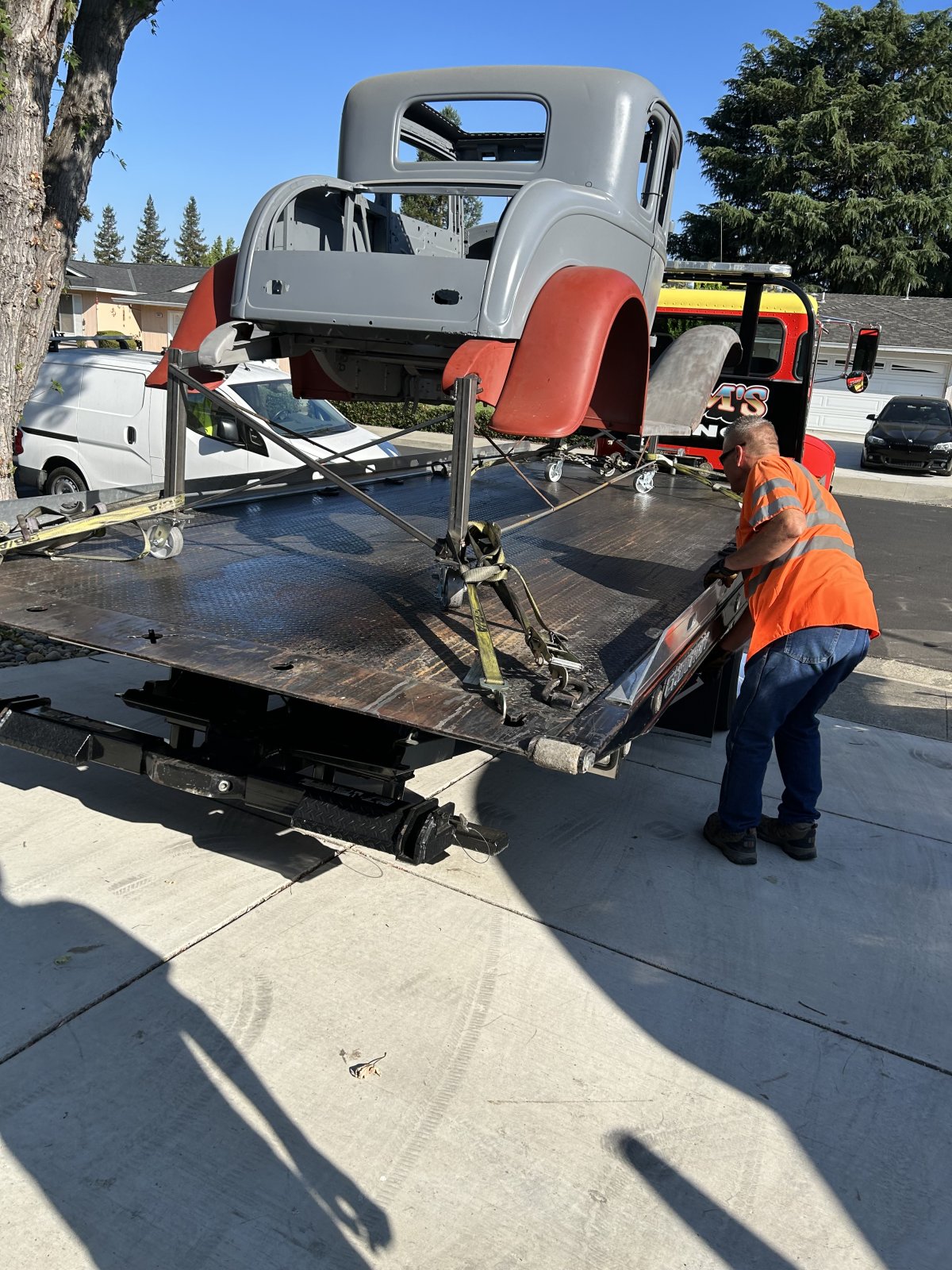

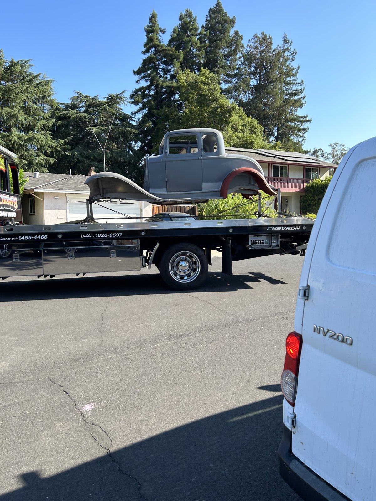

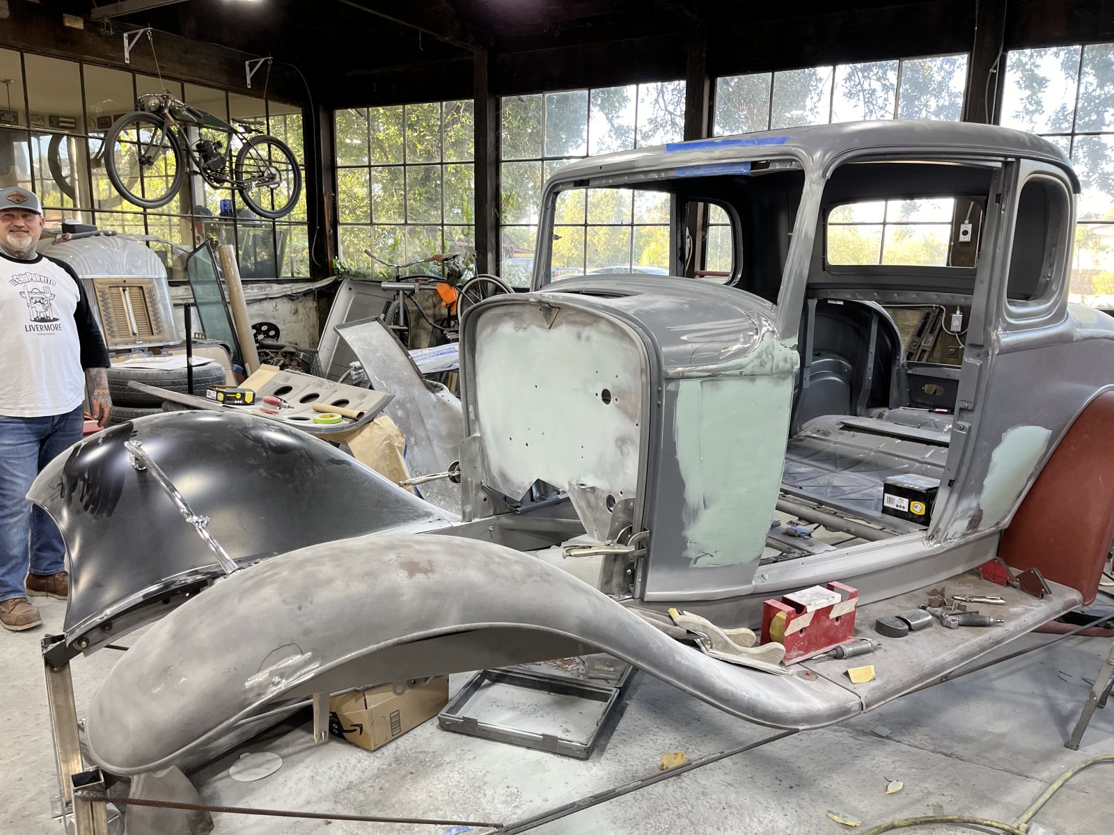

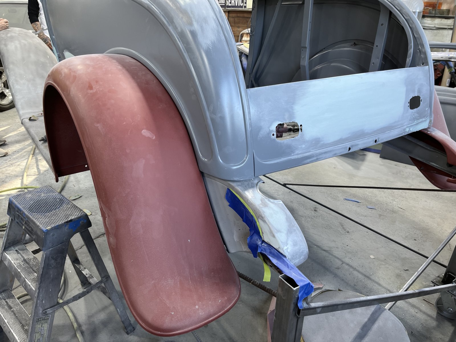

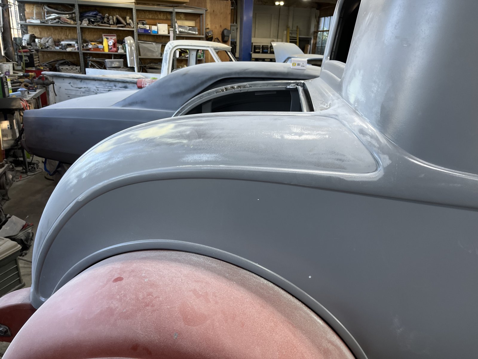

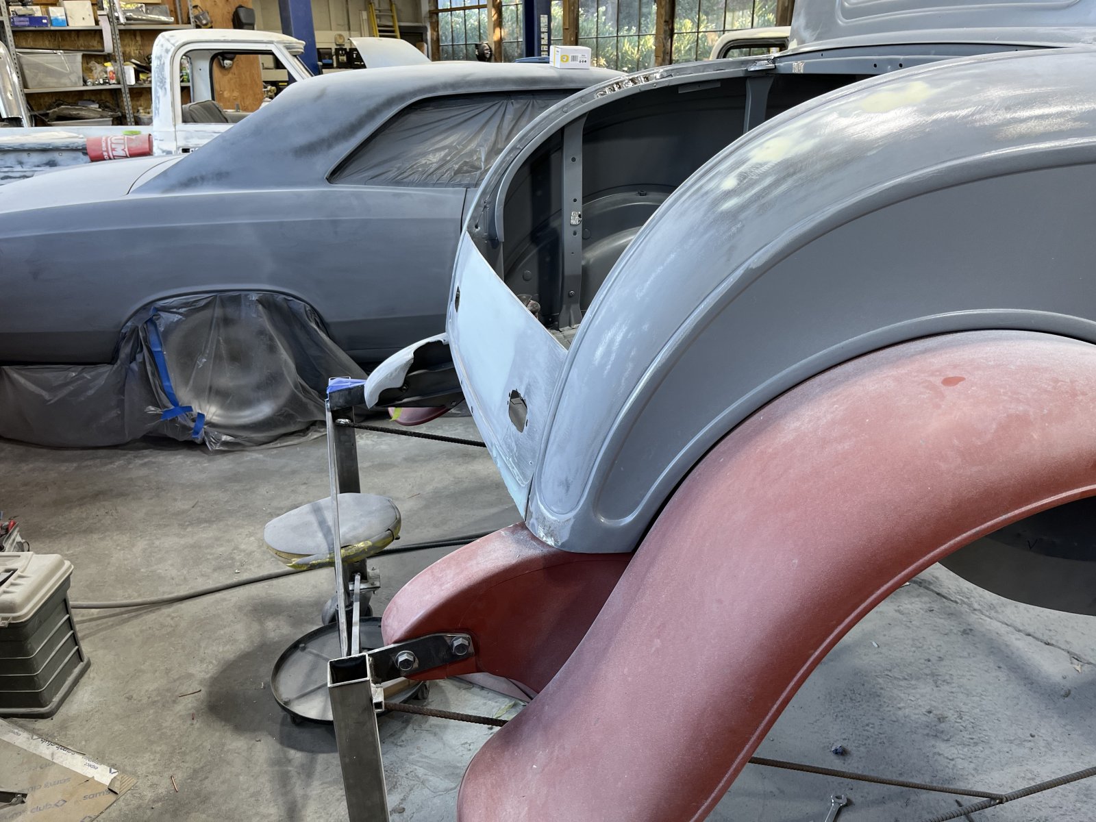

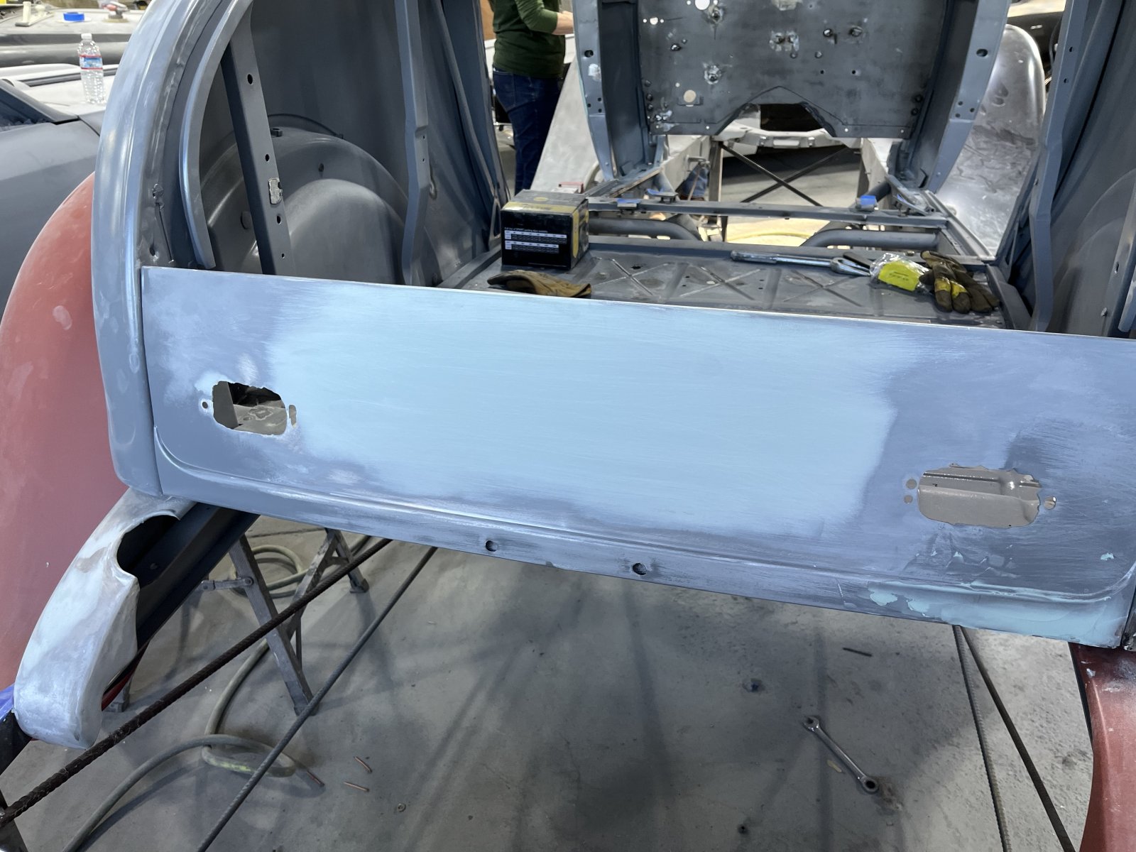

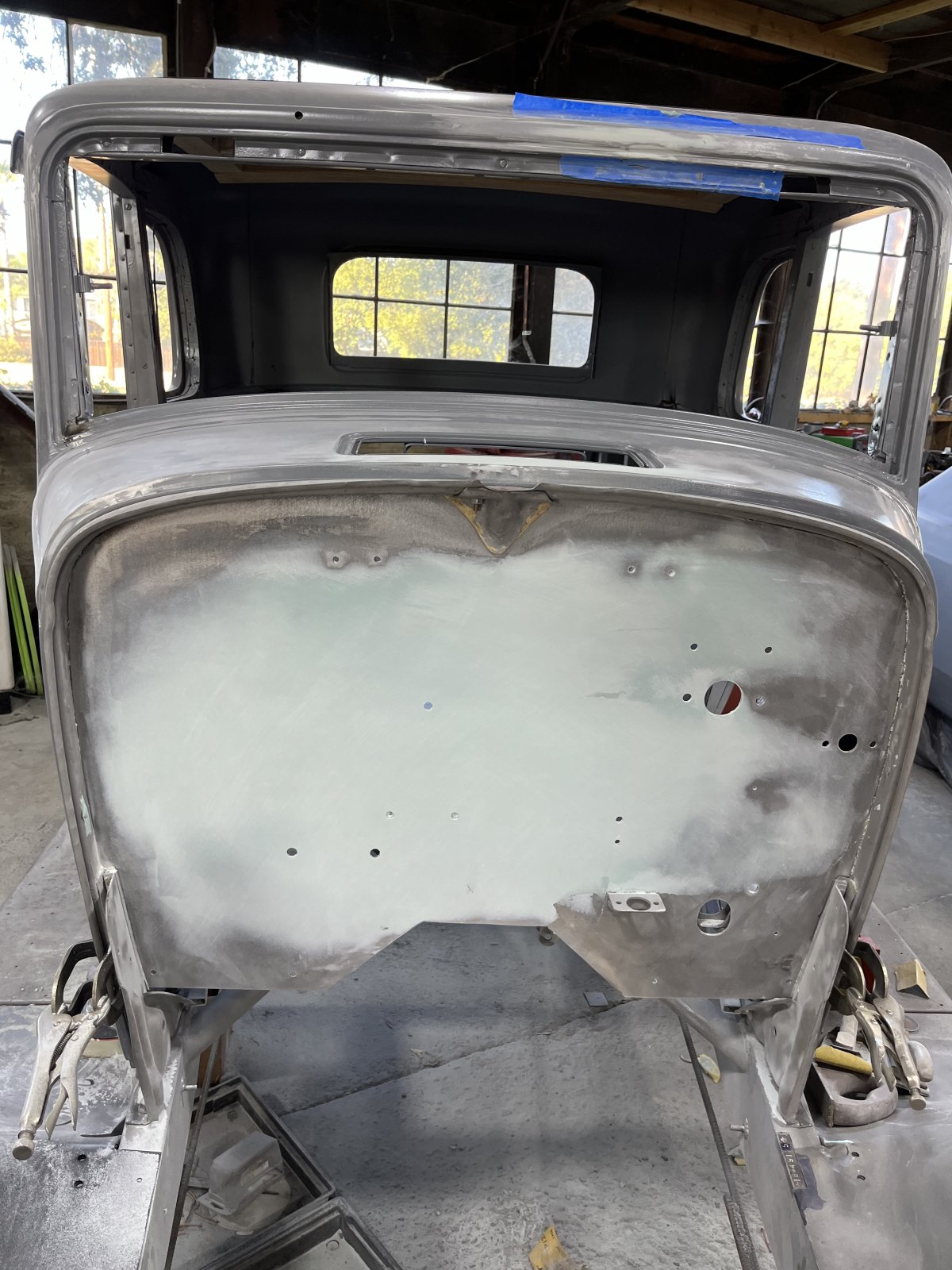

    Now that the body is off at the paint shop, on to other details 71528392797__BD15F006-9472-4496-A954-C5D90C82F848.jpeg IMG_6134.jpeg IMG_6135.jpeg

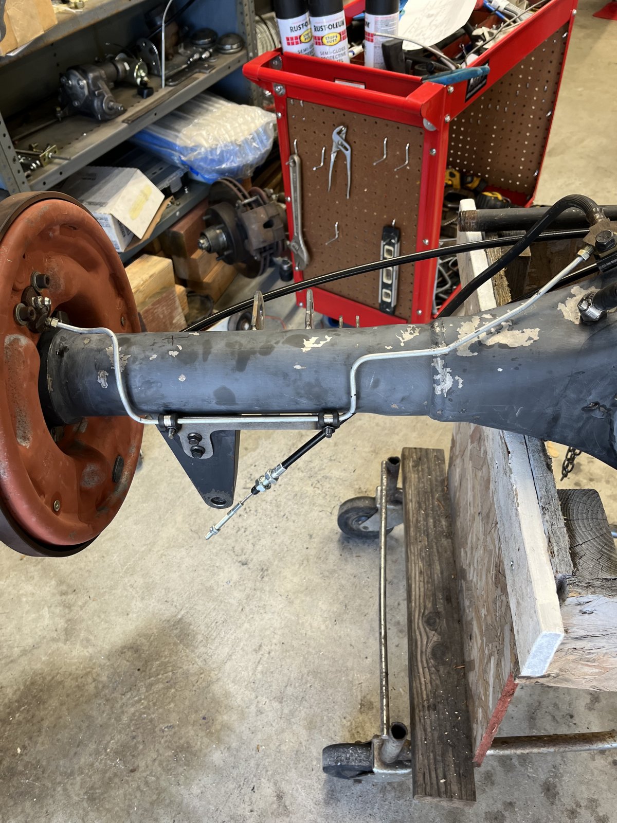

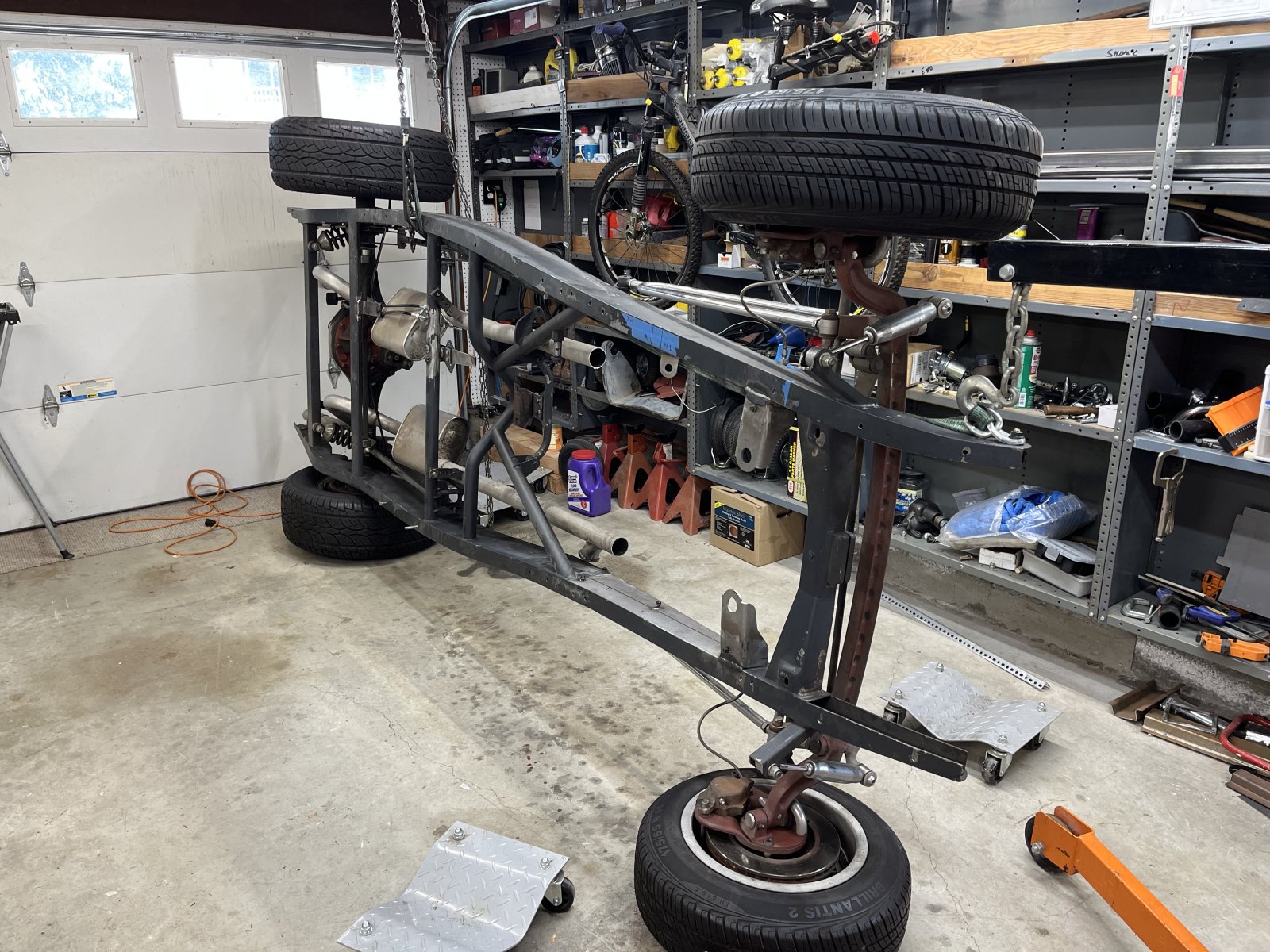

    I do have a comment on the motor mounts cantilevered from the inside of the frame. Are they welded to the boxing plate or to the inside of the frame with the boxing plate fitted around them?
    I know there are thousands of cars out there with similar mounts but I would consider putting a bolt-in tube crossmember between them. I bought a car years back that had the same type of mounts. I hit a rough patch in the road at about 40 mph and the welds broke allowing the engine to drop til the damper hit the tie rod. I got it home safely but I was surprised that the nice looking welds had broken. The engine was a 327 Chevy, much lighter than our Olds Rockets. I never really considered the G forces encountered by the mounts/ch***is when the car hits a pothole until I saw the damage. I bent up a piece of tubing and made a bolt in crossmember after straightening and re-welding the frame mounts. Just p***ing on a “lesson learned”.

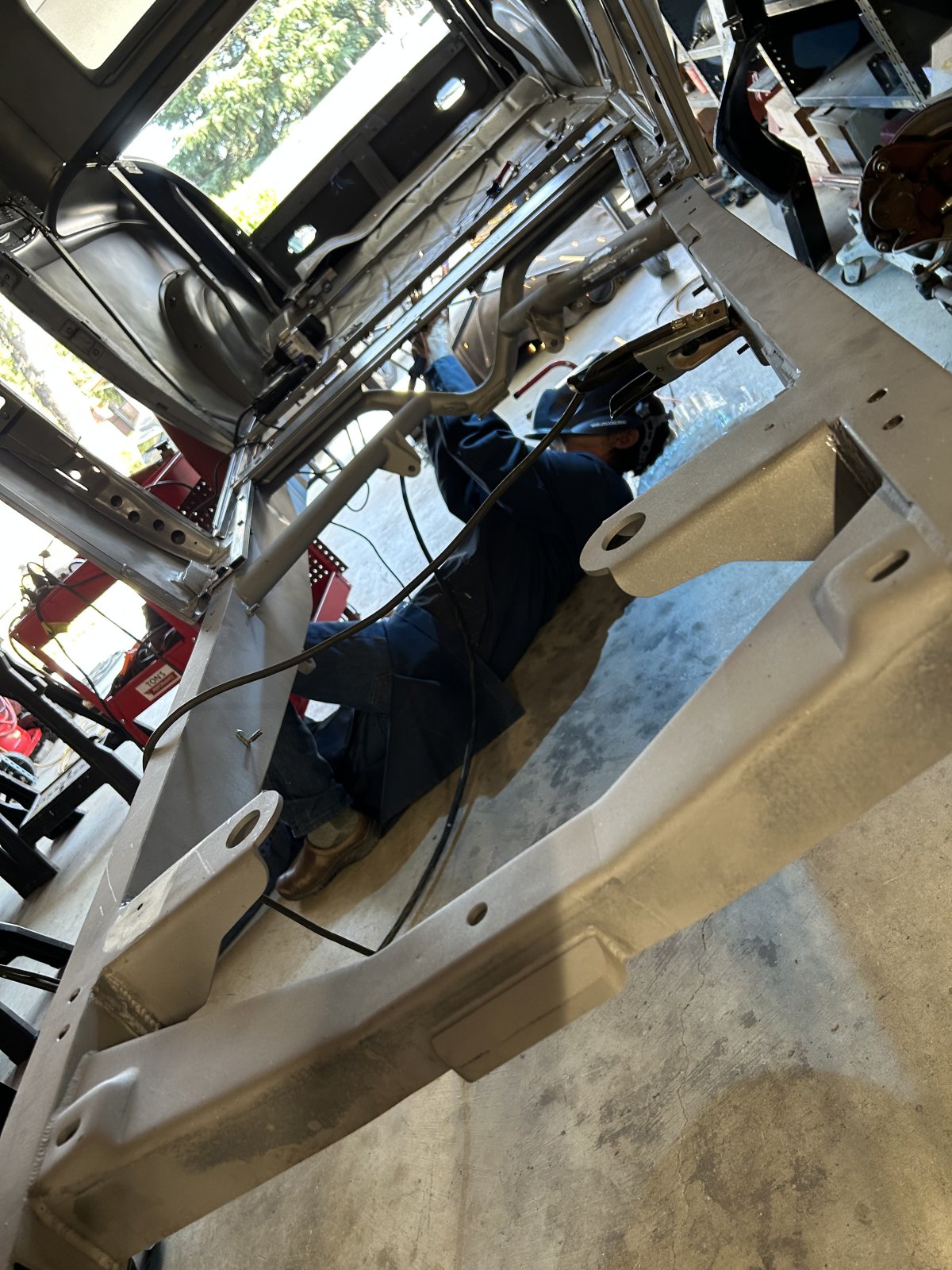

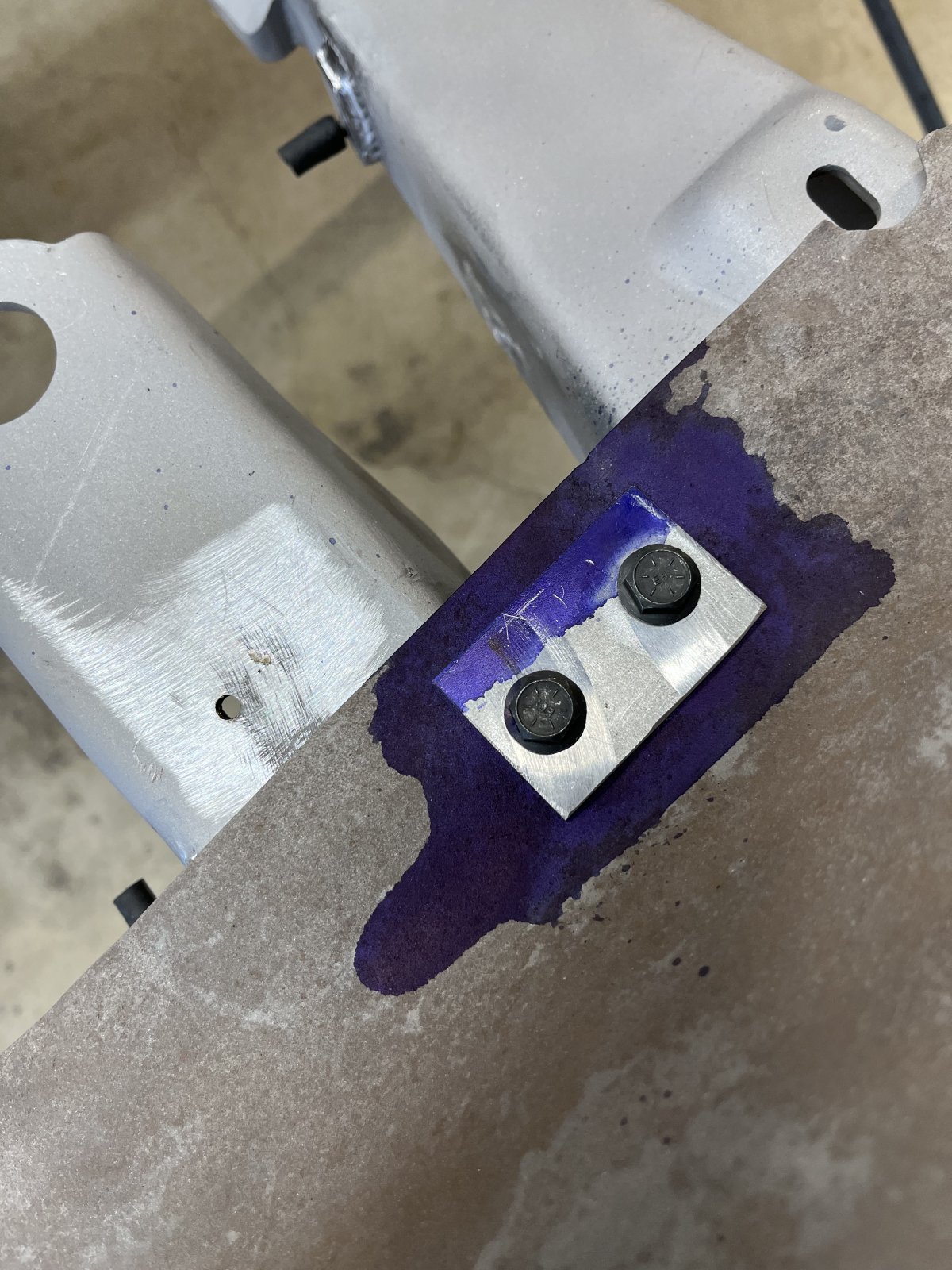

    IMG_5827.jpeg I’ll hope for the best on the the motor mounts. I lifted and rotated the frame during the welding to insure proper penetration all around

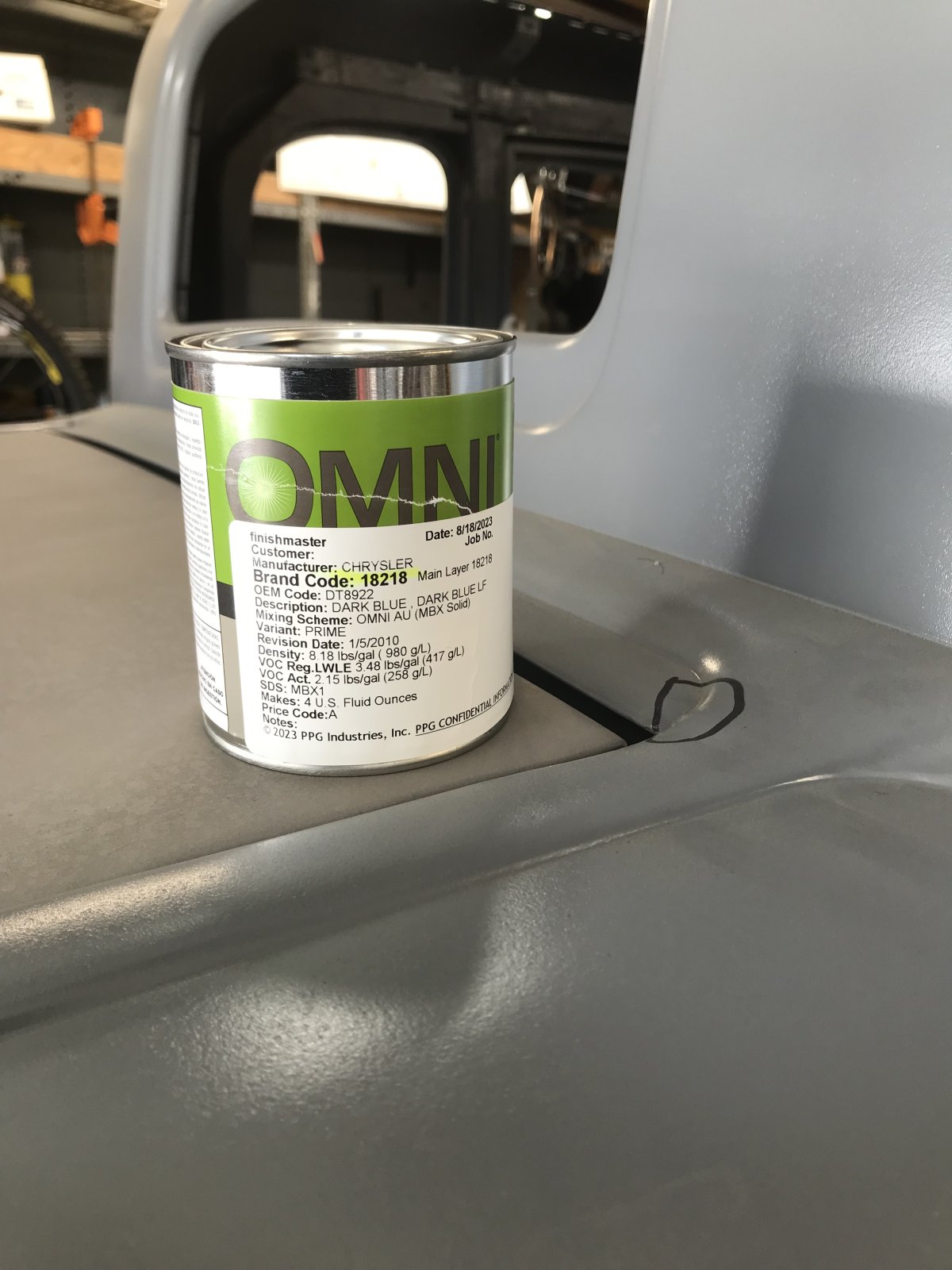

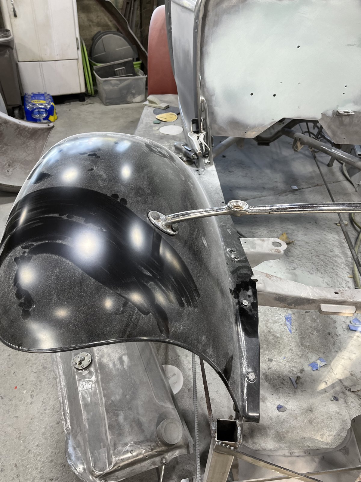

    upload_2023-9-7_7-39-4.jpeg Whatever in this can is what we’re gonna squirt
