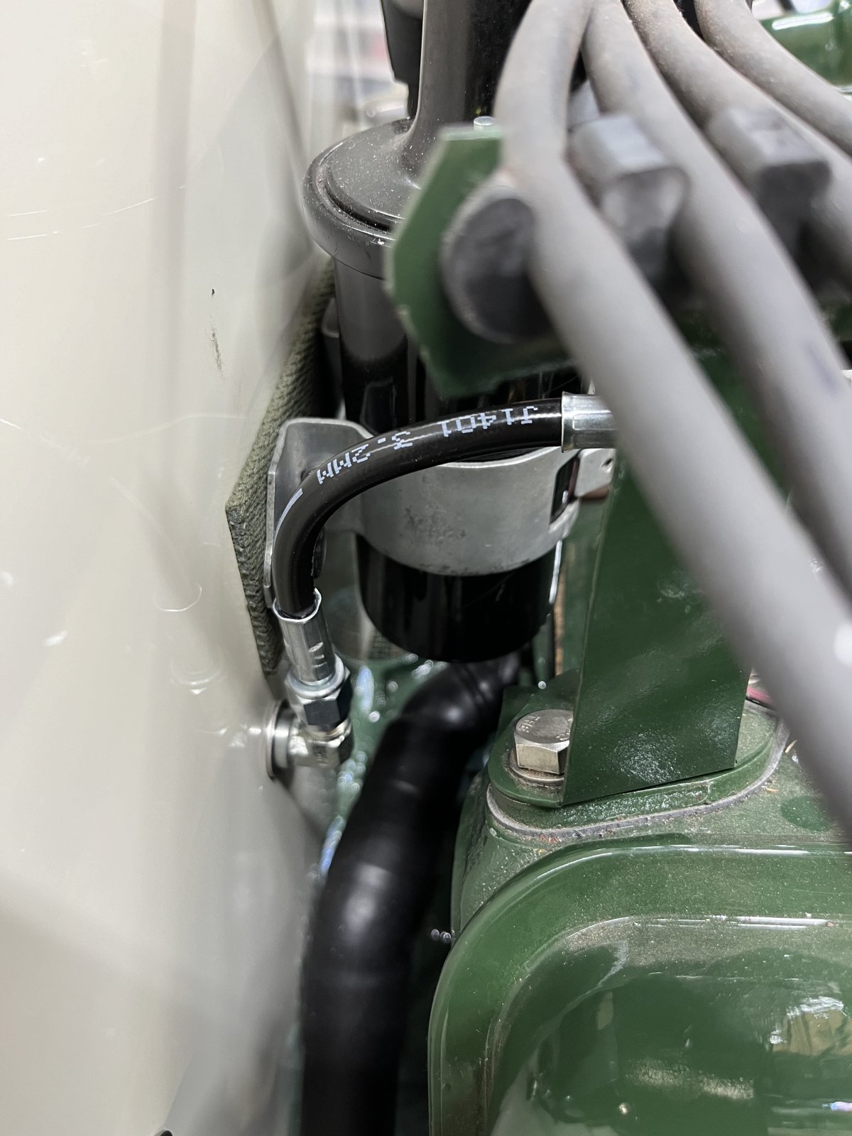

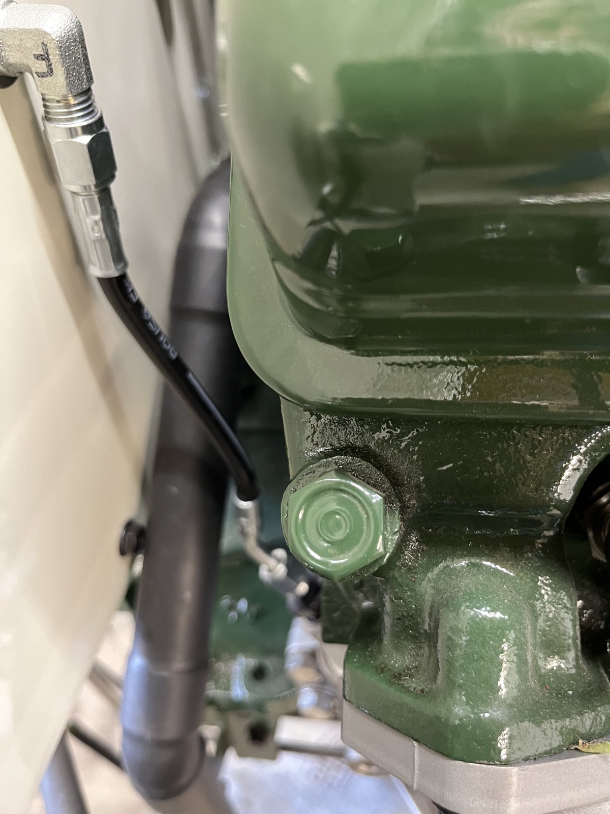

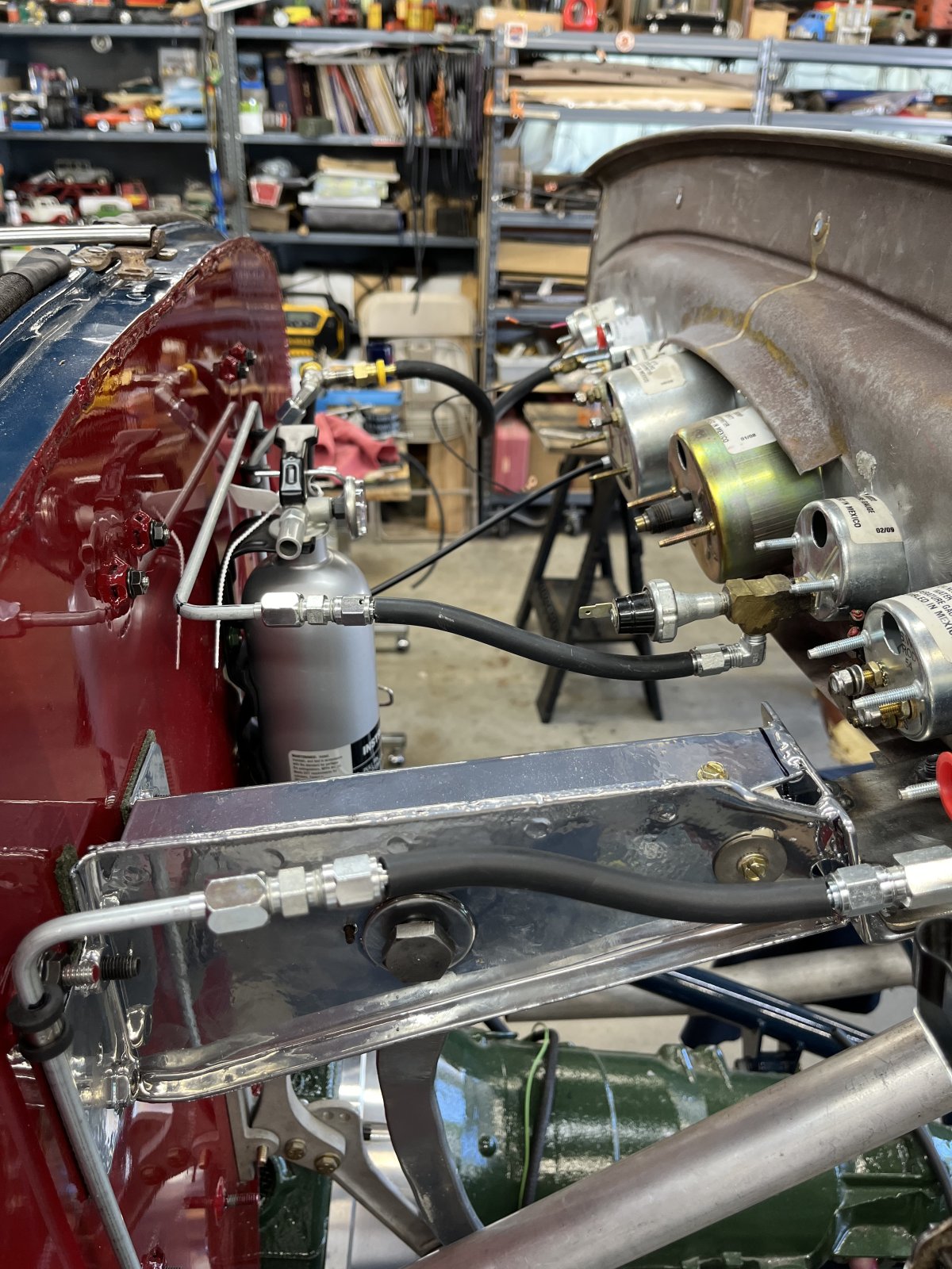

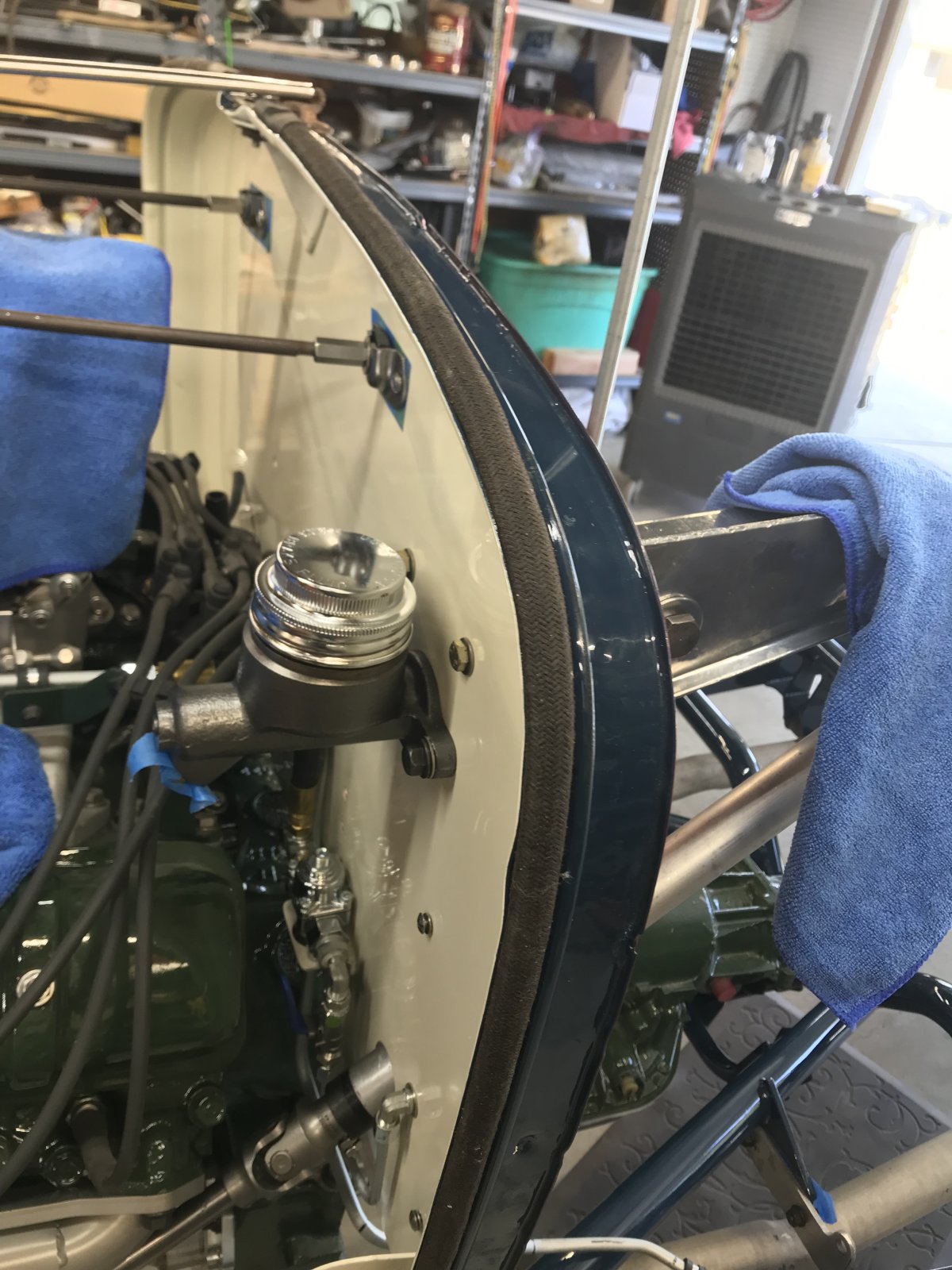

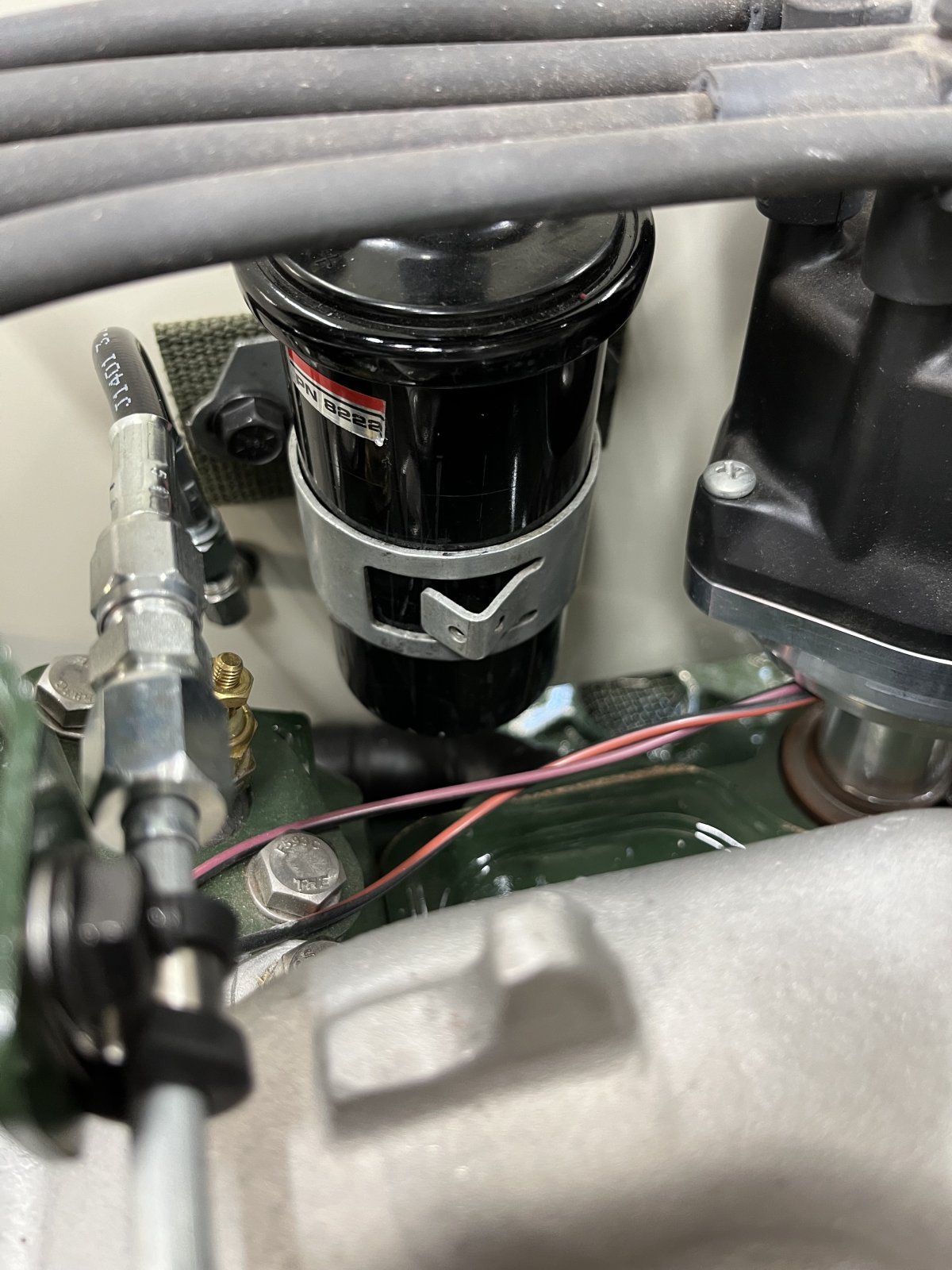

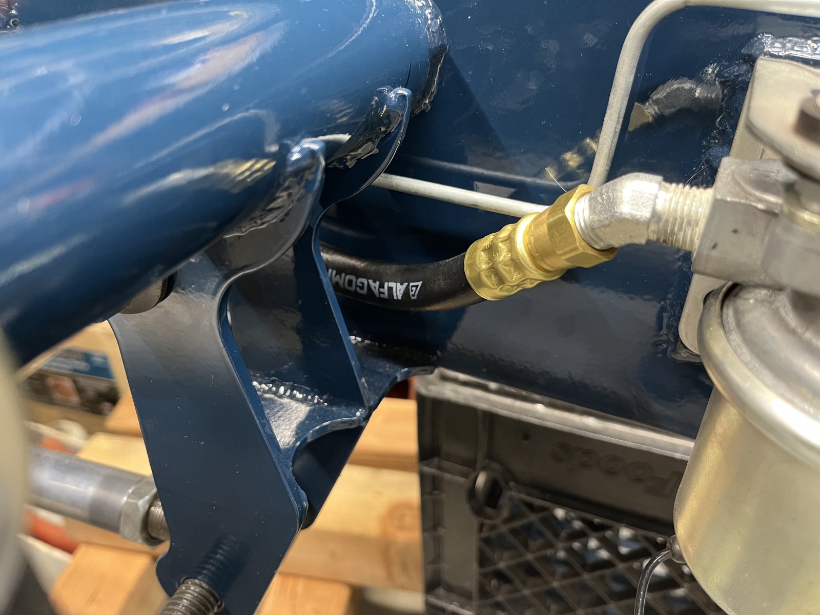

  1. @nochop where does the line from the intake go, once it gets to the other side of the firewall?
  2. nochop
    Joined: Nov 13, 2005
    Posts: 4,603
    nochop
    from norcal
    Hi Kelly. Line tees off to go to the t400 trans and vacuum gauge.
    HOTRODPRIMER and Kelly Burns like this.
  3. Thanks for clearing it up for me!

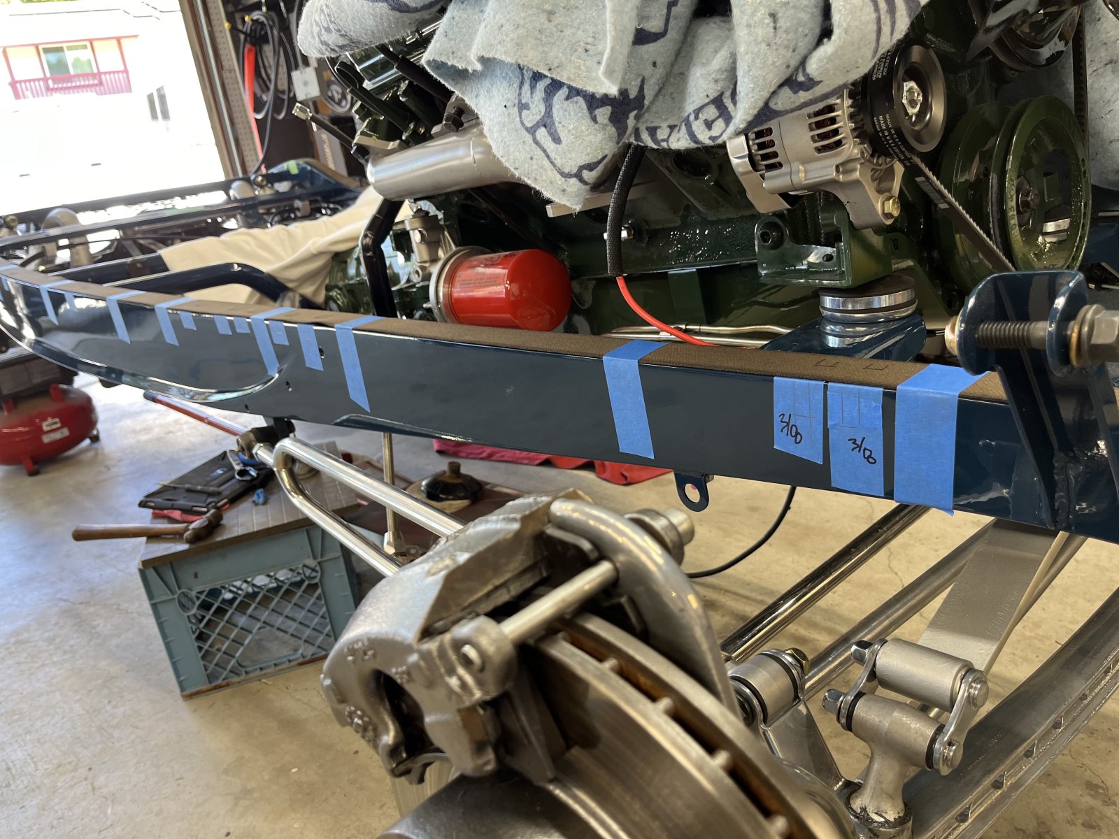

    Nibbling away at it IMG_7357.jpeg IMG_7355.jpeg IMG_7349.jpeg IMG_7345.jpeg IMG_7346.jpeg

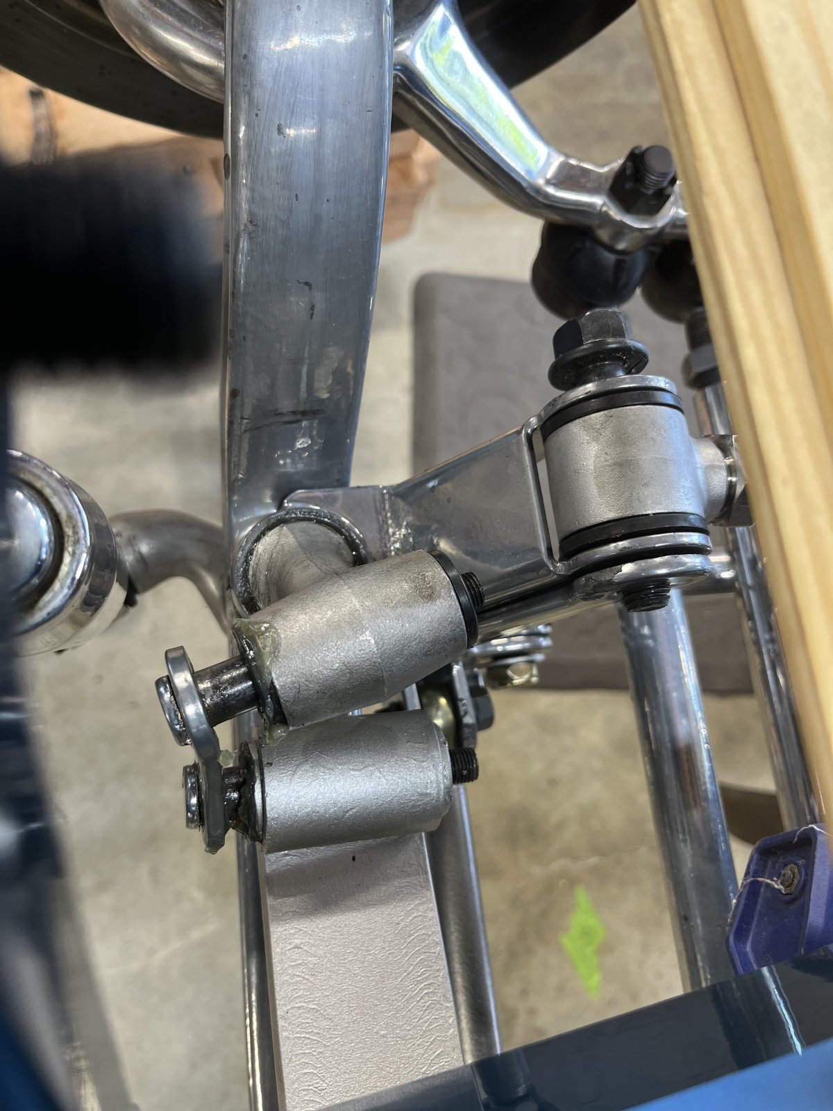

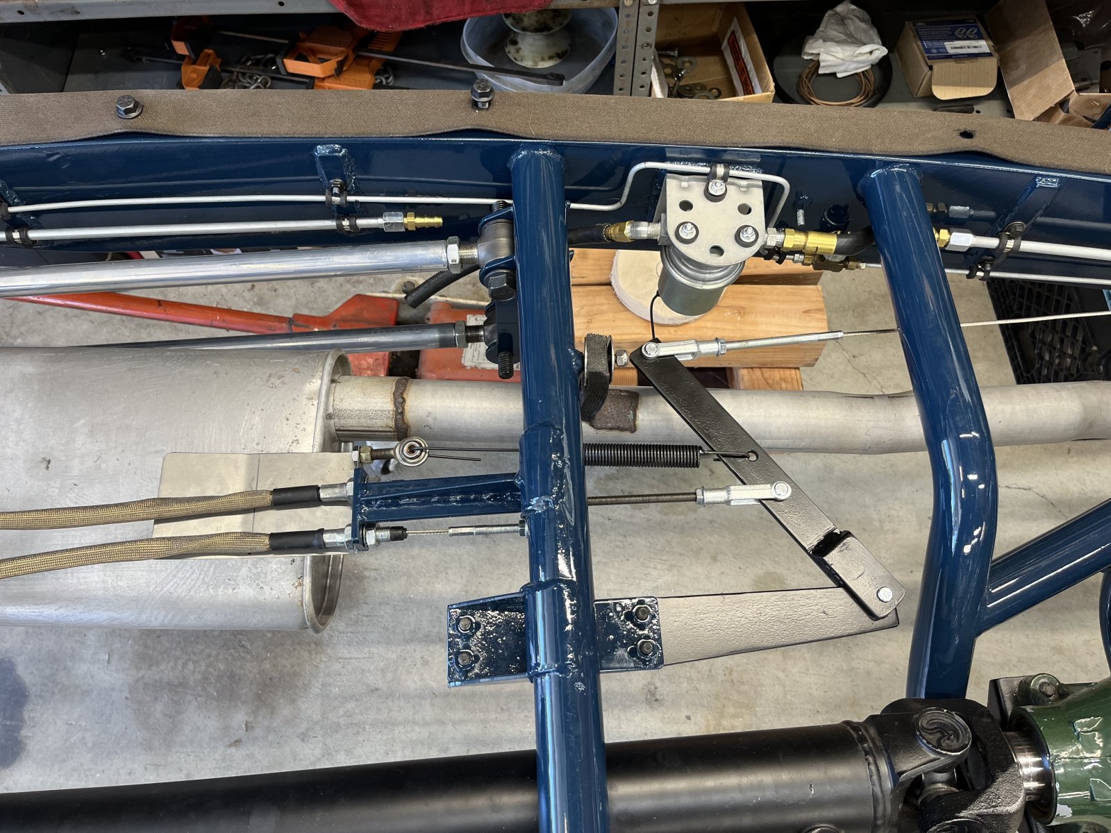

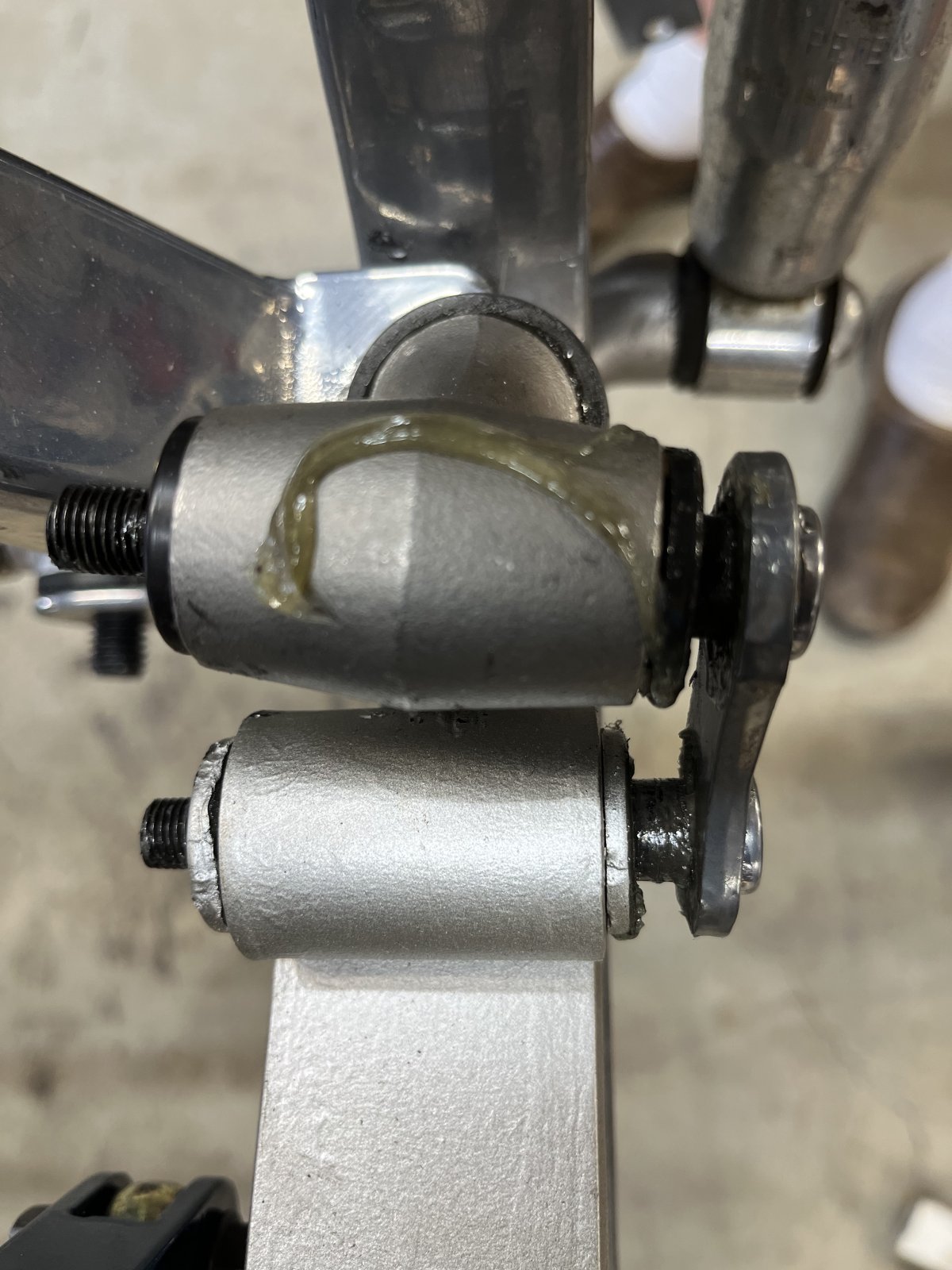

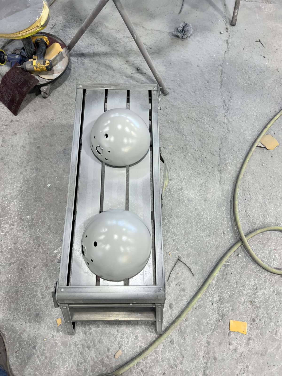

  12. nochop
    Posts: 4,603
    nochop
    from norcal

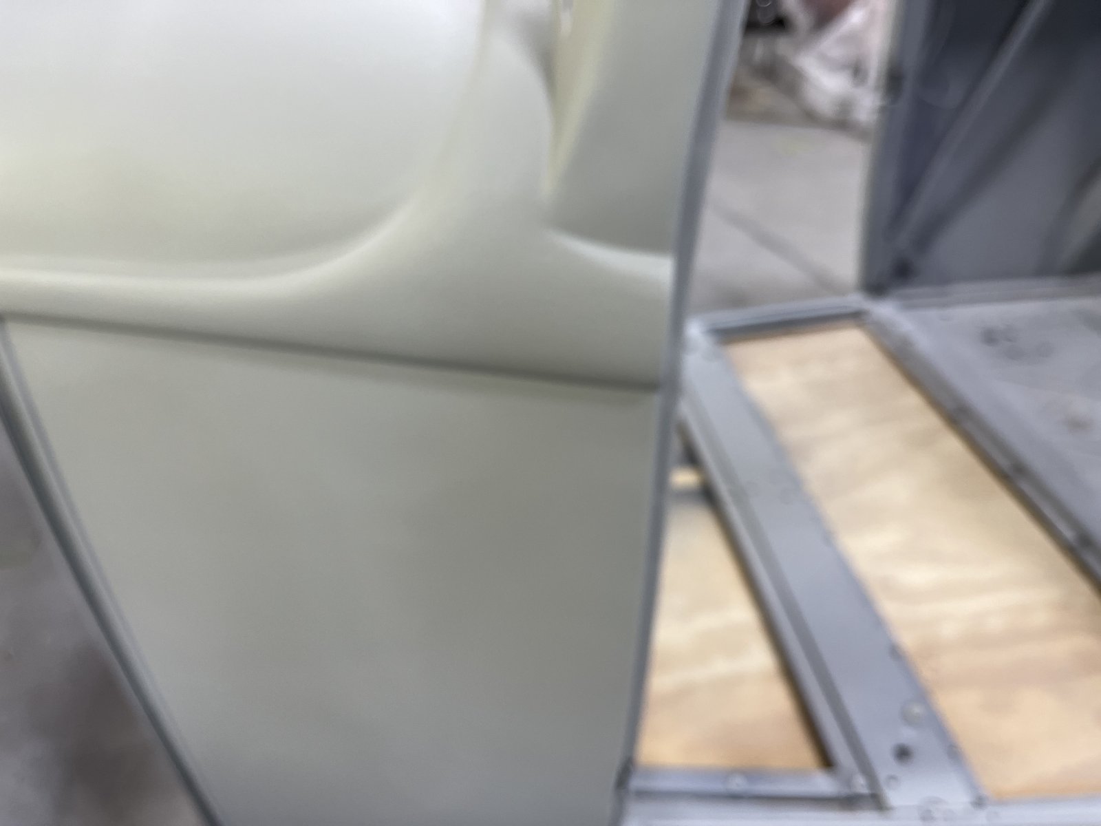

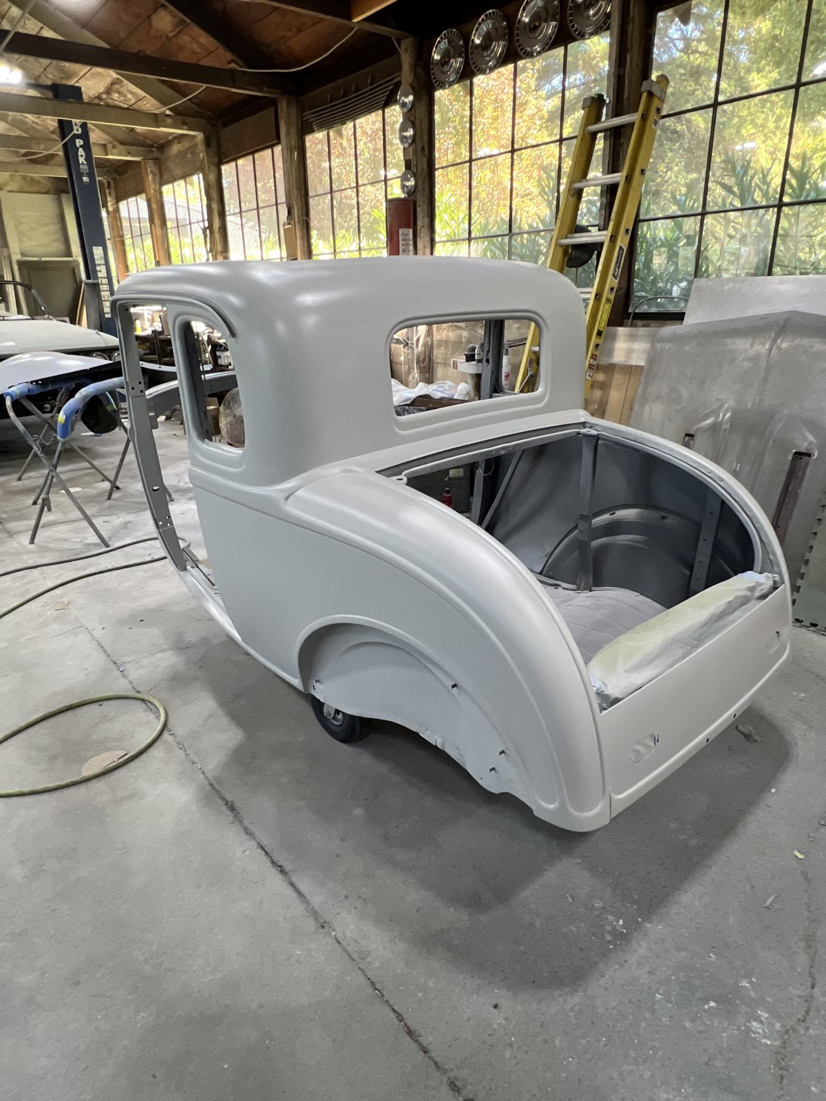

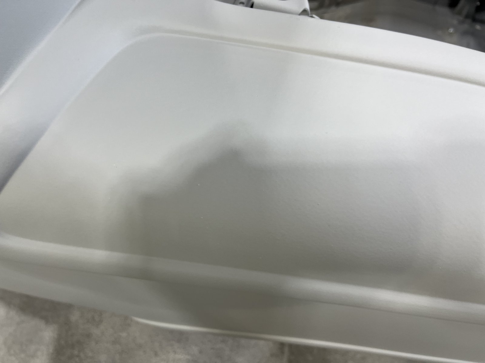

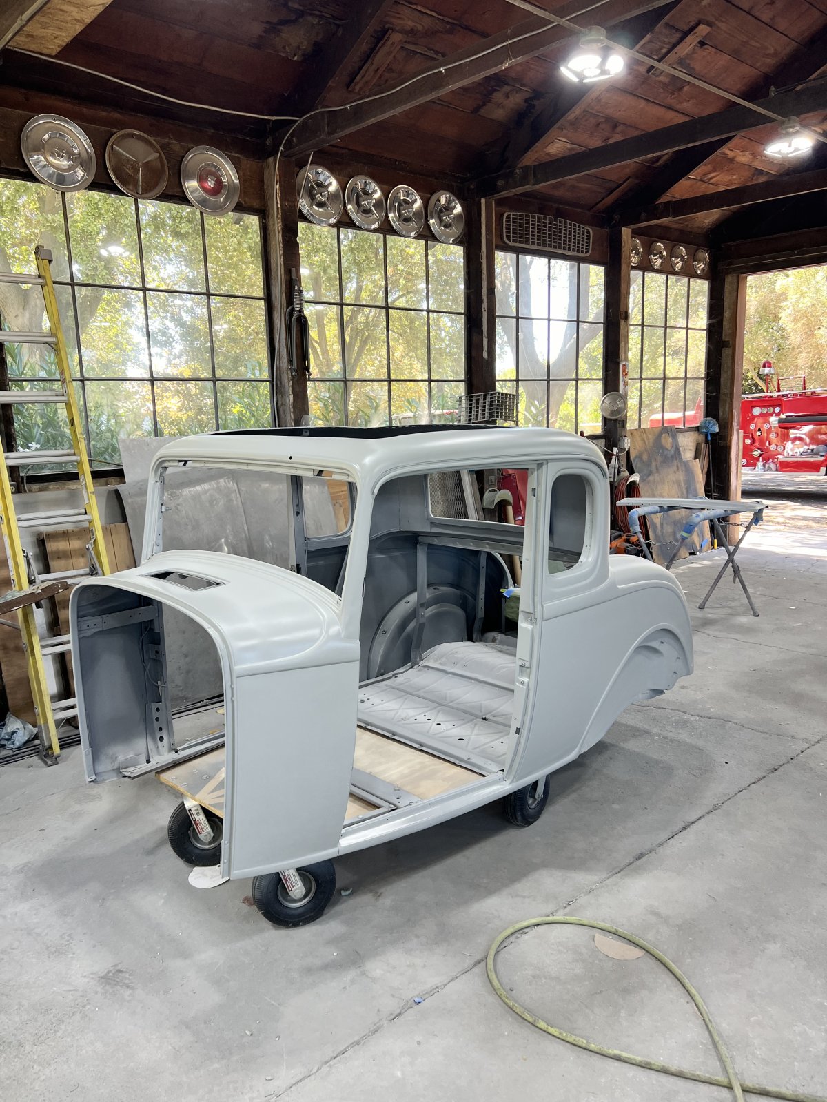

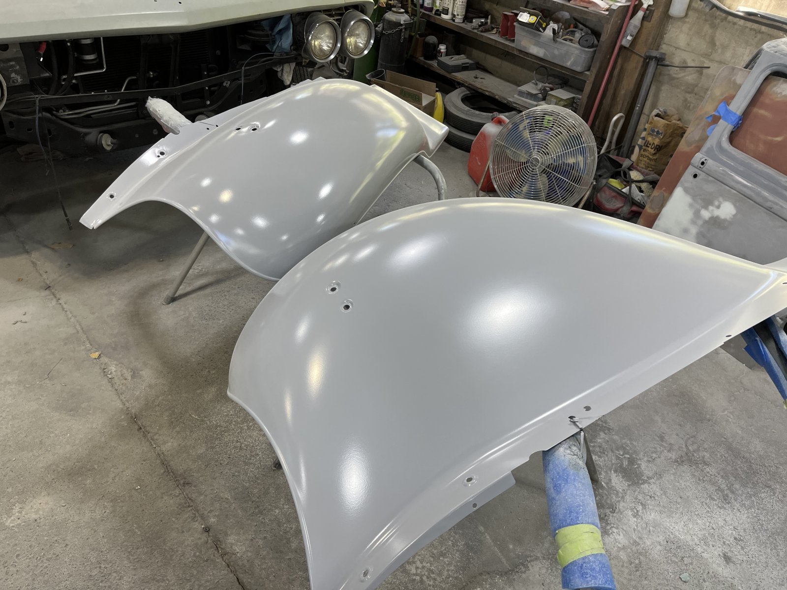

    Body guy called an said get ready, going to prime 74553446996__B9937159-AE2E-447E-A9FF-7770D9A865FC.jpeg 74553445696__B042C2FB-D32A-48A1-9ADD-D1600BD9CC3E.jpeg 74553442695__52FEC5E0-C88C-4A7C-BBC1-338998472E77.jpeg 74553441643__DAE2B777-07B6-4136-B06B-08160F35570A.jpeg 74553444703__16B76DAC-CA2B-4FE6-AD8C-98E206B2BB6F.jpeg

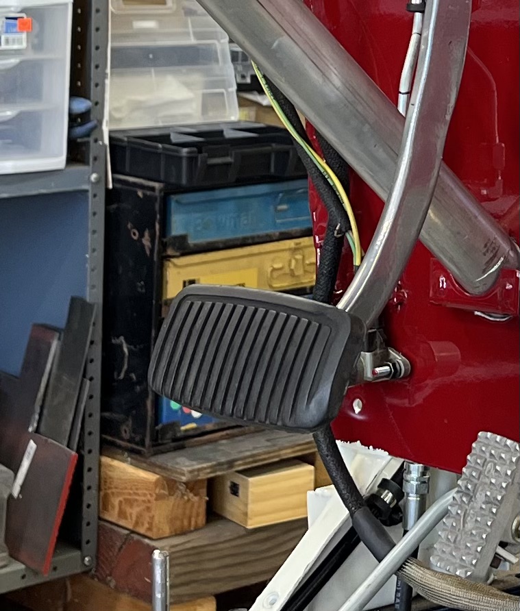

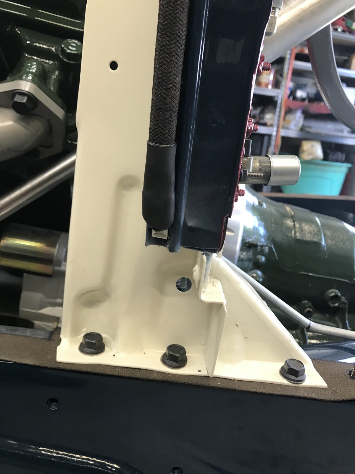

    I used this **** to restore the brake pedal. It’s been on the car since my dad built it in the late ‘50s IMG_7402.png IMG_6968.jpeg

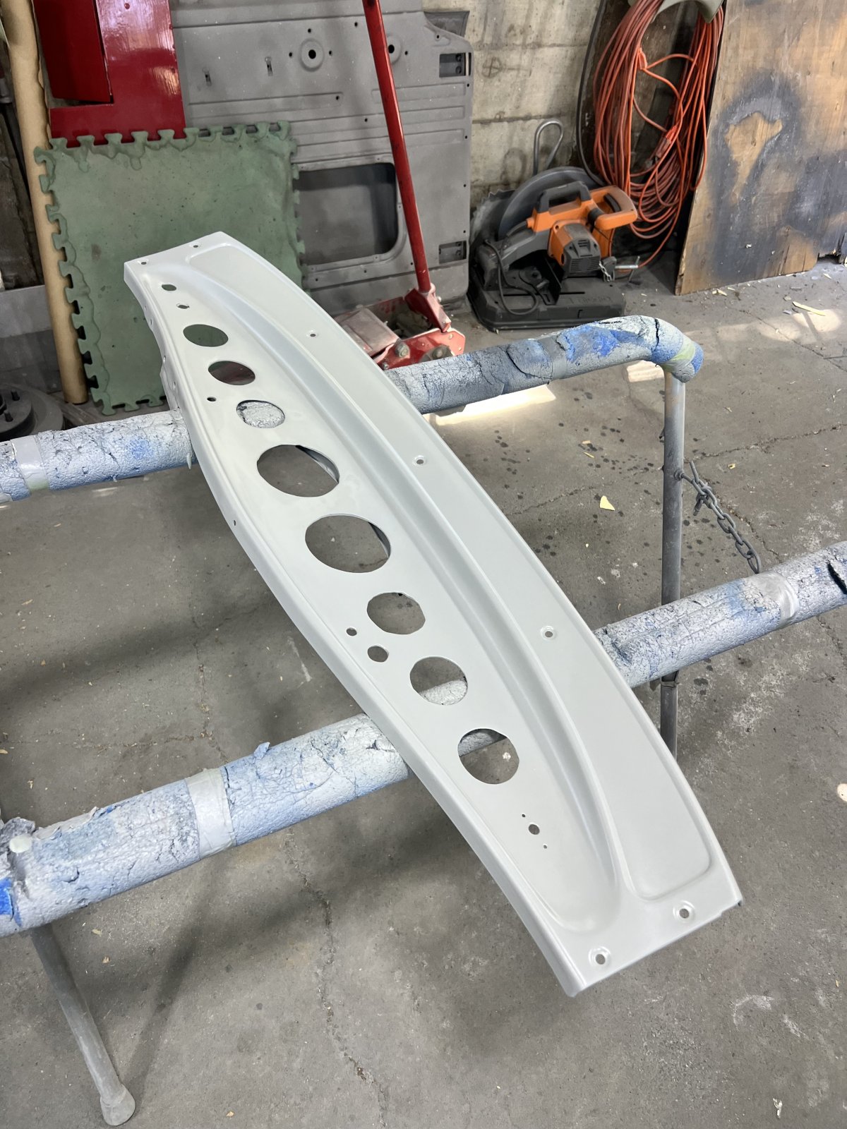

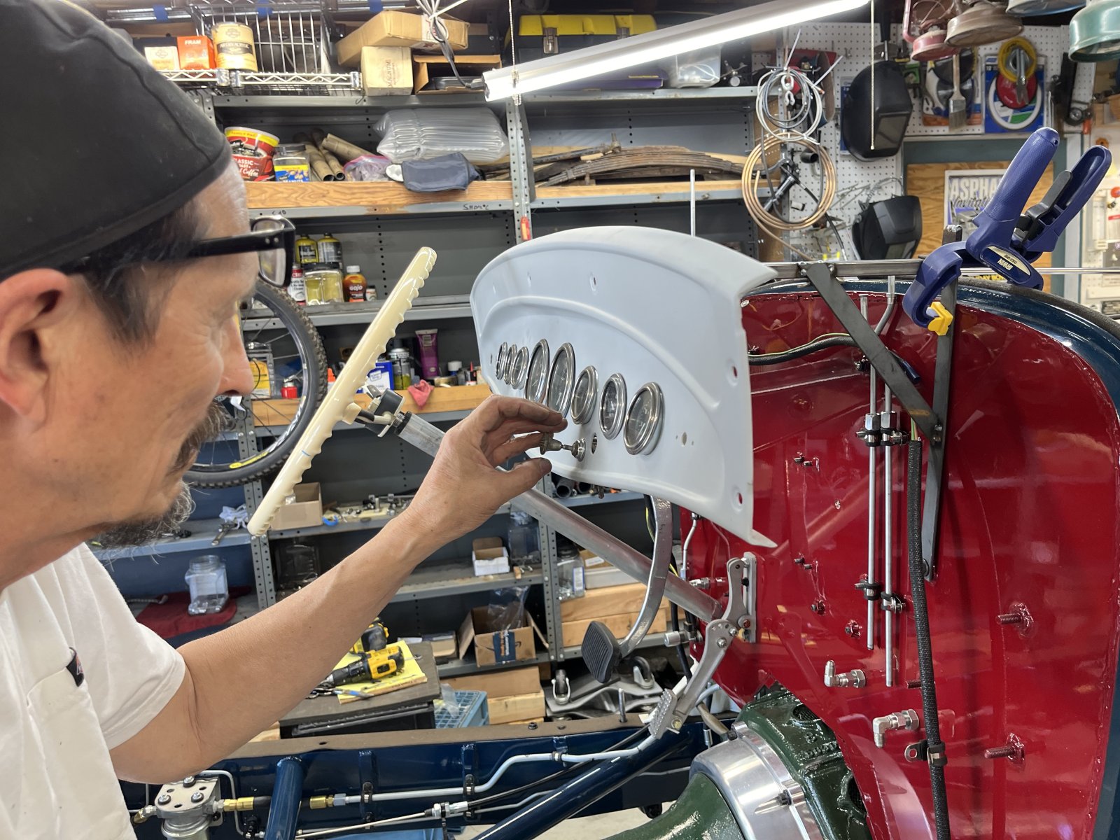

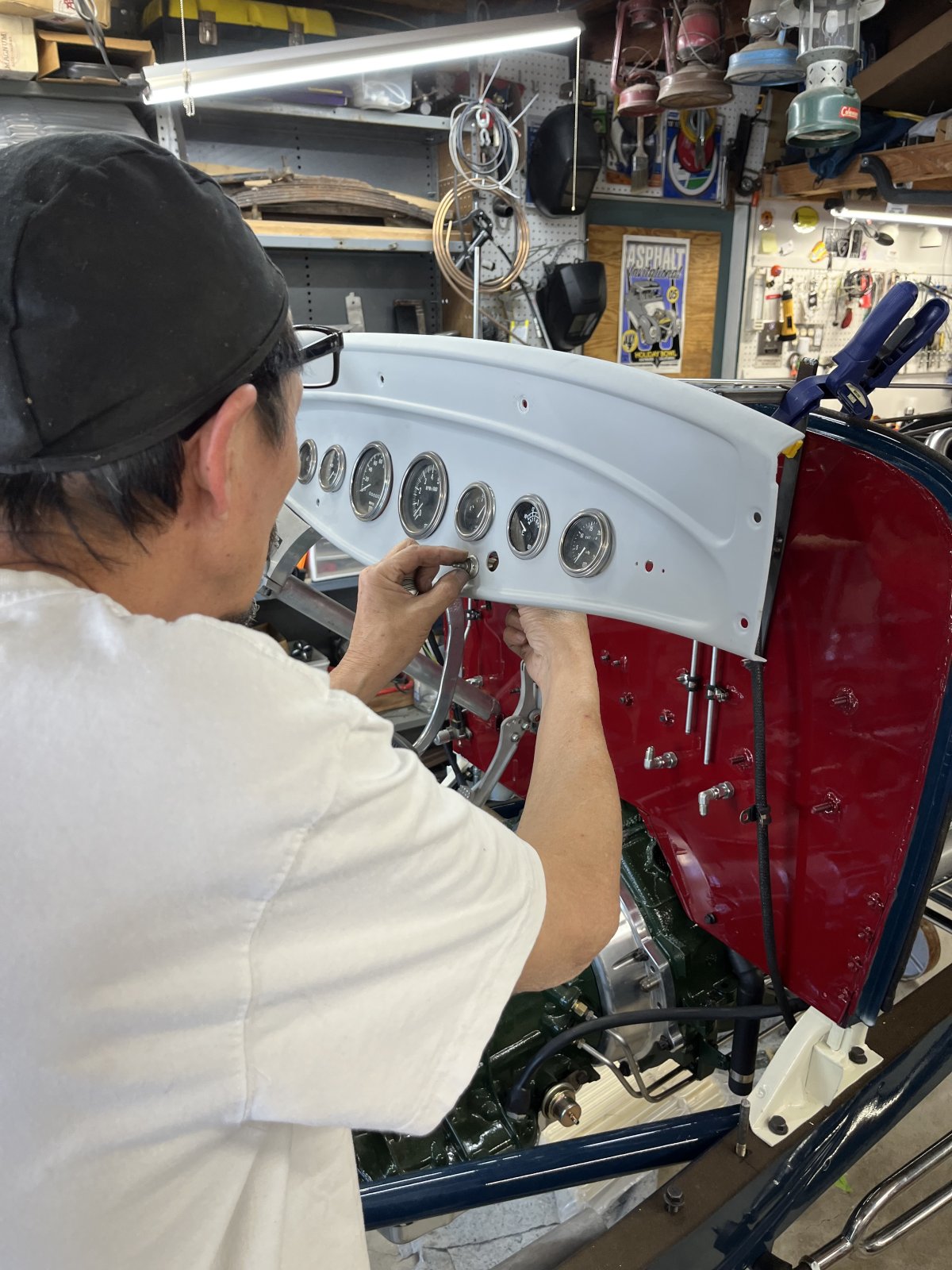

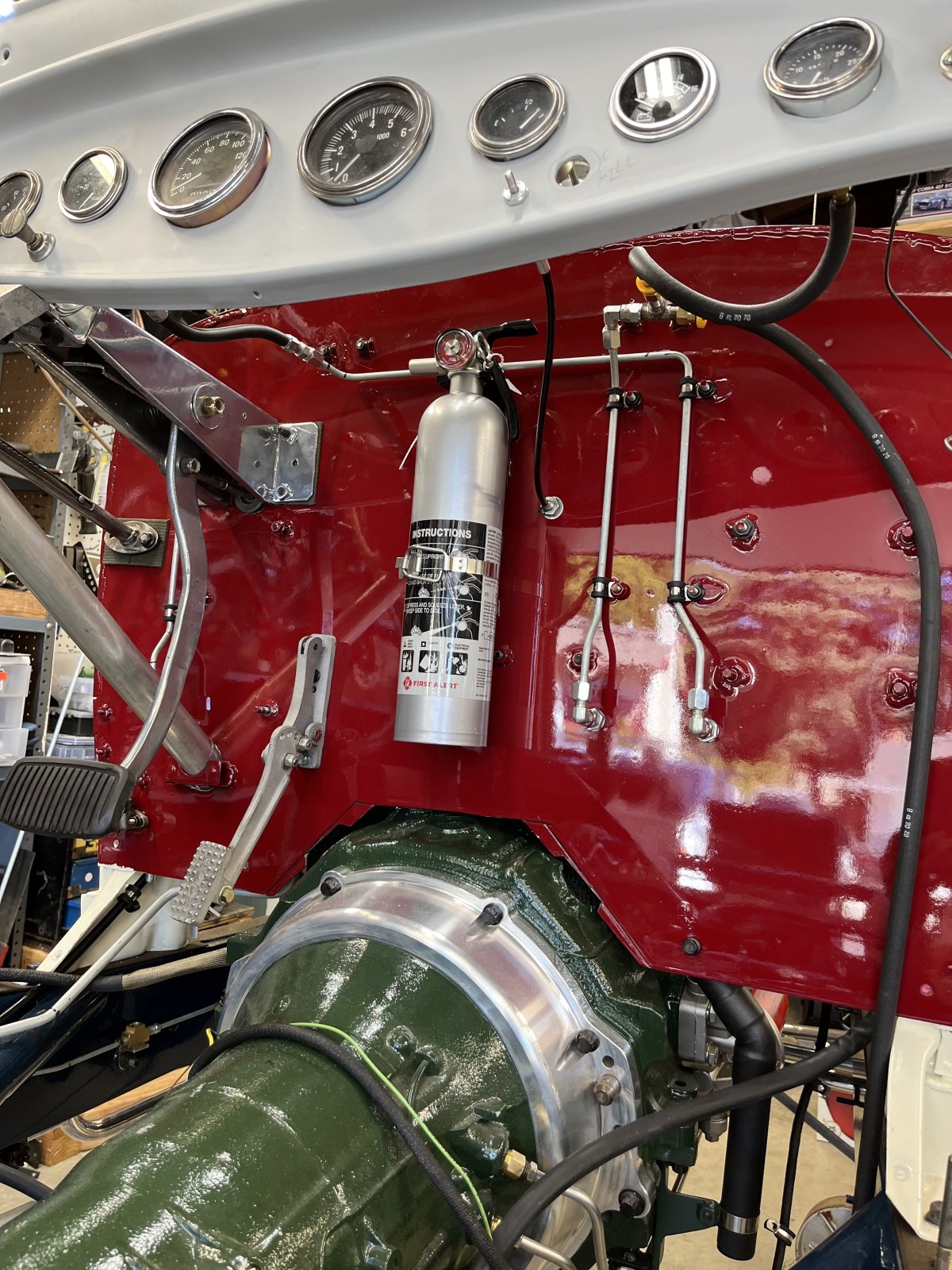

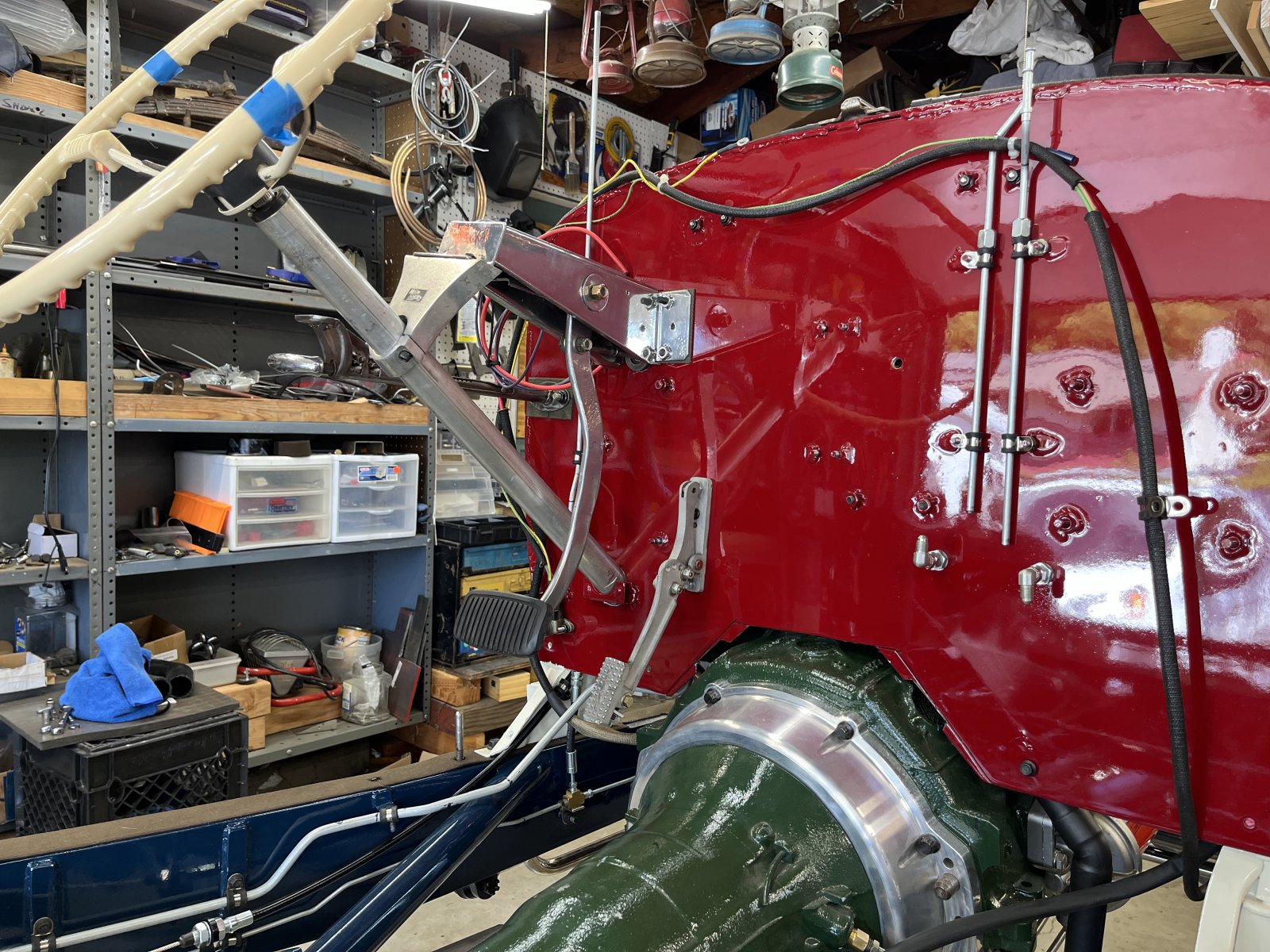

    More dash details. I have an idea on how I wanted the fire wall to end up. Sometimes a hair brain idea could or couldn’t work out. IMG_7005.jpeg IMG_7004.jpeg IMG_7003.jpeg IMG_7002.jpeg IMG_7001.jpeg IMG_6999.jpeg IMG_7006.jpeg

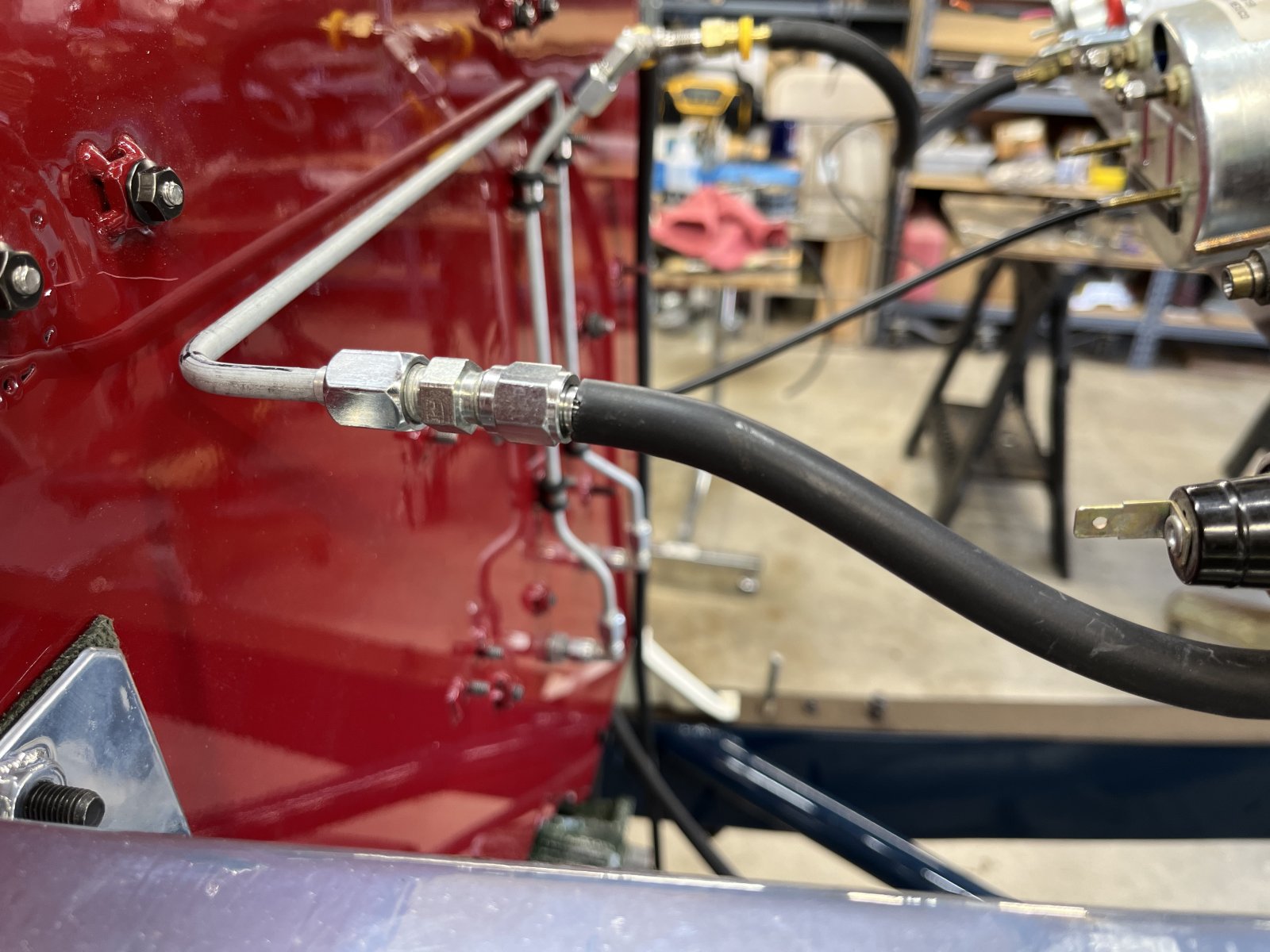

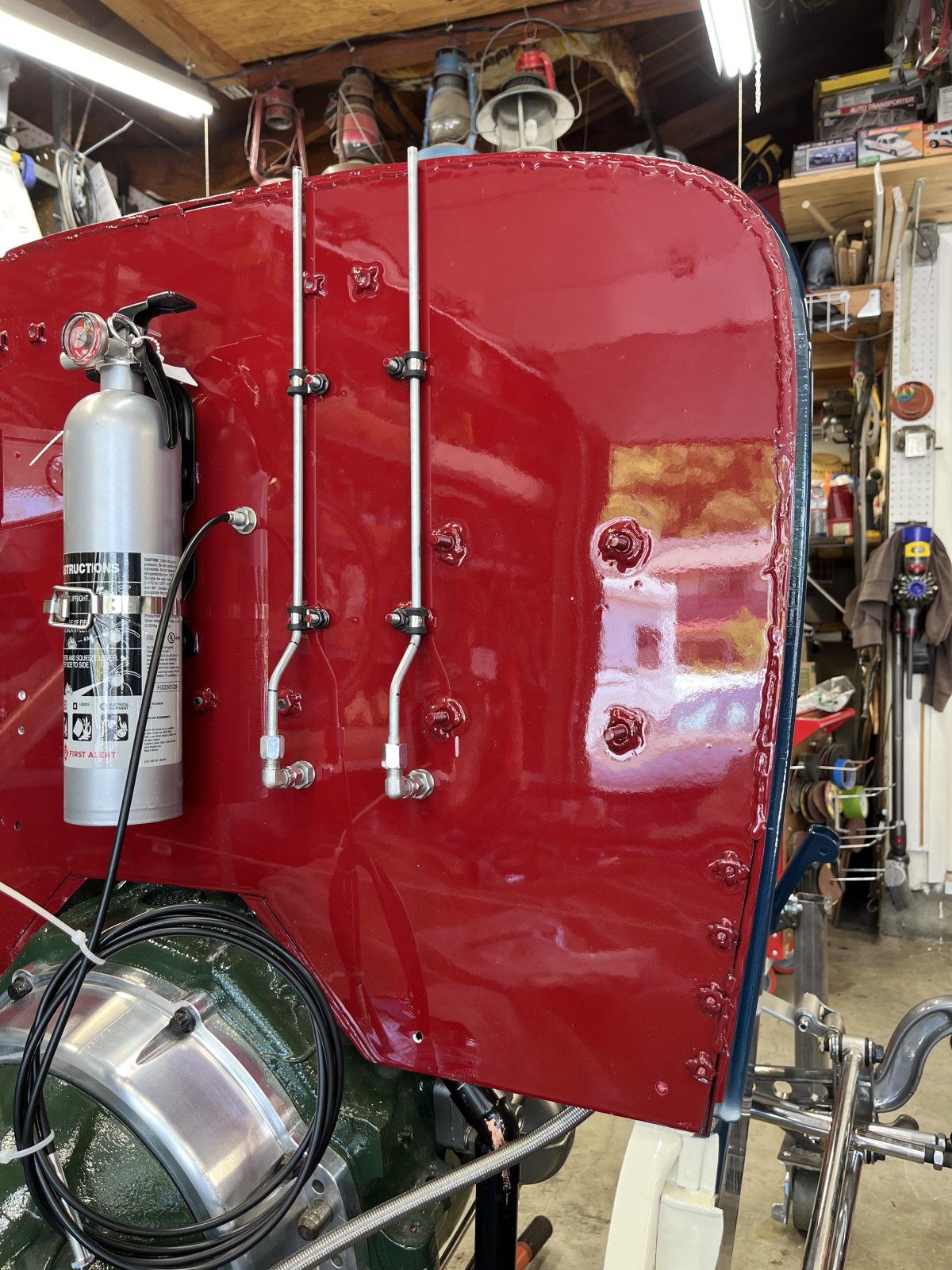

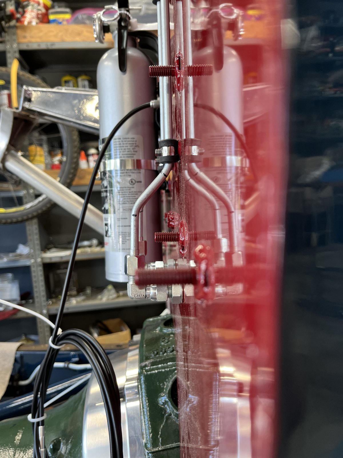

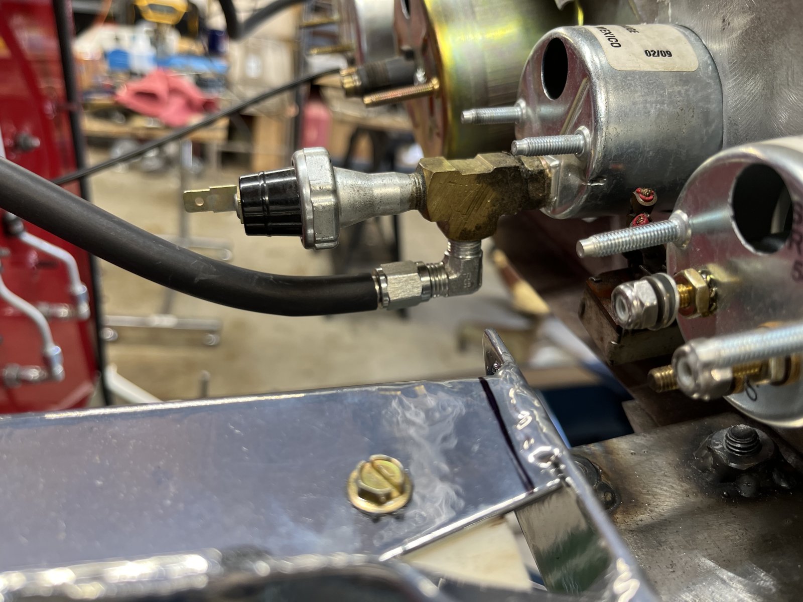

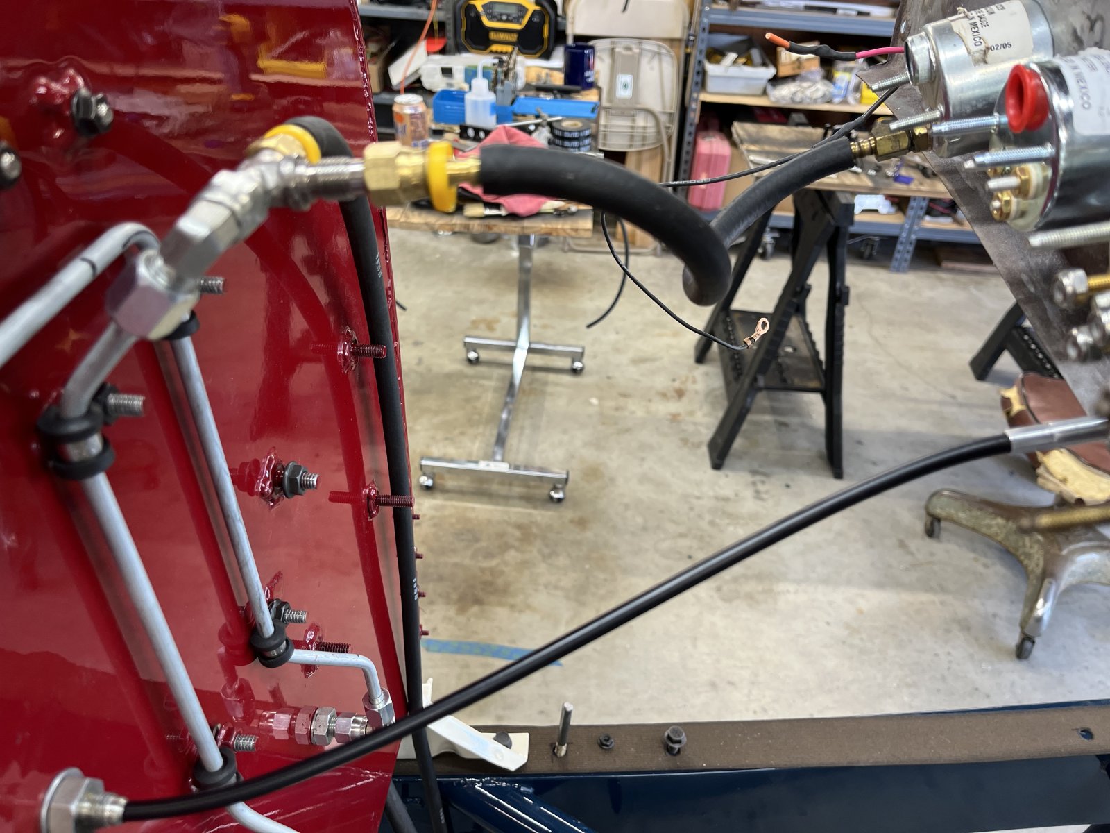

    I got my gauge (vac, oil pressure) lines back. Those things are a bit stiff IMG_7012.jpeg IMG_7011.jpeg IMG_7010.jpeg

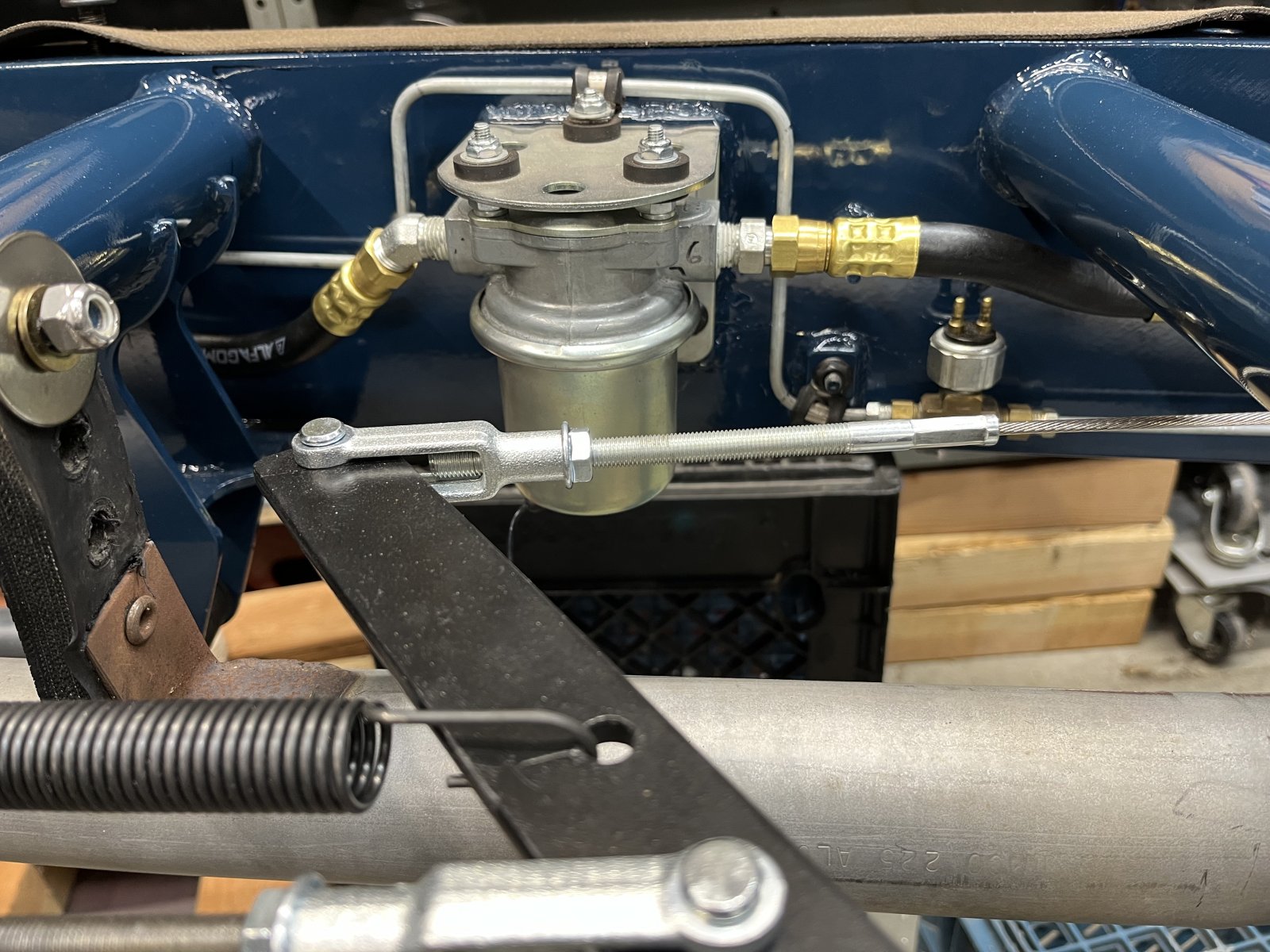

  22. vtwhead
    Joined: Oct 20, 2008
    Posts: 5,307
    vtwhead
    Are you intending to use silicone brake fluid? If so, that brake switch may only last a little while. Many have used a unit from Harley Davidson that apparently works with Dot 5. I went thru three units on my 37 while I had it but switched to a manual electric switch on the 31.
    nochop and milwscruffy like this.
  23. nochop
    Posts: 4,603
    nochop
    from norcal
    No just going to run dot 3. I may go to a mechanical switch on the pedal. I noticed that hydraulic switches are slow to react or that switch does.
    HOTRODPRIMER likes this.
  24. swifty
    Joined: Dec 25, 2005
    Posts: 2,589
    swifty
    I would definitely fit the mechanical switch. I started with a hydraulic switch and Dot 5 fluid on my 32-5 window as it was easier to fit but after 2 trips I changed to a mechanical switch. Apparently the brake lights were only on when I had my foot hard on the pedal. Got rear ended before I changed the switch, luckily no major damage. Thank God for those plastic bumpers on modern cars. Only had to re-spray the spreader bar.
    nochop likes this.
  25. nochop
    Posts: 4,603
    nochop
    from norcal
    Yup, that’s what I noticed, the hydraulic switch was put on during the first build 20+ years ago. I’ll pull it and plug it next week prior to filling and bleeding. I want to get that done before the body arrives. Yay!

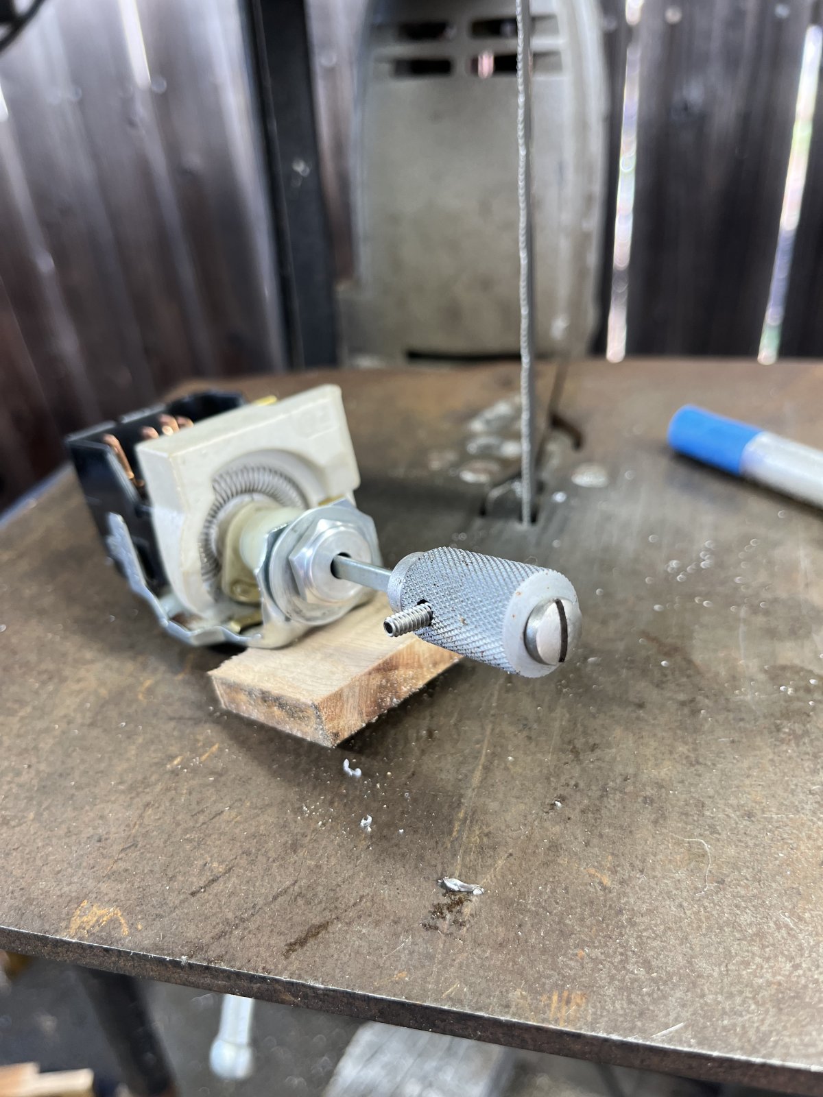

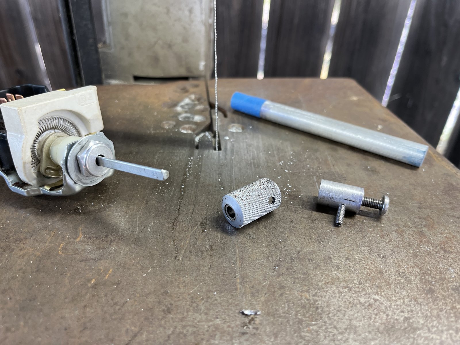

  26. nochop
    Posts: 4,603
    nochop
    from norcal

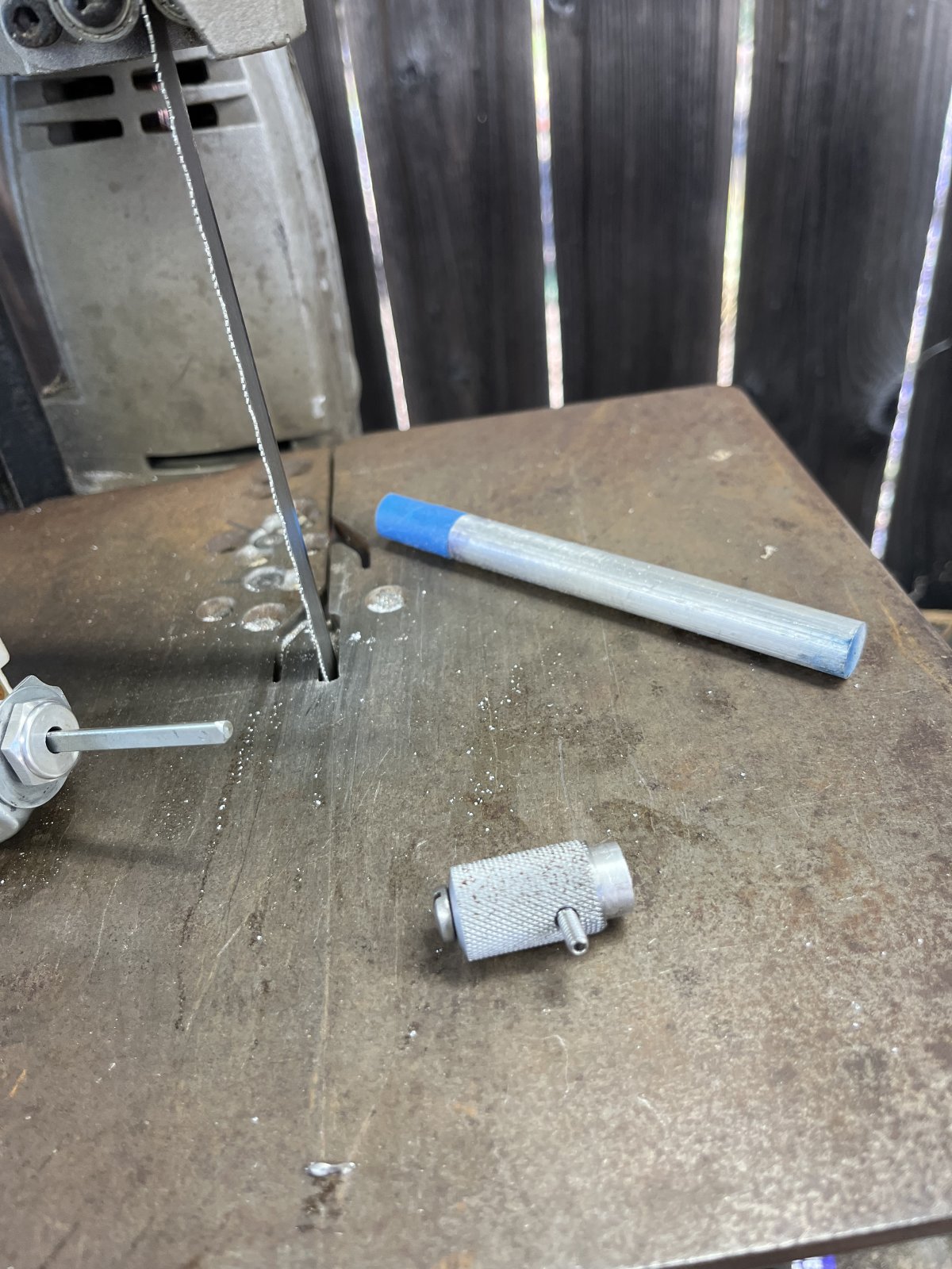

    Light switch pull, guess what I resourced IMG_7051.jpeg IMG_7052.jpeg IMG_7053.jpeg
