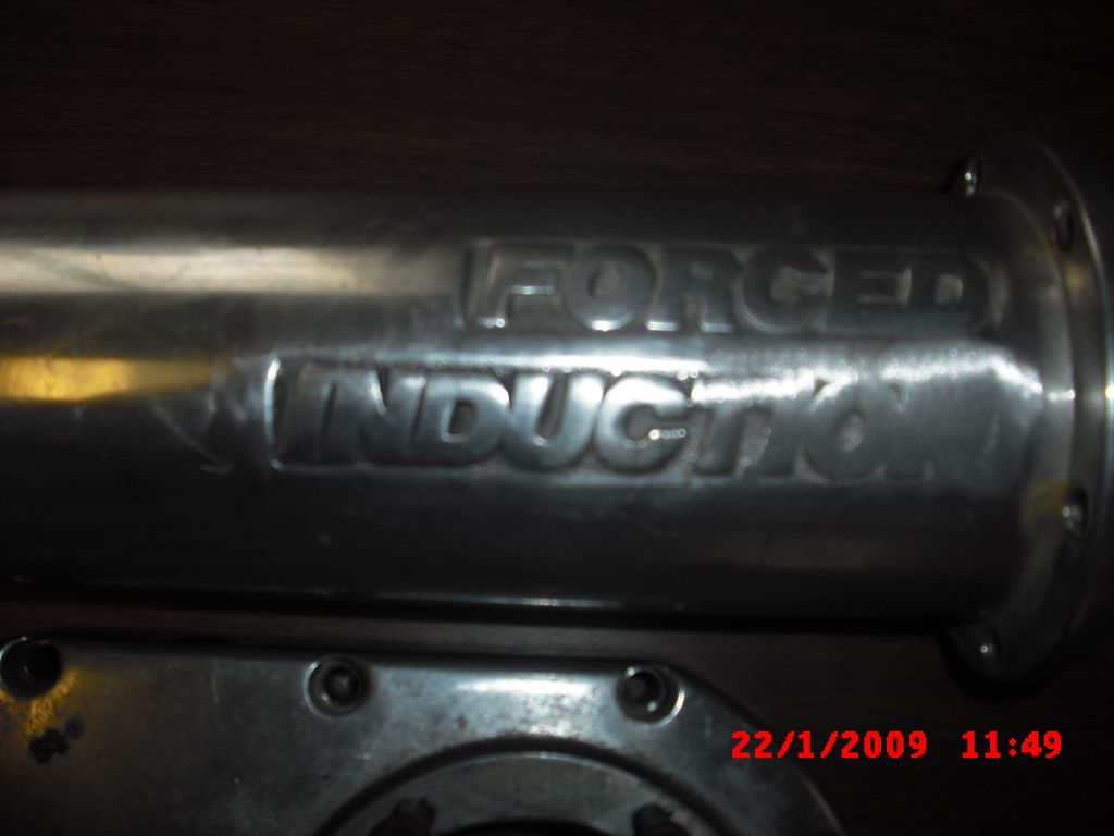

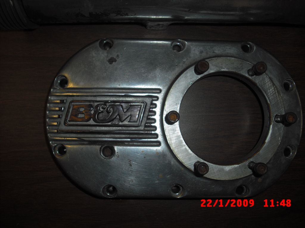

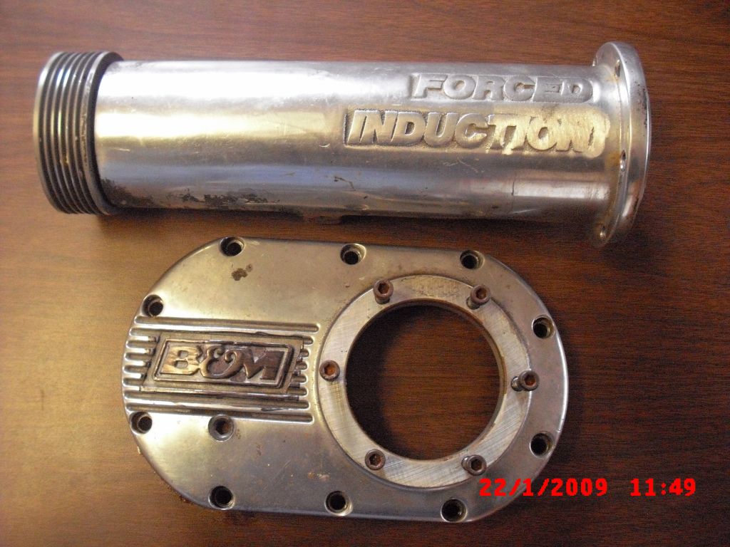

    I'm working on the aluminum alternator brackets. I also need to remove the B&M and Forced Induction logos off of the blower. As you can see in the pics, they really don't go with the build.
    I also need to replace all the cap screws in the blower, as the heads have started to rust. I'll use stainless cap screws as replacements.
    I'll post finished pics, then it will be time to polish all this aluminum!

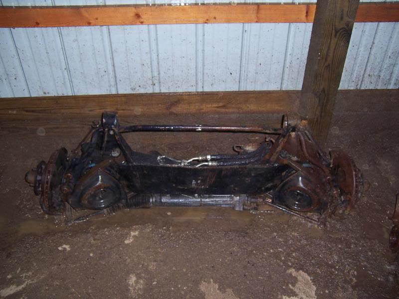

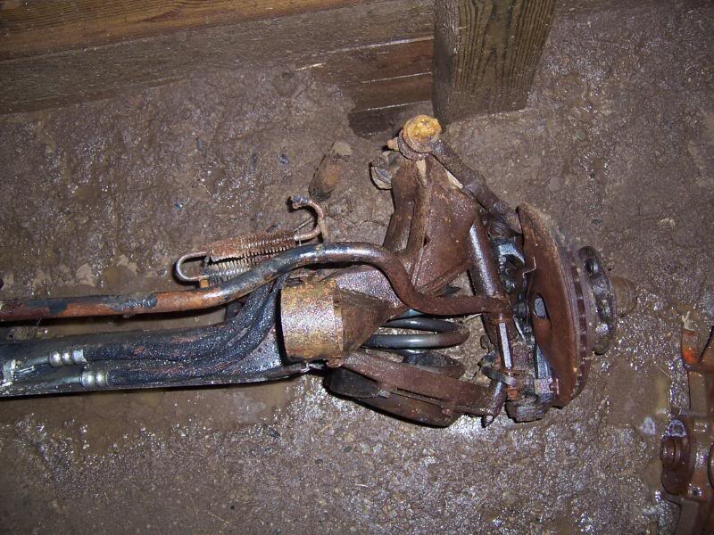

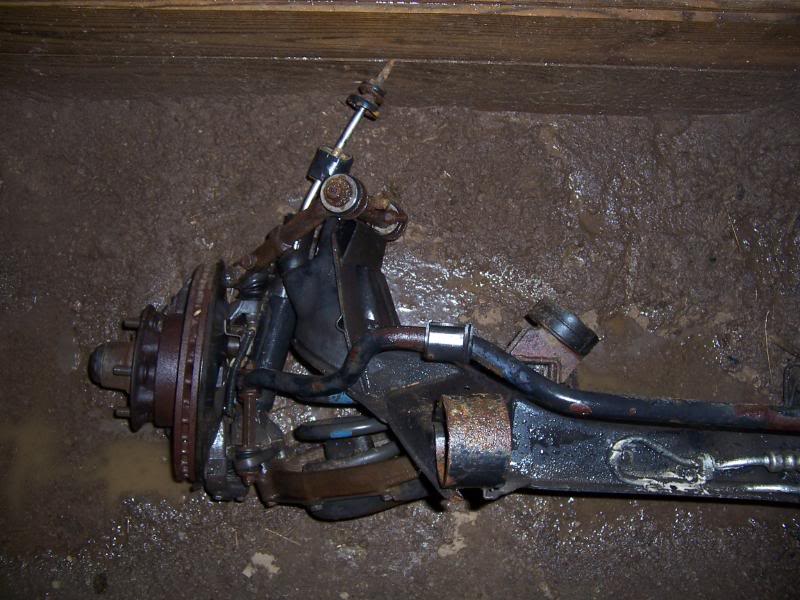

    I put a Ford 9' in, with disc brakes. I still need to fab up shock mounts. I'm running stock springs, with lowering blocks. I'm not thrilled with this setup, as I think I can do better in the suspension/handling department.
    I'm looking at a Jag disc brake, posi setup. It would offer both better suspension and handling.
    Please give me some feedback/ideas on this!

    Buddy, jag sounds good, but it can be relatively expensive to rebuild these rear ends and also to set up right with shims and pre-loads.
    You can also spend a lot of time getting your coil over shock set right for your purpose.
    If using any rear end in your Lasalle you may wish to also use a rear sway bar even on the jag or 9 inch set up.
    A friend of mine just got a more recent jag rear and installed the hubs and outboard brakes onto the early center section.
    He tells me it looks more tidy and gets rid of the inboard discs and disfunctional old style park brake arrangement.
    He just made up spacers to fit where the inboard discs were and by using the early arms etc which meant he could keep his track width within the hot rod range to suit his big rear tires etc.
    I have seen it finished and it looks sweet.
    I think you can be stuck for a selection of gear ratio's and LSD stuff, but dont quote me.

    Russ, I thought about that, but I also thought about the ride/handling, and my economics. Wayne filled me in on a lot of aspects.
    A disc brake conversion kit for the car is $1495, and I’m still stuck with stock suspension. On the rear, the Ford 9” is great, but again, stock suspension.
    <O:p
    I’m really starting to like that E***Y auction site. I was able to get a 91 Jag XKS V-12 front and rear suspension. The rear is 3.54:1 posi. There is actually a very good gear selection, as Chevy gears interchange. Cost for both was $295.
    <O:p
    <O:p
    Both cars weigh about 3800lbs, so this should be the perfect ride/handling setup.
    <O:p
    Now, I just have to figure out how to mount the damn things!
    <O:p<O:pAny volunteers?<O:p

    Buddy, most hot rodders remove the sheet metal cage and build a rectangular tube crossmember with a central kick up over the top of the pumpkin.
    You need to make a drilled place to match the bolt holes on top of the pumpkin.
    The trick is when mounting this plate to your crossmember ensure that you build in any angle to match your drive shaft stuff.
    Usually 1/8" or thicker tube is all you will need, the top pumpkin mounting plate should be about 3/8" thick or similar.
    Note that the original pumpkin bolys have a beveled shank up near the head so if you plan on using them just build in your bevelled edged holes into the mounting plate.
    The jag rear that you have maybe new but it is still the conventional style which is fine, the newer items have the disc brakes out board as I mentioned earlier.
    Your crossmember should look a little like a squared off model A rear crossmember for want of a better description.
    I will try and gets some pic's from my friend and post them for you over the weekend.
    The other thing is to keep the radius rods and rubbers etc, it is advisable to make longer rods if you can since you are custom fitting it.
    In an earlier project my friend installed vented rear disc's inboard to one of these rears and used modern front calipers out back and shaved the diff cover to get it to be more of a quick brake pad change thing, also looked tidy.
    I dont somehow think you have the time to play with stuff you just need to get it done.
    Make sure you have plenty of top of tire clearance as the top of your wheel swings in as it rides over bumps and if your clearances are taken into consideration you may get some tire s****e.
    I like looking at these rears but not sure about wanting to own one over the long term.
    Pic's soon I hope.
