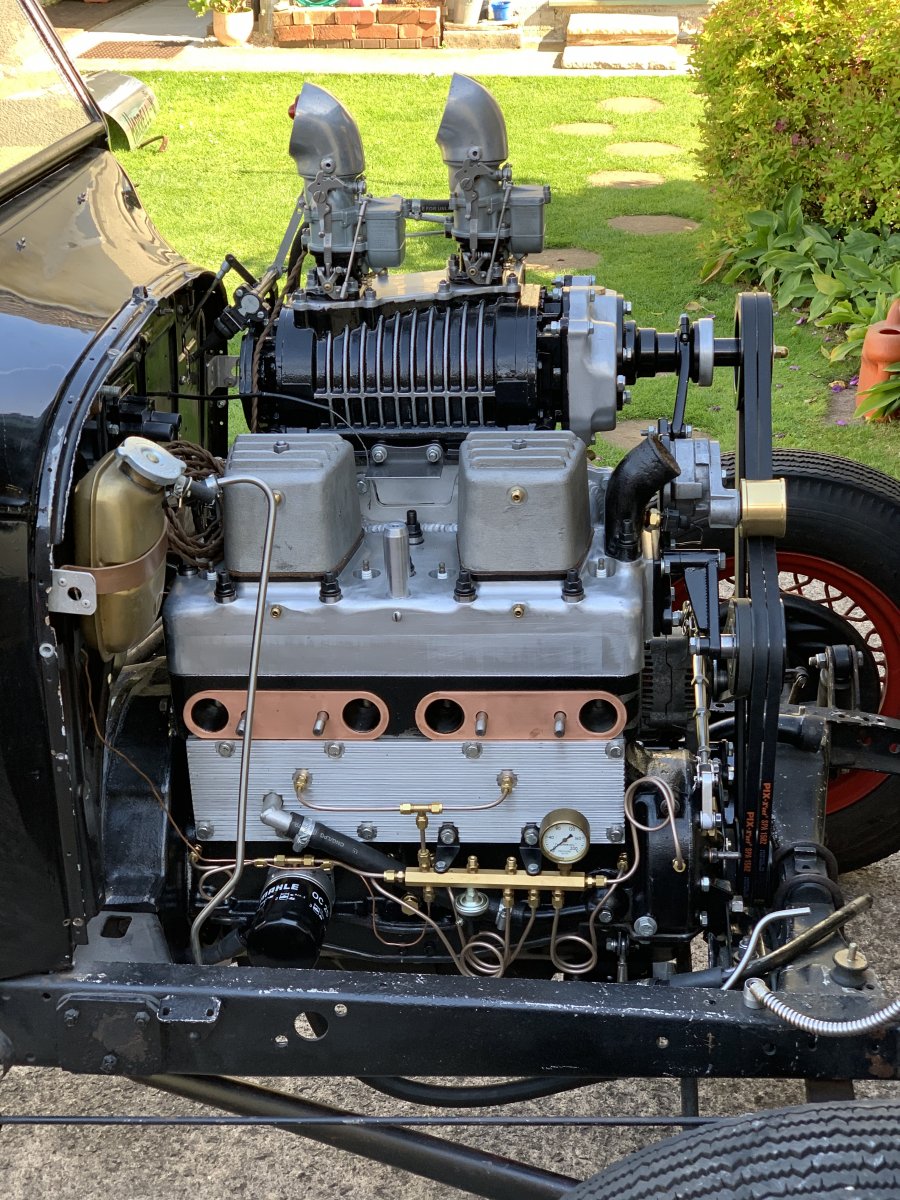

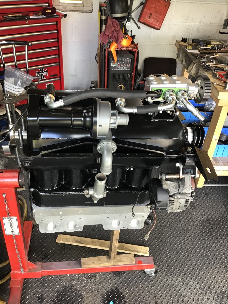

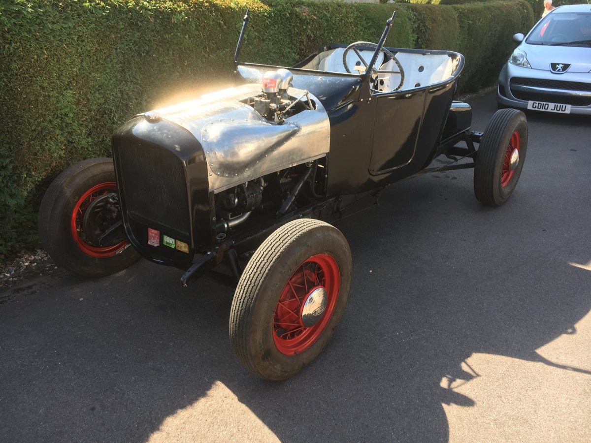

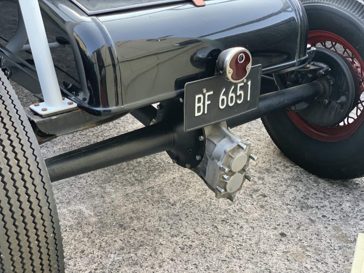

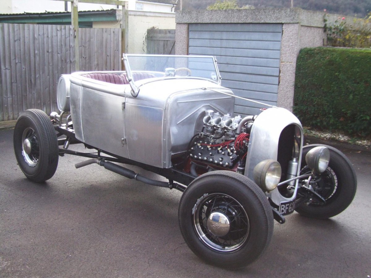

    A couple of years ago I did a trade with my old modified for a T bodied, A chissis’d car with a blown F head 4 banger. I loved the car but the owner was starting to hate it. The reason for this was it never ran properly, and kept having failure after failure.
    I guess I’m a bit of a ****er, but the trade for a perfectly good and reliable hand made car for something that had issues seemed to make sense at the time. How little did I know?
    This is my old modified during the build. Build thread here https://www.jalopyjournal.com/forum/threads/time-to-build-a-new-car-for-the-hills.737344/

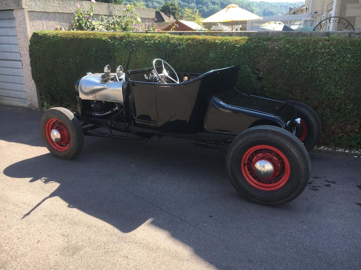

    And this is the new T’n’A being driven by Jamie, the previous owner.
    E181F10F-03F9-42F3-A2D5-0B815046C791.jpeg B11CE721-7D19-426E-BEFD-3DBF64FD0376.jpeg 74E15BD8-220D-4095-AE27-04AD12312874.jpeg 20DEBB23-1B44-4CA9-9780-0AFB4EB9B957.jpeg 3B9DD460-0262-4BA5-BA15-384F082C9332.jpeg

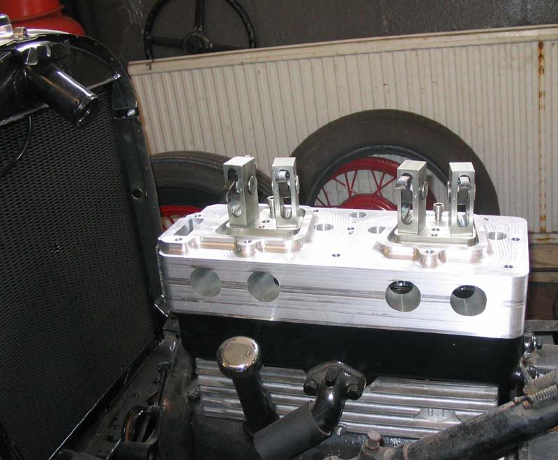

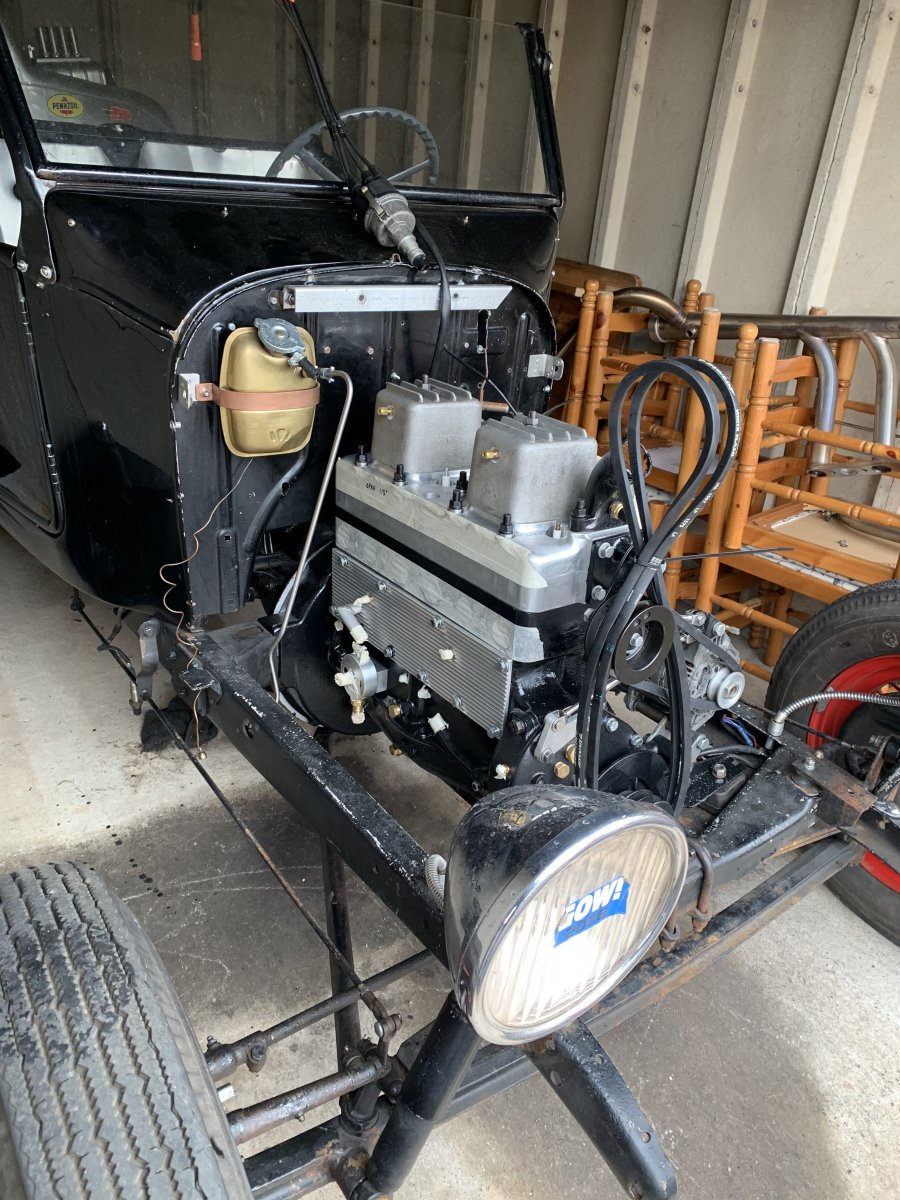

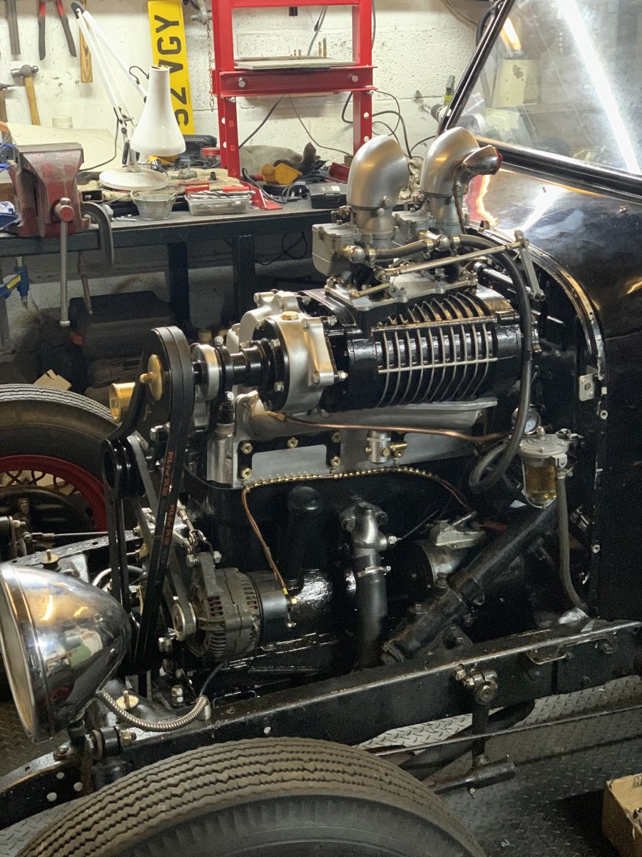

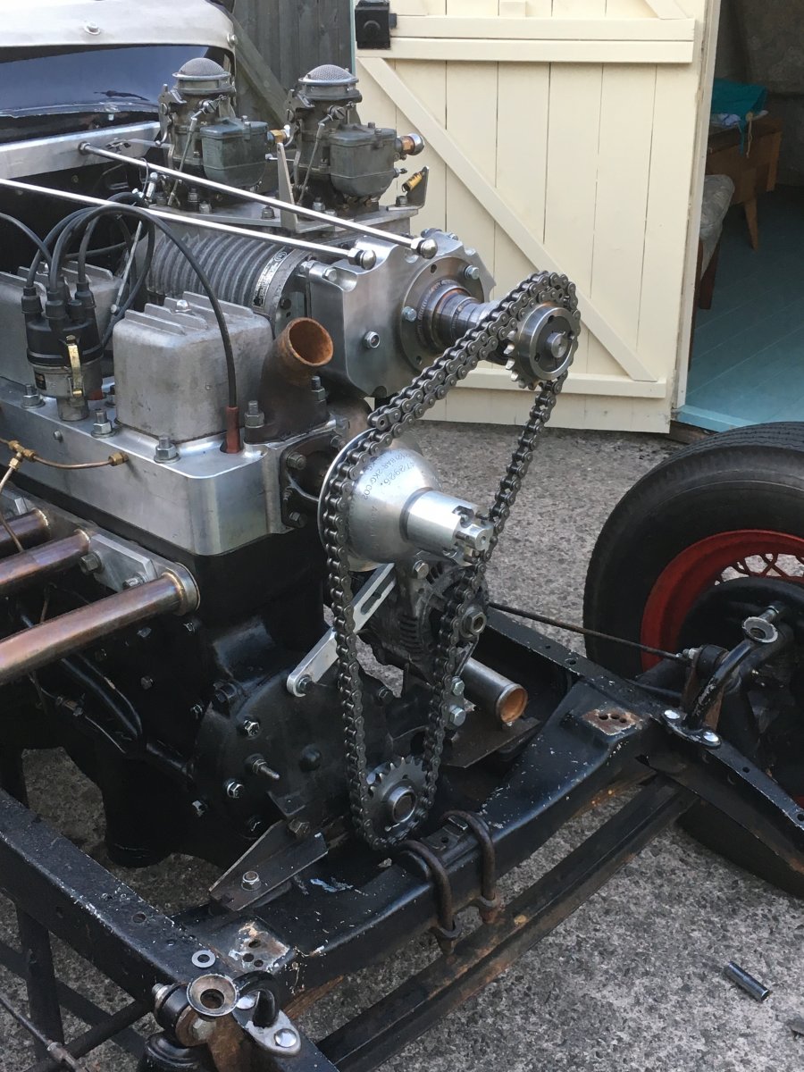

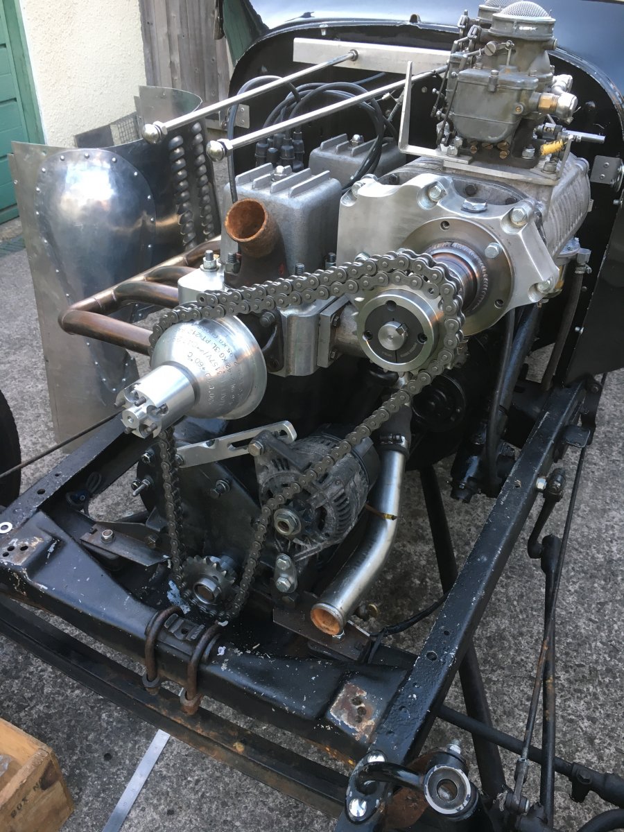

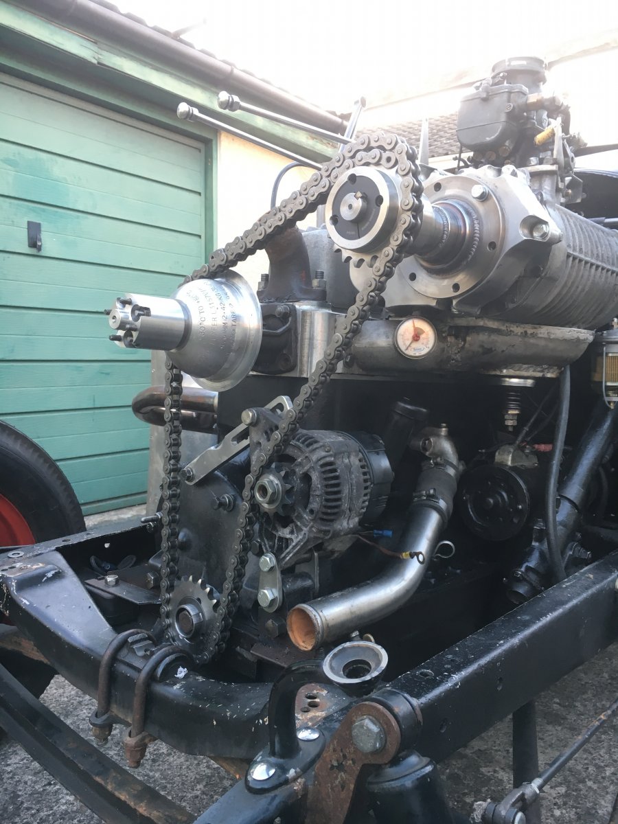

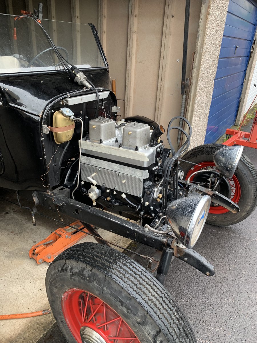

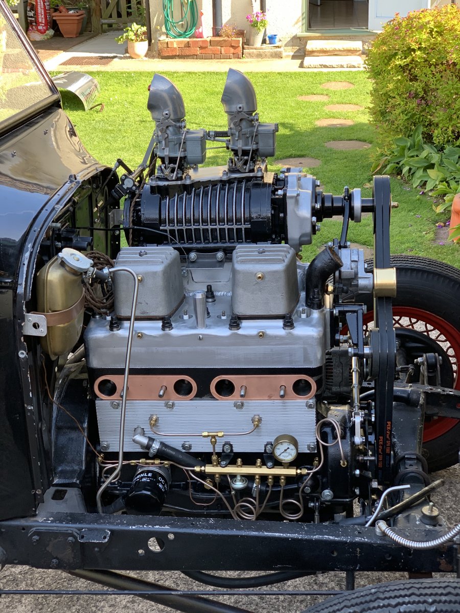

    The motor. ‘28 A fitted with a Belcher Engineering billet 2 piece head with overhead inlet, **** crank and rods etc, and a Wade RO34 supercharger as fitted to a Comma TS3. If you’ve never seen a TS3 then google one and have a look at its engine.
    9AF1EC93-7705-4541-8655-BD7C19A3B39B.jpeg C3AA1851-5A3A-4F36-8CF0-9CC4D22308A7.jpeg D53A3350-3585-4960-BFA7-F9CB74E29888.jpeg
    So far so good. I played with if for a bit, changed a few things about and set about trying to dial it in. That’s when the trouble started. My first problem was the vibration. Way too much. I know bangers do have their own vibrating style, but something was definitely wrong. The blower was a problem too. In stock form the bearings are not sealed, allowing oil to p*** through to aid oiling to two stroke TS3 engine. But this meant that if you topped up the oil in the front gears it just got ****ed through and smoked until the oil was empty. What this actually meant was that it was also ****ing in air after the carbs. M
    More to follow

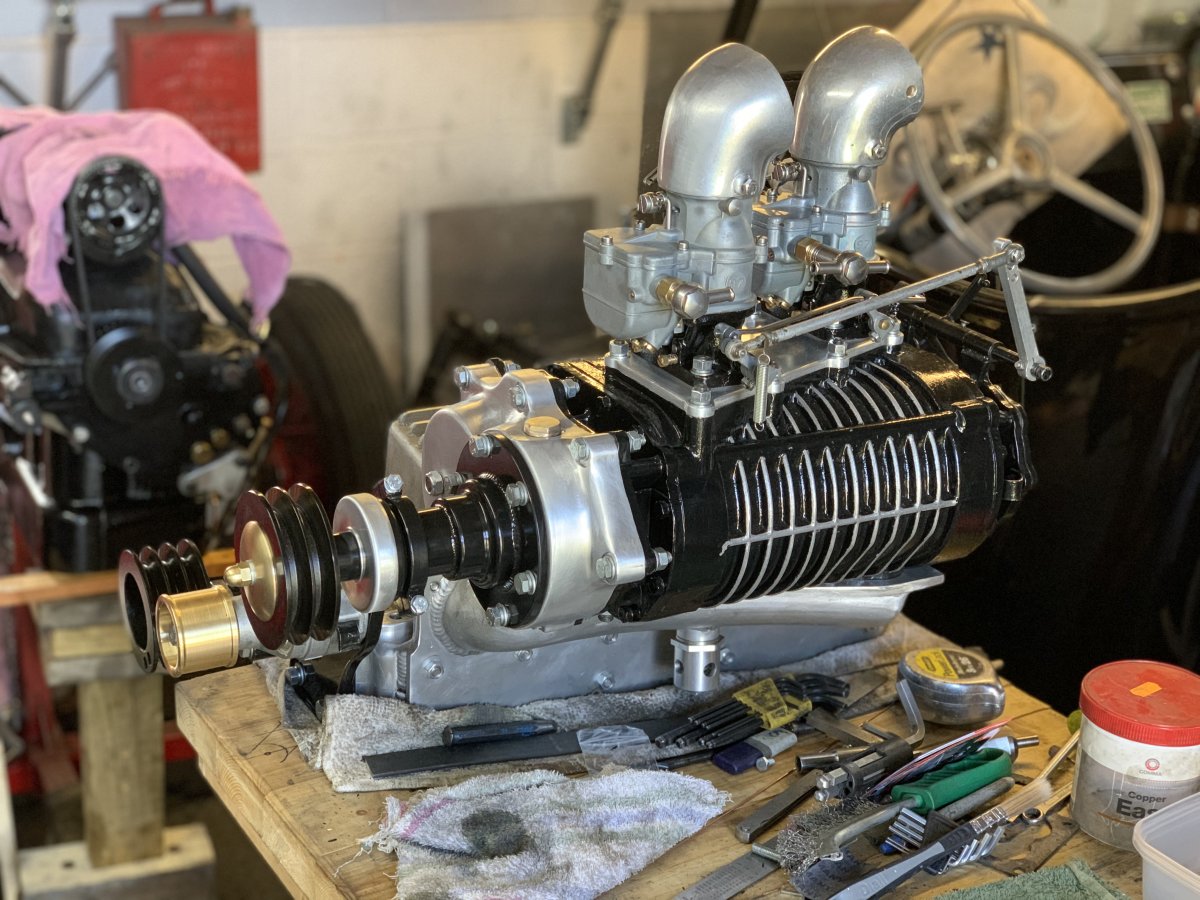

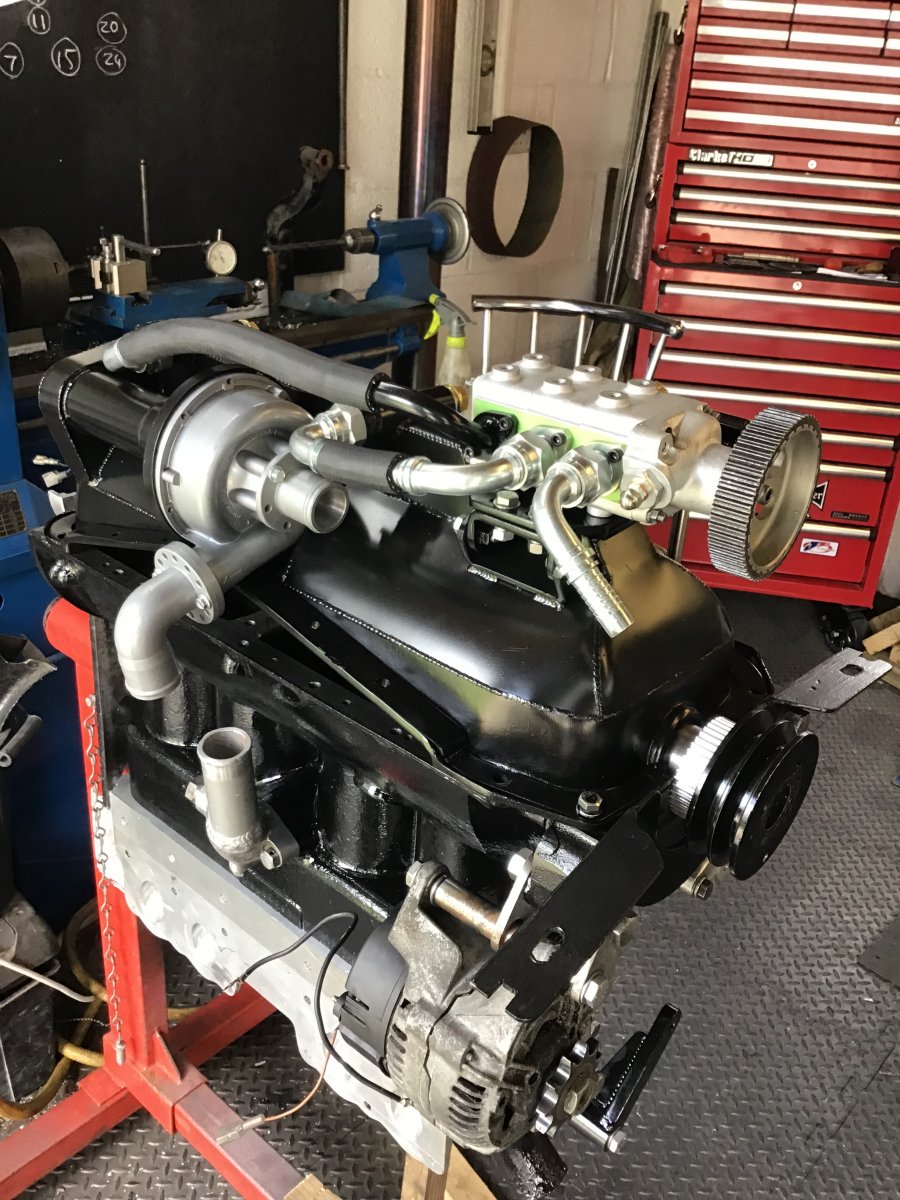

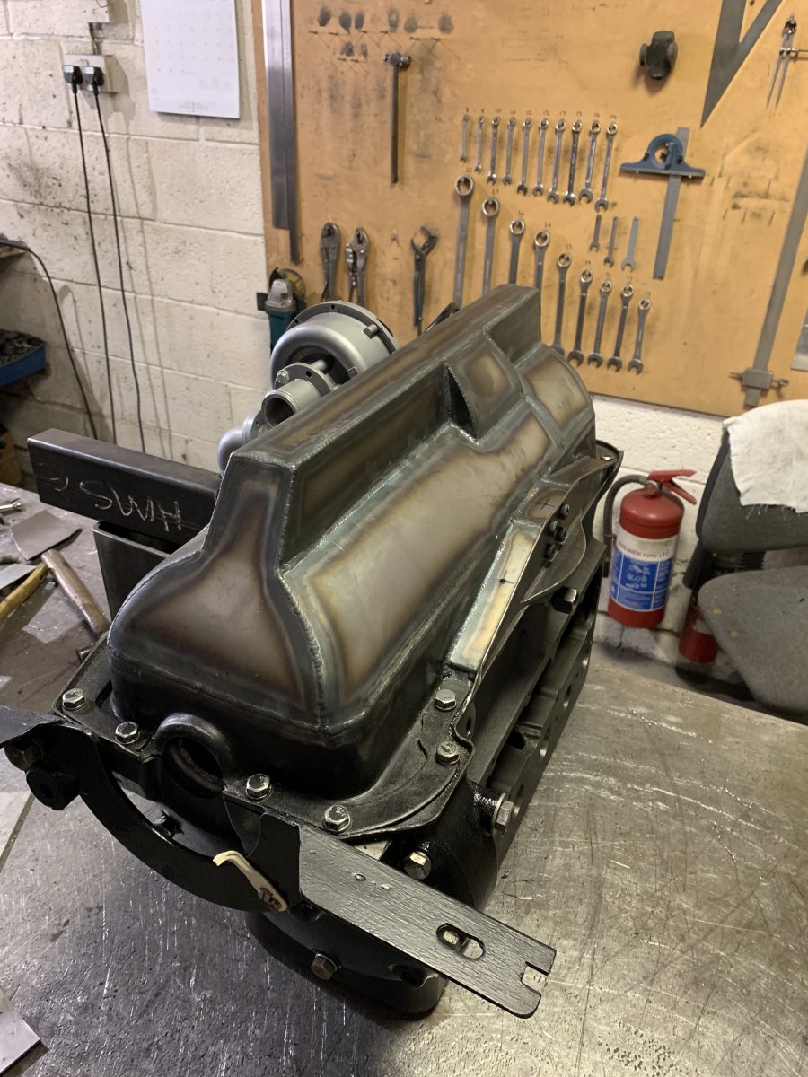

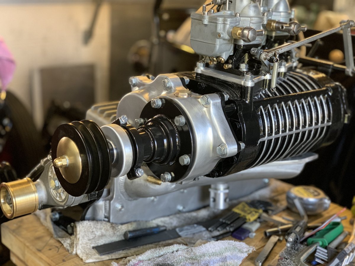

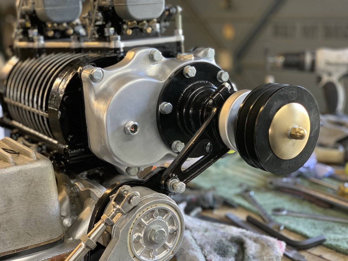

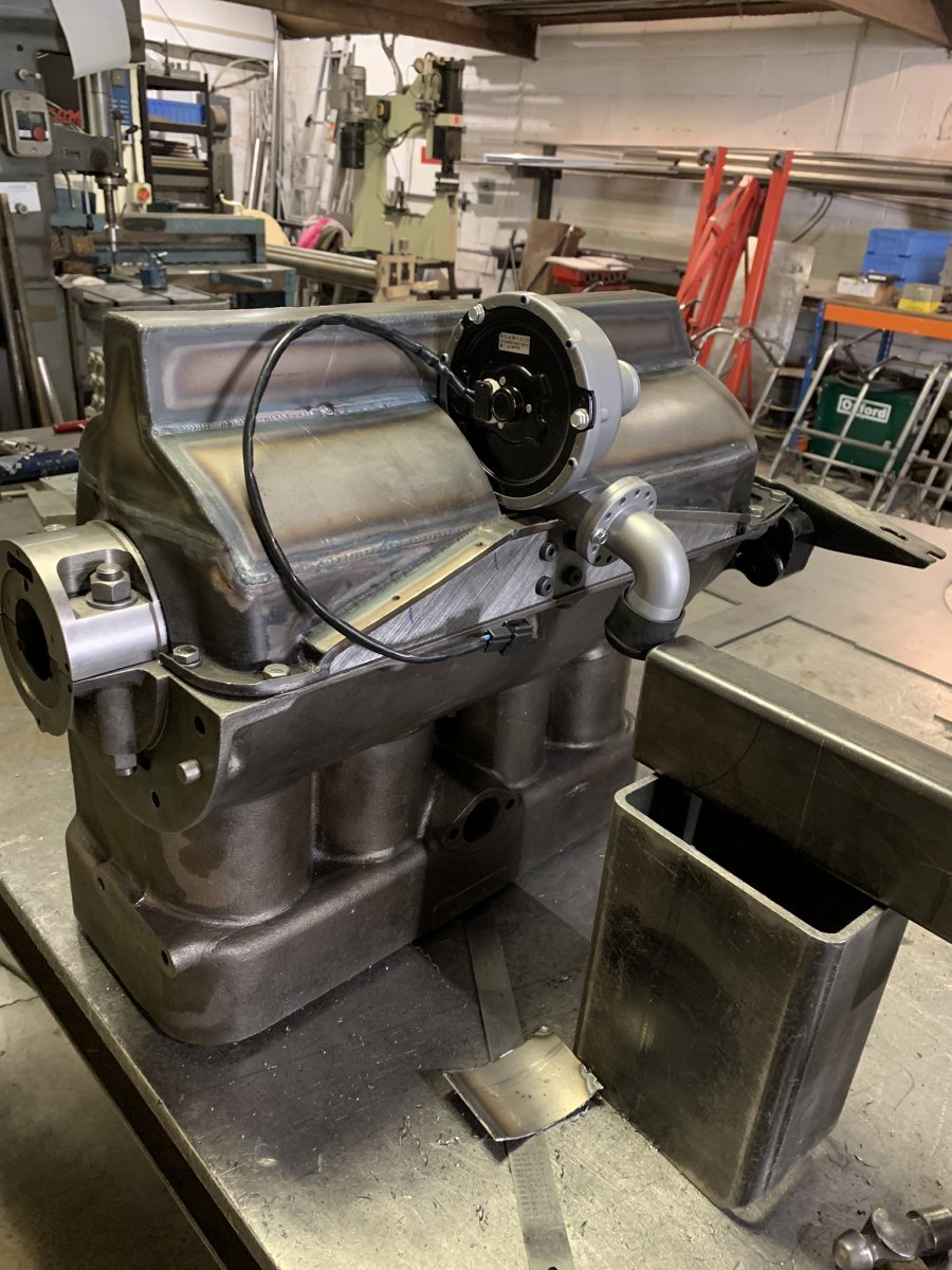

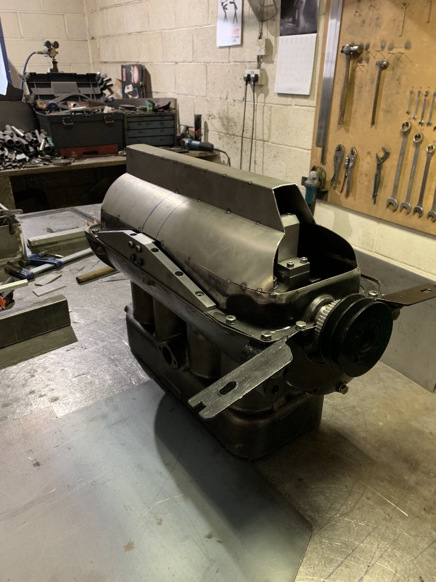

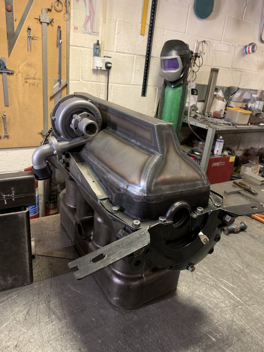

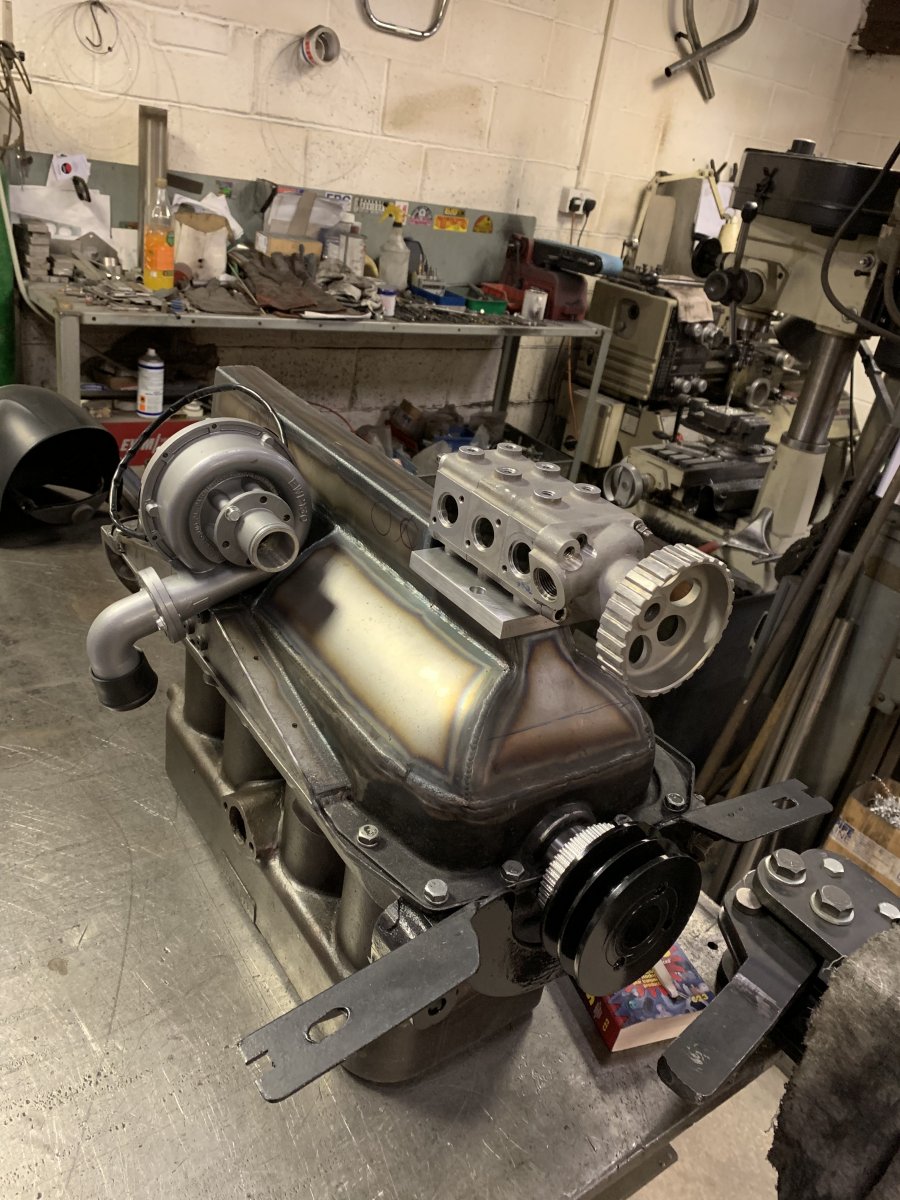

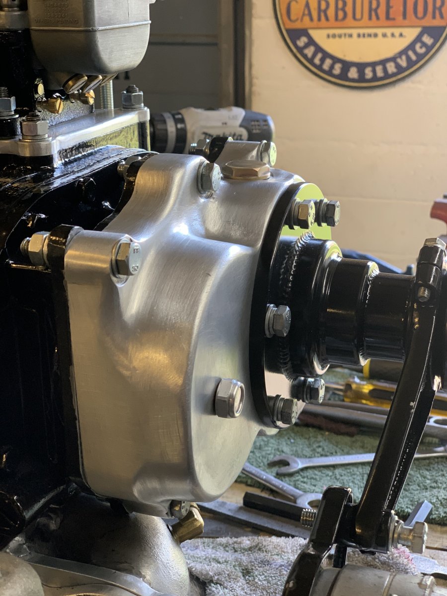

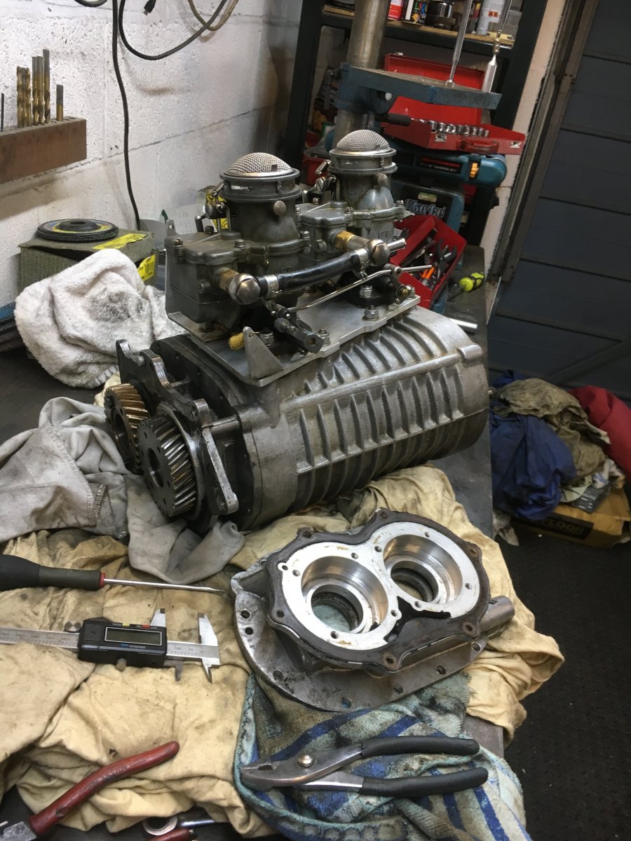

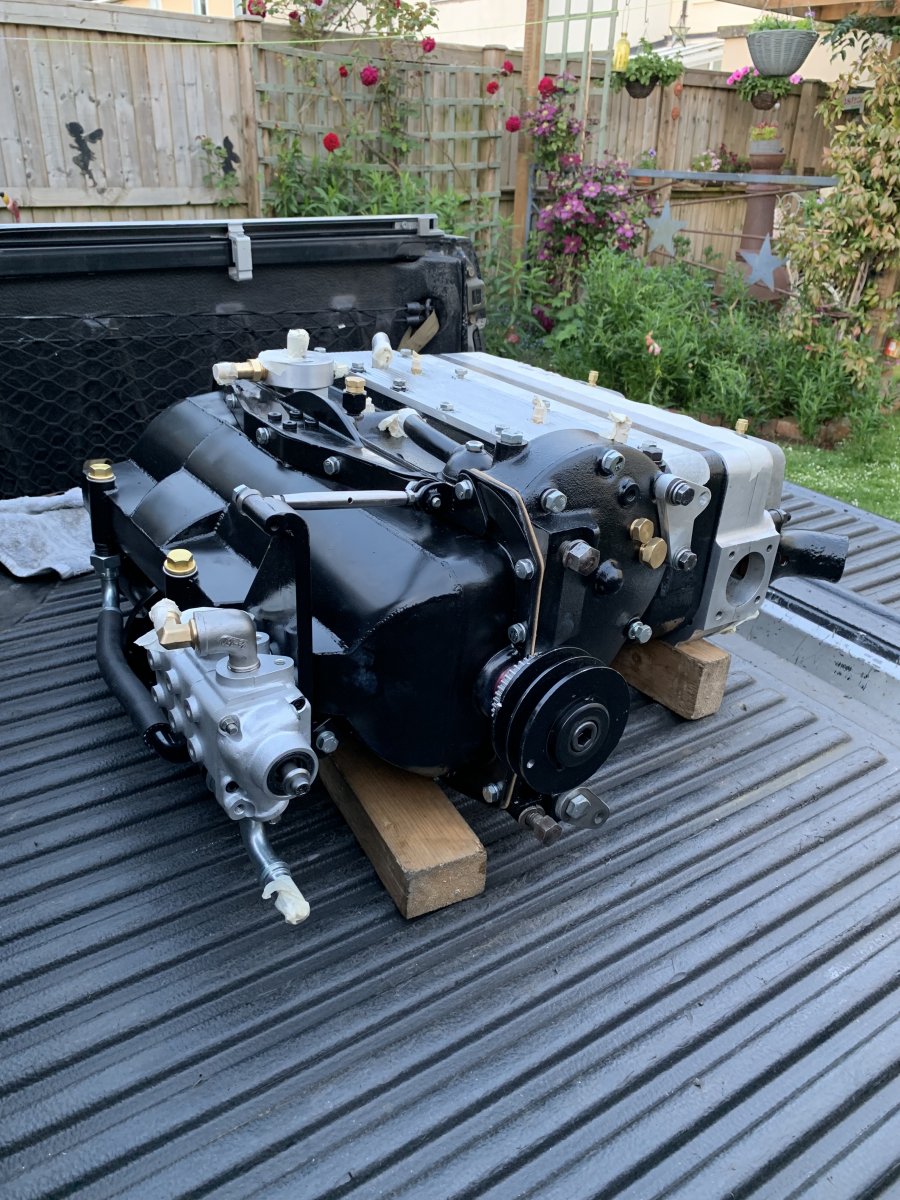

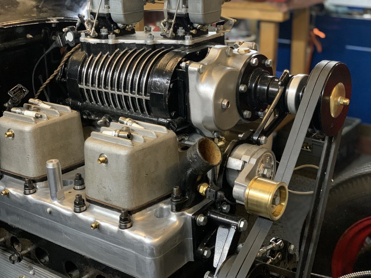

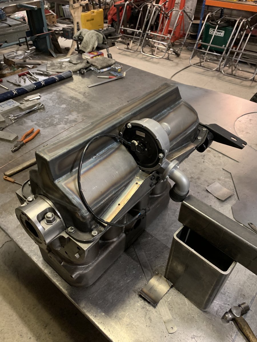

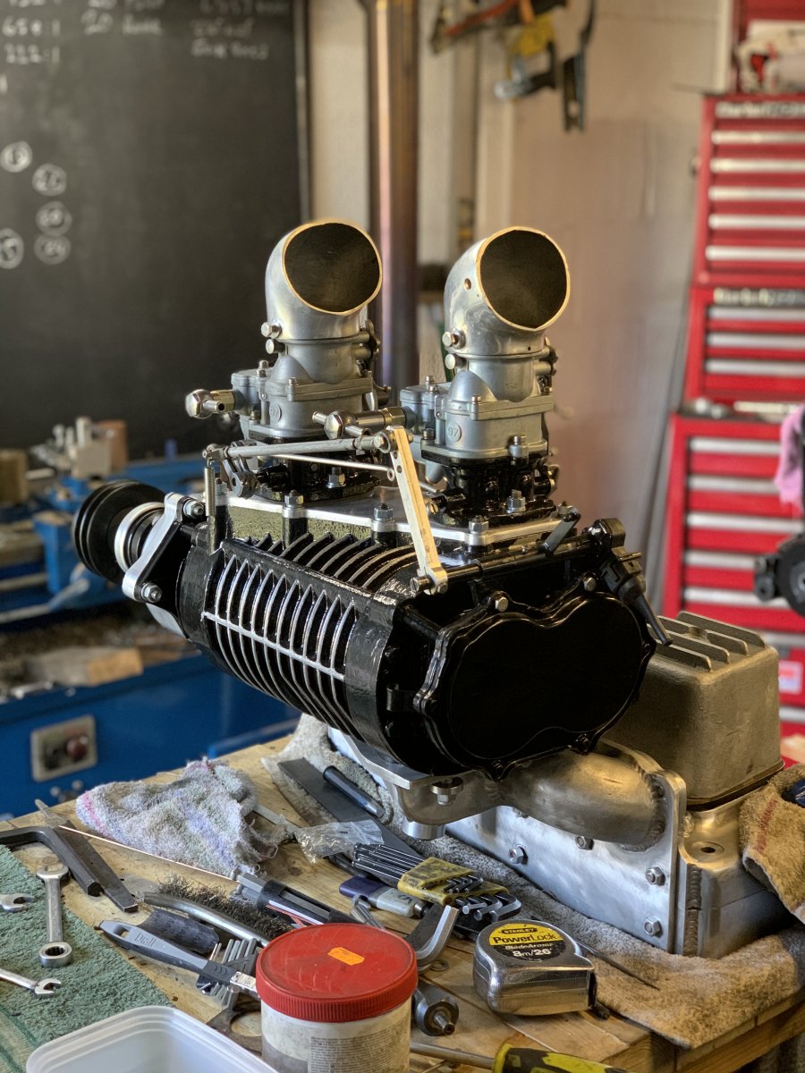

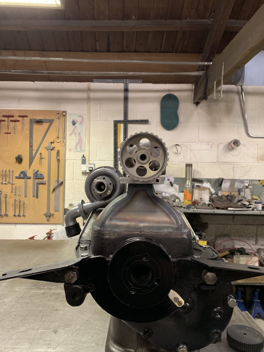

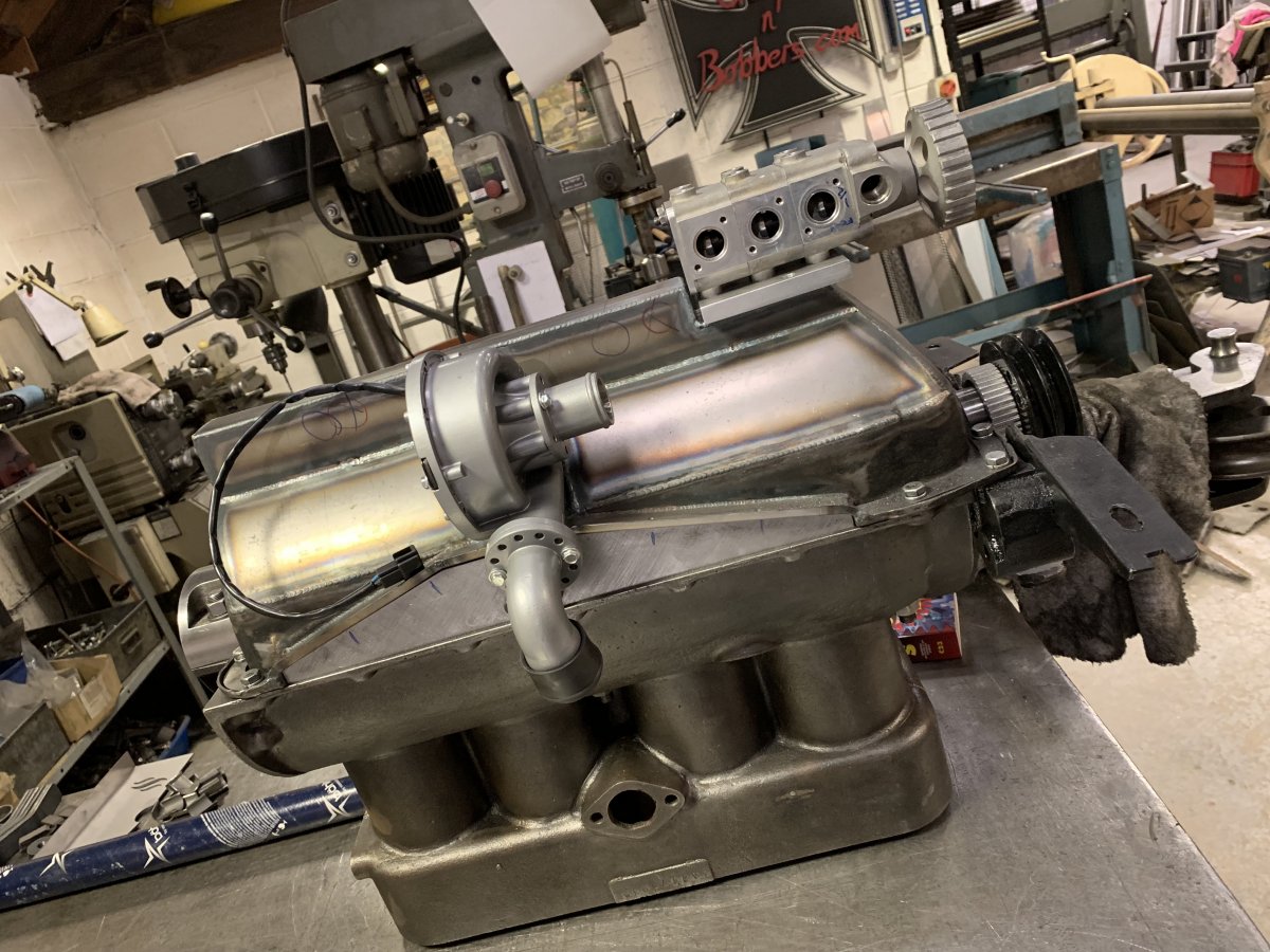

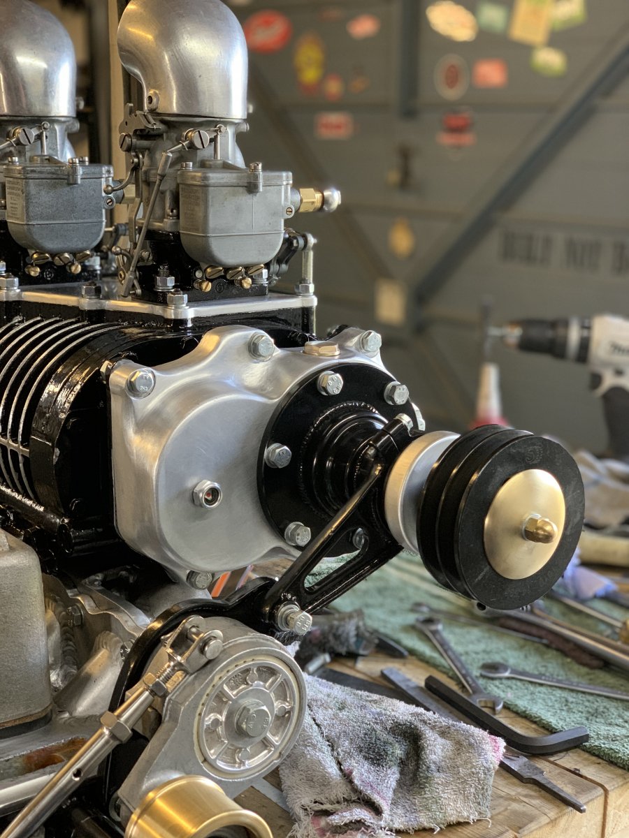

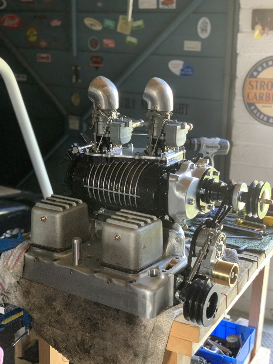

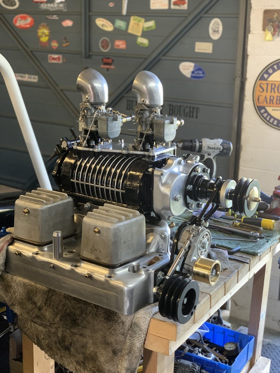

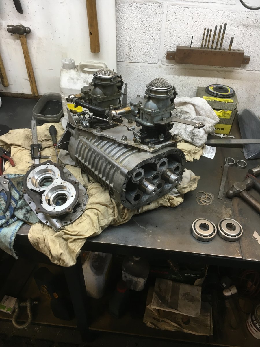

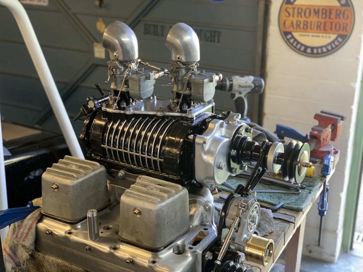

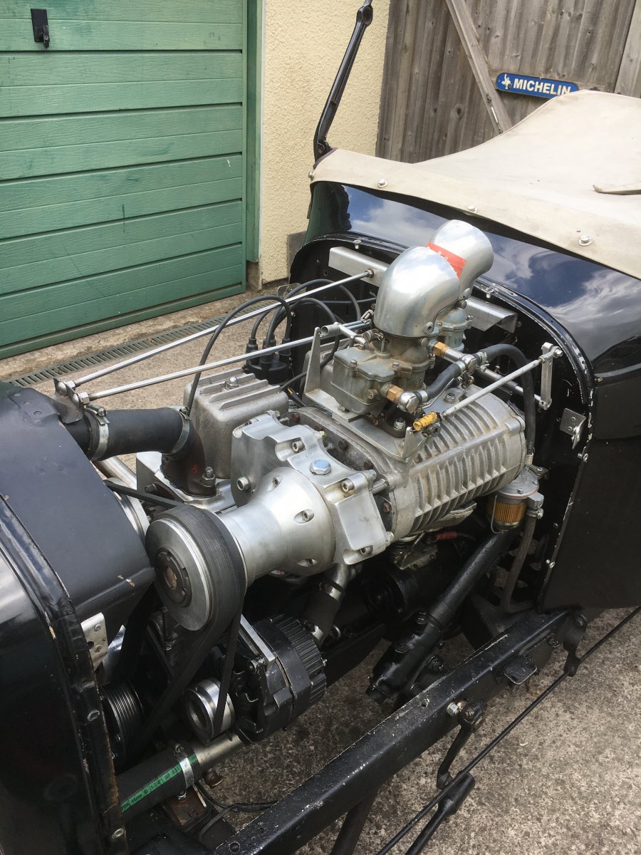

    With the blower causing a air fuel ratio issue I pulled the blower and modified it to take seals and more modern sealed bearings. That was one issue easily sorted.
    37C39E88-05B9-4D04-81B1-73AA6A4D676E.jpeg 258AE5E7-6D88-4415-B744-233FEE17A609.jpeg C425AFB5-98FA-49F9-B9FD-3669ABCCB25E.jpeg

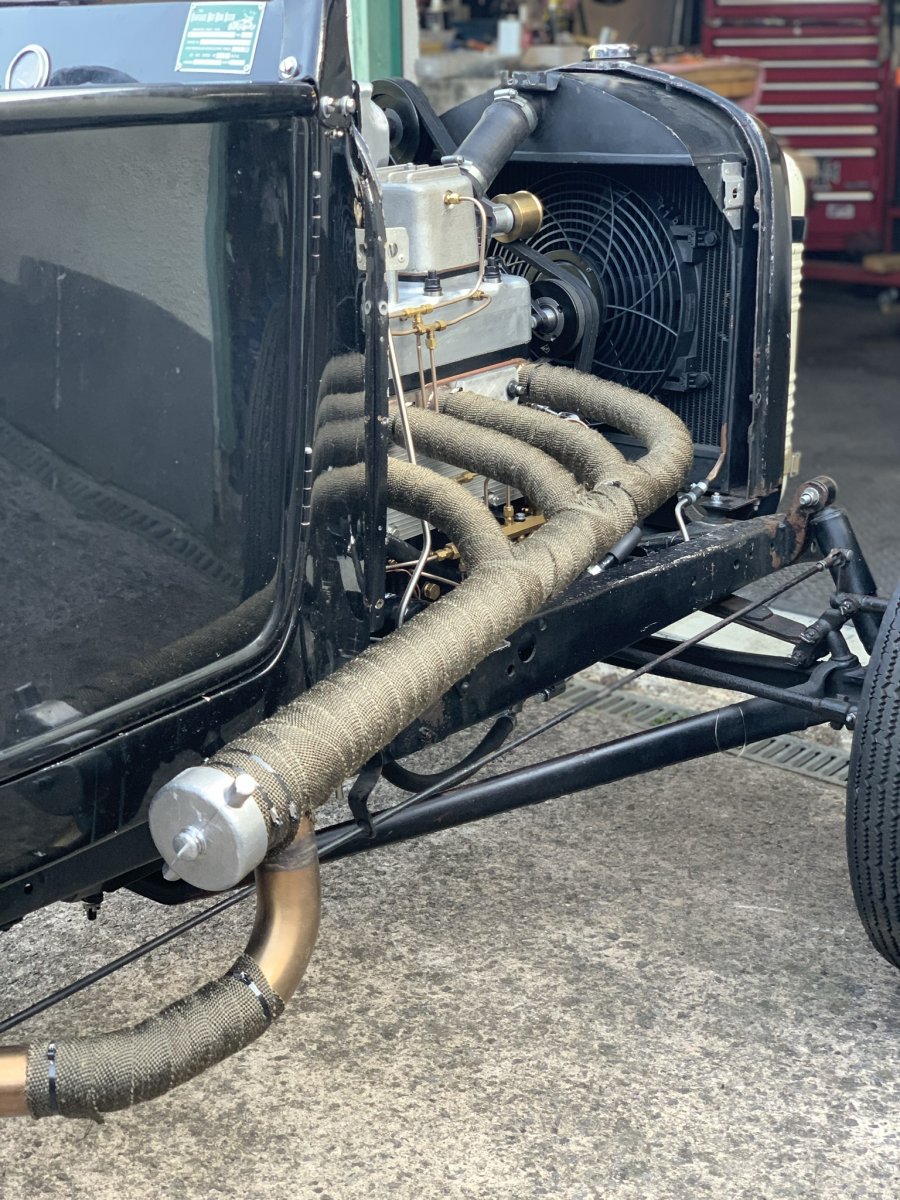

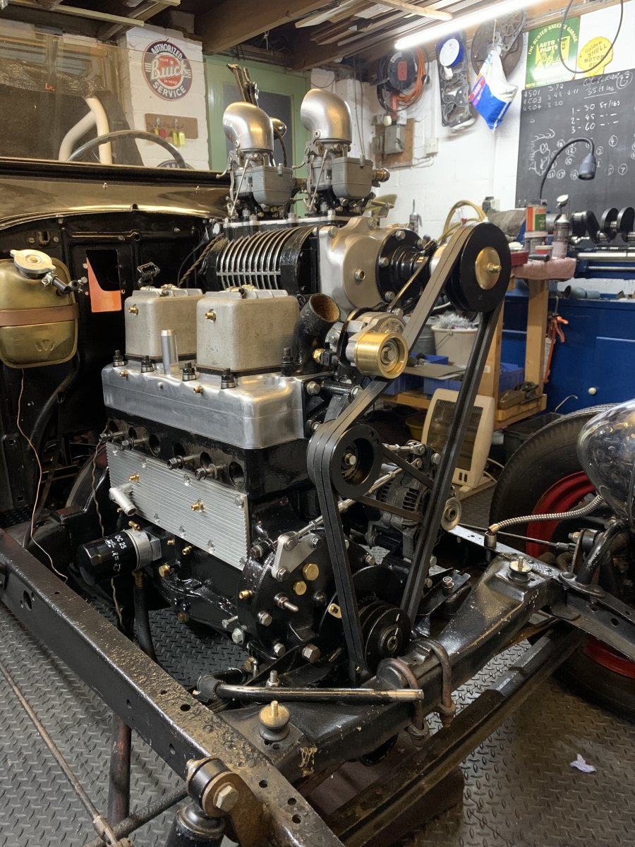

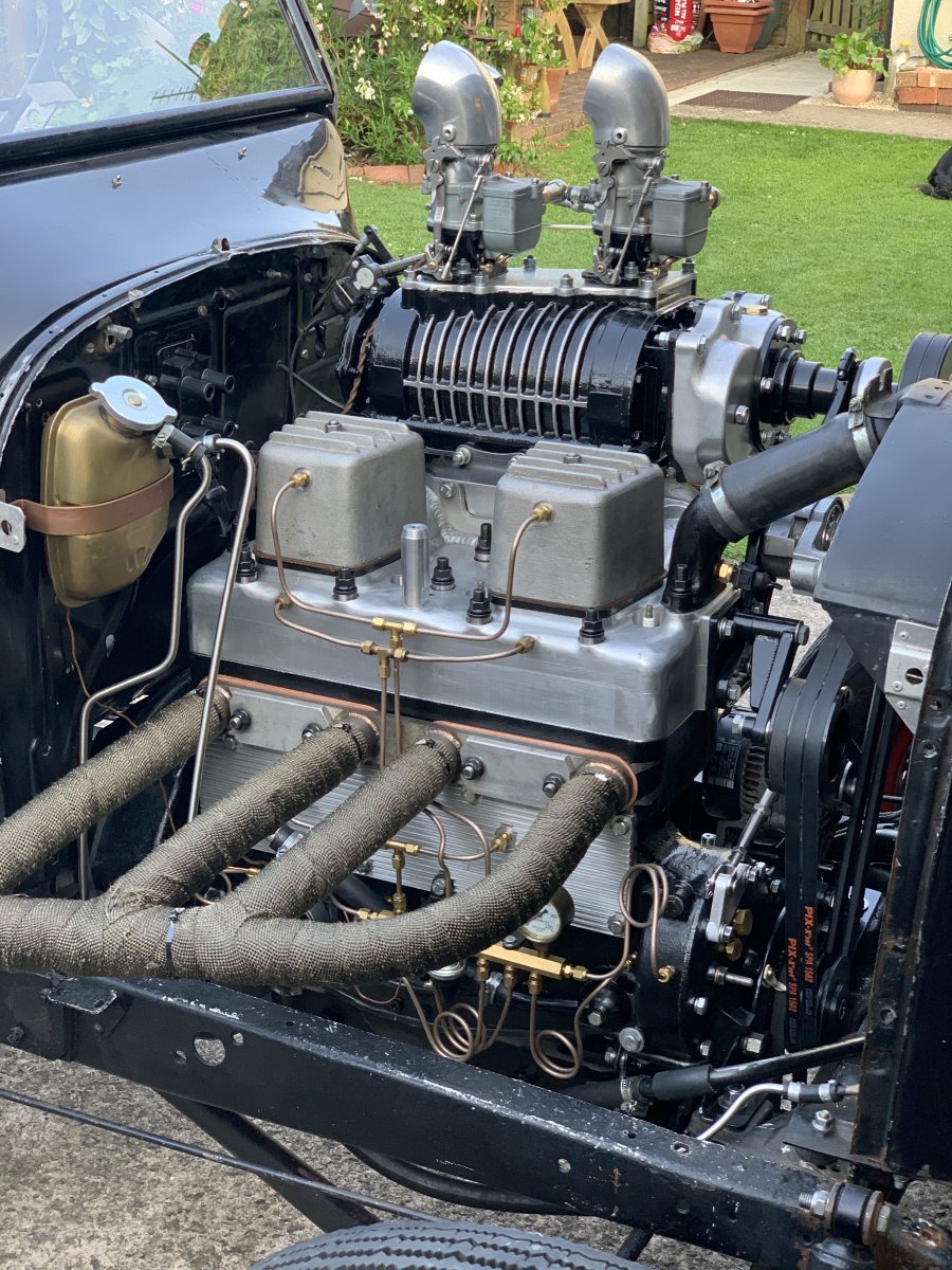

    Once the blower was sorted and refitted I decided to get a bit arty and change the modern serpentine belt system for a chain. I thought it looked great. I made a sprocket fit the strange water pump pulley that was already fitted. Acquired an alternator and fitted a sprocket to that and set it all up. Now at this point the alternator was running backwards. Not being sure if it would work I set it up on the bench, and it did indeed work. Spinning it up with a hand drill and connected to an exciter bulb and a meter it registered 14.7 volts.
    On the car was a different matter. Would it ****** work? No, is the answer. I spent ages working on it, days turned into several weeks, trying different alternators, rewiring half the car, refitting different wattage exciter bulbs, but nothing worked.

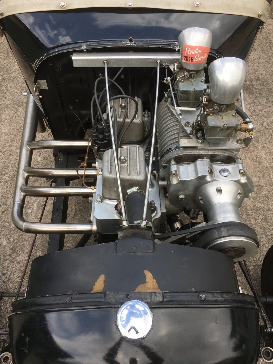

    Time had now run out for its first outing at Gow! I had failed to get a car to an event for the first time, but looking back, it was a good thing I hadn’t thrashed that engine up the hill at Prescot.
    1EC62F00-EBEA-45CA-9140-8E3F1DA07A65.jpeg FF5758BB-788C-4490-B3D7-AD0F558B7981.jpeg 58552A31-4428-4F55-9C00-4F05804FBFEB.jpeg 5AFF3730-D622-4320-8D27-9BD1B2BB0DDC.jpeg

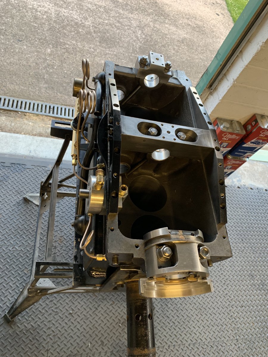

    Not managing to get it to the event I decided to pull the motor and spend some time going through it. It did have an abnormal vibration after all.

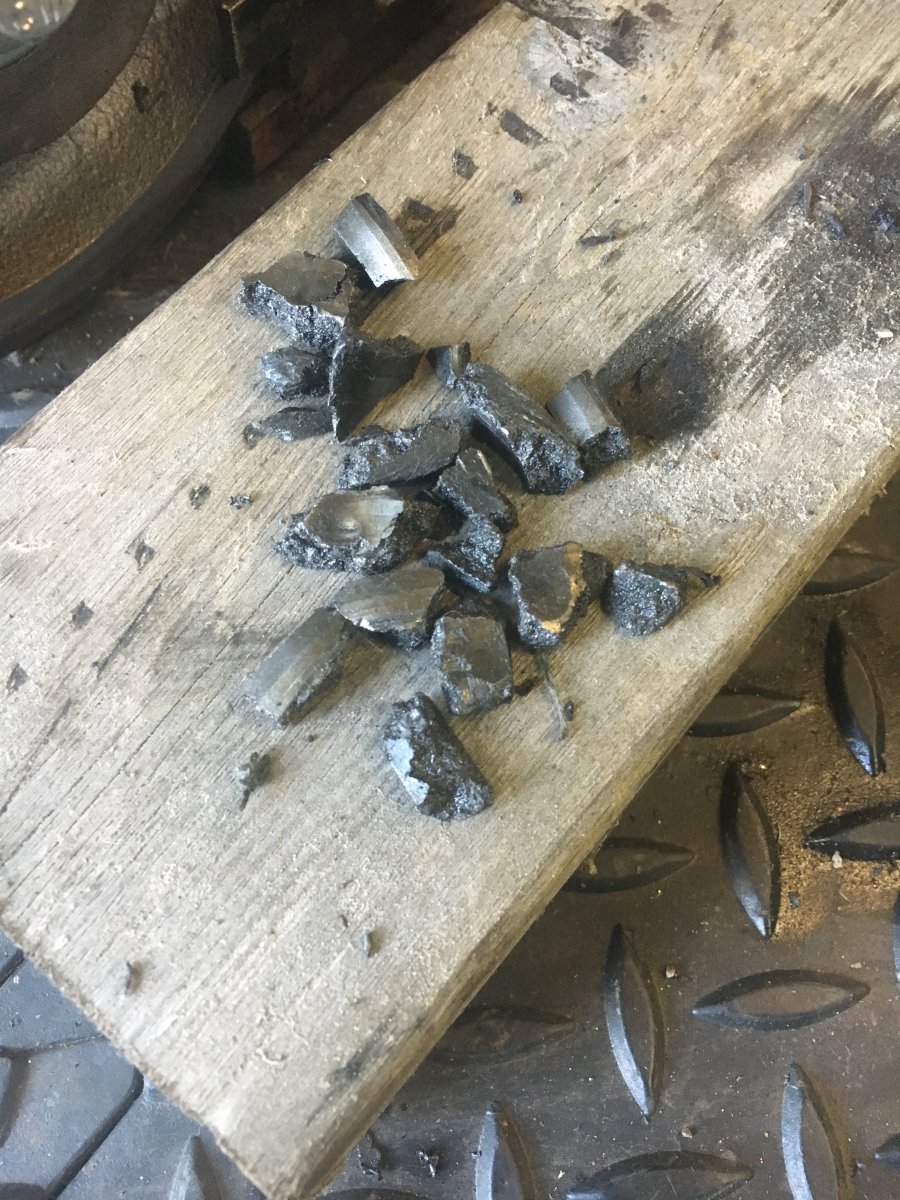

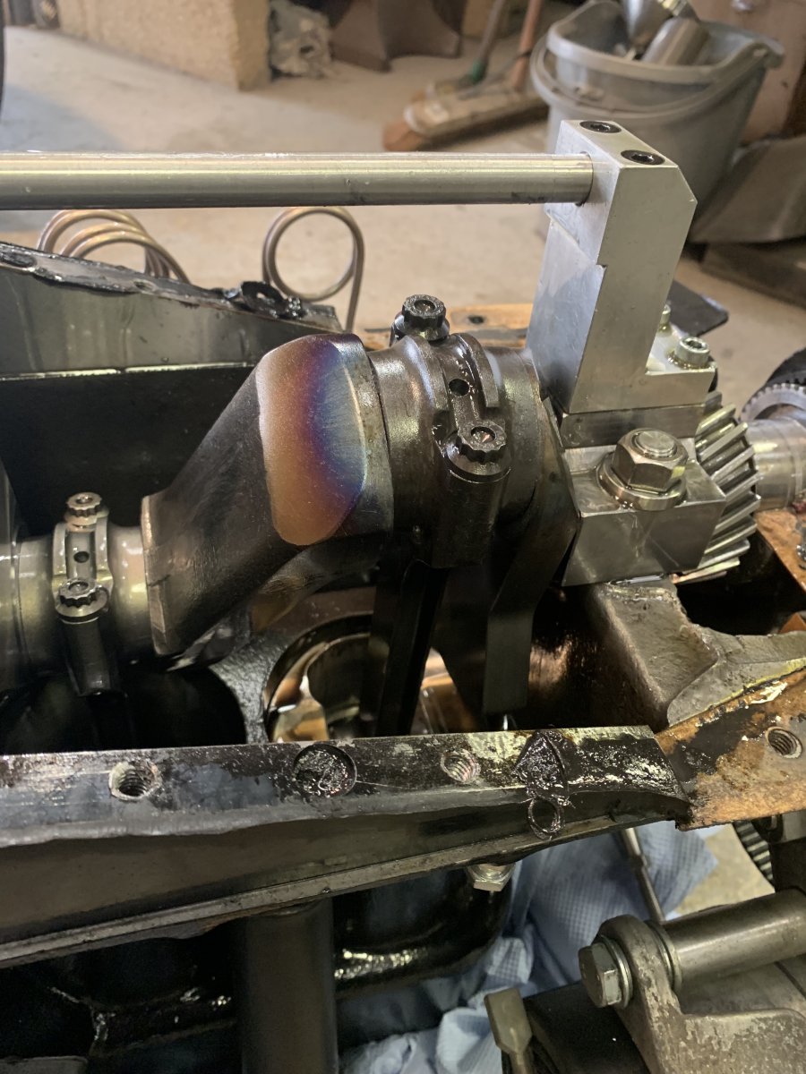

    Engine out and remove the sump. That’s when my heart sank. The motor itself was pretty clean. The crank looked good, the steel main caps were chunky and it all looked great, except for what was found.
    696E3717-0508-4D25-A459-BA330FB4409D.jpeg 7434F975-5F68-4BBE-BBD6-3A0AB70127B9.jpeg

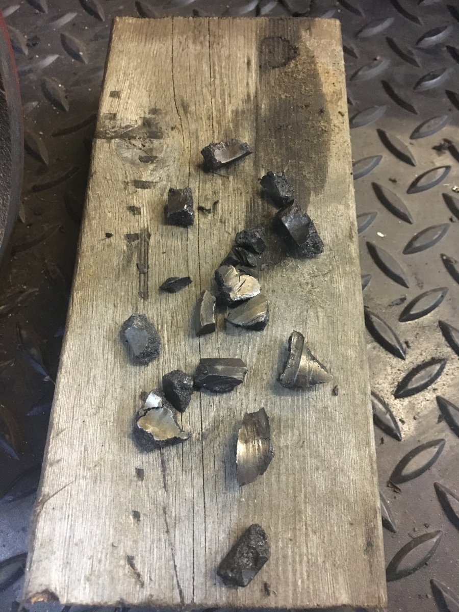

    These bits were in the sump. Panicking, I checked everywhere thinking the block the bolloxed. Nothing seemed to be wrong. Just a handful of random lumps of cast iron.
    F34F4DBF-AF99-48C3-BAD4-E2EC8F373984.jpeg 5F8BC708-53CF-45BE-96AD-23323737B9E2.jpeg
    The sump was full of what can only be described as the remains of a blown up motor, but none of those bits belonged to this engine. What the hell is going on. The company that originally built the motor fitted the main caps and full pressure oil system, and as a result needed a modified sump.
    At this point I need to say that this was not the fault of Jamie, the guy I bought the car from. He had paid good money for the engine to be built. When I found all these bits he was horrified. Talking with him about the build and what parts he supplied, it came to light that a sump was one of the bits he was missing and the engine building company would supply one.
    I’m only guessing, but sure does look like they’ve built the motor and not thought about the sump until the end. Then just took a sump from a blown up motor and somehow fitted it without cleaning it first. How? No idea, but here I am with a clean engine and dirty sump.
    CFDACE4C-F838-424C-90F6-67C2384463A1.jpeg DFB3220A-CDD8-48F4-BFE5-6B9AA7CDFCC6.jpeg

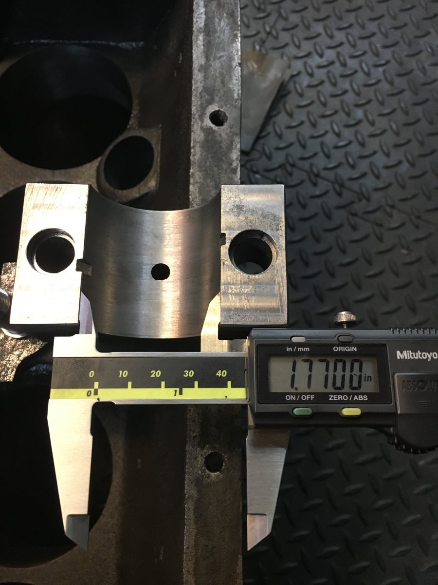

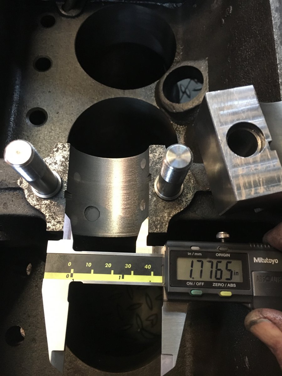

    On removing the crank I could see shell bearings had been fitted. At least that was something good. Sadly not. When they align bored the block for the shells they didn’t get it all. Part of the original casting was still visible.
    Roughly measuring the bore in the block with the bore in the caps looked to have a 6-1/2 thou difference. When I fitted the caps back on the block with the bearings in place I could feel the step where the bearings joined together.

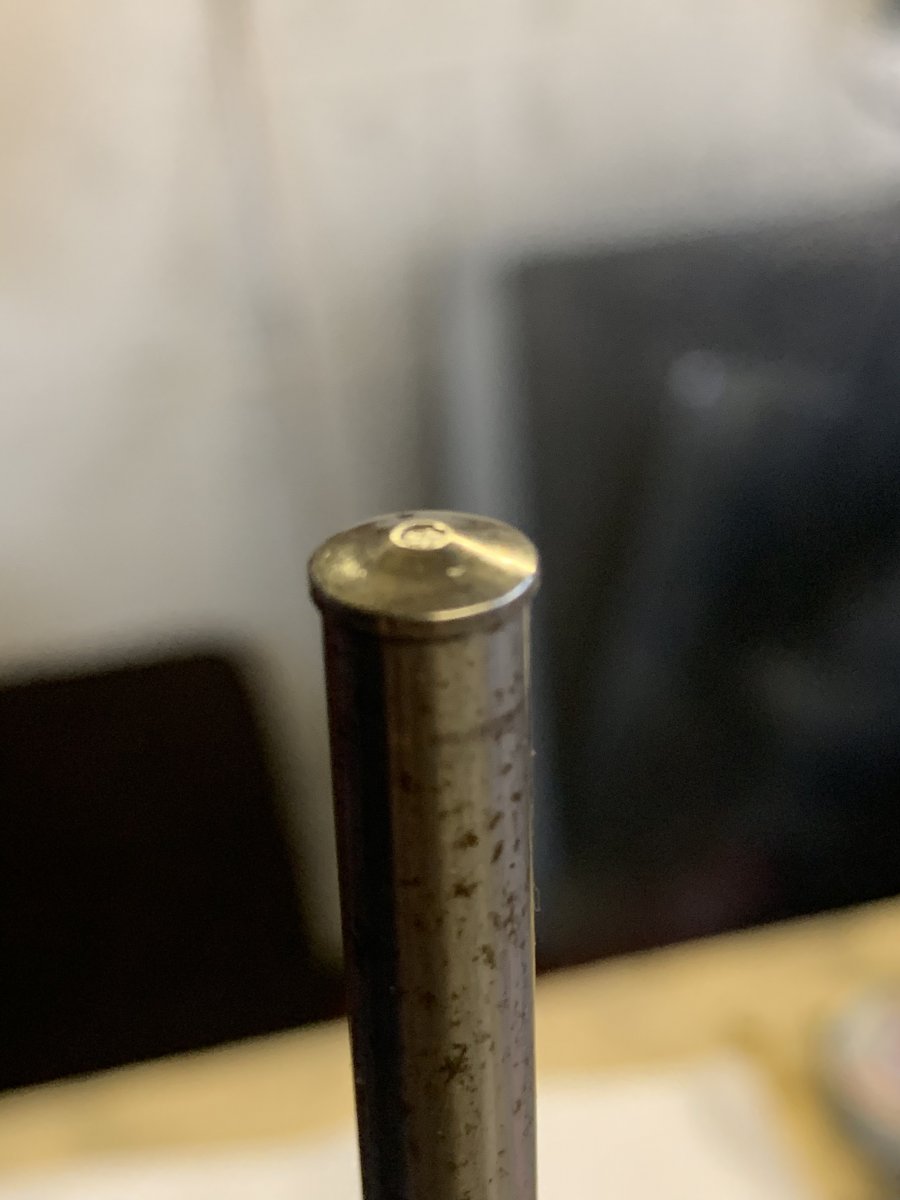

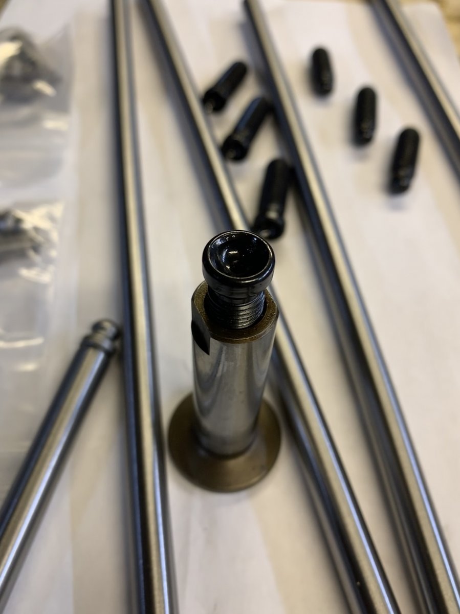

    With the head being an F head, meaning that the intake valves were over head, meant it needed push rods for the over head valves. What the builders had done was to find push rods that fitted with the rockers in the head, cut them to length and fitted them in the socket of a socket head screw screwed into the lifters. Was this a good idea and did it work, no, not really.

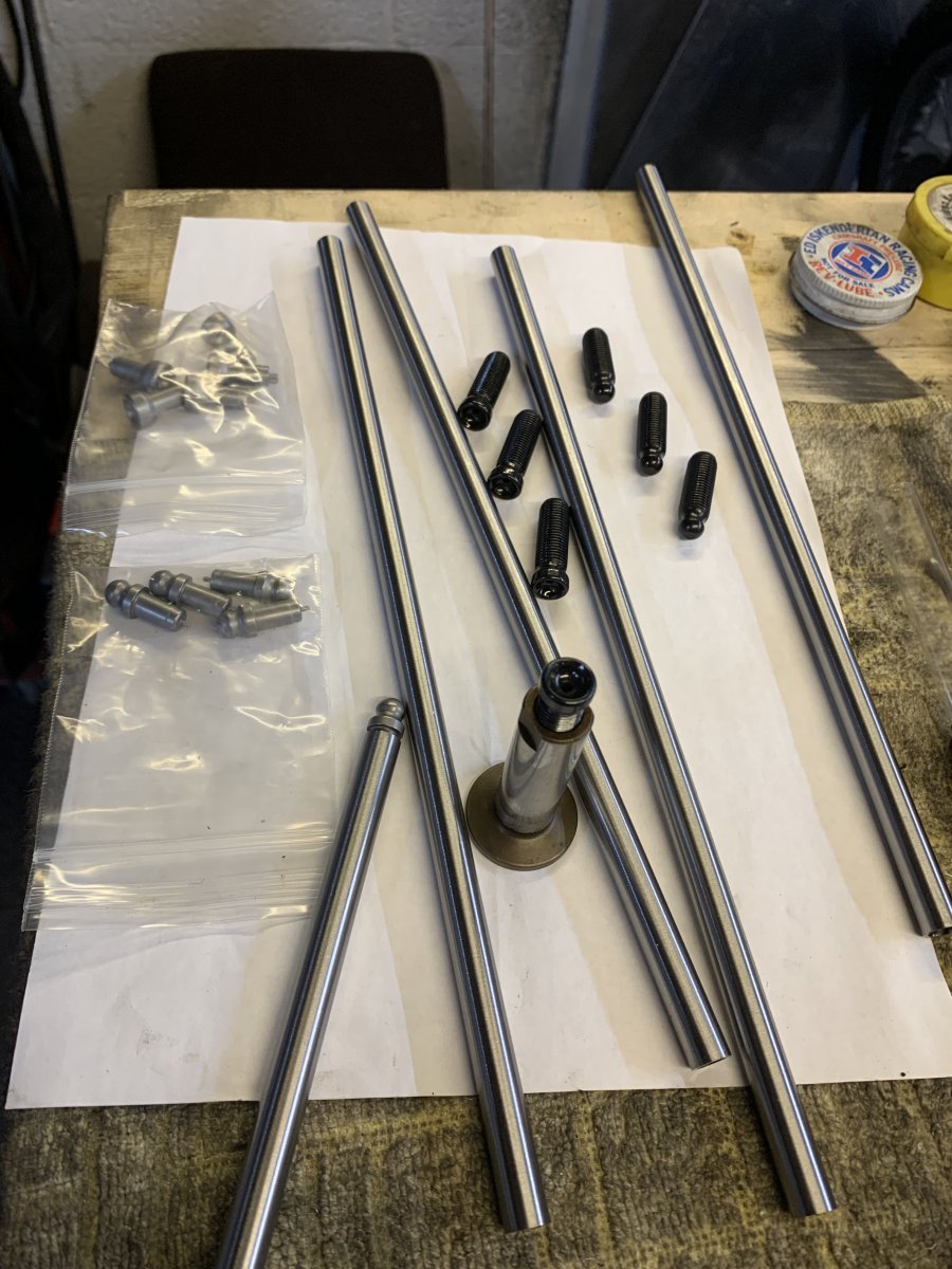

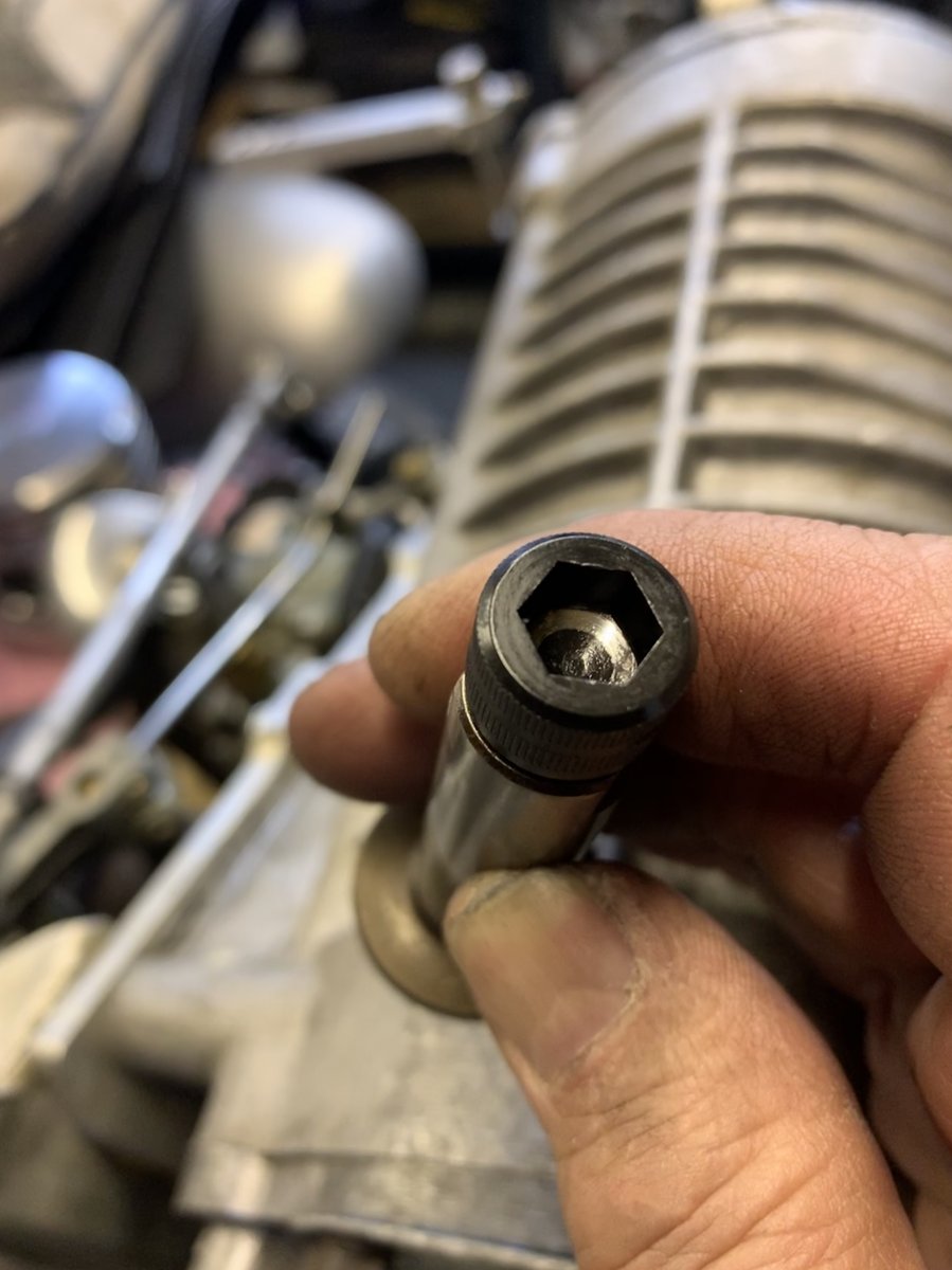

    You can see from the photos that the rods was just mushroomed. This would also be knocking the valve clearance out too.
    D20244C3-2F4B-45ED-A760-1124D8CAE50D.jpeg 52C29869-ACC4-4513-9F67-AECA4A0C08AC.jpeg
    The only answer was to invest in some Manley push rods which I could make up to size.
    3103EA7B-D374-48E0-A10F-0D34F4710359.jpeg 21AC2FF7-C43E-4C83-8F98-DA6484770176.jpeg 28FEBDBC-B840-4A1D-912D-0465E2562256.jpeg

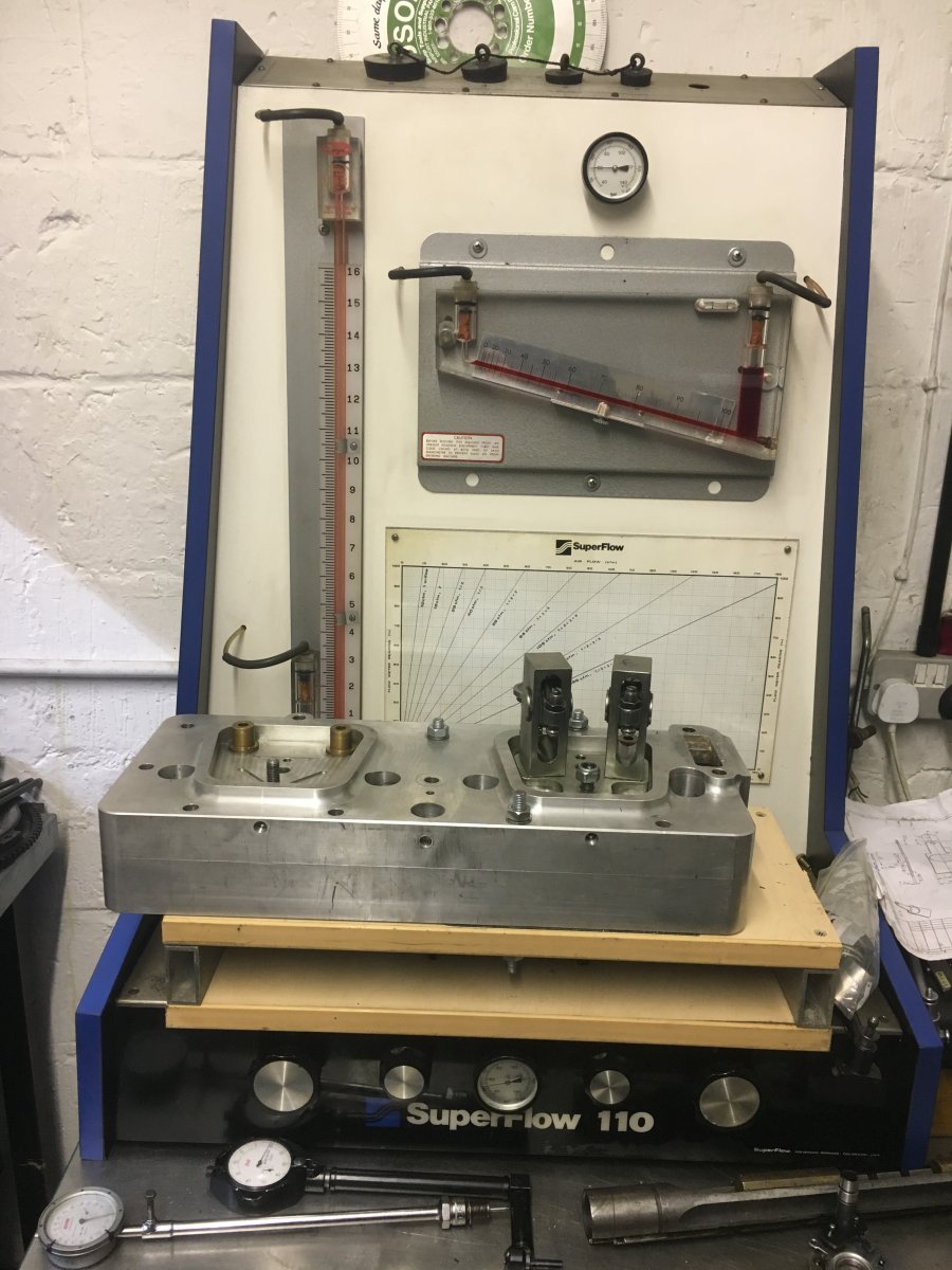

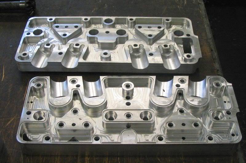

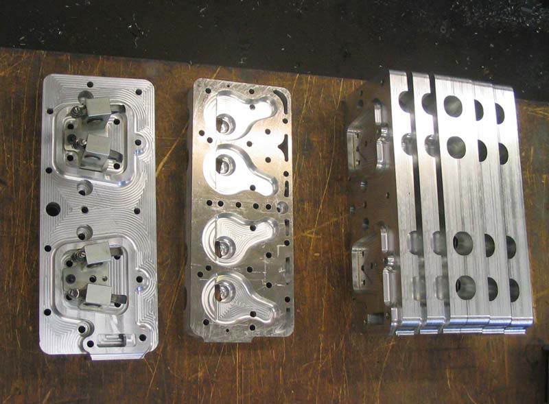

    While on the head it was a good idea to check that over. It was built by the same company that built the motor, so only prudent to give it the once over.

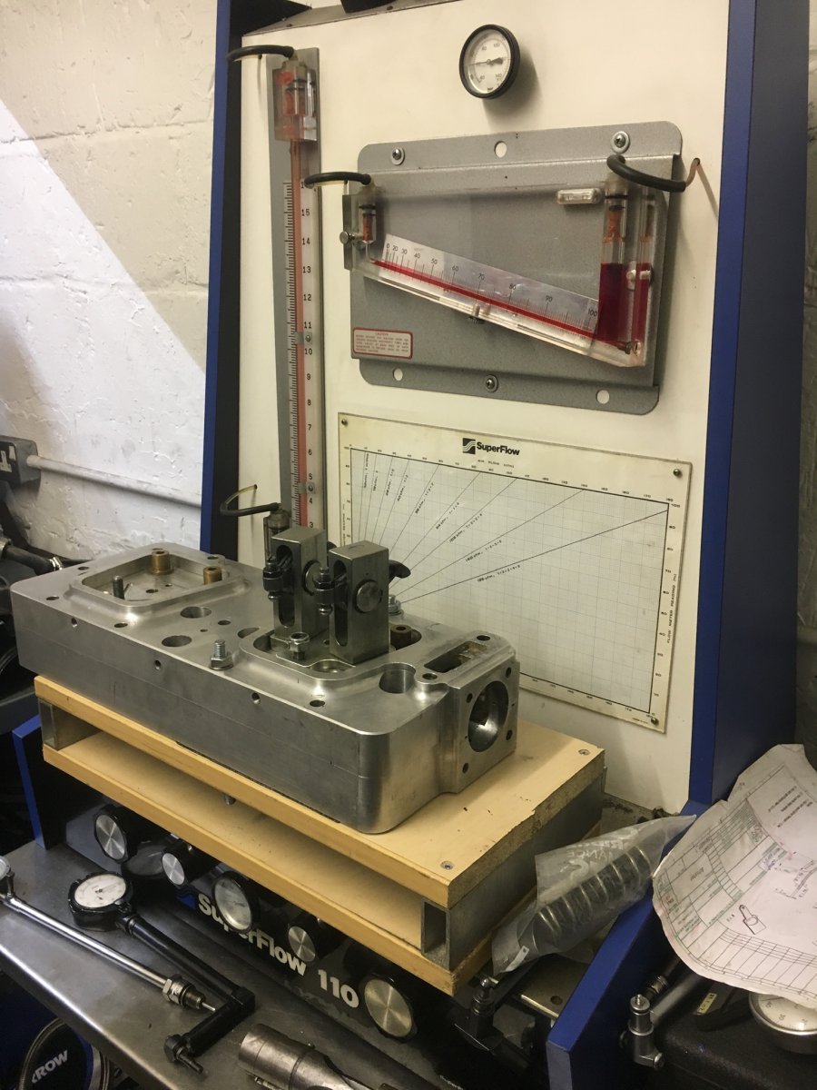

    A work customer has a flow bench. The path on the side draft head looked very flat so we checked it. It was bad. The 1-7/8” valve flowed less than half that of one of the heads my friend normally works on with an 1-1/4” valve. So I needed to do something.
    First couple of photos are from the internet and show the heads in production. You can see how flat the intake path is.
    There is also some shrouding of the valve.
    B69D2551-809A-4B39-B262-B4CCF36FC531.jpeg D23EDDE2-B265-48A6-B894-30AAC3E7B5F7.jpeg
    This is the flow bench we used.
    13F9BF12-9DC5-45AC-A00C-B417F18BCB65.jpeg 2189E2AF-1CDB-4981-9C89-3B4A0C02C0AD.jpeg

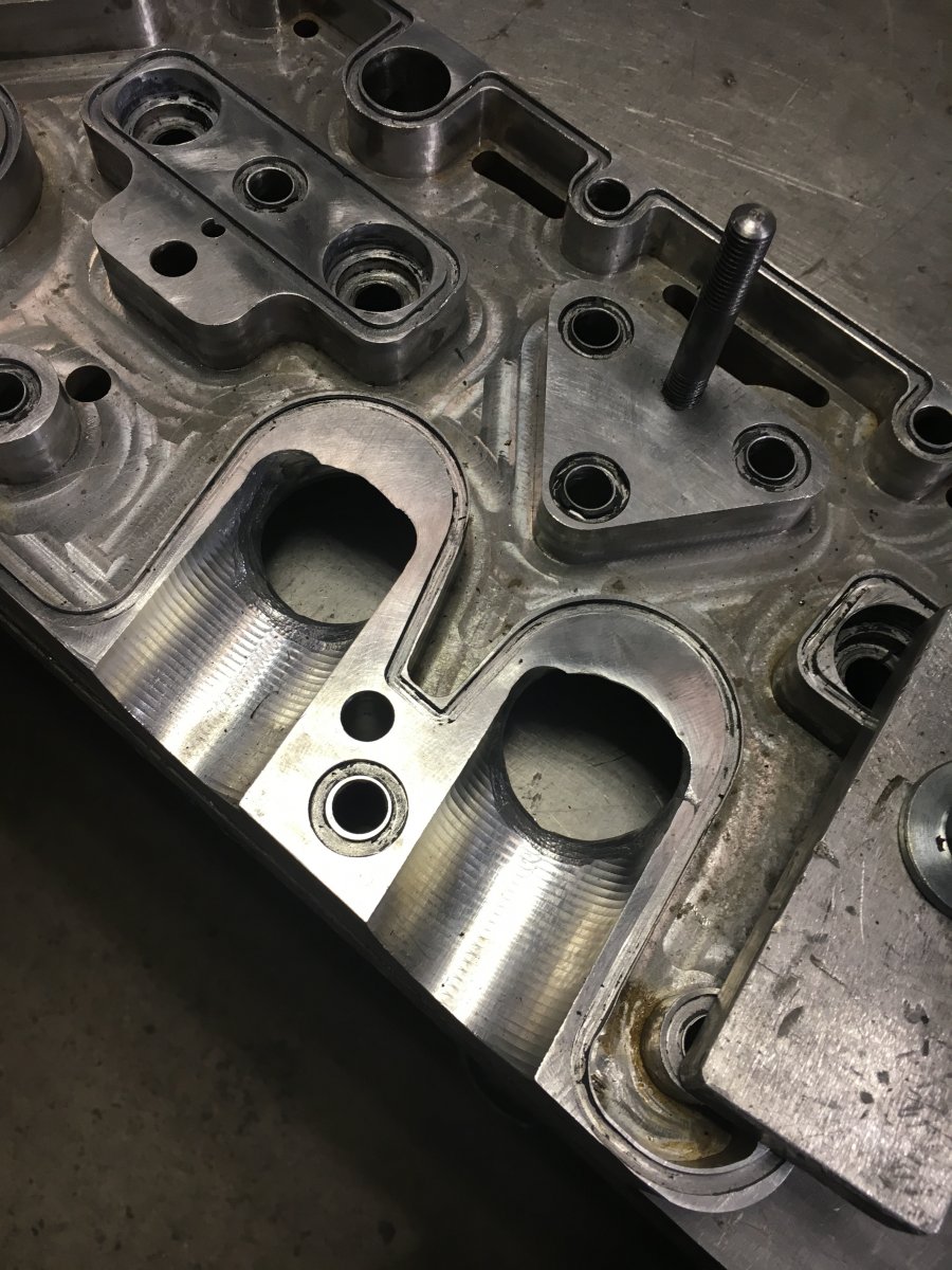

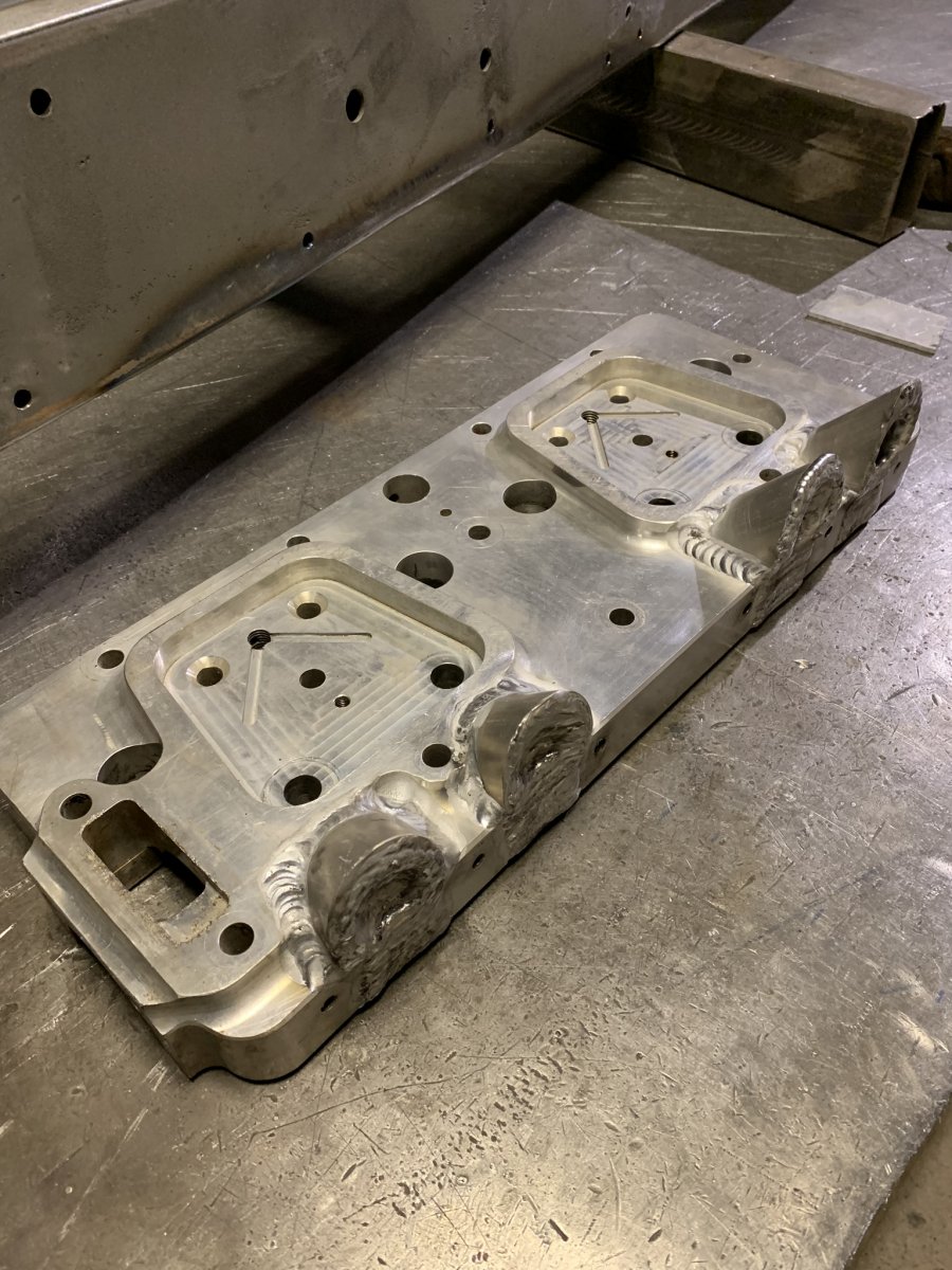

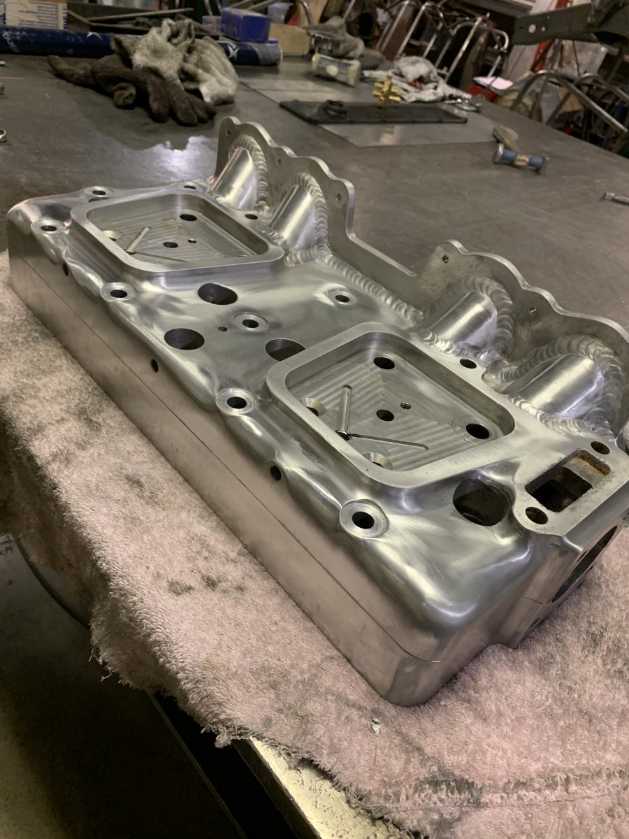

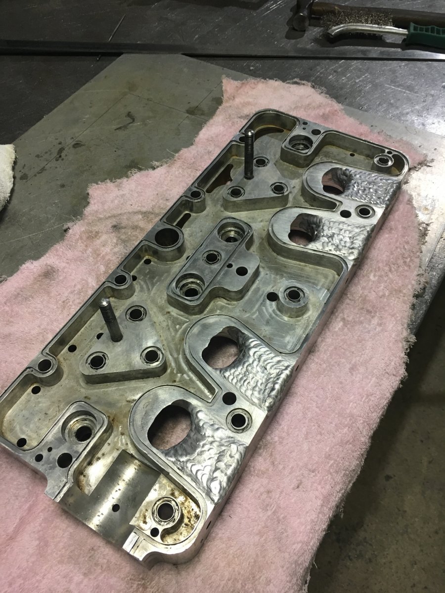

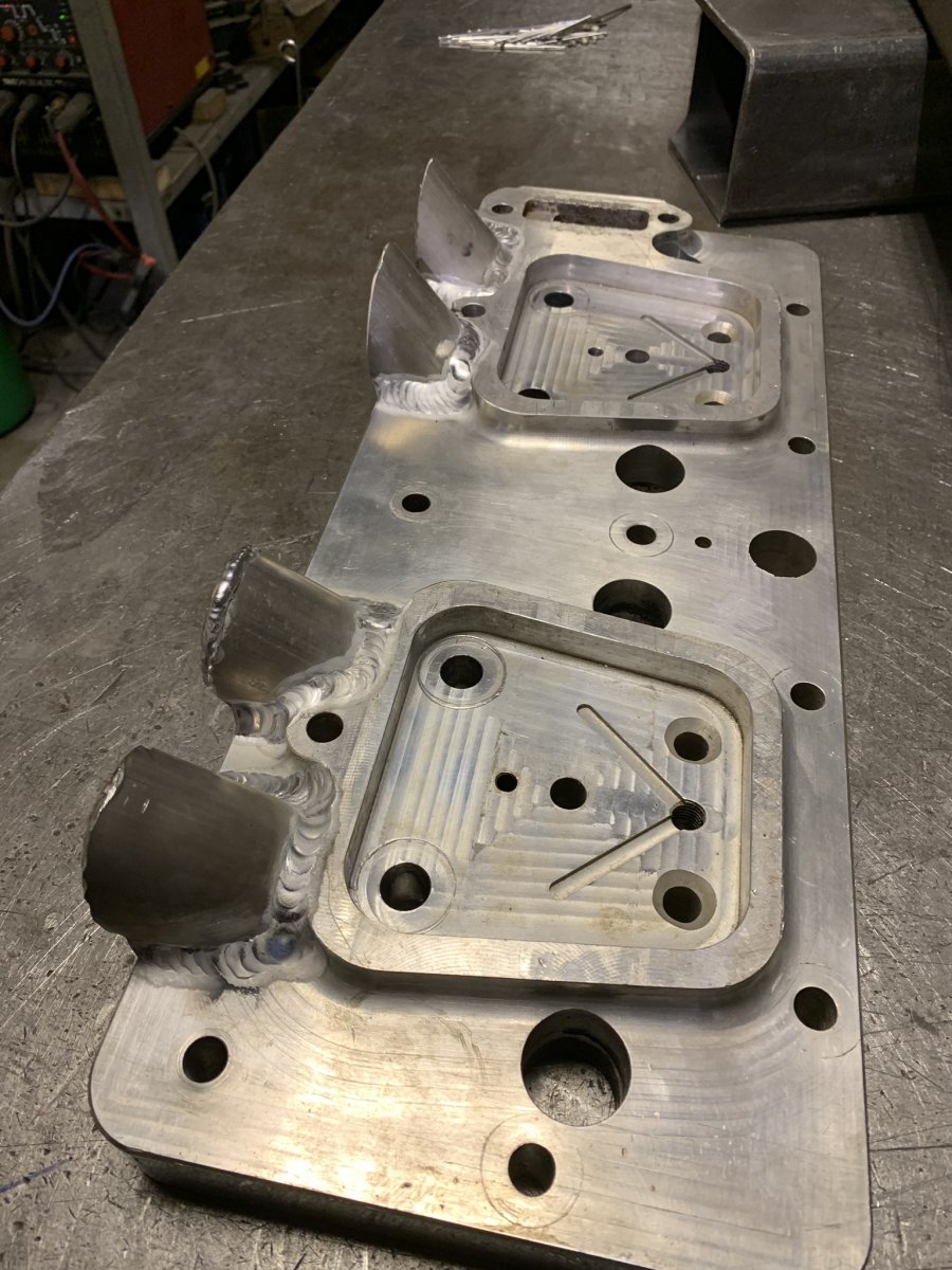

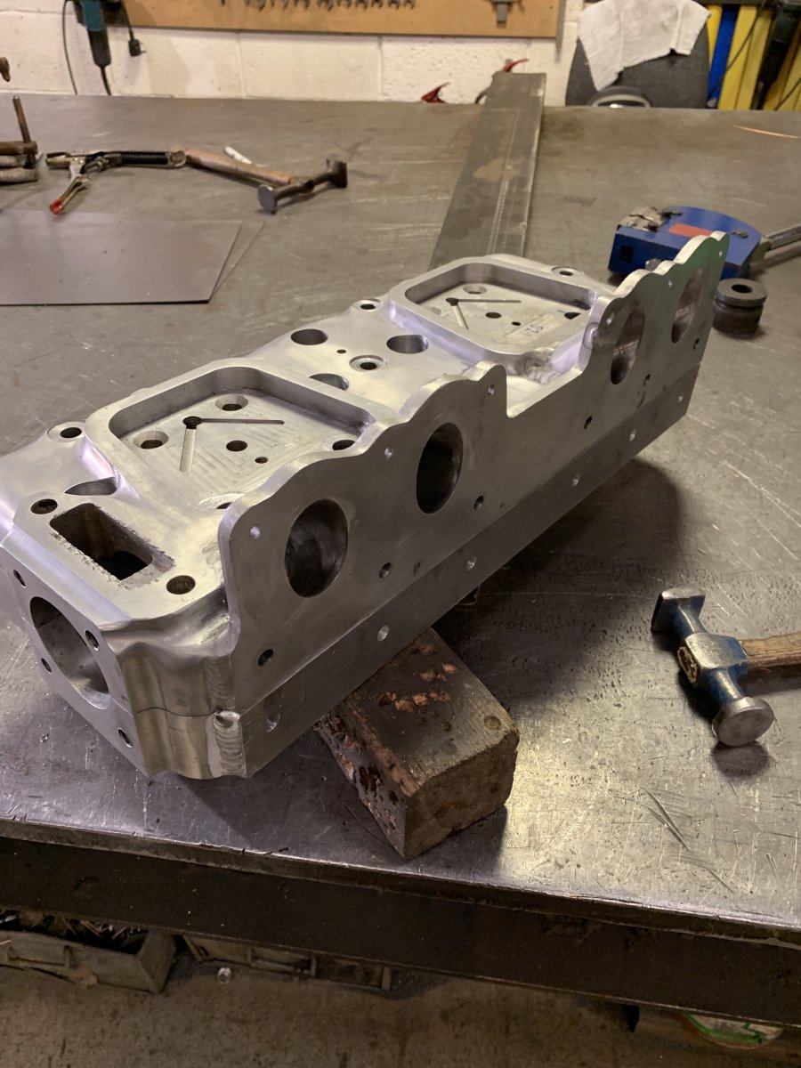

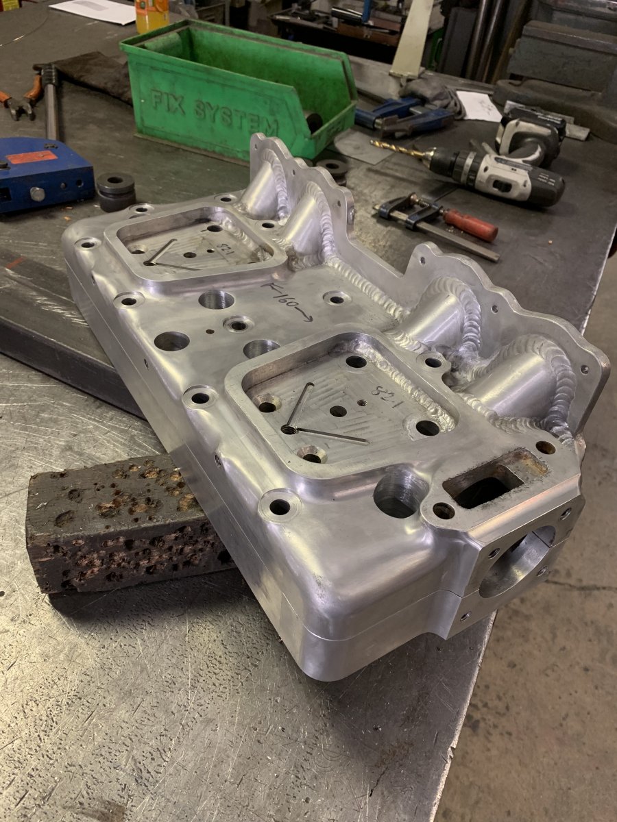

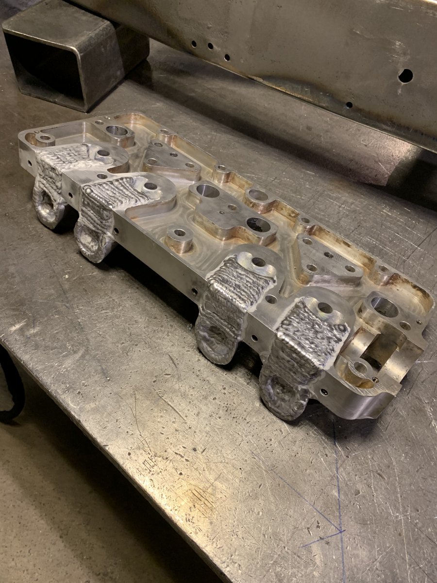

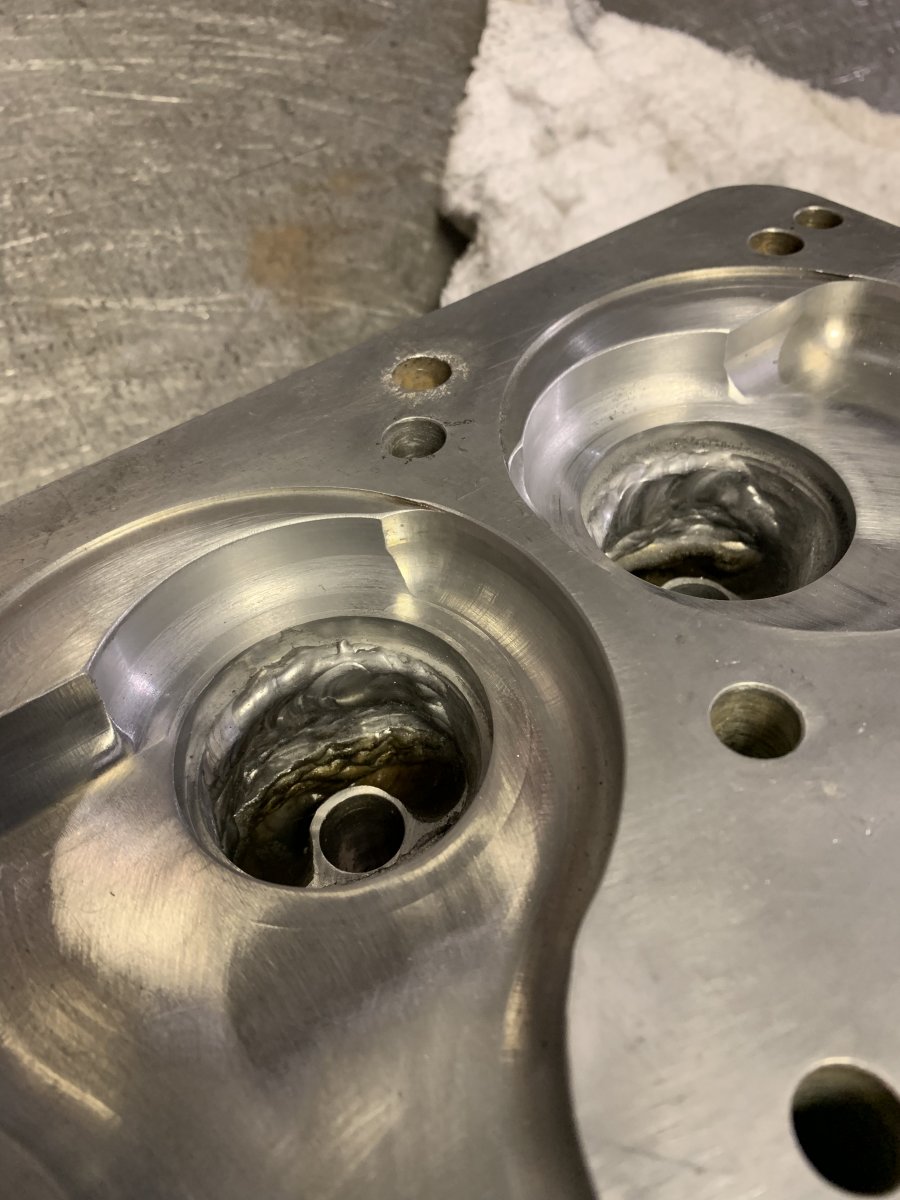

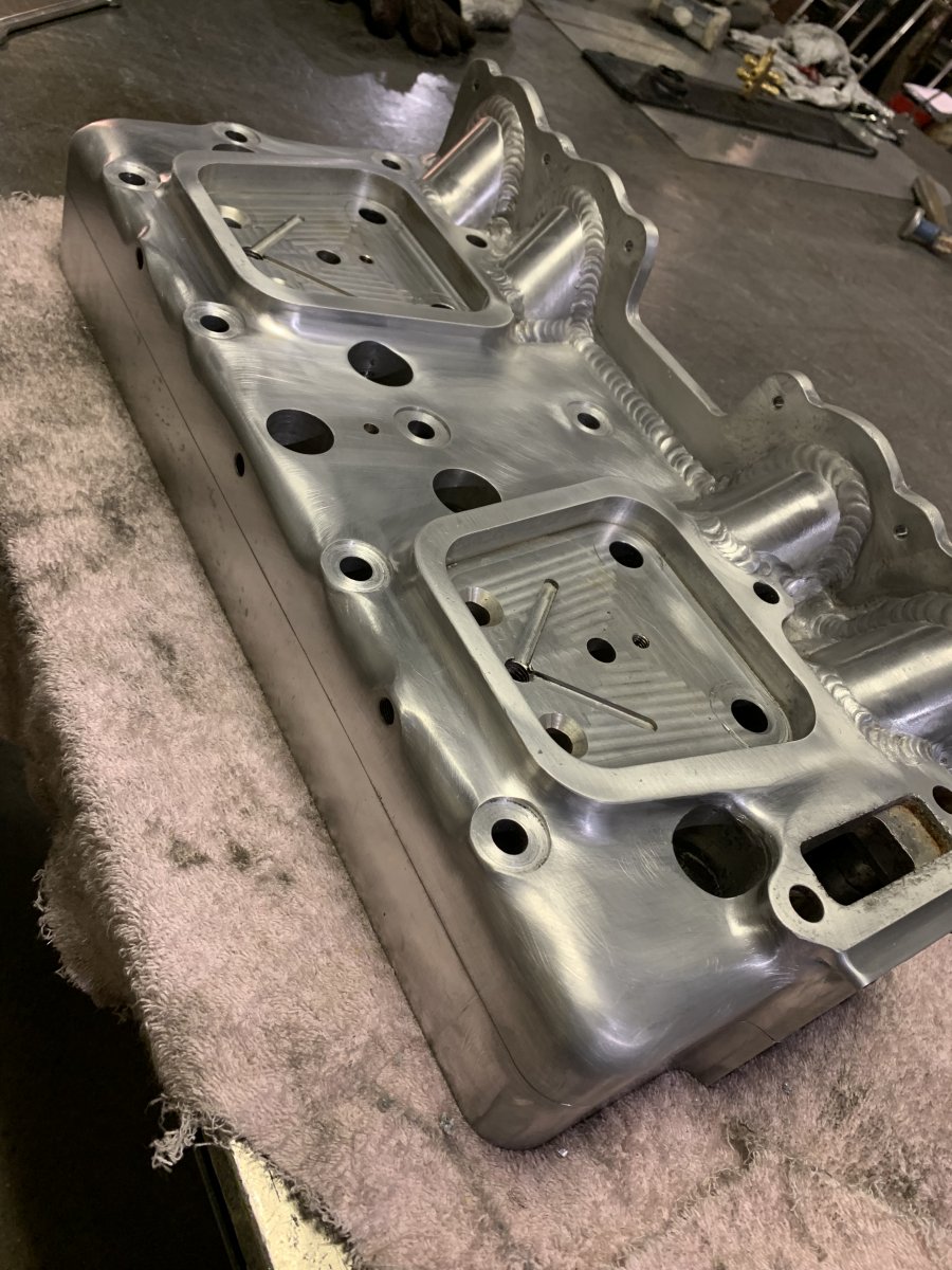

    With the heads apart I set about welding up the ports
    D51F7A24-9F6B-432F-AB10-E909F7333AF7.jpeg 49FD9C73-EDFF-4423-9C96-56DD51B82A15.jpeg
    The ports welded as well as tubes welded in where the new ports will be.
    8D4E0EC3-2A88-4D06-ABEE-EE9220D08412.jpeg 227B72D5-94D5-49D7-B860-911DAC05780D.jpeg 04DE468D-C240-4CFD-90D4-111E487BD2D5.jpeg 04DE468D-C240-4CFD-90D4-111E487BD2D5.jpeg

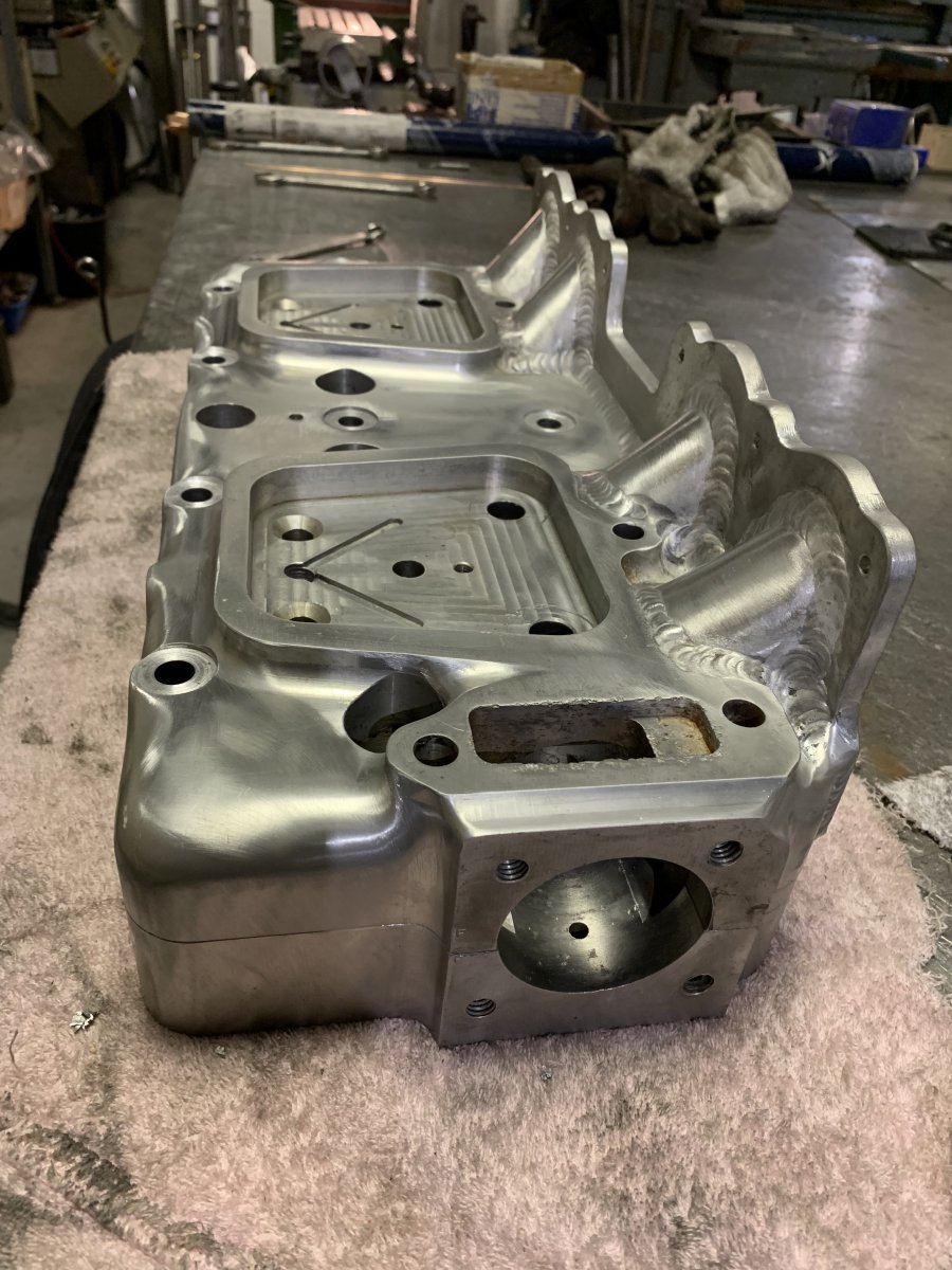

    With a flange welded on it was done. Just needed a new port to be cut in.
    I also decided to take the billet look out and took a grinder to all the corners to make them more aesthetically pleasing.
    C7C9C7AB-9F68-4FCE-8877-EF36E1D2EEDE.jpeg 5CCBE123-D405-46DA-B10A-97B2B0DC739F.jpeg CD5E4A78-2FB3-4CF9-A367-BC60F2501E83.jpeg 40B8201C-E534-4316-B49D-84B0B5321FAE.jpeg 7DCEF317-66BD-4F28-9F65-6DCBEC31BD87.jpeg C0DA8F32-5B9F-486E-A3BA-58DB7C15722F.jpeg 3B43AA71-A394-418D-B7AA-B4497C201024.jpeg

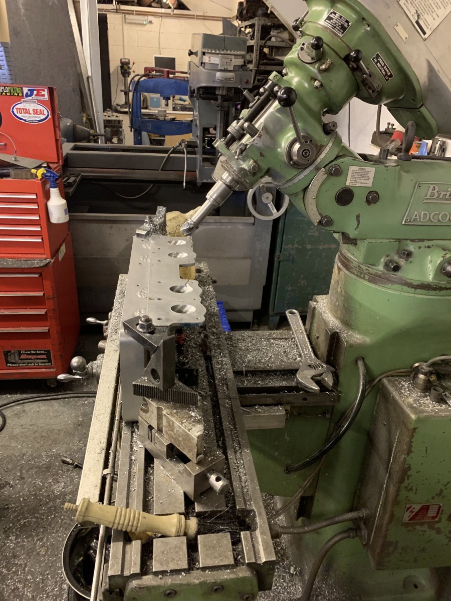

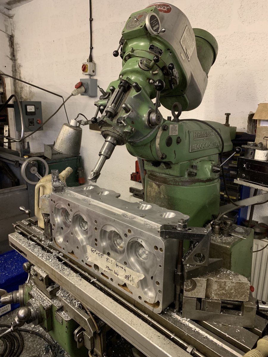

    On the Bridgeport mill cutting the new semi down draft intake path.
    BE80AC2B-5689-49BB-8A73-B836E31252DD.jpeg E4B9E51B-9FFE-478E-831B-F487766135FB.jpeg 01A034DF-6458-4EE4-B67D-E5D3DFB0253E.jpeg
    Another bit that needed to be done was to relieve the area around the valve that was shrouded.
    For this I used the old valve guides as a guide and made a cutting tool for the mill to open up the area behind the valve.

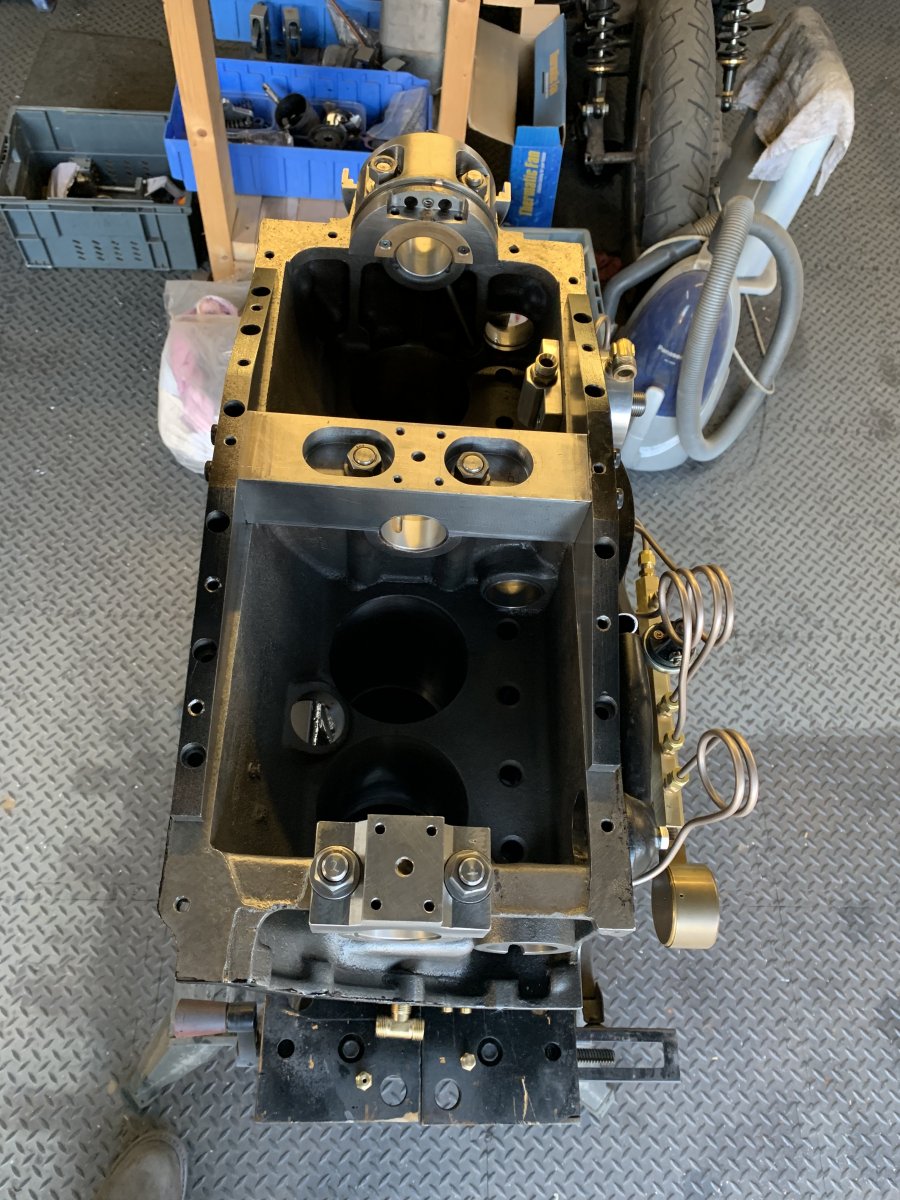

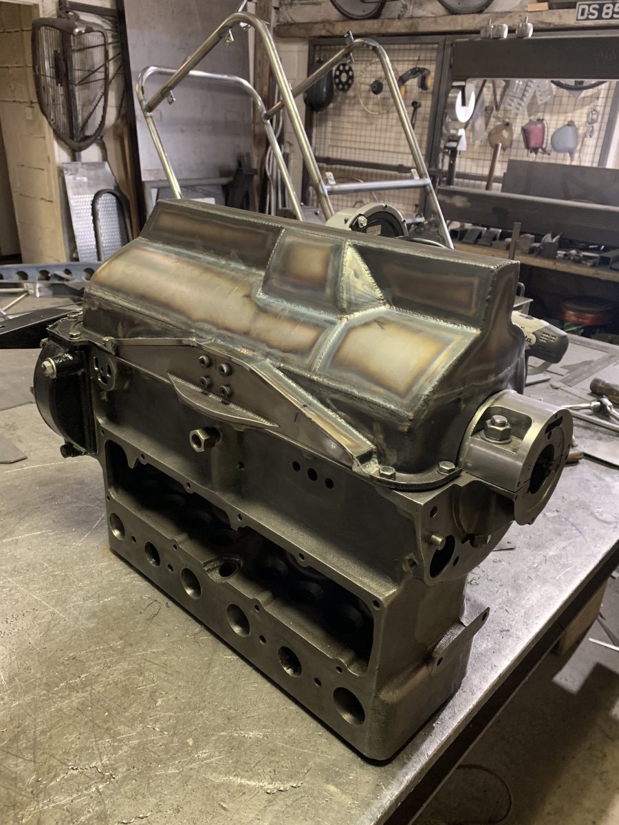

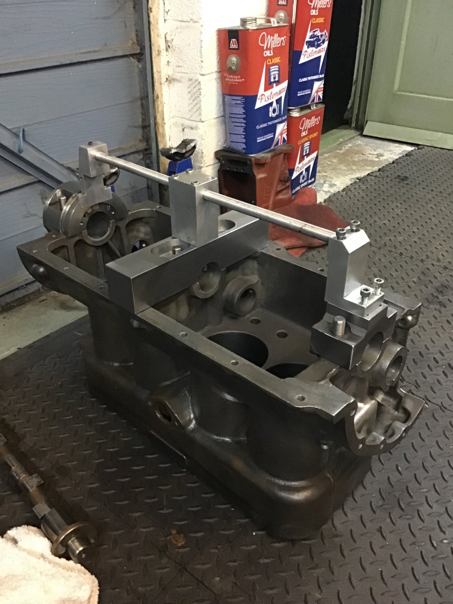

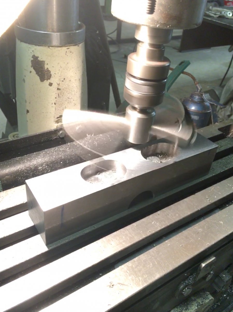

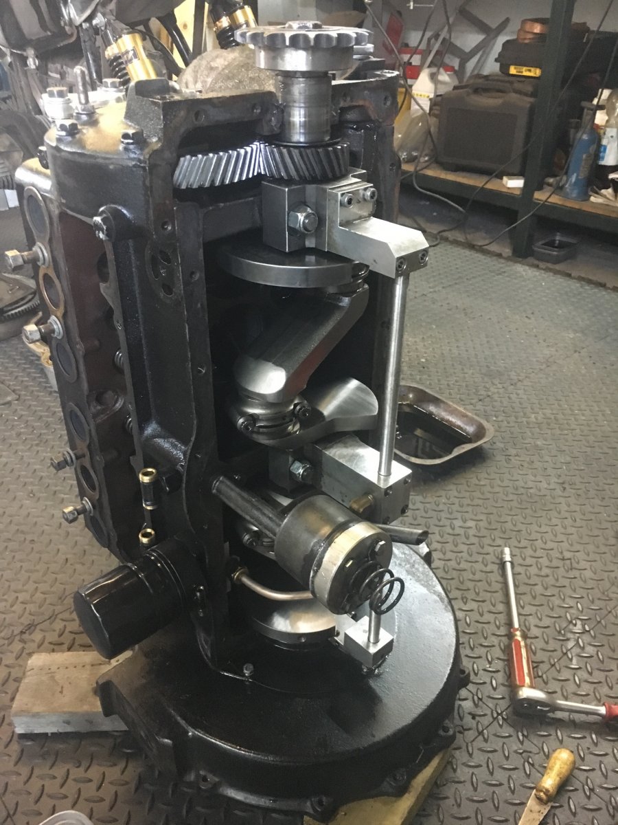

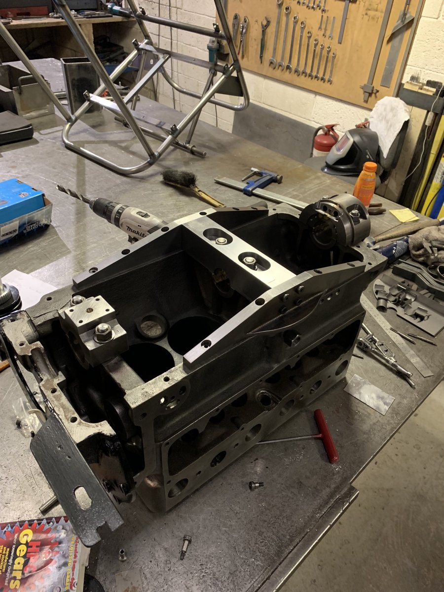

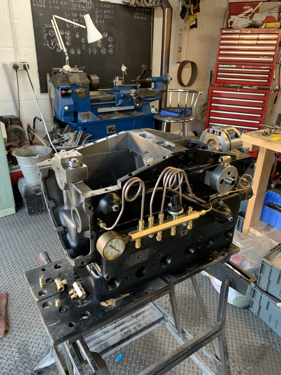

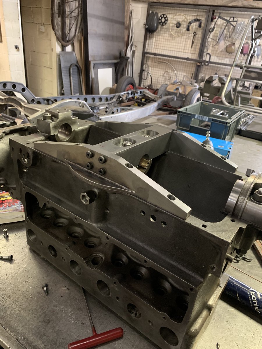

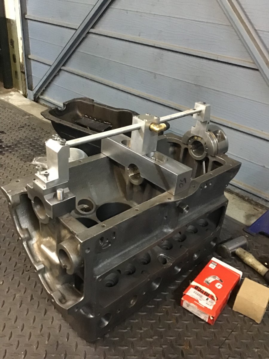

    While still working on the head I was also working on the block. I found that the AER bearings were bigger than what was used, which was good news as it would open up the bores and hopefully get rid of the step that it had. Sadly not quite enough and the small areas around the main bearing bores had to be welded. This makes it difficult for the machining as they have two differing metals and hardness to try and machine together.

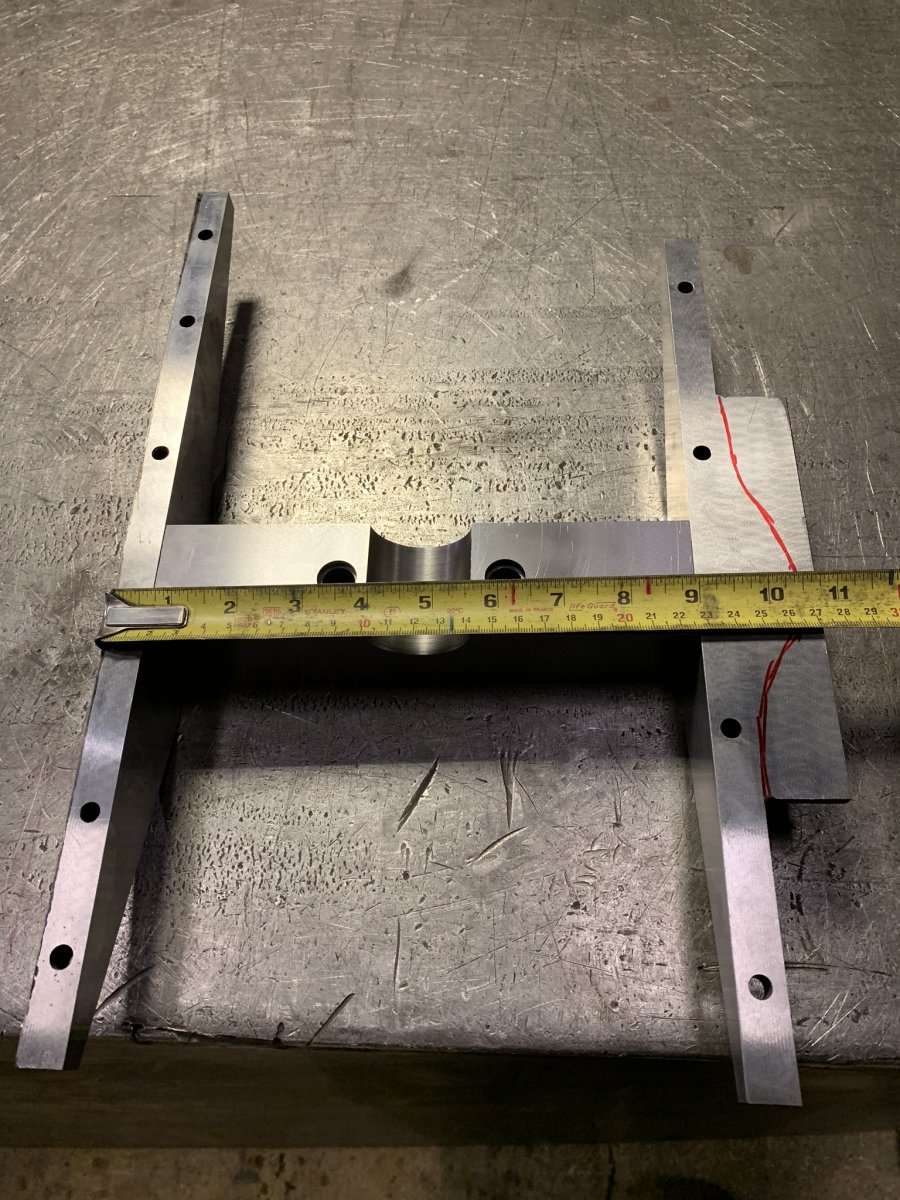

    At this point as I was having to go to the expense of an align bore I thought I might as well make a girdle to help support the centre main bearing.
    I started with a lump of 2” square, cut and machined to size. I cut a half circle on the one side with enough for machining them machine screwed it to two 5/8” x 2” side blocks. Surface ground it all flat and mounted it to the block.
    2B875005-3EB1-4F3C-ACB7-1BACA1CD8BA5.jpeg 1F271DA7-8068-449A-8A2E-519479C74D3D.jpeg E36A9EA4-0681-404F-B703-A3F1D861BEC4.jpeg 608D0DBD-B989-4C89-AB69-0F833453F9E8.jpeg 52DC8C69-DB97-409E-88AA-E627995BB110.jpeg 9B947A3F-7EA5-4DE4-ACB1-A017738FEE82.jpeg 07C42BD4-323E-4055-843E-941519B303F2.jpeg

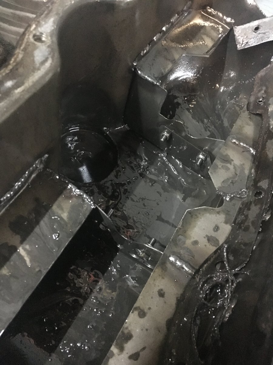

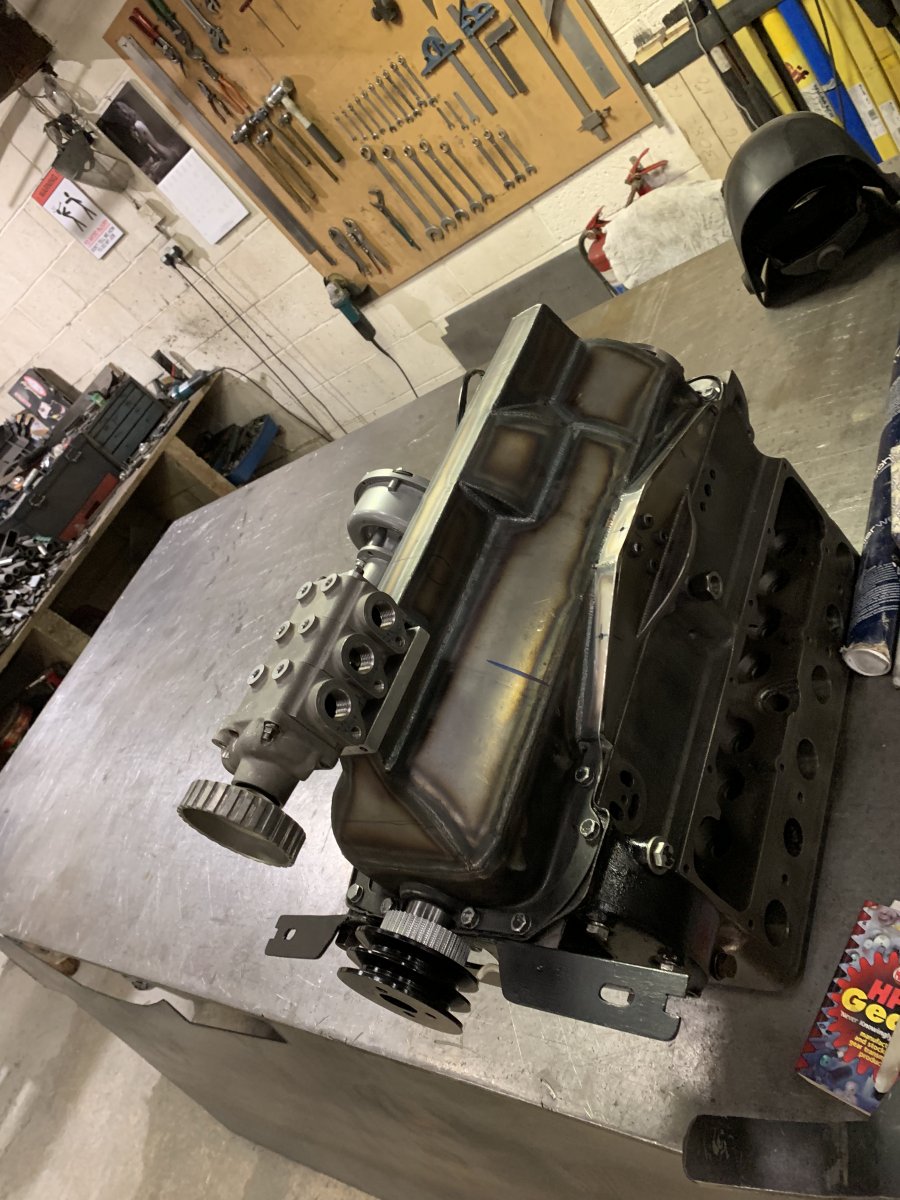

    so with the girdle fitted there’s no way the original sump would fit. I kept the bottom 2” of the sump, cut the middle bits out and fab'd up a dry sump with a centre channel.
    19E665E9-3AD2-4F97-B028-0FEF73BDBC2E.jpeg B6C49F73-B416-4A79-9DA0-A09AC14C358B.jpeg
    As I didn’t want to run the original water pump I made a mounting for an electric pump and the dry sump belt driven oil pump.
    EE919F3D-4223-41E0-A619-E3BBAC942D5D.jpeg D9F44395-4FBE-4C73-A9A4-76DF24FAD34B.jpeg 607258CD-41E0-4054-804A-FC909829DDF9.jpeg B6455F13-1CA1-4052-87C2-5CE8AEEE23EF.jpeg C87BAD31-8BB0-4927-9552-860DDFC3BD71.jpeg ED6B2147-B676-482D-BE20-CEDB8471A66E.jpeg A5890DE2-E631-4905-BB26-0232DBE432C3.jpeg AC68C1B1-2246-4F24-9C2F-19EE4F4EF11D.jpeg 37939011-9144-48B3-8114-530F036D4795.jpeg

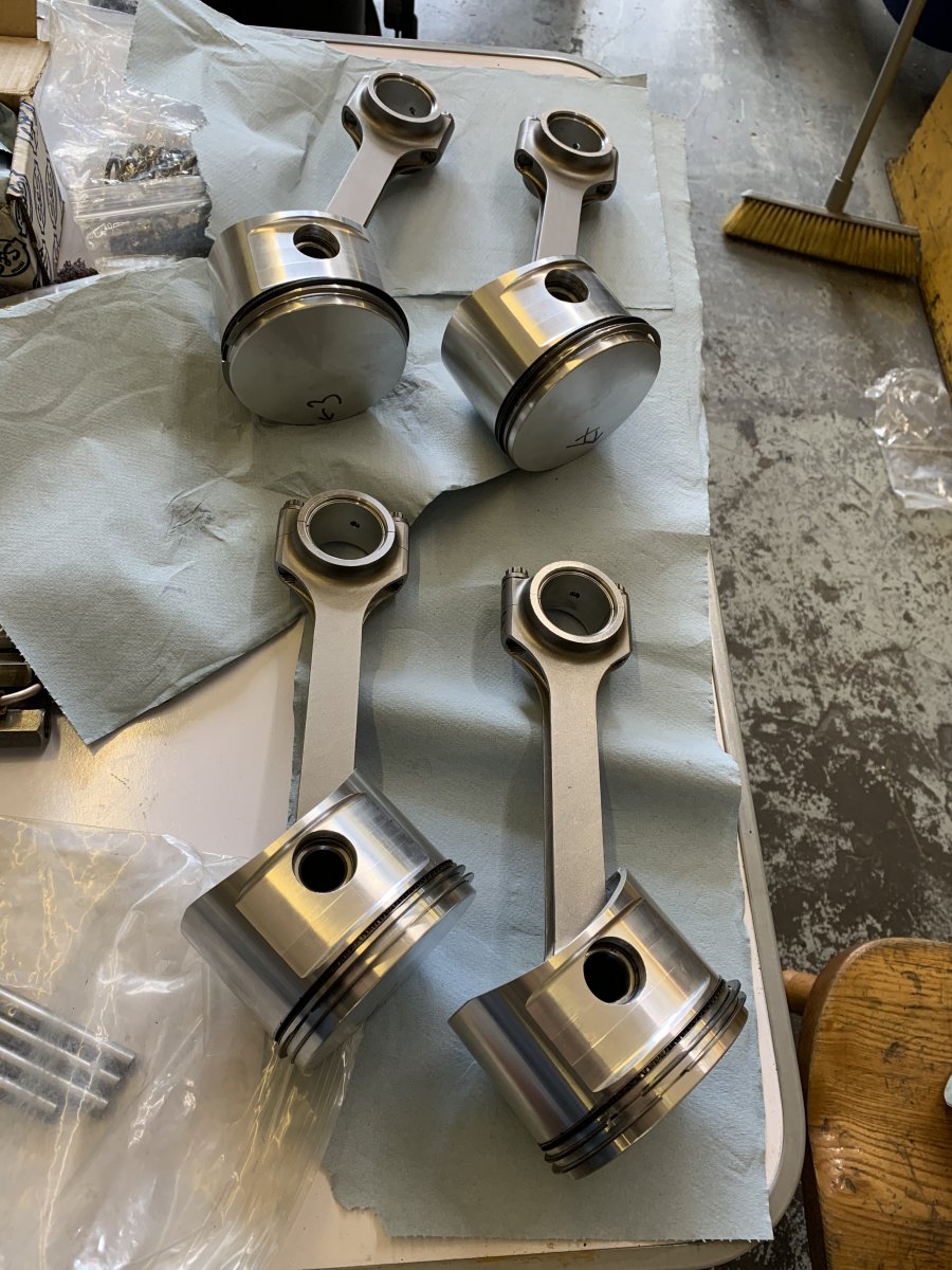

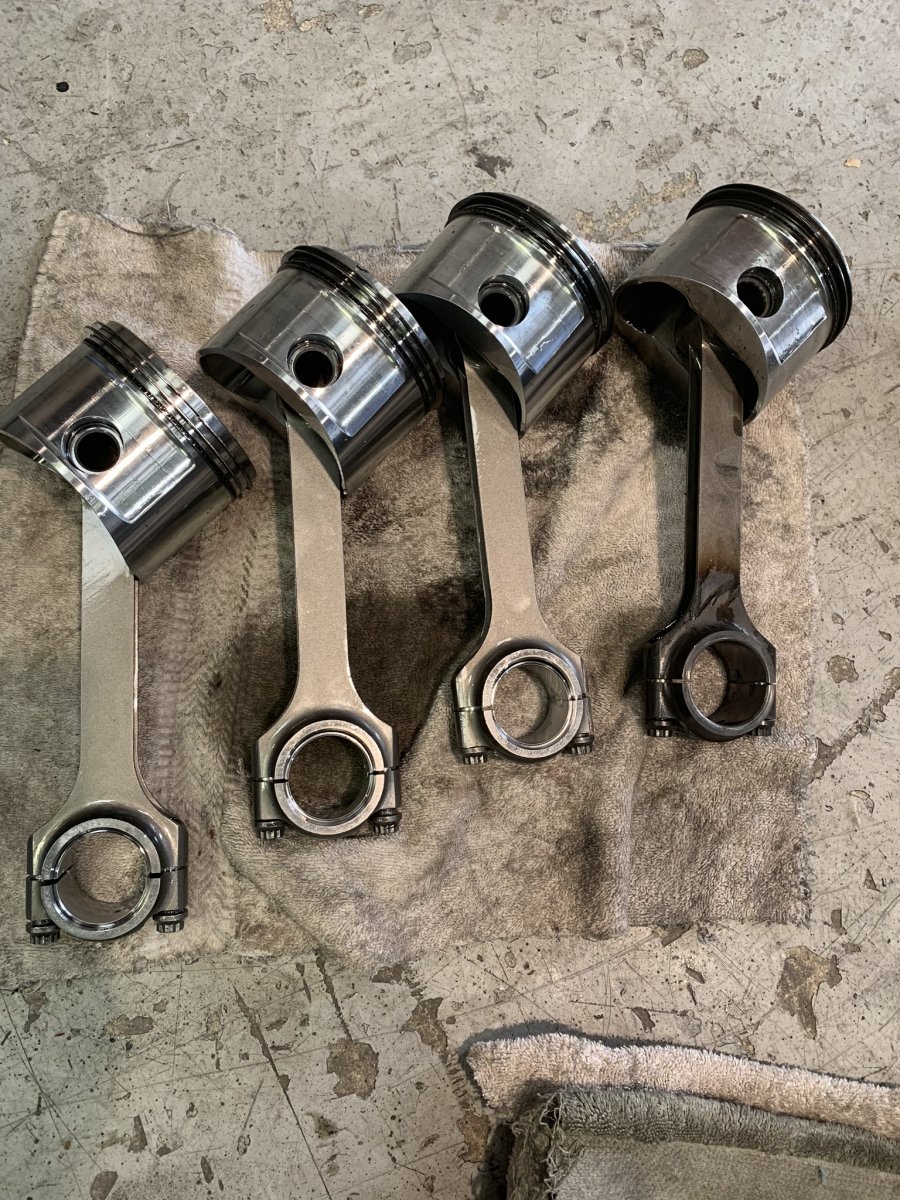

    Time to get serious. The pistons that were fitted would be fine for a stick or mildly tuned banger, but the thin top and cast construction meant they wouldn’t be fit for this engine.
    I spoke to JE Pistons and had them make me a bespoke set. Not cheap, but very nice pistons. Really thin rings too.

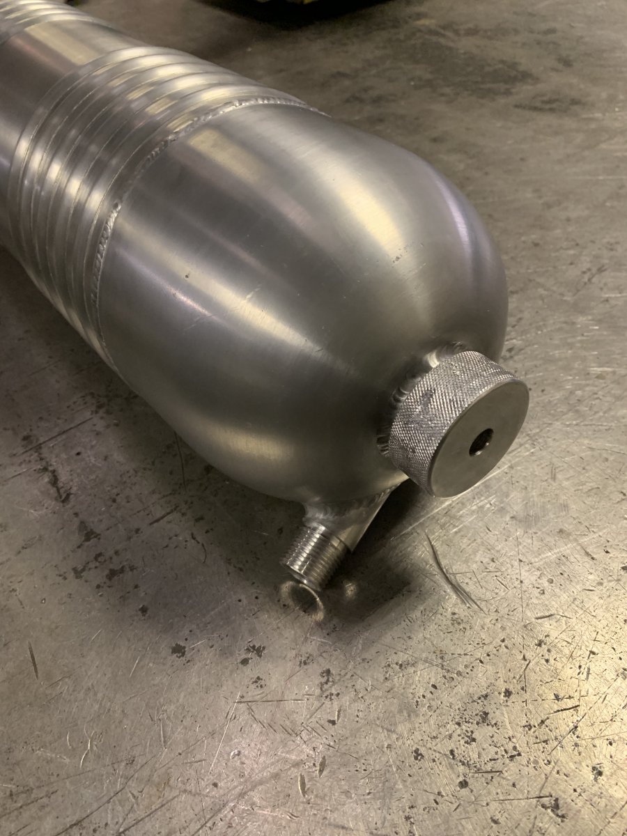

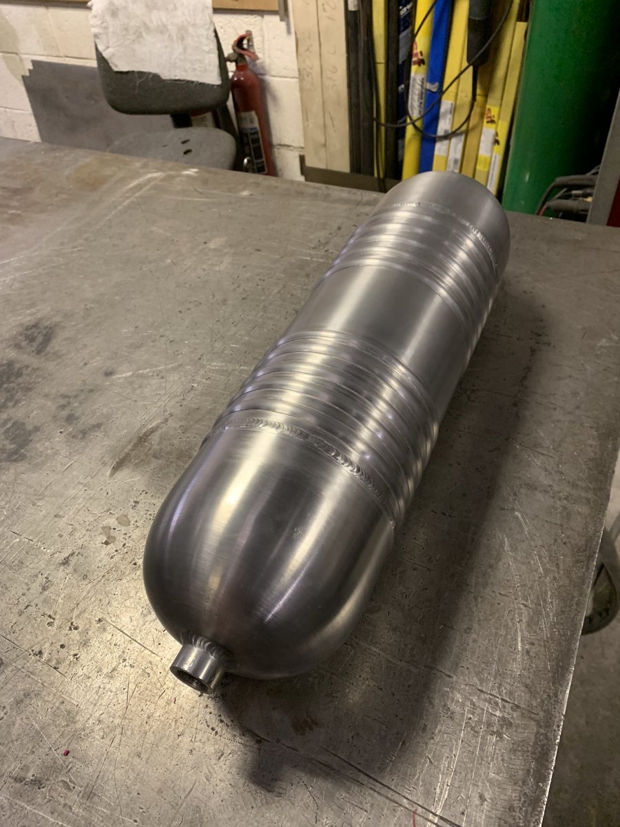

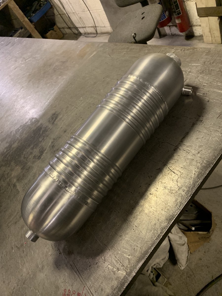

    as it was now going to be dry sump I needed an oil tank. Wanting something that looked old I fabricated one using some spun ends.
    7E0ABD1E-5AC3-46D8-92D9-650C22E51826.jpeg 5DE821C5-71D6-4111-BDBB-AB3933986C42.jpeg 3D3EC594-15A2-4AF6-A1FC-98B110D420F1.jpeg

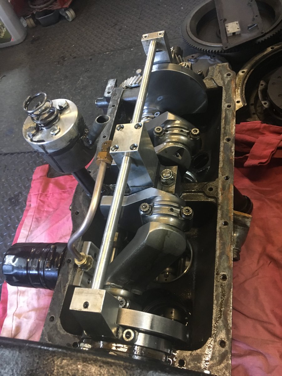

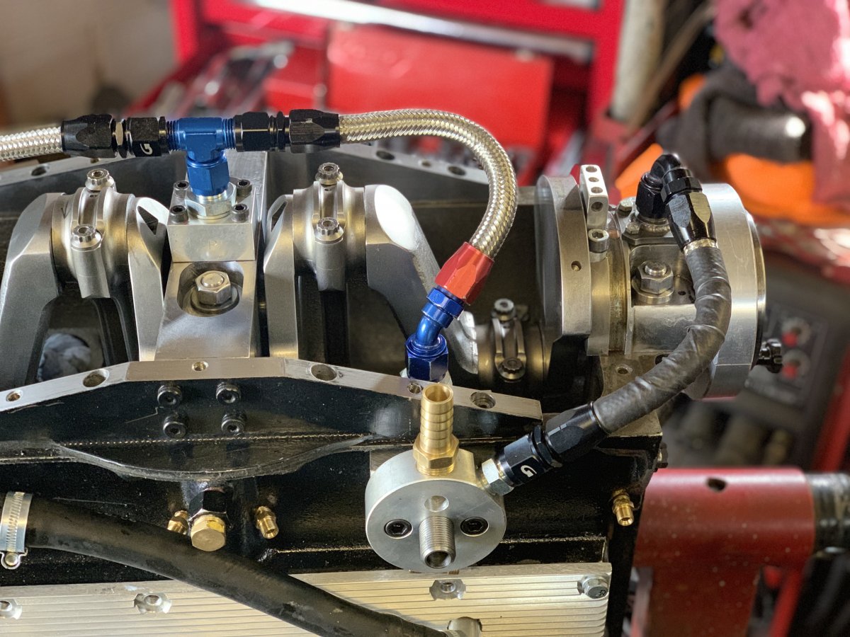

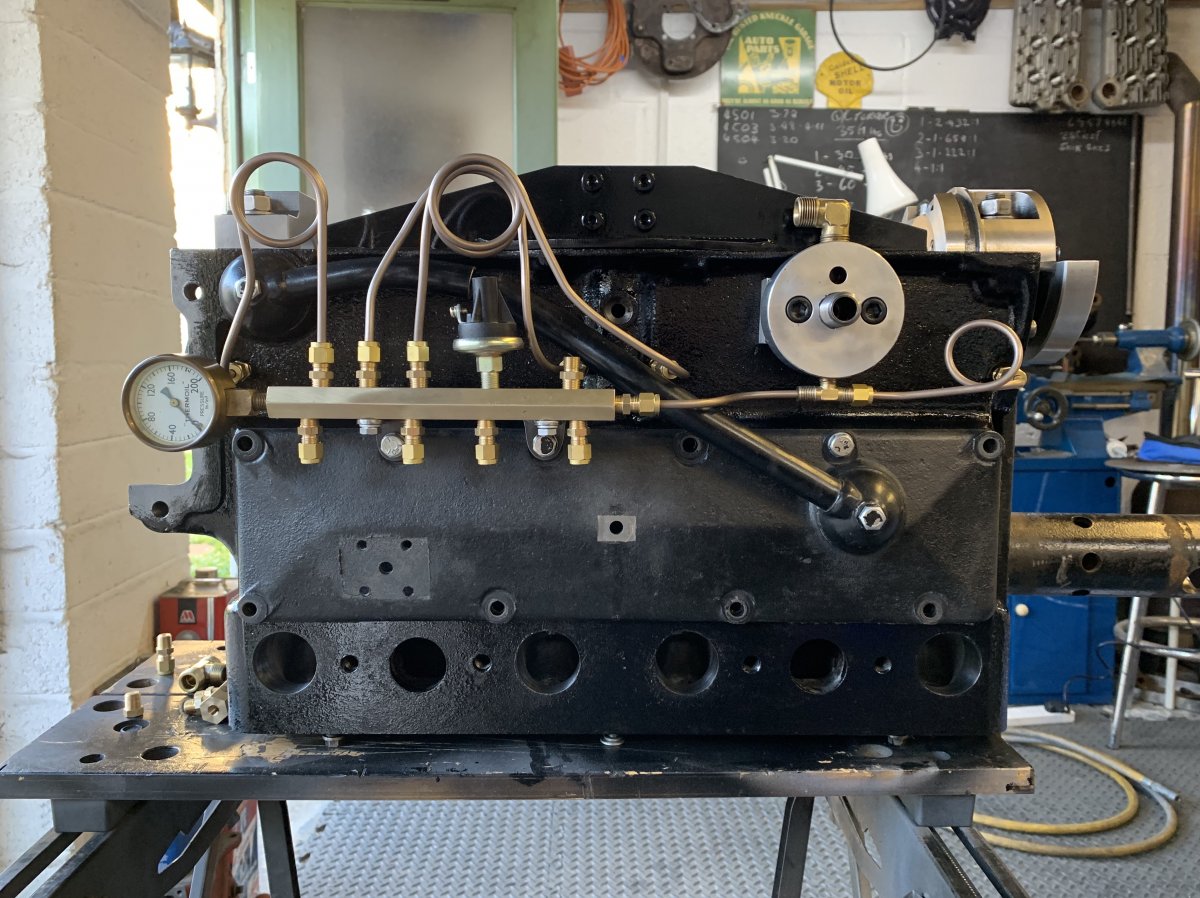

    Nearly time for the build. I now had fitted cam bearing so needed an oil feed to them.
    I started by making a br*** manifold which I could feed directly from the oil filter housing. Using small bore copper nickel lines reduced the flow leaving the majority of flow to the mains and bid ends. I also put a line to the front timing gear, the valve chest and rocker boxes with mister jets to provide a light mist over these areas.
    A41B6CCF-6B69-4DB5-8750-B680216174CF.jpeg CCB8C726-33C0-45CD-A643-911F65480B3D.jpeg 8D588CFE-15D2-4A35-91B1-F2EA1EE1DDBC.jpeg 0C4775E4-2323-4224-8B20-BA739BA59DA7.jpeg

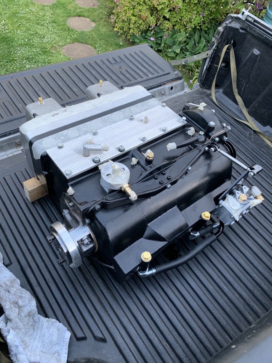

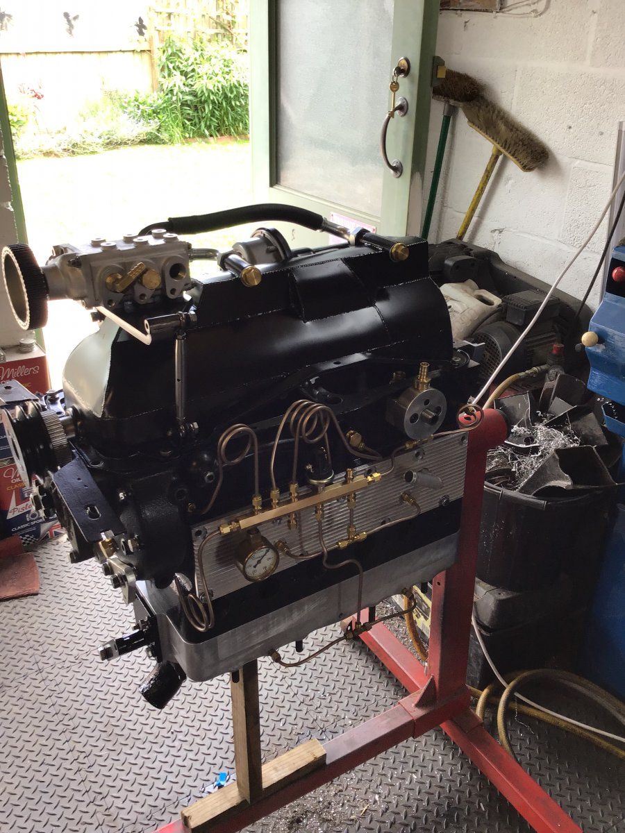

    ***an oil pump and the electric water all nicely fitted to the shallow sump. I made a fake section on the sump to look like the water pump was crank driven. It does hide the wiring so does have a use.
    FB543CF8-29F7-4BE2-A695-C9B9D02BEB58.jpeg 259312D2-CDB3-46E7-BC9F-8AD9EDF1B1F5.jpeg 43CB4F69-4FC7-46FF-B7C9-28A229727813.jpeg 4EB67703-3185-4A62-8A63-F232ABEB8A66.jpeg

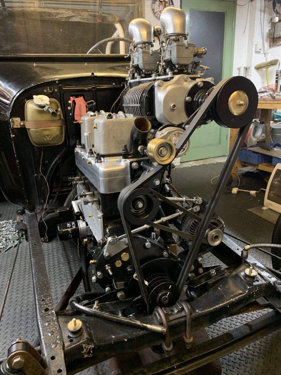

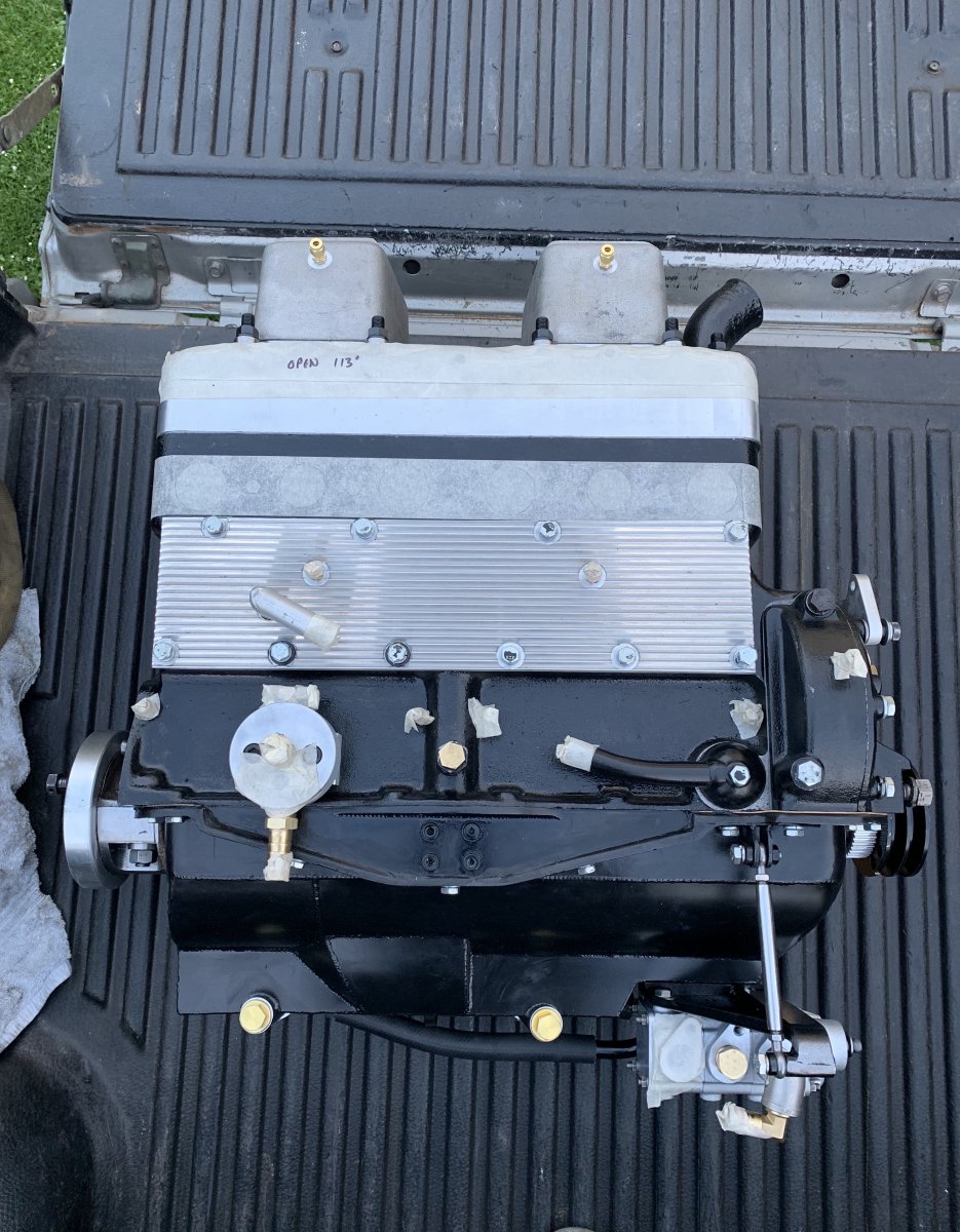

    Build day. Did it a5 my mates place with his help. All went together well. I was really happy. Just need to fit it in the car and run it up. 4 weeks till Pedine, not long.
    6A3C9B91-2D59-4546-AAA9-07427B941BE8.jpeg 81E3E120-6F6D-47AE-83C7-66B3CF04DC4F.jpeg 8F6F6768-FC38-4DFC-9B84-3F7DC918455D.jpeg 43F86690-869F-42EE-A6CE-56C9C60050E7.jpeg 9843510A-75A9-43AD-BEC2-19B152E8E79B.jpeg D8F97F96-68E8-4C45-8860-1BEE9EBA70DB.jpeg 31F6030D-0387-4C65-83B7-0EF90B6A61B2.jpeg
    Sharpone, Fordors, Tat2Neil and 27 others like this.
  11. nutrocker
    Joined: Jan 12, 2007
    Posts: 444
    nutrocker

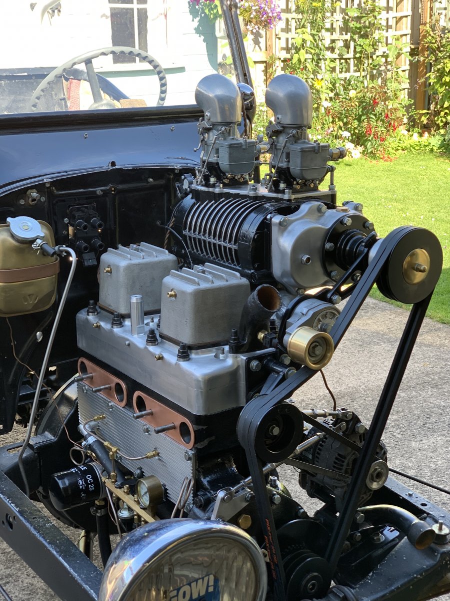

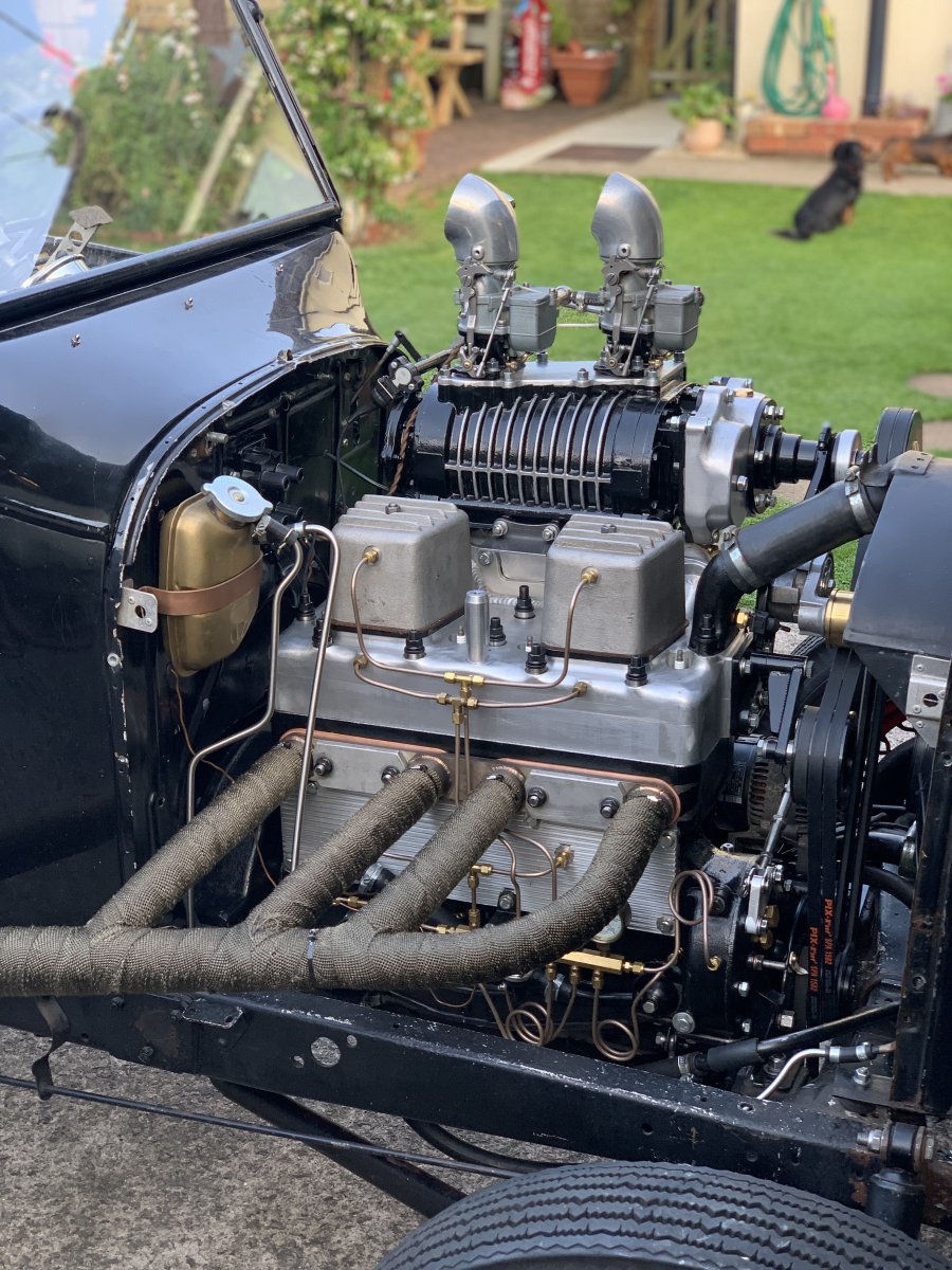

    All in, blower on, filled with fluids and ready to go.

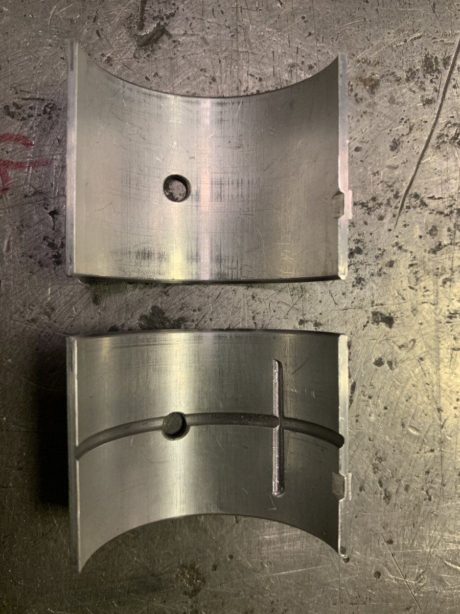

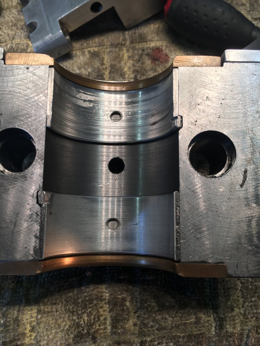

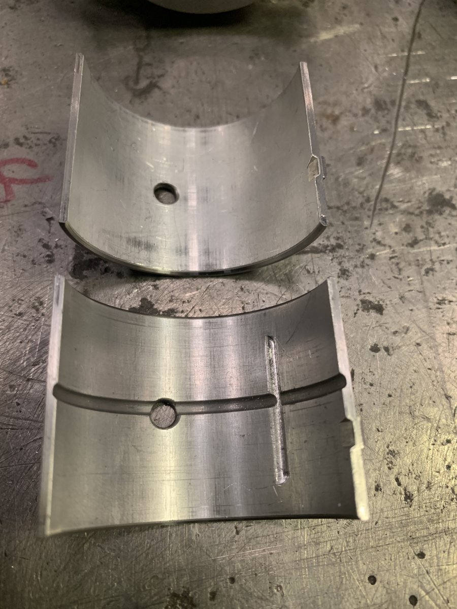

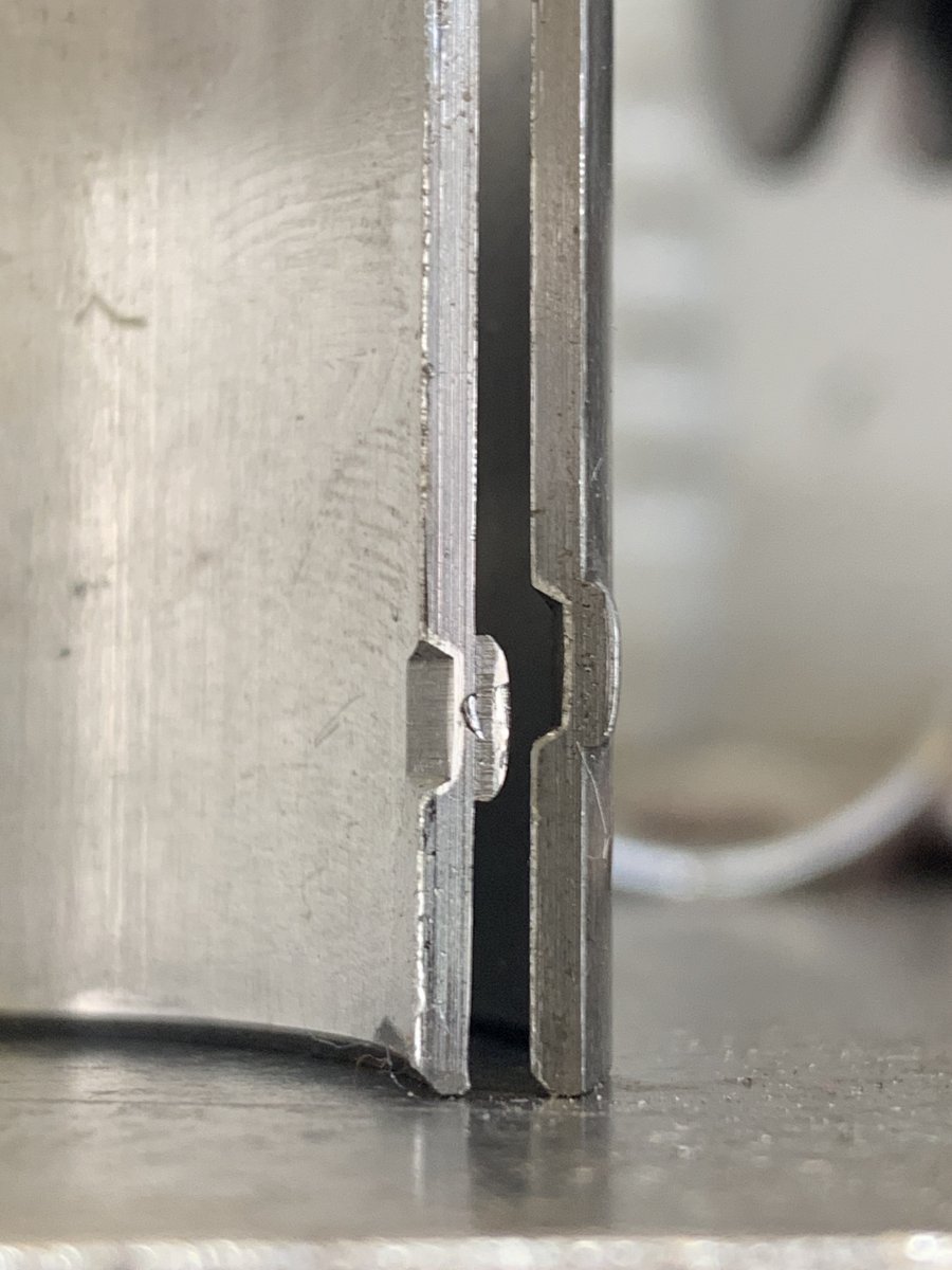

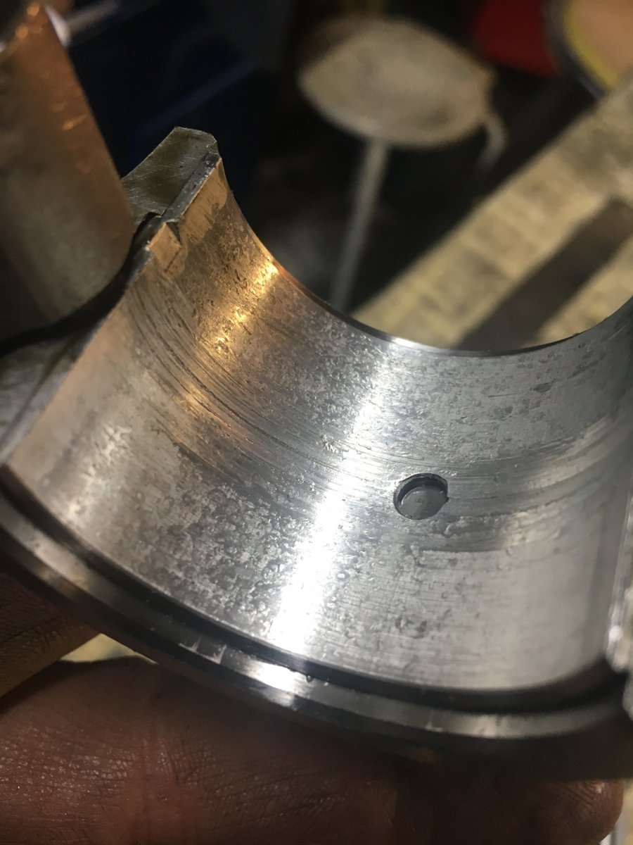

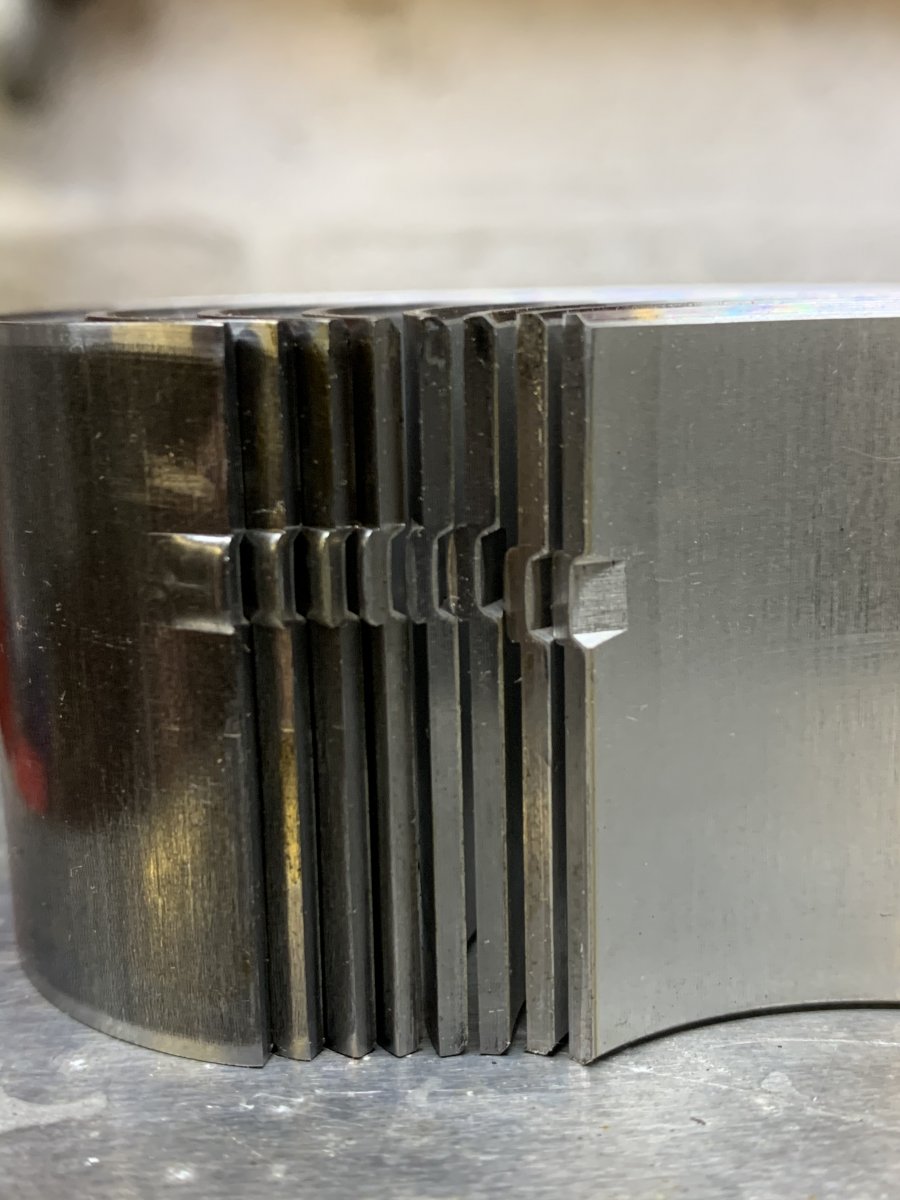

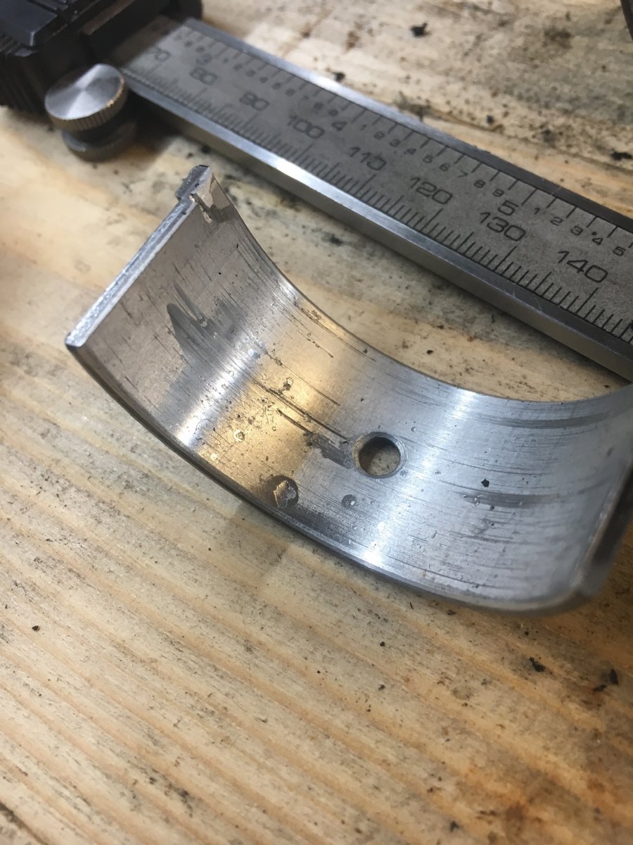

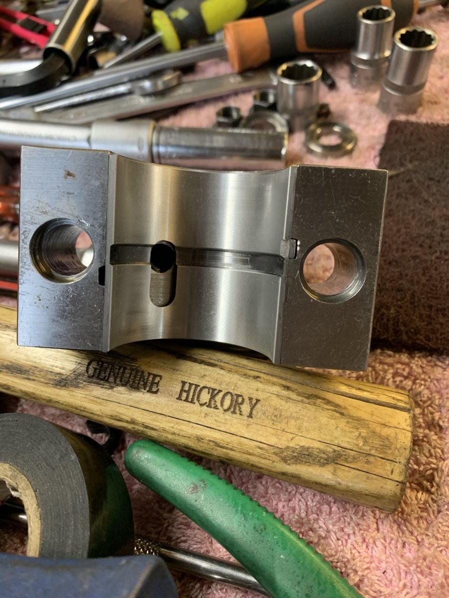

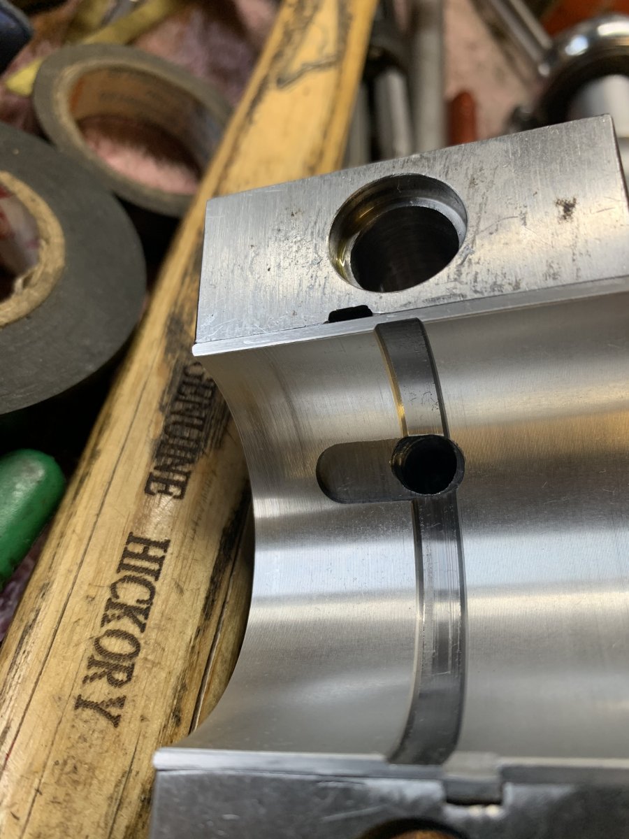

    It fires up well, runs nice, or did. 20 minutes it ran for until squeak squeak squeak. ****! FAD734A1-8D55-4F95-8BF8-00A9D05126C9.jpeg
    On inspection we found the bearings from **** had the locating tangs in different places. Bingo, found the problem. When we put the motor together it didn’t come to light. But what was happening was the bearings were just touching the journal radius causing them to pick up, or so we thought.

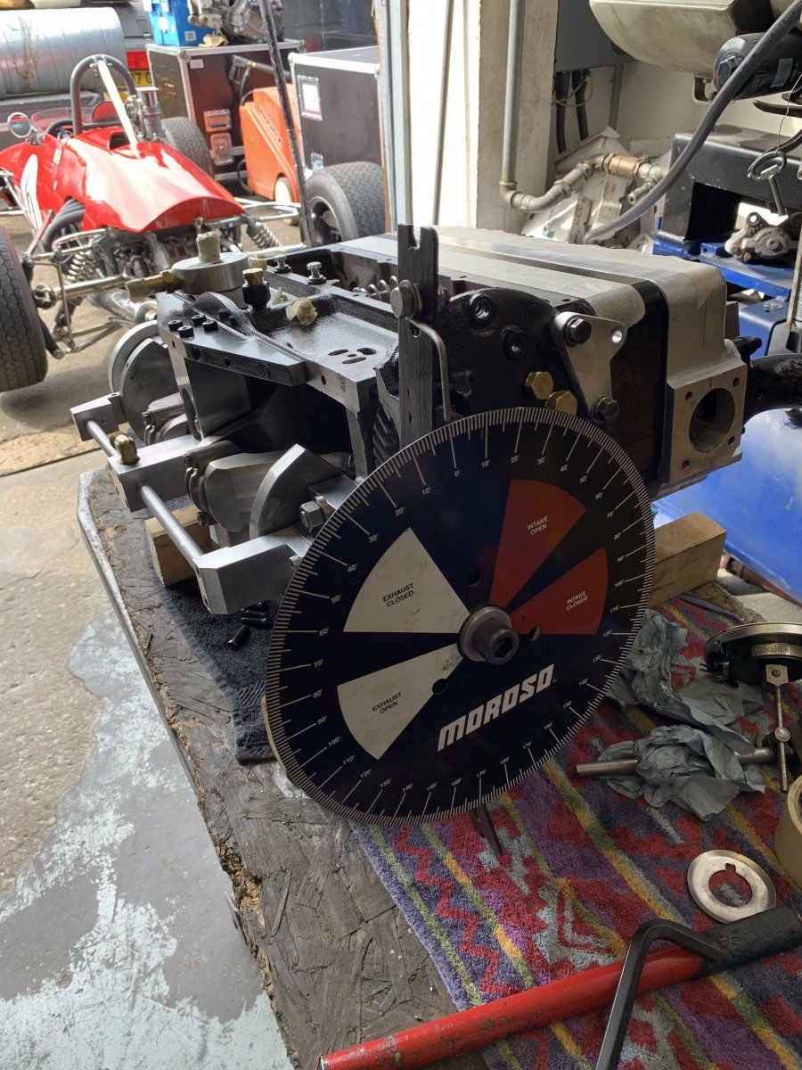

    With only one week till Pendine, new bearings were ordered, the motor stripped, cleaned a d re***embled paying attention to the clearance on the journal radius.
    All good, the motor turns over nice. Fit it back in the car. Check everything and fire it up.
    Almost immediately the same number 1 big end picked up again. Game over for Pendine that year and knowing that something more was wrong, I packed up my tools and went to Pendine in my daily.

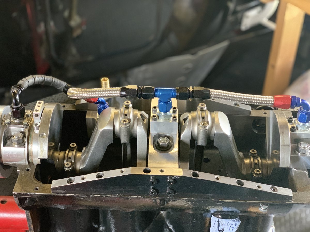

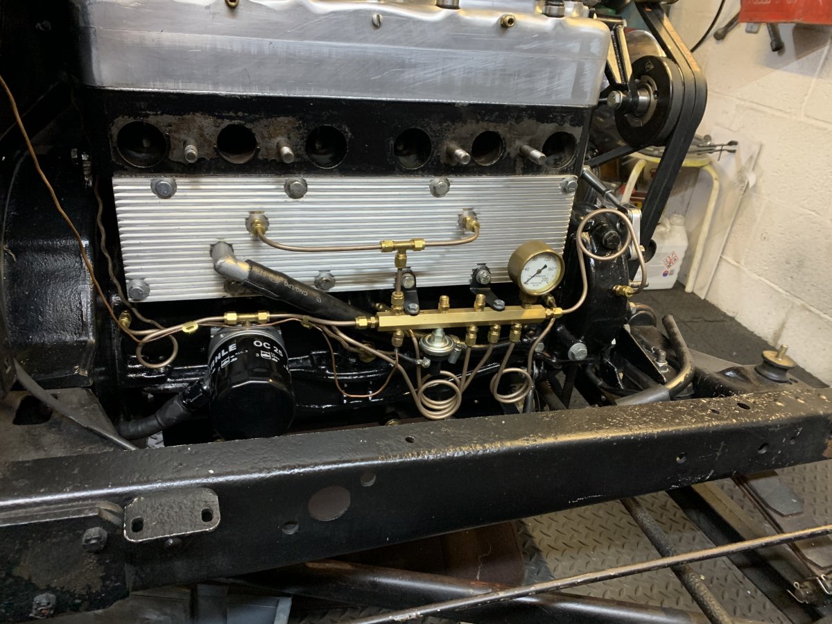

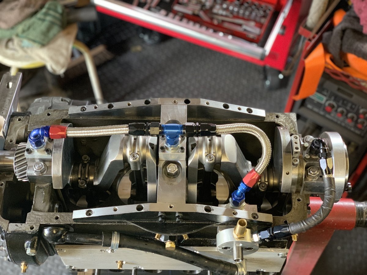

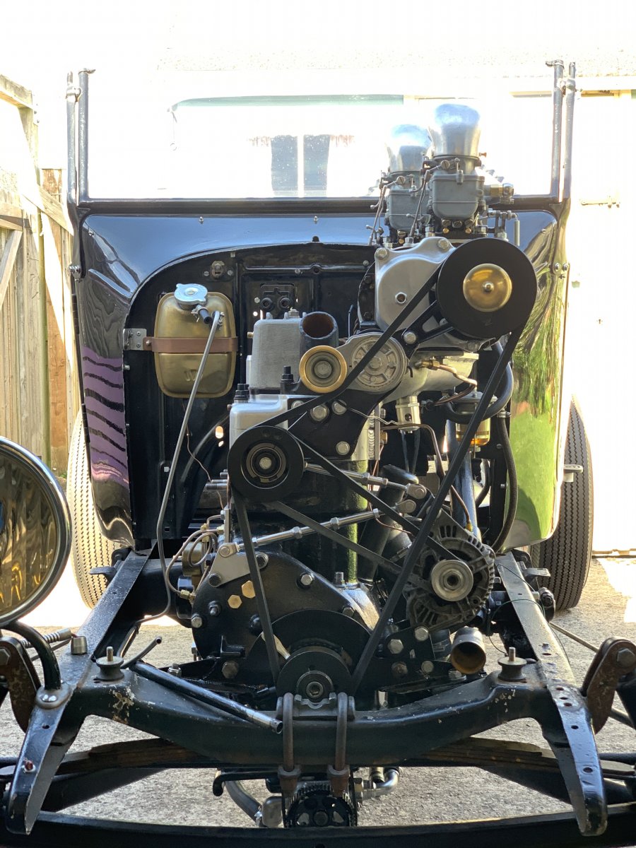

    After a month or so away from the engine I got back on it.
    so I have another problem? Must be oil feed to the big ends, it’s the oil thing it can be.

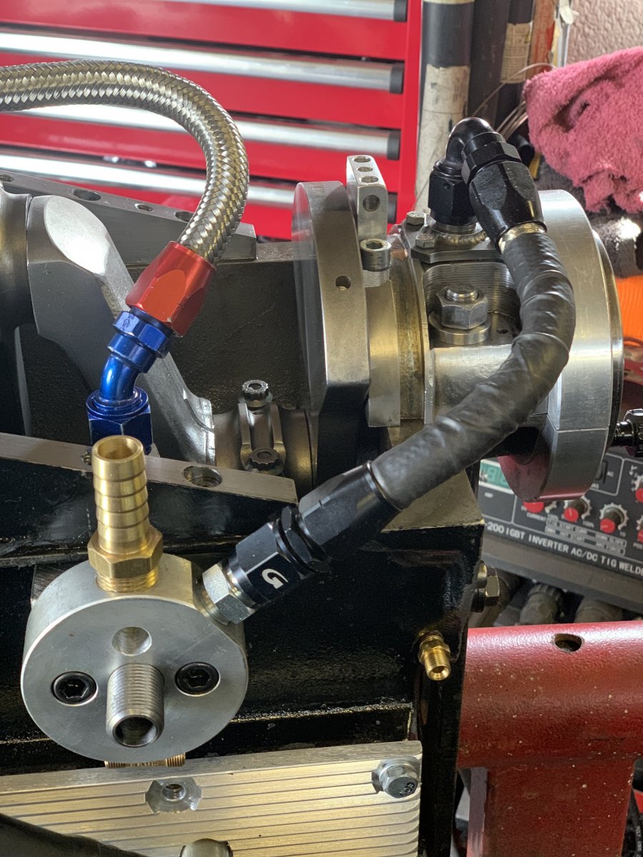

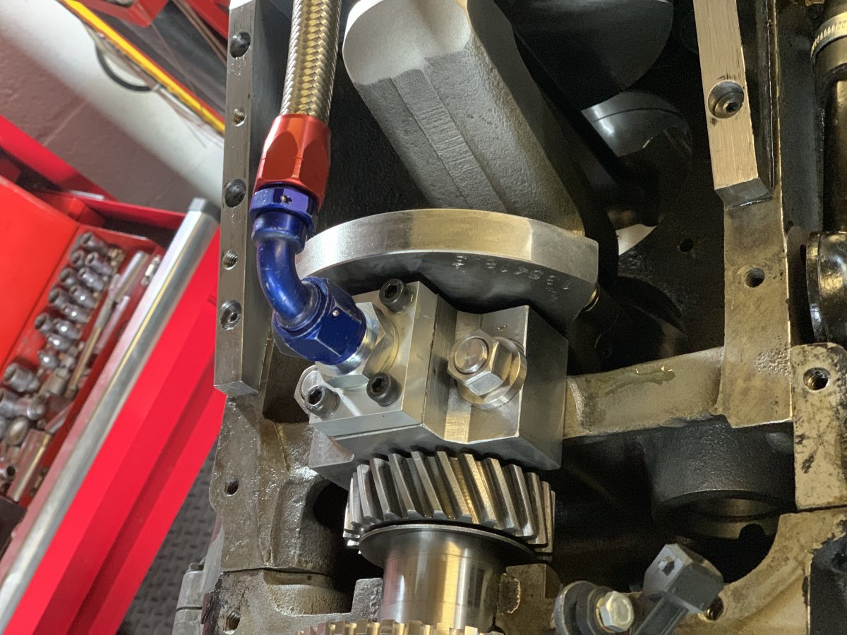

    With that in mind I replaced the whole oil feed system for the mains from the 1/4” bore of the tubes between the main caps to aeroquip hose with 3/8” bore. The rear main was now an external line with the centre and front being internal.

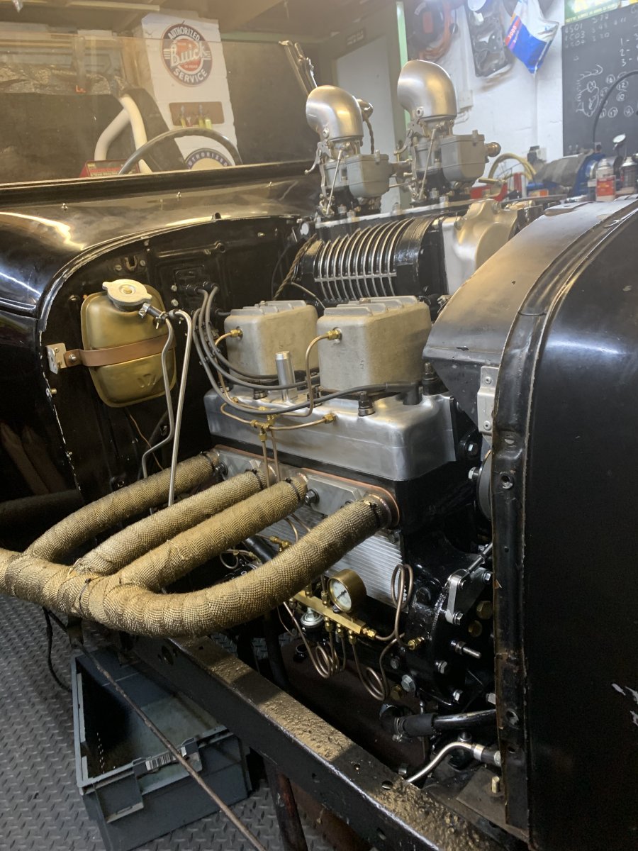

    Once it was all ***embled and with the help of my mate we powered up the oil pump while the motor was upside down on the bench so we could physically see oil going to the big ends.
    795E6AB9-3648-4CCB-B71C-B0D3DDA0E4E7.jpeg E763A3A1-4EDF-4735-9D08-3D199CF53958.jpeg 6DAA1EDE-96EC-49F4-B4B0-C569AB068108.jpeg B5690A1E-F8BD-4DBC-B113-E999CEC63F8B.jpeg 7FB55393-5220-41A5-9E79-0B8218AB3EC3.jpeg

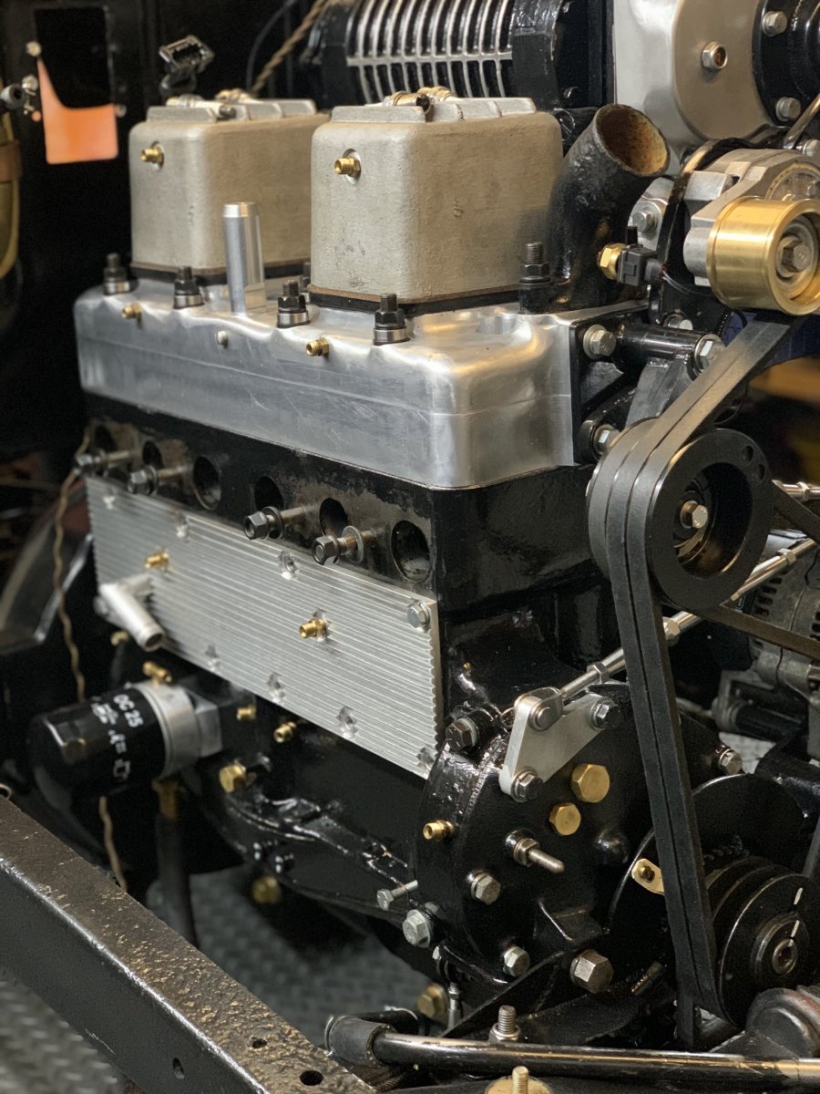

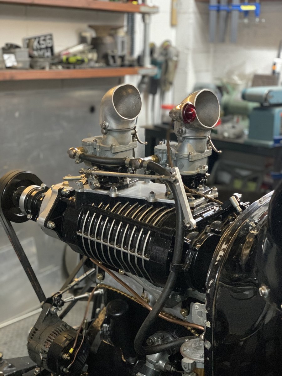

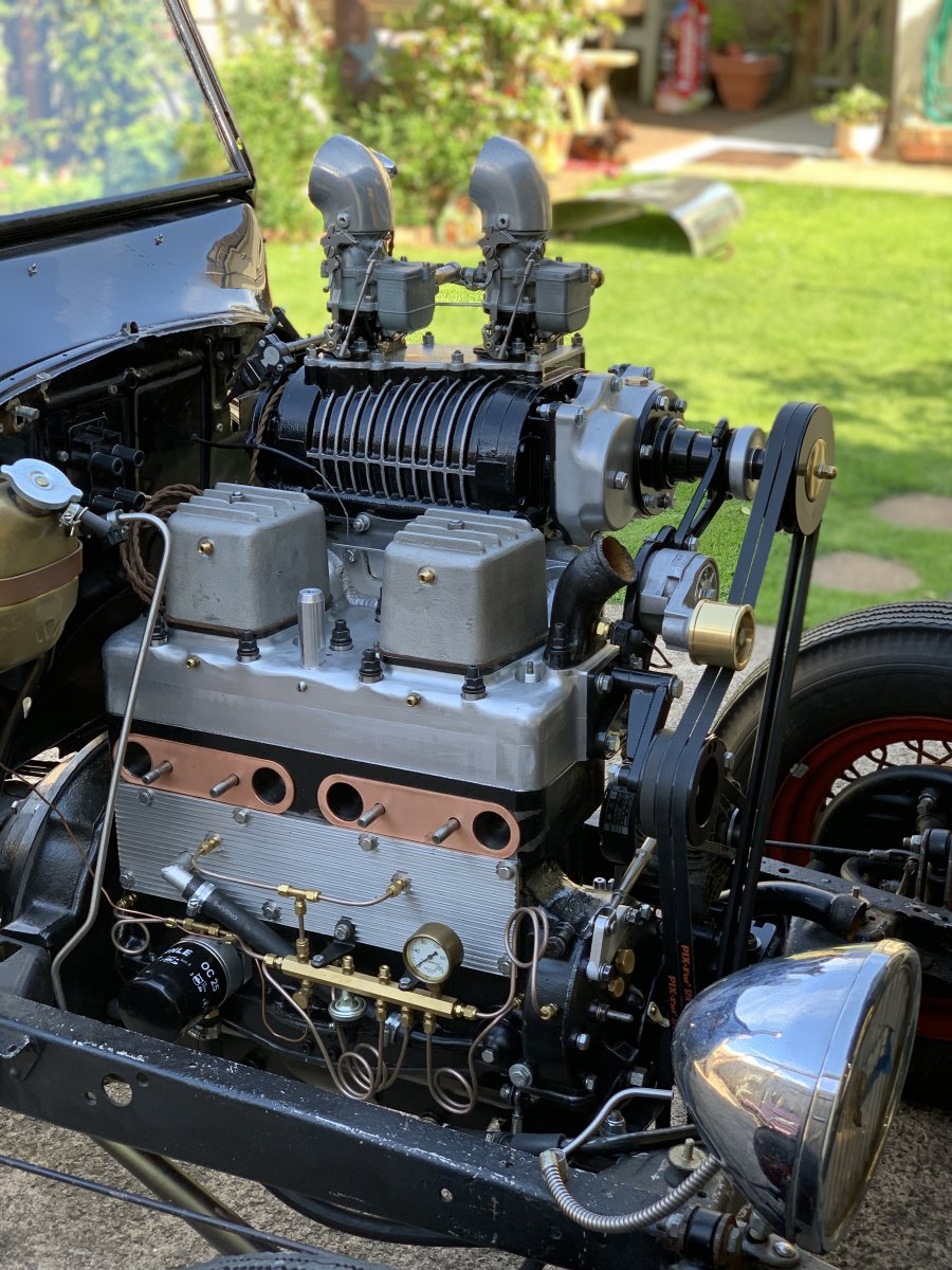

    with a bit more time, I spent some of it making the billet on the blower a bit nicer too. I fitted a sprung belt tensioner as well.
    F4F4B244-479C-4C69-963F-804CD61D0B9D.jpeg D1E77C97-D522-413D-B527-8C15BB6858B0.jpeg

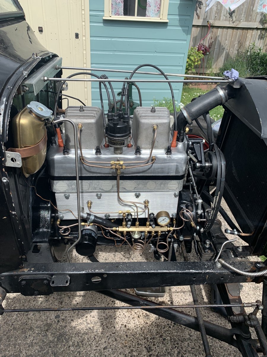

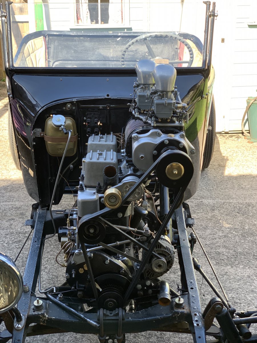

    Starting to look real nice, and with the all new oil system it should work too.
    1C7BB52A-82D7-4833-8FC1-60216E46D369.jpeg 36C05249-FC85-4E54-B640-00054729EC4D.jpeg C4F76F44-6B71-48D4-8C85-7F03016FB8DF.jpeg CA659AD3-E93D-4235-A647-9E6D8A116EDA.jpeg CDC9F164-A32F-47A1-B9C6-BC425A96A39E.jpeg 628CF8C9-E9CB-489E-8D82-8807C06E691A.jpeg FDB4512D-1FDD-4E3A-9A08-AFF7D7BBF0E3.jpeg 122235BF-4420-43F4-B7B0-AE04135C62BE.jpeg EB76CBDD-11EE-47E5-B89F-4FEC49996BFE.jpeg E718C392-0669-47BE-9080-E2AE2337DDAB.jpeg

    nutrocker
    One of the things I was happy with was the cam. Although a nice grind, one of Jim Brierley’s dual grind cams, it didn’t suit what I thought the blower would need.
    I talked to a UK cam company and told them what I was doing, what I wanted and could they help me. After they stopped laughing, asking why would I want to build a motor like this, they helped me design a one-off cam that on paper will work. So much for my retirement fund.
    With the new cam, all new oil system things were looking good.
    I even took some time out to take some arty farts photos
    6B7236F2-E8DE-4482-878B-810763CC3430.jpeg 0B52B1B0-22E1-452F-A7C7-C0FEEAF40574.jpeg

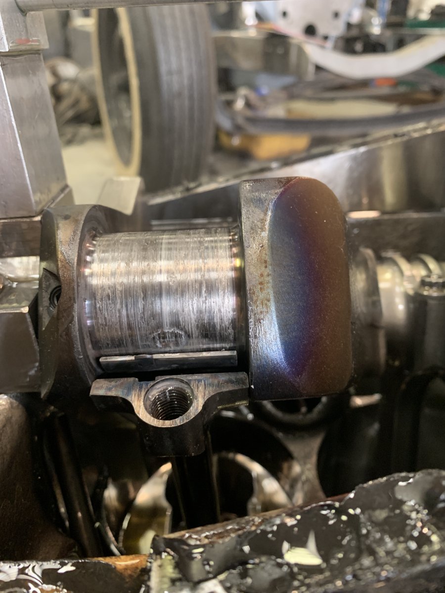

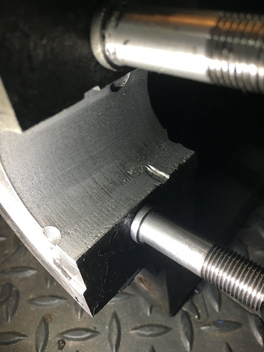

    The feeling good didn’t last long. Within a minute of the motor running I could hear that squeak. Shut it down and pull the sump.
    While it wasn’t as much as last time, it still wasn’t right.
    It can’t be the oil system.
    D7453533-C902-48F8-BF7B-3830204A0E6B.jpeg 07AB75AA-9860-466B-B900-18193B7D1066.jpeg 74A0C78B-5BD7-481D-B8B7-64544064FDBC.jpeg
    Sharpone, Fordors, woodz and 29 others like this.
  17. Dangerous Dan
    Joined: Jul 10, 2011
    Posts: 659
    Dangerous Dan
    fantastic workmanship and skills. But for a poor guy like me I could have built a couple of cars in my style of cheep rides . You are a genius. Just sayin.
  18. nutrocker
    Posts: 444
    nutrocker
    This time we had to look elsewhere.
    Had to start with the rods. With the motor upside down I rotated the crank. That’s where the problem was. As I rotated the crank I could see the wrist pin turning in the small end bush. But as the piston went up the bore the wrist pin locked in the small end and started to turn in the piston. Over centre and on the way back down it freed itself from the small end again. Is the rod bent.
    I had the rod checked for round after the very first failure and it was fine with a bit of a hone. So is it twisted or bent? On a surface table and dial gauge it looked fine, but too much chance of inaccurate readings. So I just bought a new set. Even less in the retirement fund now.
    To be sure, I also sent the block, crank and rods with new bearing off to a very good machine shop. I asked them to align hone the block, fit the bearings and measure the ID. Then grind the crank to suit the bearings rather than ask then to grind it 10 thou under. Same with the rods. Now I have no pension fund left.
    But the motor is all back together, in the car and runs very well. Still have to get it on the rolling road to set up the fuel and timing, but it runs without squeaking.
    On another note, the new bearings from **** arrived like this. To be fair, they were good and sent me replacements and thanked me for bringing to their attention.
    5592676E-0A78-45D4-A86E-EBCE8F8080AC.jpeg 959E6976-F6D4-4CD7-8A5D-0F6F33D19170.jpeg F8989D1D-8AB0-426F-8B30-BF4E1C0A514F.jpeg E2350CA3-A8BE-4CD3-AF75-FC4695F62E3E.jpeg 6161C019-002E-4E73-9E2F-4D431C92D7D5.jpeg 0514DD3E-5244-4094-BE18-59597899732A.jpeg 8C3E764B-1702-4BB9-9F6A-AAE51FF74D75.jpeg 73ECAC22-1CEF-41E1-8E85-32615F187DD0.jpeg 7217899F-8937-4377-93C6-F2A89FE71258.jpeg 07348EA7-AC9E-4910-9F85-3AC1E384C470.jpeg BC048F4F-C5B9-490B-9562-1F244E982EC7.jpeg A23E7FE5-10D2-46D8-A39D-1E72D3599806.jpeg

  20. Smrtmike
    Joined: Nov 11, 2018
    Posts: 21
    Smrtmike

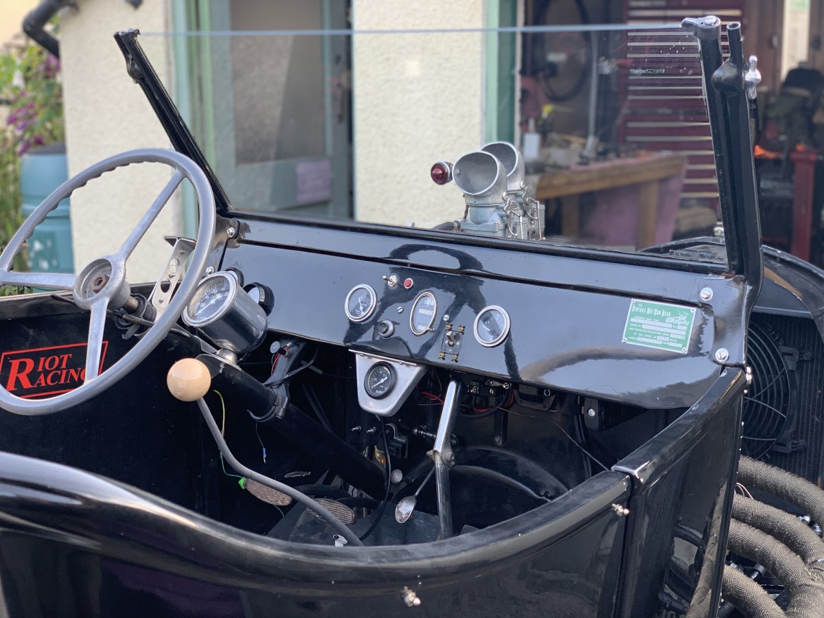

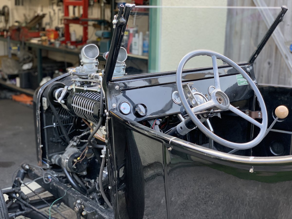

    I like the shift light on the rear carb scoop. At least that’s what I think the red light is for. Or is it a low oil pressure light
    Sharpone, Stogy, HiSpoke and 3 others like this.
  21. nutrocker
    Posts: 444
    nutrocker
    It’s oil pressure warning light.
    If I have the tonneau cover on I can’t see any of the gauges, and having blown up a few motors in my time, knowing oil pressure is a must.
    Sharpone, deadbeat, Stogy and 6 others like this.

    So end conclusion is that #1 rod was bent or twisted causing the bearing to rub on the journal harder than the oil film could support causing the bearing to gall up? Now for a run!
