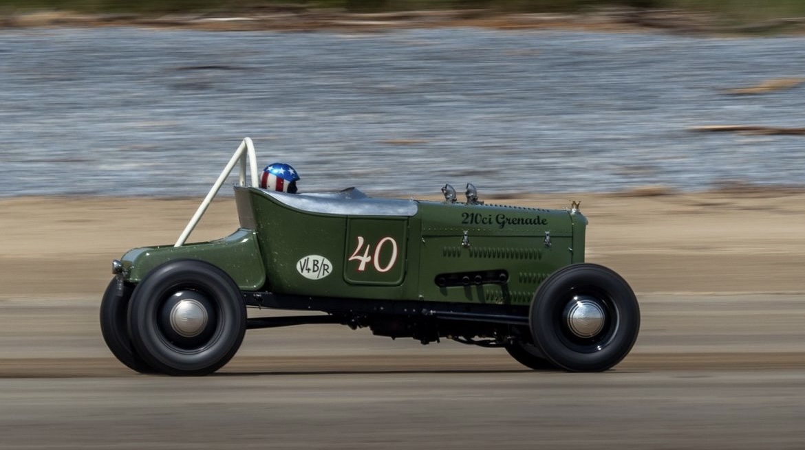

    VHRA Pendine was as great as usual, so big thanks to Neil and the team for all their hard work.
    Now I’m back and caught up on a bit of sleep I can up date you.
    I flat towed the car to Pendine, the last thing I wanted was to break it before I got there.
    The car ran great, never missed a beat. First run on Saturday morning netted me a 102.06 mph. The sand was slippery and I was still fighting to keep it straight through the timed section.
    I have an old cell phone with a speedo App on the dash, which read 100mph as I got to the first of the timed section flag.
    The second run, for me the sand felt better and I was all settled in before the timed area. First flag I had 102 on the speedo but a rear end step out between the flags knock 3mph off instantly. I only just managed to miss the second flags on the way out.
    That was it for the first day.
    Over night I removed the headlights and fitted some washers under the dump valve spring to get a bit more boost.
    Sunday there was a strong head wind. No way would the car be able to run faster. So 102 mph will do for this year. Happy with that.
    I got there and ran a personal best with the car, got the car home in one piece, what more could be better.

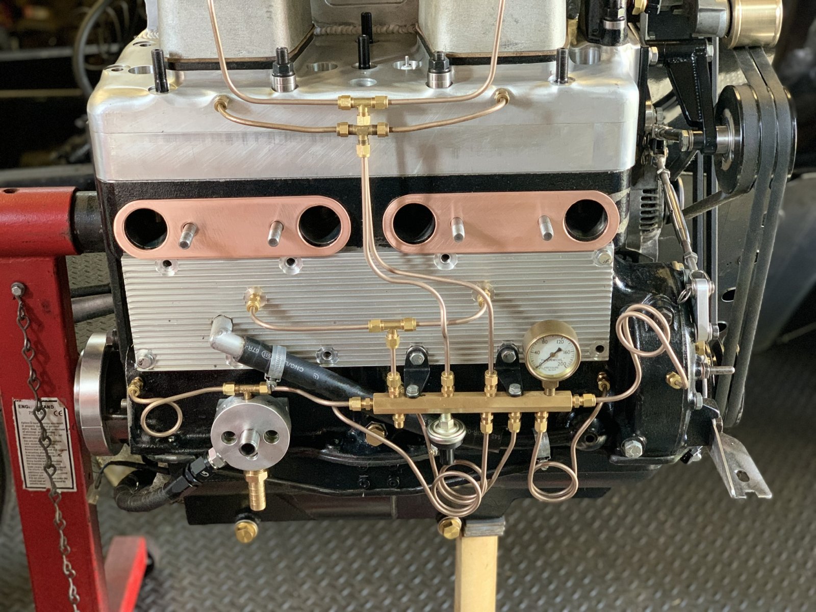

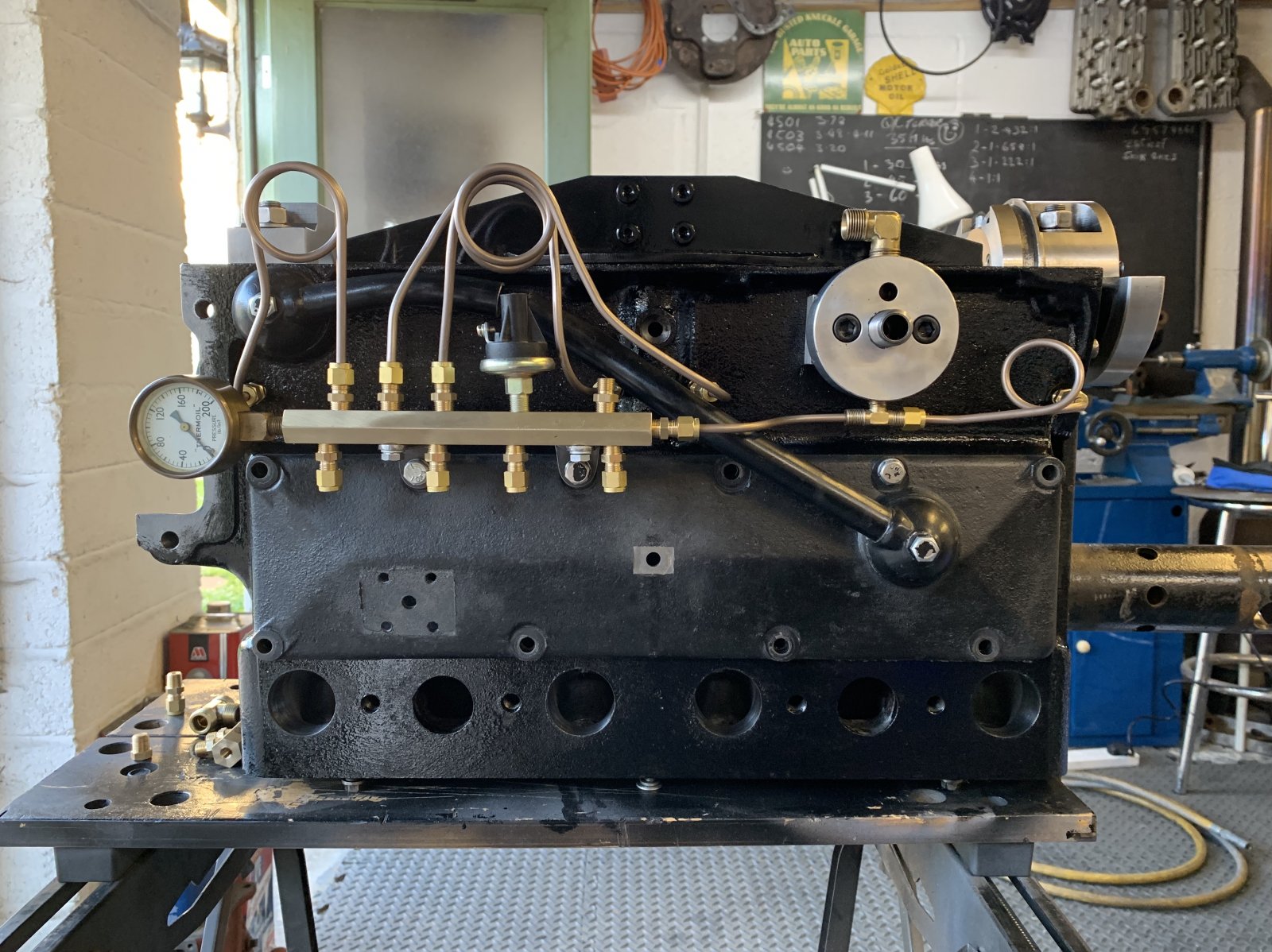

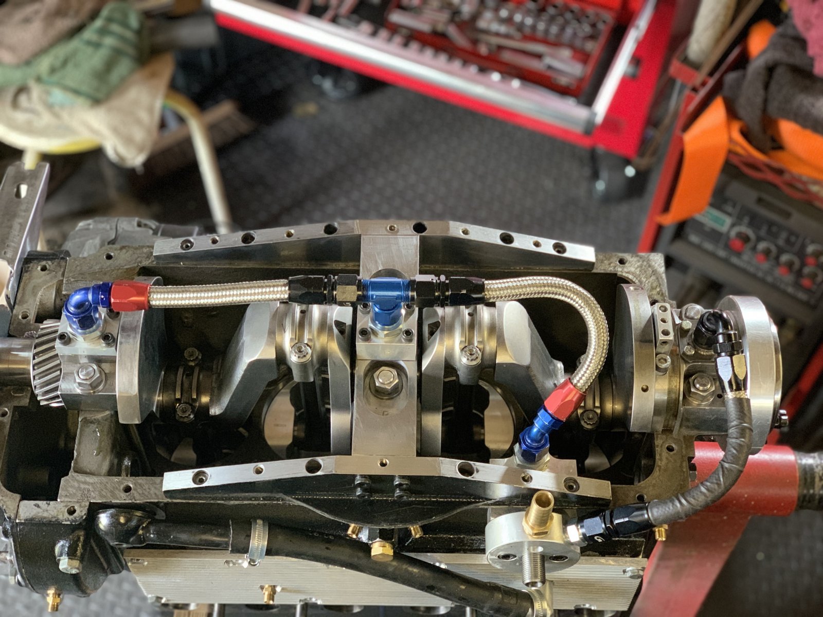

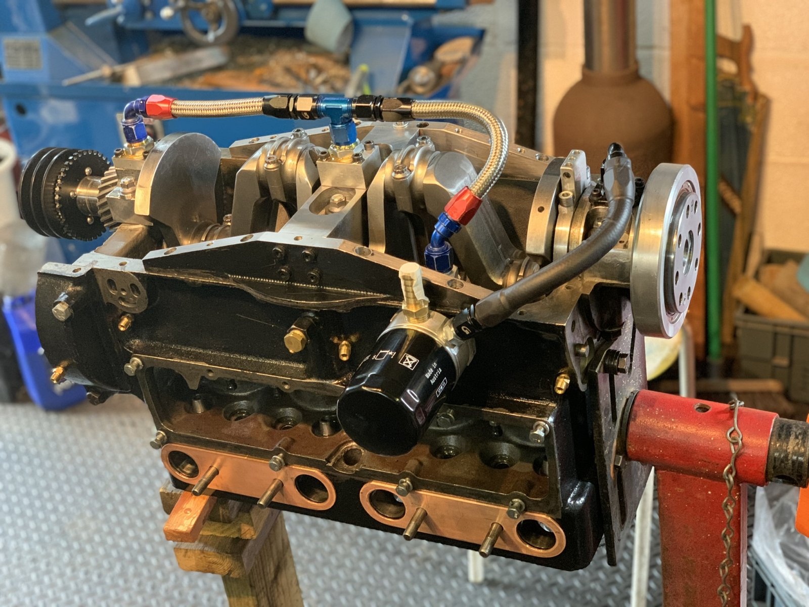

  9. Pete, absolutely love your work! I'm @bangersmodified on instagram.
    Do you mind shedding some light onto your dry sump setup? I'm planning on doing something similar on a Sprint Banger I'm building.
    Stogy likes this.
  10. nutrocker
    Joined: Jan 12, 2007
    Posts: 444
    nutrocker

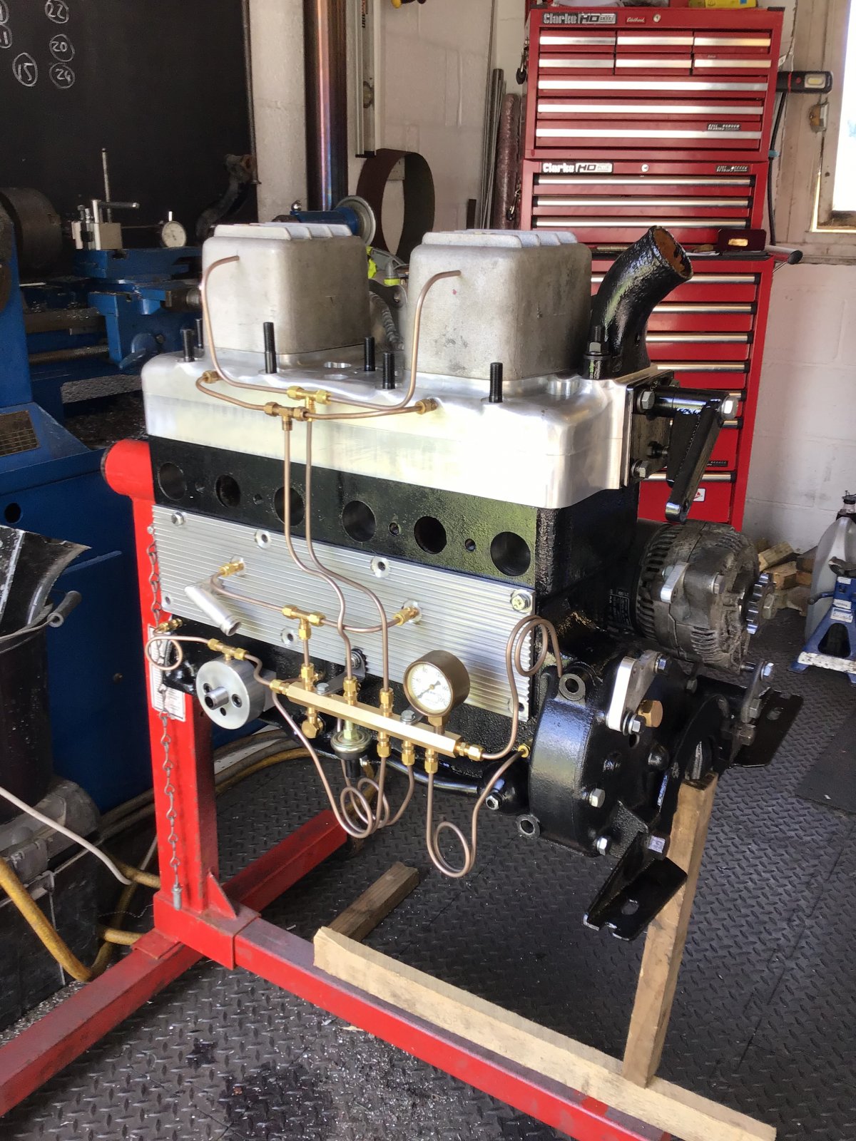

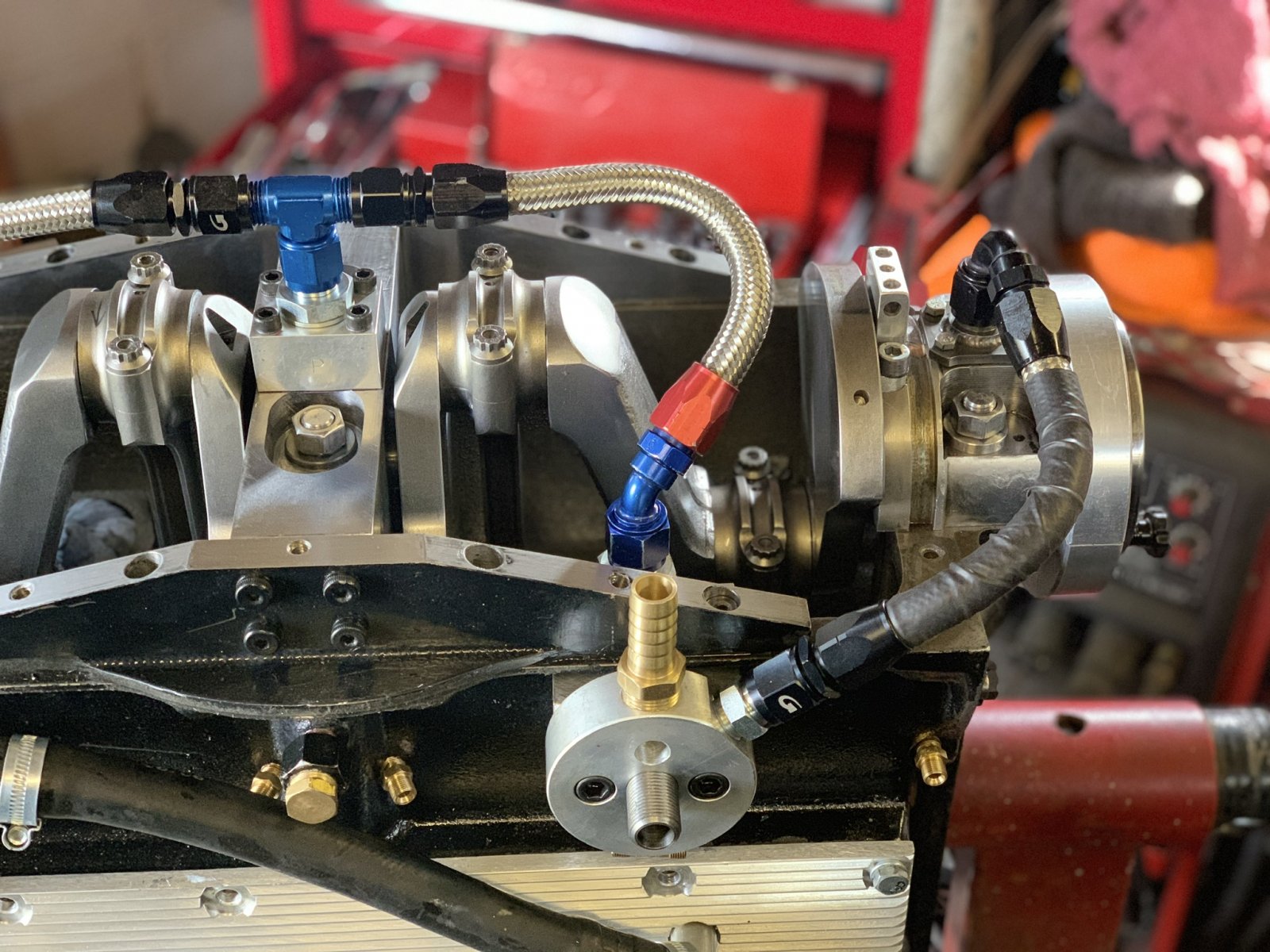

    On my engine, I used a ***an oil pump that’s belt driven off the crank. It has two scavenge and one feed. The idea is that the two scavenge pumps **** the oil out of the sump quicker than the one feed can pump it in.
    A0779DF0-AE2D-4F66-AE44-6D1F0E645BAB.jpeg 51D1B8B8-60F6-4F0C-B9F7-C26AC11E9BB8.jpeg 095BFC91-EC31-431A-9F34-2C5518BB0064.jpeg
    I have the feed from the oil tank to the pump, from there it goes straight to the oil filter. The oil filter is mounted on the side of the block which allows both internal and external oil lines.
    The internal line feeds the front and centre main, which in turn feeds rod end journals 1,2 and 3.
    The external lines feed the rear main, plus rod end 4 and 3. It also feeds a log manifold with small bore pipe feeding the four cam bearings and a line up to the head to feed the rocker shafts.
    I added a couple of extra lines to spray oil over the cam gears, en block valve chest and the over head valve area to give a mist of oil over these parts.
    1C81D85C-8050-4DC8-B077-DEE48538A11D.jpeg E2635A7F-B9DA-4CD7-8DB4-5BD757225D05.jpeg 44BFD4A7-C467-4EA8-BC06-65D6D1EA8A4E.jpeg FF26D703-31B1-48A2-B454-4DB90C1A4ABB.jpeg C024C003-C084-4E03-8458-D6C799B78929.jpeg 75E886D6-AD3B-4B41-9EF9-FED796EAE40E.jpeg 4BBD20C1-7732-4A13-B68E-91DFC0F2F88D.jpeg 6A8ADFC2-E952-495E-98C9-1997A2C381EF.jpeg
    Hope this helps with your project.

  11. AmishMike
    Joined: Mar 27, 2014
    Posts: 1,449
    AmishMike
    This is such a great build, love it & follow closely. Maybe mentioned much earlier, but, what oil pressure do you get with this great setup?
    Stogy likes this.
  12. nutrocker
    Posts: 444
    nutrocker
    Thank you.
    The oil pump has an adjustable relief valve so I can set the pressure at what the engine wants.
    In this case I have around 40psi at idle going up to about 60psi.
    One thing about these pumps is the flow, they flow a lot of oil. It’s more set up for flow than pressure.
    Pete.

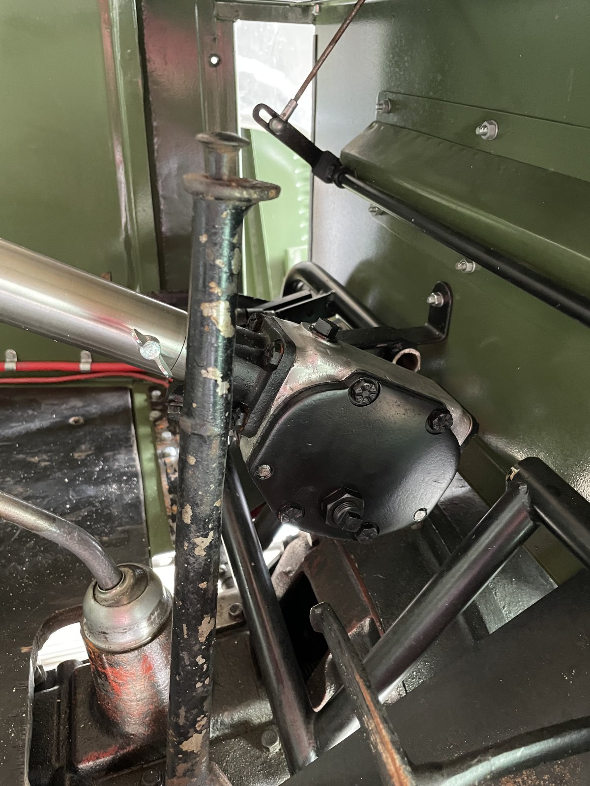

    Been a bit of time since the last update, so here goes.
    The time between last years Pendine and this year was spent making some changes to the car. The big one that took way longer than it should was to replace the old Model A steering box for a series 2 Land Rover box. This was made more complicated because I wanted to keep the model A drop arm and the extension that I made for it.
    The A box has a square shaft and the Land Rover has a spline.
    I had to strip the LR box, machine the spline into a square, which was smaller than the A, then machine a square sleeve to take up the slack.

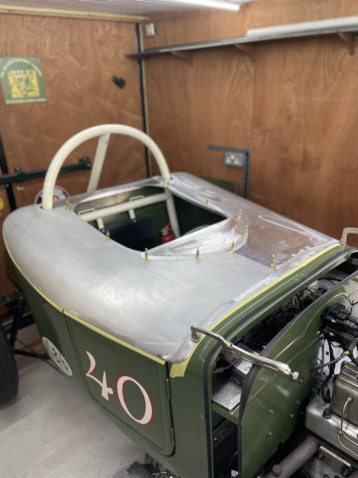

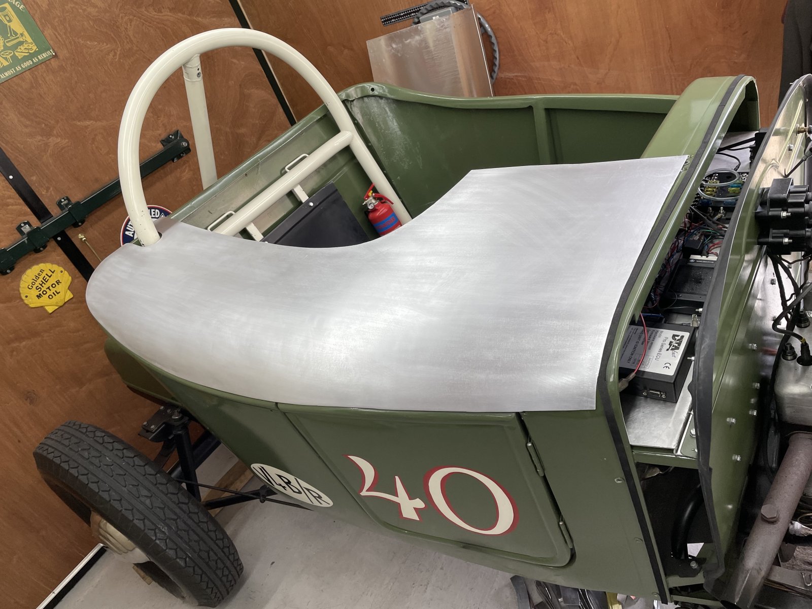

    I also made the tonneau cover that I had made a start on last year, just didn’t have the time to finish.
