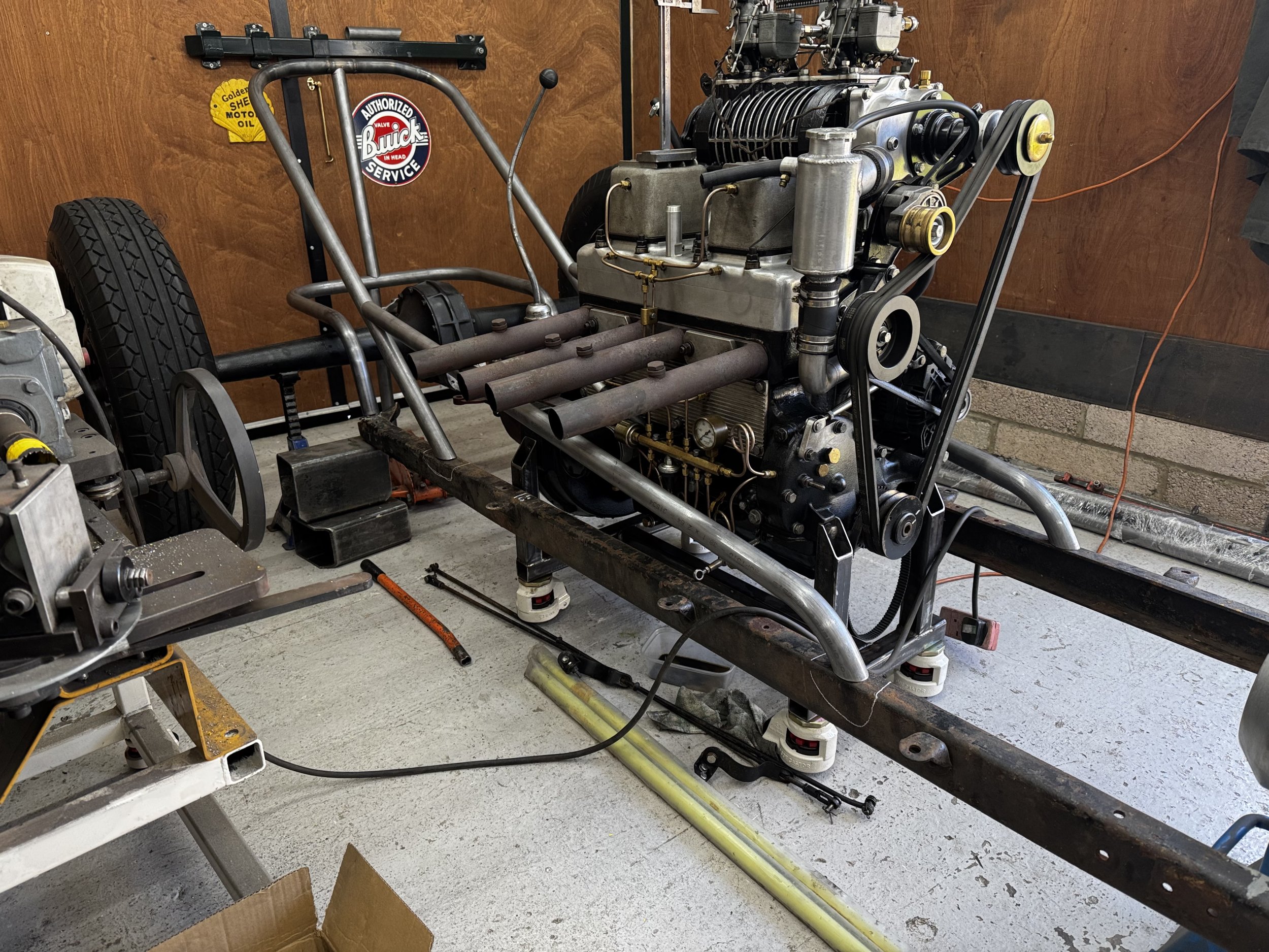

    Thanks, I am about to get some patterns cast for end plates to suit a Wade & was curious to know how it worked for you - very well obviously.
    winduptoy likes this.
  2. nutrocker
    Joined: Jan 12, 2007
    Posts: 444
    nutrocker
    The Wade blower isn’t the best blower, but it does look cool as it’s an older design.
    Its max revs are 5k. Any more than that the rotor tips create some kind of barrier and it stops pumping air.
    The angled intake and outlet are to stop pulses from the straight rotors, so the carbs sit offset. People have welded them up and run them straight, I don’t know how they performed though.
    It’s also very big and heavy. Modern blowers are much more efficient, but don’t look as good.

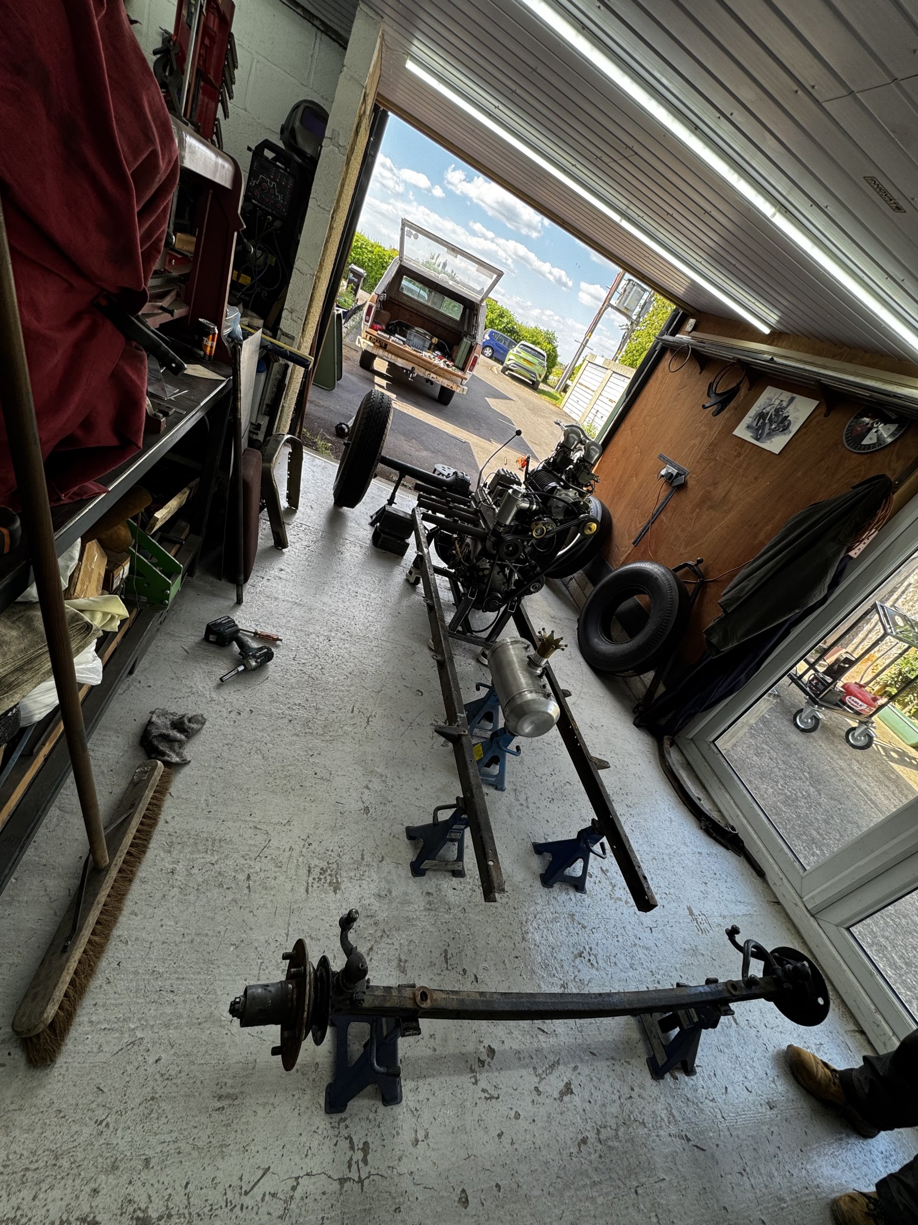

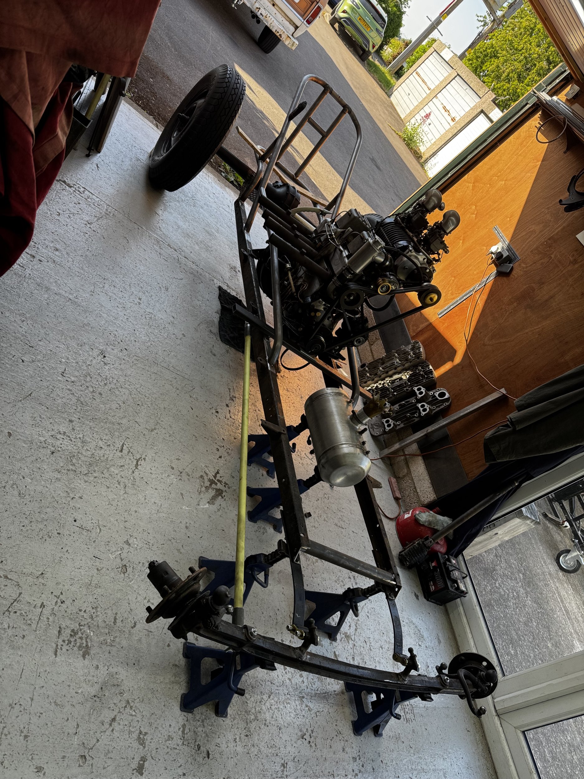

    Update on the car.

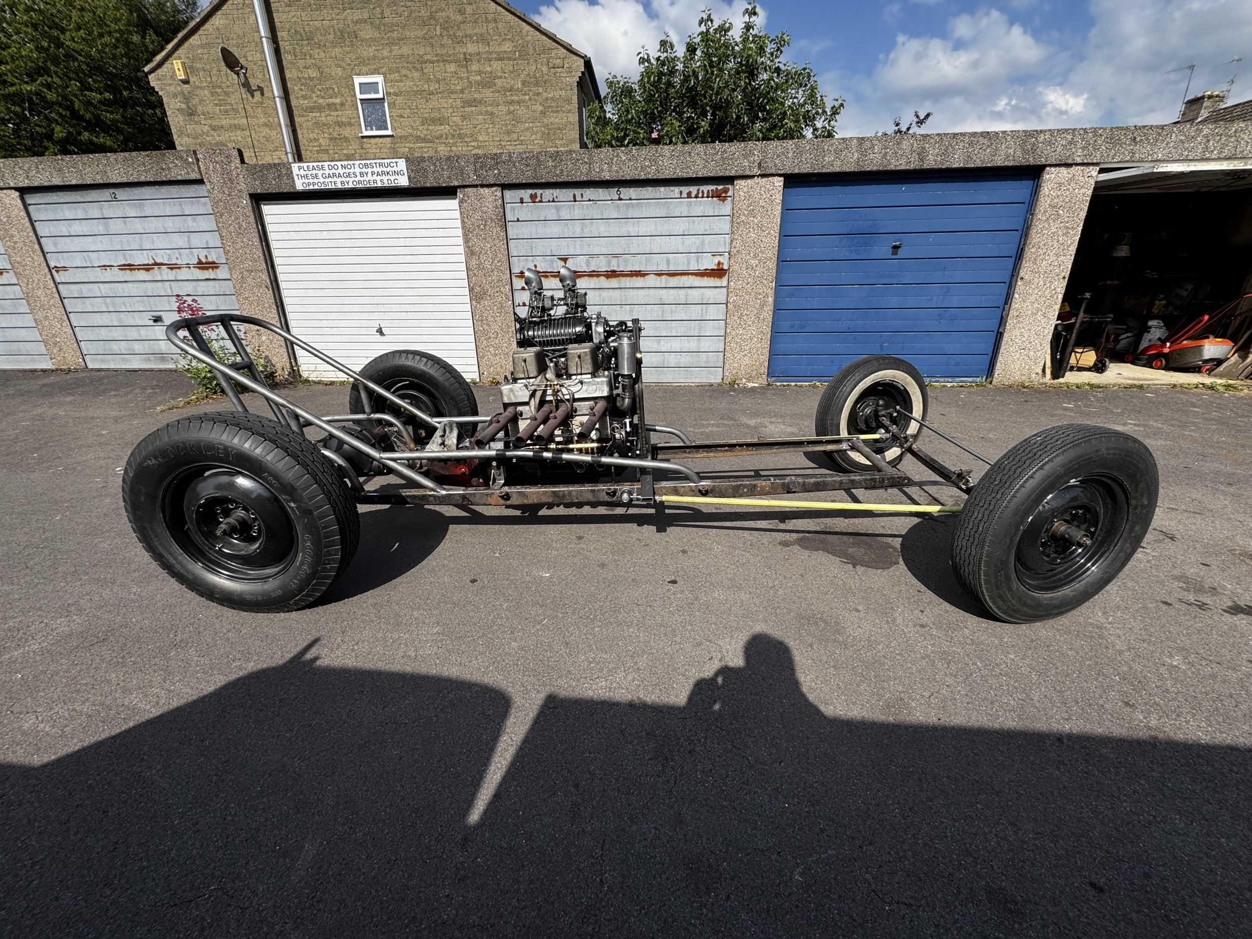

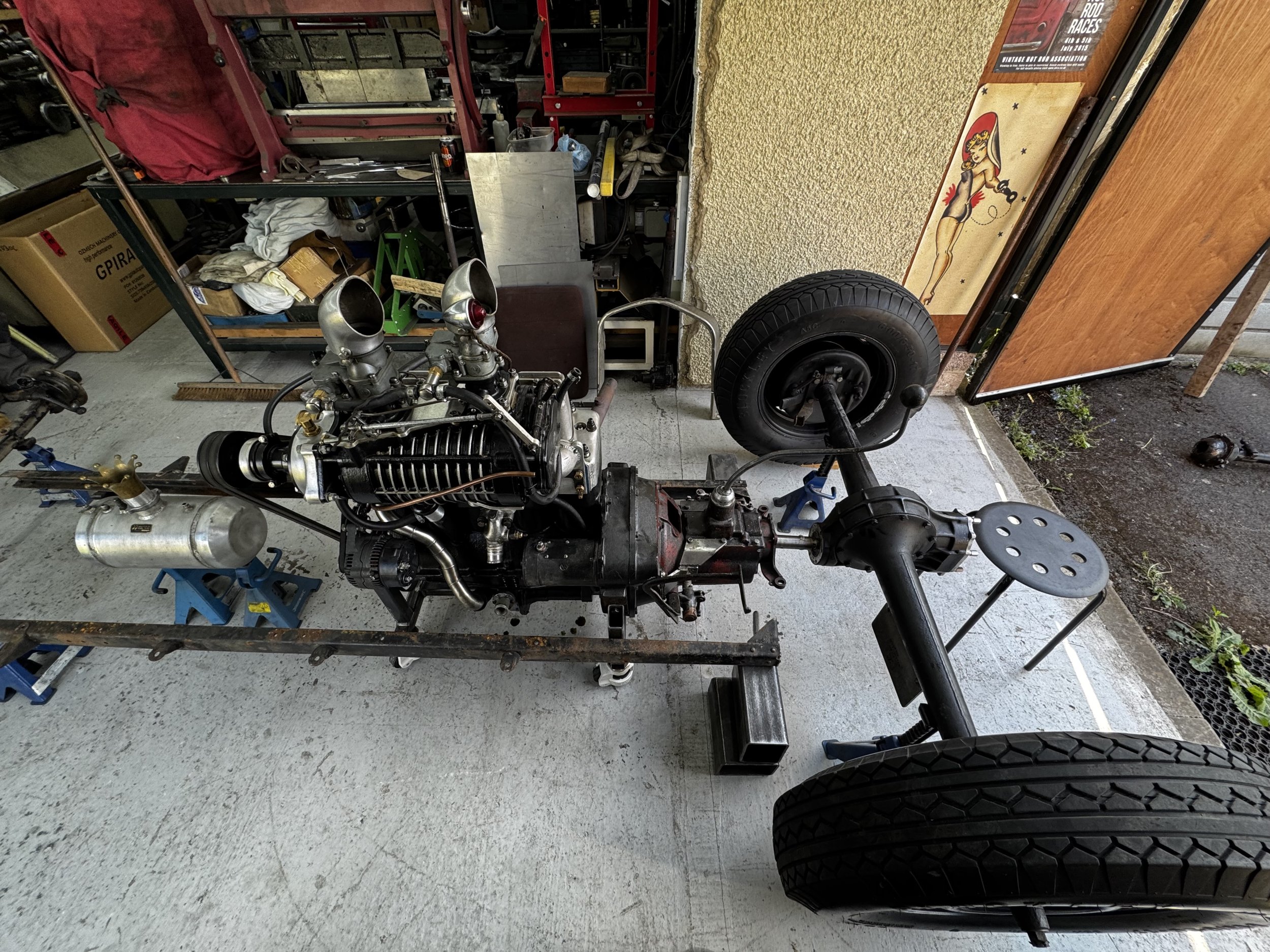

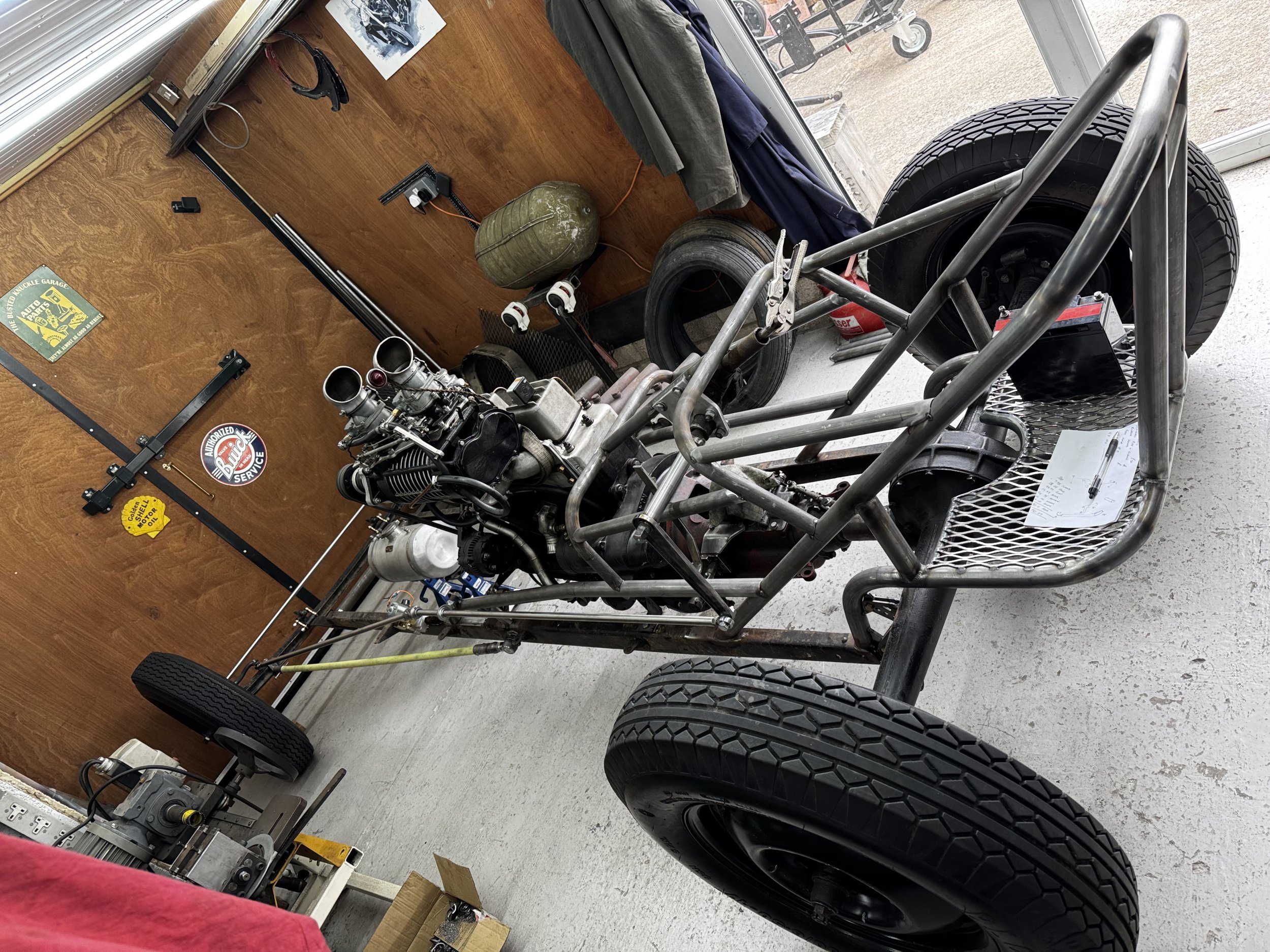

    I plan on fitting a hopped up big block Olds in the car, which means the 4 banger, 39 box and the A QC rear axle are coming out.
    What to do with them. An early style rail was the answer.

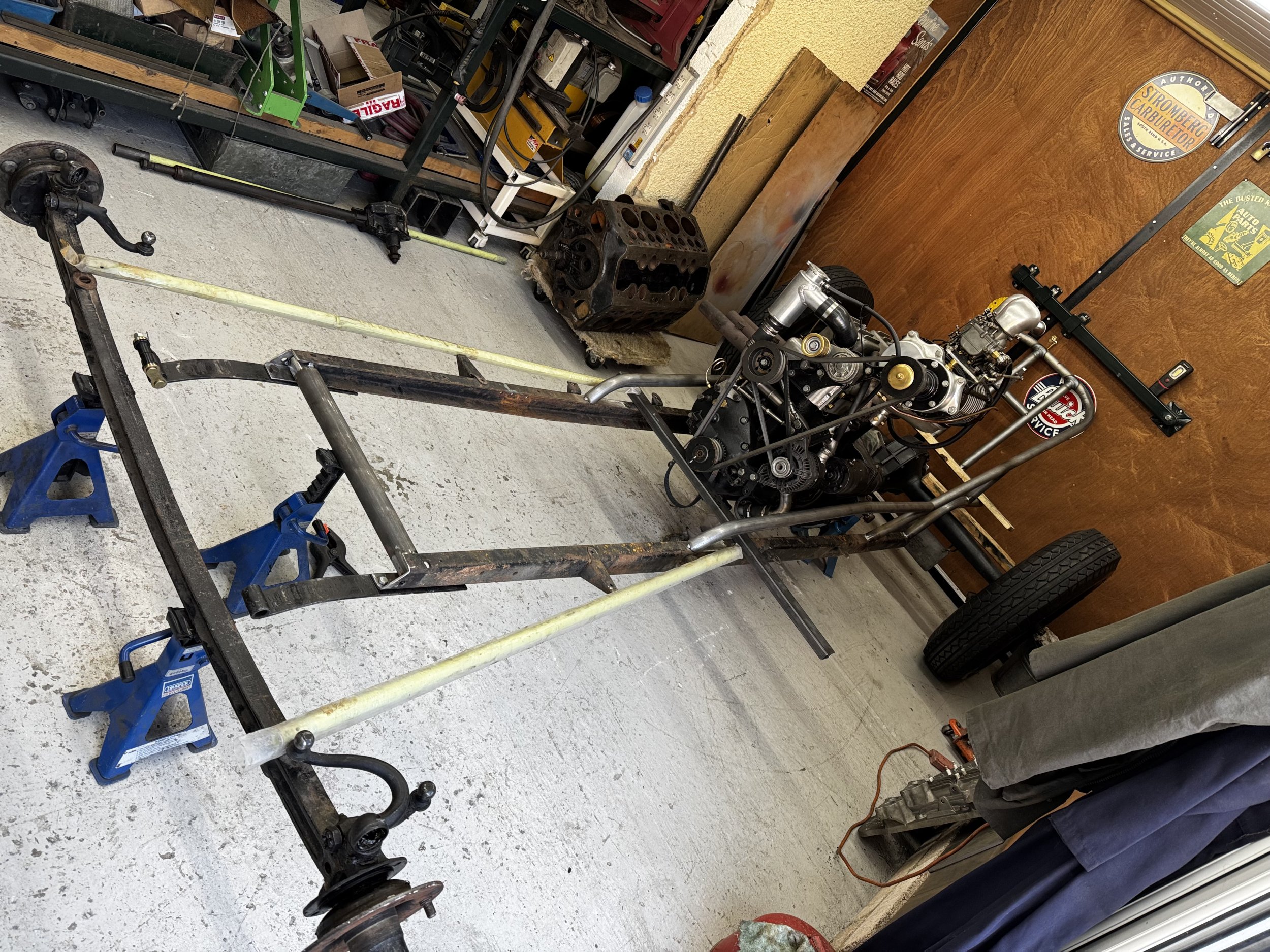

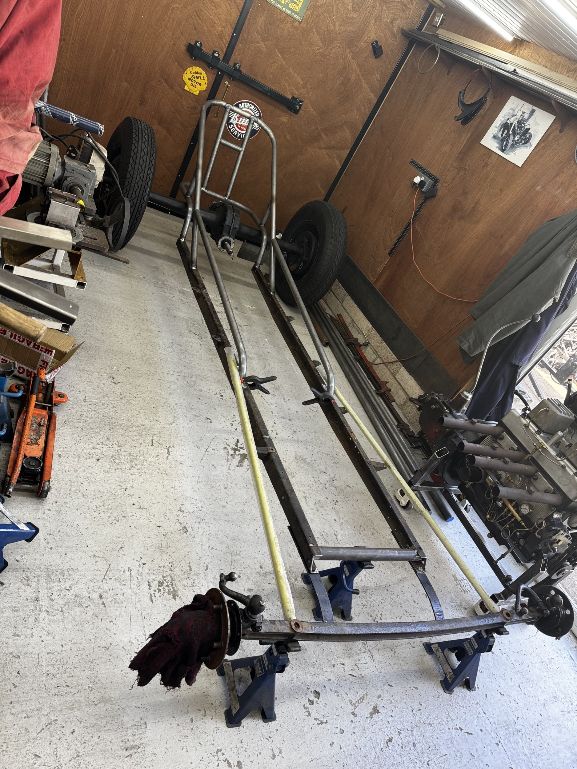

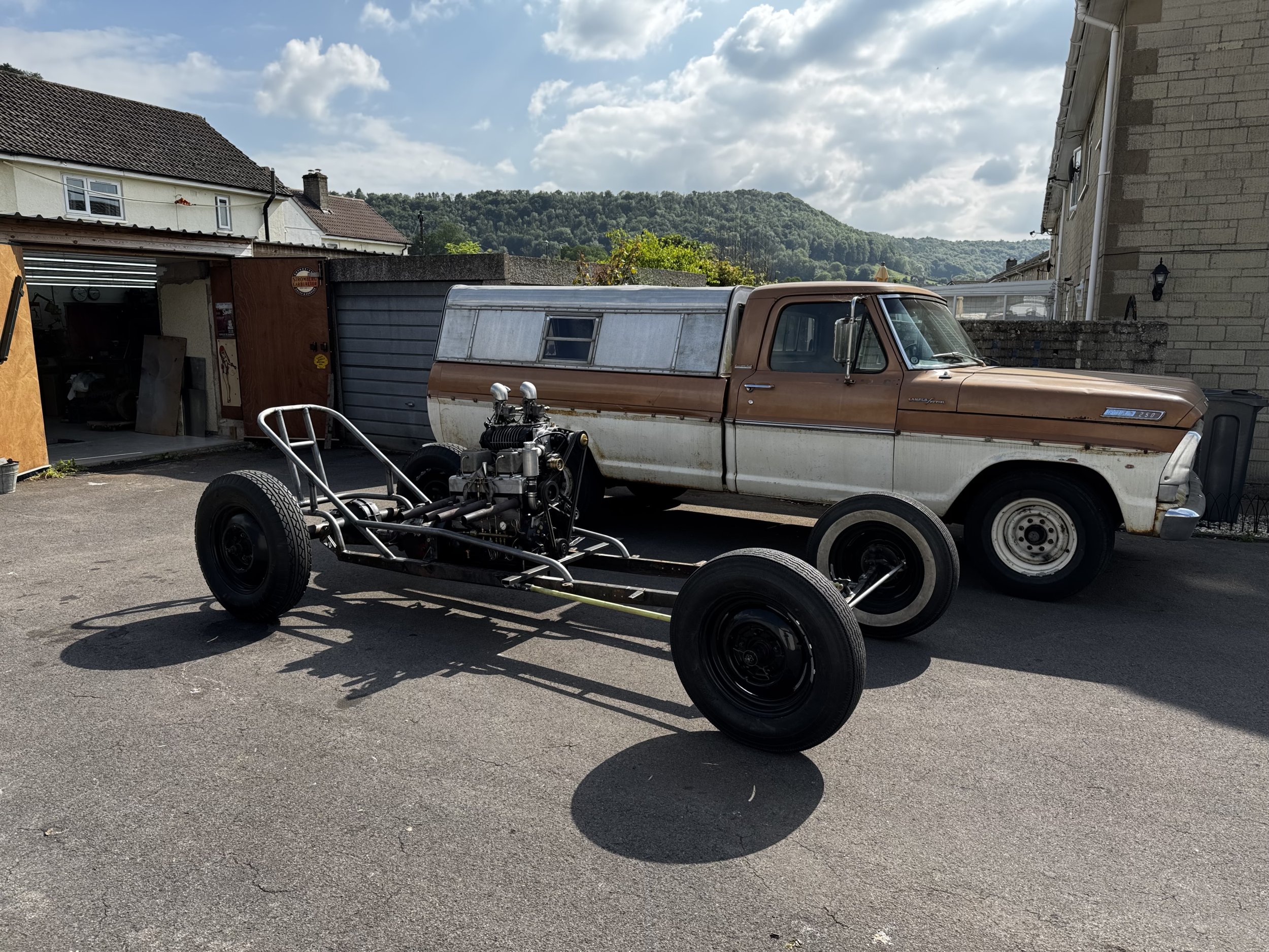

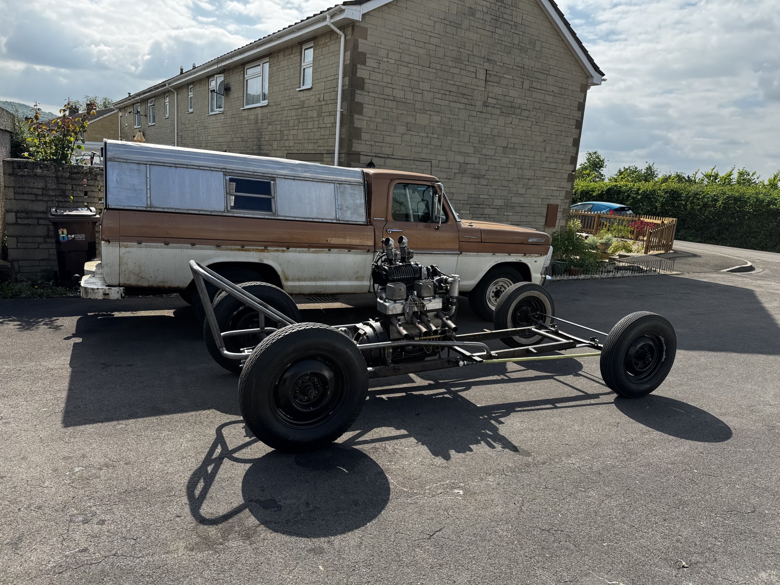

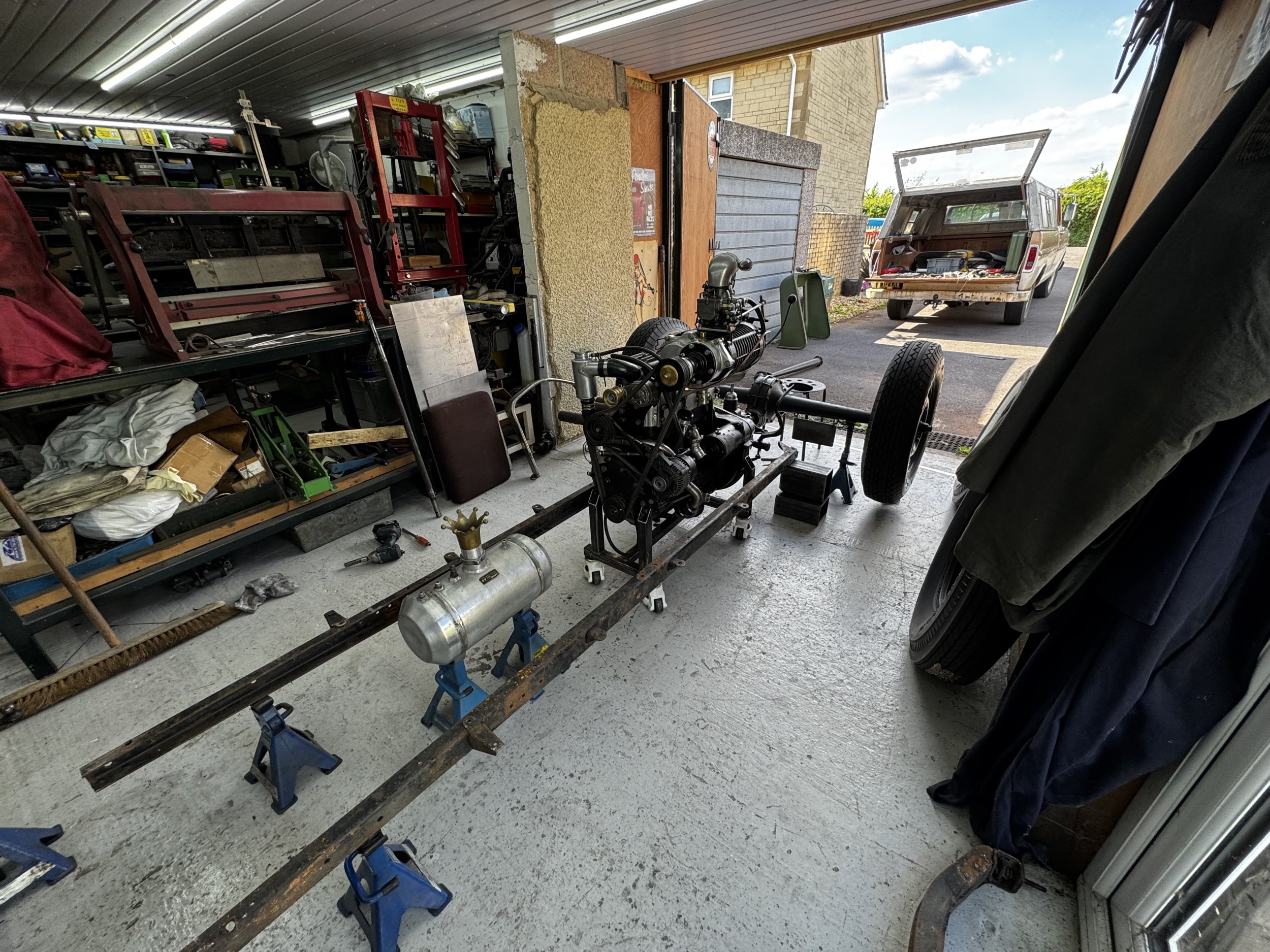

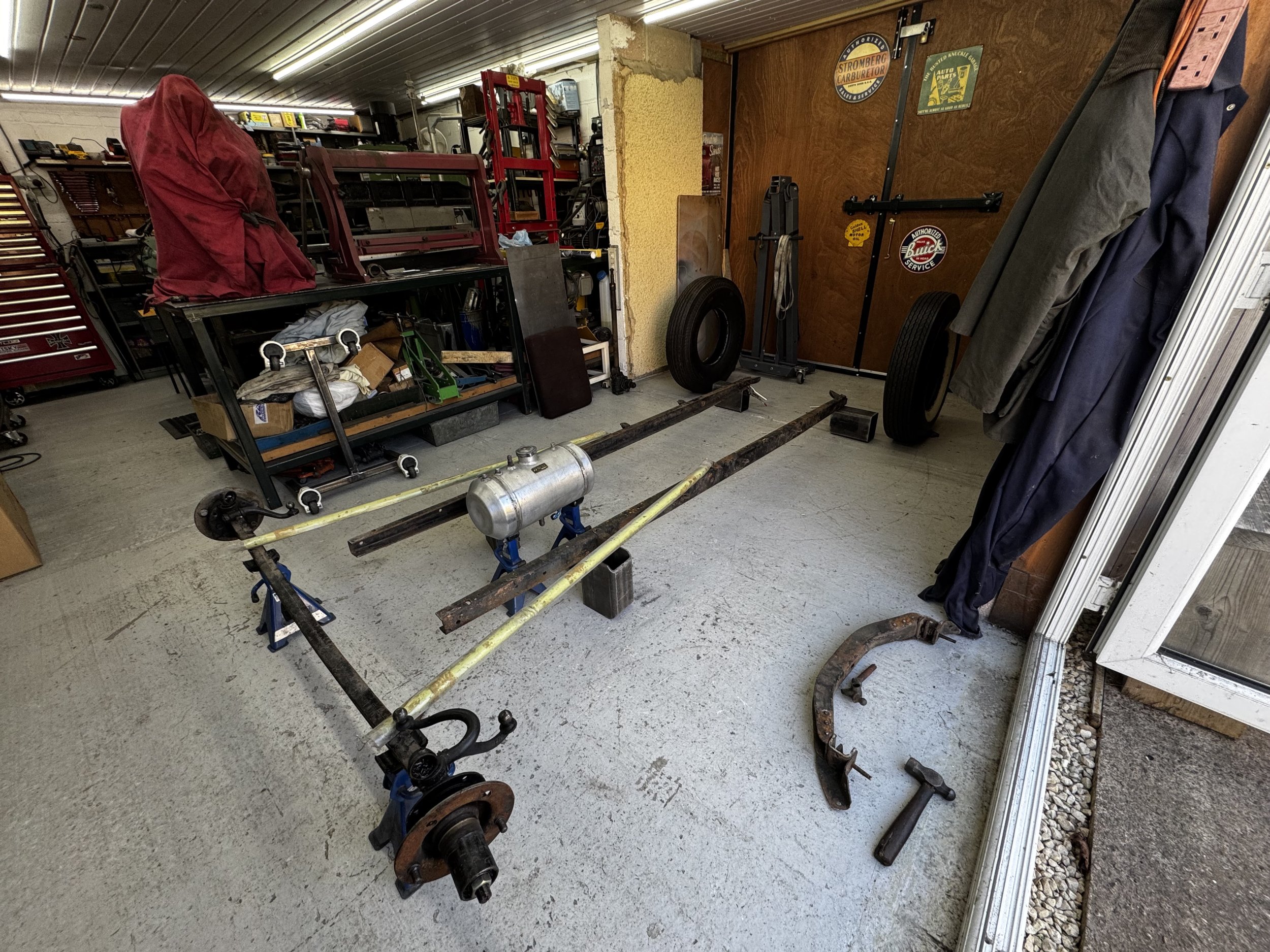

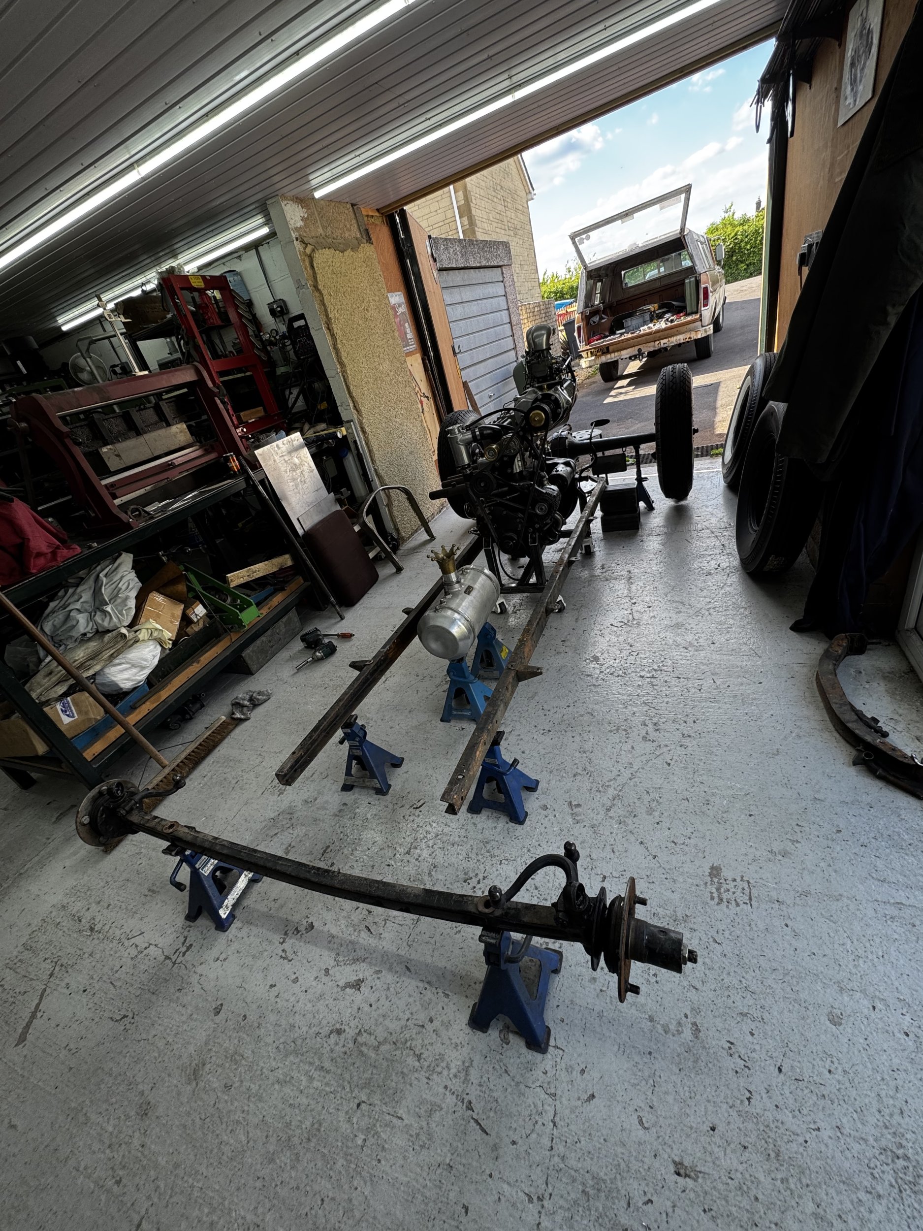

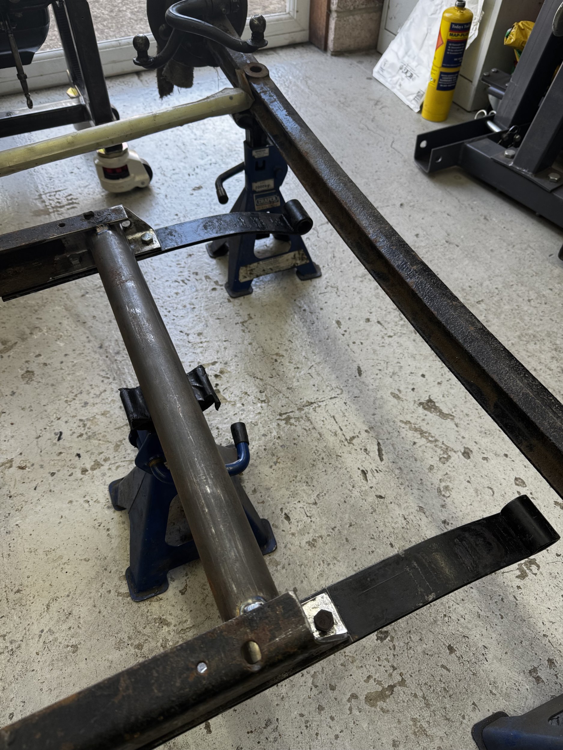

    6 weeks ago I started with a pair of T rails and some dom tube, A front axle and the bits from the T.
    Mock up
    IMG_1029.jpeg IMG_1027.jpeg IMG_1053.jpeg IMG_1054.jpeg IMG_1055.jpeg IMG_1056.jpeg

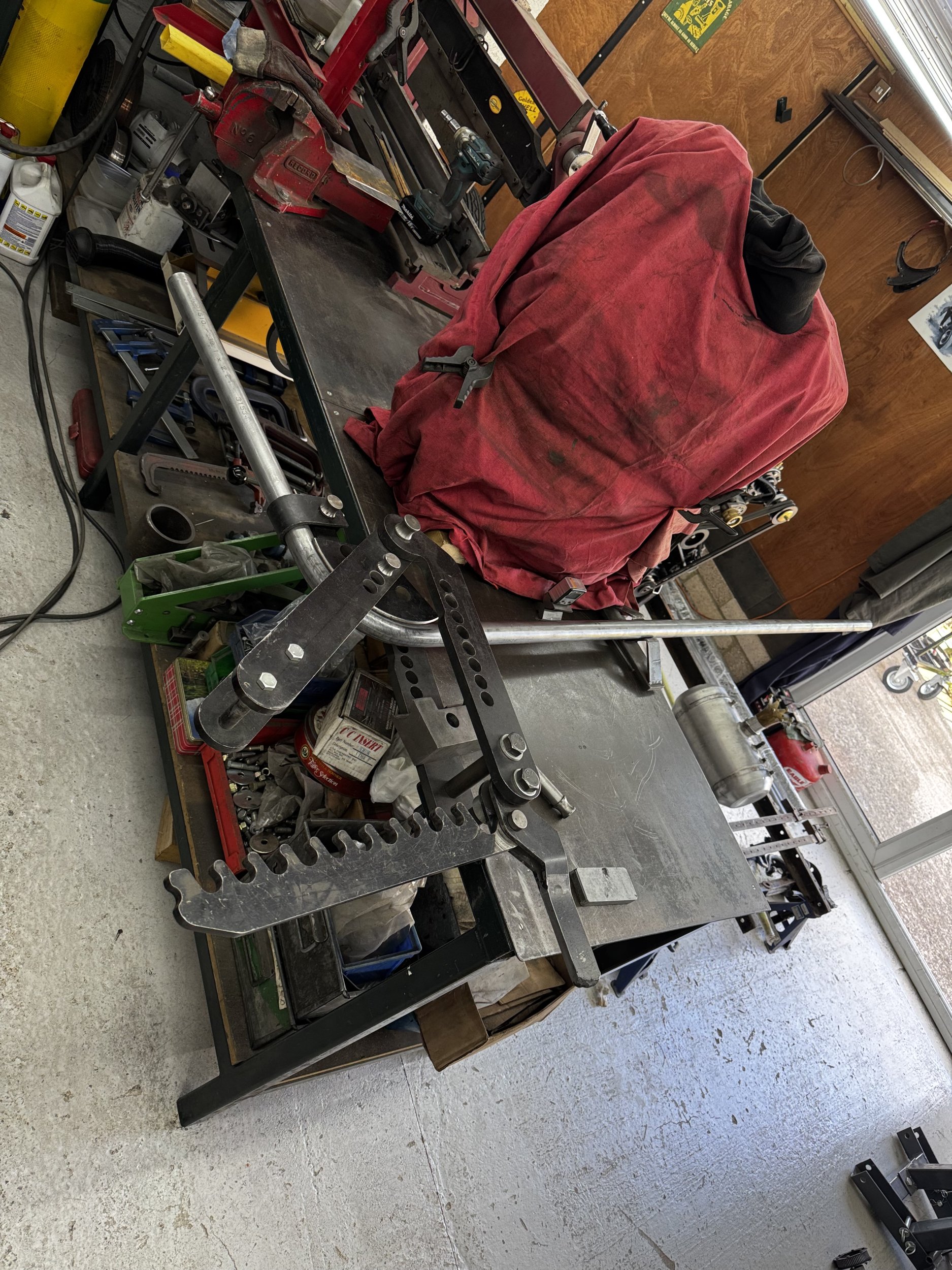

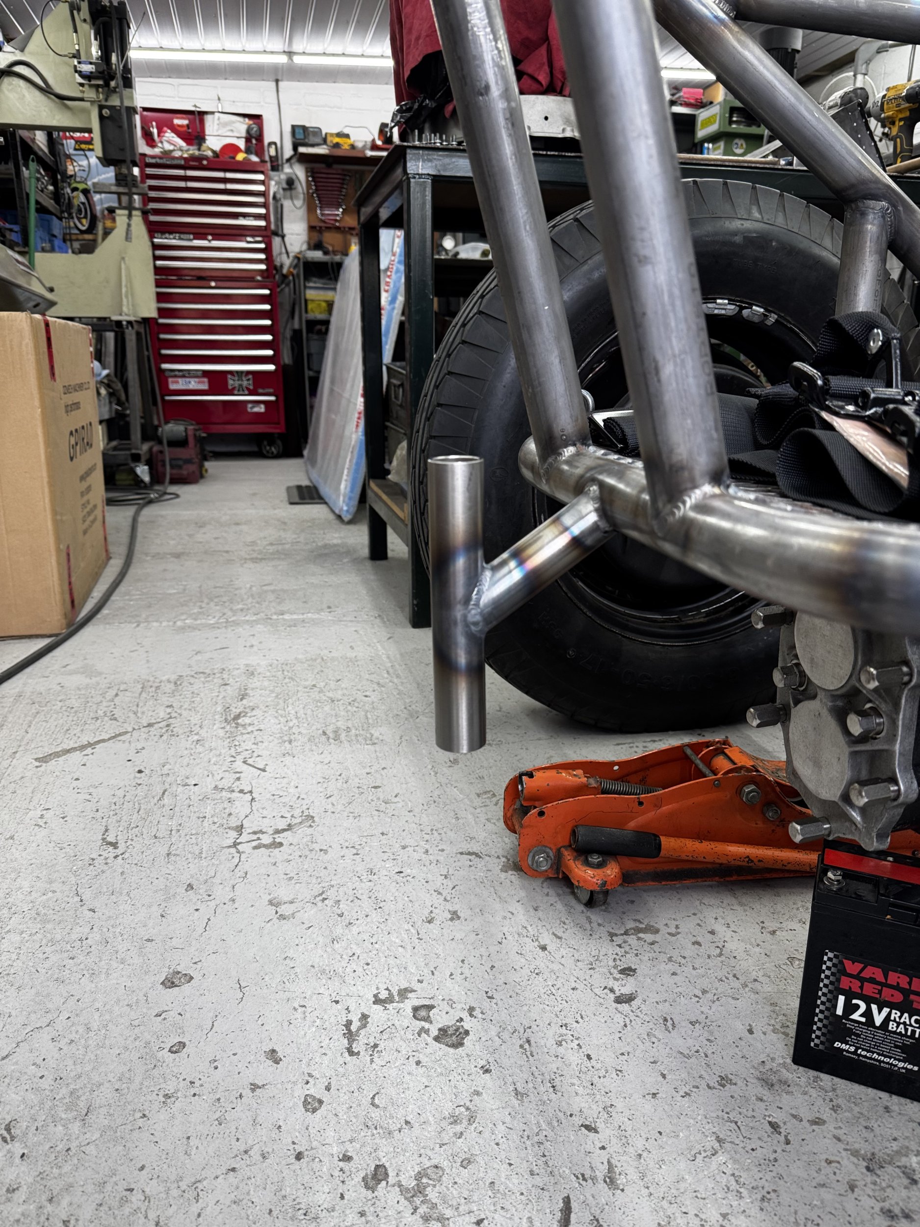

    Bending tubes
    IMG_1072.jpeg IMG_1073.jpeg IMG_1074.jpeg IMG_1080.jpeg IMG_1082.jpeg IMG_1088.jpeg IMG_1090.jpeg

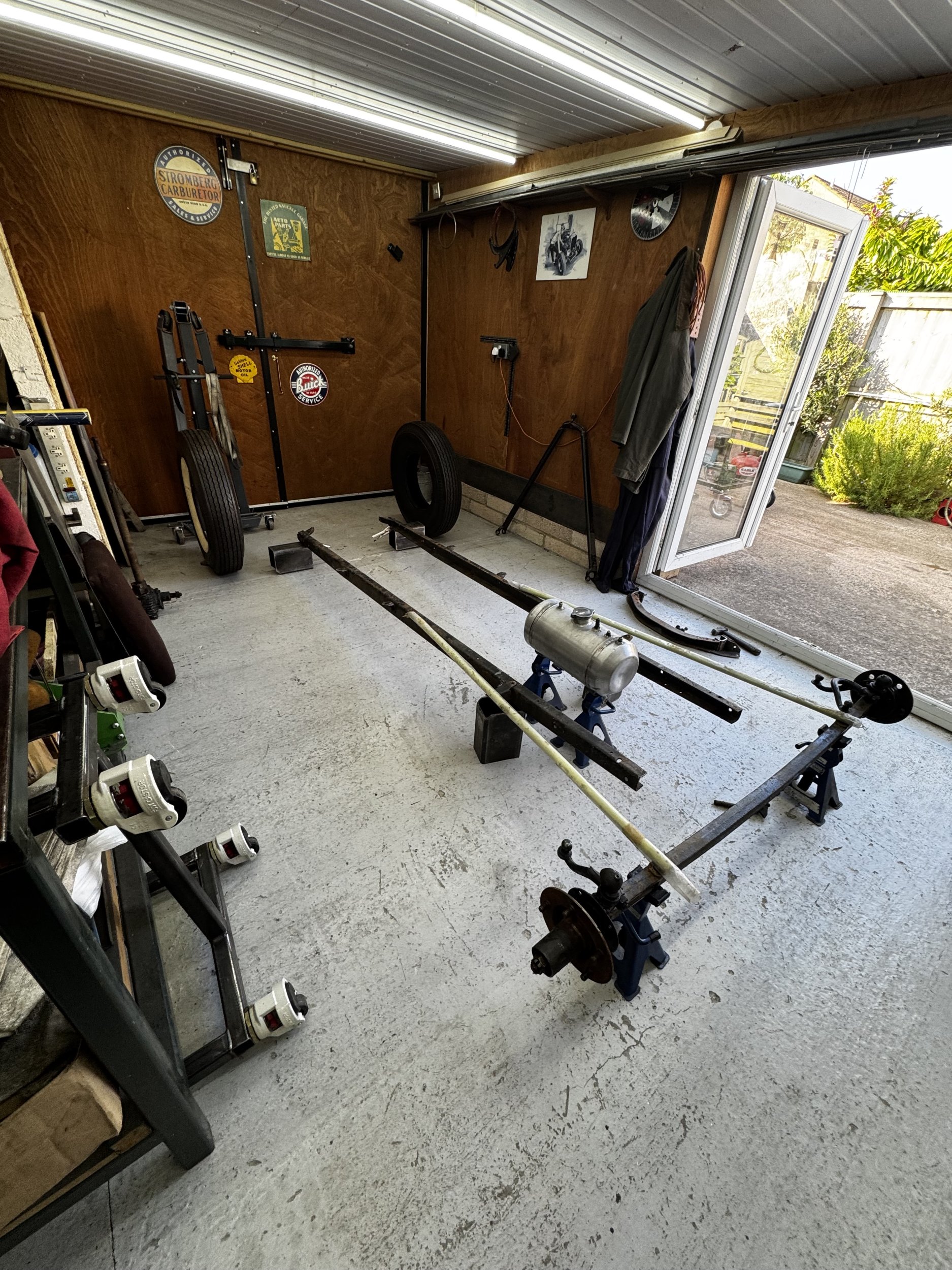

  12. nutrocker
    Posts: 444
    nutrocker

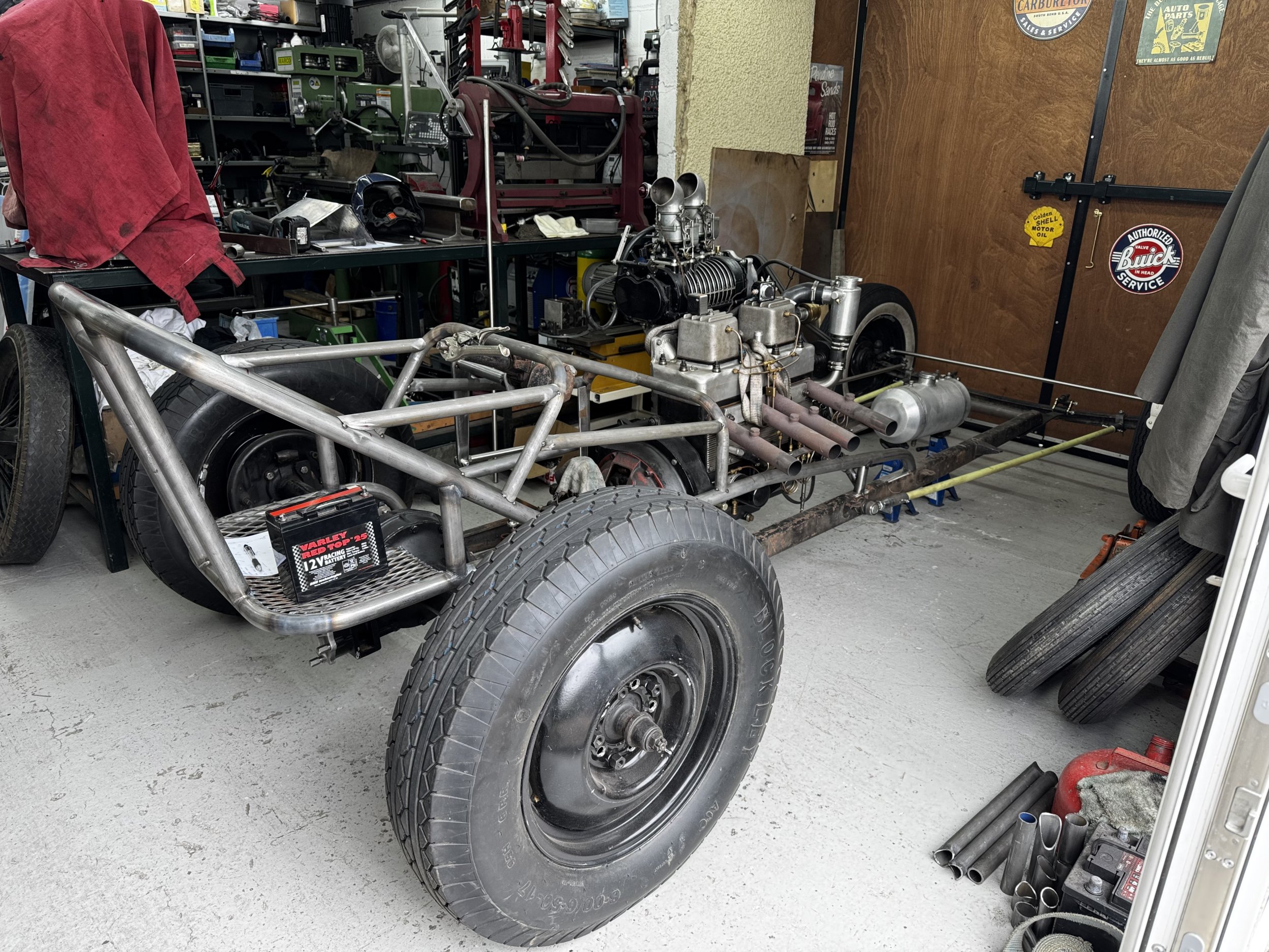

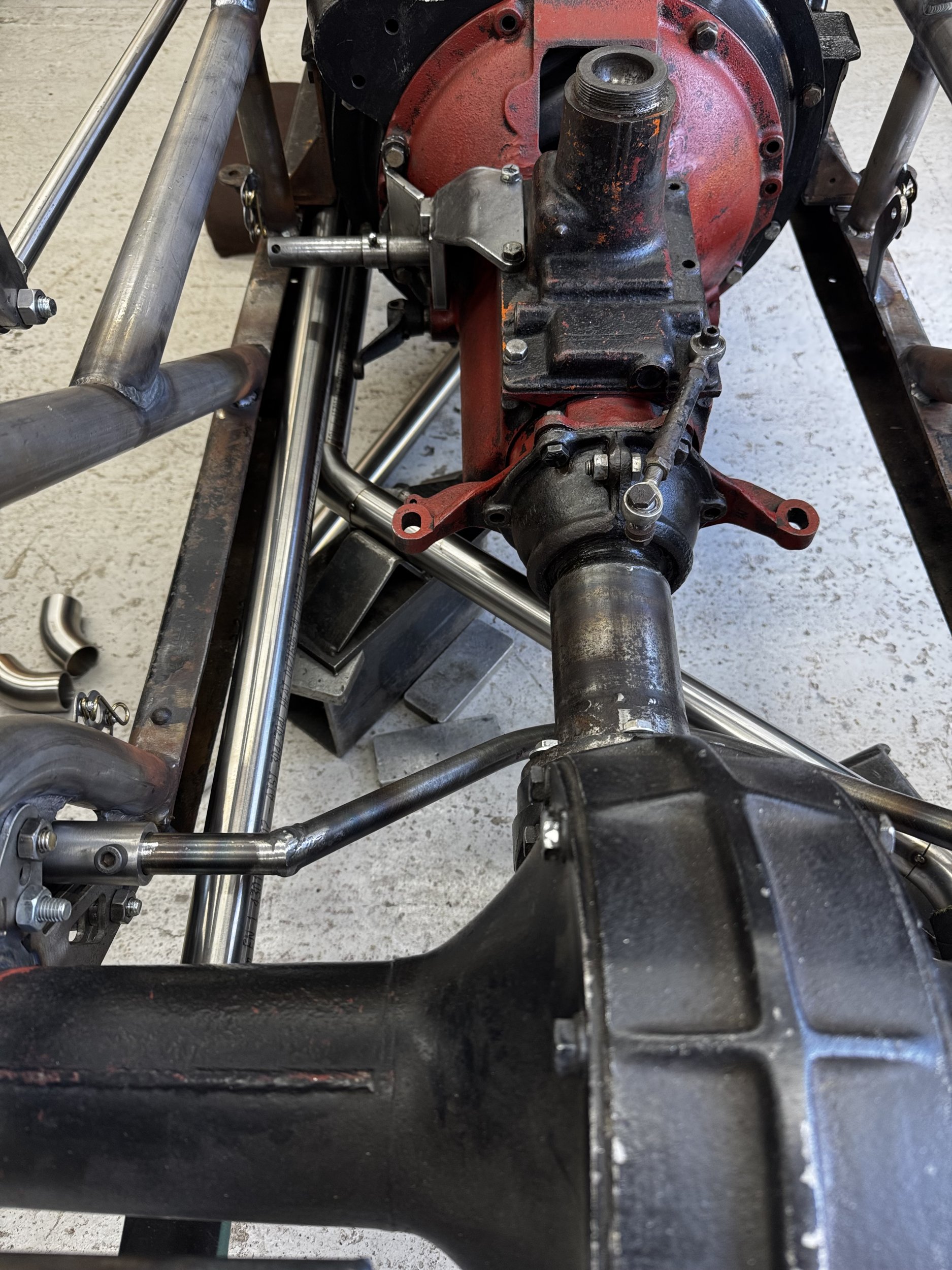

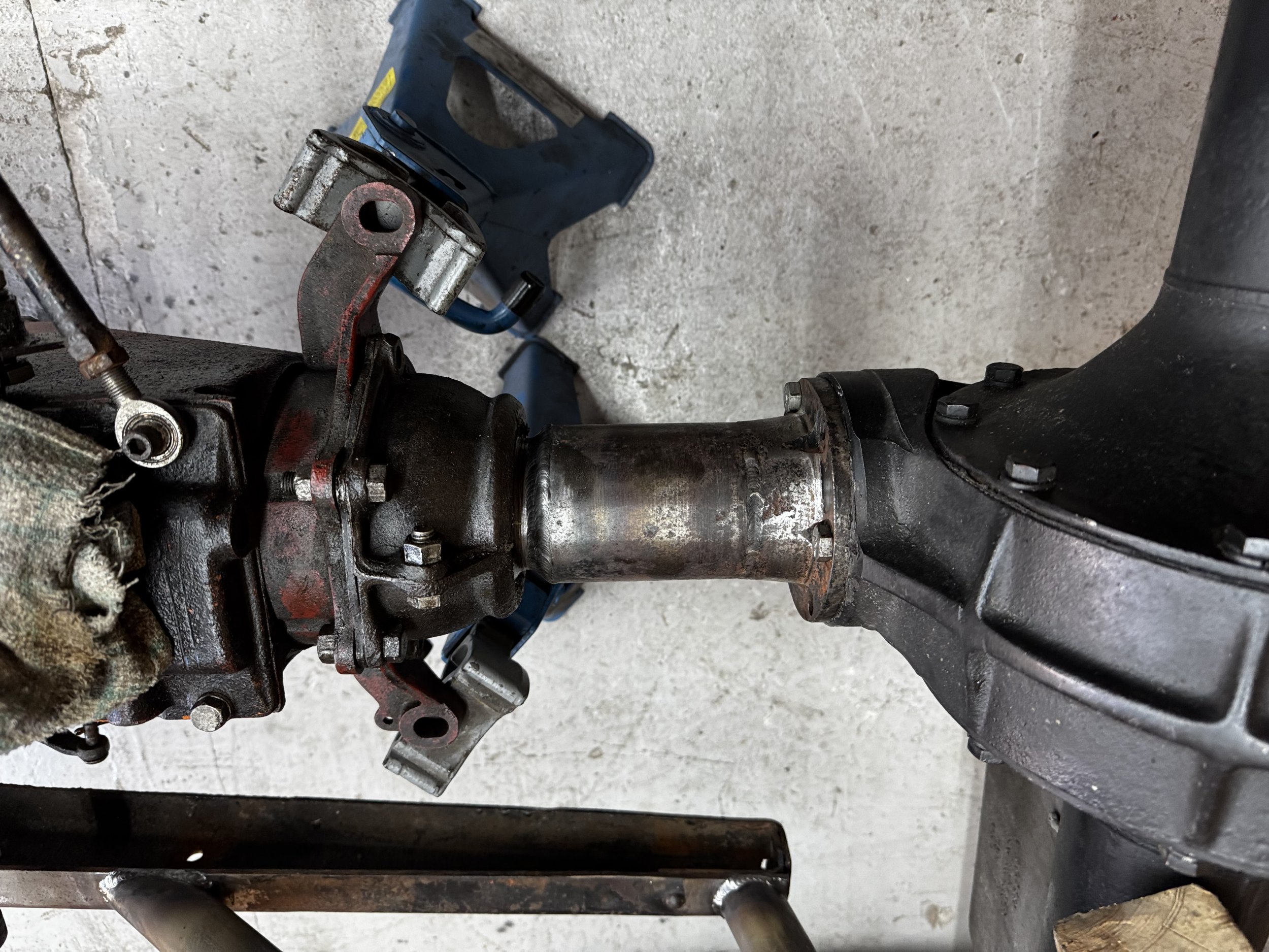

    Front axle has an A spring cut in half, drilled and mounted as quarter elliptical.

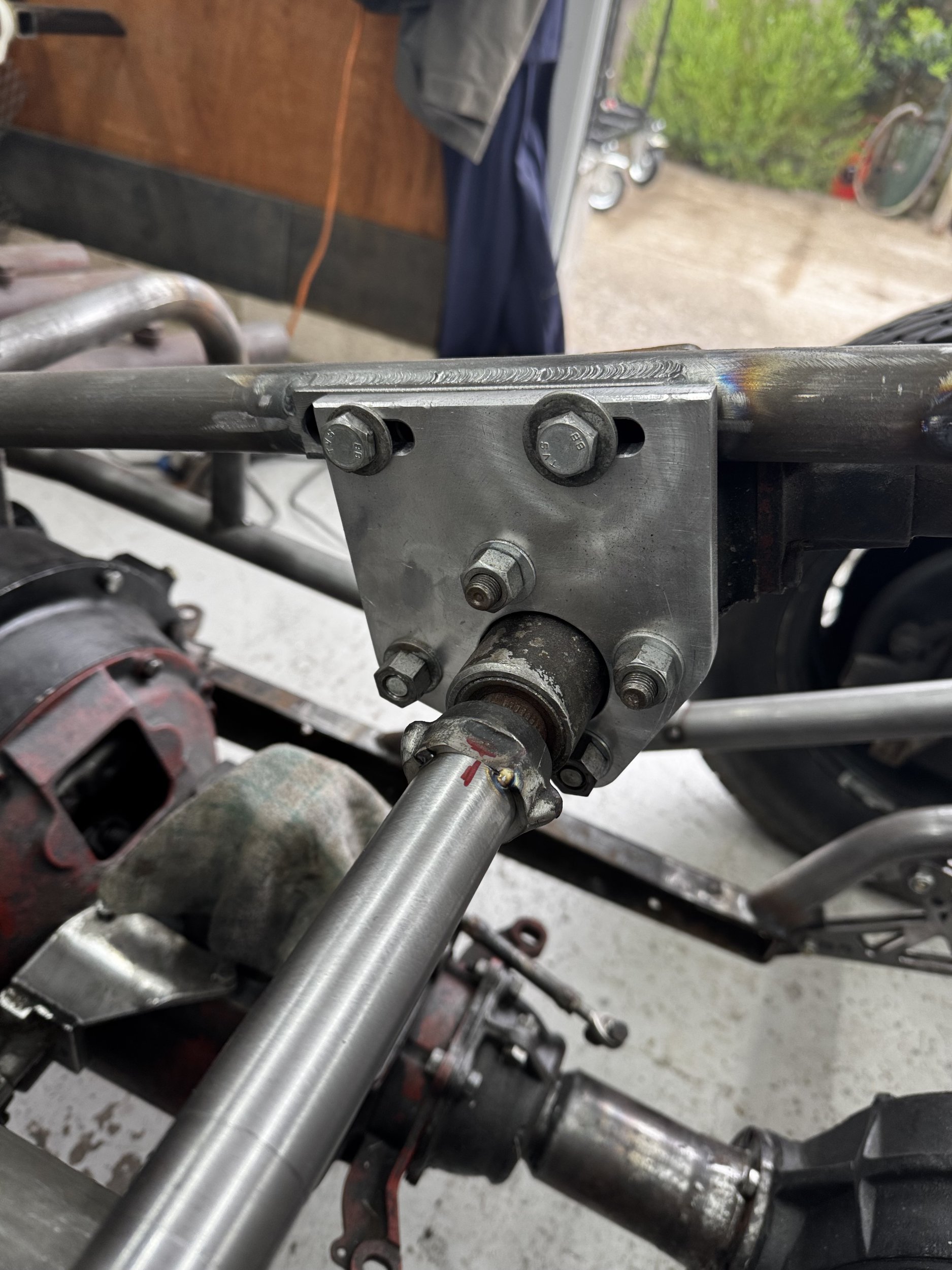

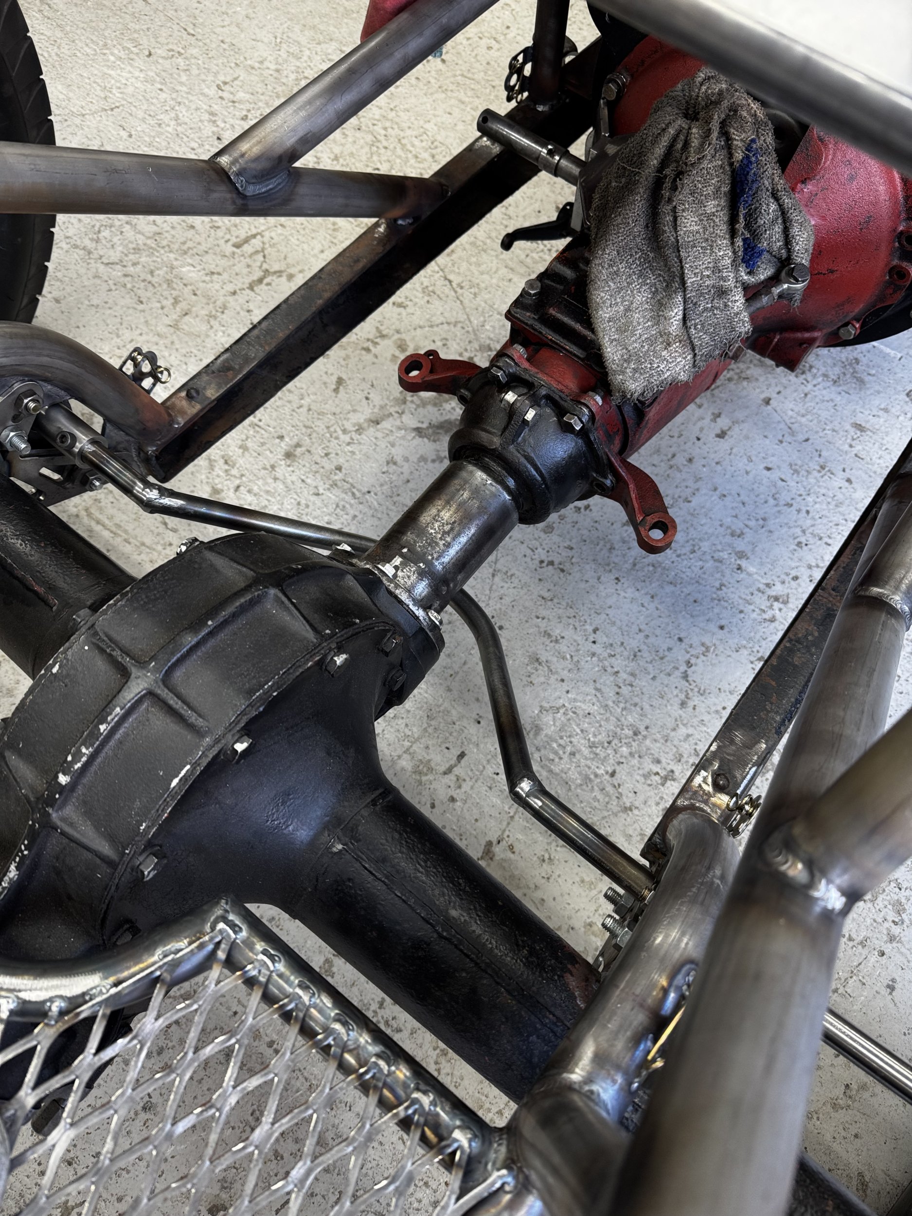

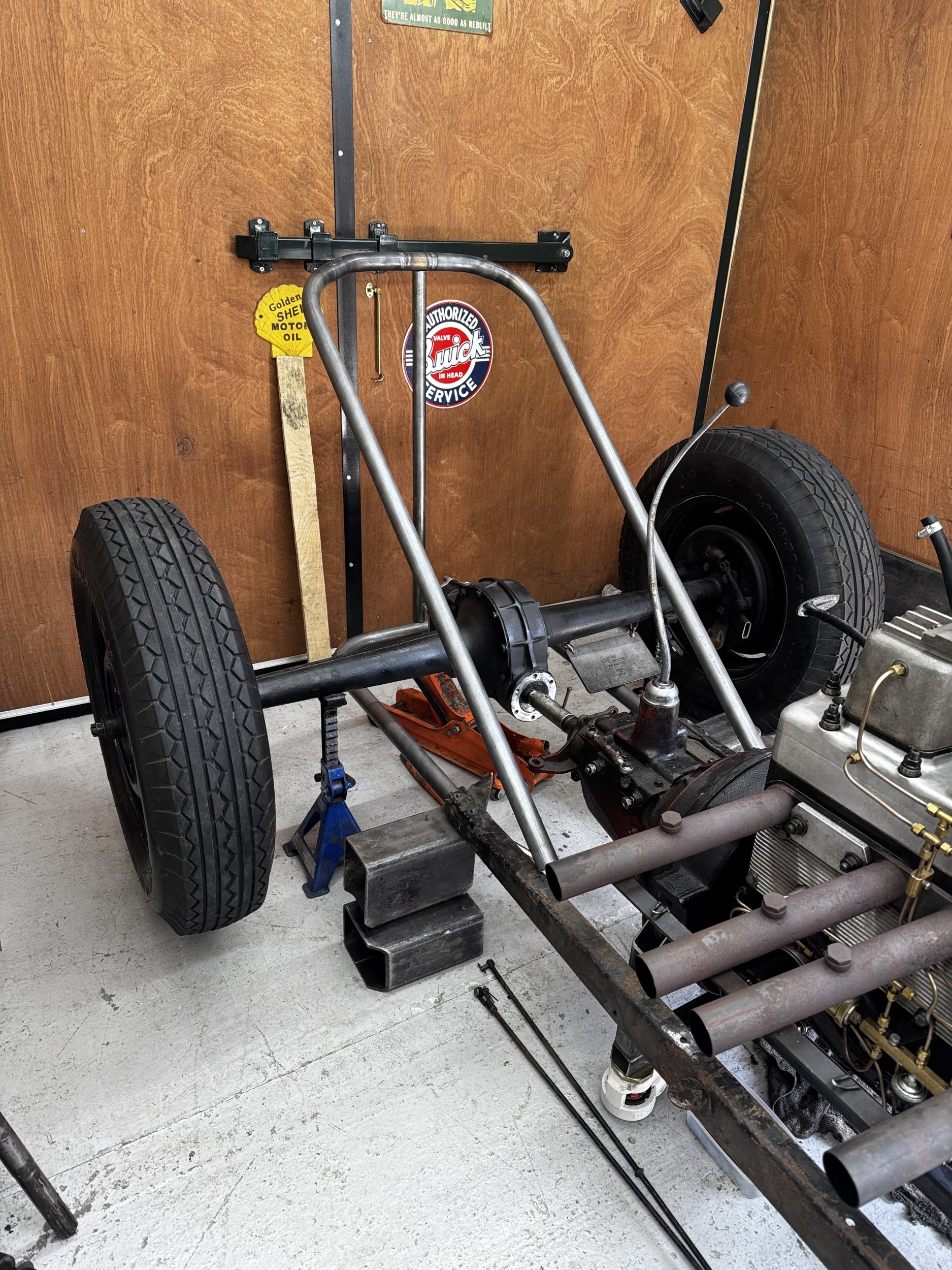

    Looking at how to mount the rear axle.

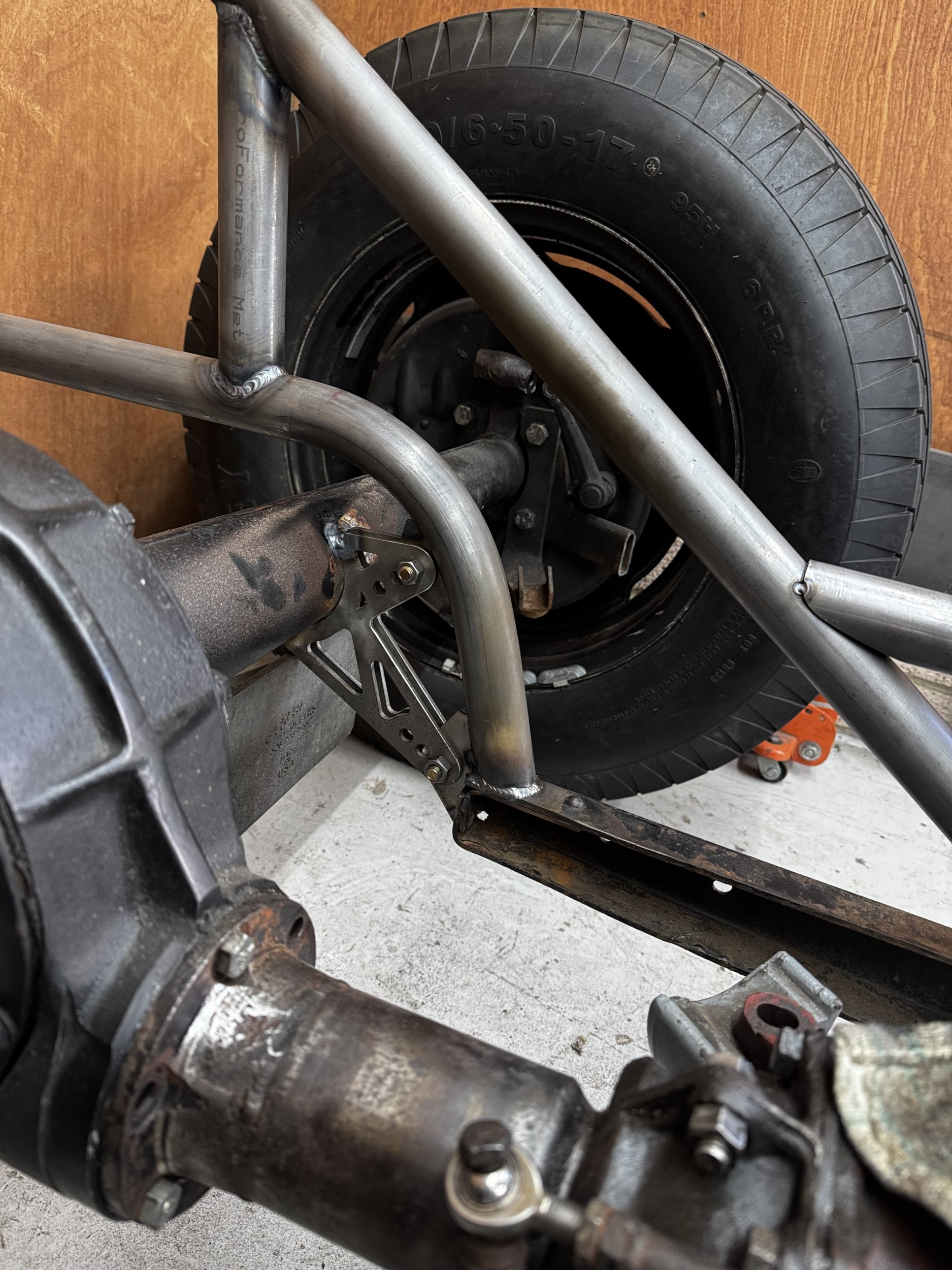

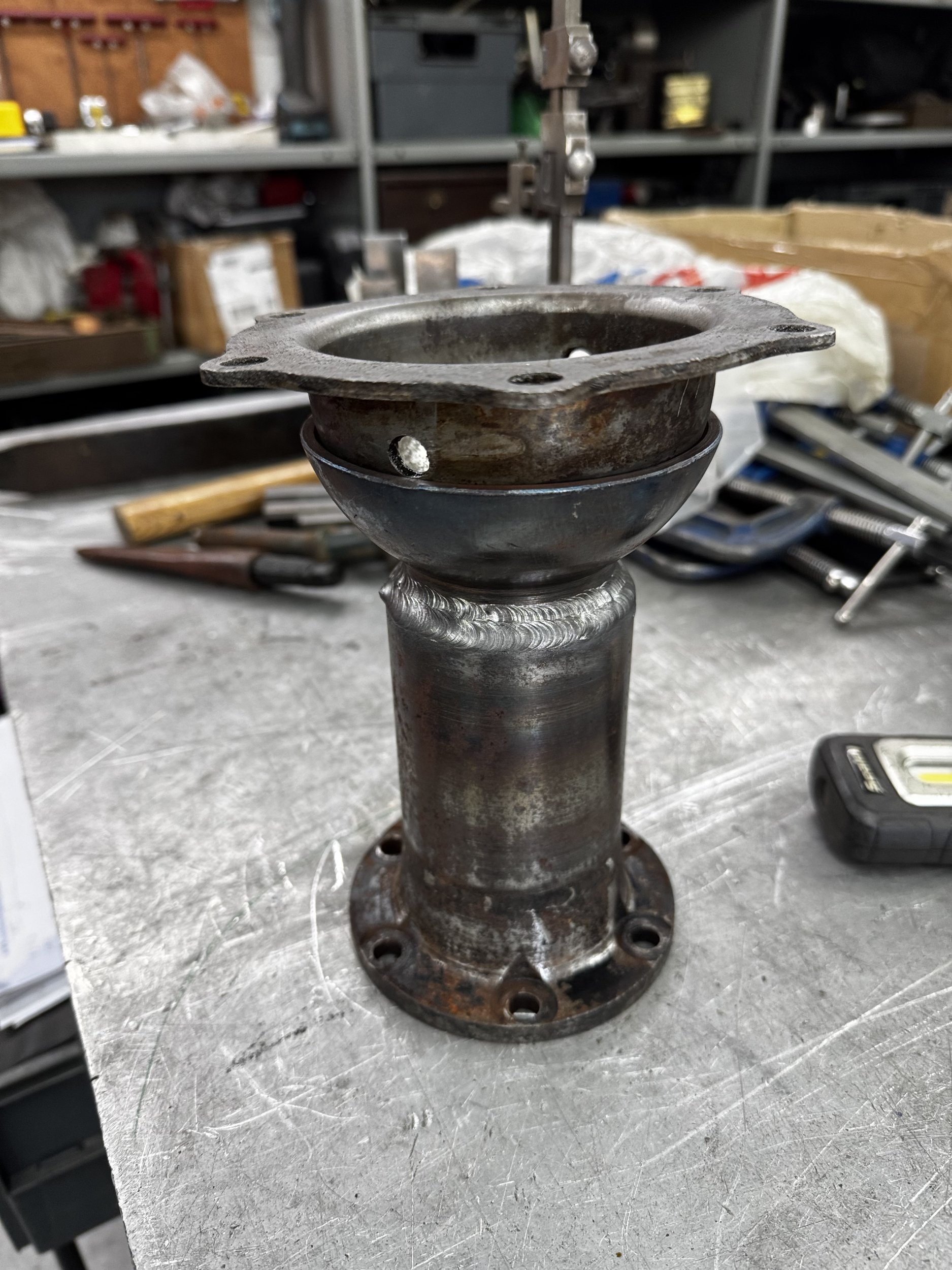

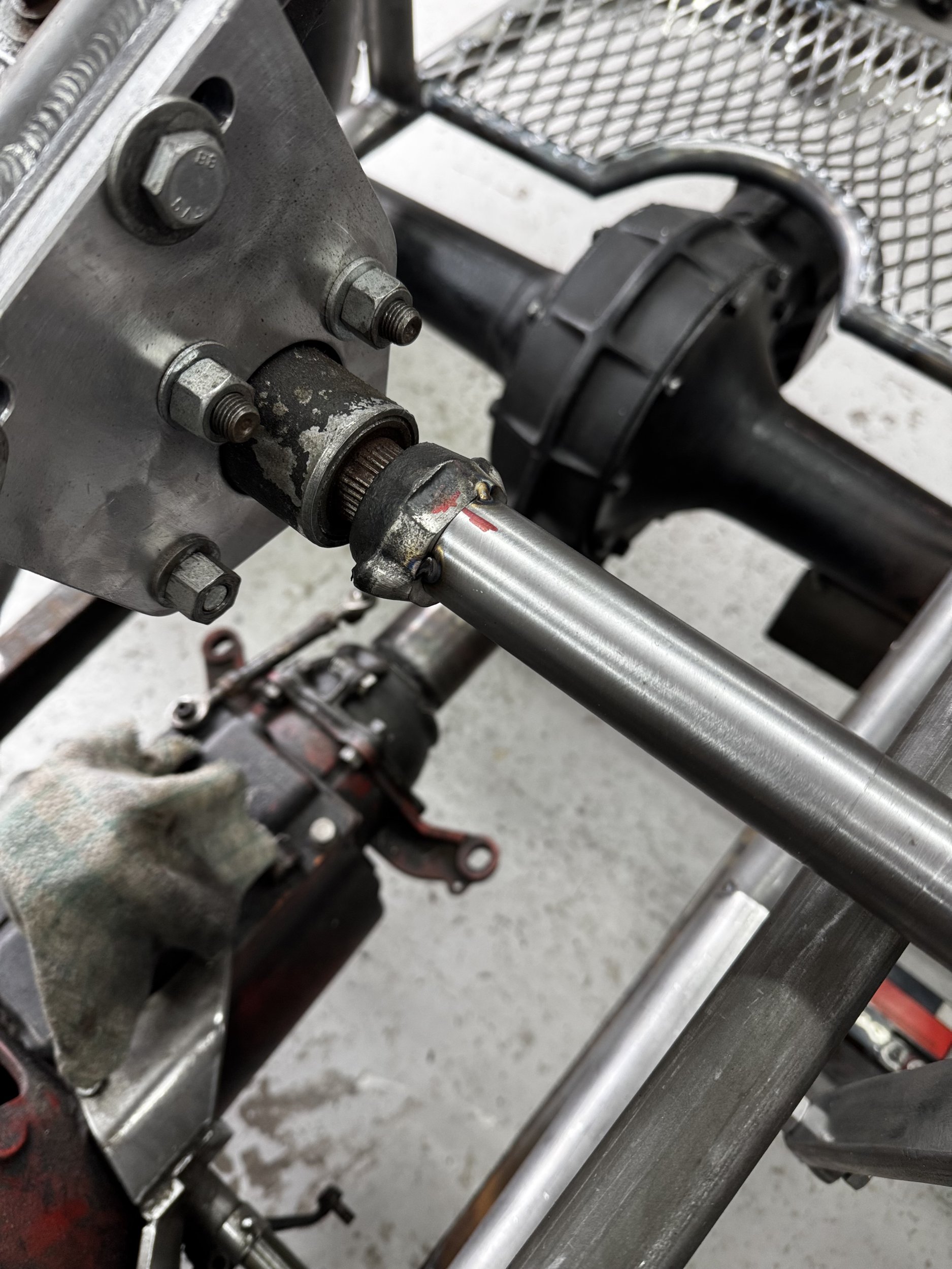

    Shortened torque tube. Still using the UJ and swivel.

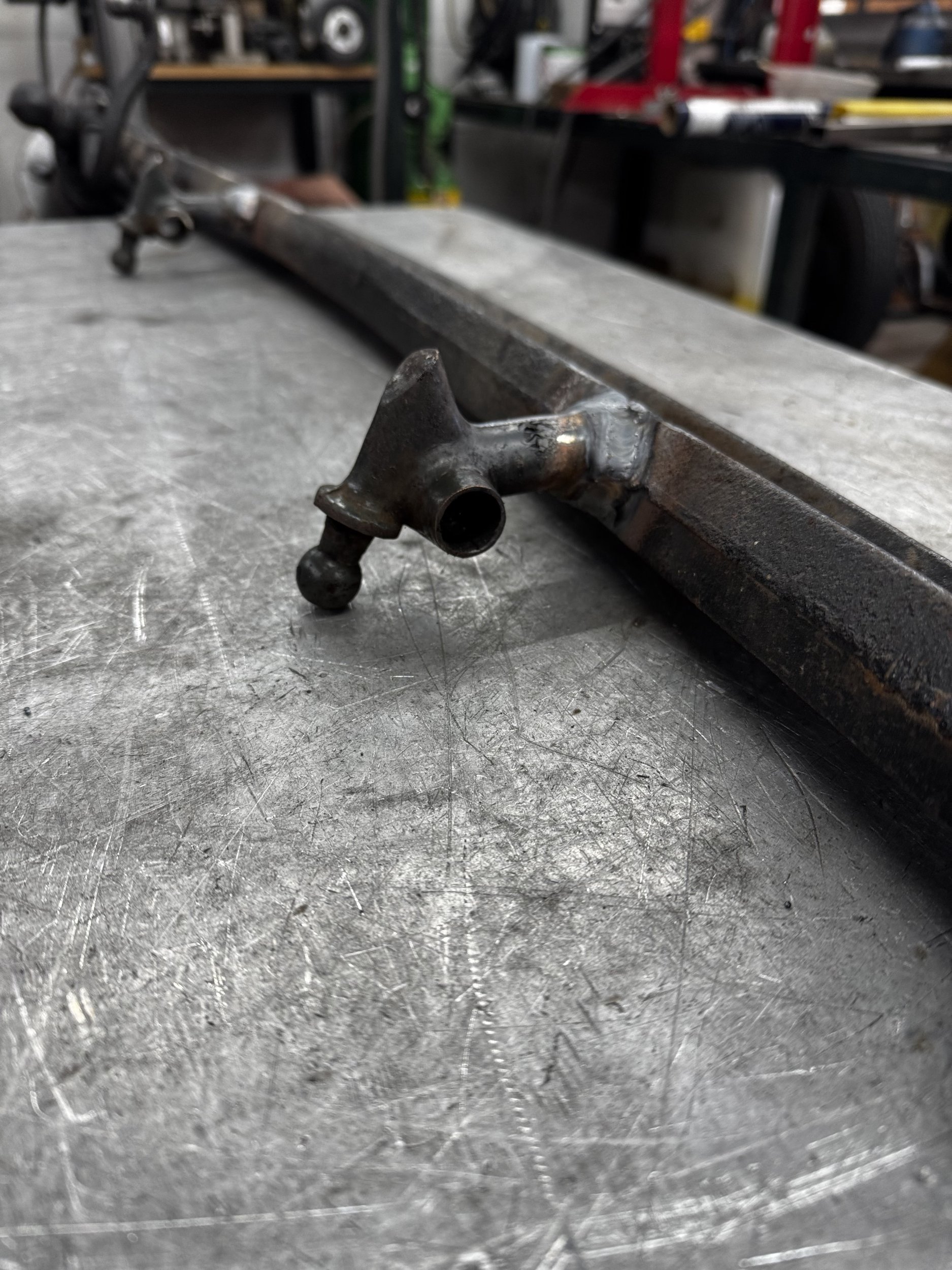

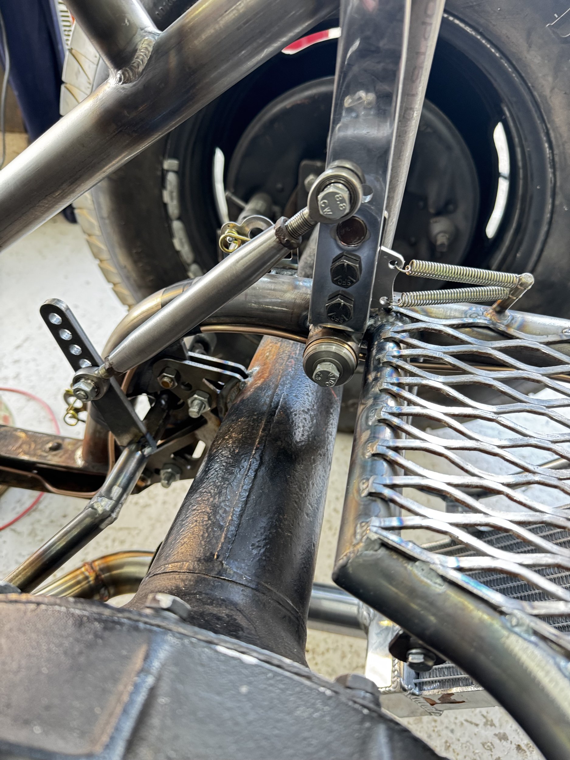

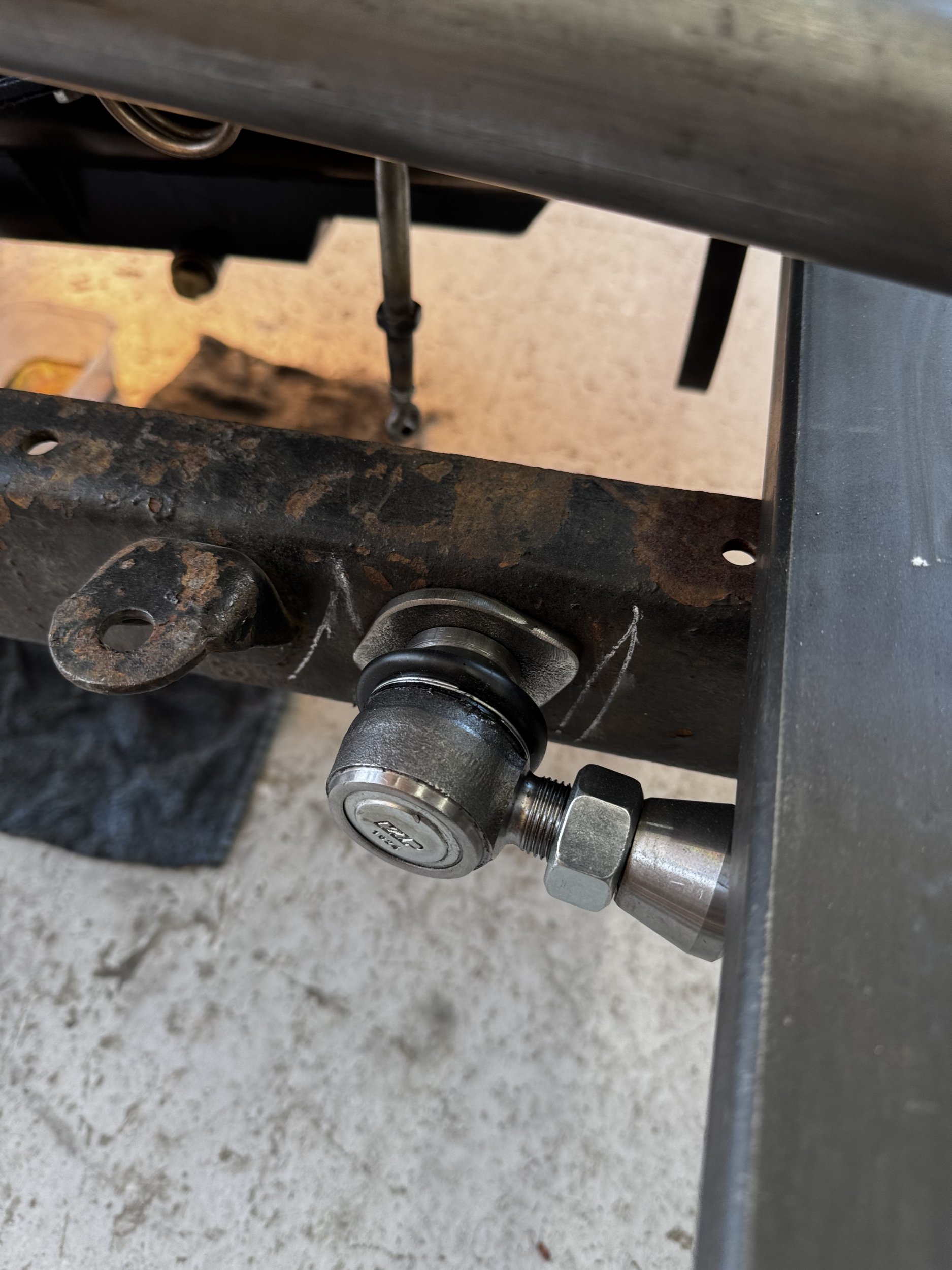

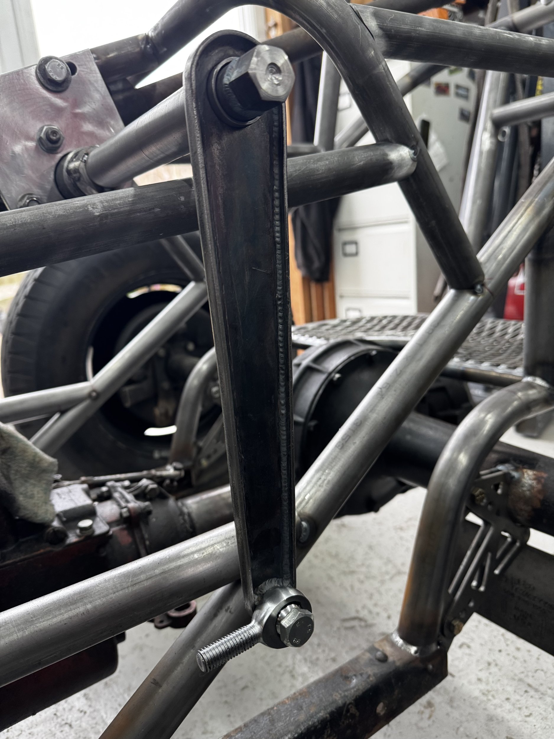

    Front wish bones are old aircraft control rods. No idea what they came off, just something I picked up years ago.

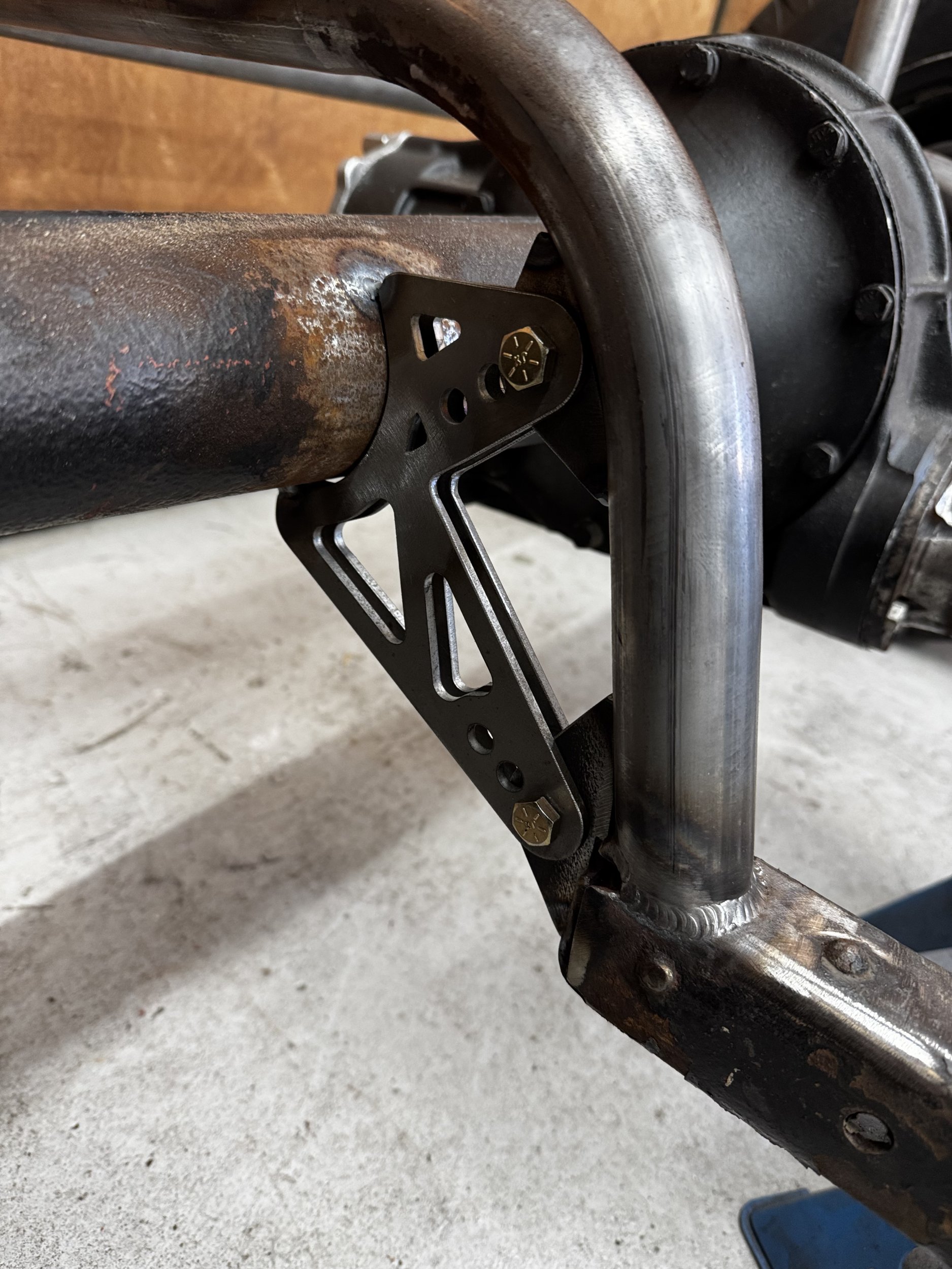

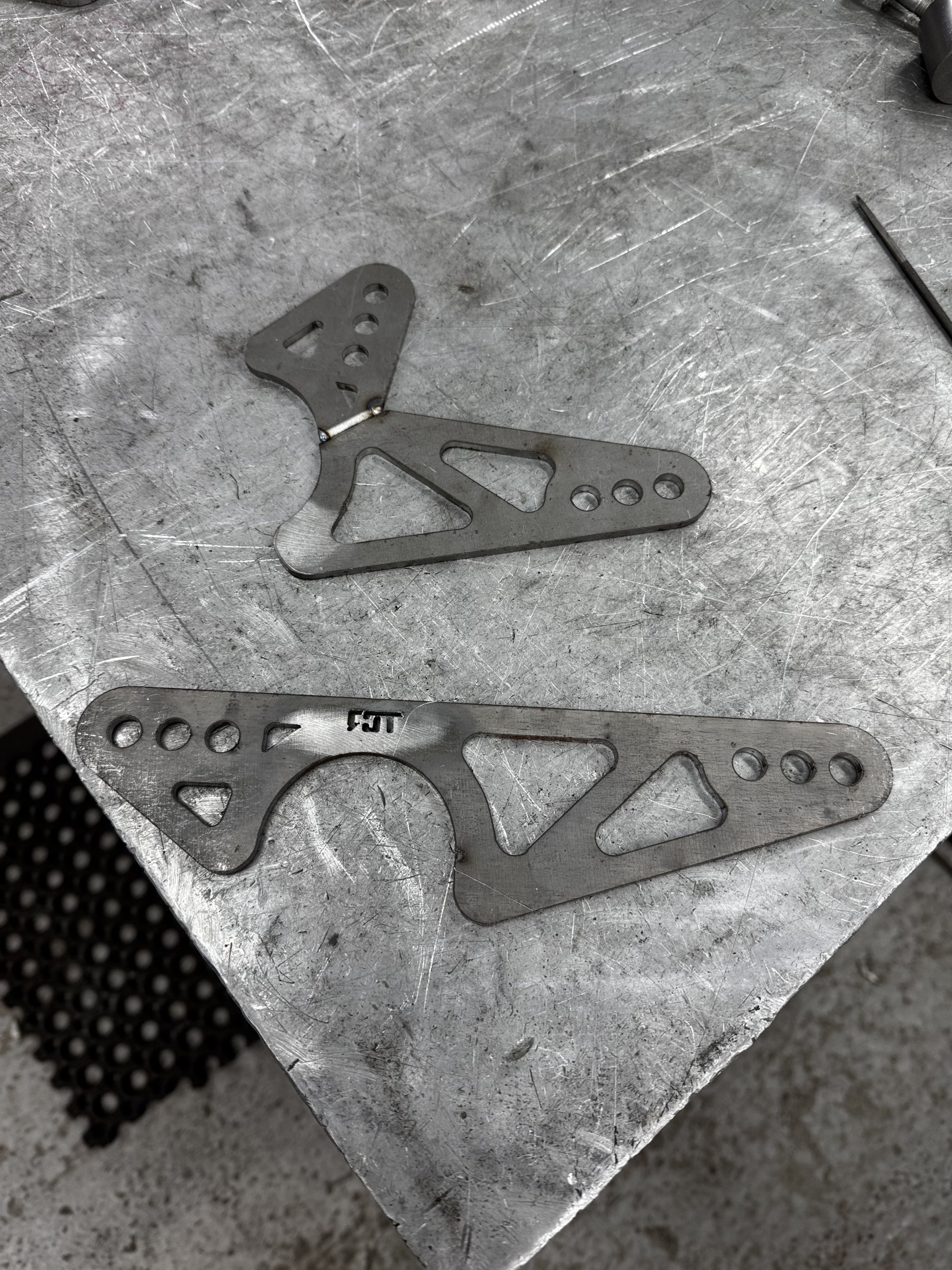

    To save time I bought 4 laser cut 4 bar axle brackets from ebay. Quick cut and weld to make axle mount plates.

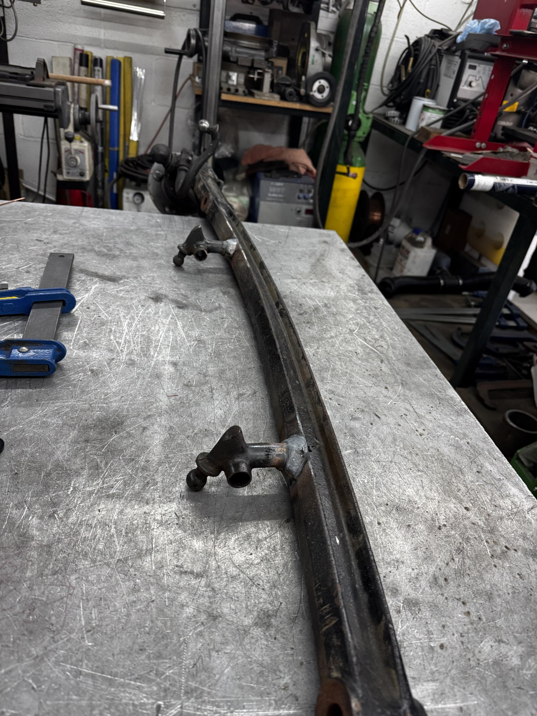

    I cut and welded a pair of English Model Y perch bolts to the top of the axle to suit the quarter elliptical springs.

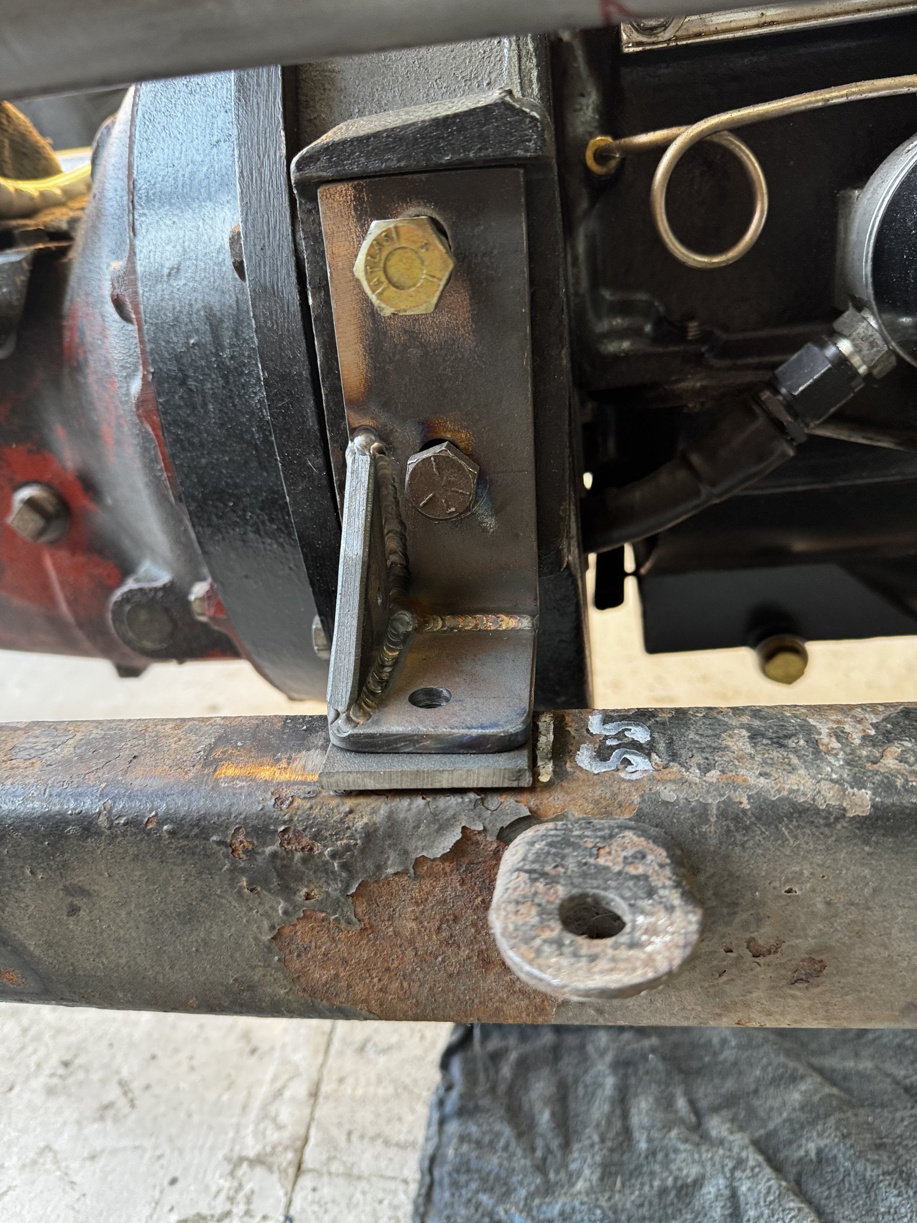

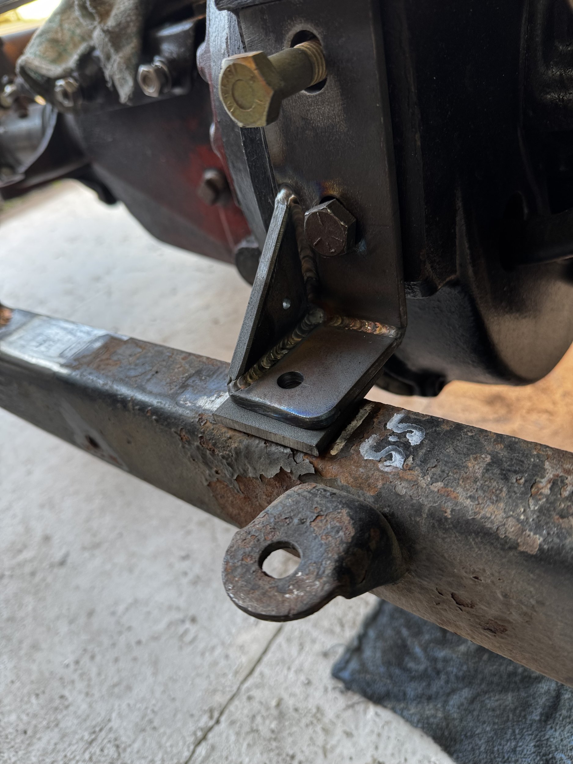

    shackles on the springs and make up the wishbone front and rear mounts. Add rear engine mounts and wheel it outside to take a look.
    IMG_1127.jpeg IMG_1128.jpeg IMG_1129.jpeg IMG_1130.jpeg IMG_1131.jpeg IMG_1140.jpeg IMG_1141.jpeg IMG_1142.jpeg IMG_1143.jpeg IMG_1145.jpeg IMG_1148.jpeg IMG_1149.jpeg

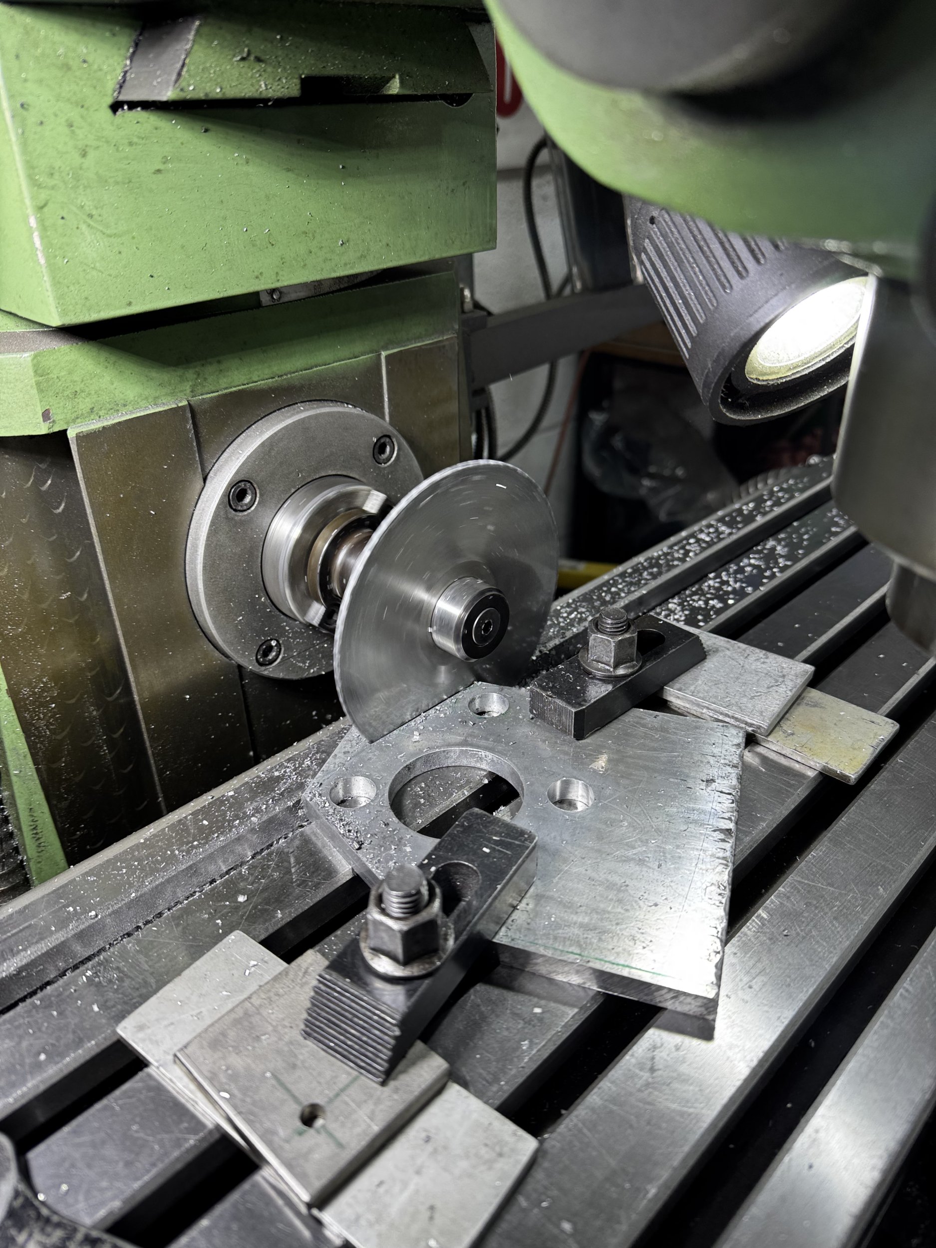

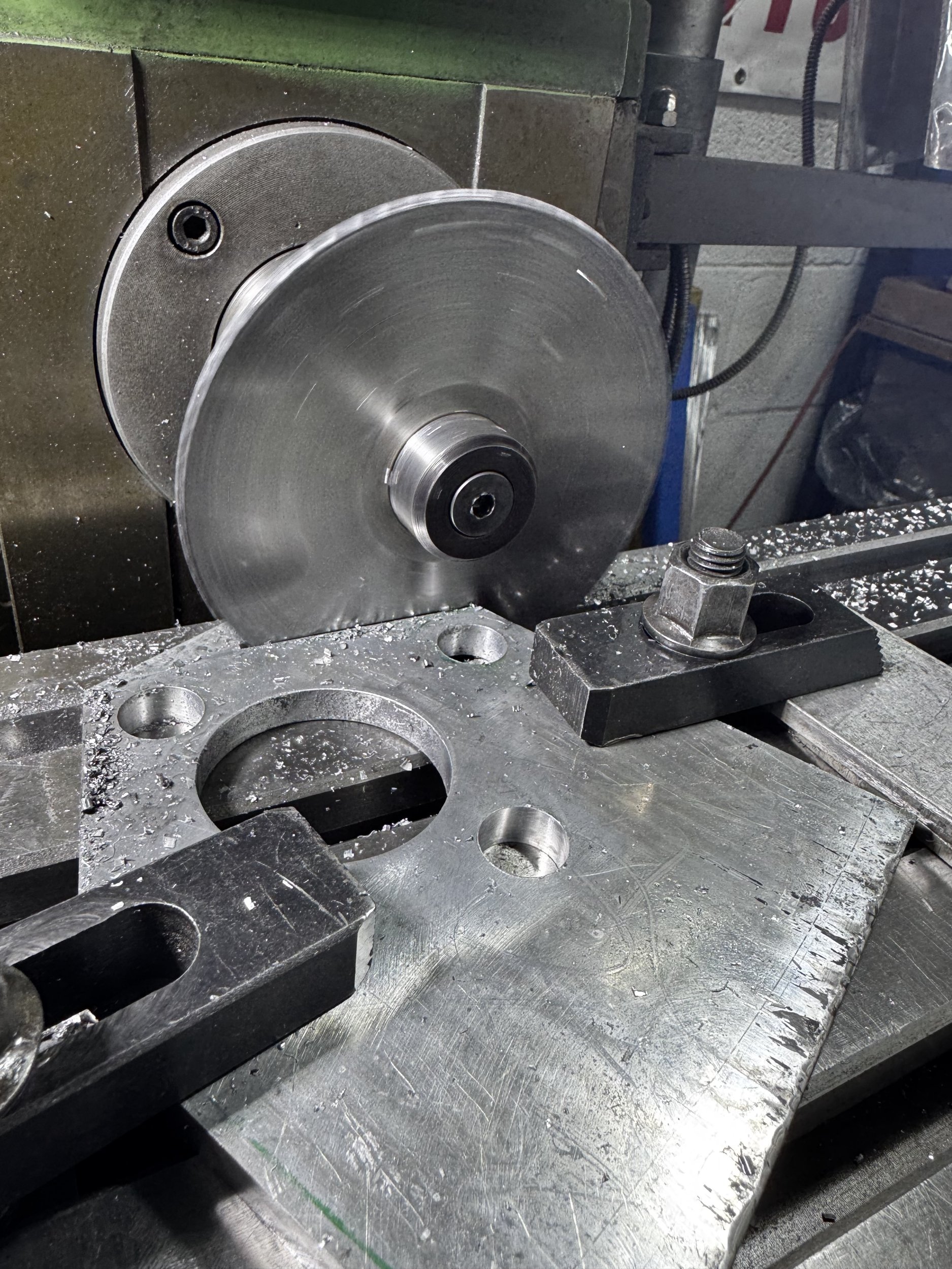

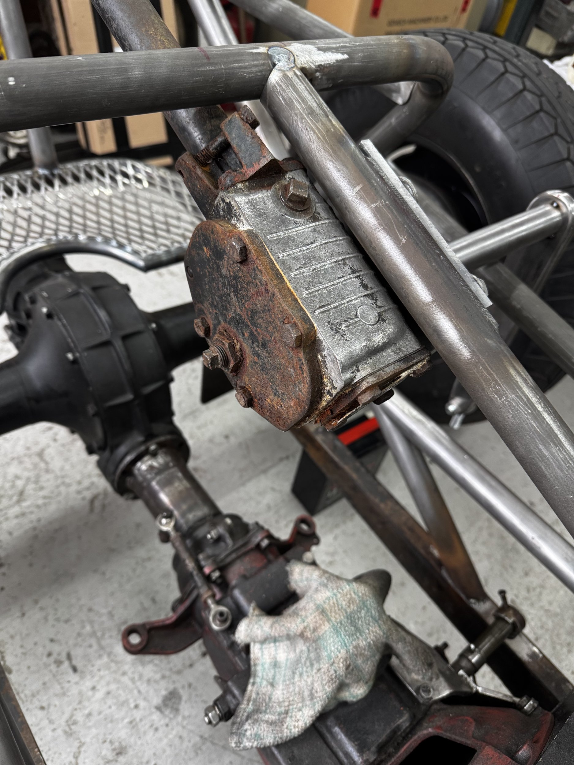

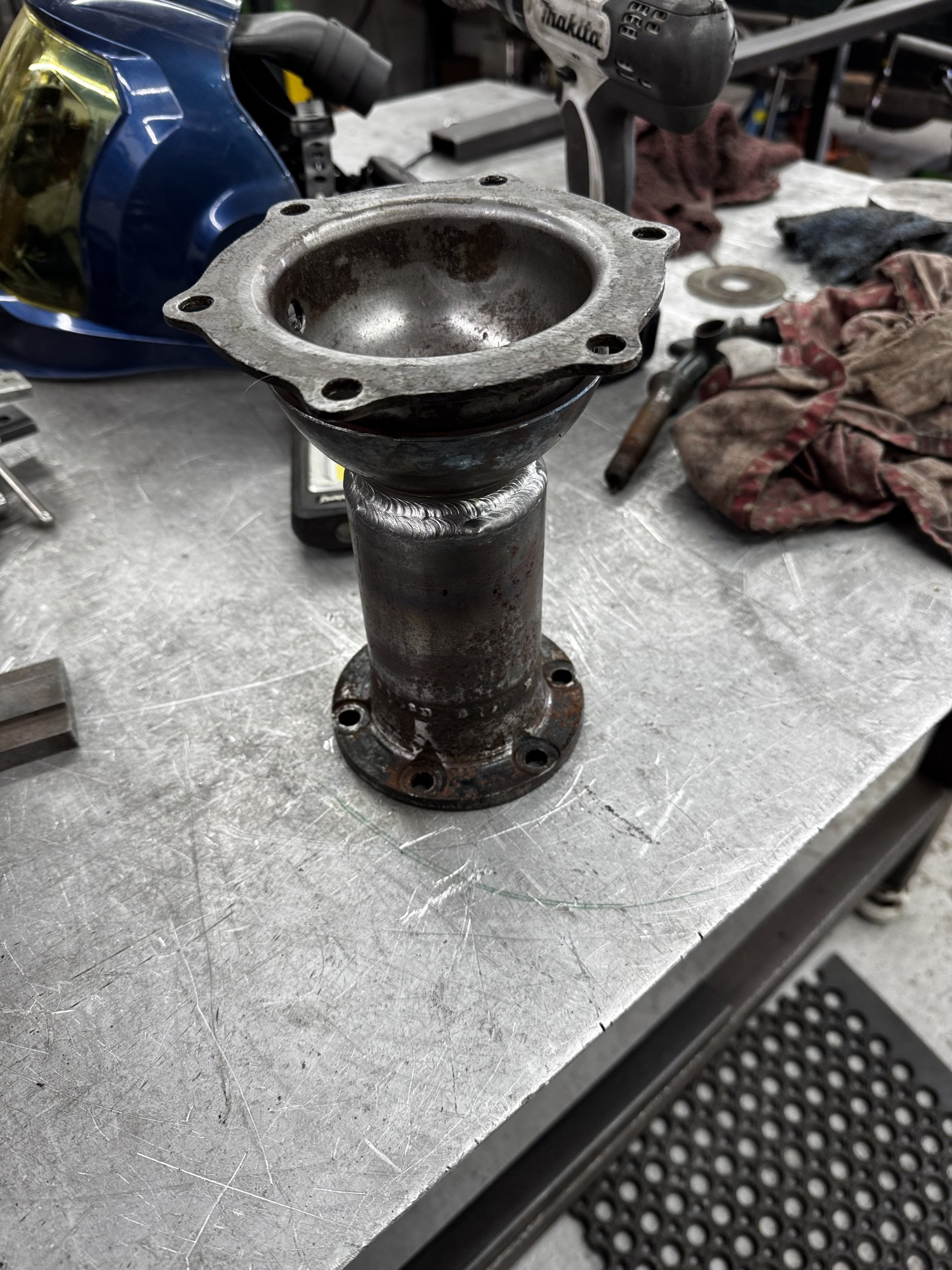

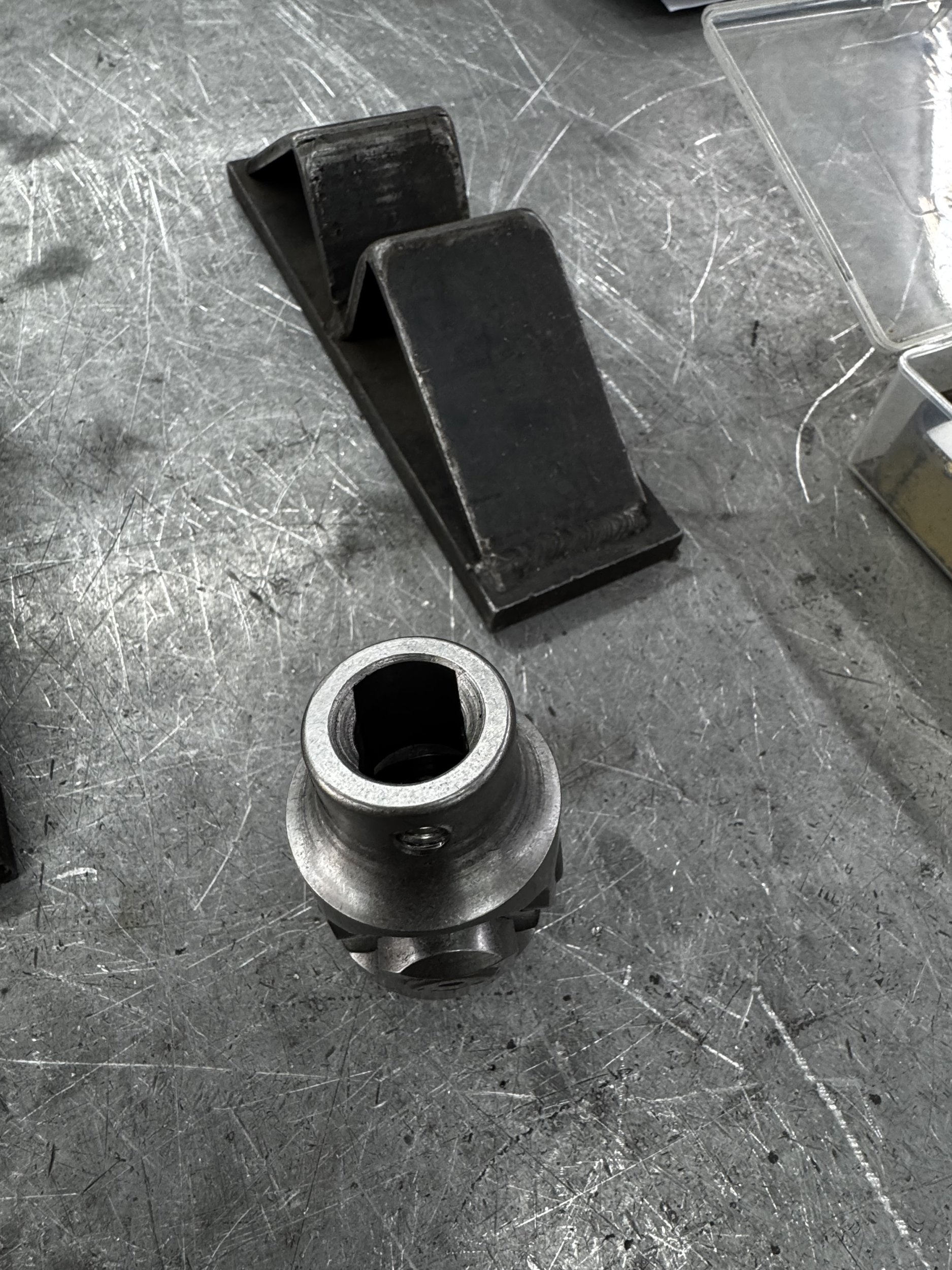

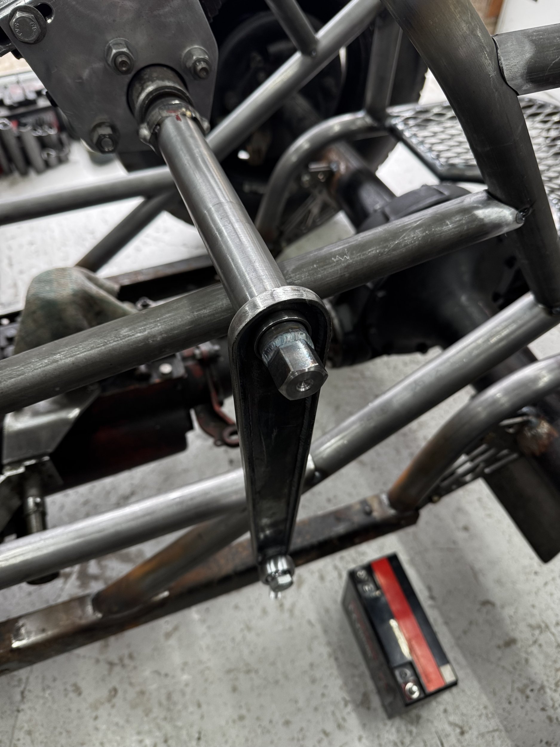

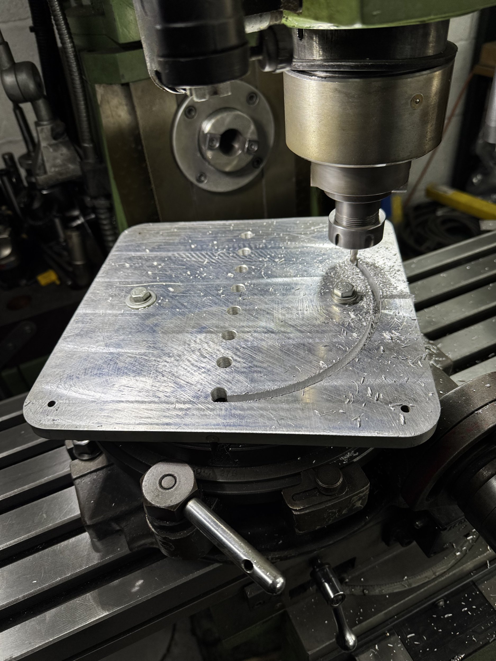

    Steering next. I used the mill to saw a thick aluminium plate to mount the Land Rover steering box. I made a long output shaft and used an exhaust clamp and ring to locate it. A long fabricated drop arm to make the steering quicker.
    IMG_1174.jpeg IMG_1175.jpeg IMG_1176.jpeg IMG_1177.jpeg IMG_1178.jpeg IMG_1179.jpeg IMG_1180.jpeg

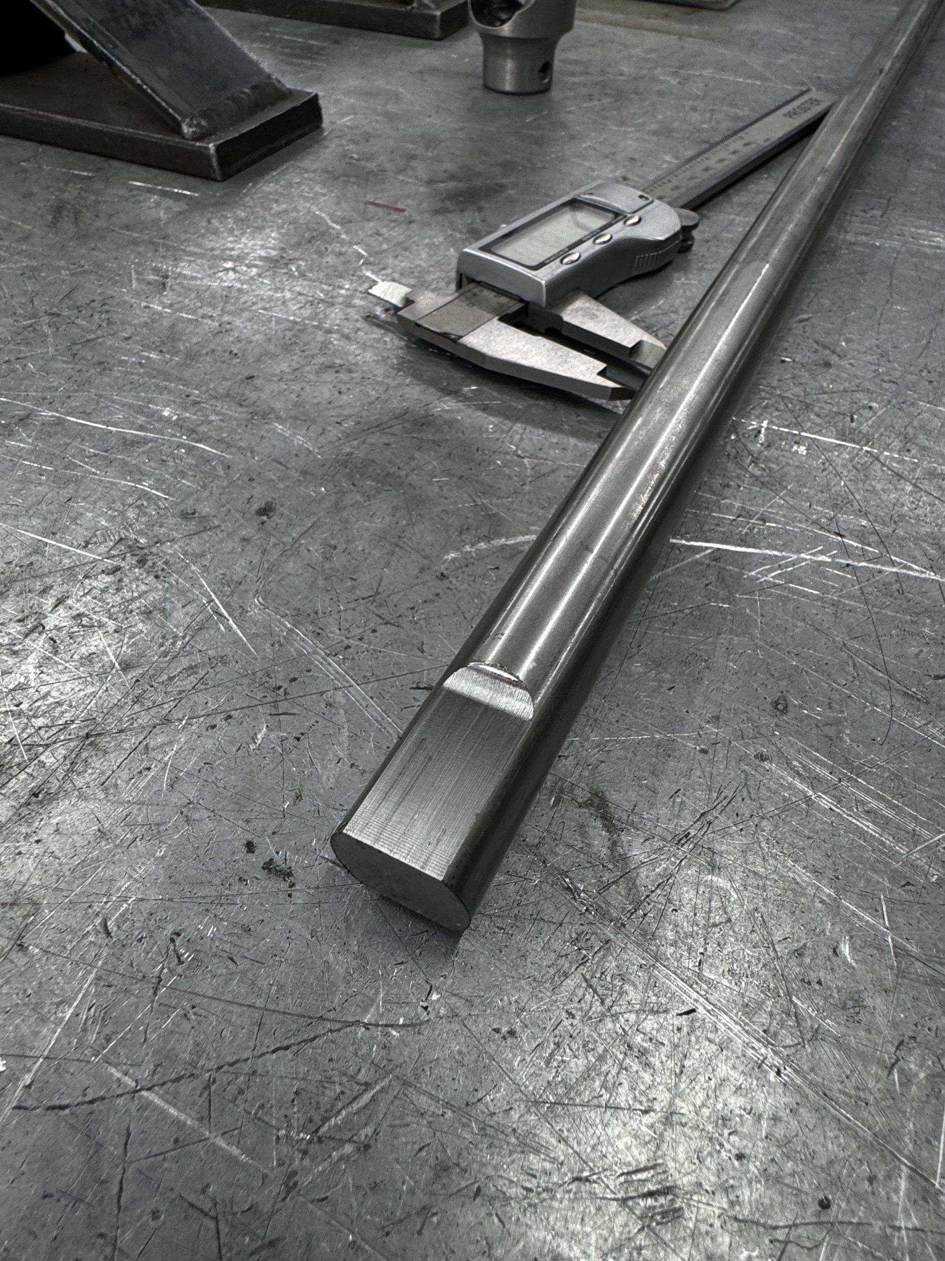

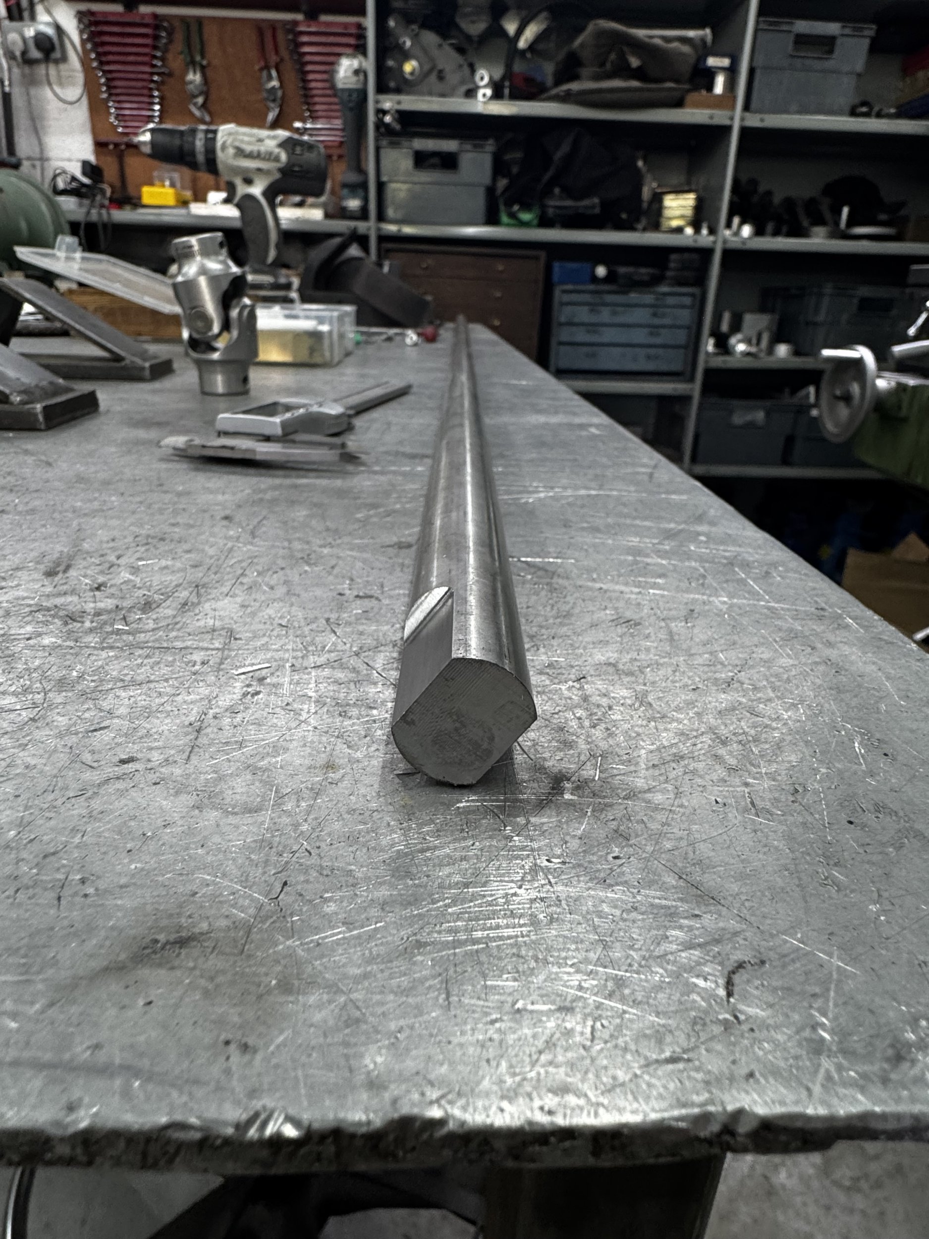

    3/4” stainless steel bar machined with two flats (DD) one end and a 1/2” rod end the other.

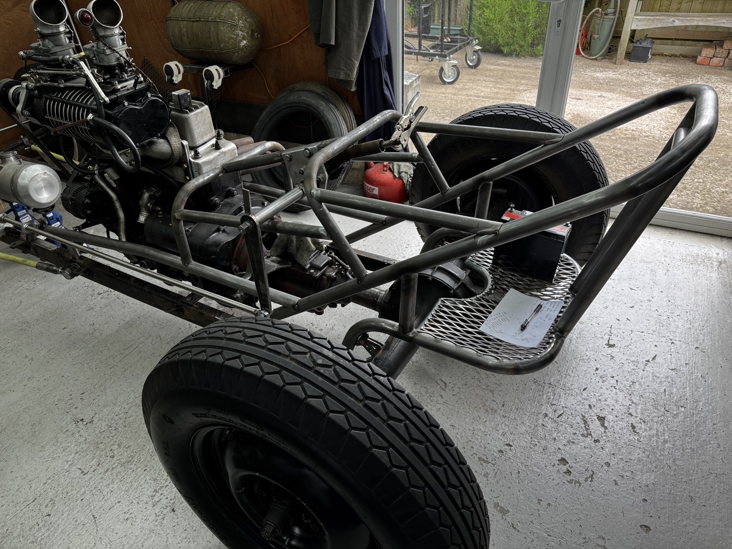

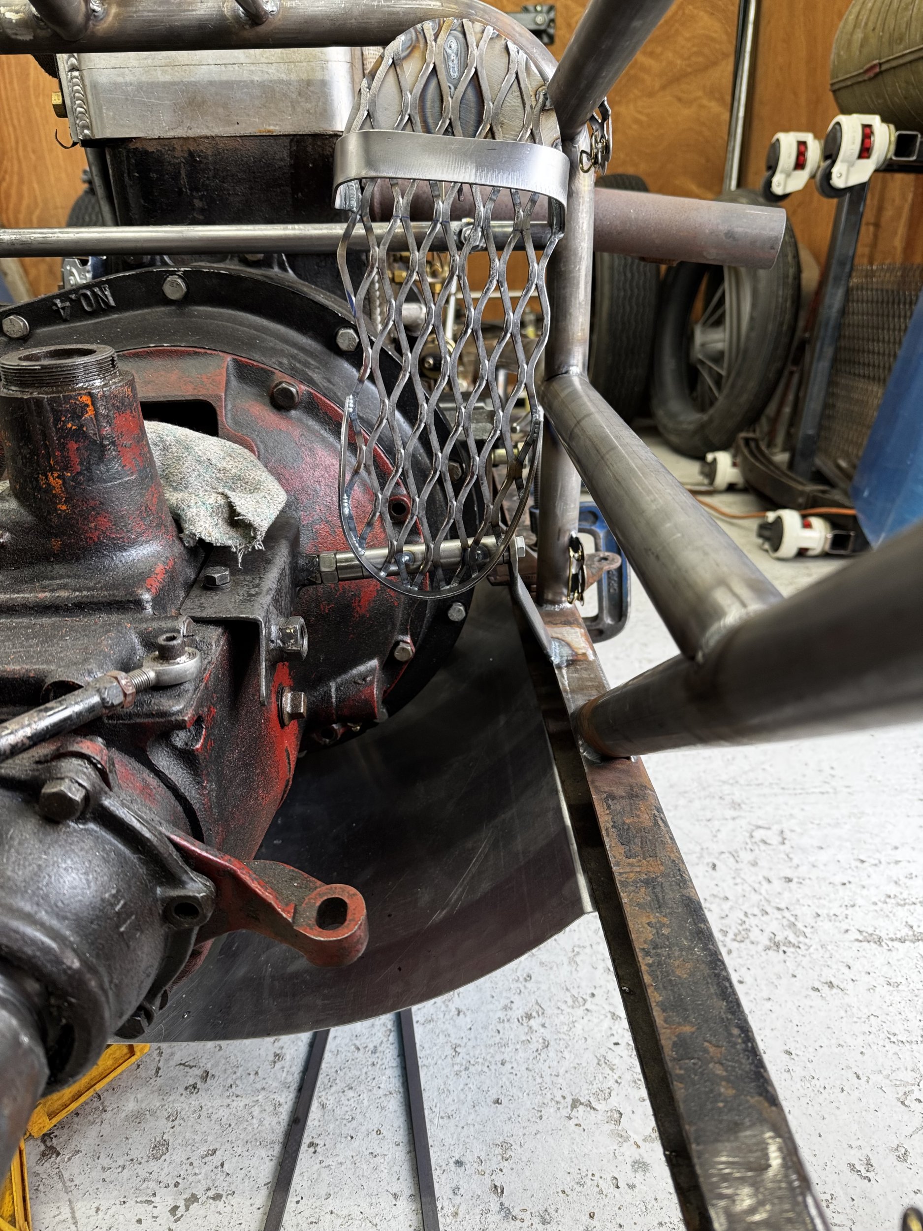

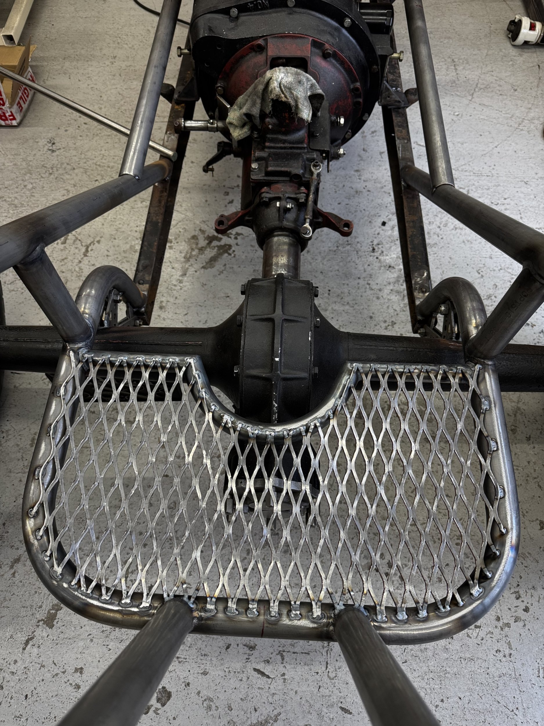

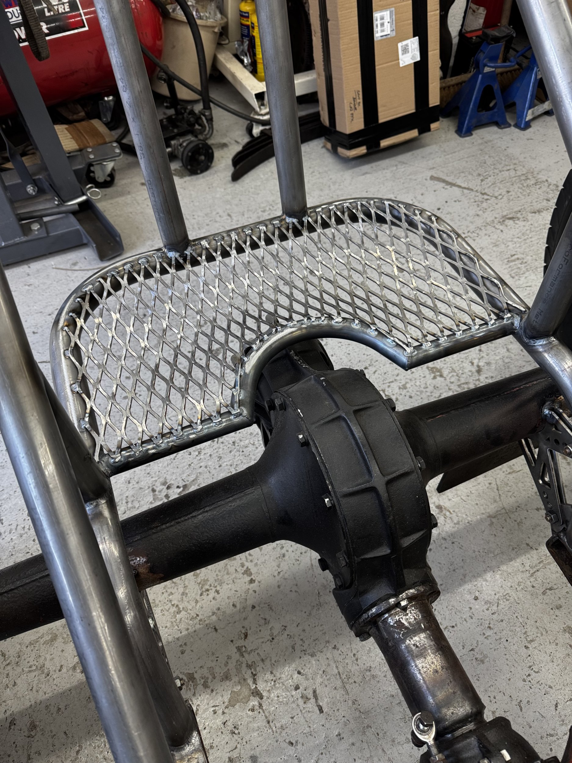

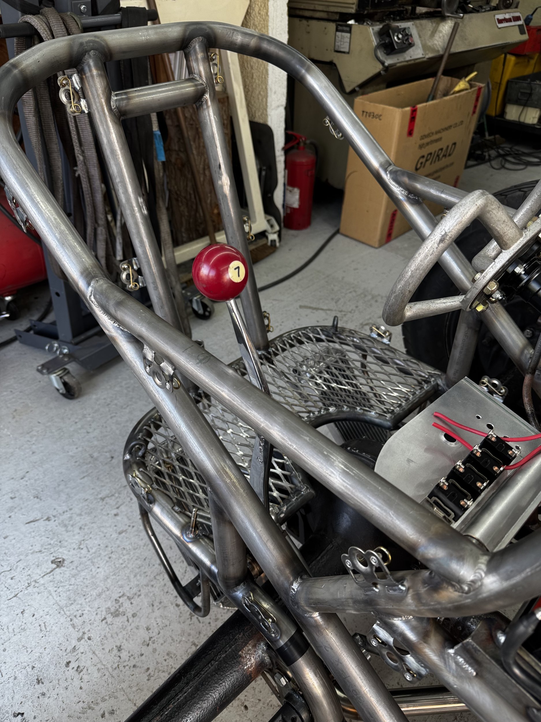

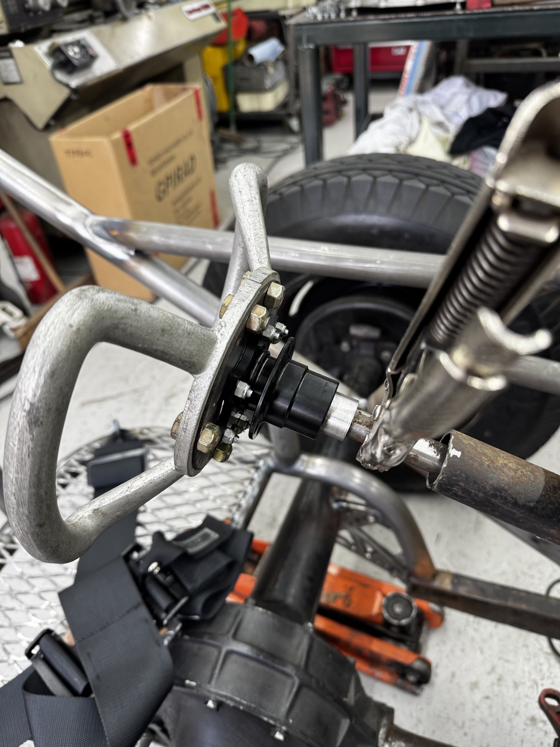

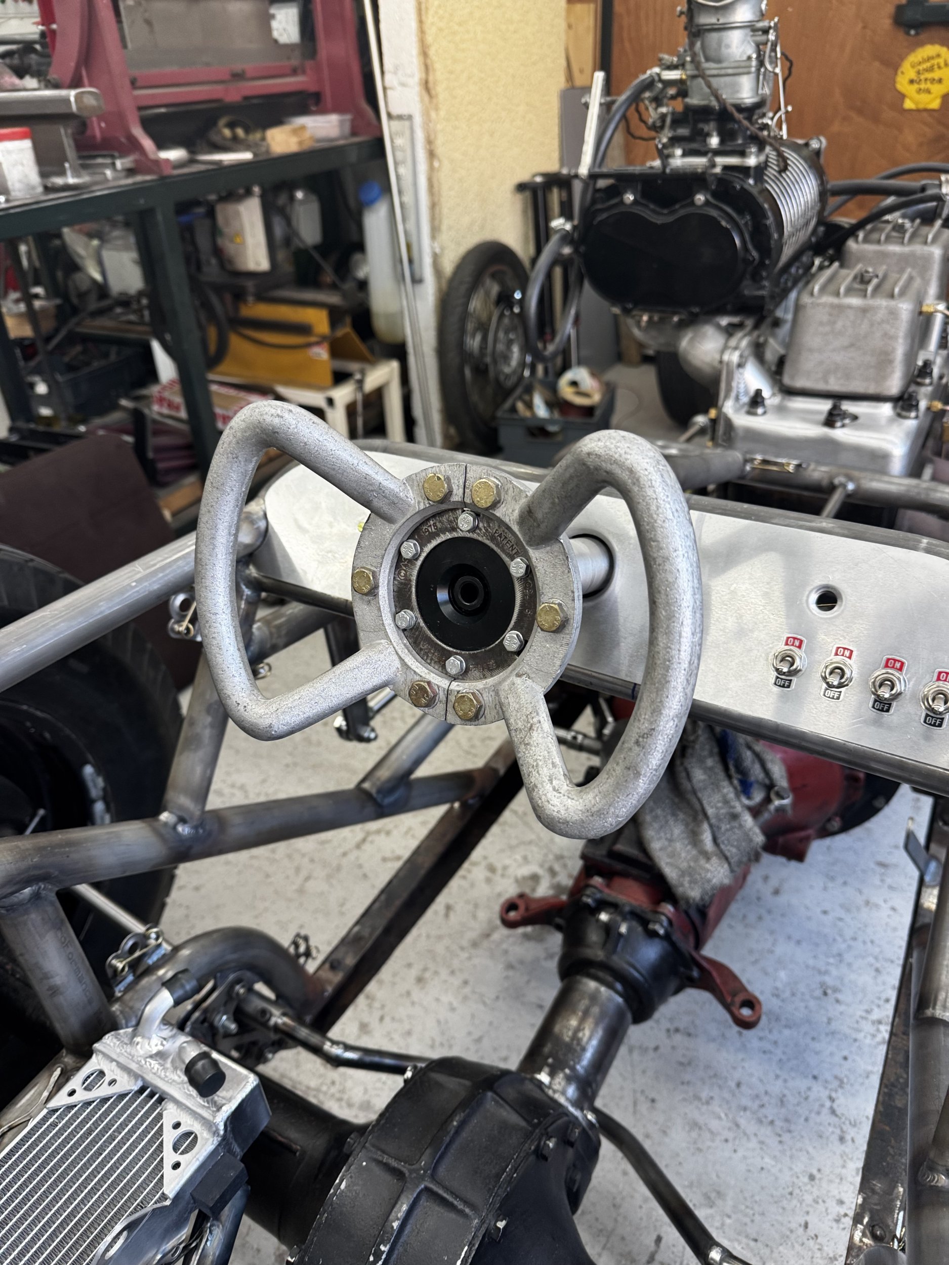

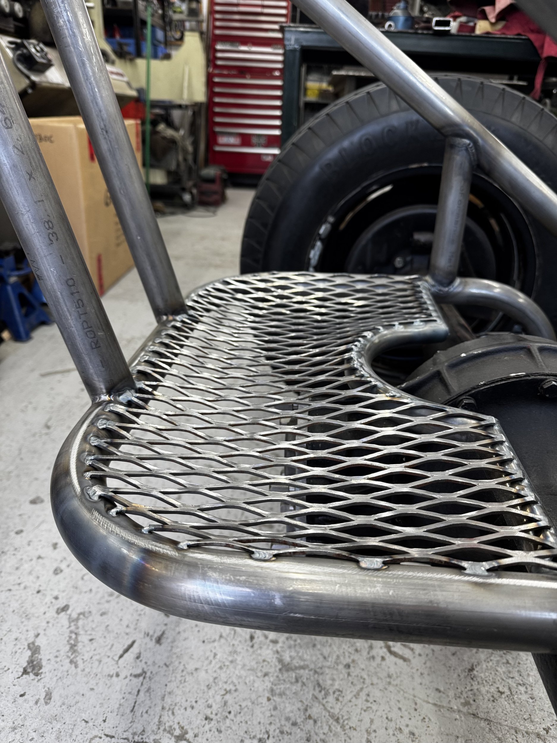

    Add some expanded mesh for the seat. Cheap and lightweight.

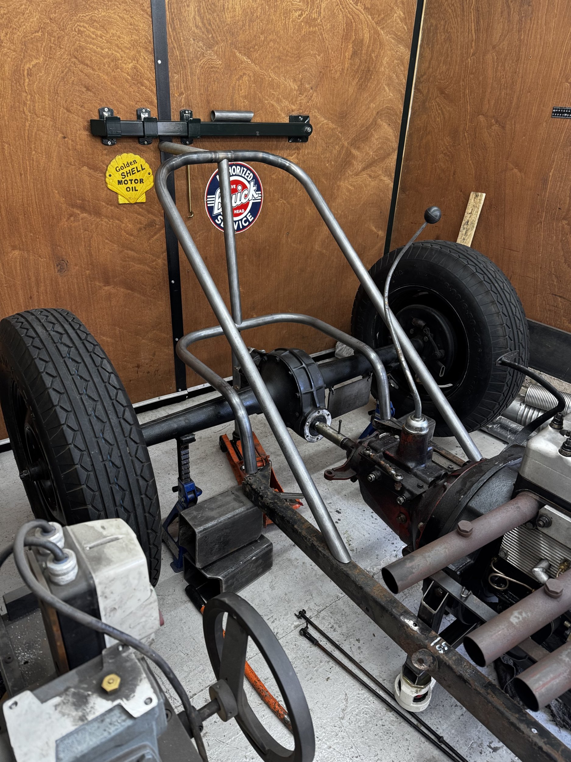

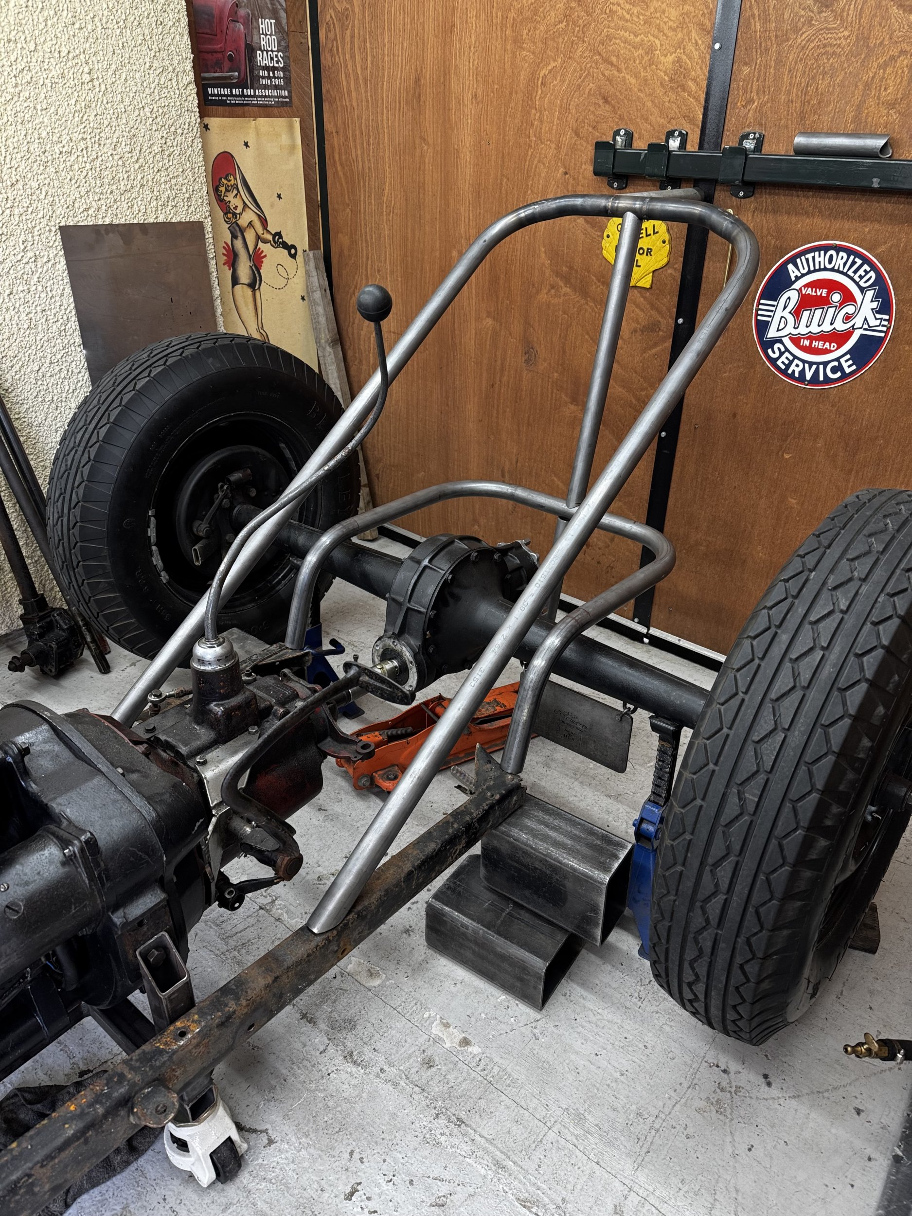

    More tubing for bodywork and to hang stuff from. A push bar and seat belt loops. IMG_1159.jpeg IMG_1160.jpeg IMG_1161.jpeg IMG_1213.jpeg IMG_1214.jpeg IMG_1217.jpeg IMG_1222.jpeg IMG_1223.jpeg

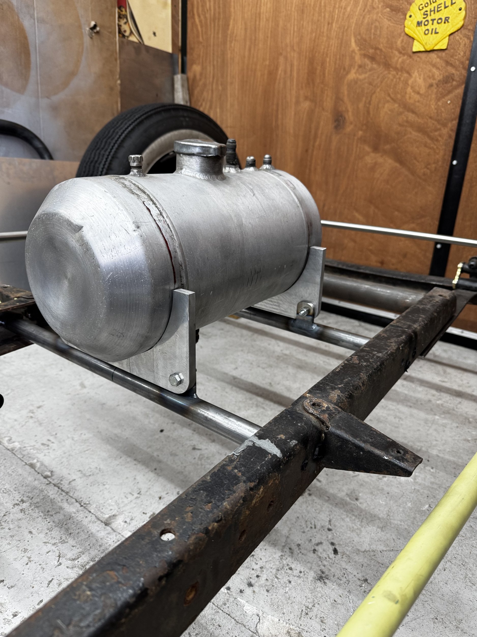

    I bought an old tank. Has a moon sticker, but not sure it is. The proper moon mounts aren’t cheap and take time to get here so I used the mill and rotary table to make a pair.

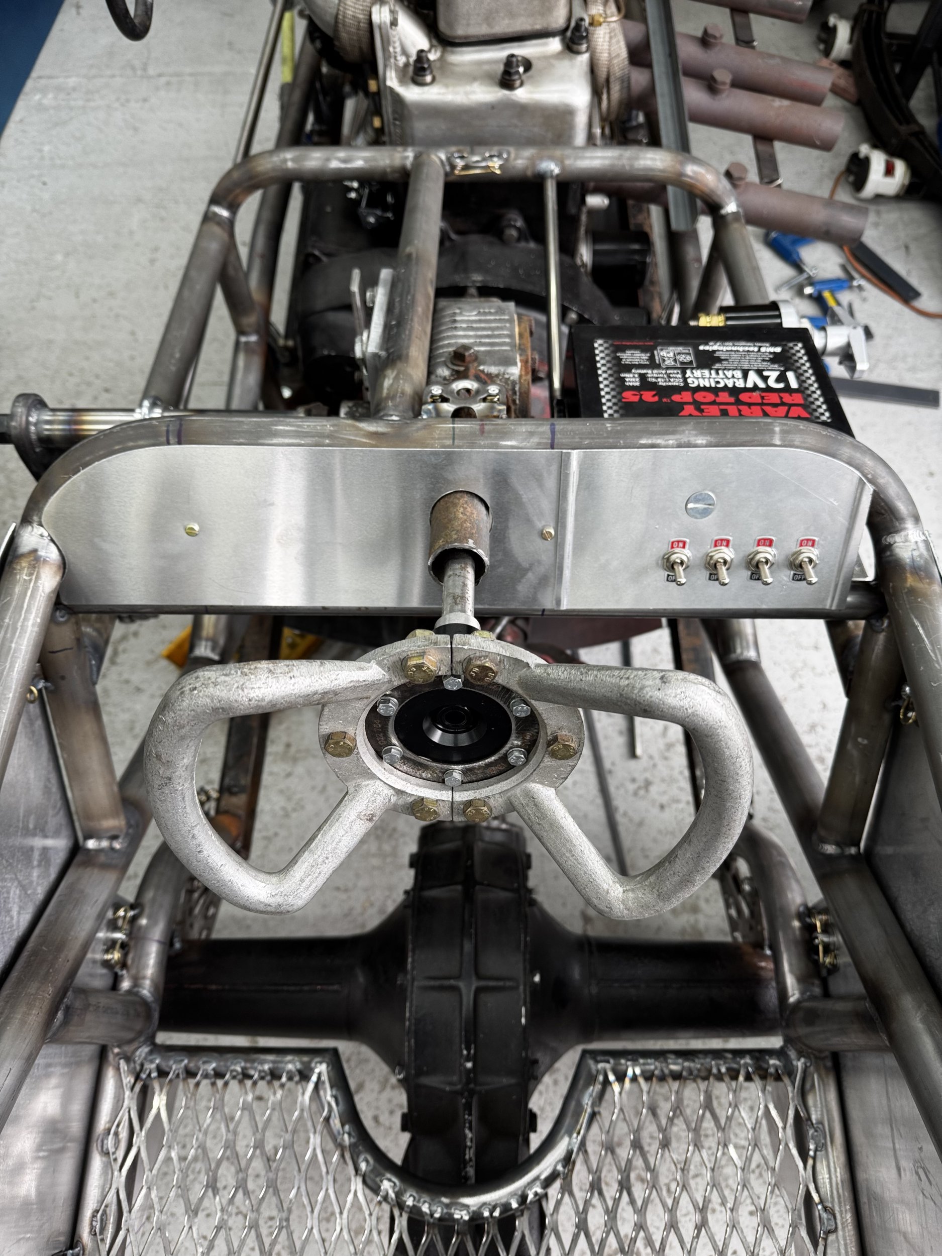

    ****erfly steering wheel is a couple of gas bottle handles bolted to a quick release boss.
    Chucky, winduptoy, Outback and 5 others like this.

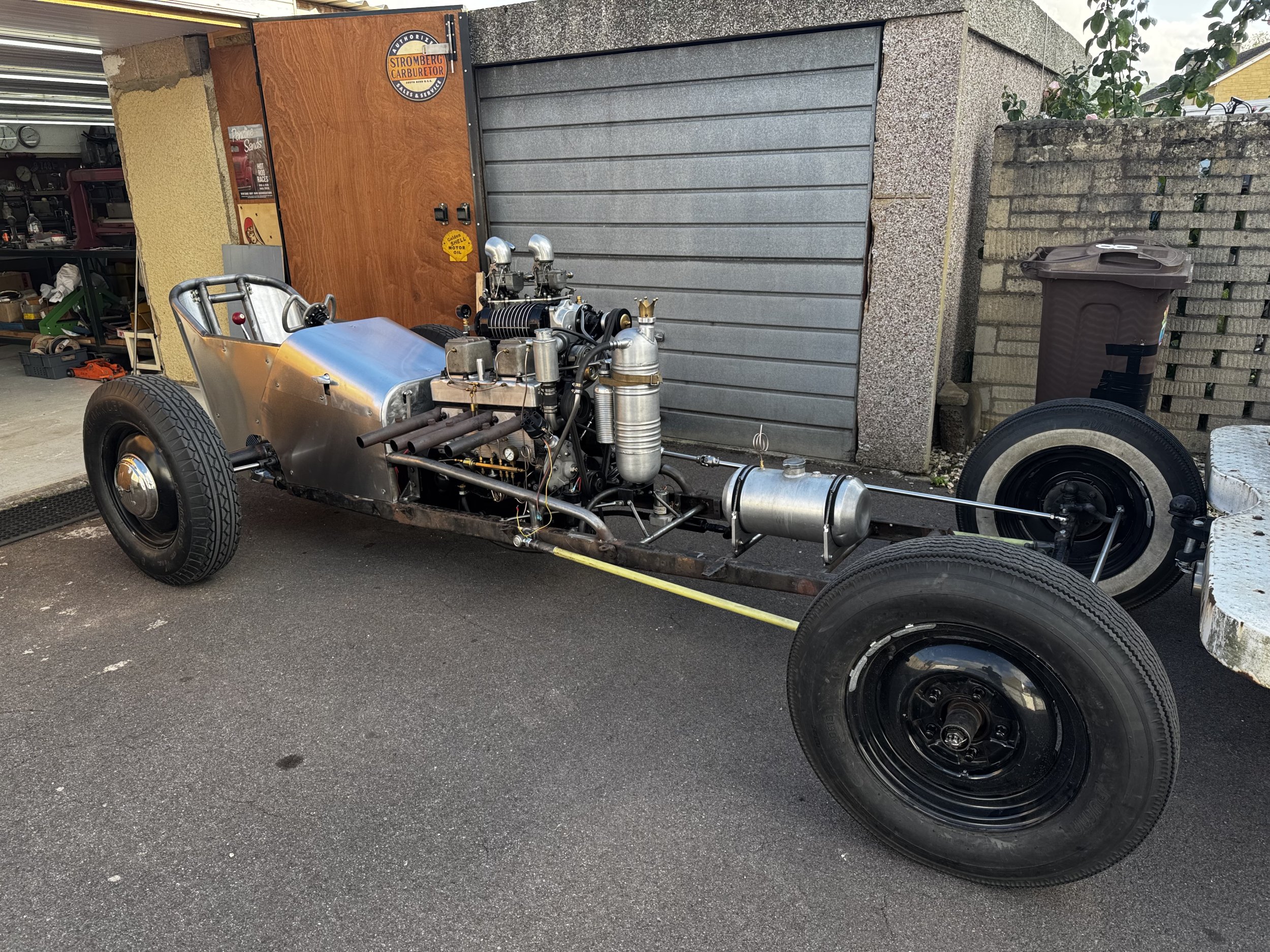

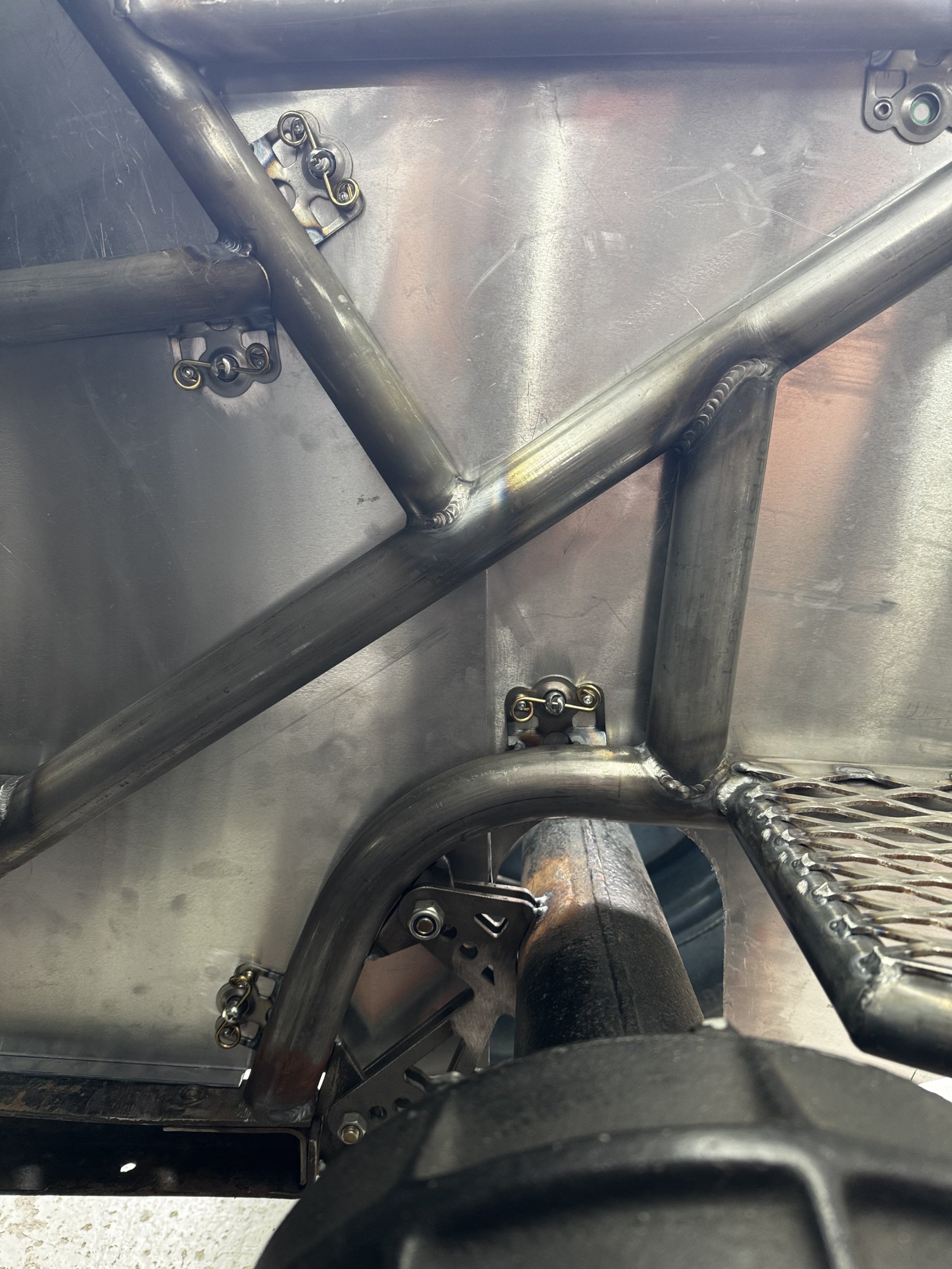

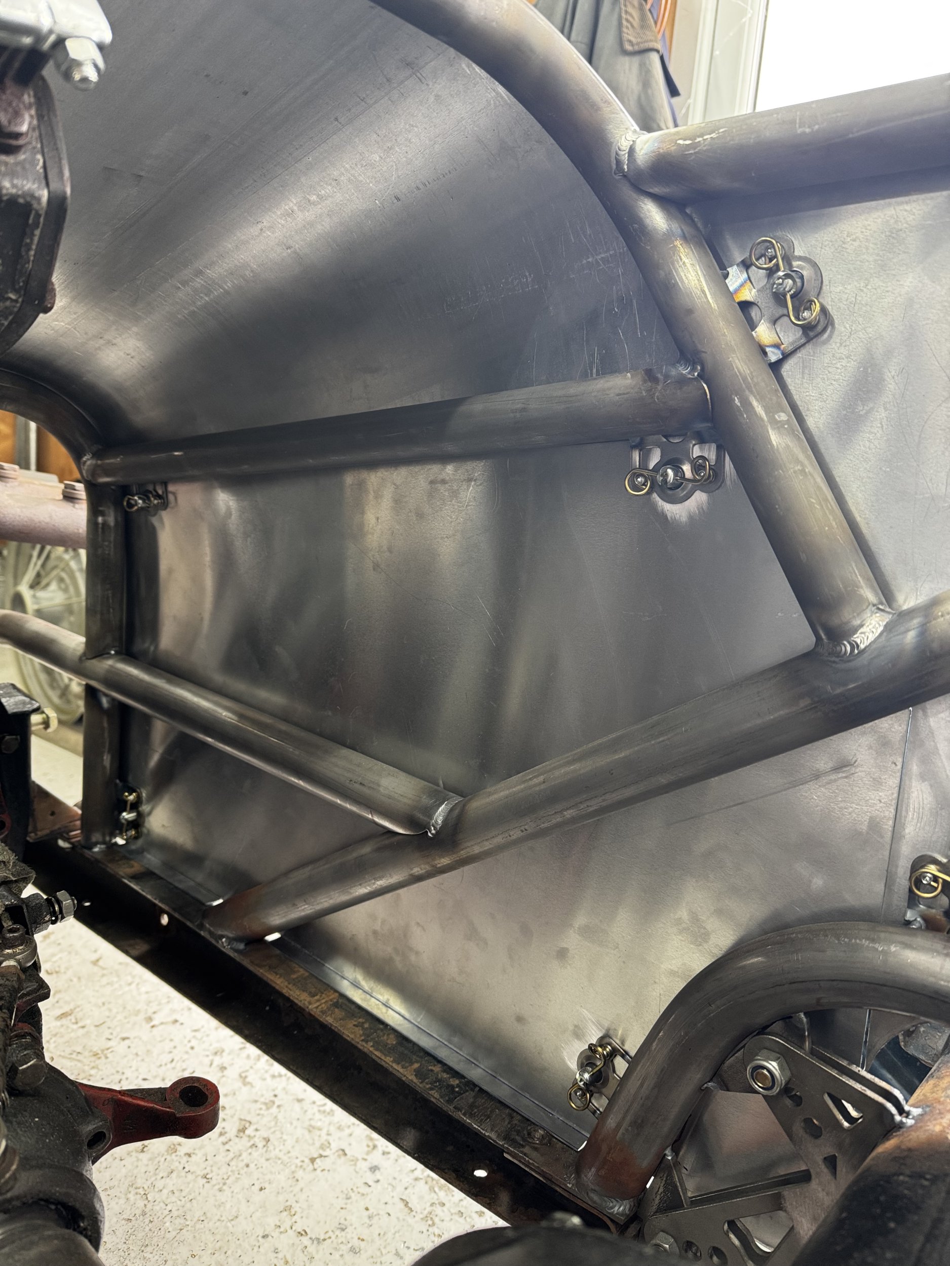

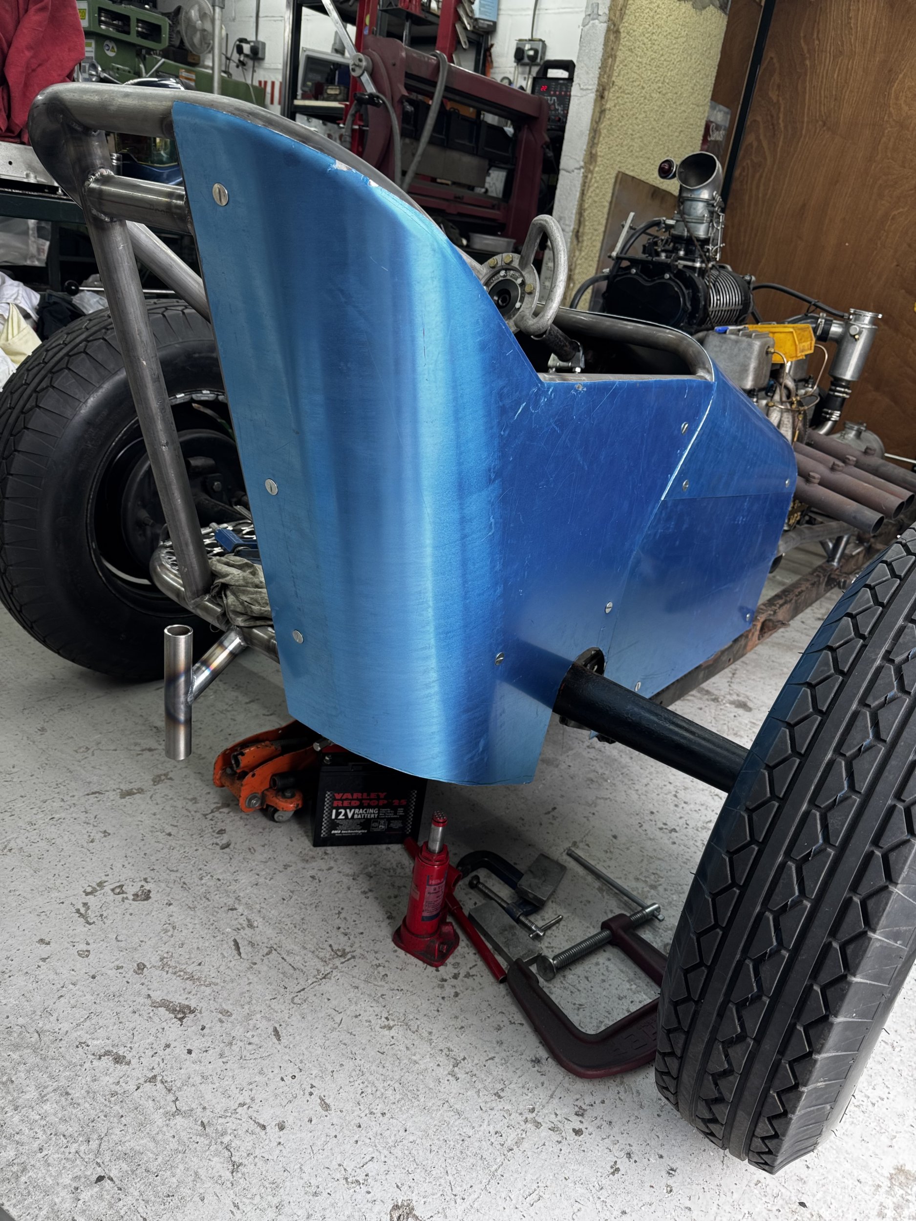

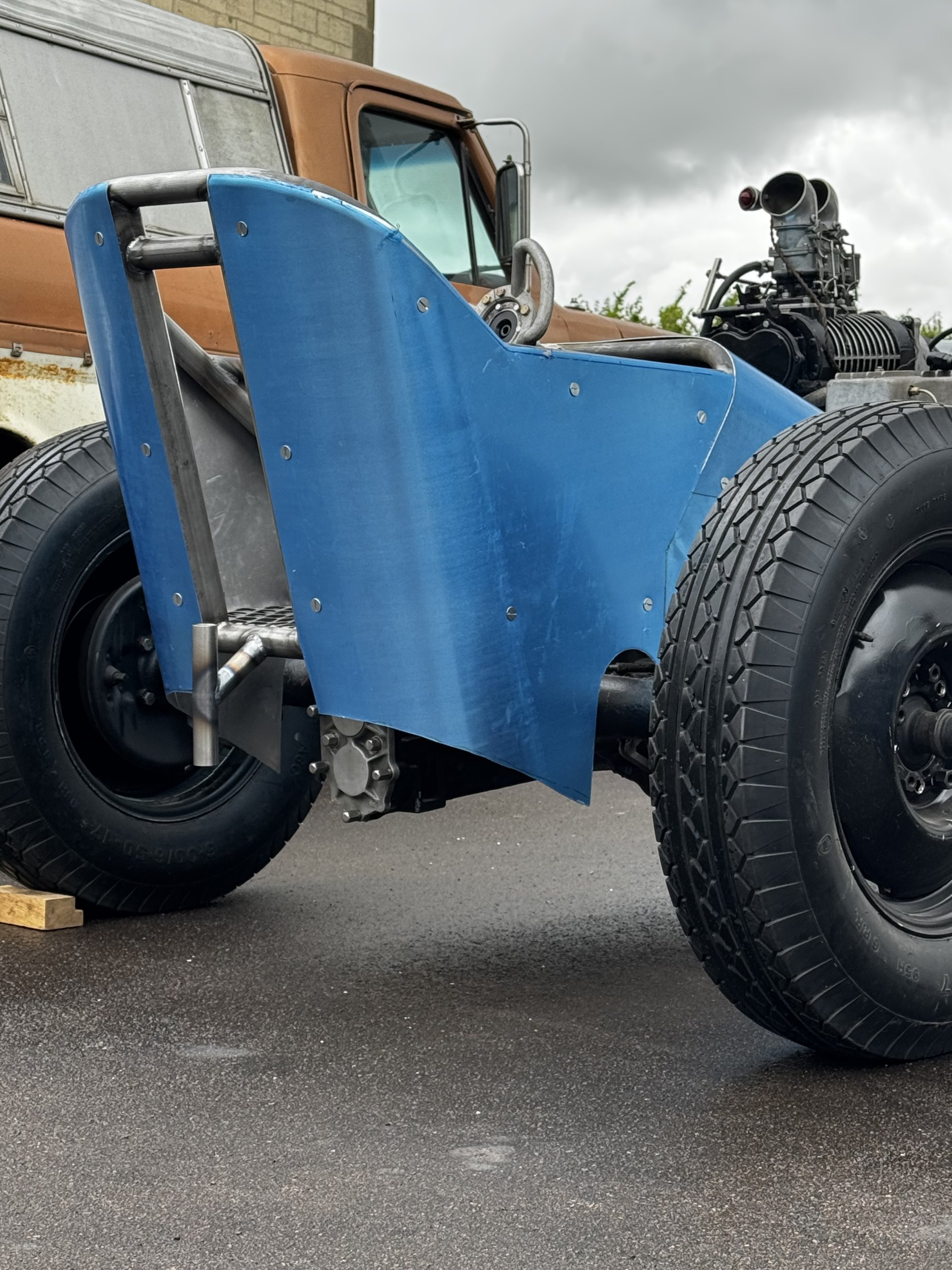

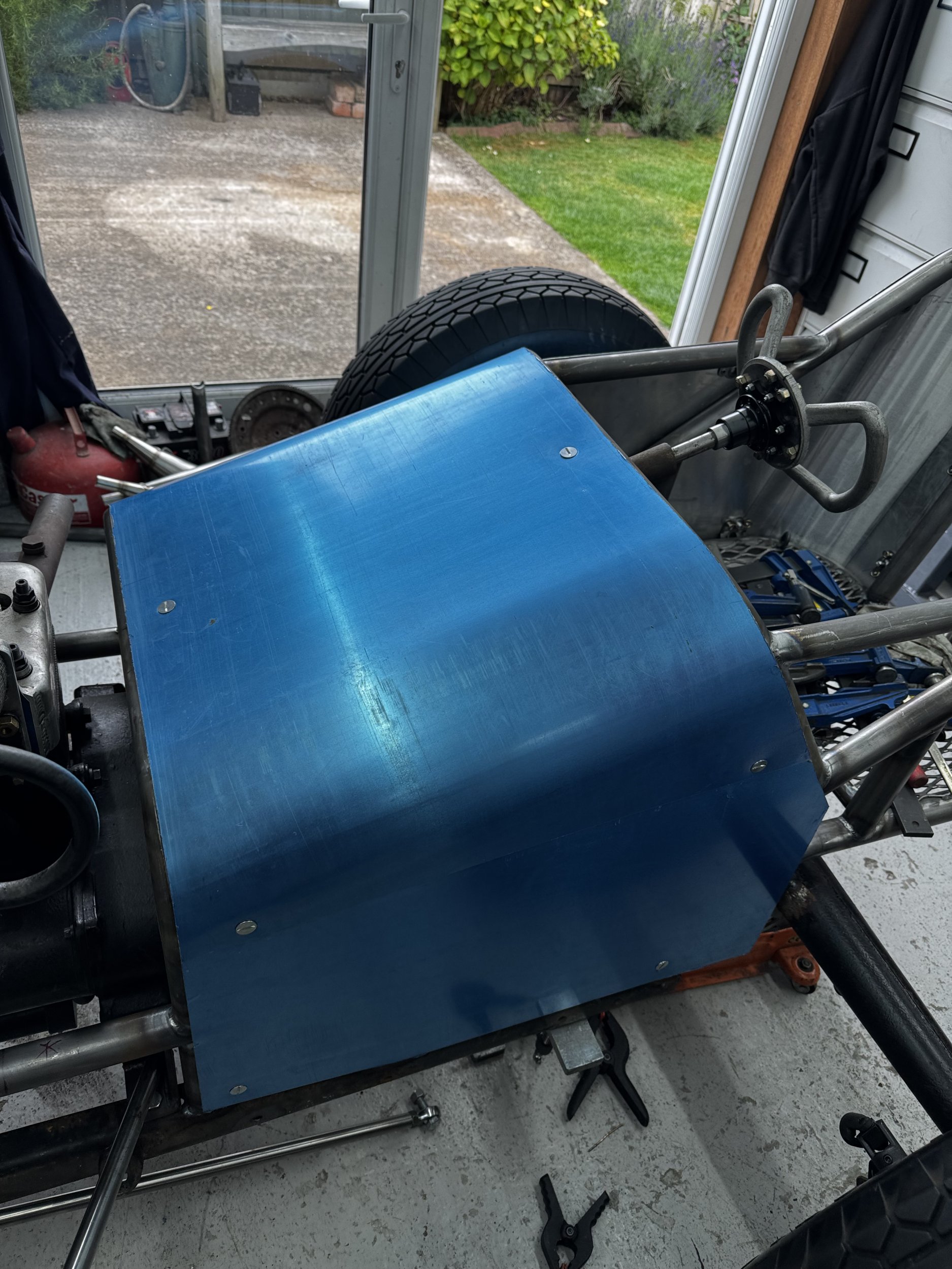

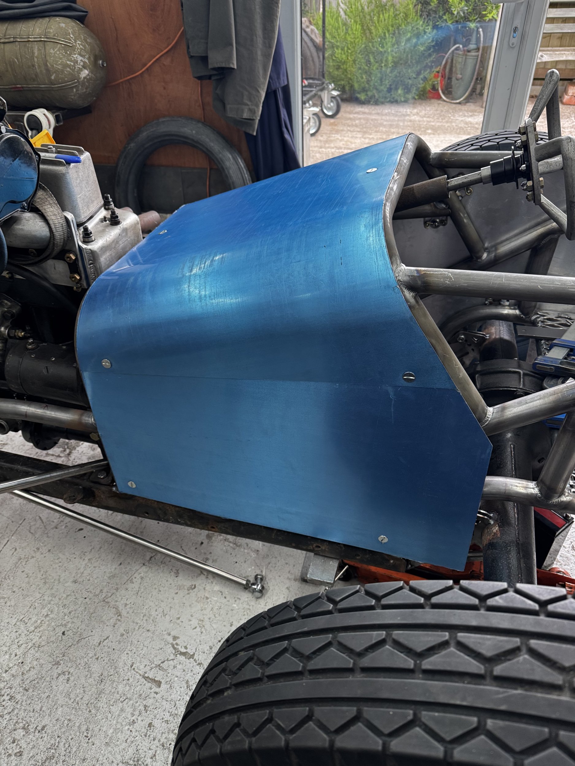

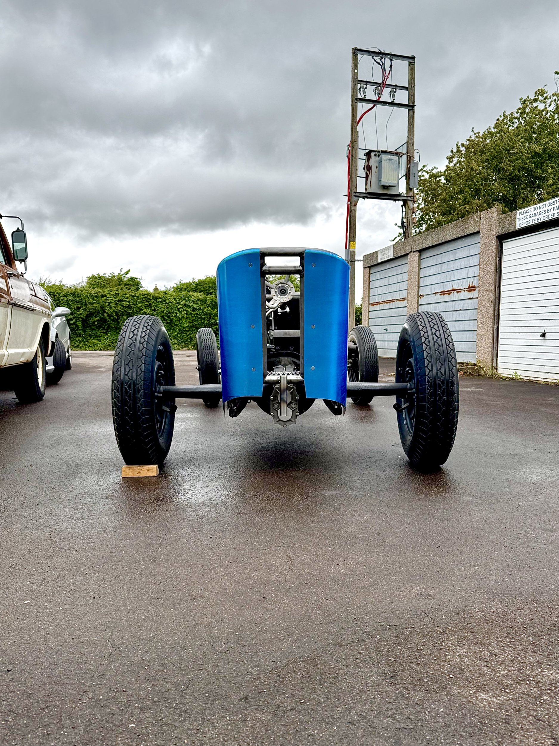

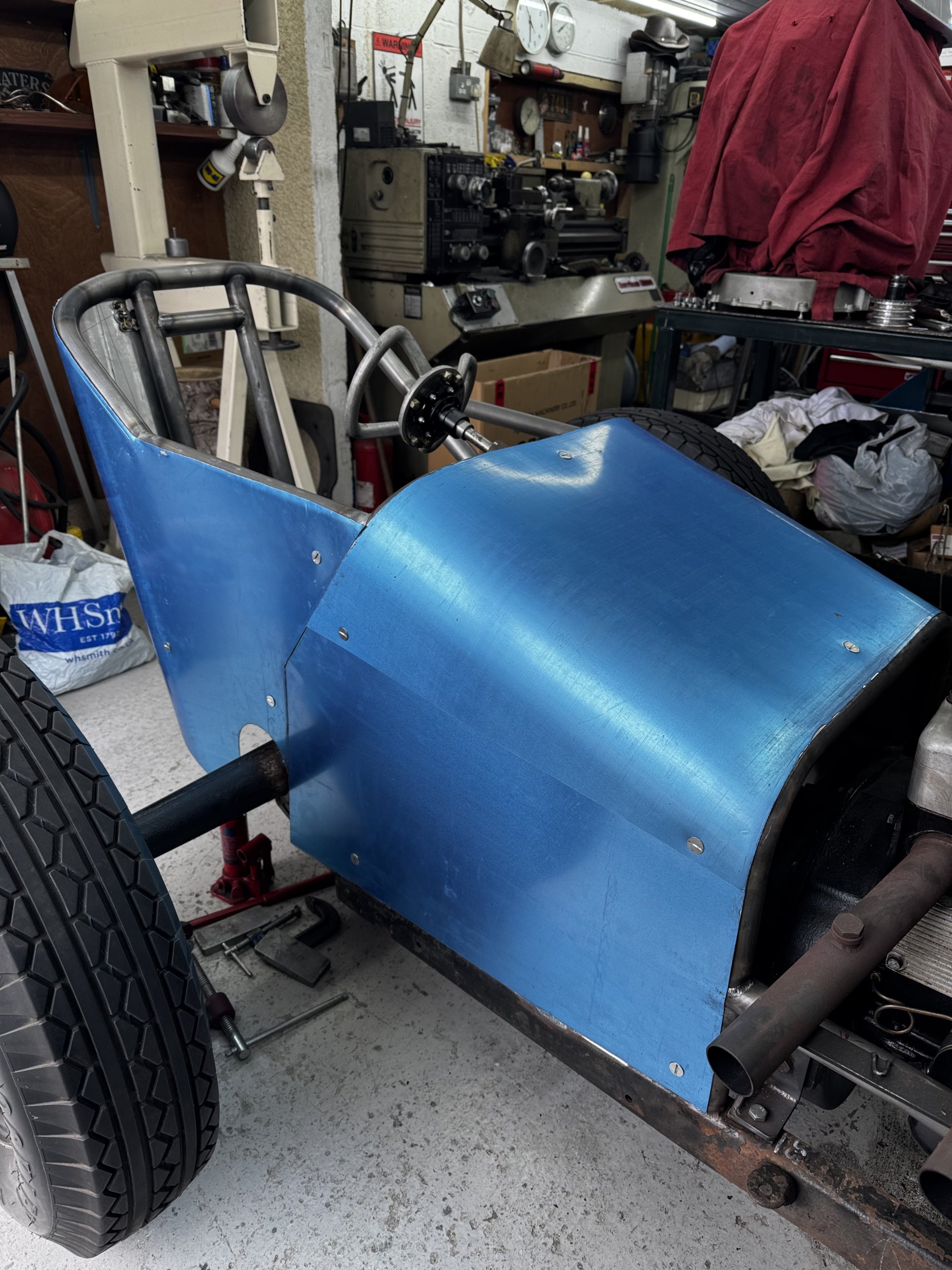

    Thin aluminium sheet and a bunch of Dzus fasteners and voila! body work! The blue is just a protective layer.
    IMG_1237.jpeg IMG_1238.jpeg IMG_1239.jpeg IMG_1240.jpeg IMG_1241.jpeg IMG_1243.jpeg IMG_1244.jpeg IMG_1245.jpeg IMG_1248.jpeg IMG_1250.jpeg IMG_1251.jpeg

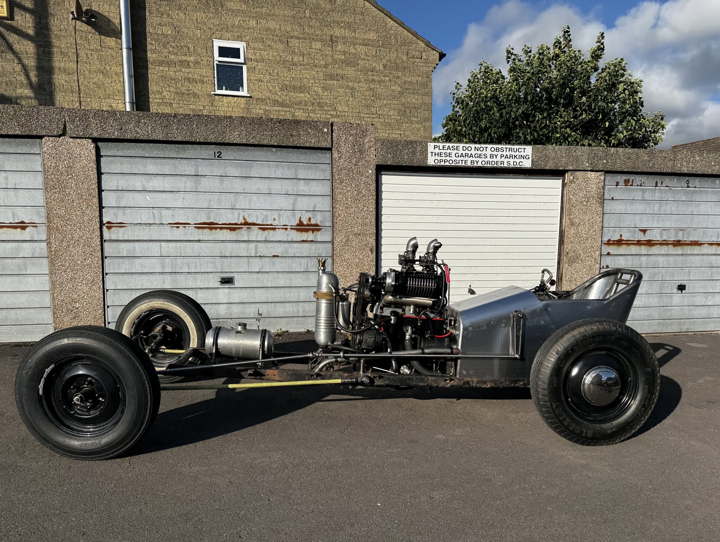

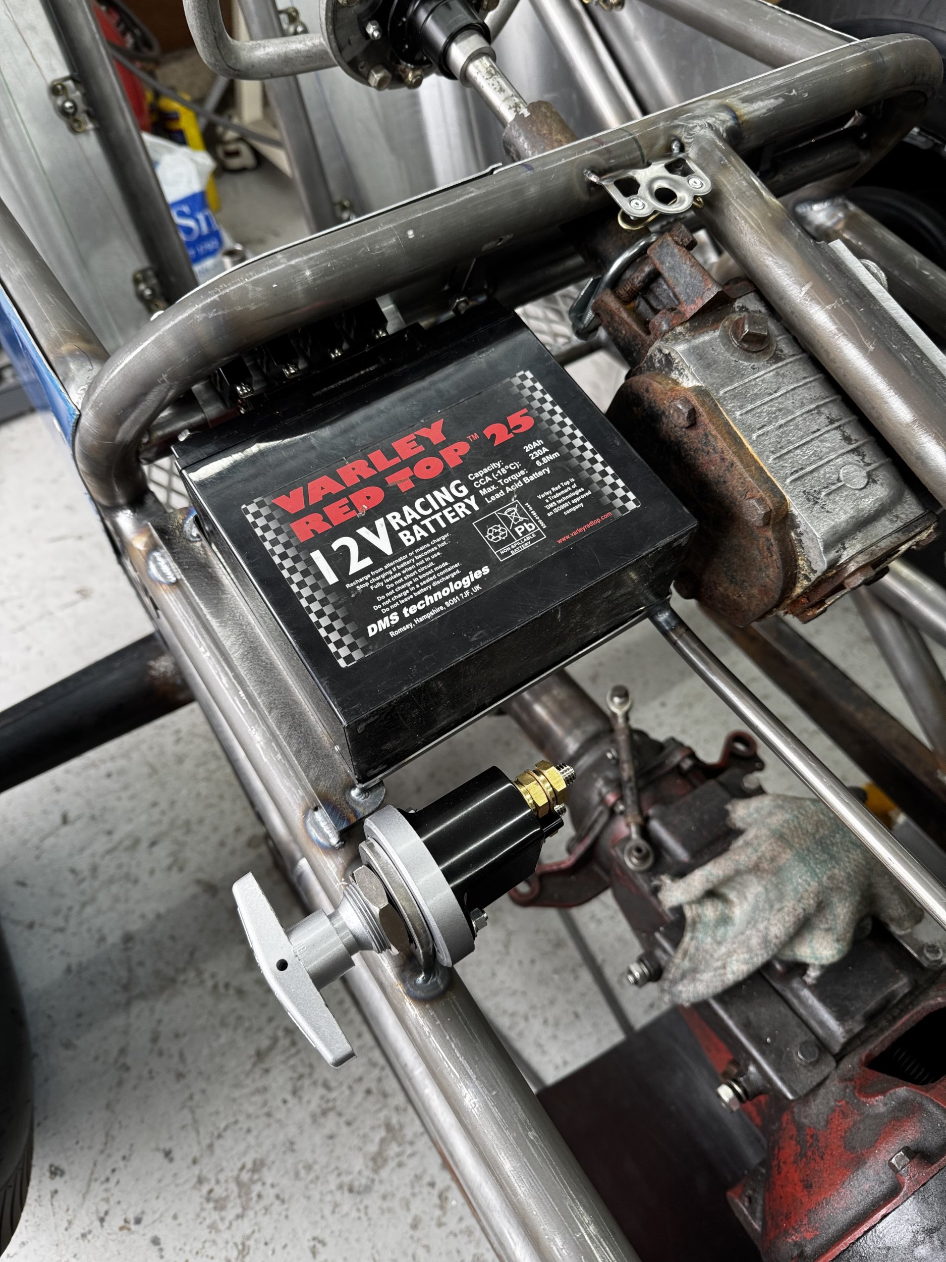

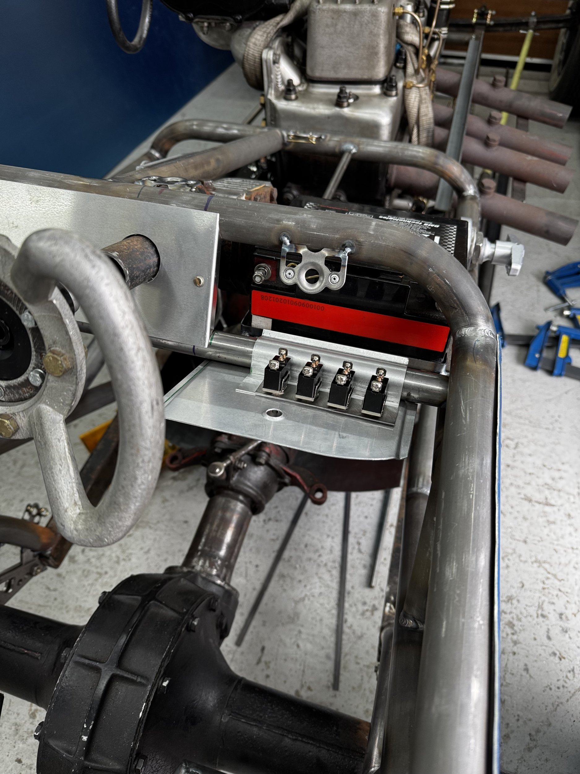

    All the big bits done, time to tackle the small time consuming bits.

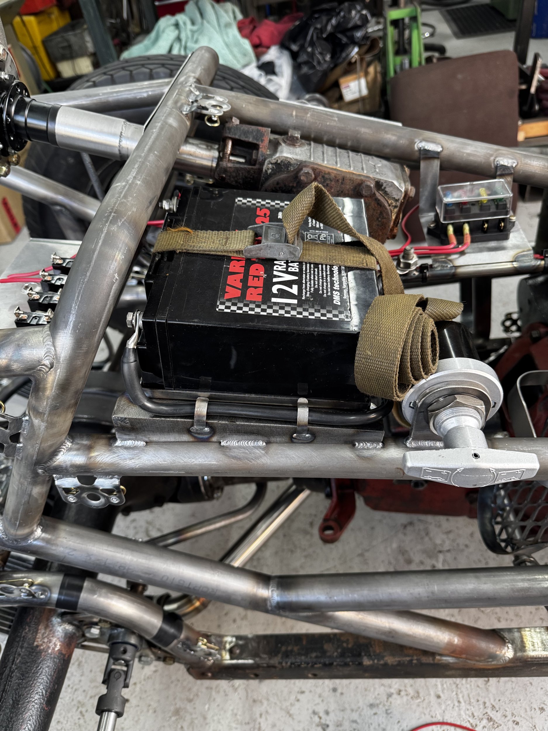

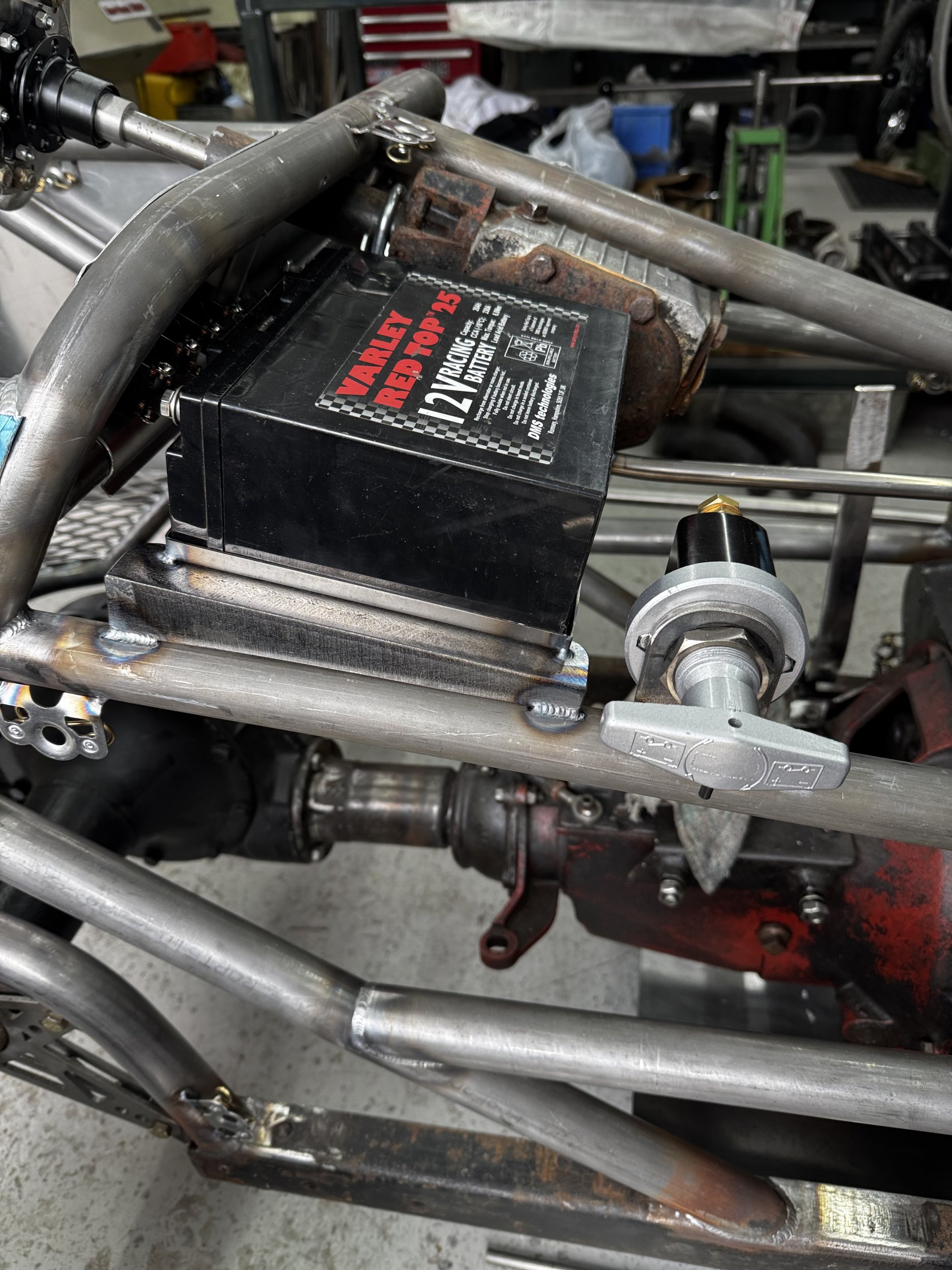

    Mounting the battery, making the dash panel with an easy access to the battery terminal for charging.

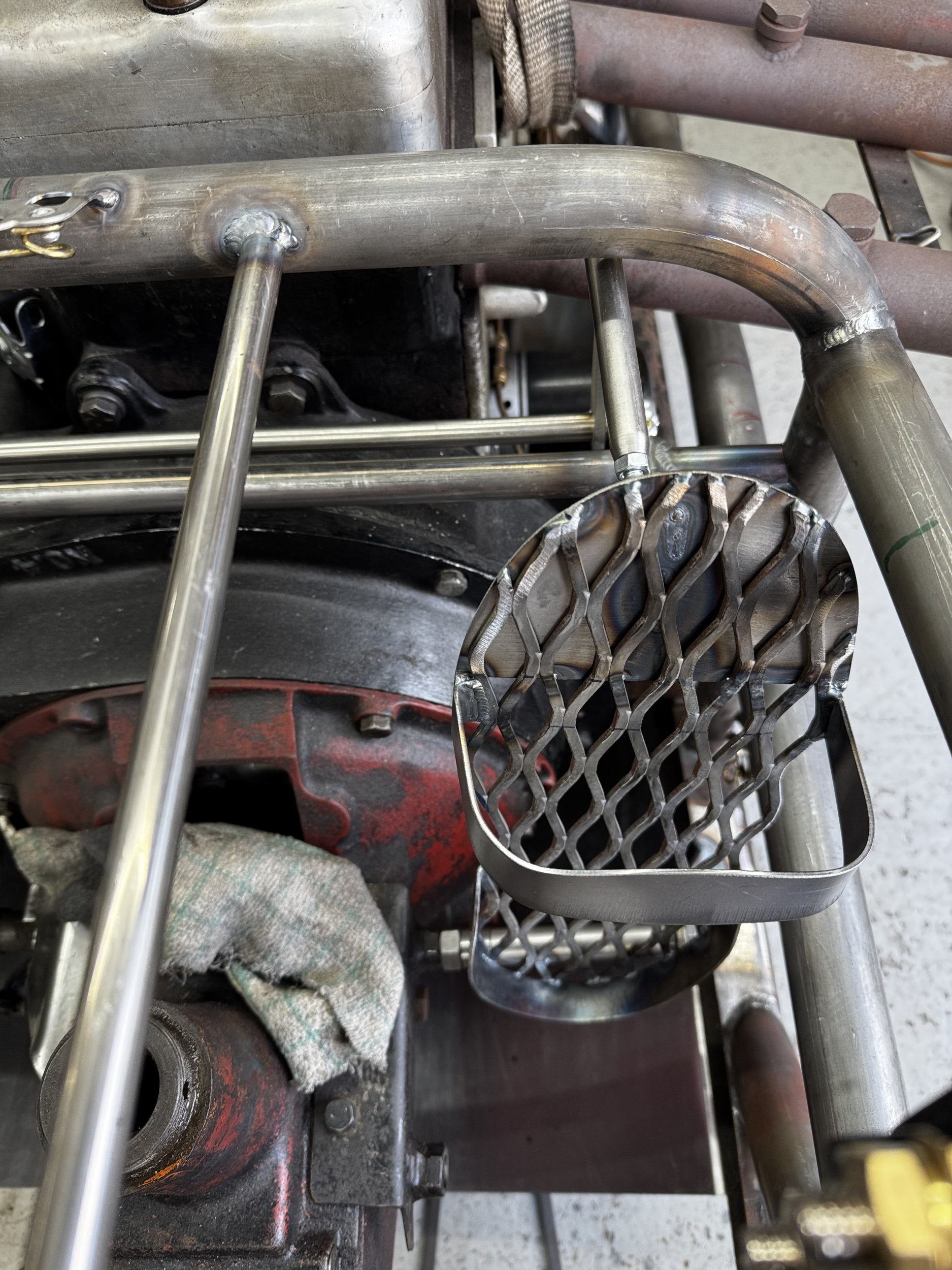

    the lightest, strongest throttle pedal I could make quickly

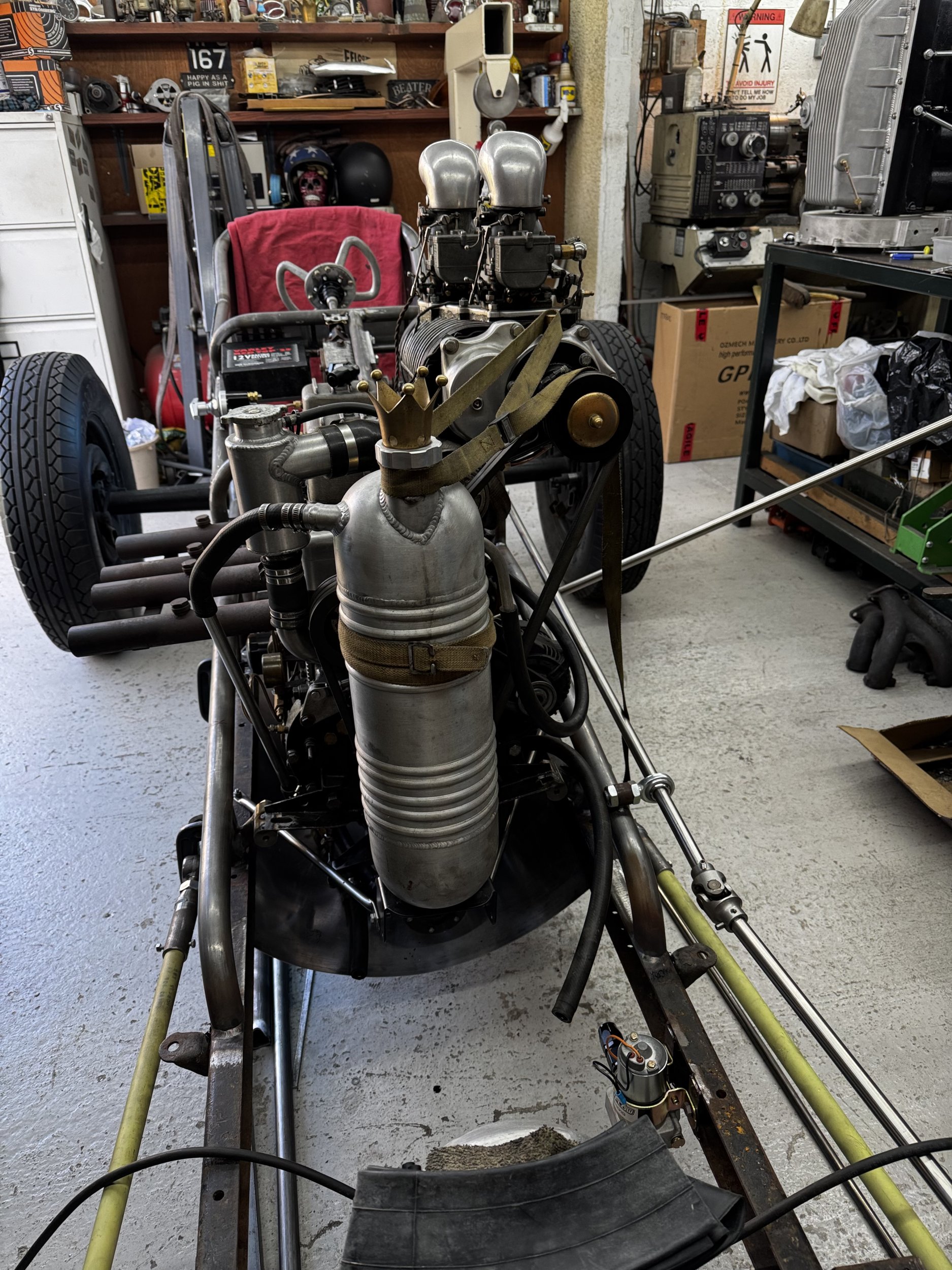

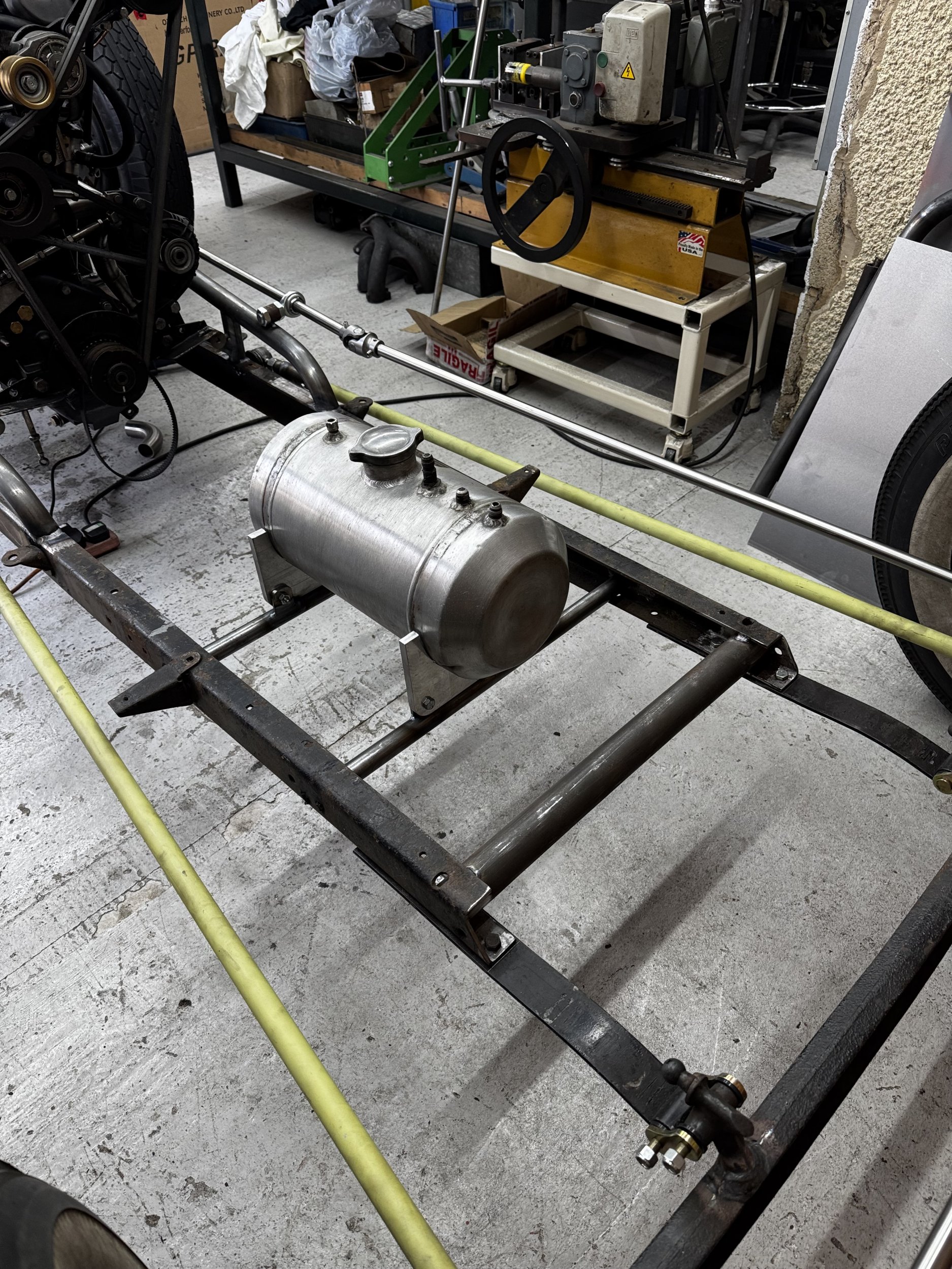

    Mounting the oil tank for the dry sump motor

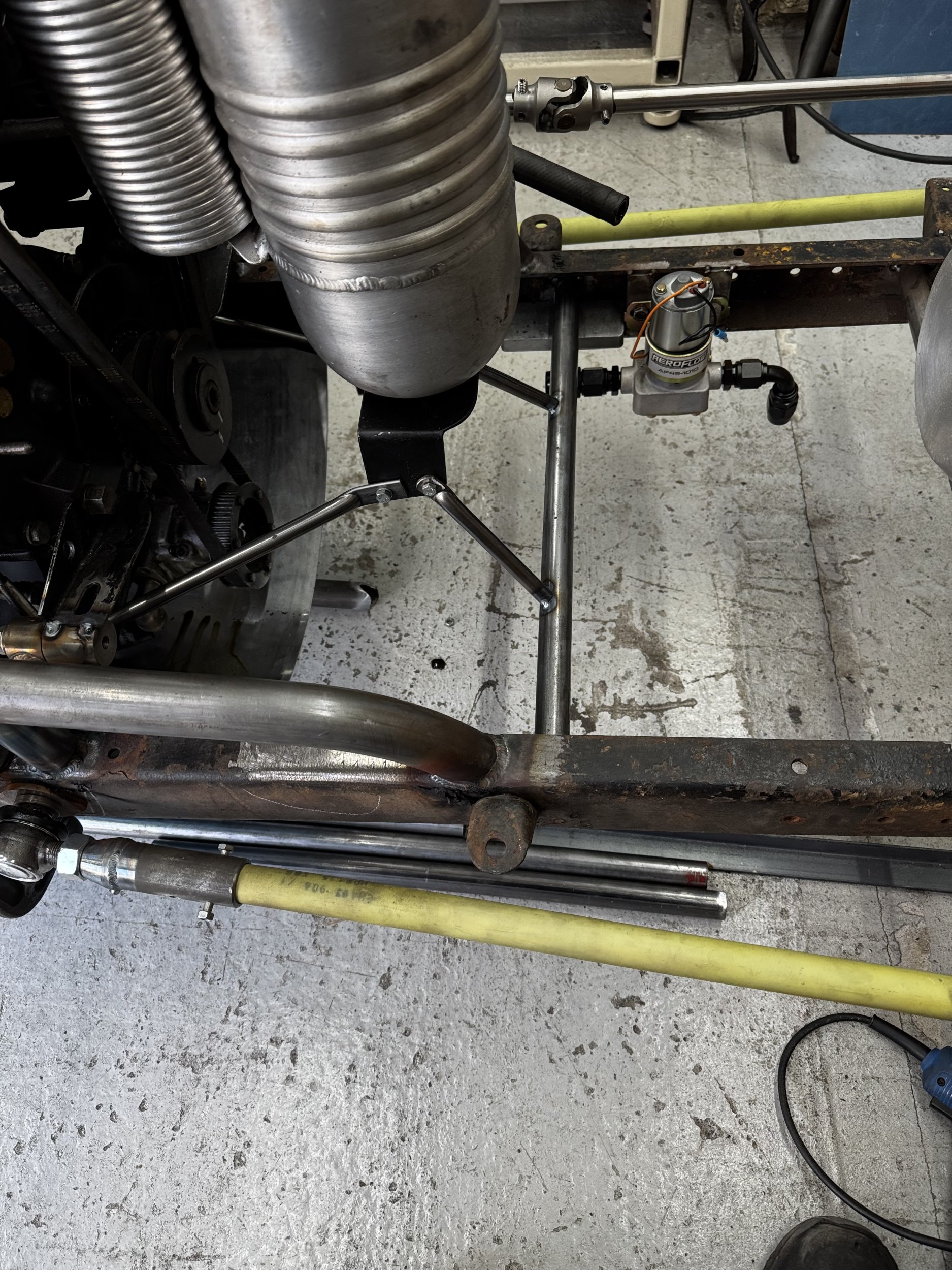

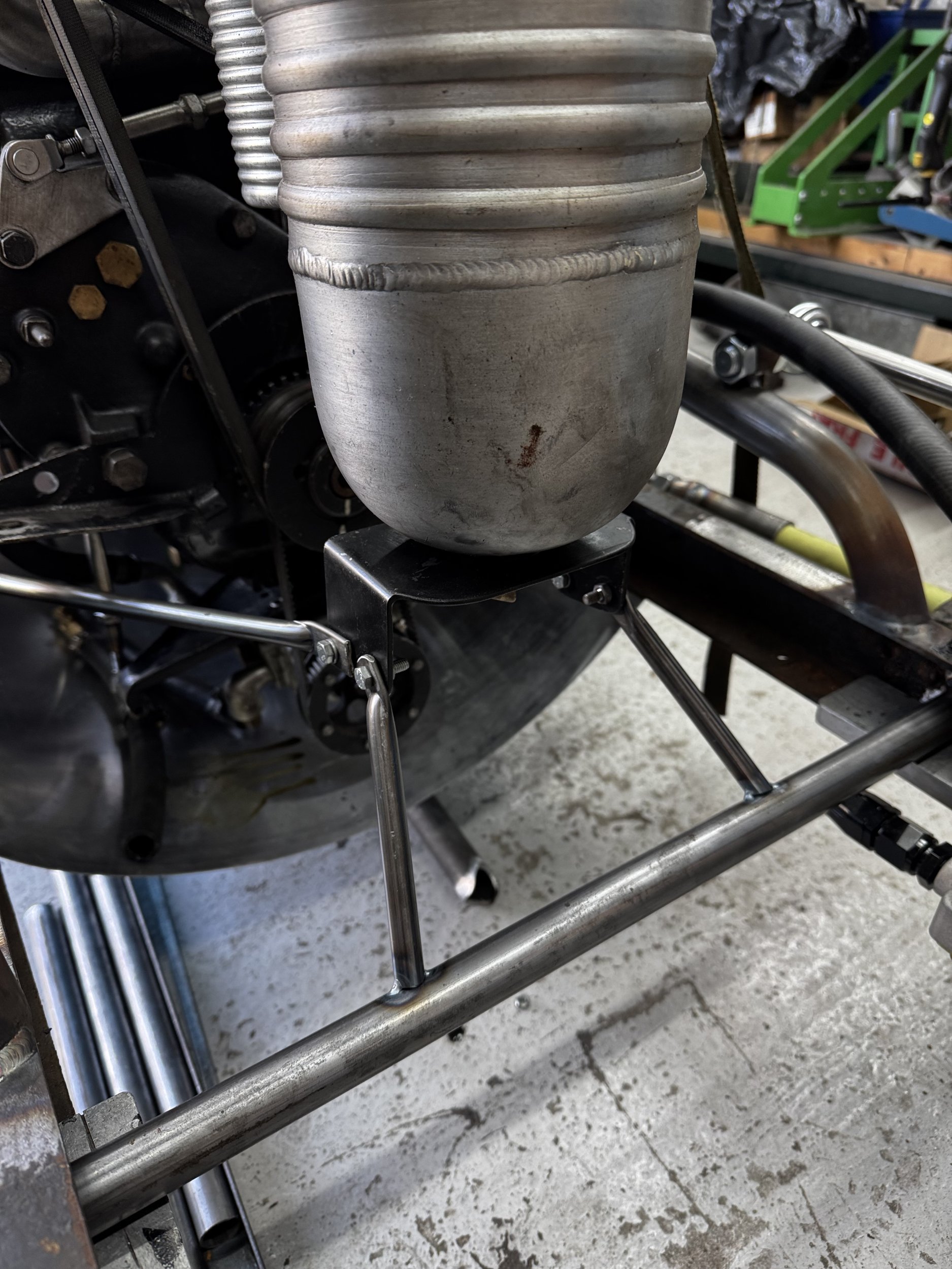

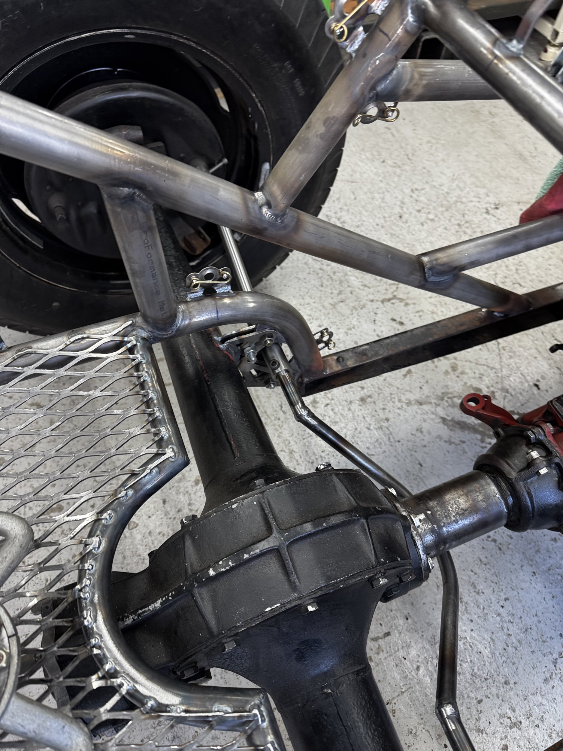

    One of the bits I wanted to use from the T was the mechanical rear brakes. I made a rod that went under the torque tube. This connected to a uj, rod and another uj. Add an arm with a series of holes to adjust, a rod with left and right rod ends and an old Hurst Indy shifter with pool ball top. Brakes!

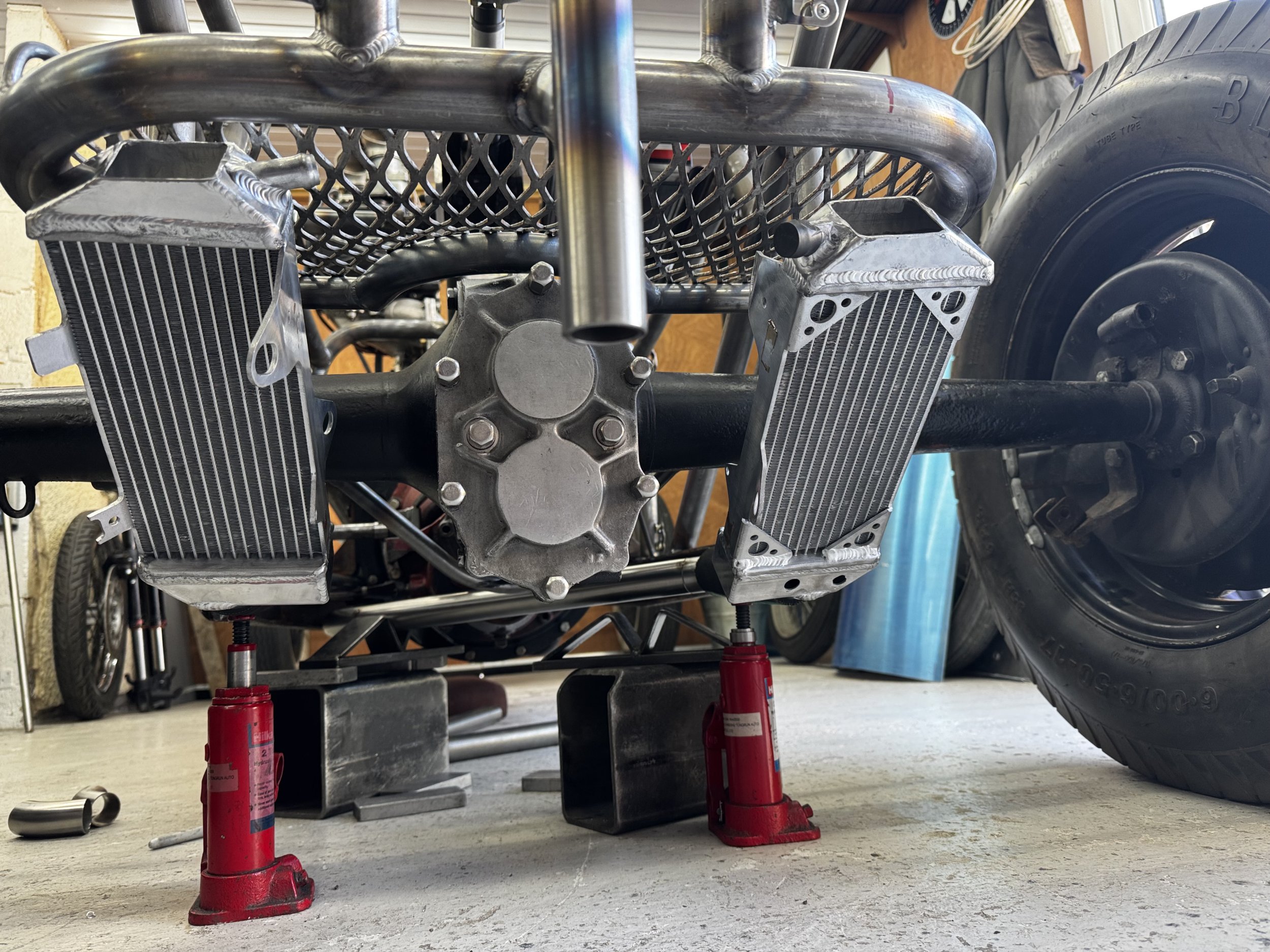

    As the engine had an electric water pump, I bought two small motorcycle radiators. Mounted them under the seat and piped up with some stainless tube.

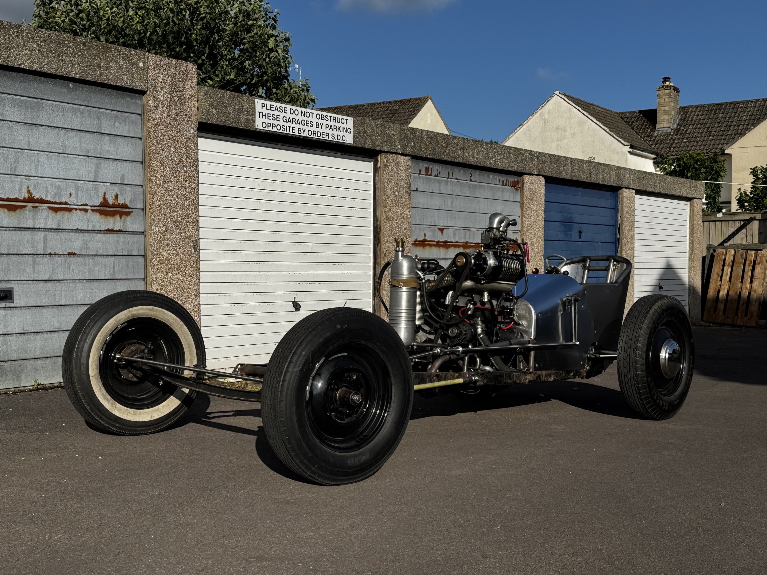

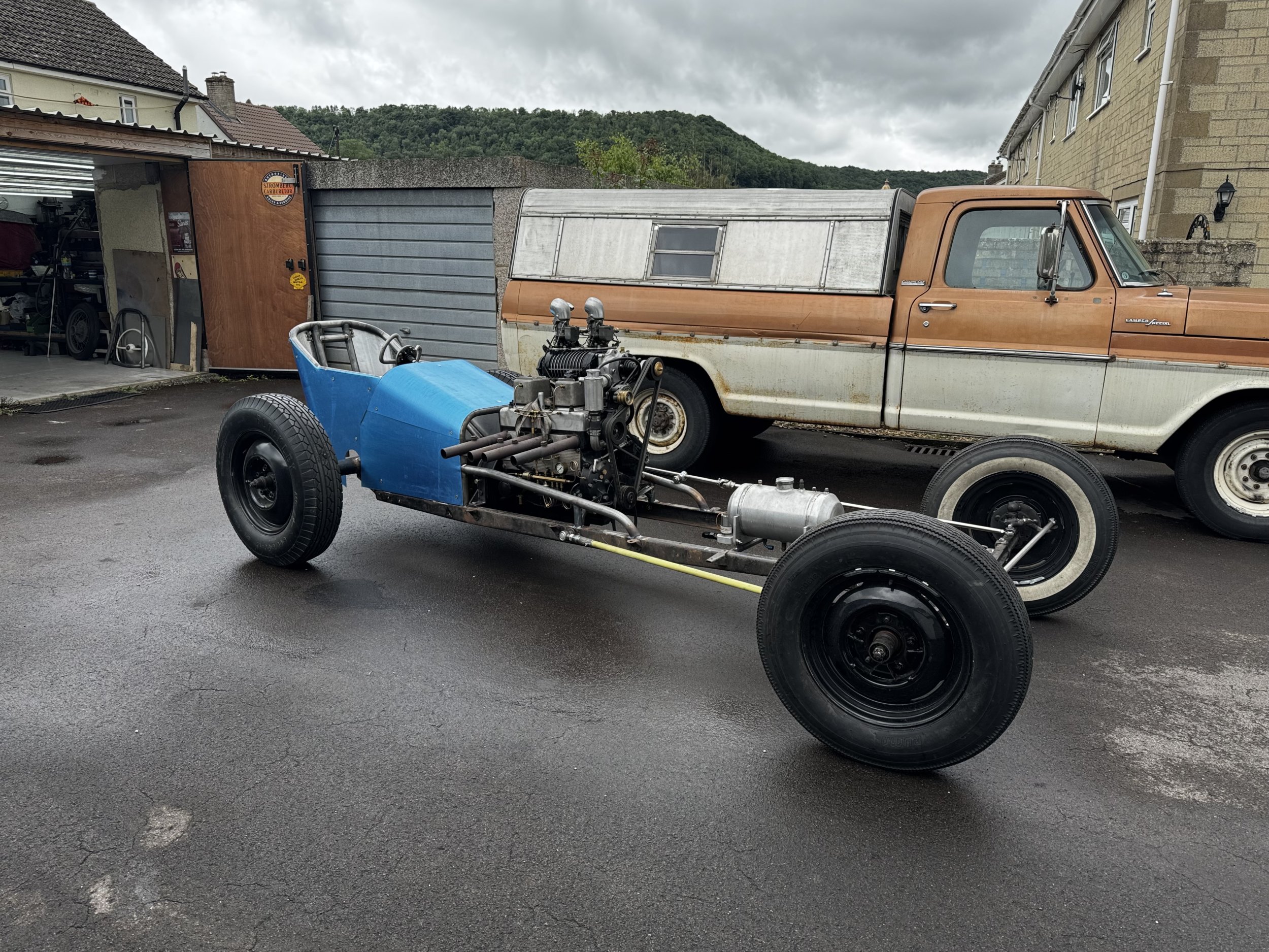

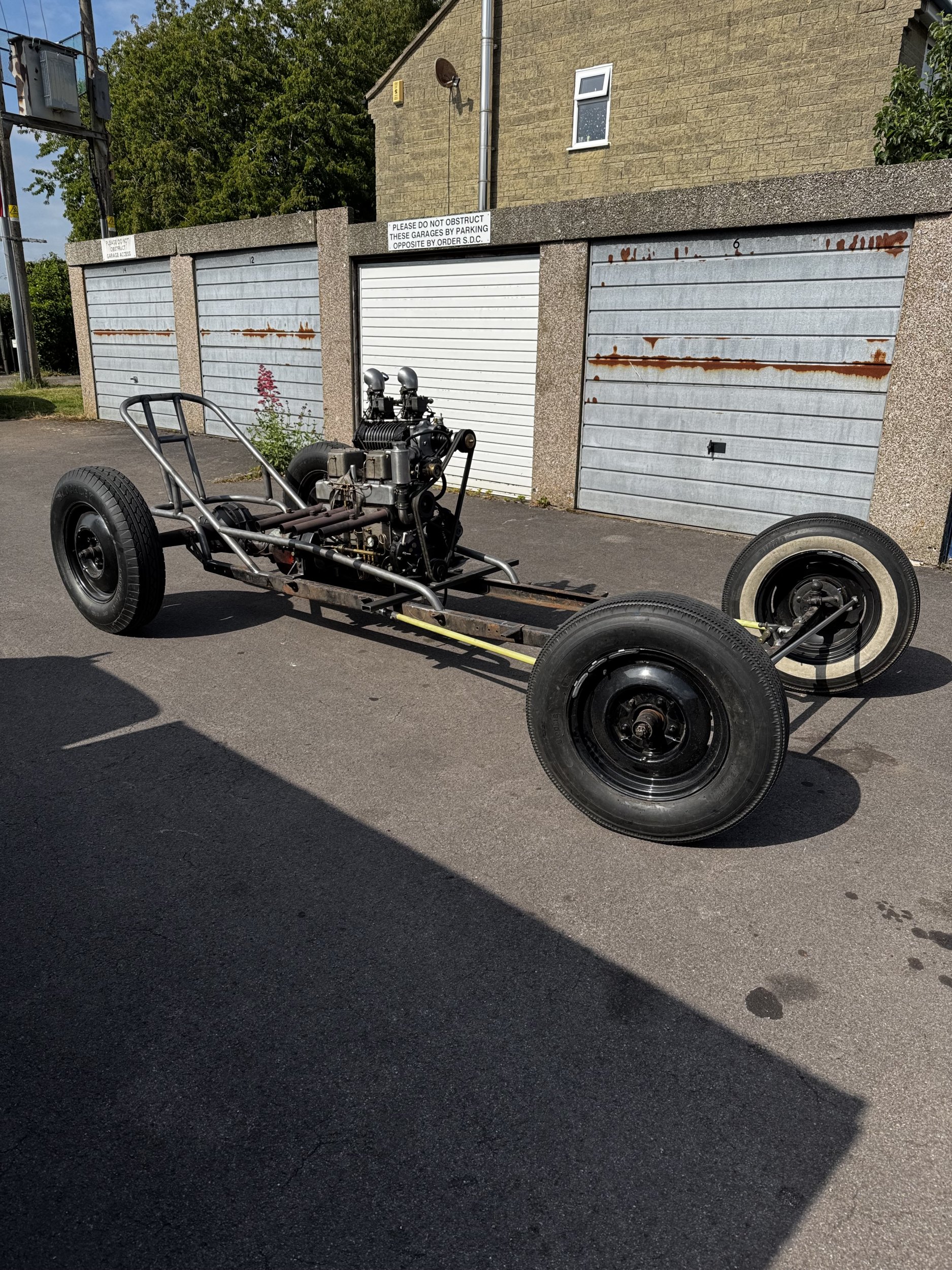

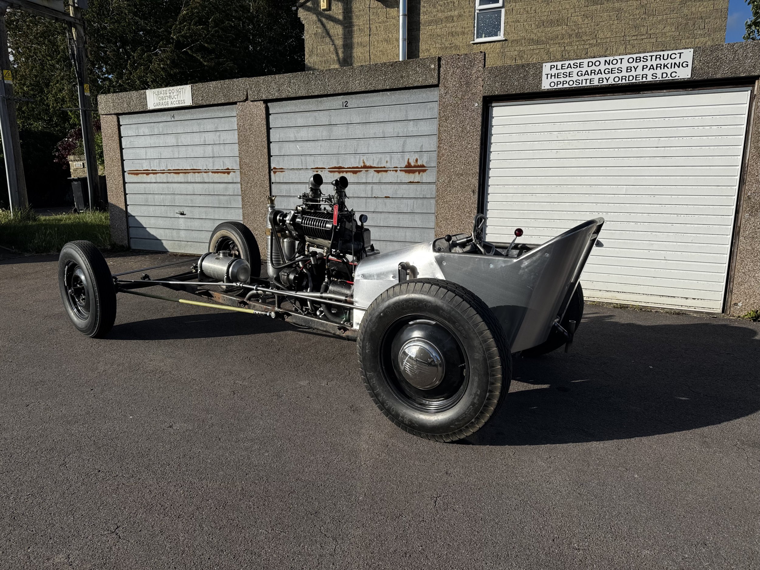

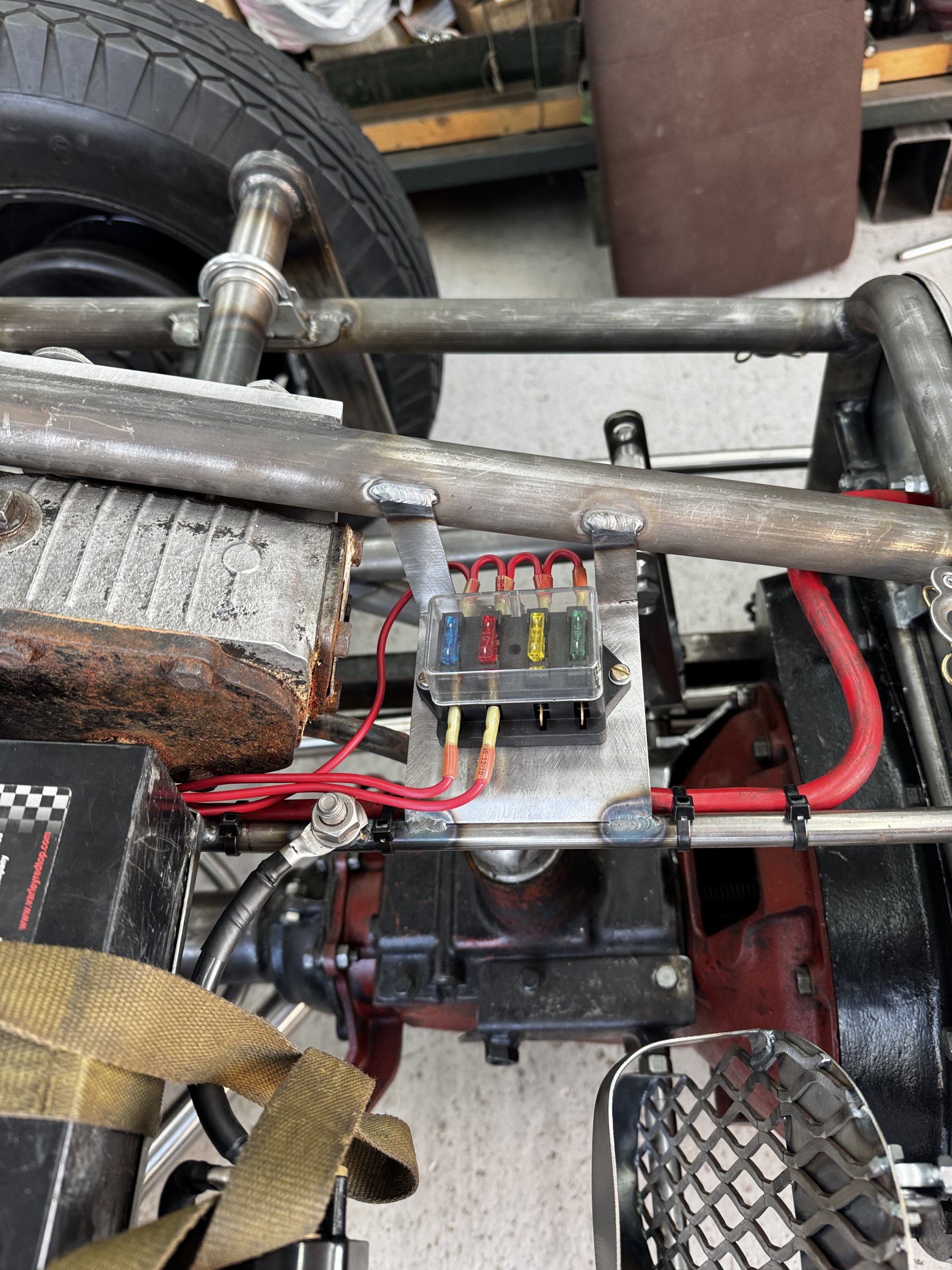

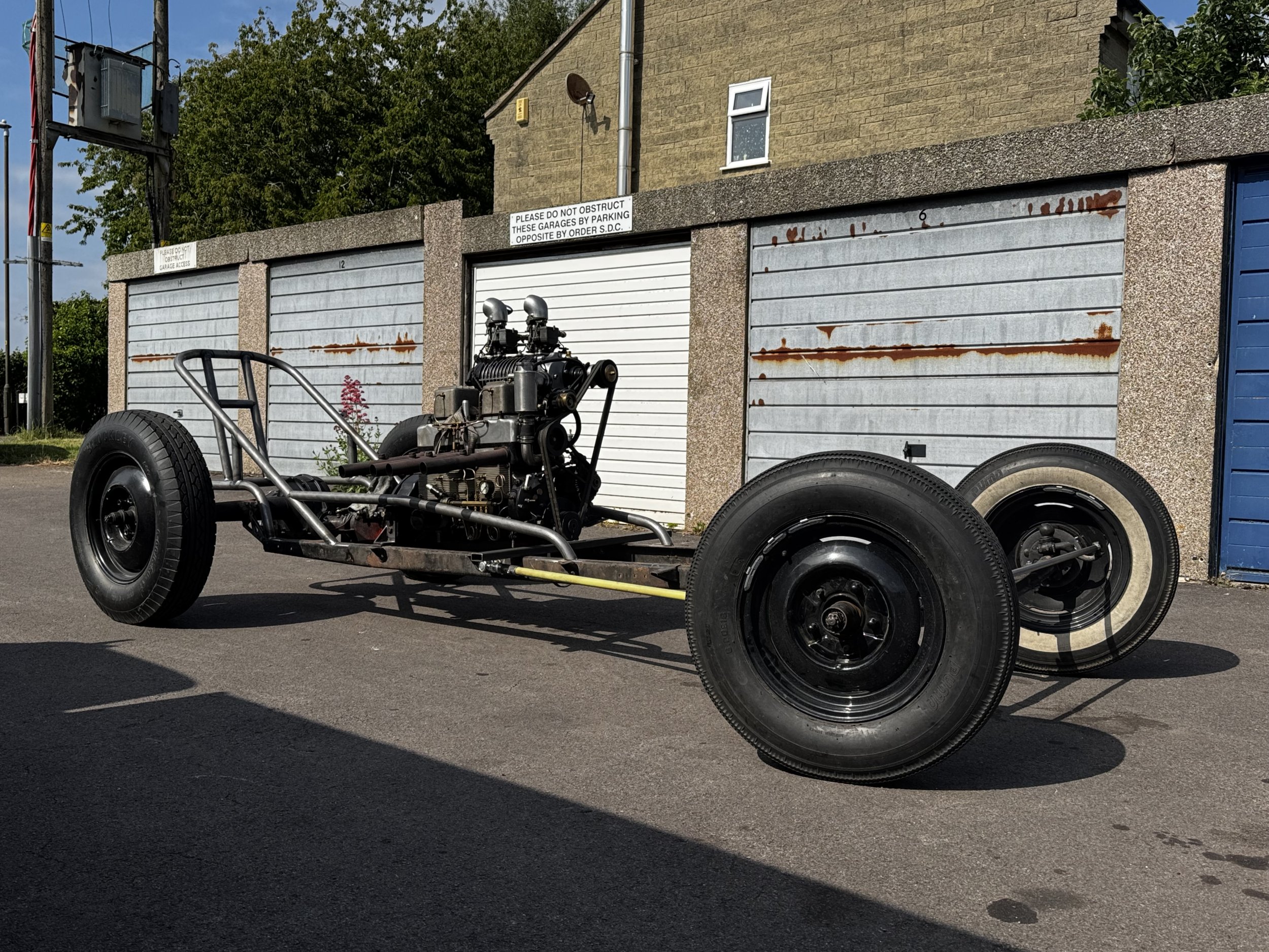

    Bit of wiring, temporary battery strap, remove the blue layer and done for now.
    IMG_1340.jpeg IMG_1341.jpeg IMG_1350.jpeg IMG_1351.jpeg IMG_1352.jpeg IMG_1353.jpeg IMG_1354.jpeg IMG_1356.jpeg

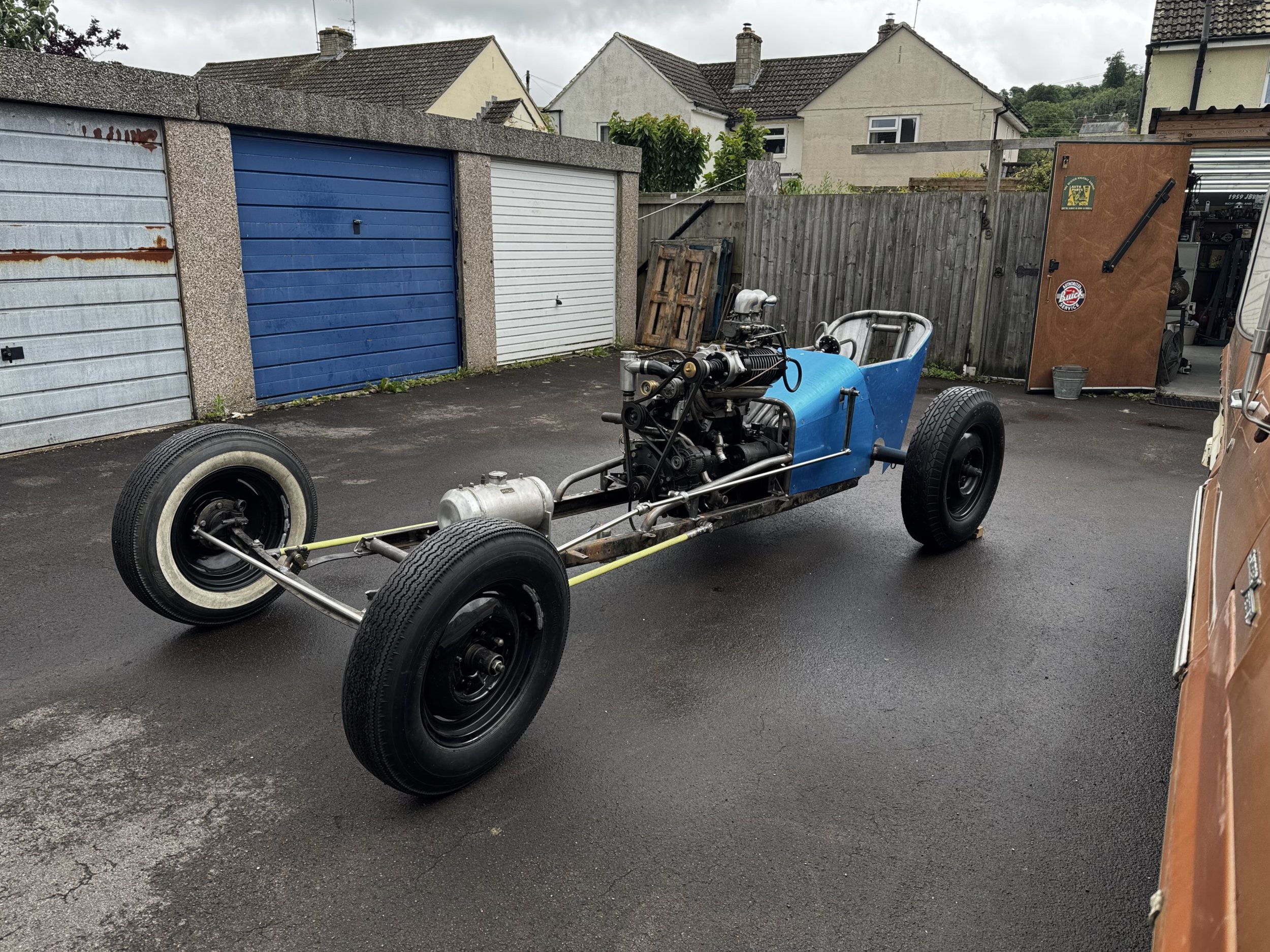

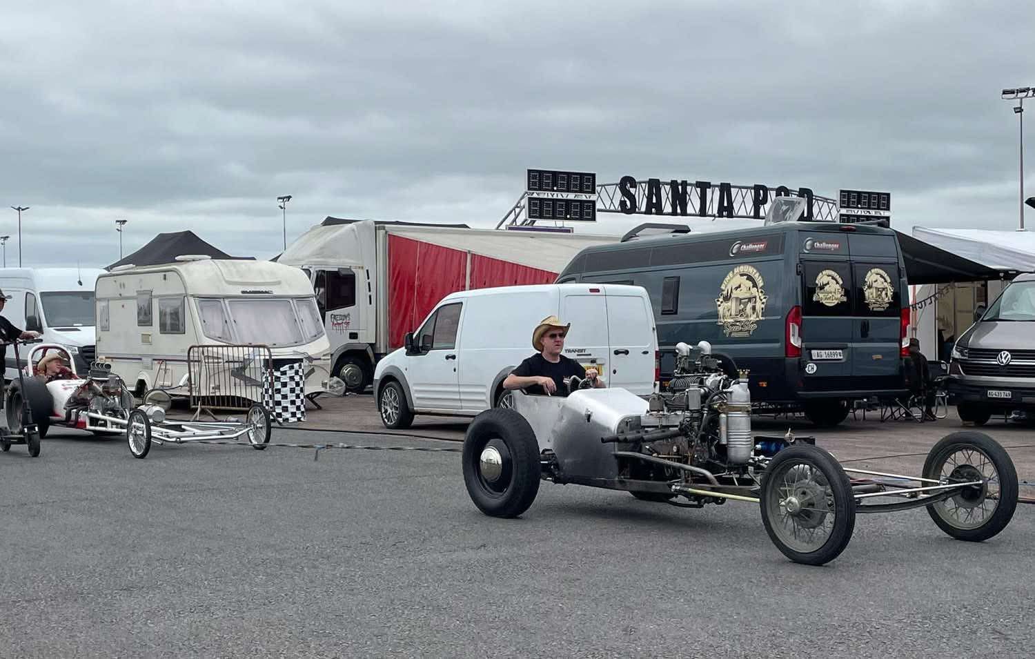

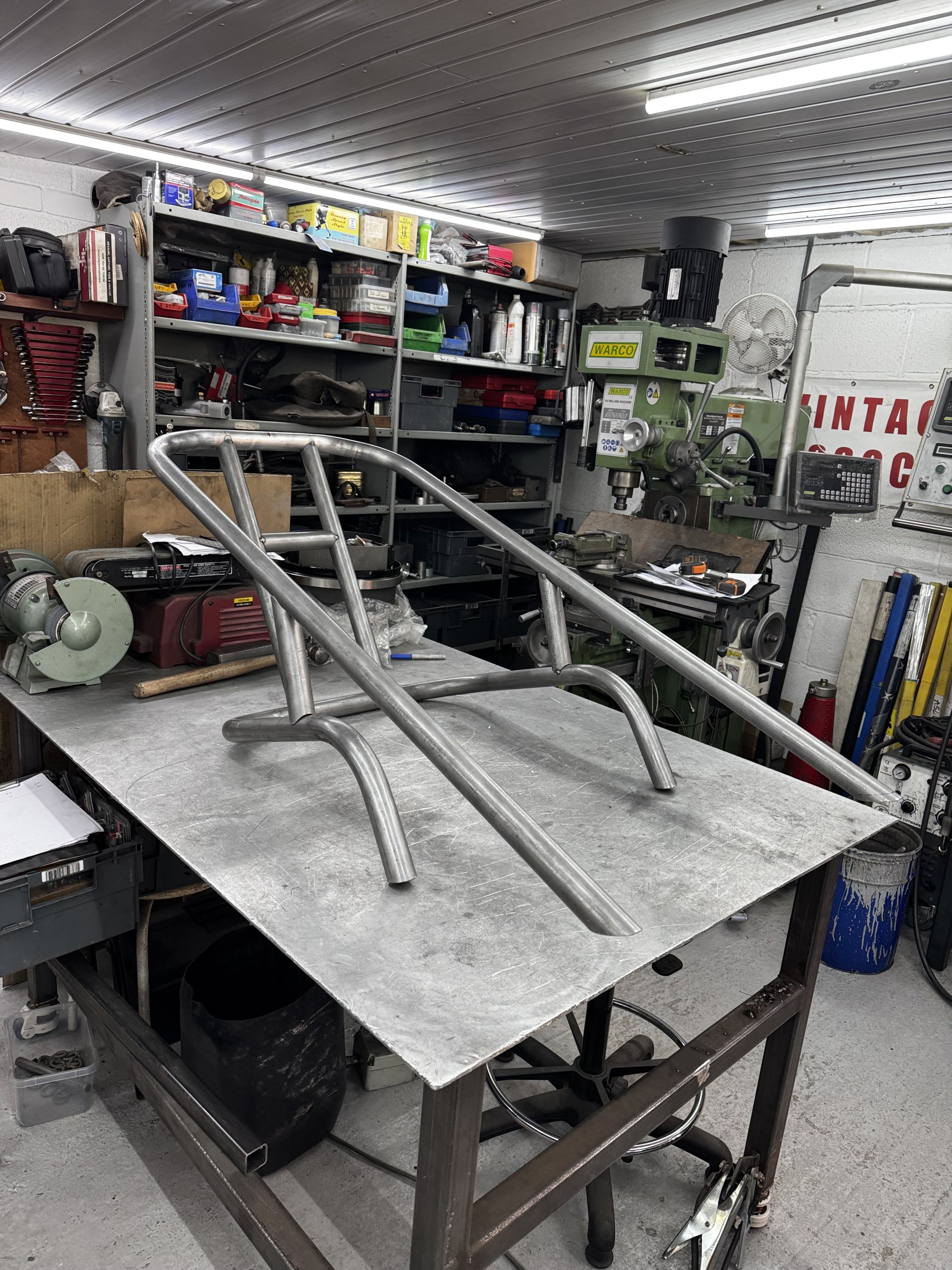

    This was last Wednesday. Thursday morning we packed up to go to Santa Pods Dragstalgia.
    No, the car isn’t finished. It need a roll bar. I did make and fit one but didn’t like it so it was cut off. It’ll need front shocks and an under tray to comply with our club rules.

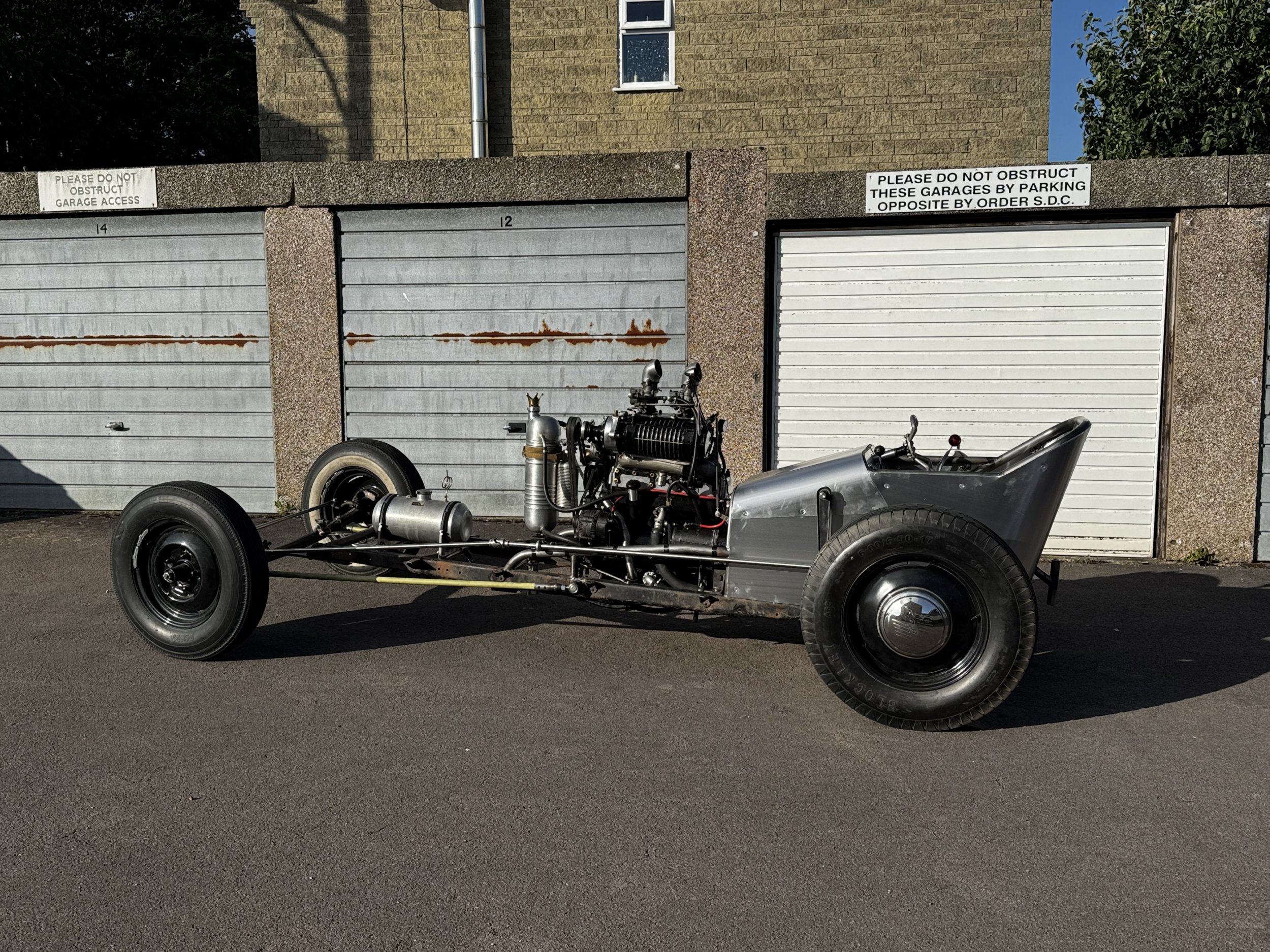

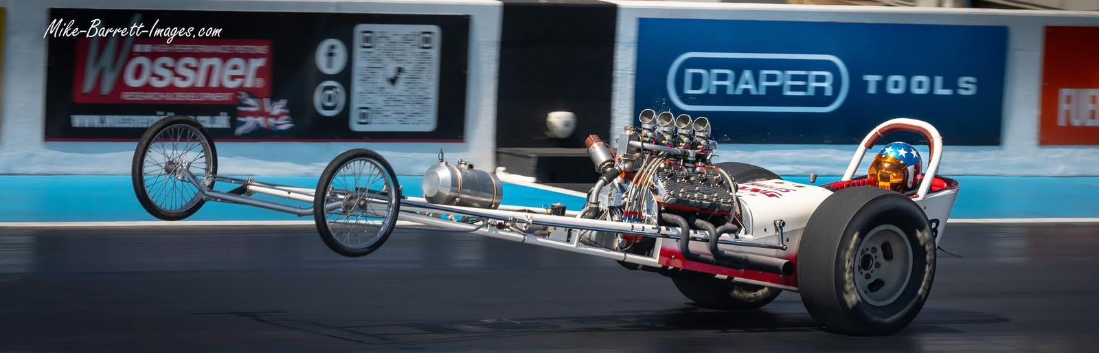

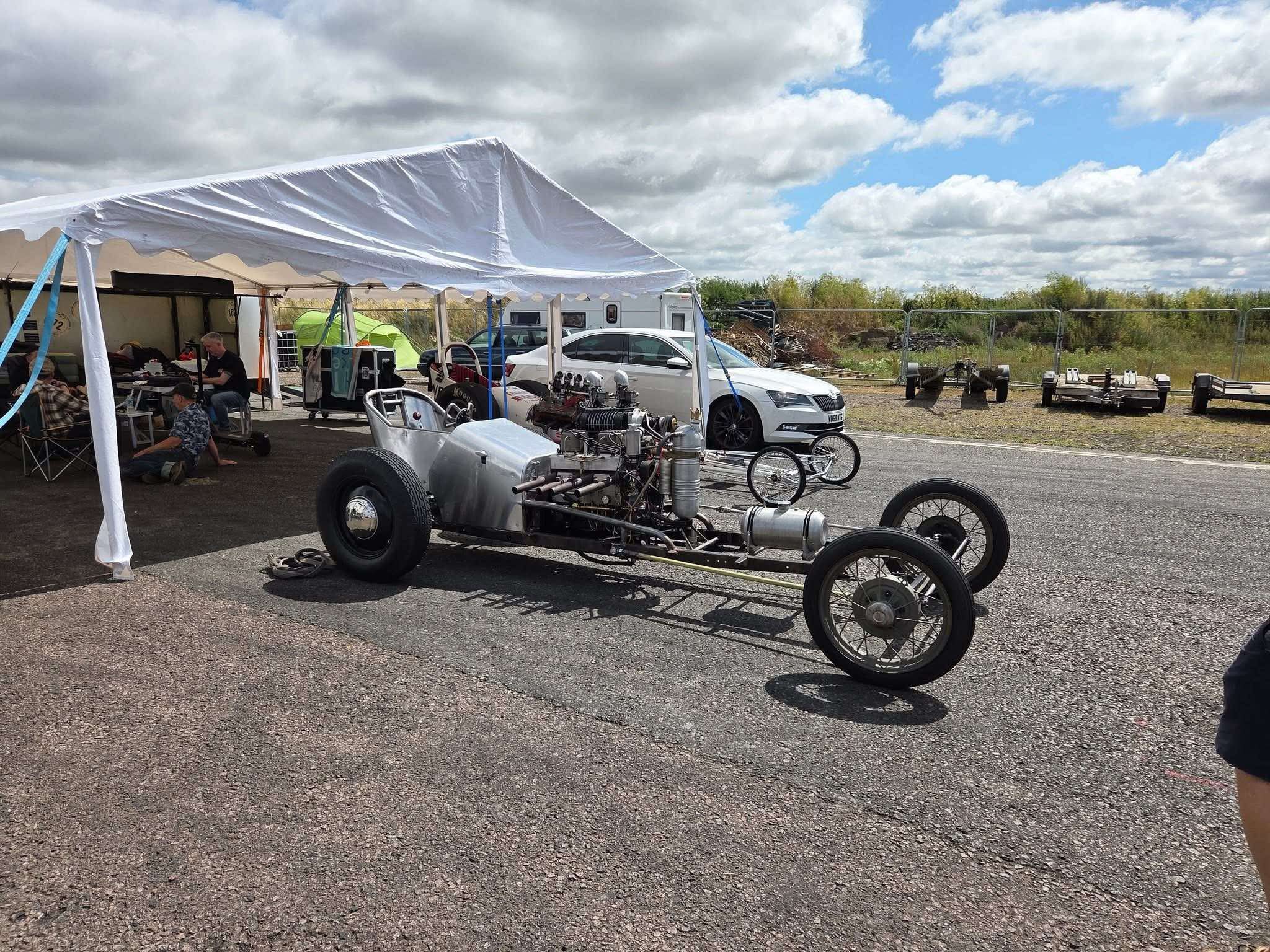

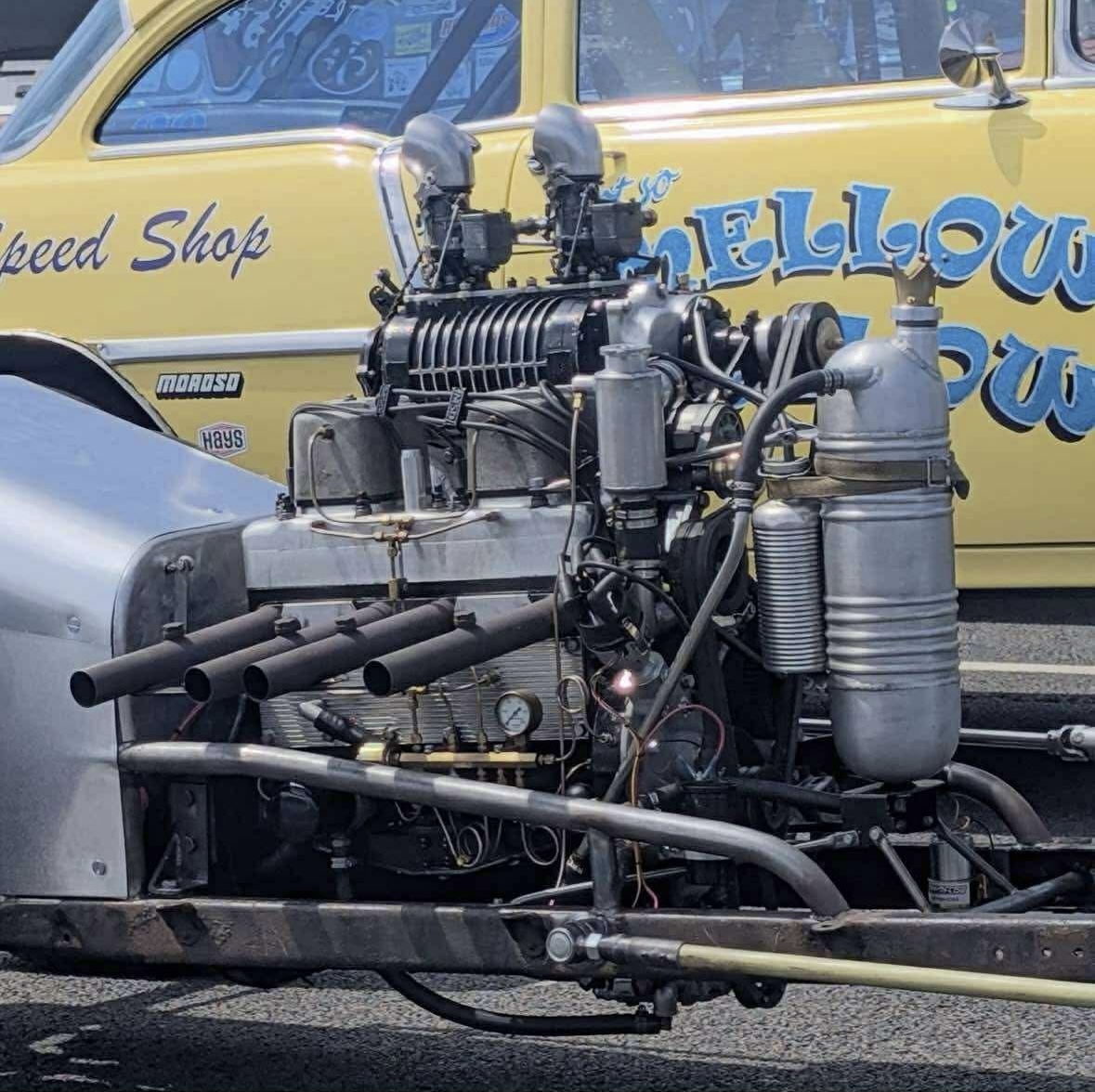

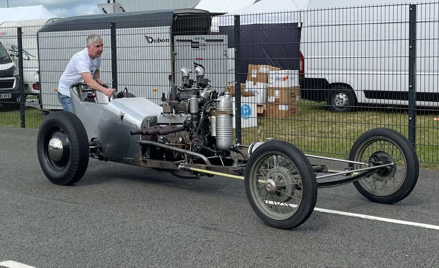

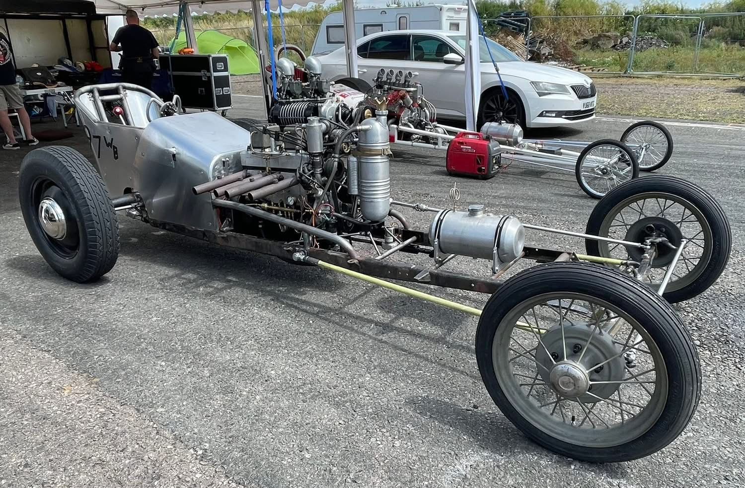

    Finally some photos from the weekend. We used the car to tow the other flathead dragster we run. f3c0614754d1f64d35173cfdc7570ab6.jpeg
    435d5deb940e2e86bc815d3931227c88.jpeg 50c427c0dd33c9a17057343260106acf.jpeg 029e2e8b4962d9a02d7f50008eeb4676.jpeg a600cf67a1f2e45cfce9e676a2fc56ee.jpeg IMG_1394.jpeg
    And the other car we run.
    credit to the photographers, thank you.
