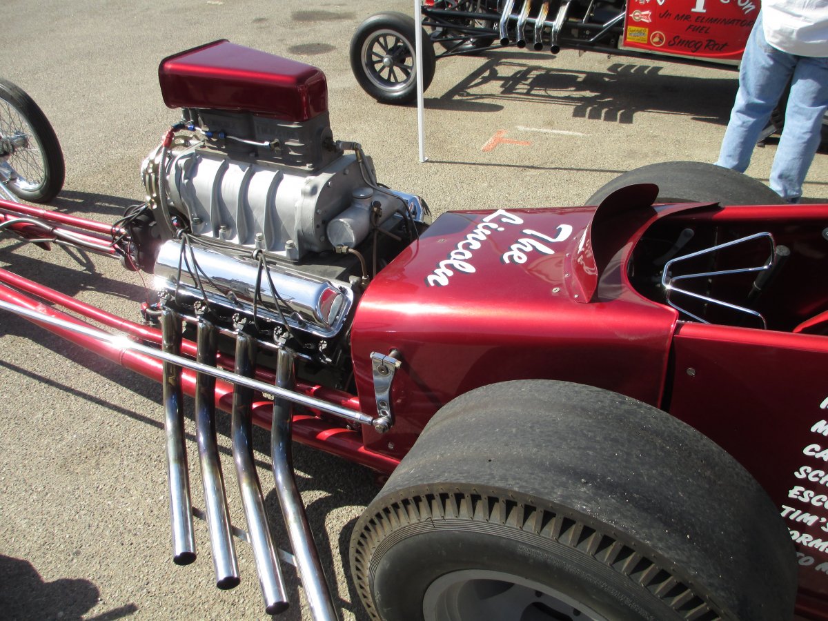

  25. Marty Strode
    Joined: Apr 28, 2011
    Posts: 9,737
    Marty Strode
    chryslerfan55 and Deuces like this.

  28. wbrw32
    Joined: Oct 27, 2007
    Posts: 7,314
    wbrw32
    Marty,back in the days of Ted Cyr and Rodney Singer,,FORGED TRUE was the hot ticket,
